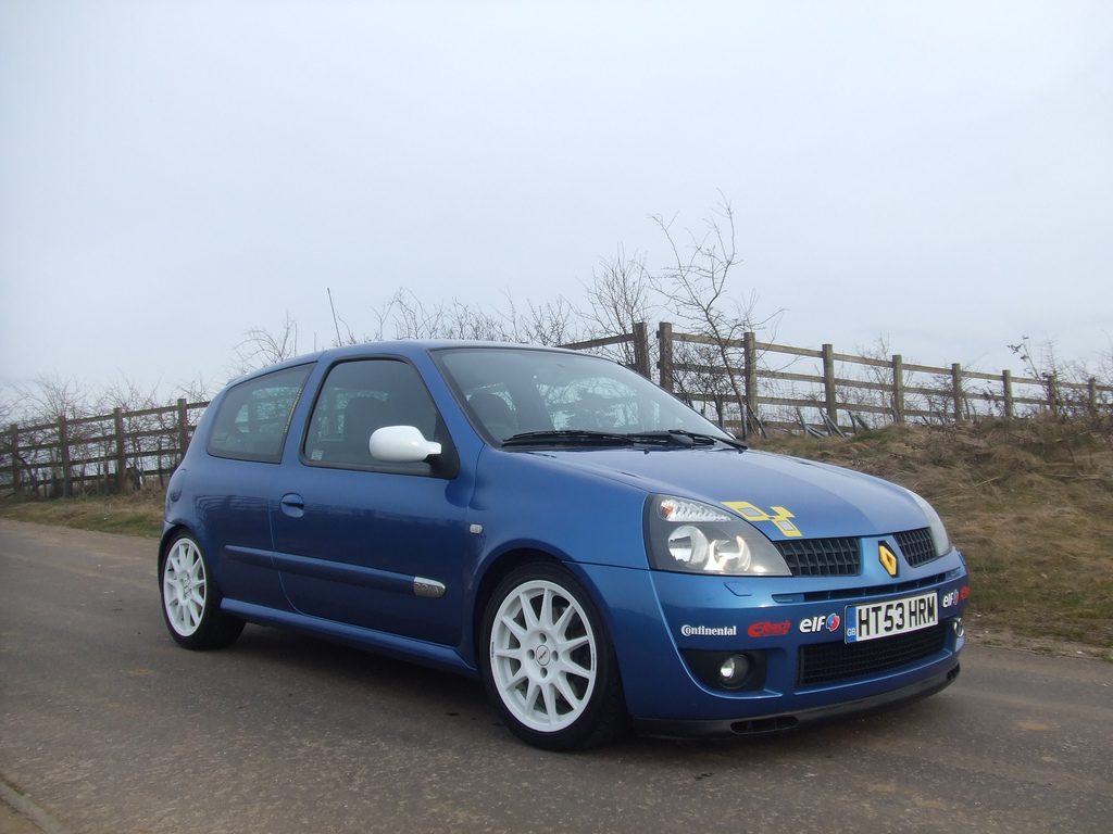

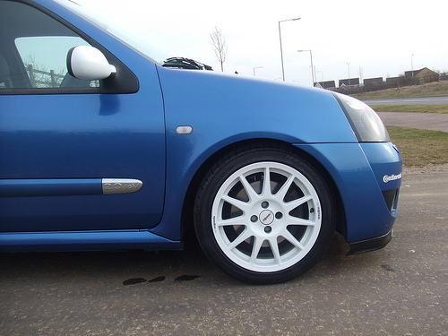

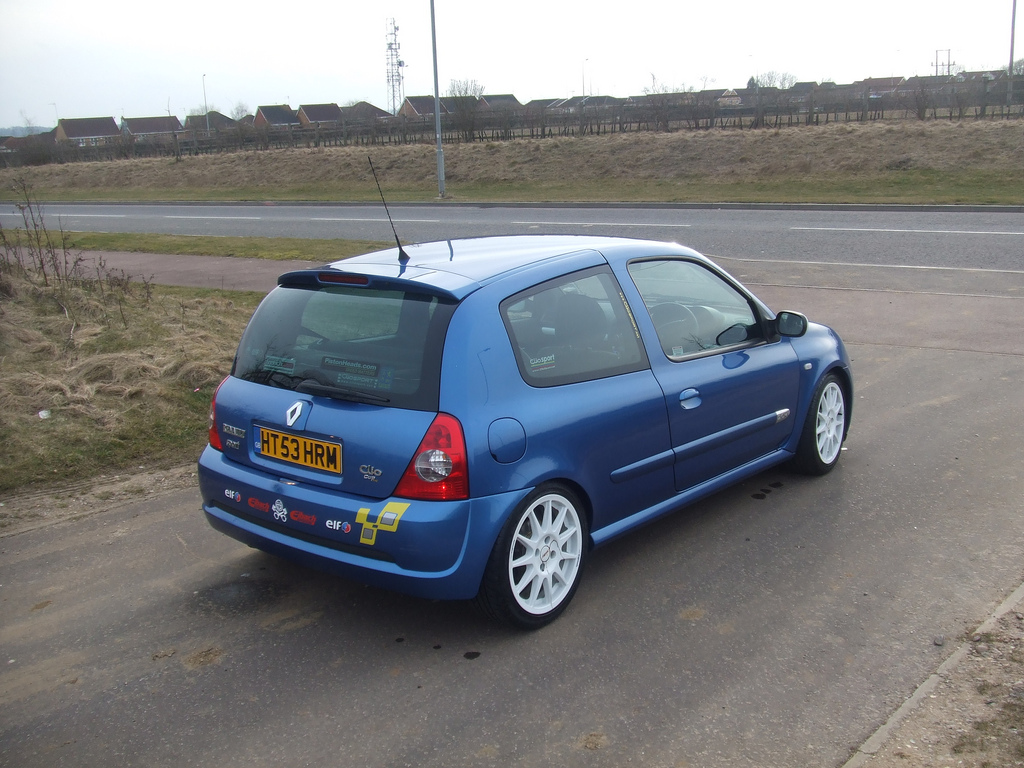

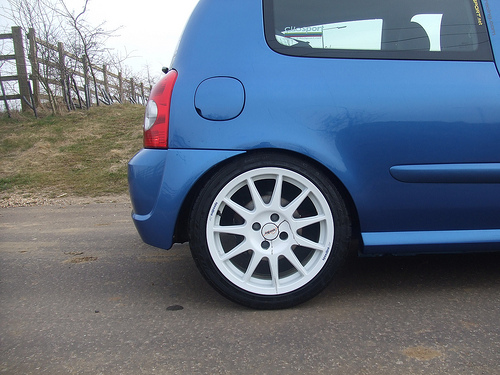

Here ya go:
They should settle after a while so will have to wait to see if thats any good.
