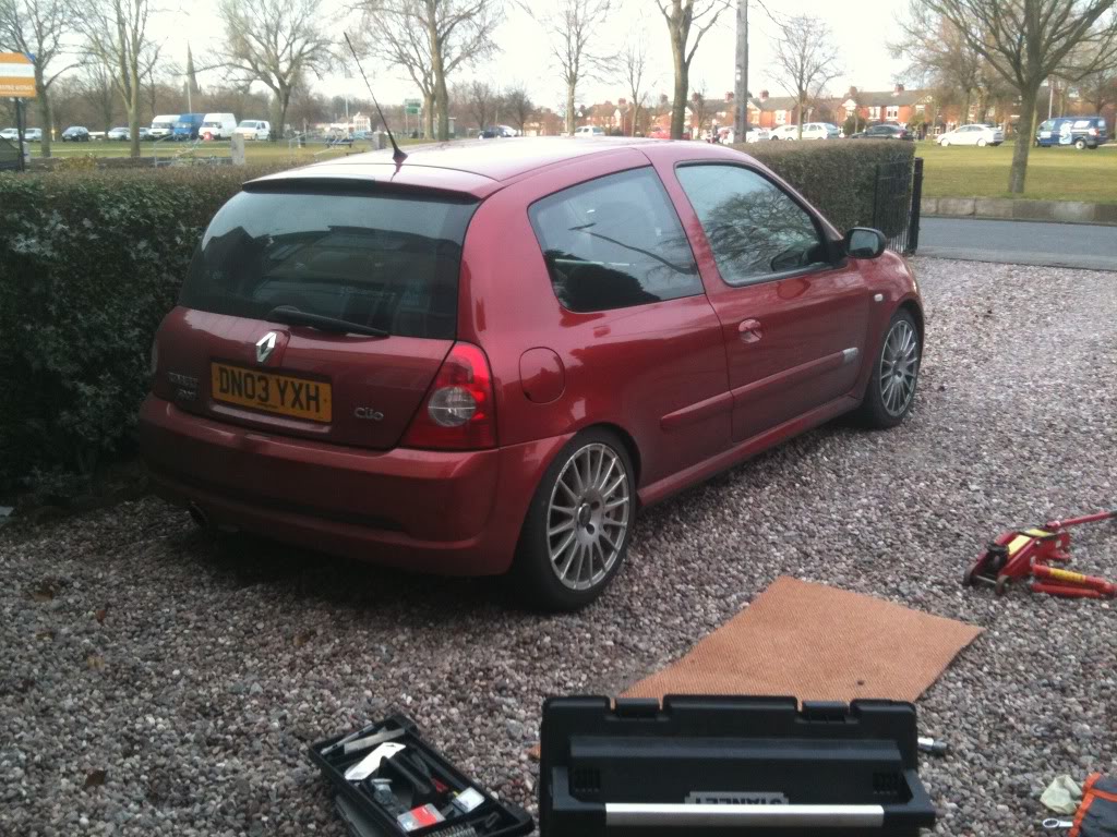

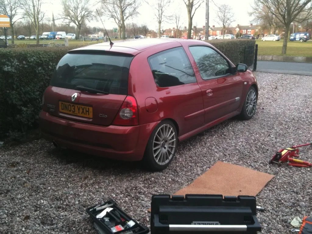

Well got the fronts finished and set up yesterday. Bit of a bugger to get camber set up to run for a few weeks to allow them to bed in before getting them professionally done but think I've done ok with getting them both equal with a very slight touch of negative camber. Found out when removing one of the struts what the rattle had been and why my car hasn't felt as if it had handled too well recently; top part of the spring had managed to get above the cup it is supposed to seat in.
Thanks to thos who already fitted and had adjusted to having so many threads on show, saved me ages so I knew roughly how many threads on show would give me a decent drop/stance. Settled on 50 at the moment. Theres a few speed bumps on way to work I will nee dto be a bit careful of with my Cup splitter but hopefully should be ok. I also covered them in waxoil to hopefully protect the threads and keep them shiny as I live right on the coast so good chance they will look pretty corroded pretty fast otherwise.

mine are on now, (big thanks to da;)), went for 54 threads on the fronts, and the rears all the way down, also removed the bump in the arch, we took her for a test drive and so far so good no scrubbing ect, very impressed with them tbh feels like a different car to drive, also took her out with my normal passengers and no rubbing/scrubbing over rough roads/speed humps, so overall im sooooo glad i bought these, however it is gonna take some getting used to with the lack of body roll, as compared to standard shocks ect it feels strange going round bends and having been used to the roll i still feel like i want to compensate for it and oversteer in the corners lol.
but my honest opinion is these are the bargain of the f**king century imho, my car feels planted and they arent too stiff ect. i love the stance and height is spot on for my tastes. tried the best we could to get the camber something like, but feels ok to drive do hopefully it wont be too far out.
just need to let them settle in and have them setup proper like;).
