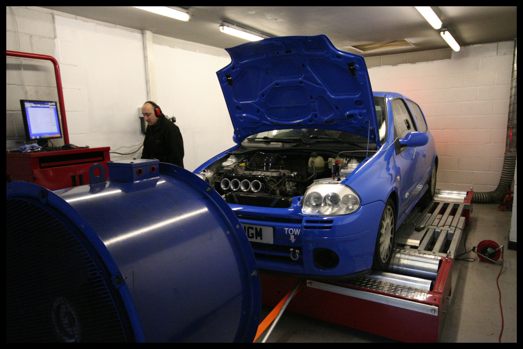

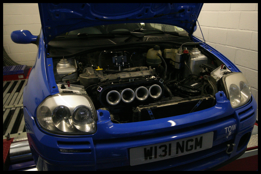

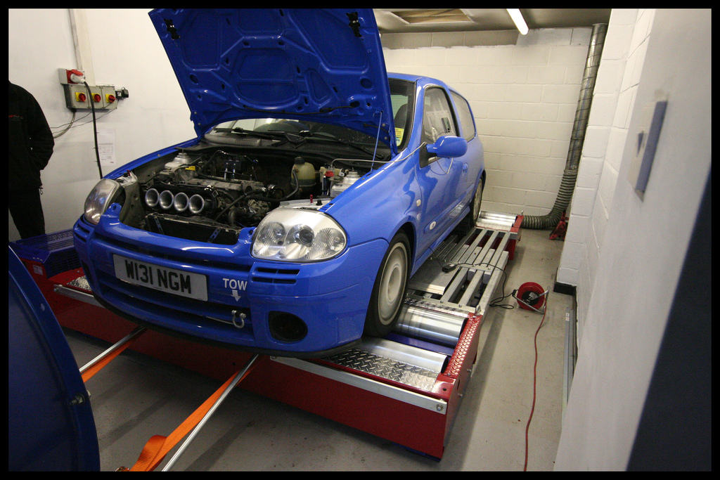

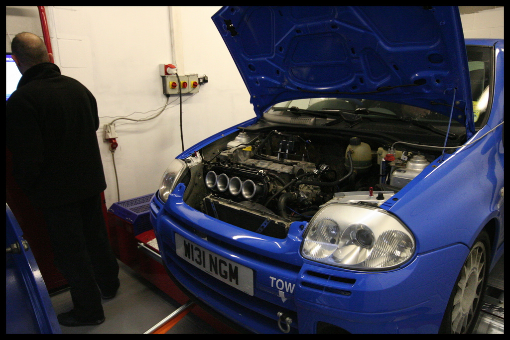

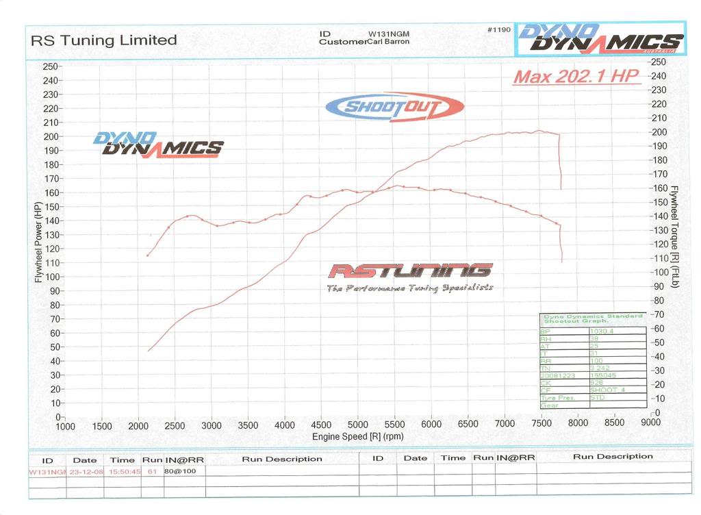

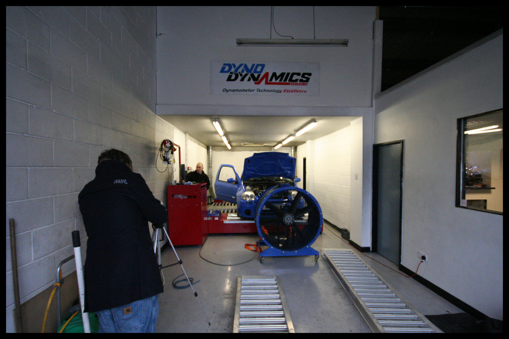

Since the car was now running we decided to book it into RStuning at leeds to get them setup and mapped. We somehow managed to get to leeds making the 1h 20m journey will flames comming out of the exhaust and not being able to let the car idle (would just cut out). When we arrived paul balanced the bodies with a trusty bit of tube (burning his arm in the process from a flame spitting out of the bodies). Once this had been complete it was then onto mapping of the car, with approx. 20-30 power runs the car was complete. The car is now running perfect and drives totally different, the lower down torque is incredible and the final bhp figure does not tell the whole storey. The car made 202bhp with catcam 420s (pretty much standard cams).

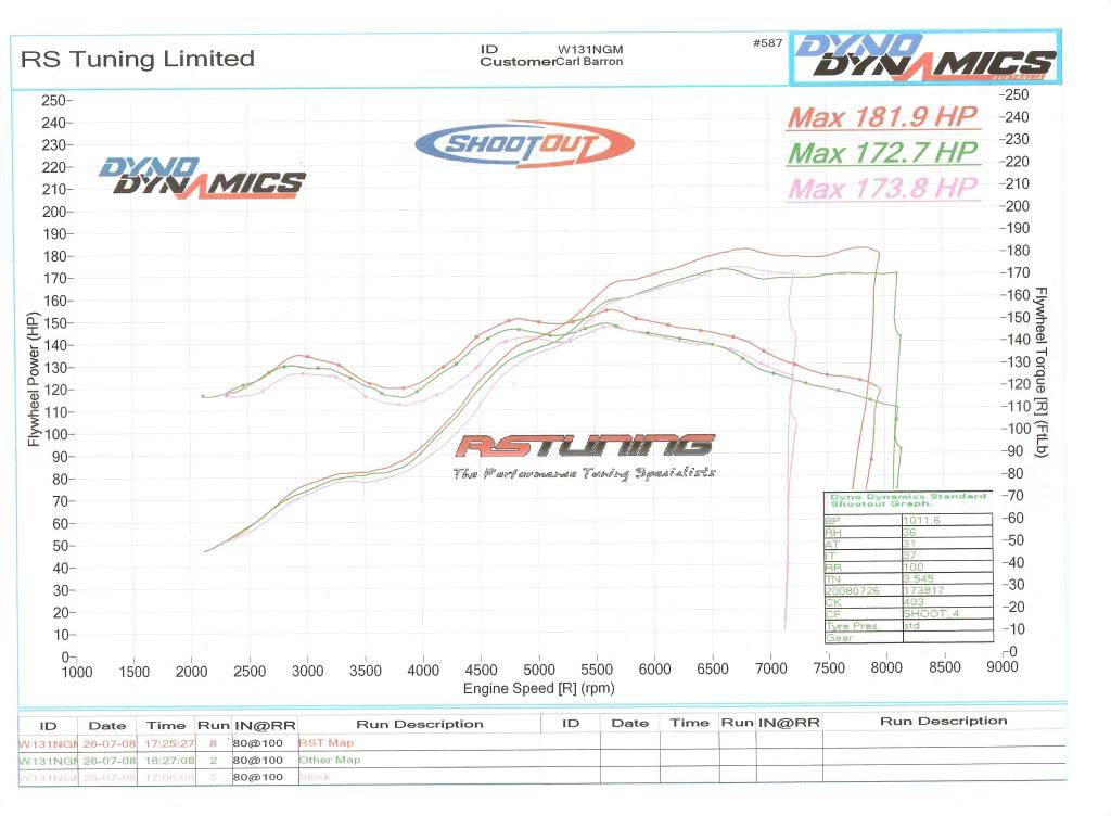

Before ITB's
This image has been resized. Click this bar to view the full image. The original image is sized 1024 x 752.
After (notice the torque!)

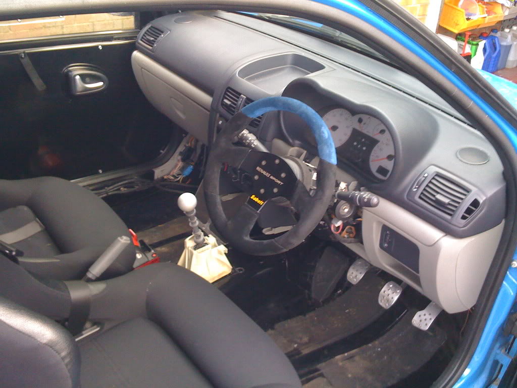

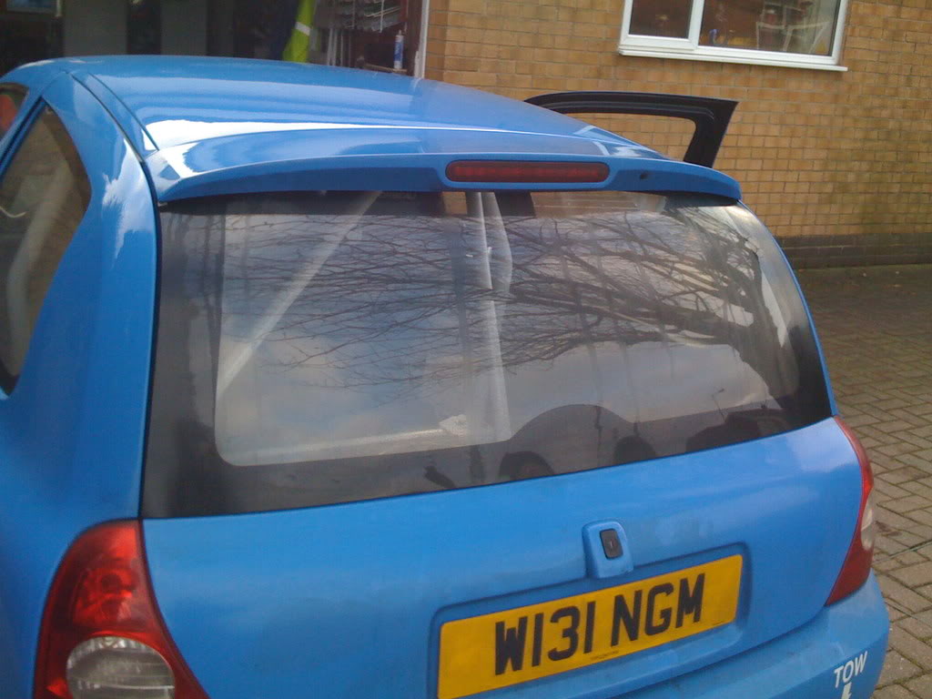

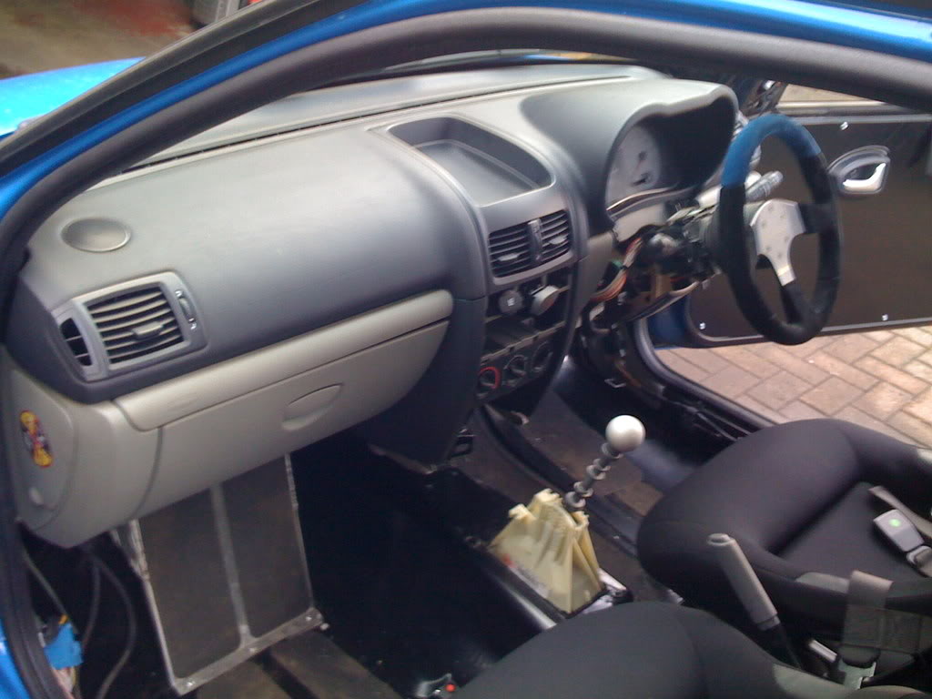

some from today
