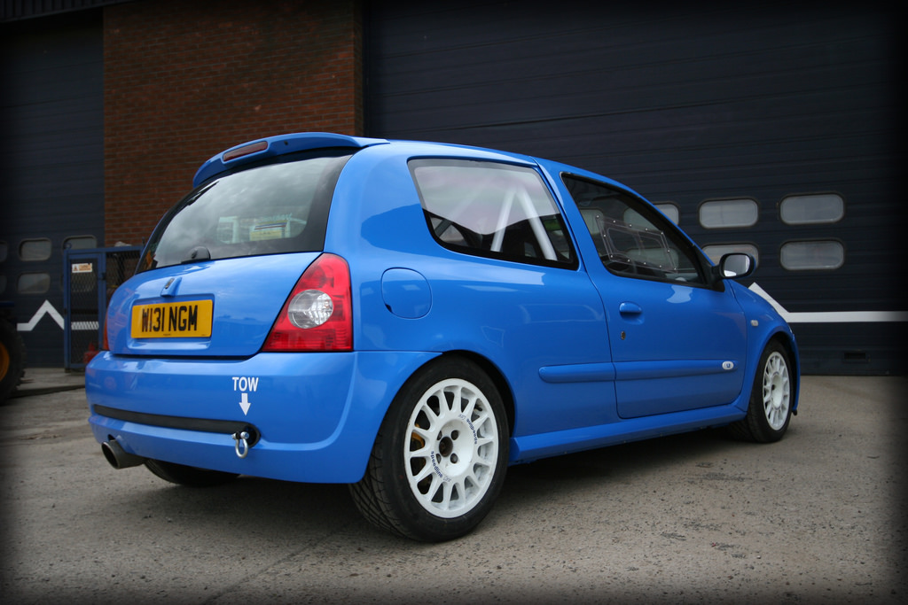

What toe eyes are you running on the car lads?
As with everything Else they are custom.
They are a Steel pin, miirc 22MM on the big end then this has been lathed down in steps to fit the hole in the car, one end it then threaded to match the car. The large end is has a 11mm hole drilled through the centre.
We have then used 10mm bolt and pin heavy duty shackles as the towing eyes.

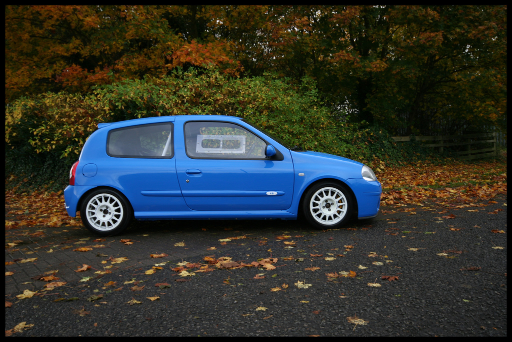

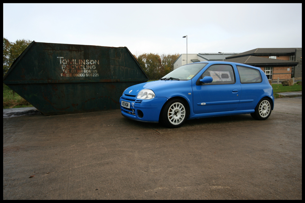

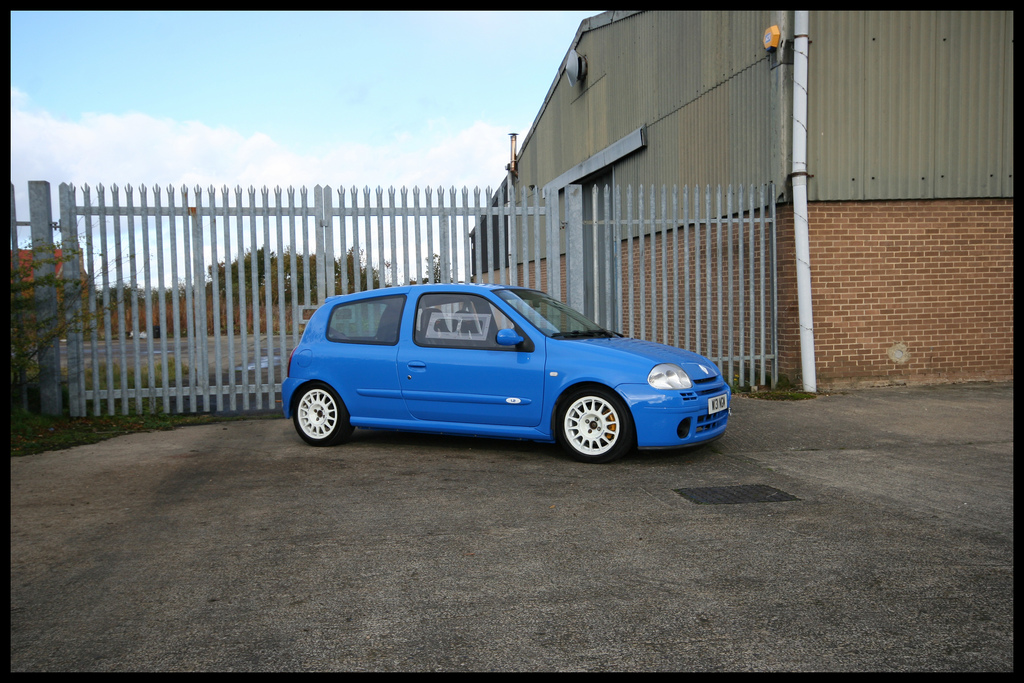

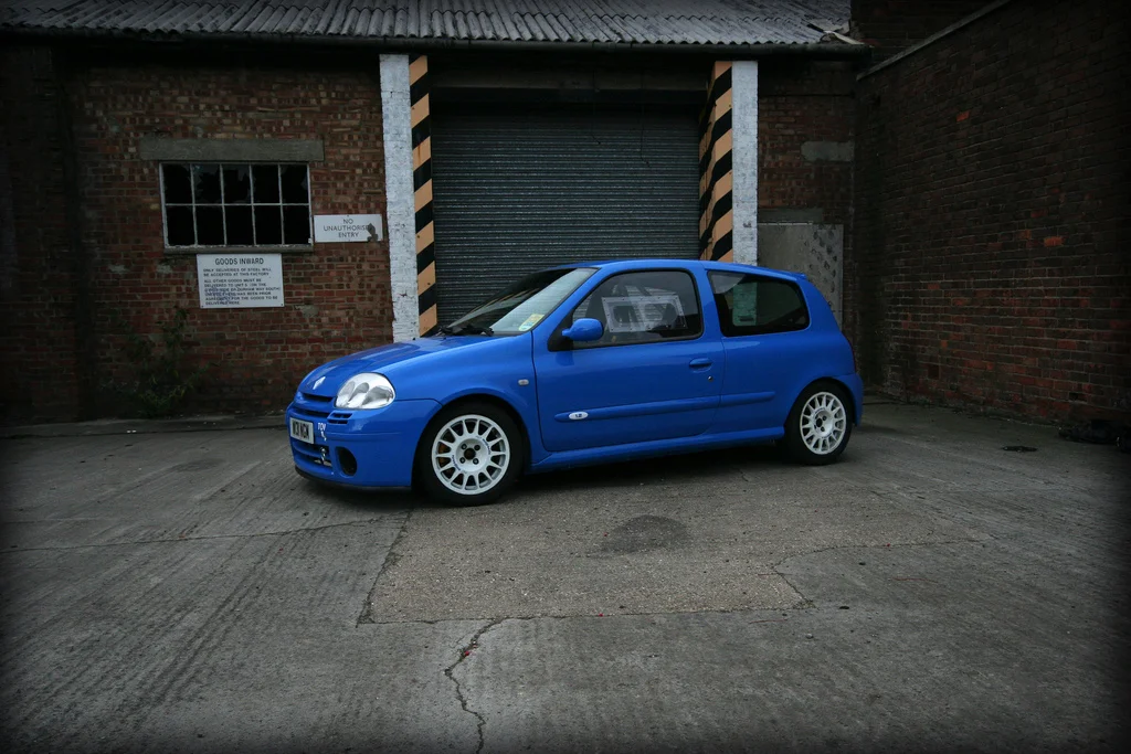

Thought i better put the final pics in this thread aswell.

Looks fricking awesome guys!!!

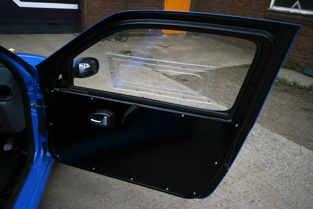

I would also like to know about the poly windows ;) where, when, how much LOL..
Also where do you get the interior door handle holders from, are the a RenaultSport part?

Looking... amazing !
I posted your pictures on my french clio rs forum in a thread called "we love english cars" lol

yeh, pretty cool actually...i want to dislike it on the colour alone...But it's pretty smart.

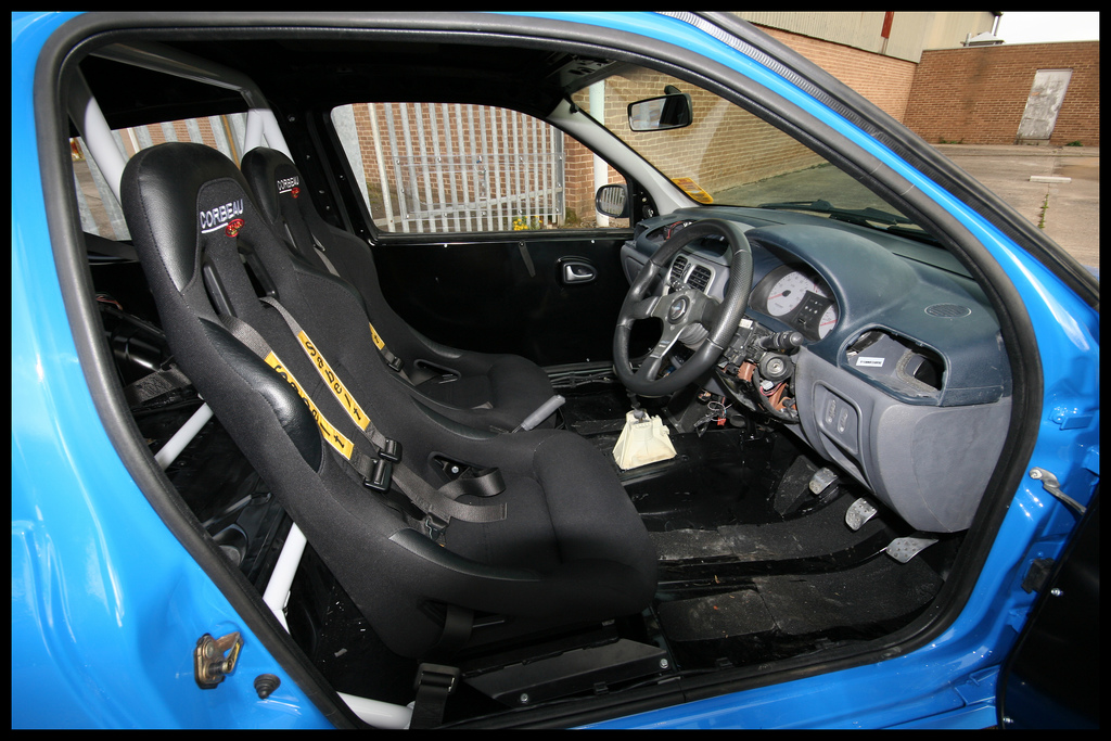

Gorgeous!! Did you spray the interior yourself or get a bodyshop to do it?

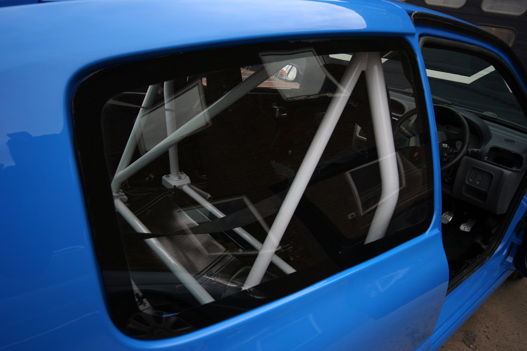

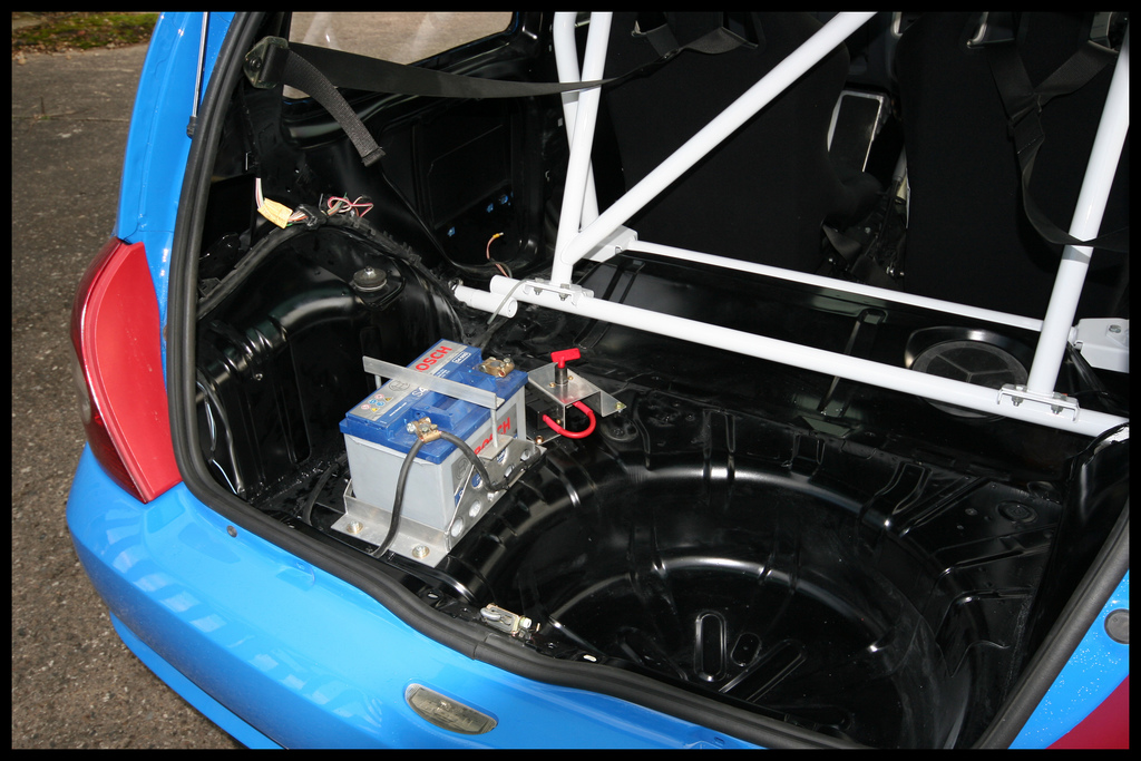

Wow, thats one clean looking trackcar! Fantastic. All you need now is a proper cage!
  Cup'd Monaco 172
Re: PH1 172 Track Car, abit special
I was just about to post that. Love the look, but seems odd you stripped it and resprayed, why not get a decent weld in cage?
