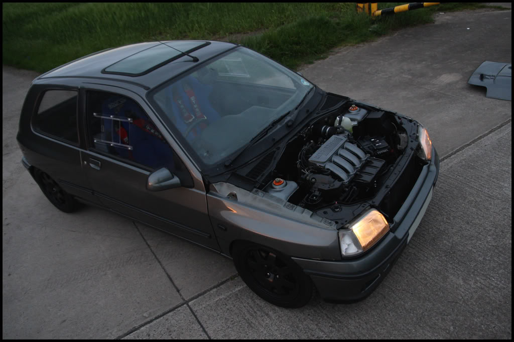

Stopped for a few pics on my way home just then, spent the past 4 or so days finising stuff off for Brands Hatch on wednesday.
Finally got the suspension at a height im happy with on the front, camber setup, top mounts set and then the tracking sorted, drives nice now. Also swapped the master brake cylinder as mine was nackered, had to press the pedal 4/5 times just to stop! New one has sorted it all for good :)
Also finished a few other bits, tidied wiring inside, put the bullet camera on, fitted the front polycarbs etc. Scuttle Induction setup is now done with, its how I want so im leaving it, no more messy viper in the engine bay!
Hopefully the weather will be like its been over the past few days!

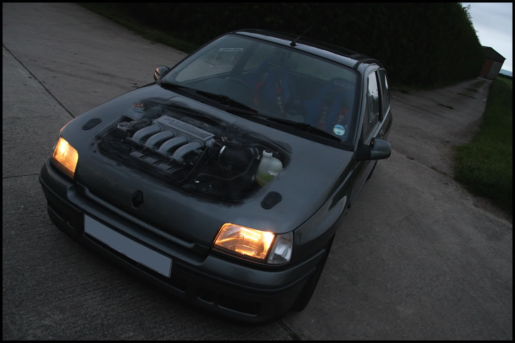

Jord, Is that a Valver Scuttle induction kit?
Nah, DIY. TVR filter (as the valver lot use), and two 172 90* elbows back to back, 70mm hole in the bulkhead to the scuttle area and its spot on....the noise inside is epic!
