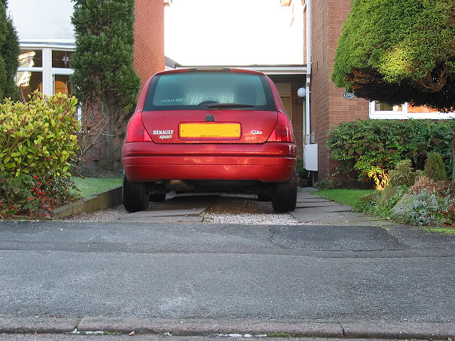

Hi,
my rear bumper is all warped. I think this is because of the exhaust heat. it bulges out in the middle. Ive seen it on other 172s too, but i might be wrong. I was thinking of "Gripfilling" a piece of springy stainless steel T bar to the inside round where it is warped to even up the stress. im pretty sure i can make this work, but what would be the normal solution. thanks

I have seen it on several Mk1 172's, mine suffered from it and Renault were kind enough to give me a brand new bumper after 2.5 years. The new one, now 4 years older still looks perfect.
At the time other people with the problem commented on heat as the casue but I dont think it was.
The 172 bumper despite looking like a normal Clio bumper but all painted is quite different, its just a big block of polystyrene with a plastic skin. I had a good look at the warped bumper that came off and the dimples corrosponded to plastic clips on the end of studs that hold the skin on, they looked like they were on too tight, maybee if you can slacken these off you can lessen the effect.
Heres what mine looked like.
