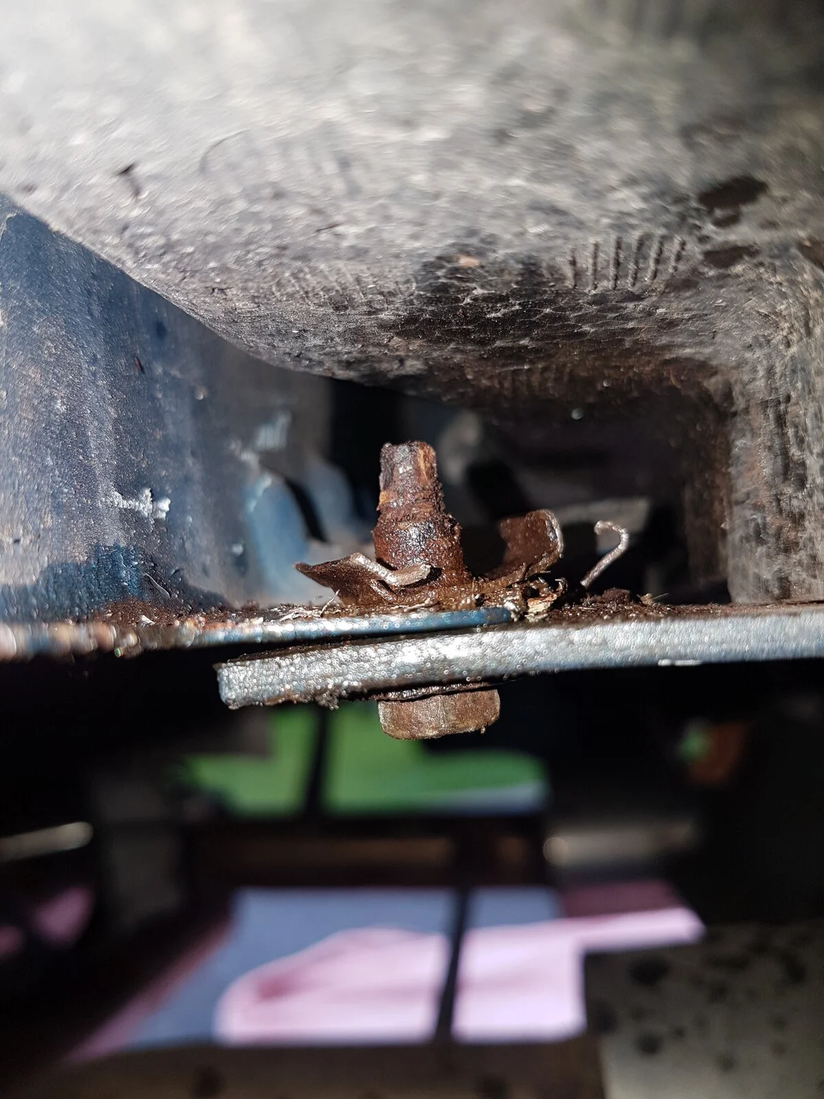

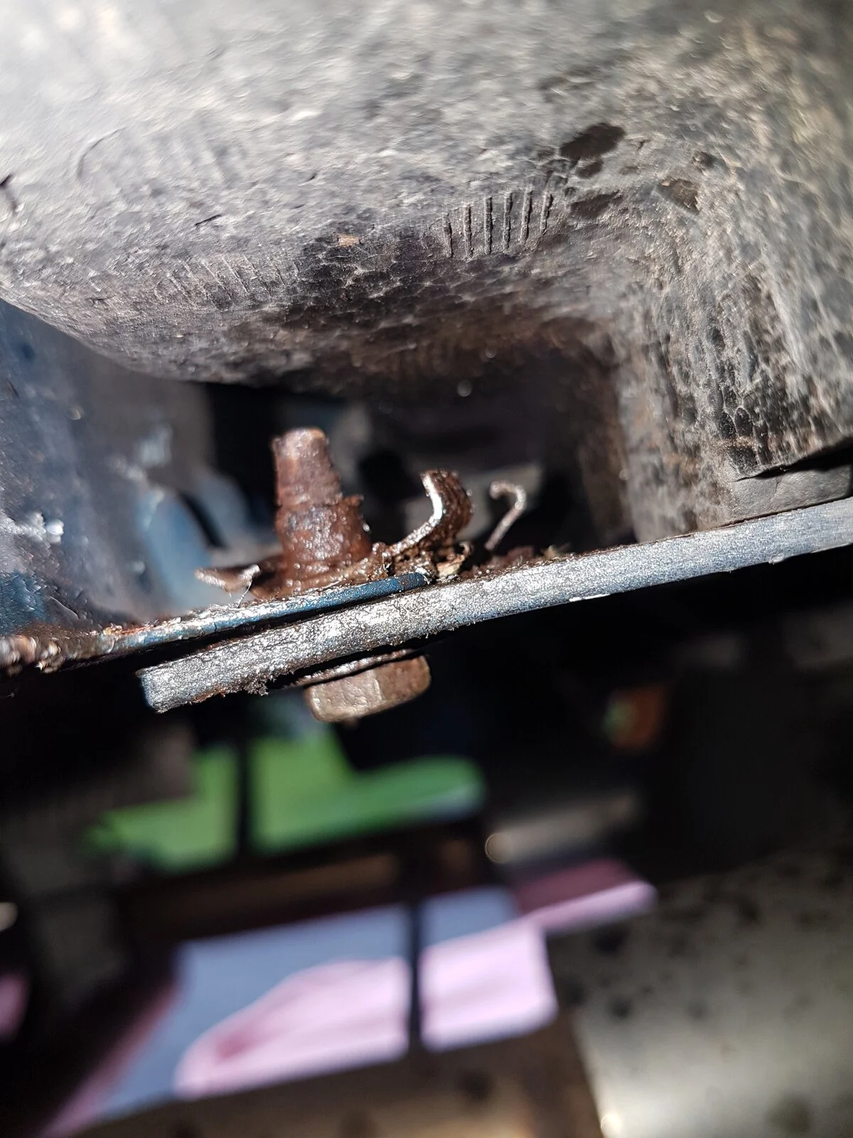

Trying to removey rear bumper, all bolts came out with relative ease (wd40, bit of wire brushing etc) but one of the M10 bolts underneath is just spinning and the clamp thingy on top has crumbled.
Is there an 'easy' trick to get this out before I get the dremel out and go wild? Can't get anything up there to grip it..

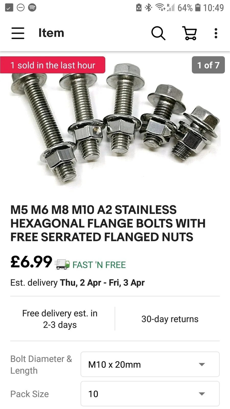

Would something like this work as a replacement? I don't know much about bolts to be honest, would the thread pitch be the same, ie can I replace the wheel arch bolts with these as well?

Small pair of molegrips usually works.
Yeah bolt will be fine but with a couple of washers to spread the load.
frayz
Yeah I’d get some grips on that if you can, if not just drill/cut it off.
Replace with some M10 stainless hardware, penny washers and nylock nuts.

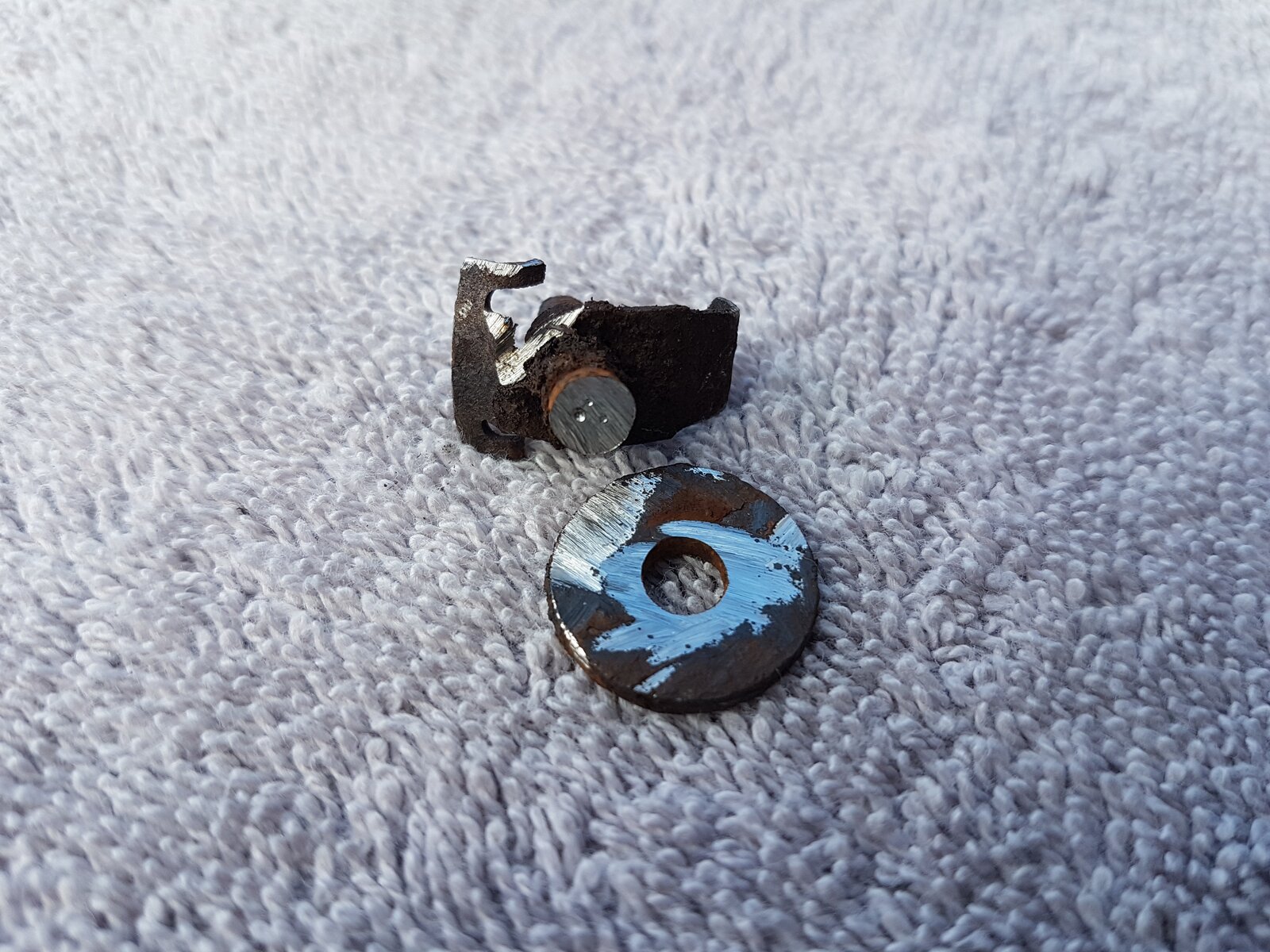

Thanks guys, bolts and washers ordered and eventually just Dremeled the bolt off.. Brilliant clip design!

Off to order new bolts now, been reading a bit about things now and found there's A2 and A4 grade stainless steel bolts, I assume A4 is better for better corrosion resistance?

304/316. Either are fine
