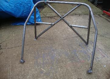

So car has now been purchased. Before I do anything I want to get a cage. I'm not going full cage because the cost is just vast.
I've been eyeing these up for years now and just wondered if anyone had any experience with them.
How easy are these to fit, quality, weight?
At under £200 it looks good. Regardless it's from ebay it looks to be made by a proper fabricator so not your standard ebay jobby. I can't find any previous threads on this despite seeing them for sale on here a few times.
I guess the question is, is the metal used good enough that it's going to help save you in a crash, or is it going to do more damage? If it's the latter, then even if it's a show cage it's certainly something to consider :smile:.
Yeah that's really what I'm thinking about, whether it's going to help or is it going to bust. I'm not after a show cage, just want to have somewhere to mount harnesses and protect as much as possible if the unfortunate did occur.

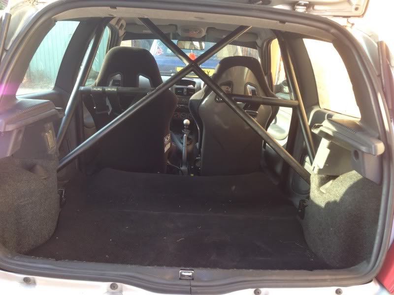

@GrahamS I have one of these fitted in my track car...like the comments say I found my car much more solid when fitted and I am not and expert on steel but it is made from solid stuff.
Me and my mate who has a garage and does mainly Ford tuning is very impressed with them and like you said it will do more than not having one I'm sure.

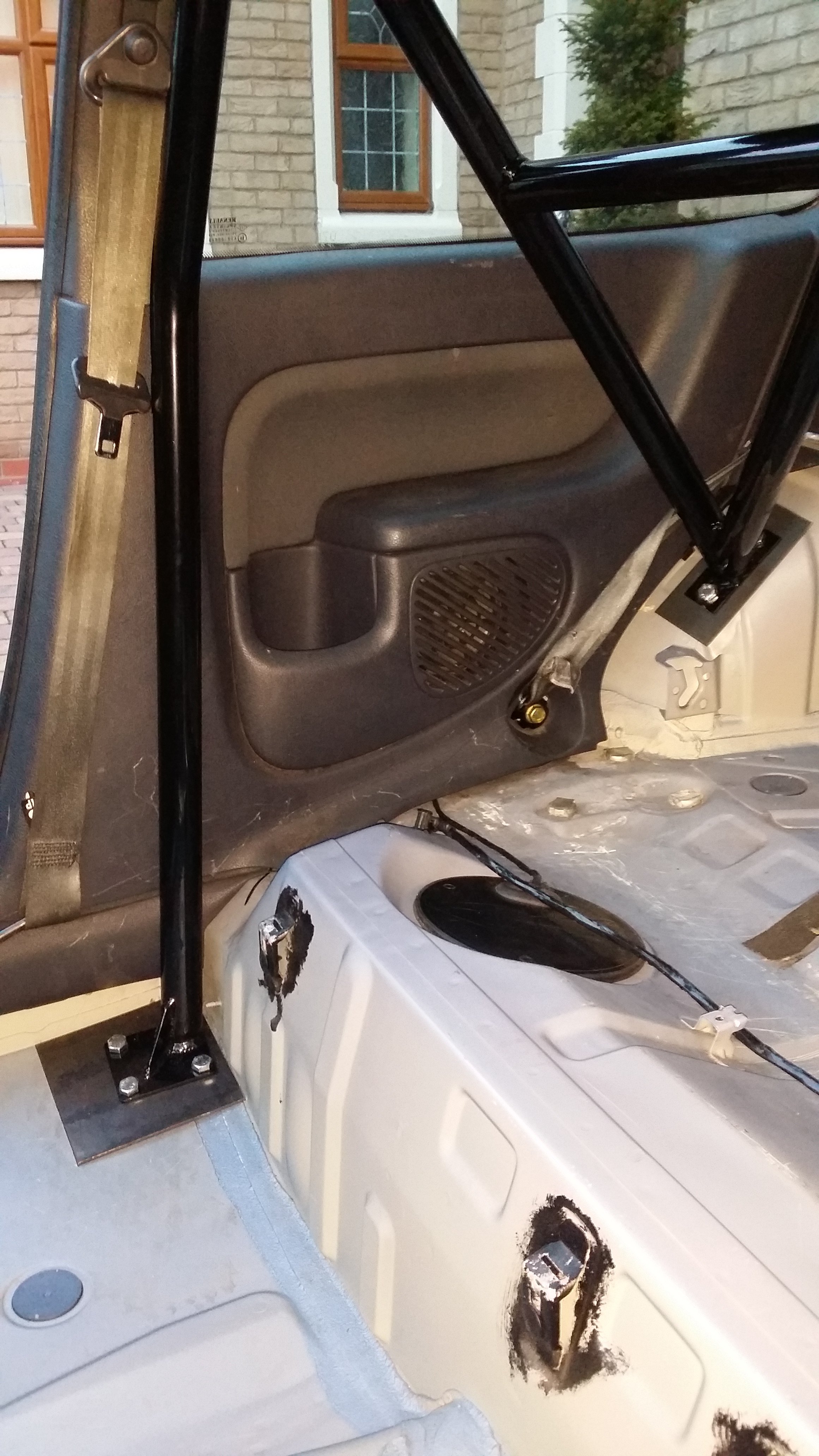

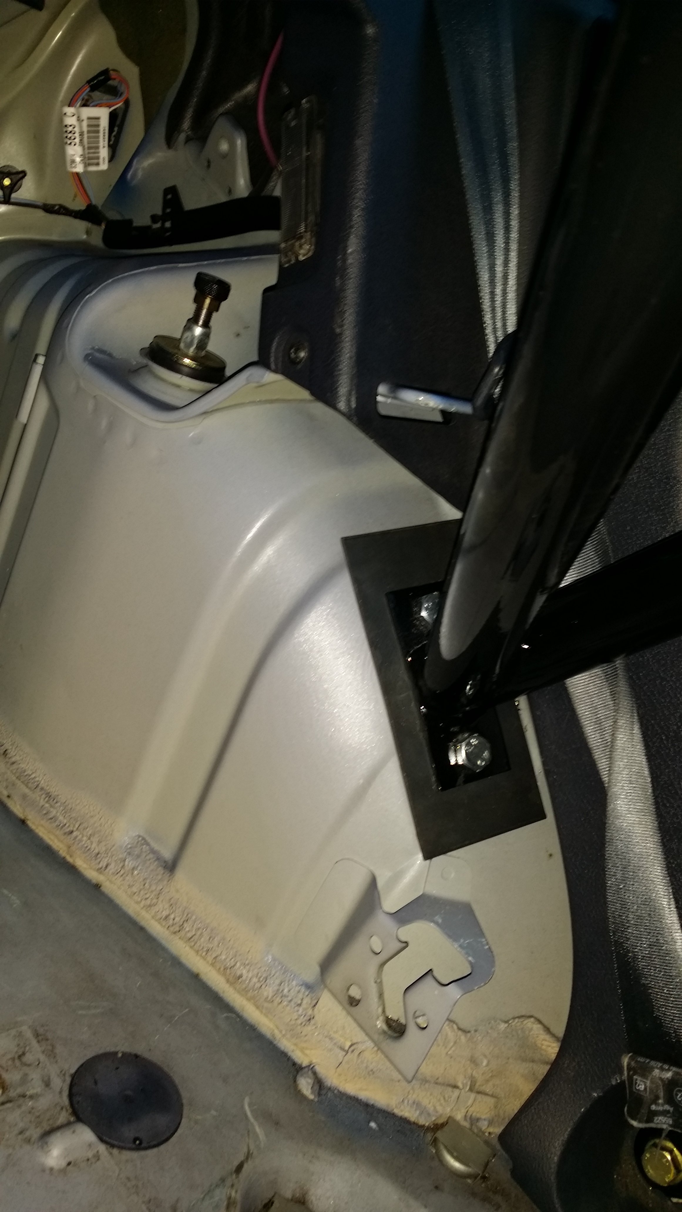

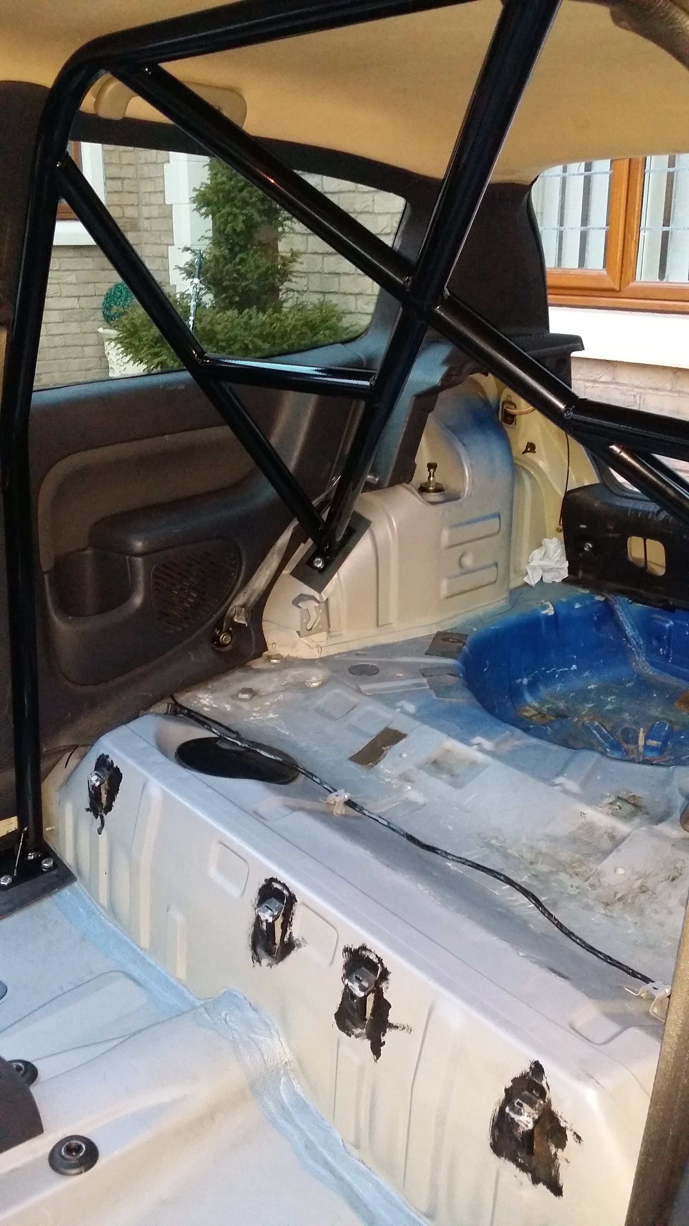

I have one but made my own spreader plates as the ones in his 'kit' are crap imo same size as the feet on the cage and pretty thin (mine are 4mm thick steel plate and 8"x8" the rears are 3" and about 8" and have spreaders on either side of the car inside and out) the cage itself is very good granted I haven't rolled the car to test it lol I mainly wanted a harness bar but this was cheaper and I have a mate who makes his own cages for his grass tracking or whatever they call it and he's rolled a few times (I've been with him on some) and his hold up well and I would say these are better made. Had mine powder coated for £30 and jobs a good 'un. Was a bit of a pain to fit definitely a 2 man job lol and mine was bent a little by the courier.
exactly the replies I was after. Thanks for the pictures @StuOwen86 that looks good and fixed pretty good. Does it come with bolts to fix it in or when you made up some spreader plates did you have to use extended ones?

You need to be sure that spreader plates are used though. The standard crash structure is pretty decent anyway and this will add that extra support in the event you manage to get on your roof.
I've just dropped him a line about the cages asking for group buy prices on getting five and 10 people together. Also asked about making larger spreader plates and how much extra that would be. Will let everyone know and keep it updated.
I 'think' that I used the bolts supplied they're only 8.8 still high tensile but I did have loads that I brought home from work so not 100% that I used the supplied ones. As said get the larger and thicker spreader plates if he will do them I read the msa blue book and seen how big and thick they used and made mine to that size. Think it says about 12cm squared and 4th thick I had to slightly bend the wheel arch ones and then they pulled to the right shape when I bolted them tight. I have all faith in the cage holding up to a roll BUT not that it wouldn't punch through the floor and the rear arches I wanted as much as I could as both harnesses would be pulling on it if we have a head on. I only use mine on track though.

I found this site really helpful http://www.clubgti.com/showthread.p...guide-illustrated-to-help-with-MSA-compliance am I right in thinking the spreader plates are only on one side of the car or do they act like a clamp and go both sides of the shell? The above thread thinks it's 12cm square with 3mm thick. What kind of place can weld this in?
I got an email back.
We do a fitting kit of 4 under plates and all nuts & bolts for £20. If your guy's want to fit spreader plates that is their choice. we would never use anything thicker than 2mm as this will deforme with the floor. a thick 4mm plate could tear the original floor and punch through as because it wont bend it wil tear...........We do make full cages but require the car as they are pre-stressed and welded into the car
