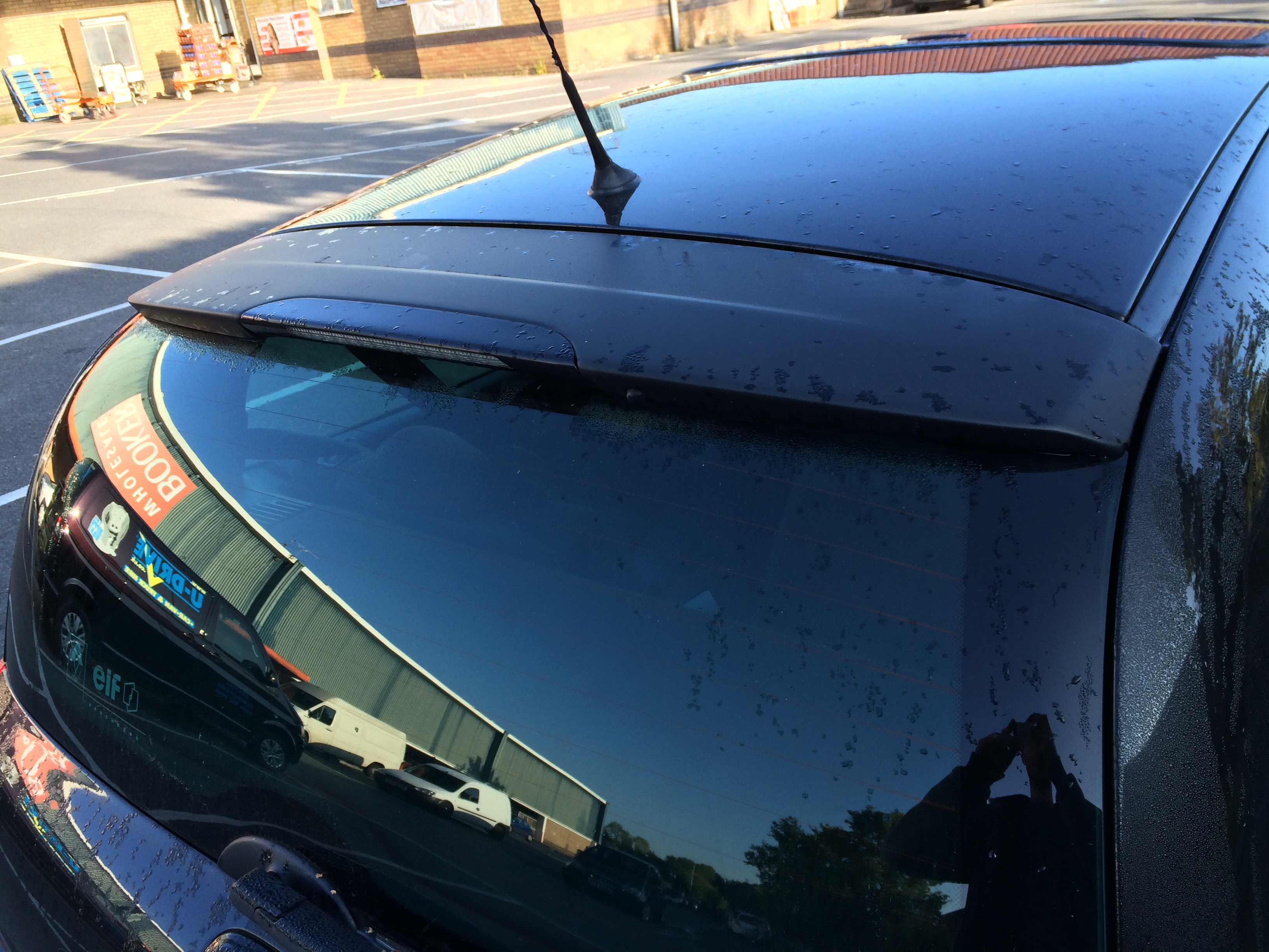

My rear high level brake light hasn't been working for a wee bit, at first I assumed it was just the bulbs but I got a friend to replace them all, and it's working fine when connected to the mains at home.
He also tested the connection from the car itself and said it's fine, so we've come to the conclusion that it's the little white connector that connects the light to the car, pictured here:
It's in pretty horrid condition, the connectors aren't copper, more green :(
Is there a way to buy that specific bit without having to repurchase the entire light? As the light itself is in fine condition.
Probably a long shot but figured I'd ask anyway.

Just but the light, they're something like £24 from Renault IIRC
What's the best way to prize these out?
Lever away at the points with the silver clips from the bottom?
Assume it can be done without taking off the spoiler?

Get a knife on the long and and slowly prise it out. Doesn't take much force
