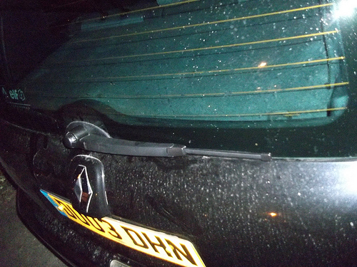

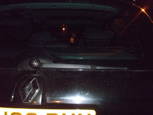

anyway, i have purchased a vrs wiper arm and i am going to trial fit it monday
13mm nut.. You may be in for a fight with the old wiper arm as they are sometimes a pig to get off. Good luck :)
Alright, yeah old one came off with abit of persuation from a ball join splitter tool ;).
The skoda arm looks really good bar the end cam wich has a washer jet built in, something that i can live with. Allbe it thats its longer than the renault one.
Will get some pics up when iv got round to finishing thr rest of my car rebuild
Will post pictures up tommorow for you lot. Might not be to everyones taste but its better at cleqning thr screen than the standard one by far

this is the blade and arm
requires a little moddification
1. needs 3-4mm off the bottom of the bolt cap as it pops off when wiper is in rotation
2. cap also needs cutting down as it has a hole originally for a built in sprayer.
performance wise, i clears the rear window superbly
cost slightly differs as when i bought it two weeks ago it was £6 , it is now around £7 BUT i think it will out perform the original.
looks of it is each to their own tbh, i can live with it but the little mods im doing will tone it down
pictures up soon when i can find them
for those who want to know, i took the old renault one off as it was rattle'n on my screen and was pritty much passed the life span

pictures as requested
