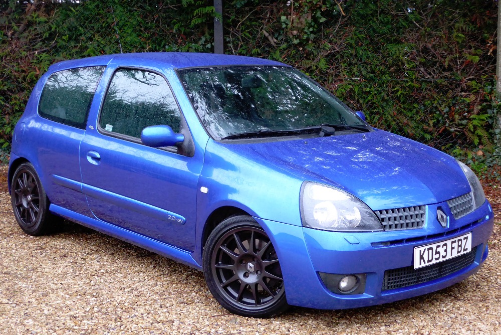

Only just realised I've never done a build thread for my current 172 Cup so thought it would be rude not to.
Had one back in 2014 which was actually quite a nail so ended up selling it on.
Since then I've had an MR2 Turbo and a Skoda Fabia VRS which became my only car when the MR2 blew up. I managed not to get bored of the Skoda for 9 months haha. Then I made the mistake of looking at Clios on ebay while bored at work.
After looking at a few ads and nothing standing out to me I clicked on an advert for a 172 Cup that was up for £1800 in Carterton. The moment I saw the photos I wanted it but didn't have the money.
I had a couple of job interviews lined up the next day so rocked up for the first one in my Skoda. The first impression they gave me wasn't a good one (wanted me to park over a mile away).
At that point I remembered that Clio so phoned my best mate up and asked him if he wanted to go look at a car. Lo and behold half an hour later I had picked my mate and his brother up and we were on our way to look at this 172 Cup.
I had emailed the dealer asking if they would take part ex for my Fabia but kind of just turned up and hoped they would still have it. They did, the test drive was probably one of the best I've been on. Literally got thrown the keys to it and told to go have fun. The moment I sat in it I knew I was buying it so went and hooned it round the roads outside RAF Brize Norton.

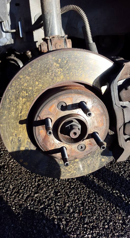

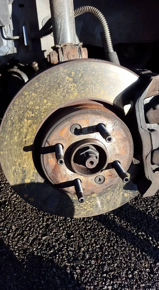

One of the first things I did was fit a stud conversion because I quite frankly detest wheel bolts having come from Jap cars which had studs from the factory. Actually fitted these on Christmas Eve 2015 2 days after I got the car haha.

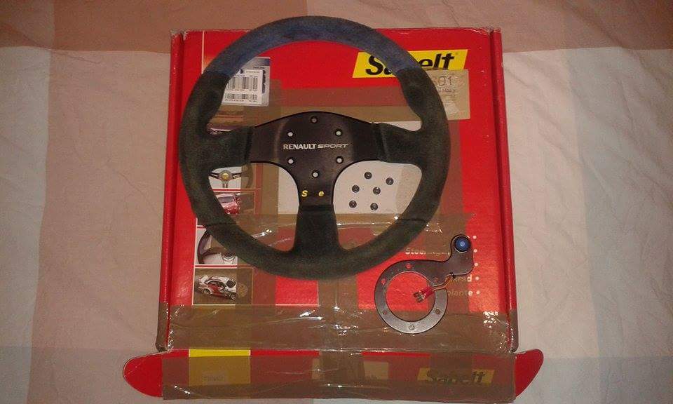

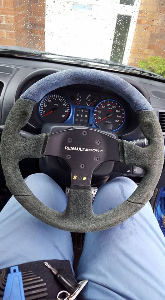

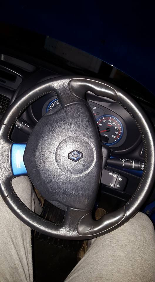

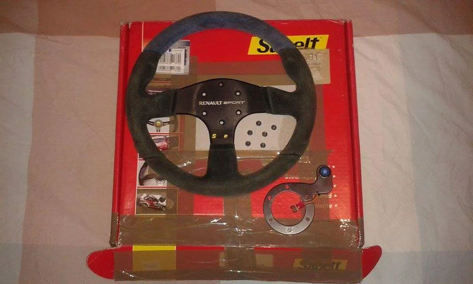

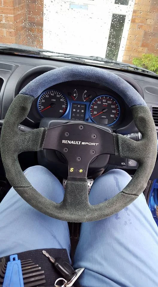

I also fitted my unmelted steering wheel. Only issue with it was a nicked thumb grip.
This lasted approximately 12 days before I bought a second hand Sabelt. I think the sabelt was the first thing I fitted that began journey into it becoming a track car.

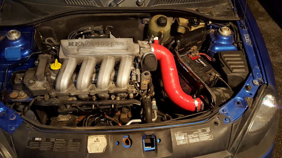

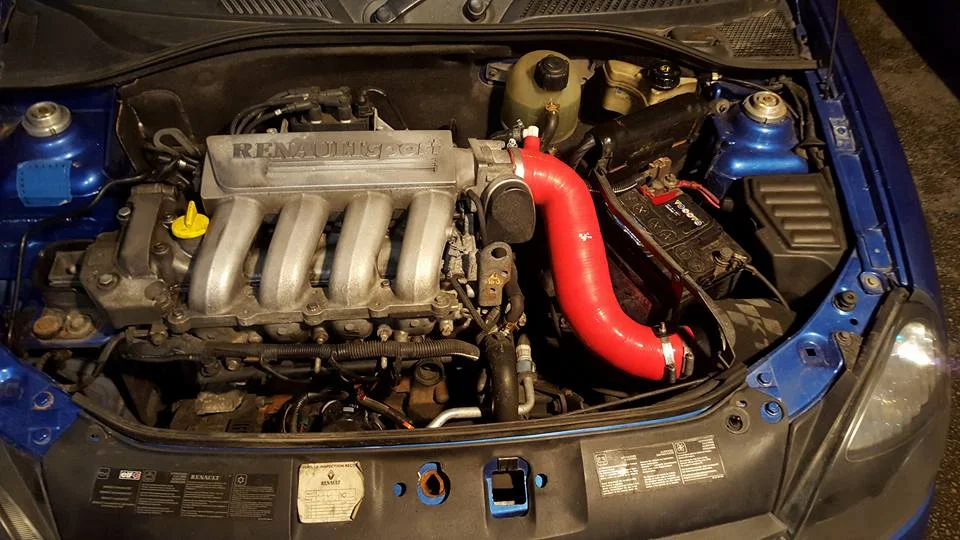

I also picked up another KTEC induction kit, I wanted a blue one but ktec were out of stock so I actually ended up buying a used one.

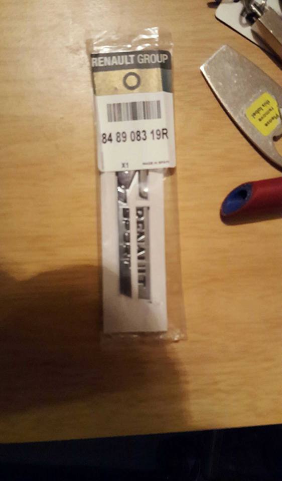

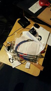

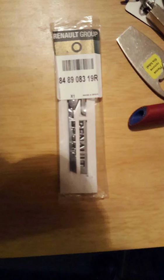

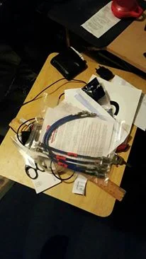

A couple more goodies included braided lines, an RS badge, new number plates and new engine mounts and a powerflex insert.

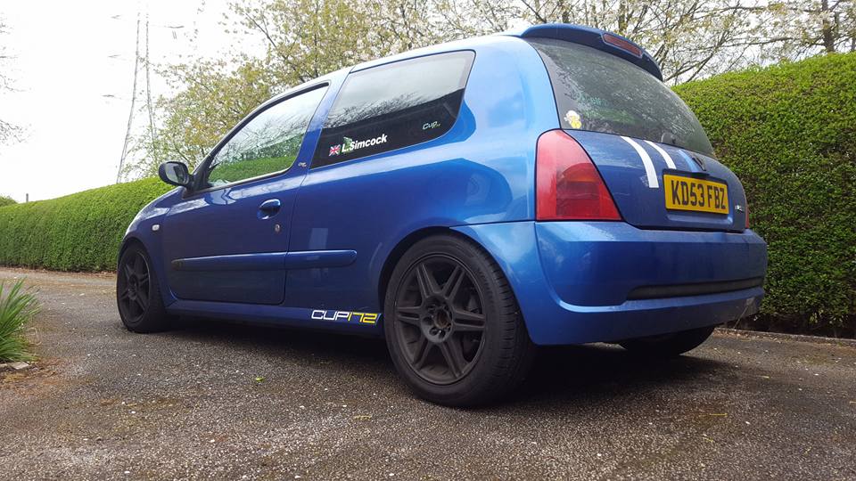

  Mondial Blue 172 Cup
Righto lets continue the tale of my Cup.
I also got a MAD tow hook for it which still lives on the car now. It sat lovely and the 595 RSRs that I bought made it look and handle well.
I fitted my sabelt when that turned up. Wish it still looked that blue haha, recently discovered the date stamp of 06/06 on it so I imagine its seen some racing action. Absolutely love this wheel, need to get it retrimmed at some point.
At this point it was still a very very nice 172 Cup road car and infact got featured on a few instagram pages. I still can't get over how good it looks in this photo. However apart from the door bullets it looked the same as every other 172 Cup with a Fabia splitter and Turinis. I wanted brake ducts, not just any brake ducts, I wanted cup racer ducts but no way was I paying £150 for them so I kept my eyes out.
2 days after I took this photo I made the plunge into it becoming a track car. I fitted a bucket seat and later fitted a 4 point harness which has since become a 6 pointer. I've retained the standard seat belt because running a harness daily was an awful idea so didn't last long.

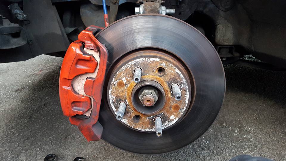

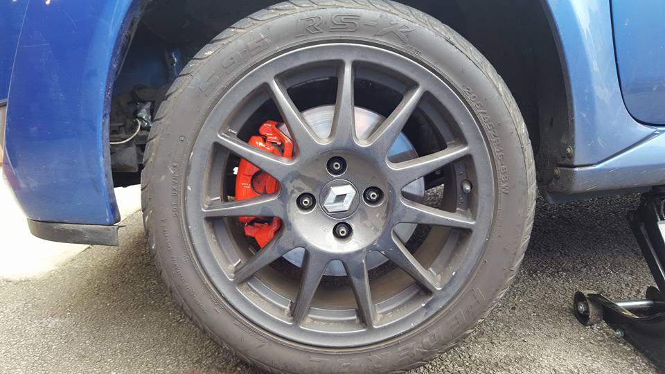

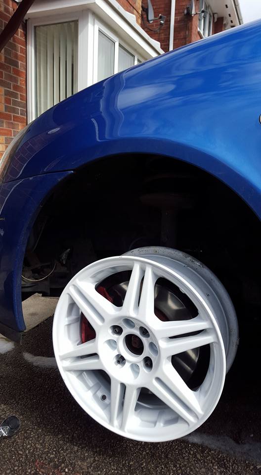

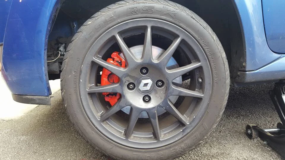

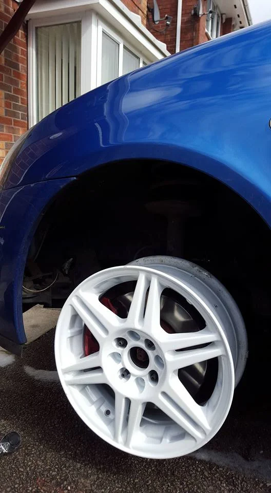

I decided to make it faster I would paint the brake callipers red. Awful idea, took a silly amount of time and I ended up melting the paint on track.

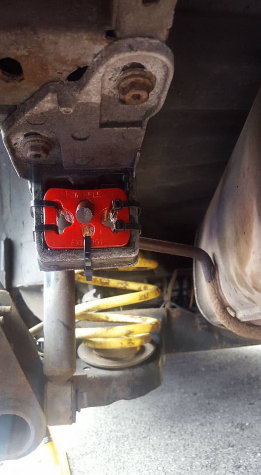

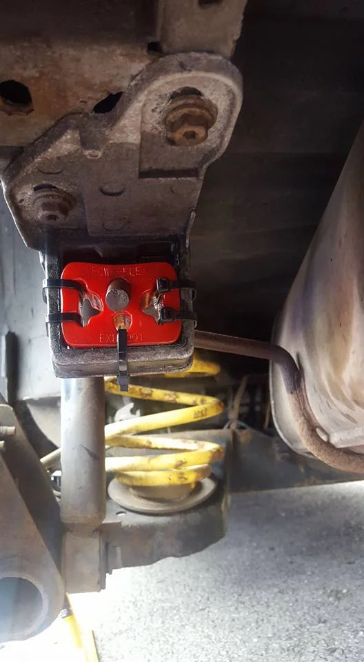

Also had to fixed the obligatory exhaust mount so made my own like I had on my old Cup. Still cabled tied and still going strong. I'll make a proper one eventually haha.

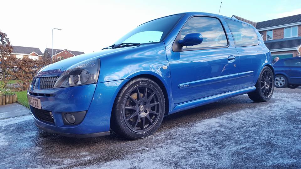

One thing I had wanted to do for a while was get some 15 inch wheels so when I saw someone local selling a set of 15s that didn't look to bad on here for £60 I knew i had to buy them. Painted them white originally which I soon discovered was a mistake so ended up rattle canning them black.

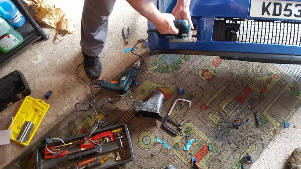

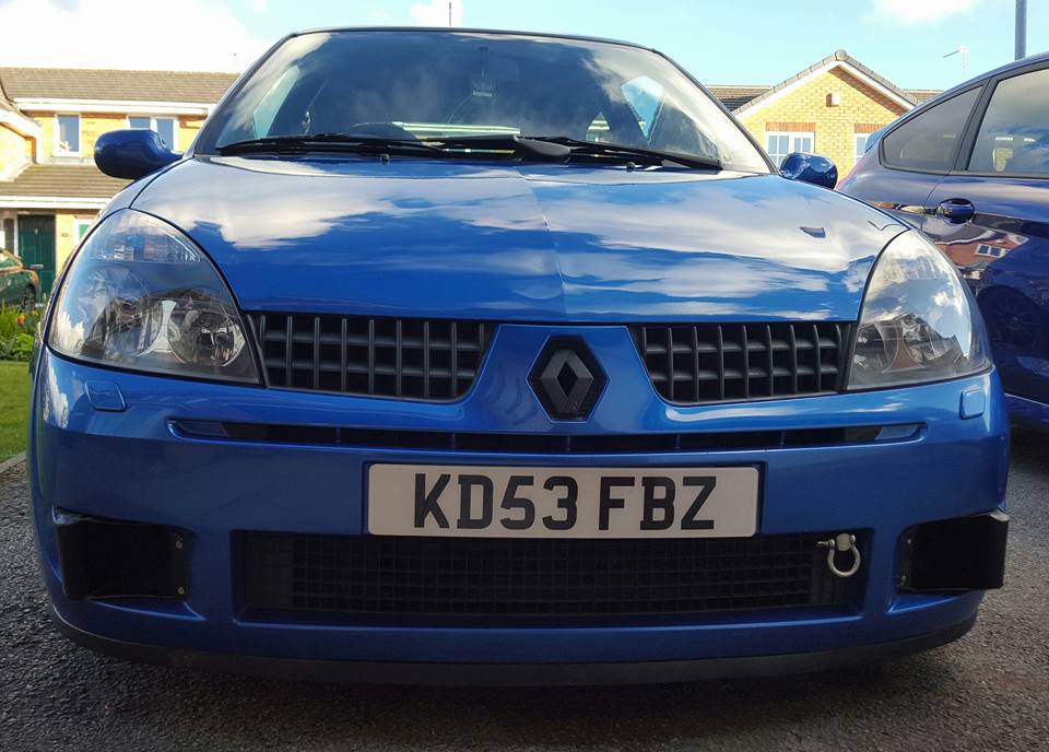

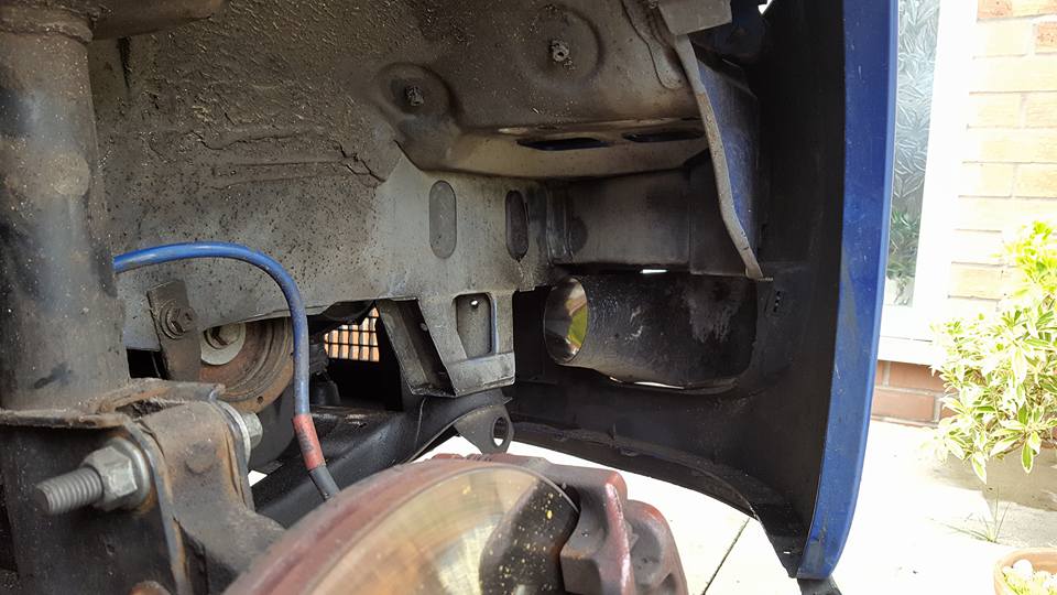

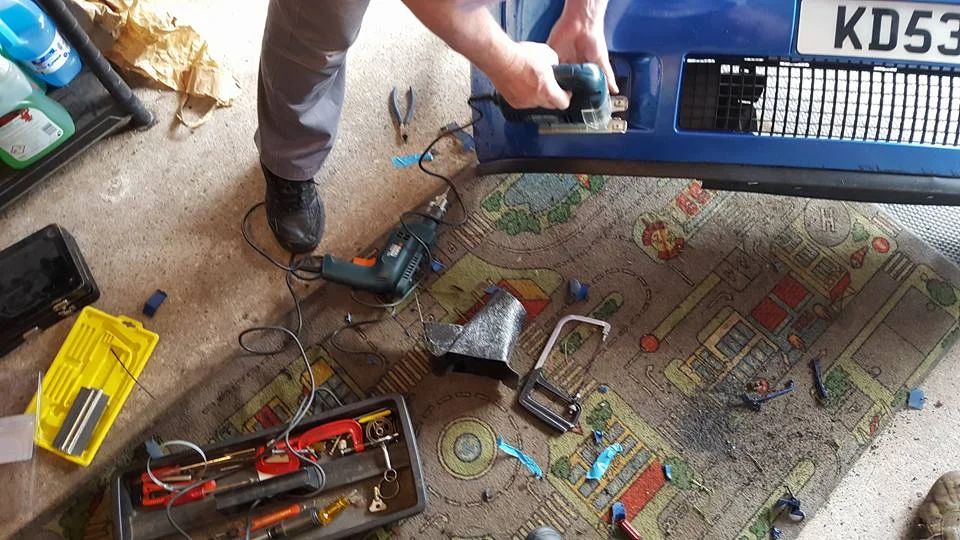

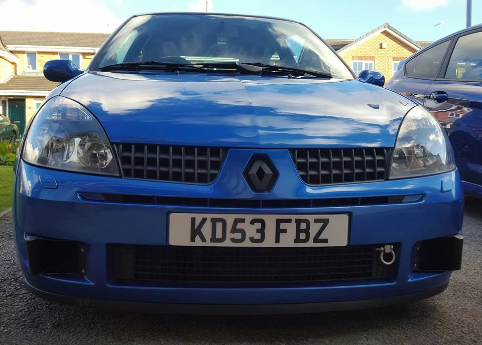

Next up those Cup racer ducts I had wanted, I managed to find some...
£50! from Fred Hopkins. Wasn't fun cutting into the bumper to fit them but absolutely love them.

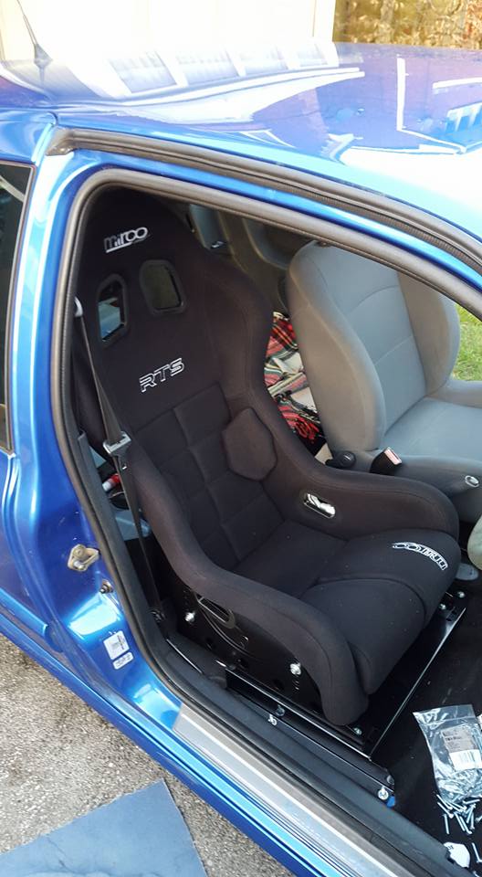

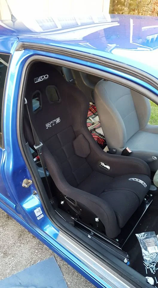

The OMP subframe I had for my bucket seat wasn't low enough so I sold that to a friend and picked up one of the excellent VBD X Low subframes made by Jon Foz. Had a little bit of a struggle getting an XL seat like my Mirco to fit correctly with it but got there in the end.

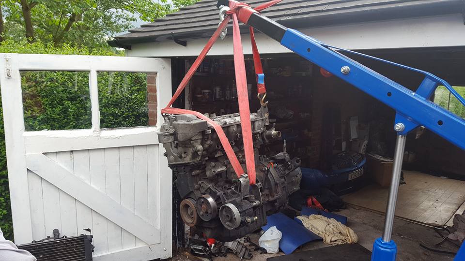

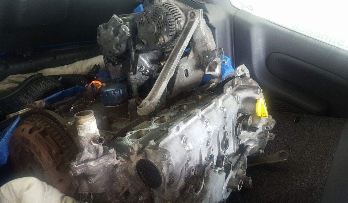

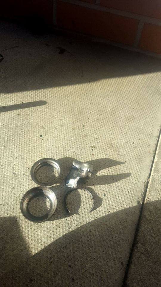

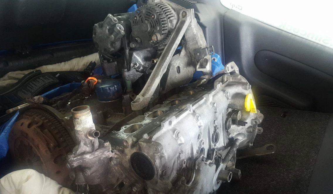

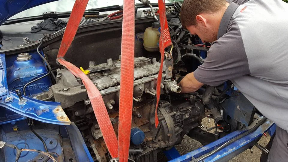

One thing I had noticed since getting the car was the oil consumption seemed to be getting gradually worse. I suspected that the Valve stem seals were failing. It was due belts shortly anyway so at this point I made the decision to replace the engine. I had read online that the Phase 1 engines had larger exhaust ports so was on the hunt for one. I found one advertised on here, it was 134k miles but the belts were doing 6000 miles and 6 months previously so I agreed a deal of £225 and headed down to Brighton to pick it up.
It still had its full compliment of oil when I arrived so we drained that out. I have to say I was very pleasantly surprised to see that not only was the oil still golden but the engine had never been run on anything other than the correct ELF oil. It could have literally been dropped into a Non Cup without issue but since i had a cup it was a case of removing the whole AC setup and simply fitting my cup setup.
Righto I've run out of images again so I'll continue from the engine change on the next post.
Oh yeah when I said the old engine was getting worse, it got to the point where it was using a litre of oil in 300 miles!

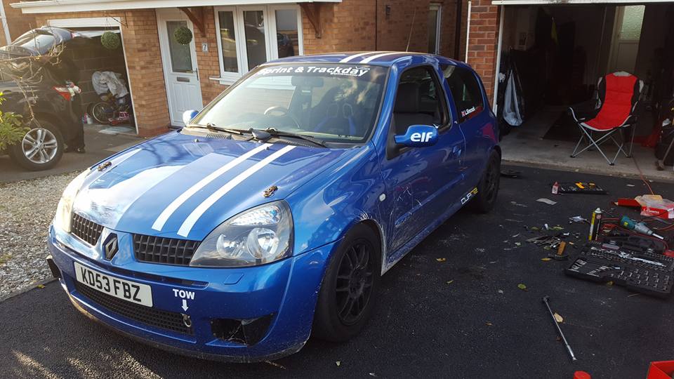

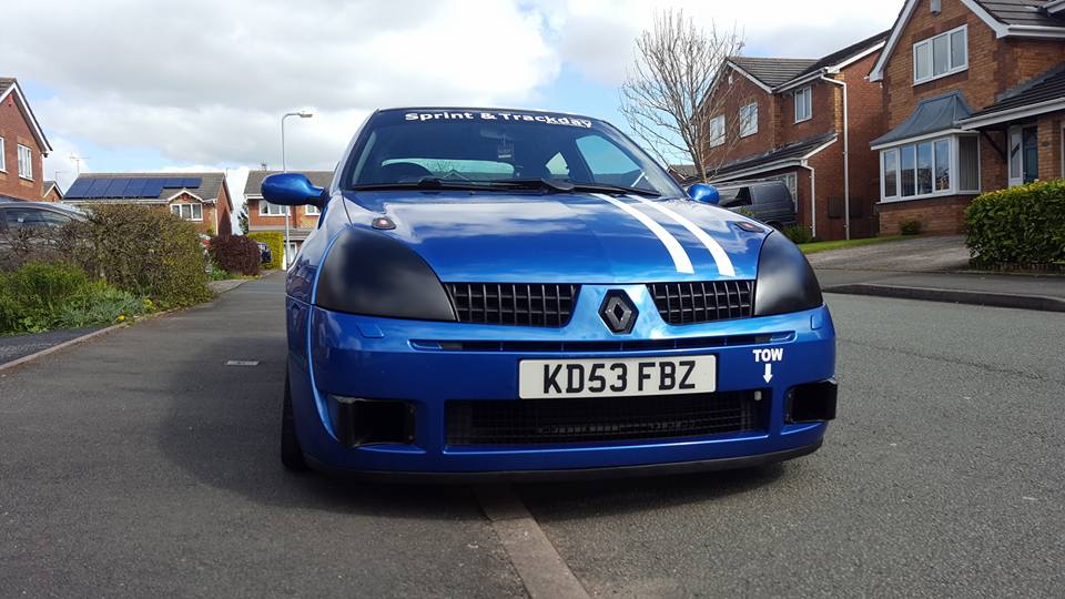

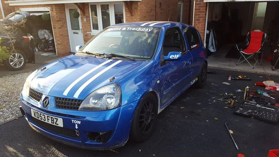

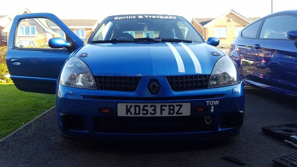

I forgot to mention in the last post. I got stripes fitted to make it faster. No idea why they weren't done all the way to the end of the bonnet and I need to get this sorted at some point.

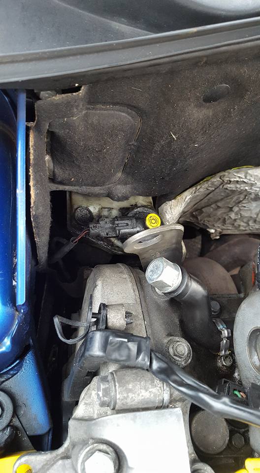

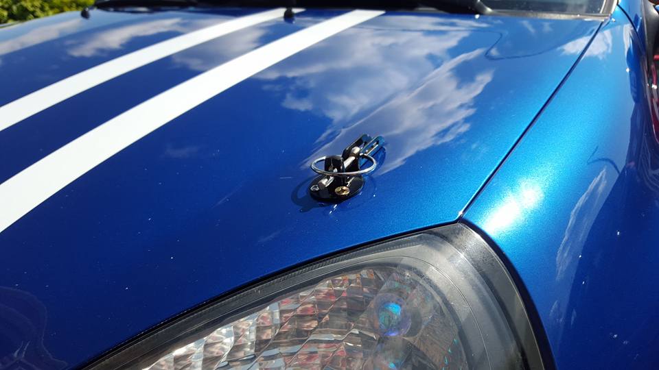

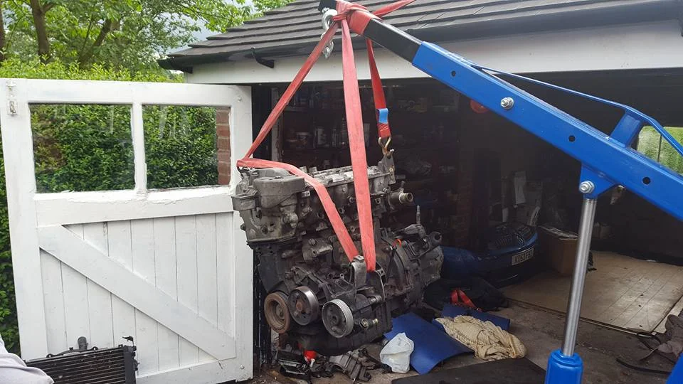

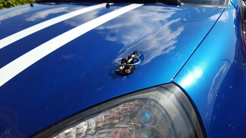

One thing I did having seen an immaculate Racing Blue 182 written off due to a failed bonnet catch was to fit some pins just as a fail safe while still retaining the OEM catch.

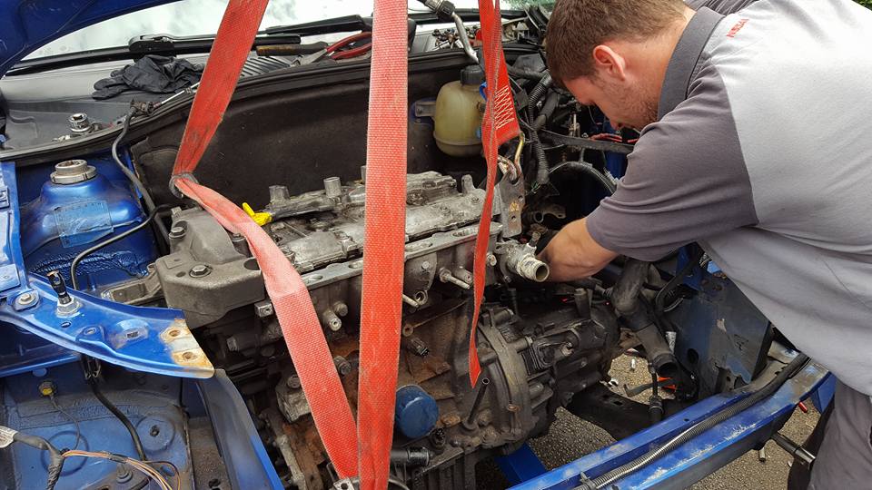

Anyway moving on, as I said, engine change, a friend who is a fellow ClioSport owner @Beasley Clio182 very kindly gave up his weekend to help me (by help I mean do most of the work) fit the new engine. I'm learning as I go along but Dean is a Nissan Master tech and has many years experience working on cars. He said it himself, it was one of the smoothest engine changes he has ever done. On our backs on my grandads drive we had the engine swapped from driving in to driving out in 9 hours! Couldn't have gone more smoothly. We didn't drop the subframe and instead took it out through the top which in my opinion was much easier.
13406796_10208597438346376_1603763733242432768_n.jpg 13406931_10208599080787436_7704767370251146214_n.jpg
Obviously first port of call after the completed engine change was McDonalds, we definitely ruined their sinks washing all the oil off our hands haha.

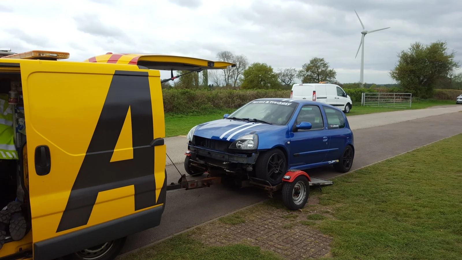

Next up I had entered the Javelin Sprint Series round at Croft. The car seemed to be running well and behaved itself on the drive up. It did look cool with the numbers on it. This wasn't to last though unfortunately.

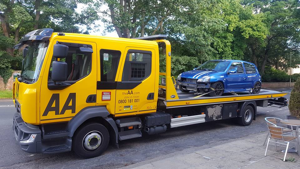

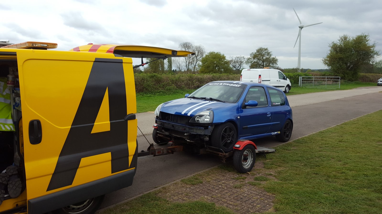

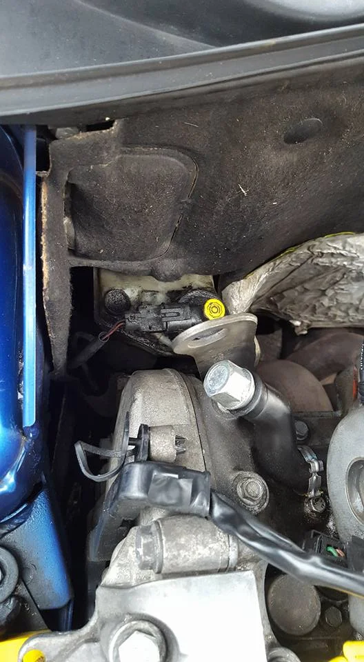

On my first practice run the High Pressure power steering pipe exploded ending my day and nearly resulted in me having a big off. Luckily I managed to hold it but that was my dad over sadly.
Limped the car away from the track and called the AA to rescue me after realising I couldn't fix it at the circuit.

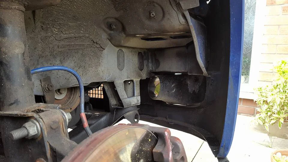

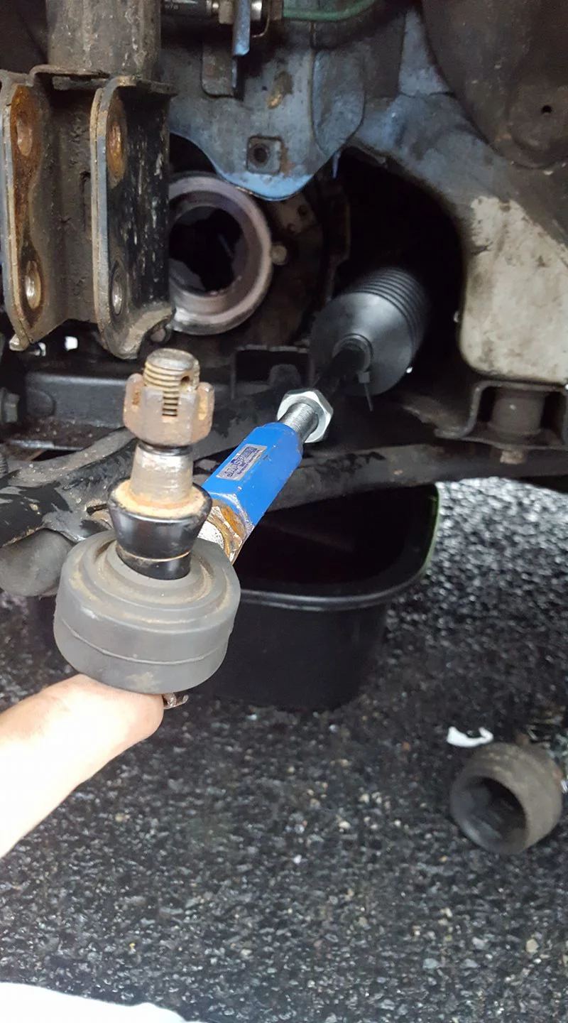

After doing some research online I decided what I was going to was convert the car to EPAS so promptly ordered all the parts and then left them in my shed for the next 6 months. I did however fit a shorter aux belt to run it without powersteering until I got round to fitting the EPAS.

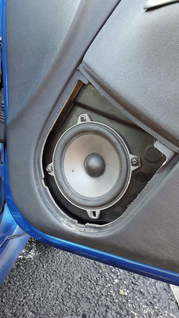

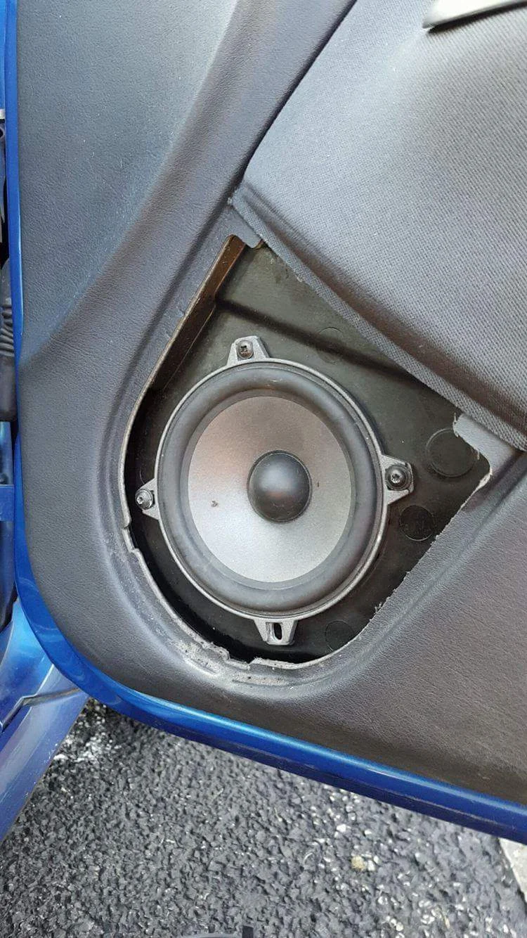

Because its a track car it clearly made sense to fit some better speakers. It was more the standard speakers were awful and I had these from the MR2 I blew up which happily fitted perfectly into the Clio so the Focal Polyglass speakers went in.
I also decided to delete the charcoal canister to save some weight. Literally just blanked off the lines with bolts and kept the solenoid in place to avoid tripping a warning light.

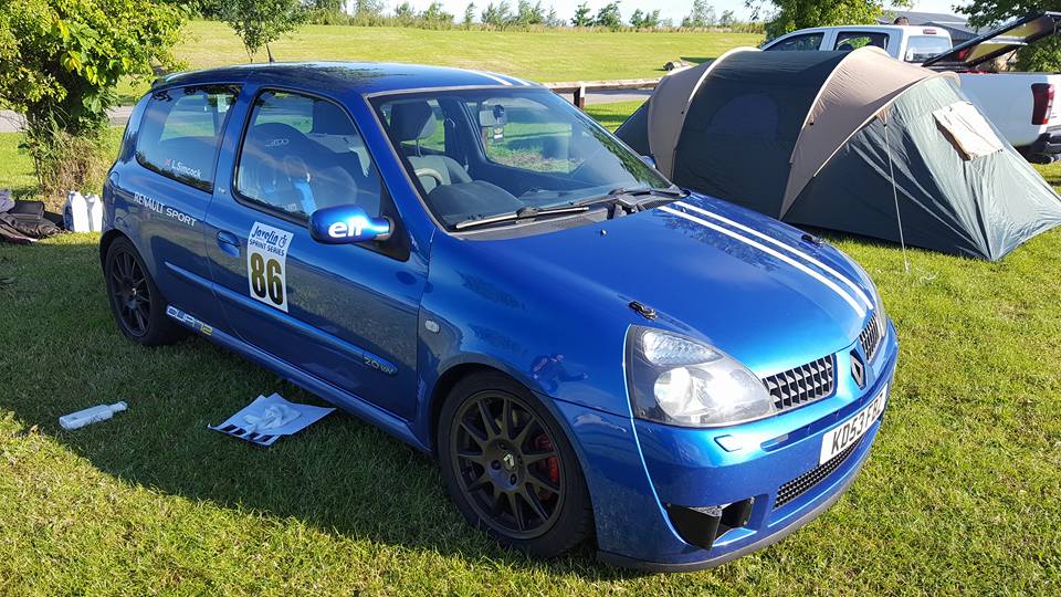

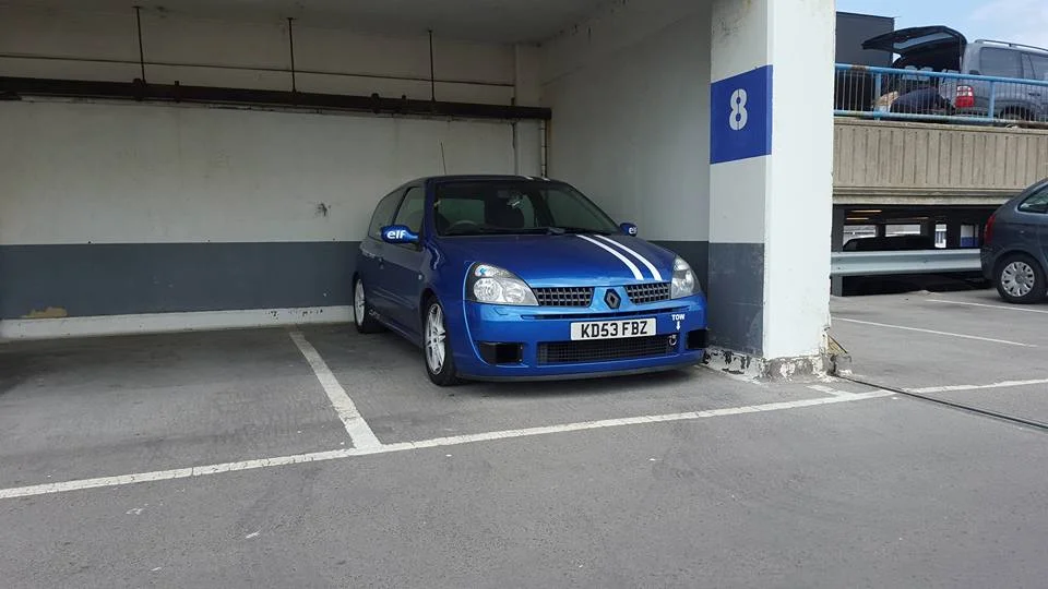

I managed to secure free entry and free track time at the Fast Car Festival held at Donington park, the free track time appealed to me greatly as I had been meant to do Donington in my first car but the day got cancelled due to snow. I got 2x20 minute sessions free however typically the car broke in the first session. It kept dropping into limp mode which would clear when restarted but then reoccured until it wouldn't drive normally. I also managed to snap the exhaust off bouncing it over the sausage kerbs at the chicane on the national circuit. I had fitted some 20mm bolt to hub spacers at this point too meaning the already good turn in was improved even more.
This was the first time I'd had the Clio on a proper circuit and I have to say I was very impressed. Not only was it very very quick through the corners it also managed to hold its own on the straights. I had the GoPro recording, next time I'm out I'll be using the side mirrors and removing windscreen mounted mirror (which slides off) to allow a better view.
Clearly I had to go past the Silver 182 even with the limp mode issue even if it did mean then immediately pulling in to let him back past haha. It was after this I discovered that my centre pipe had partially snapped and was blowing quite badly. I made arrangements to travel up to Blackpool to purchase an OEM centre pipe which was 200 miles old for £25.

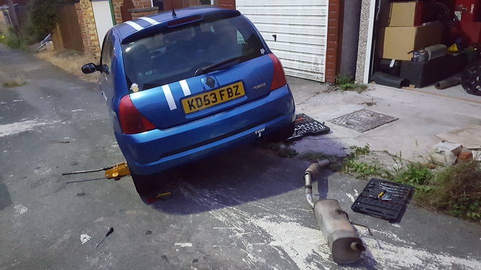

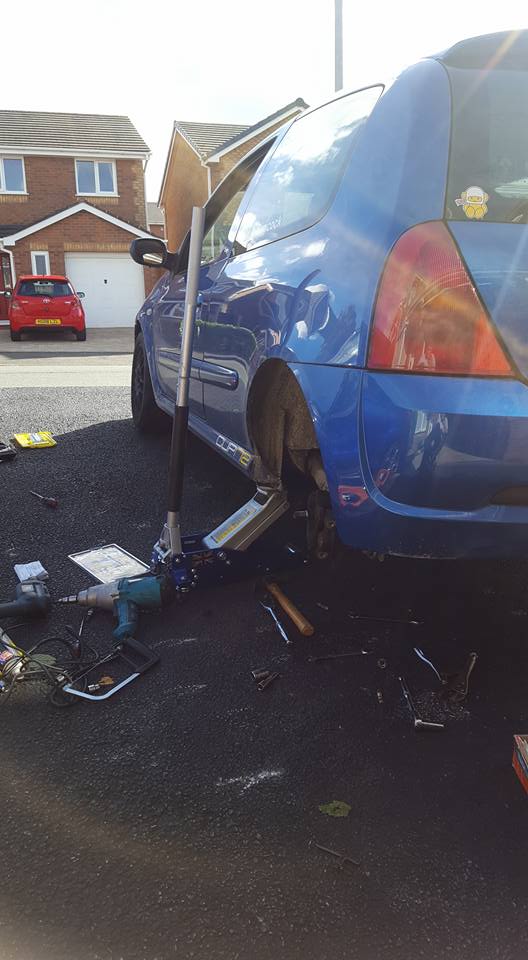

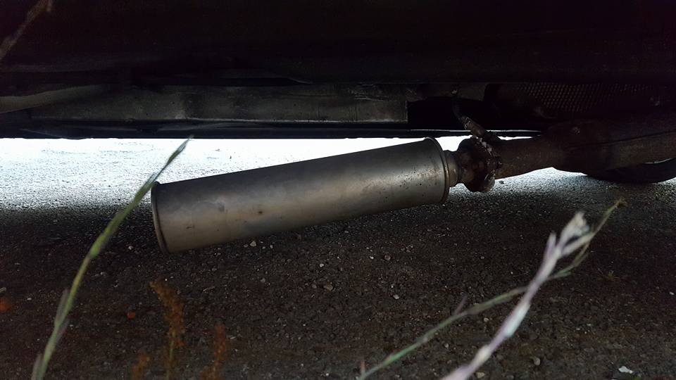

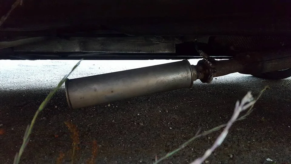

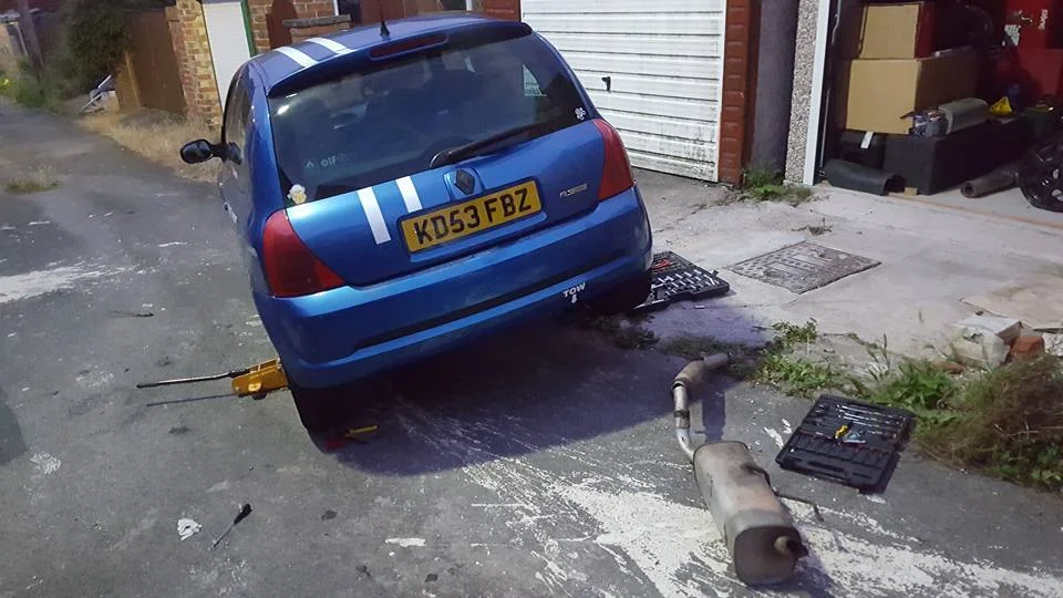

On the drive there it was getting gradually louder but when I stopped it looked like it was still attached so I continued. Got there and paid my money for the centre pipe and we had a good chat. Just as I was about to get in the car to leave (bare in mind it had been parked for about 45 minutes at this point) we hear a *Thunk*. Looking under the car somehow while we were talking the centre pipe had completely snapped and that Thunk was the sound of it hitting the floor.

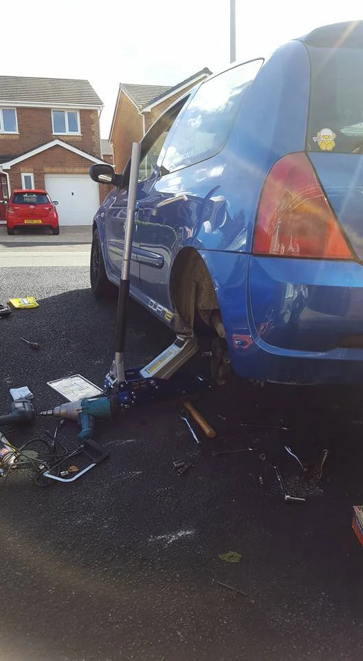

Sooo... I was in blackpool, and had got tools but no jack. Luckily the guy I bought the exhaust off had got a jack I could use so we got it up and proceed to fit the new centre pipe...
Which turned into also fitting his 200 mile old back box that he let me have for £10 because my centre pipe was rust welded to the back box and the only way to separate them was to cut the pipe in half.
By the time we finished it had gone dark so I decided to get a photo with the Blackpool tower lit up in the background. Not the greatest photo but you get the idea haha.

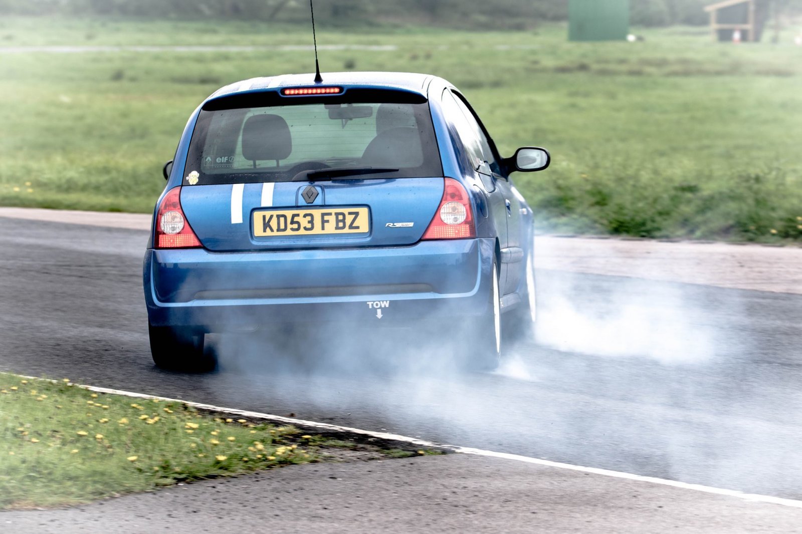

This photo was taken at a track day I did at Curborough in May last year. Locked up going into the corner and decided to see if pulling the handbrake would help me get round. It did, wasn't quick but resulted in an amazing photo of the car.

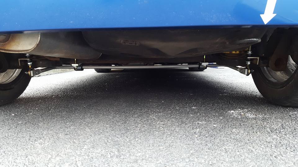

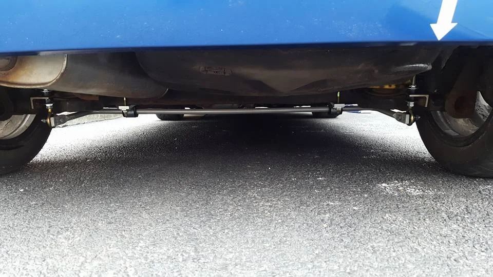

I decided to treat myself to a whiteline Rear Anti Roll Bar which feels like it has made a slight difference to the turn in of the car. There is a rather tight roundabout at the bottom of my road that in the dry on semi slicks I can go round at 40mph since adding the camber and fitting the ARB.

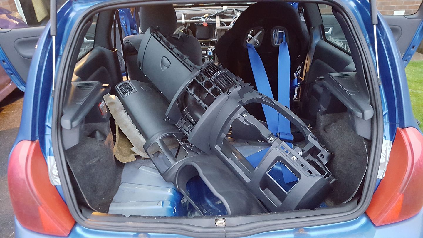

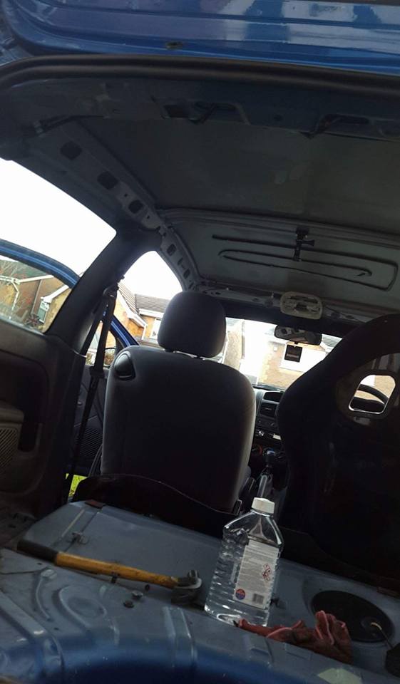

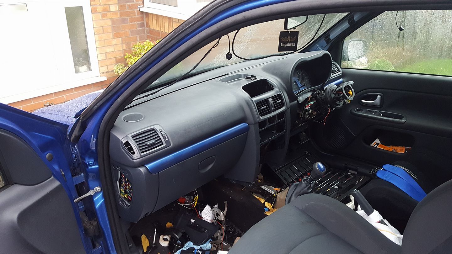

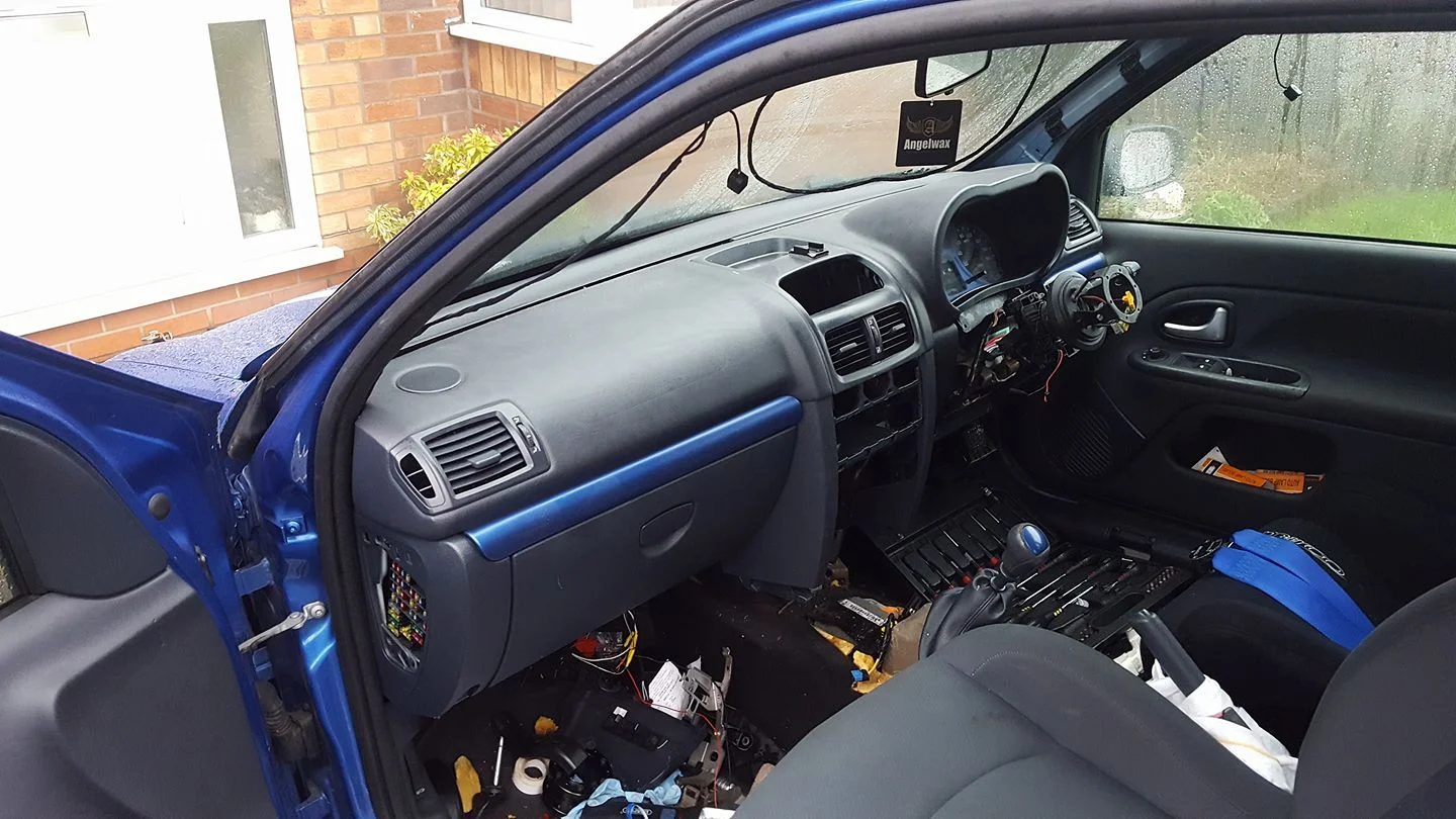

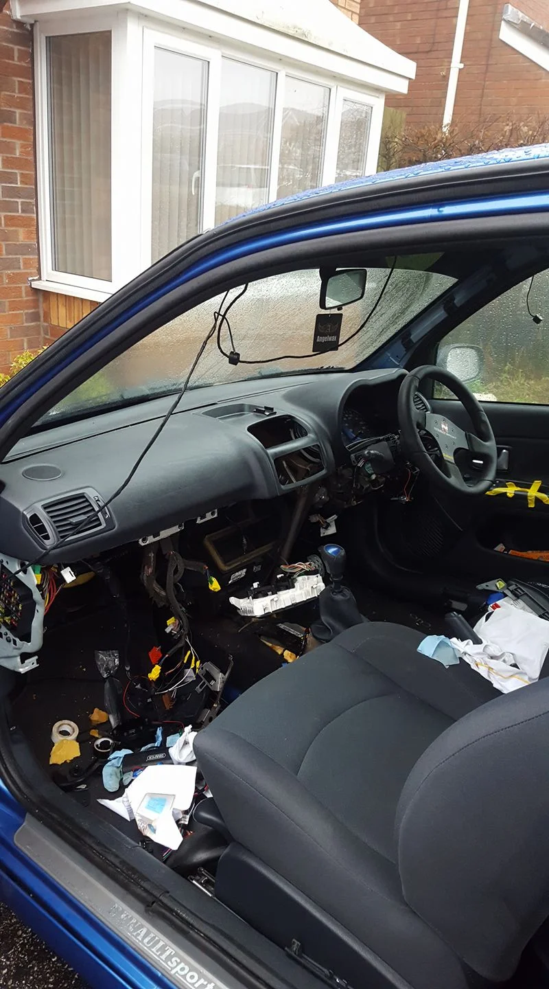

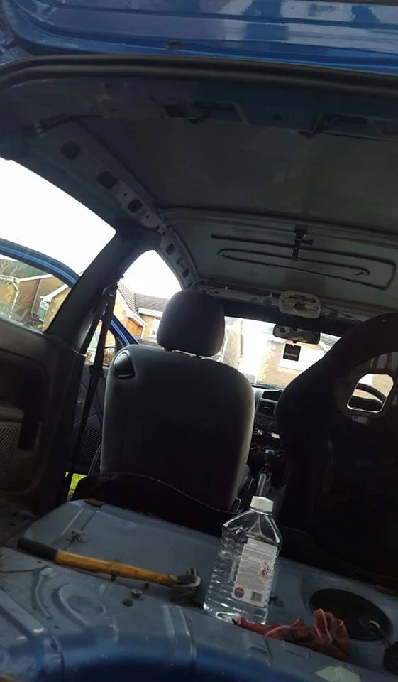

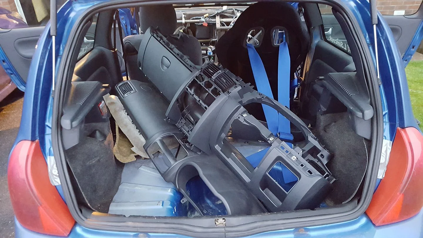

I still had my rear interior fitted at this point so instead going over bumps it began to rub on the outer arch when I had a passenger because of the springs its on. (Bought it with Apex Springs and CompBrake top mounts, still not got round to changing these, saving for Gaz GHAs and PMS Top Mounts
Rear interior removed this issue was solved. Oh and head lining. Still a lot to strip but not going too mad while its my daily.

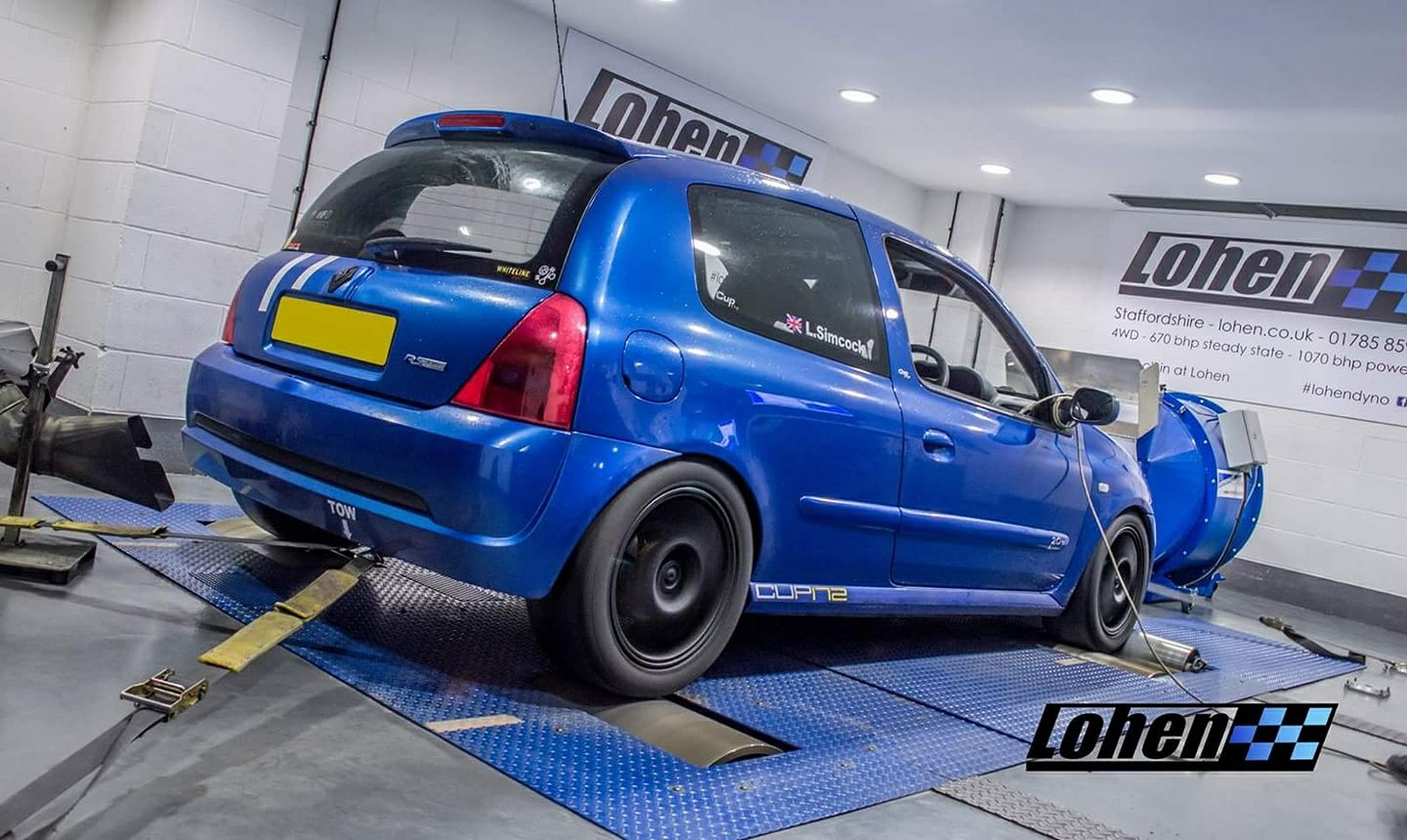

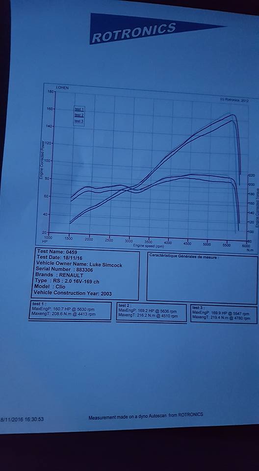

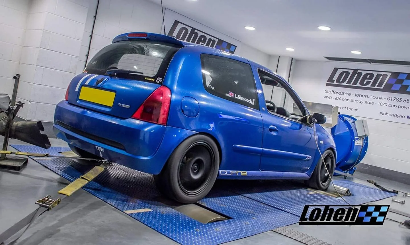

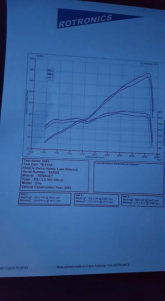

I attended a dyno evening at a Lohen where the car ran very healthy indeed. It hasn't recorded the RPM correctly but the Power and Torque are bob on.
15167624_10210004652805858_4709908778193852843_o.jpg 15167689_10210004651805833_2032828281641081847_o.jpg 15134782_10209951705362205_8755220263193194337_n.jpg
169.9hp and 161.8lbft! Very happy with that for a 143k mile engine. All I've done engine wise is fit a KTEC Induction kit so some more breathing mods and a map should see a nice figure indeed.

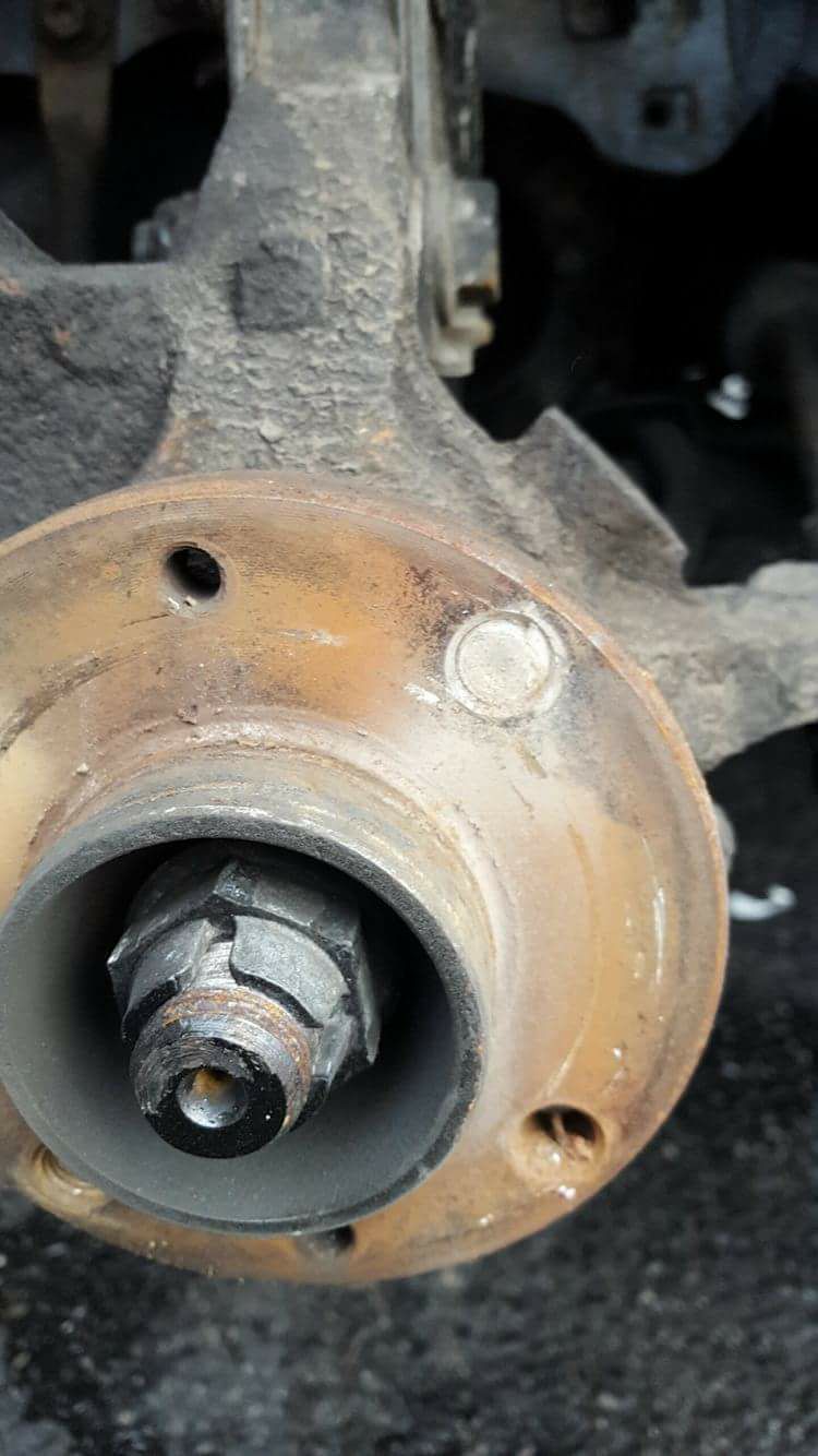

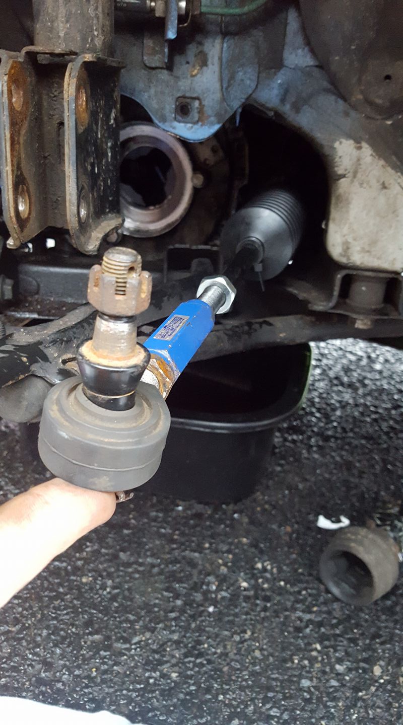

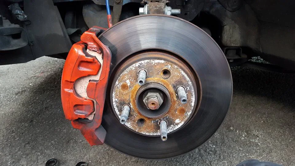

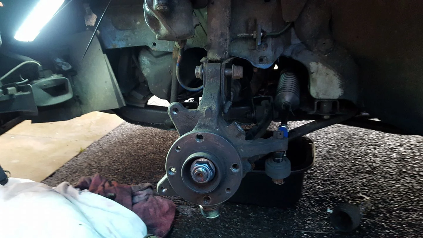

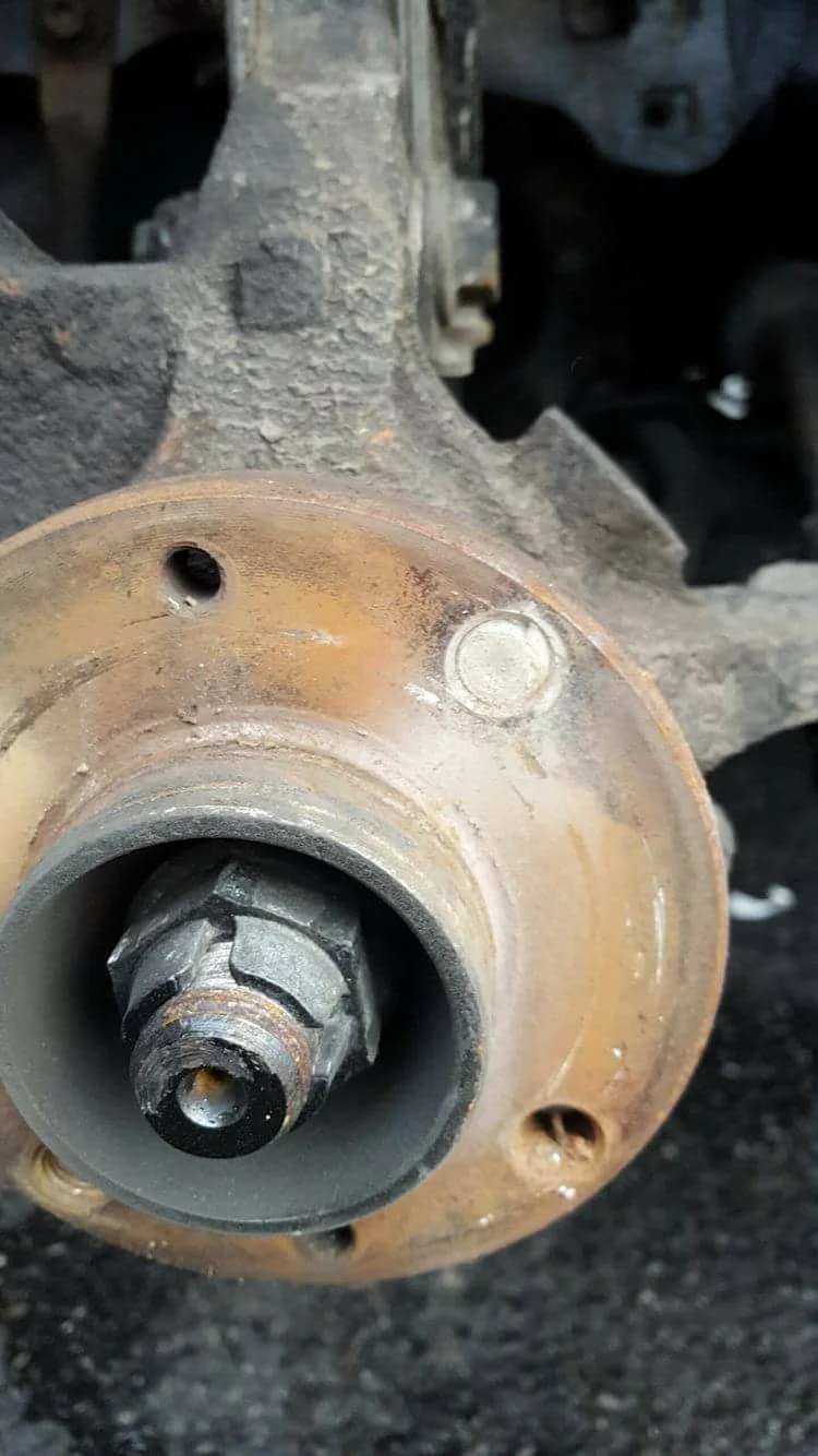

I had been running 20mm Bolt to hub spacers, a few days later I was driving home and suddenly it started to feel like I had a wheel loose. I pulled over and checked the nuts but they were all tight so limped it home and made a very worrying discovery. Upon attempting to tighten the bolts for the spacers one of them simply snapped with barely any force put through it.

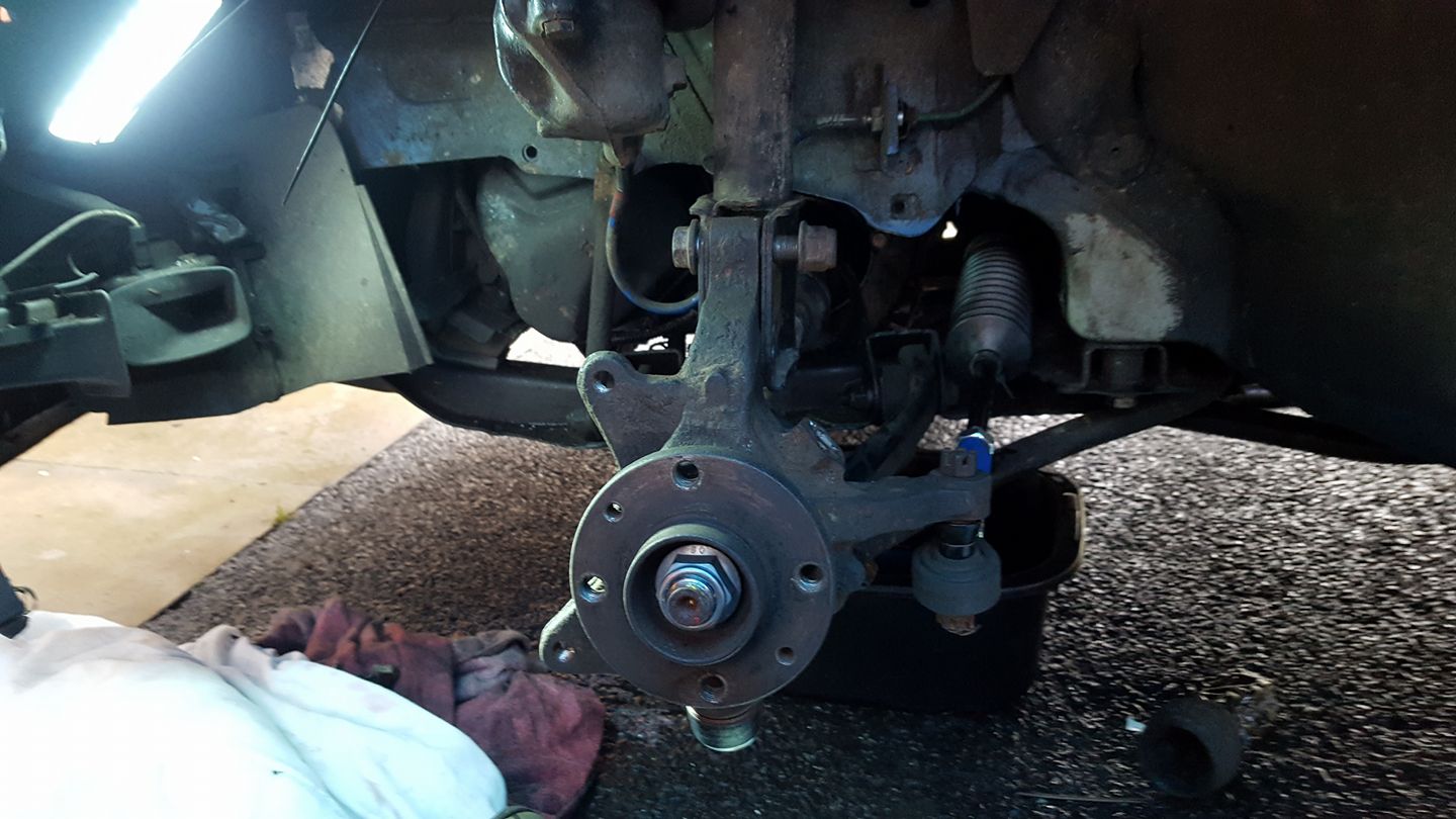

Knowing that I had some modified hubs in the shed I decided to fit these instead of removing the snapped bolt (which I had stupidly loctited in). This didn't go well when I discovered that the driveshaft was seized into the hub. Having managed to pop it out of the box I took it to a friend's work where he tried to remove it using a hydraulic press. At 4 tons of force something budged. That something wasn't the drive shaft. The cast hub actually snapped under the force so got chucked onto the scrap pile along with the shaft. A 2nd hand shaft was purchased from ebay and I shortened the new track rods ends to fit my modified hubs.
When I say modified, they have been drilled to allow the fitment of a JapSpeed Bump steer correction kit which has genuinely made a massive difference to how it feels.

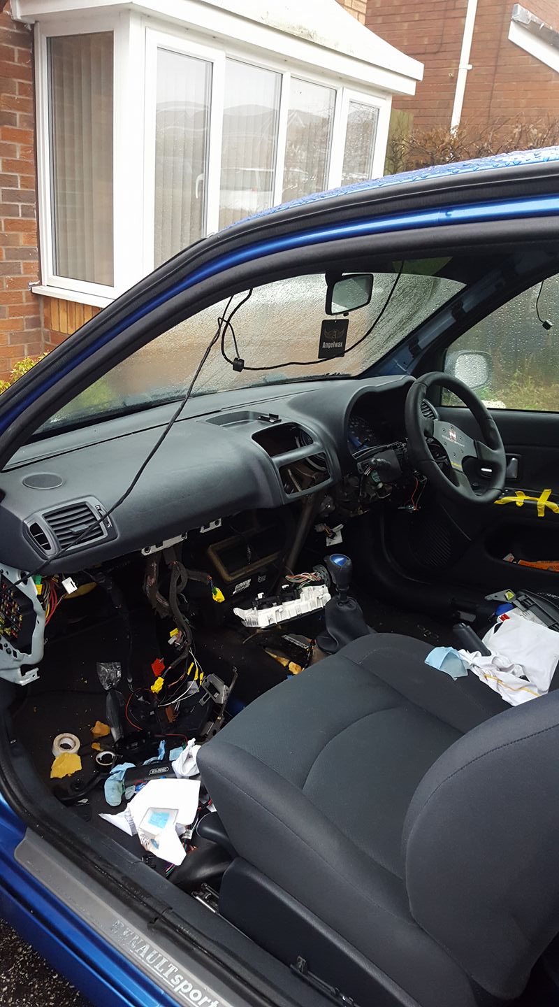

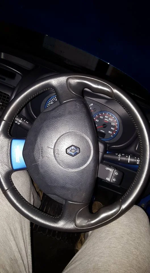

So as mentioned in the last post, with my MOT being due at the end of February I decided I should probably get round to fitting the EPAS to the car. Thankfully Clios are easy to pull apart so the Dash was out and the EPAS fitted and wired in using an EBay kit without too much effort. I do like the look of a top dash only so once its no longer a road car thats probably how it will be run.

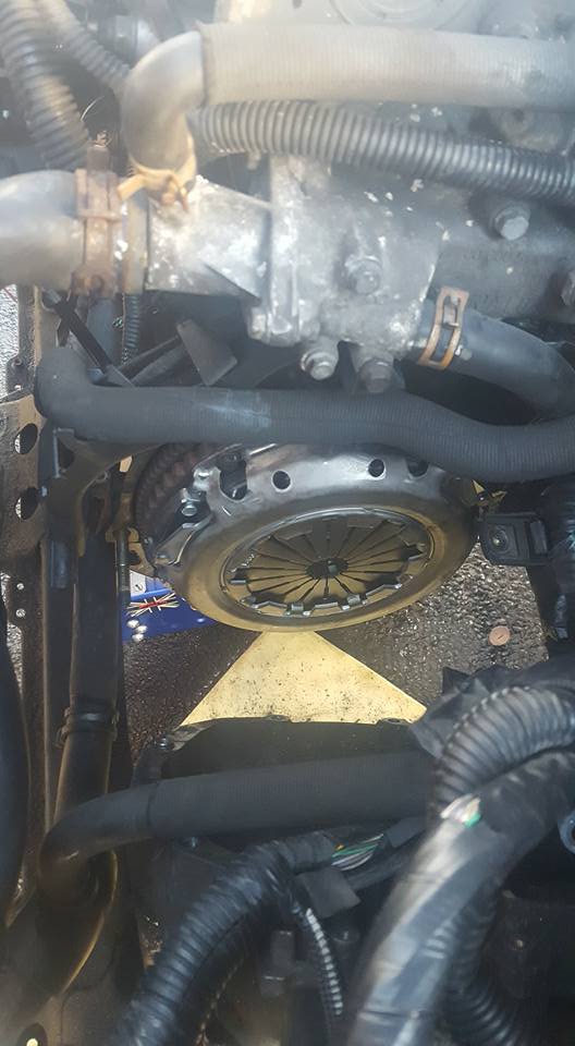

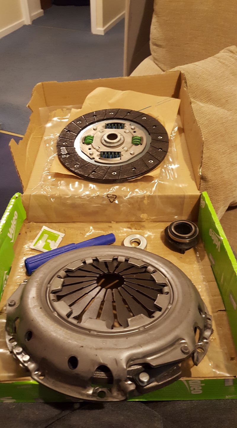

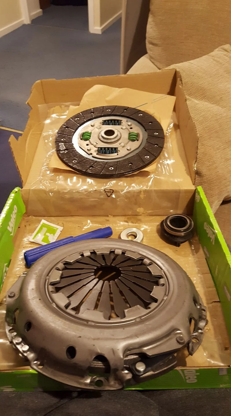

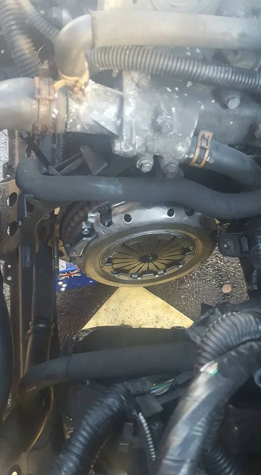

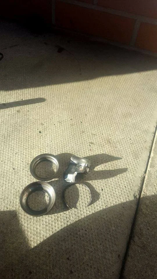

Sadly I didn't realise that the collar which the release bearing sits on had been damaged which meant after managing to put it back together having never done a big job on my own before (I swapped the clutch with no help what so ever) the first time I engaged the clutch it was still making a horrible grinding noise. This very very nearly ended up with me breaking the car for parts, as you can imagine after having done such a big job on my own and having found out it wasn't fixed I was extremely dejected and had I been able to extend my bank loan I don't think I would have fixed it.
Looking at Photos of the car made me realise I couldn't bring myself break it however I had vowed at this point I wasn't going to pull the box off myself again so I booked in into RS Four Ashes in Cannock to get the clutch issue resolved and to have an MOT which had expired at this point.
It managed to make it from Stoke to Cannock however I noticed some oily smoke on the way there, at this point i was too annoyed to actually care and finished the trip there. Upon parking up outside Four Ashes I realised that what had happened was that the gearbox had dumped its oil.
The box was stripped down and it was found to have damaged the planetary gears in the diff, I also had a complete synchro set as 3rd had been crunching and had a few other bits and pieces done. After a week of driving the 1.4 Courtesy car I couldn't wait to get the Cup back.
Getting it back after the box rebuild made me realise how bad the box had been before, it felt like a different car. It seems to have behaved itself since then, I finally bought some longer studs and fitted some 20mm slip on hubcentric spacers. I'm taking the car to the Nurburgring in June and after speaking to Dale Lomas from Bridge to Gantry discovered that my Bonnet Pins wouldn't be allowed onto the track. To ensure that I wouldn't have any issues I decided to fit aero catches to the bonnet and also to the bumper which was only held on by the factory clips at this point so not solid at all.

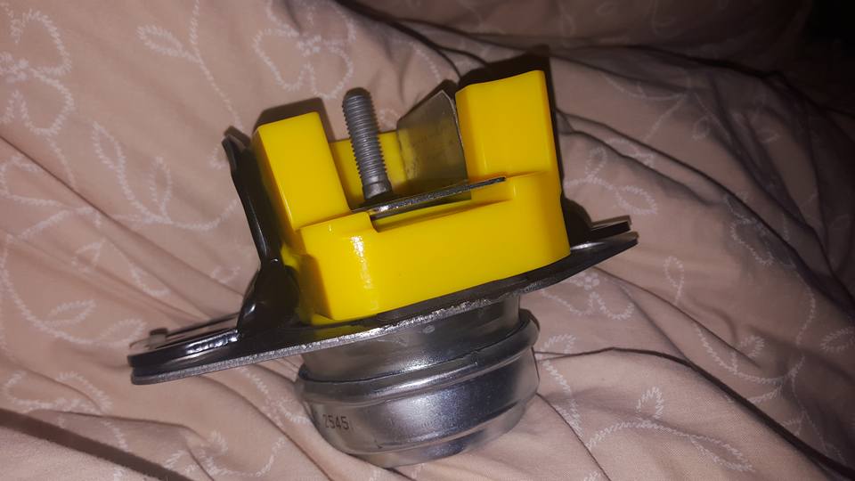

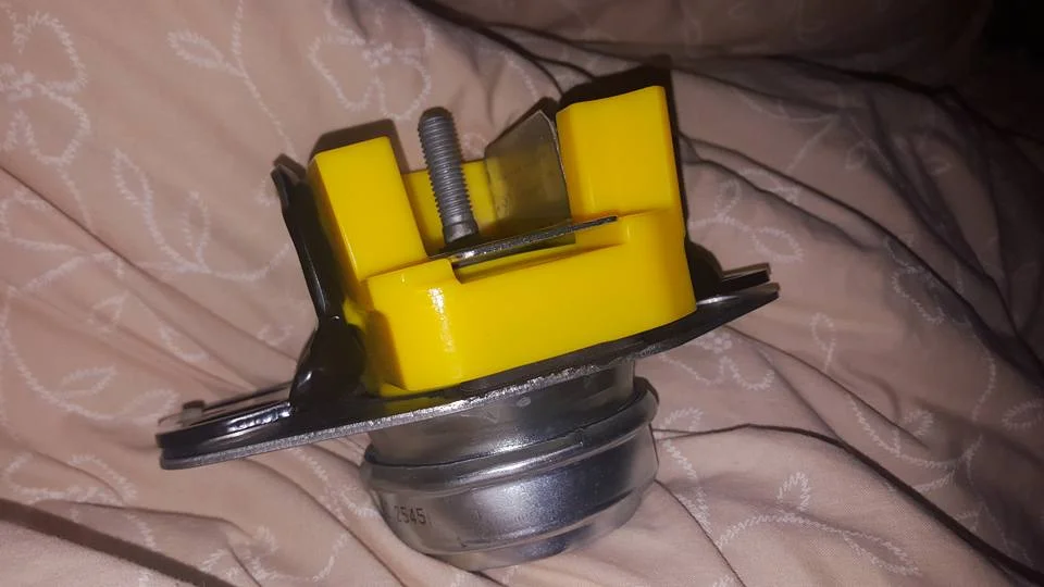

19. Powerflex Dogbone mount
20. Powerflex Upper engine mount insert

I like the strips :smile:
Cheers haha. Going to get them redone soon hopefully so that they actually finish haha.

Bit of an update. Gone to have the box looked at sooner than I planned.
Popped the diff circlip yesterday at a track day so got it recovered back to four ashes. If the box has to come out I'll get my 182 manifold fitted.
  172 cup
Nice right up mate sure I've seen ya about in this but wouldn't be hard I only live in bignal. end ha ha , that last pic at curborough I've just ordered a renfort plate for my diff solves the problem
Wouldn't surprise me haha. I live on Audley road so go through Bignall End on the way to work etc. You've probably heard my RC6s
Yeah it's at Curborough haha. Think potentially just going to weld it for now. Planning on getting a gripper eventually.
As suspected, circlip has gone, that and my 5th gear issue should be sorted soon. Looking forward to getting it back, can't stand not having a car haha.
Replaced the circlip and welded it in place. This lasted a week so the car is now back in having a 182 diff fitted.
If anyone is interested its going to be up for sale once I have it back. Decided using a track car as a daily wasn't a great idea so I'm putting it back to standardish and am replacing it with a Mini haha. I'll put a sale thread once its back with me.

Hows the noise for daily driving?
