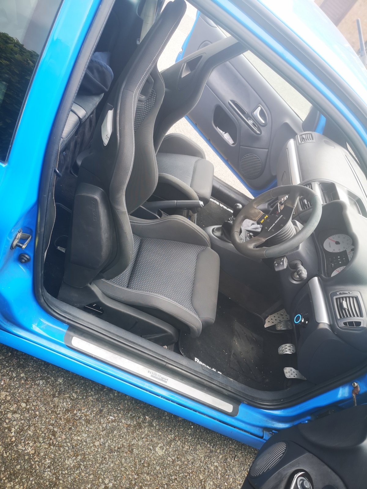

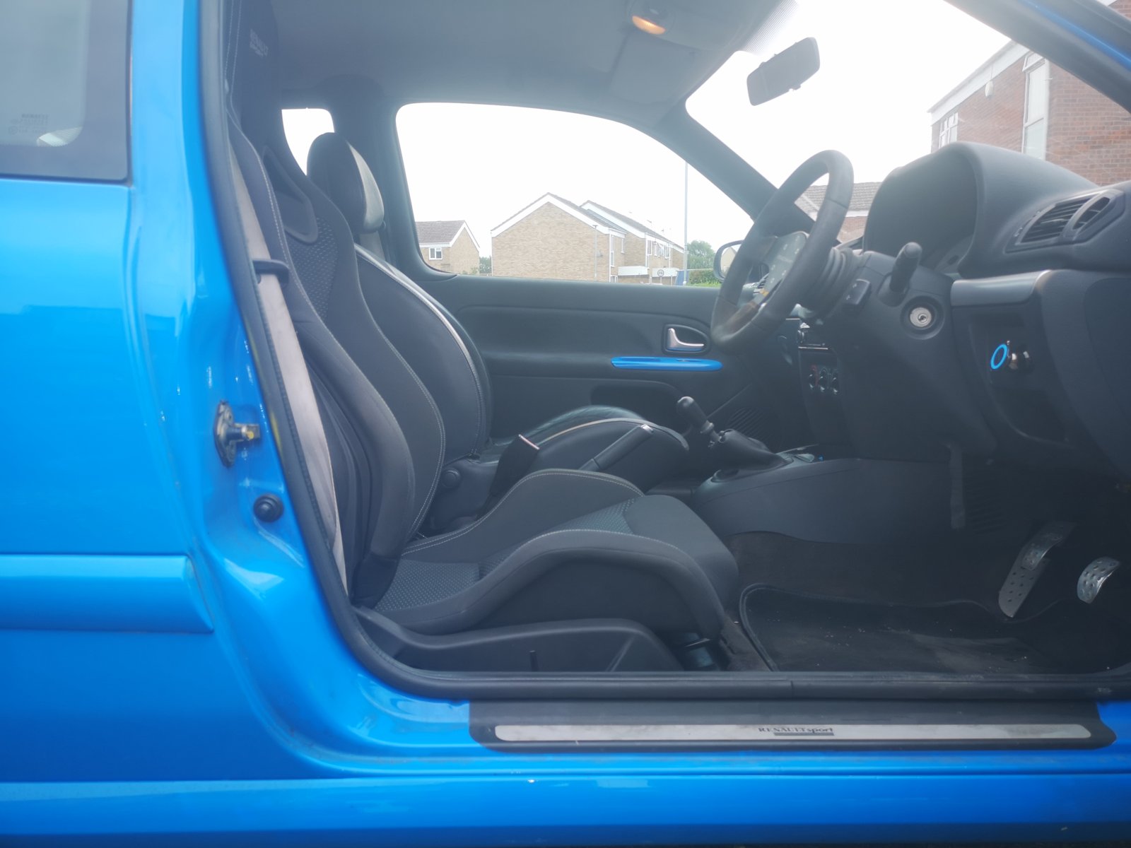

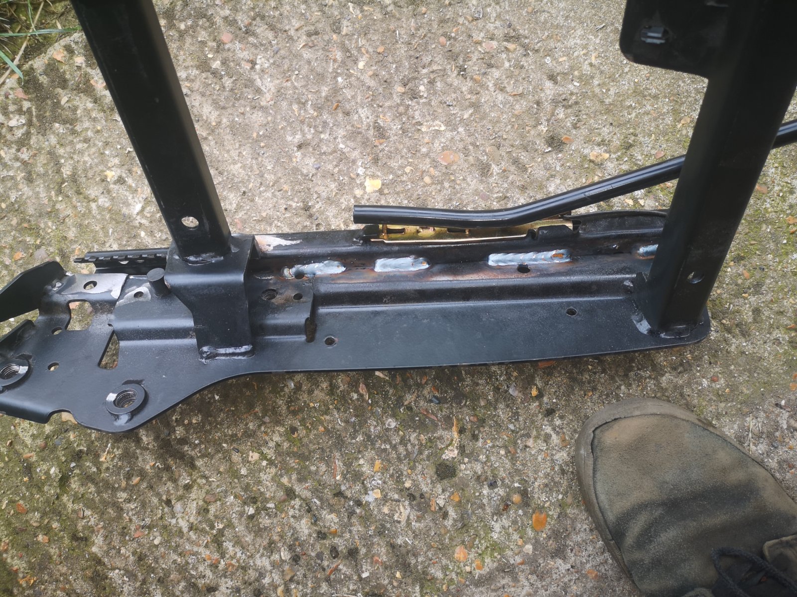

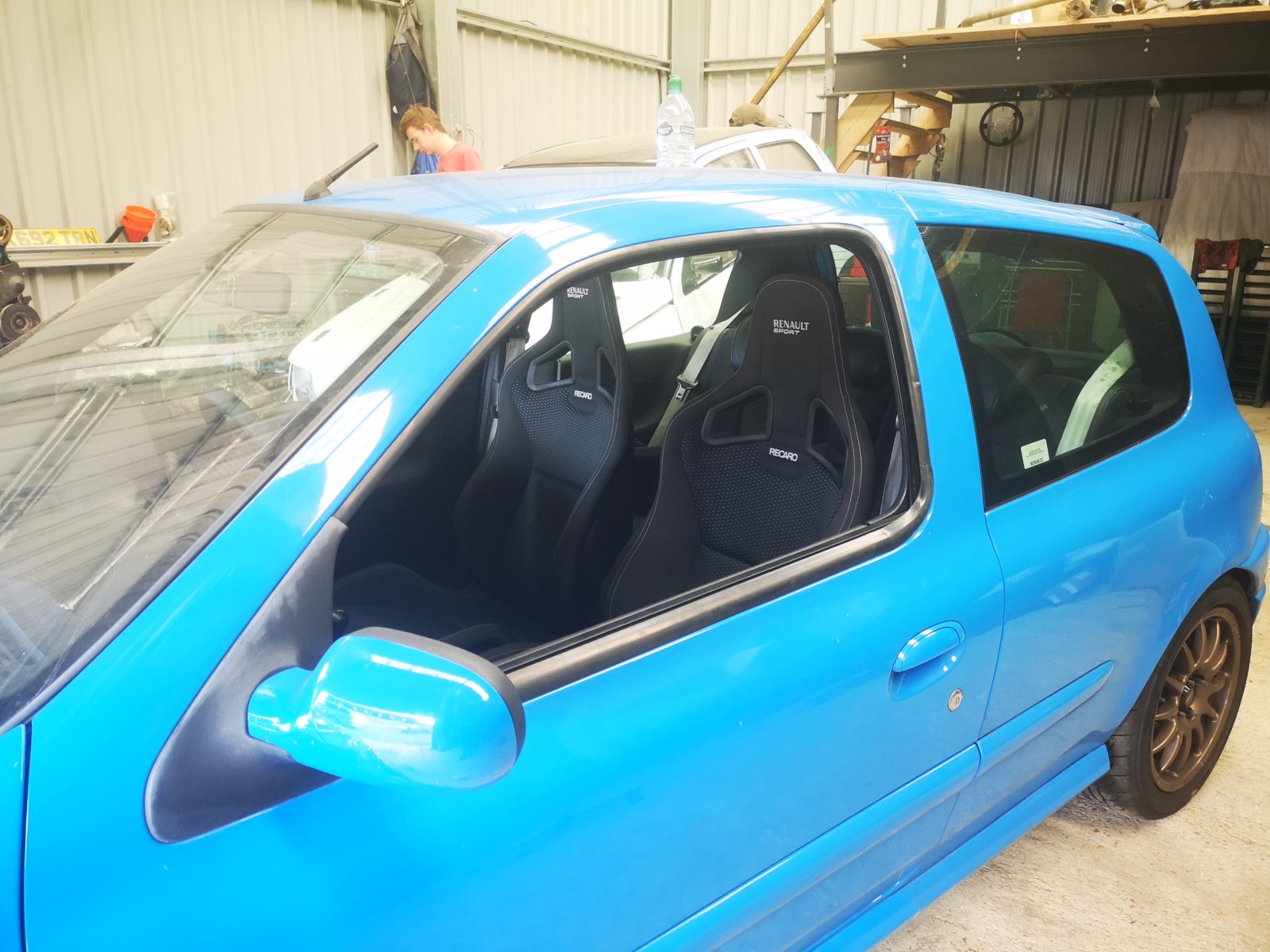

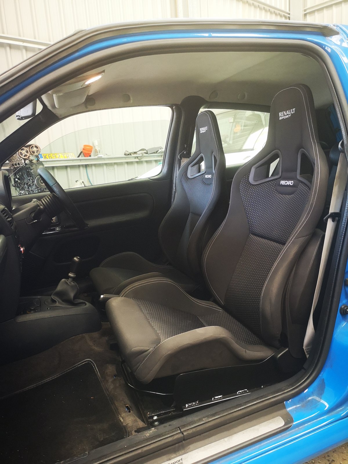

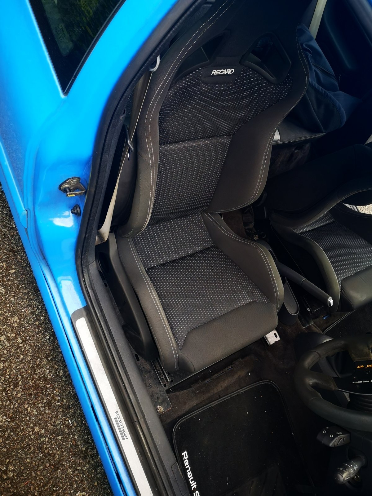

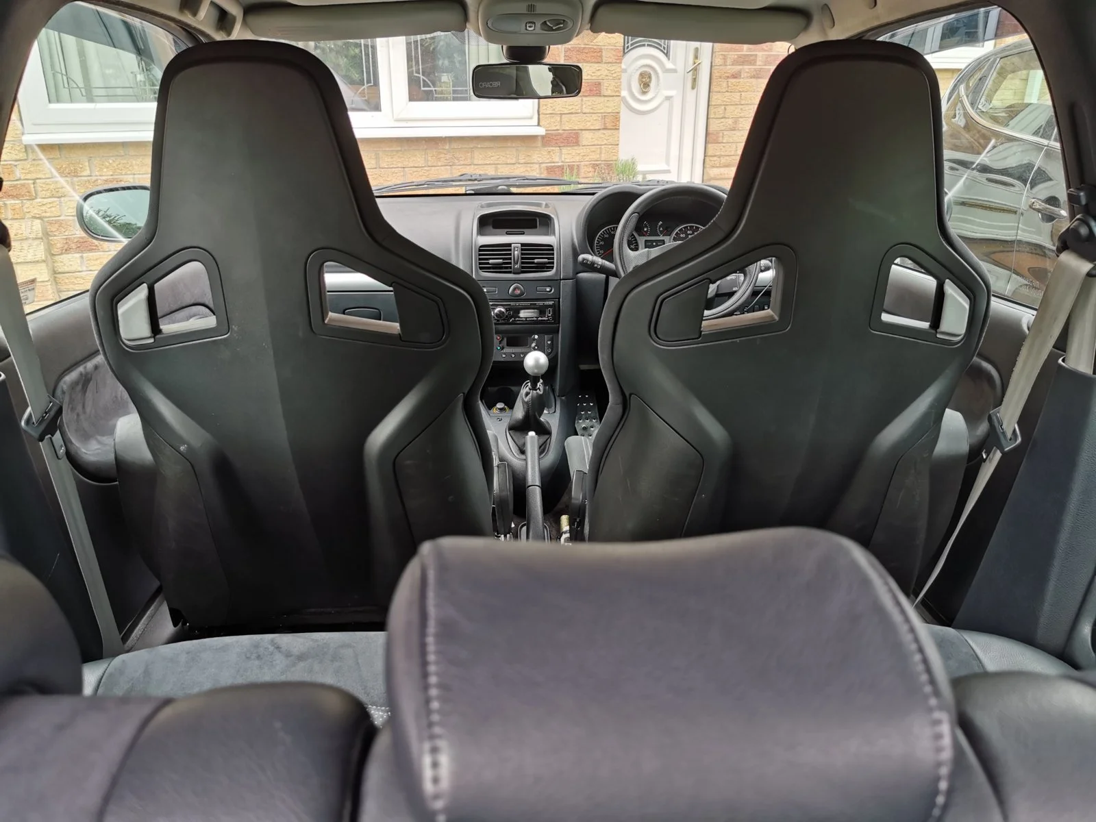

Took alot of messing about but finally got my 197 seats fitted how I want them.
I wanted a lower seating position than standard so they needed alot of adapting to get them low enough.

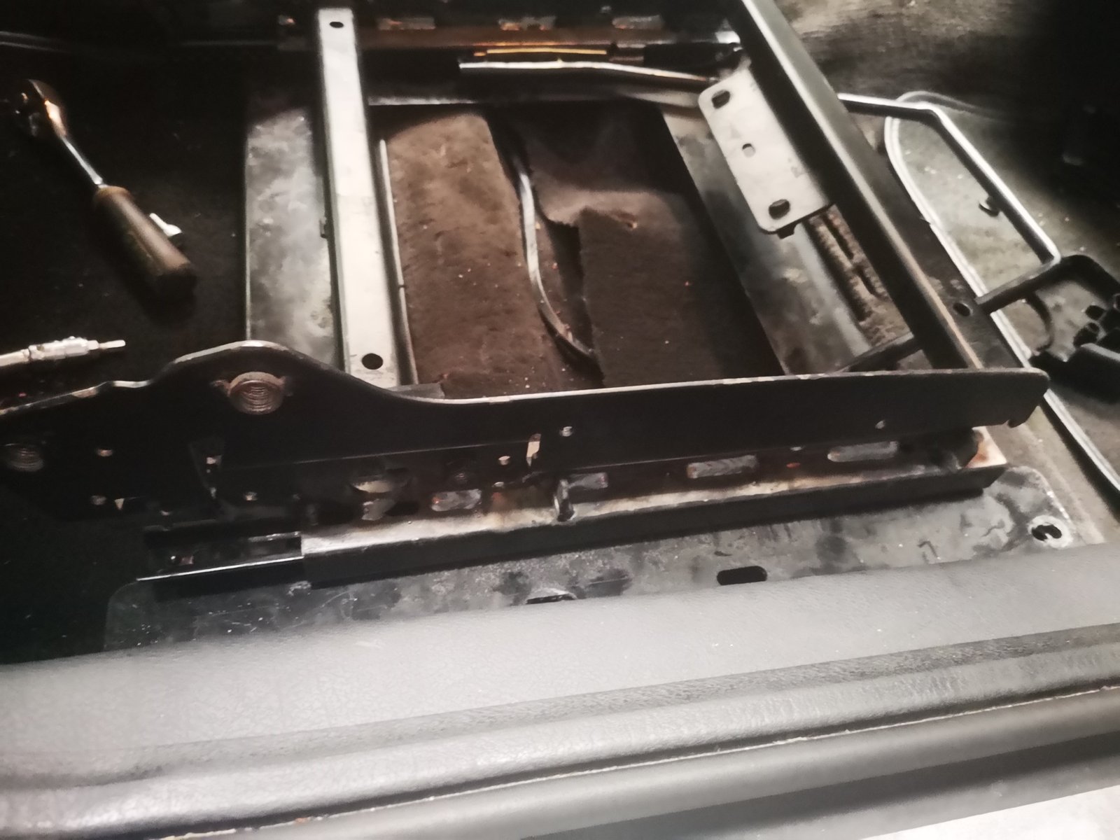

Ended up chopping up the 197 recaro frames and welding them onto universal seat rails which then bolt onto Jon foz subframes.

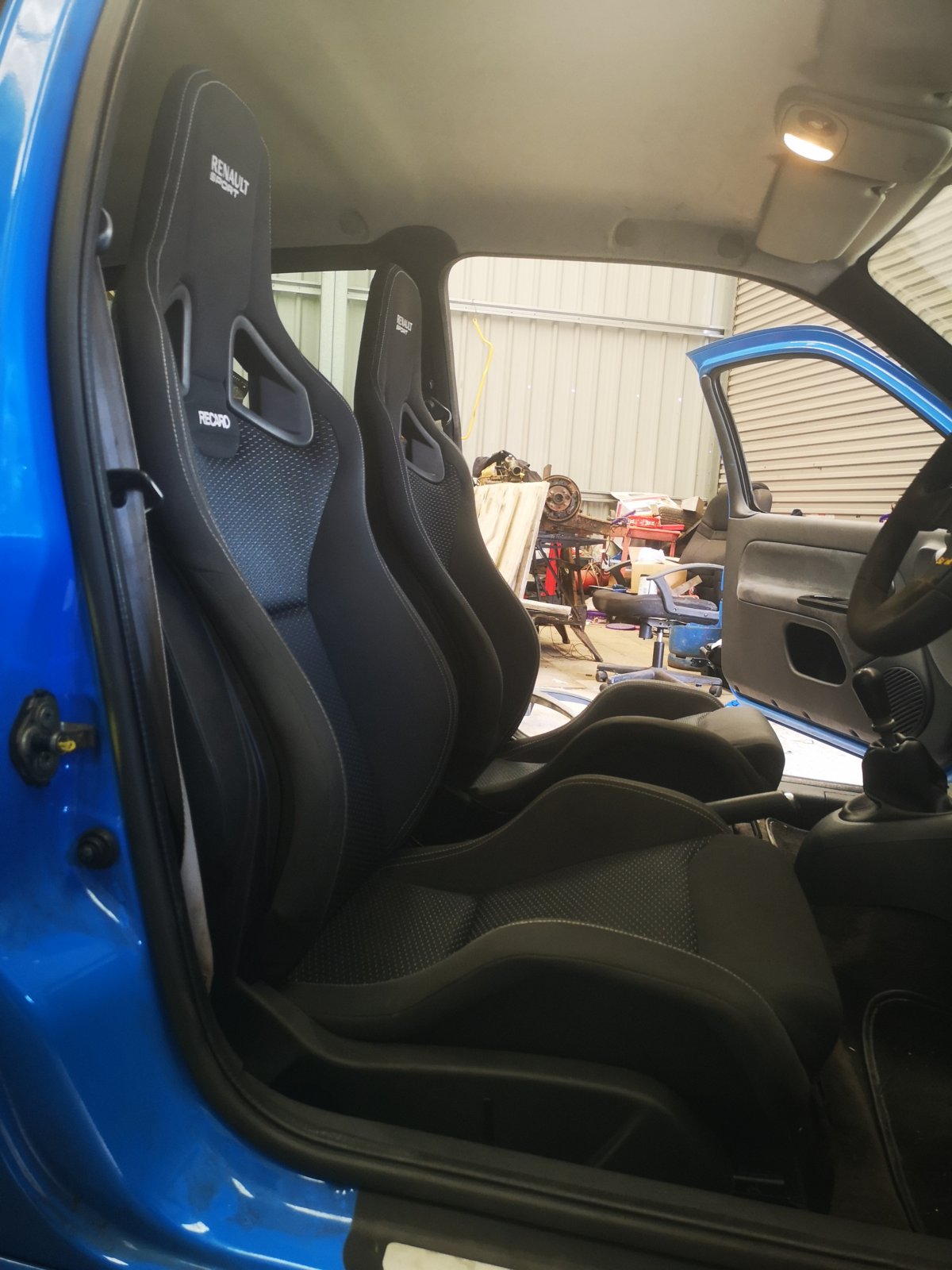

Seating position is now spot on for me and they tilt forward and slide back and forth nicely picture below shows the height difference compared to the standard passenger seat which has the spacers under the seat removed.
And a few pictures with both fitted to the car
And a few pictures of the mounts before they got painted..

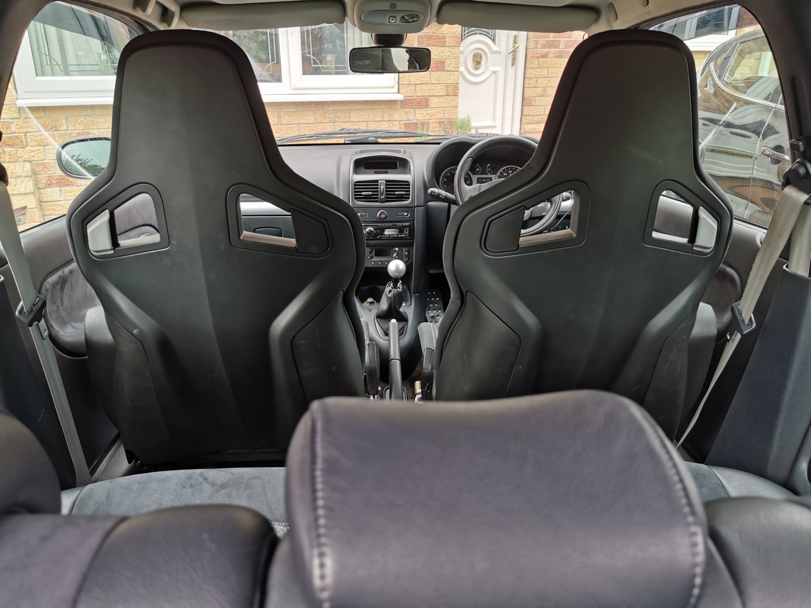

Great job! I've always loved the look of those seats. Can you still see over the steering wheel? :p
Haha just about.. I'm over 6 foot but any shorter and they'd need raising up a little for sure

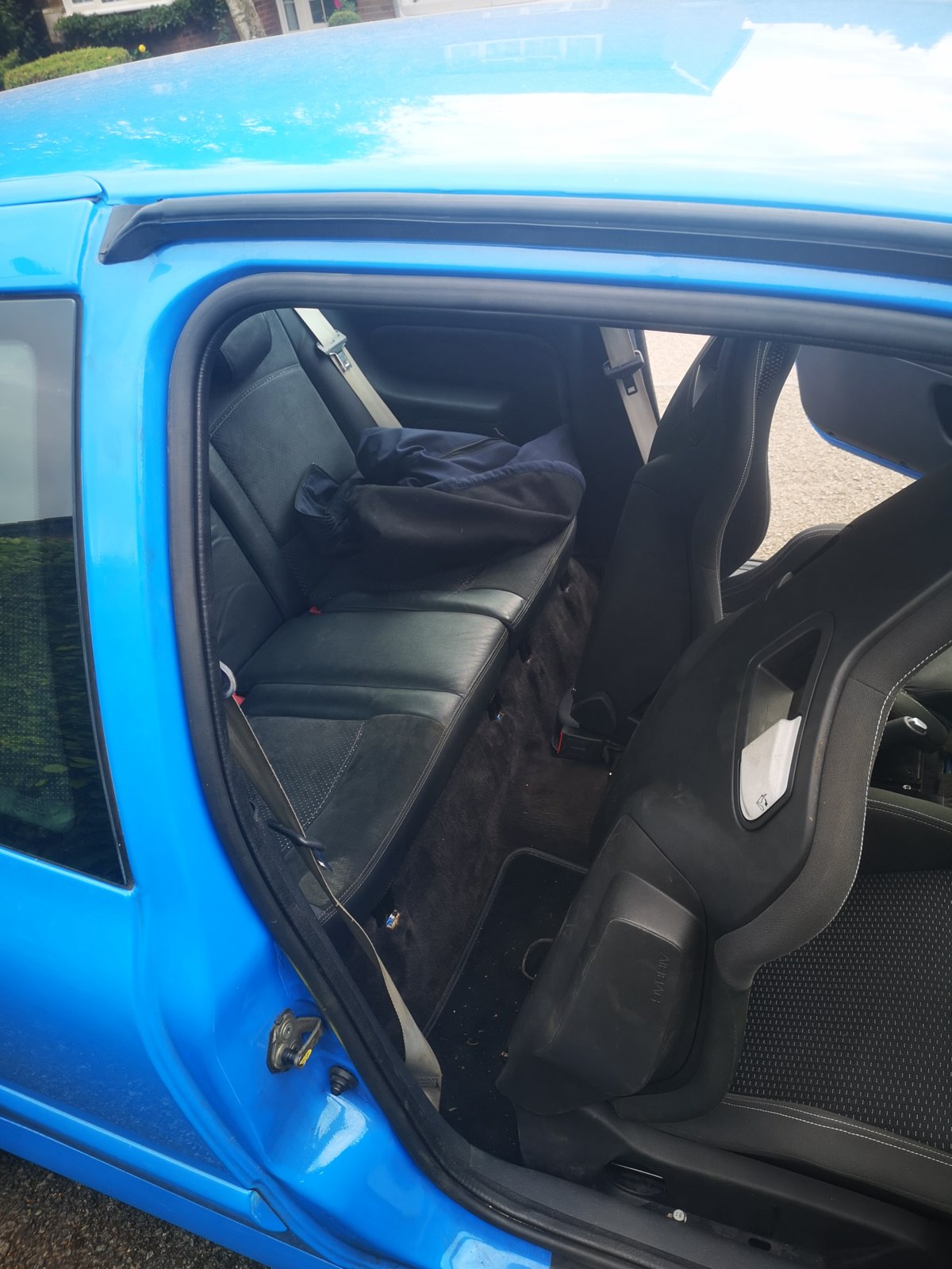

Do you have to write off the back seats when these are installed?

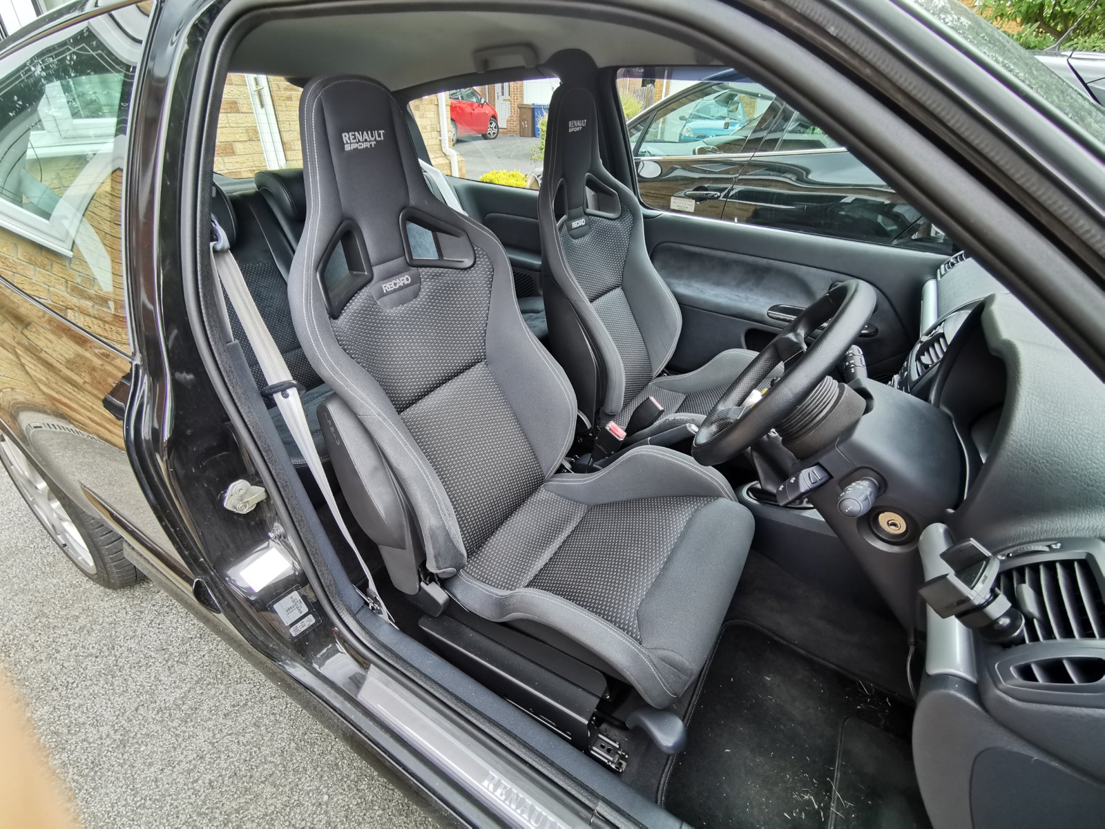

They look a bit lower than mine are, but I'm a short arse and they suit me fine. So much more comfortable than standard seats. View attachment 1429225View attachment 1429226
They look really well fitted! And yeah they hold you in so much better too, I'm paranoid about getting in and out of atm as the bolsters have no wear on them but I can see how easy it is to wear them as they are very high!
No difference in rear leg room really, just need to slide the seat forward before tilting as you lose the mechanism that does both to get them to fit

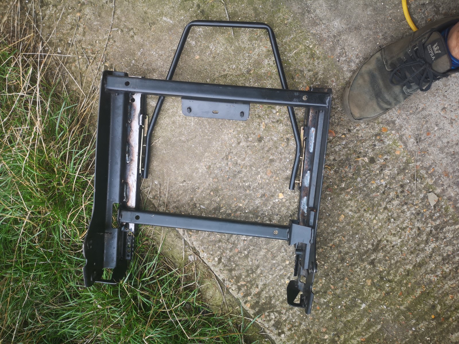

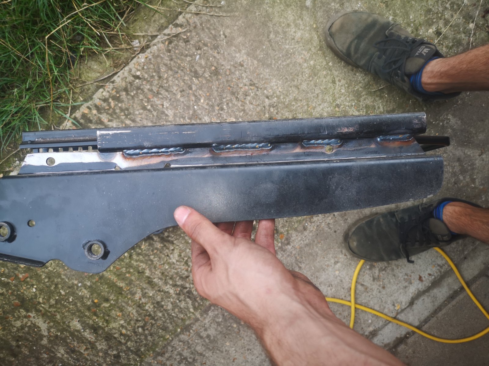

View attachment 1429204View attachment 1429205View attachment 1429206View attachment 1429207
View attachment 1429210View attachment 1429211View attachment 1429212View attachment 1429213

This is definitely on my to-do list! Thank you for the photos of the rails too, spot on.

And tilted for rear seat access
