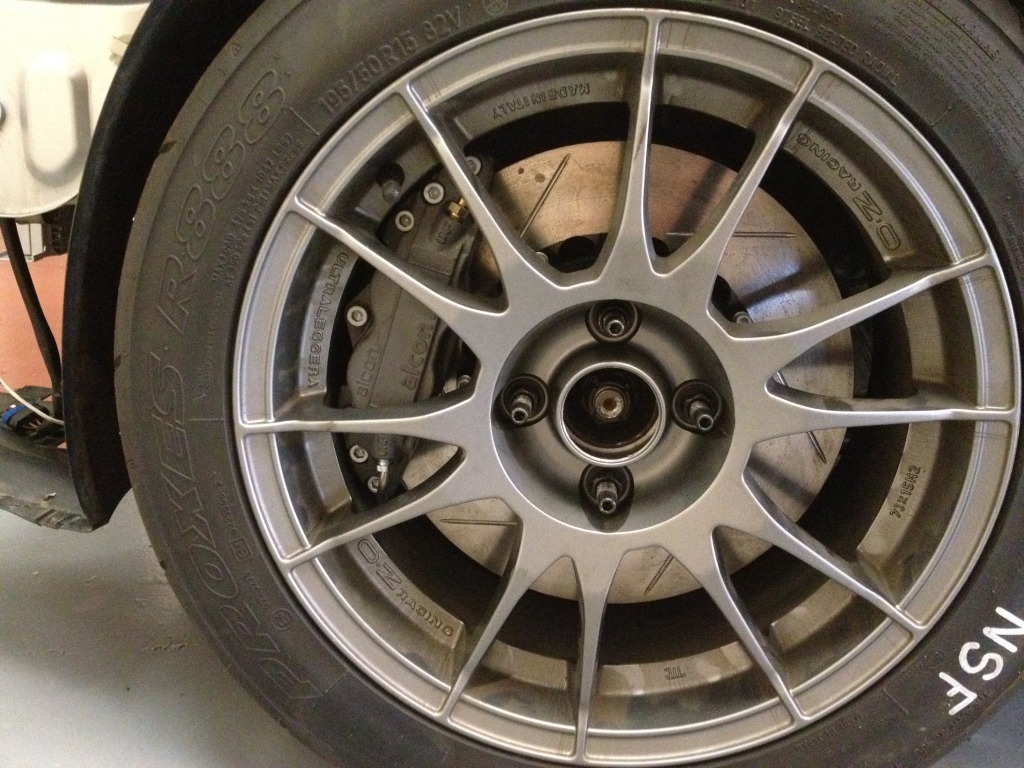

Sorry missed the post above yes it does say that but I would give them a call and ask as its what i'm running and although i'm only going to be running a 10 and a 5mm spacer to start with i'm fairly sure we can go bigger. It certainly looks that way when I look at the amount of the thread that sticks out from the end of the nut!
Edit: Just found a photo which shows the amount of thread left with no spacer
