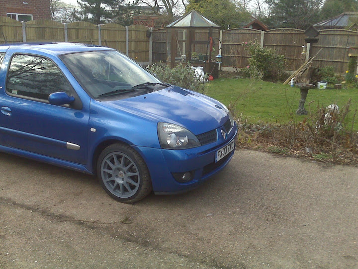

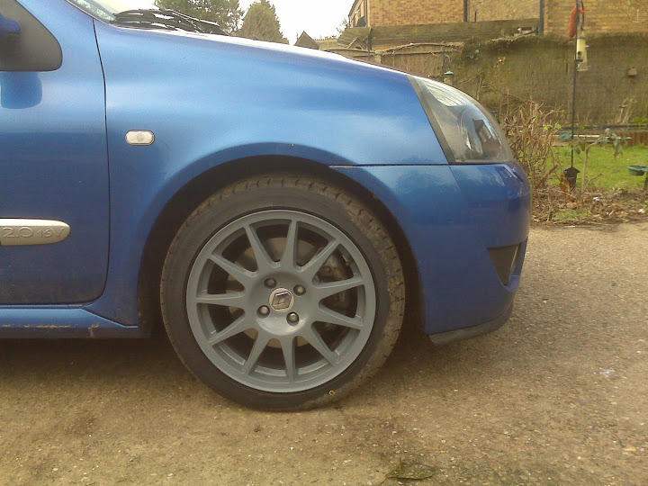

Any way....the finished article:
Now i can either get the rears done the same as these havent been done yet, which will piss me off, or pay to get them redone, which will properly piss me f**cking right off.

That'll teach you for trying to ruin a set of Cup Turini's by spraying them a colour which just makes them look dirty! lol.
Sorry, only joking, I just think they look much better in Silver.

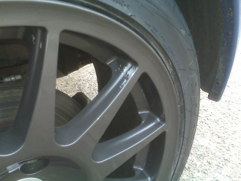

Having being burnt the first time i thought id pay to get the professionals in and get the job done right. Having spent a fair chunk of money to get all four wheels refurbed, i was initially pleased with the result, however the wheels were done on Wednesday and now today (Friday) the paint is peeling, looks like the guy has used a microscopic amount of lacquer in most places and none in others. I can leterally just scrape the paint off with my nails
Im now waiting to for the guy to pick up his phone to tell him to come back and sort them out, what i dont want is for him to just patch them up as i dont trust his workmanship, i supose another coat of lacqure should be enough to seal them, but im no expert.

I say it a lot, but for good reason, only ever paint wheels if you can do it yourself and know it's done properly. I'd bet that with so many spokes on the Turinis hes only half-arsed prep'd in between the spokes, hence why the paint is peeling already.

The problem will be lack of primer or decent prep for the paint to stick/bond to. Another coat of paint wont solve that.

where they properly dry before he let you take them? Sometimes they can be dry to touch but the paint can still be soft. Would have expected them to be baked in the oven though but there are some cowboys out there

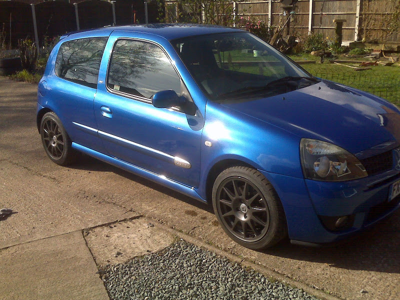

Here's mine:

he wont have used lacquer it looks like 2k paint which is just a direct colour . id just get your money back and get them re done elsewere . its no good painting over paint that is gonna flake. he may sort that bit out thats already flaking but the rest will follow in time and bring your new paint of trust me

exactly mx1...when I prepared my 1.8 wheels for the winter tyres I had to remove almost all the paint around the lip with a screwdriver because it was flaking...i "tested" all the paint with the tip of the driver to see if it made a "paper" sound, there is where you have to remove the paint. Usually it comes off leaving bare metal.
