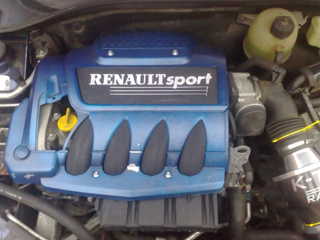

Or just be a cowboy like me and do away with the cold air feed altogether ;)
Cant really see it but basically as the standard inlet is too big my viper is too far forward at th mo to make a decent caf so just did away with it
Cant see there being much heat soak and it gets cold air through the bumper... havent noticed a difference in sound/performance at all.
P.s like the tie wraps ;)

that bay could do with a bit of a tidy up
surely the acoustic valve was not connected to the viper anyway?
WIP dude ;) (work in progress!) house is caining the car funds at the mo :(
