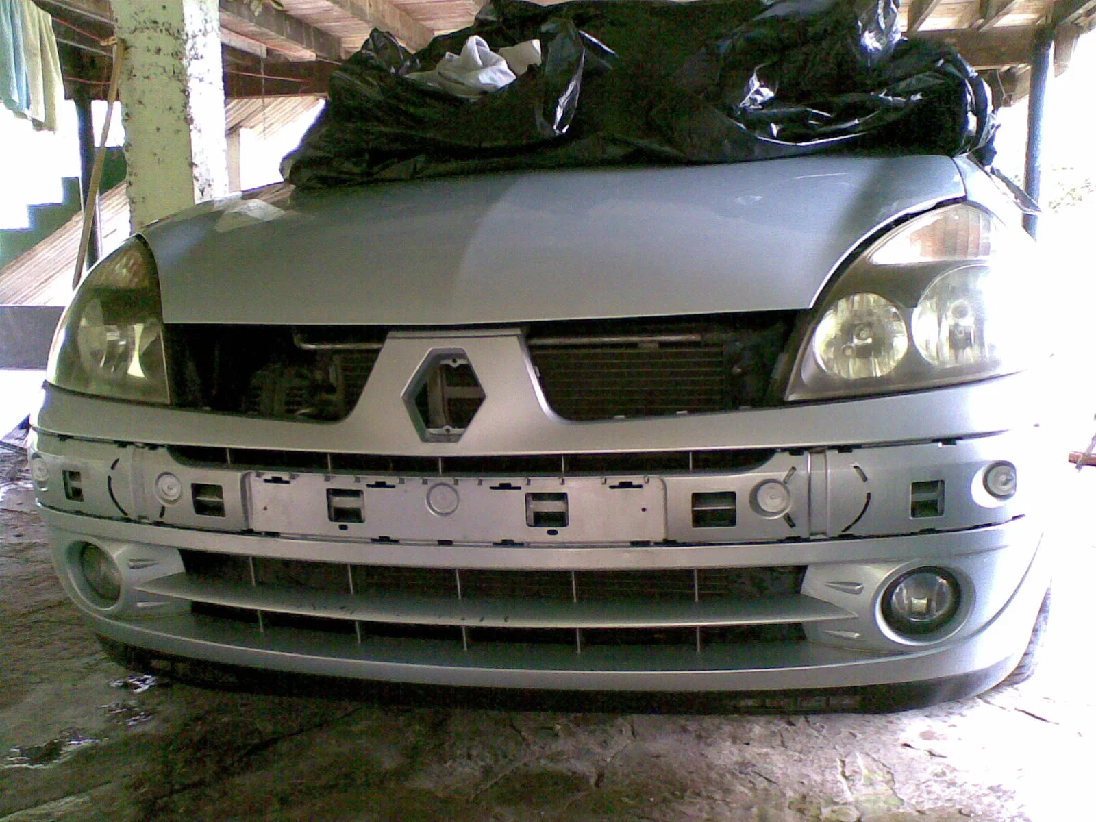

Middle portion comes off easy. Remove your number plate and the screws. Take your time when working the ends. I poured some soap water to help lubricate the clips, that are easy to break.
