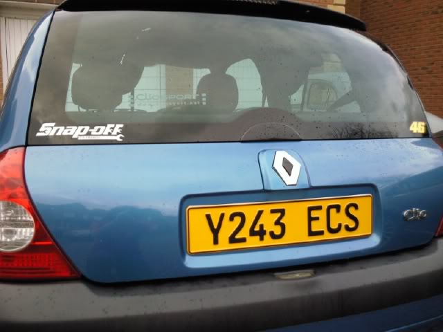

anywhoo, i got it off and got the new plate on and it looks soo much better. Thanks for all your help guys :star:
now i don't know wether to keep it black or colour code it lol
Its the standard cover that has been fiberglassed over by the look of it, he made a good job of it.
