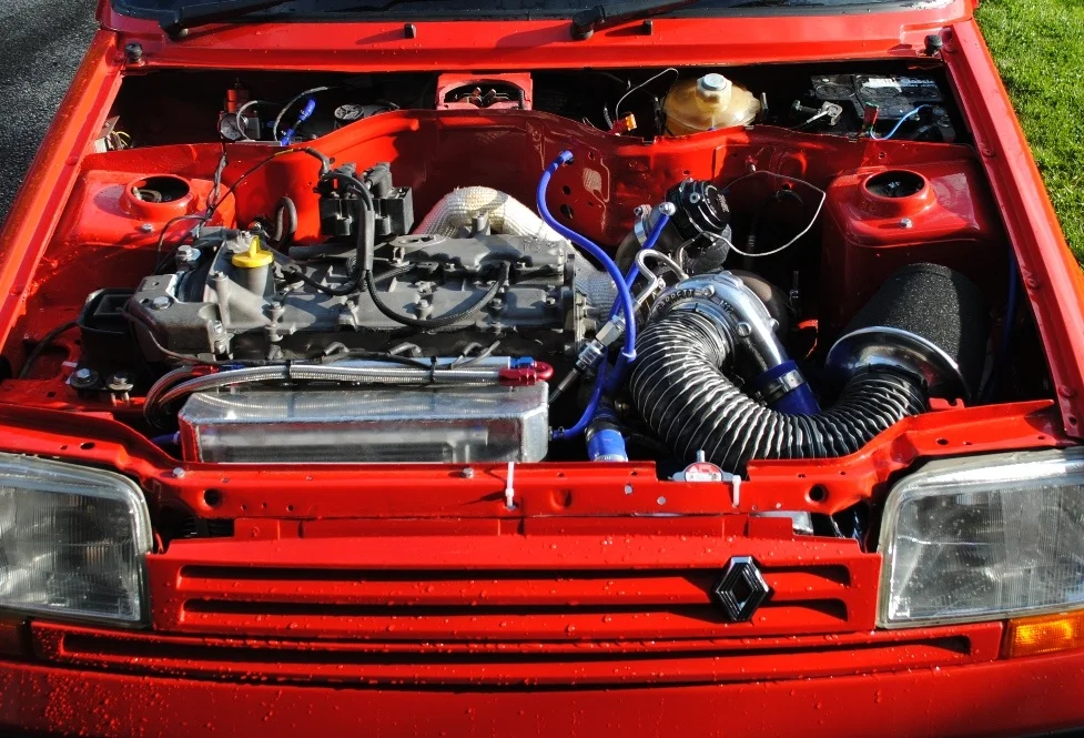

Engine bay pic:
A
ashy_gtt
Quick update, big thanks to Scoff (EFI Parts) for spending all day Sunday mapping my car, what a top jobs he's done. Thanks mate.

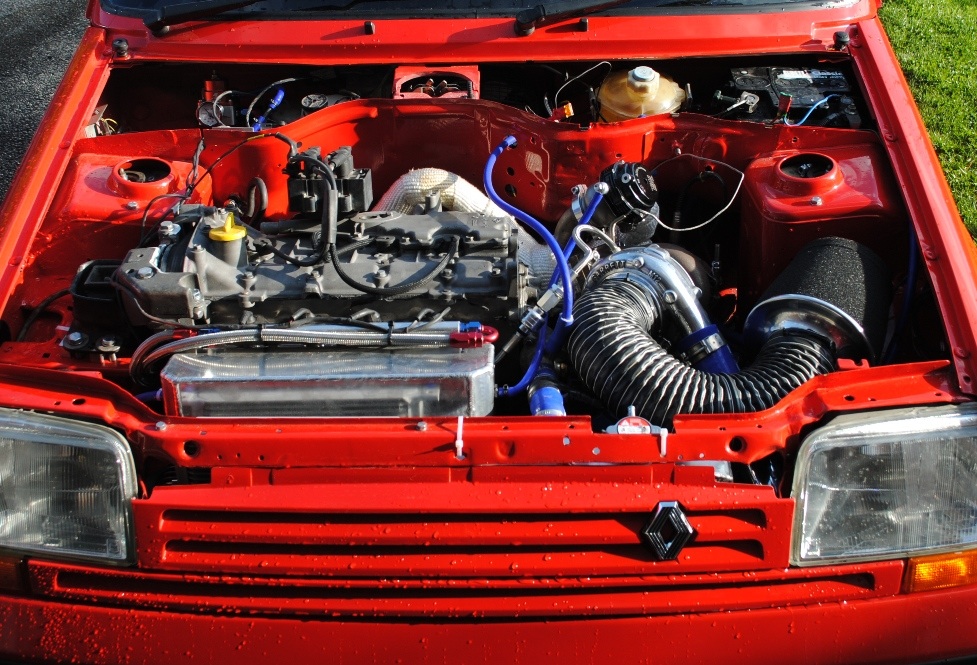

As BT lost all my pics when they shelved the free webspace I've uploaded a recent engine bay shot...

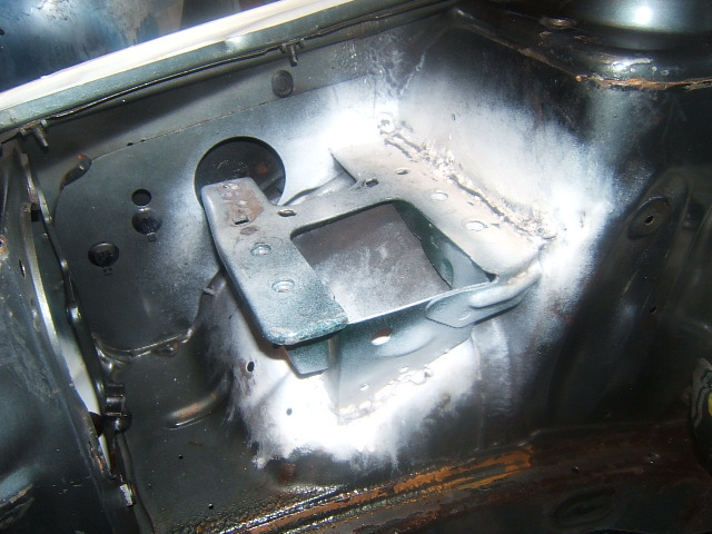

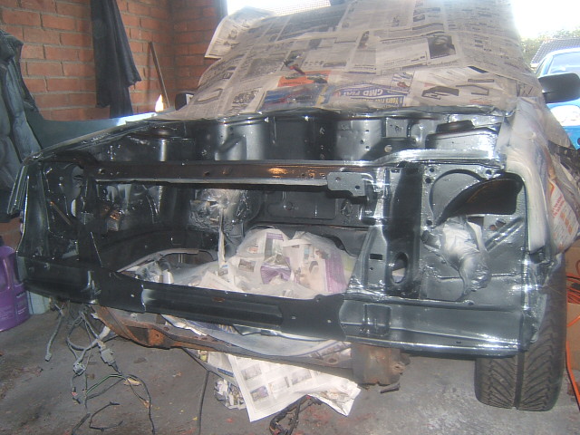

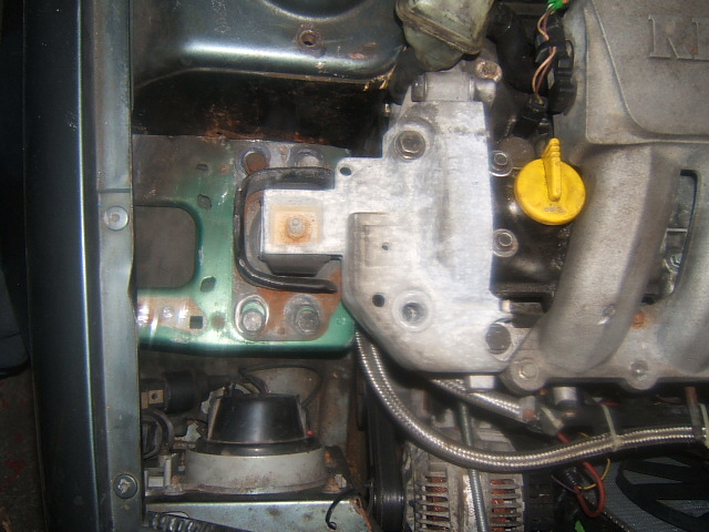

One of the problems with the NA engine was movement, it rocked about too much on the gtt mounts, so I had to brace it with a bit of a pikey stabiliser bar onto the strut top.... So once the engine was removed for the turbo conversion I decided to weld in a clio top mount...

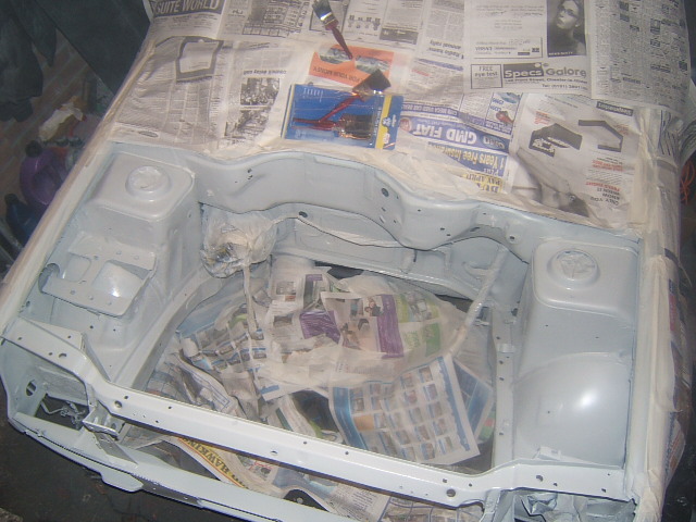

Here it is primed -

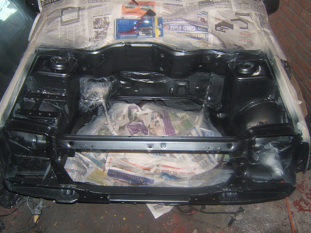

And painted -
Sorted, now to drop the engine in....:quiet:
the old bottom mounts fits perfect ????
