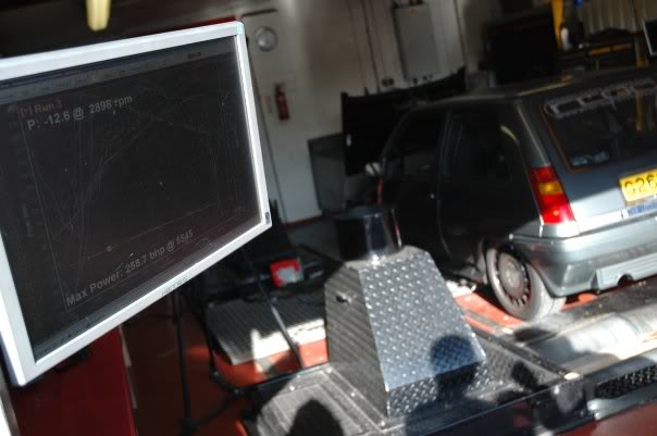

Just a quick update, the car drove 400 miles round trip, did 18 runs at Pod on the 29th (and the gearbox never faultered) with road tyres the best time was 13.8 @ 105mph.
Next stage is to whip the engine out this winter, bigger clutch, bigger injectors and a bit more boost. Should be interesting :D

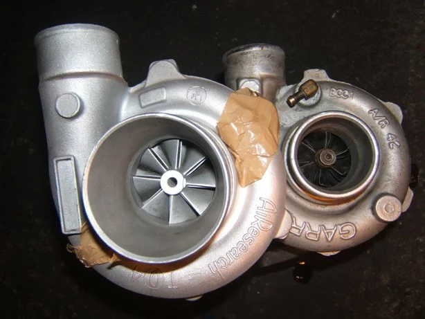

That turbo's on its limit really its only a small 50 trim T3. I've bought a 2wd cossie turbo which is the next step, could do with finding a 4wd comp wheel and cover too but they are like rocking horse poo.
Its all good fun tho :)
Managed to get a bigger wheel and cover for my 2wd turbo :D

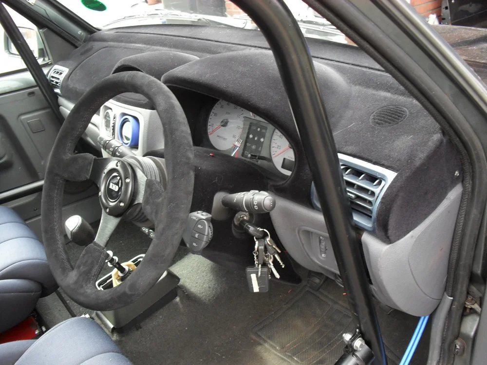

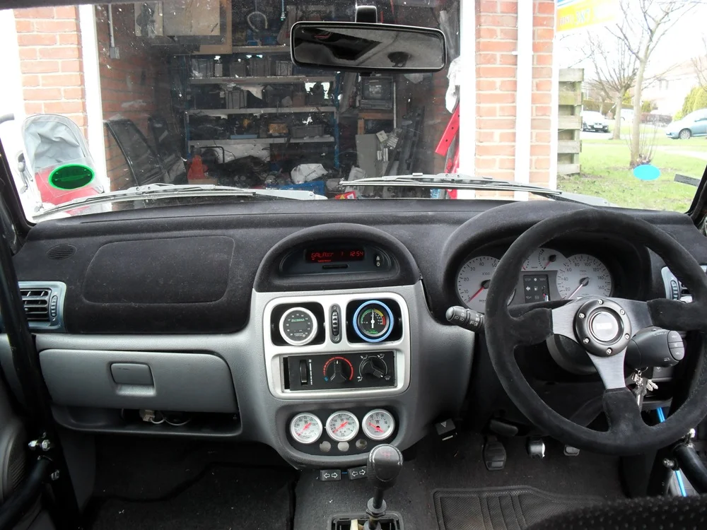

Finaly got round to modifying my dash (had to cut 1" off each end) the new flocking made the steering wheel look old and tatty so it was replaced. Love the new look now feels much more modern.

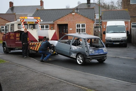

Long time no update... But to be brief...
Put it all back together with the bigger turbo but my clutch wasn't able to hold anything more than 12psi of boost. So took it down to Pod in May last year and broke the bottom end. Spun a shell and welded it to the crank....

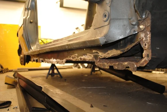

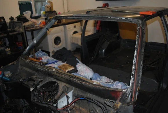

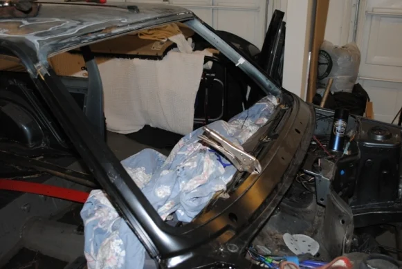

So whilst I re-built the engine I thought I'd also do some body work. The shell was rusty (rotten in places) so out came the grinder and welder.

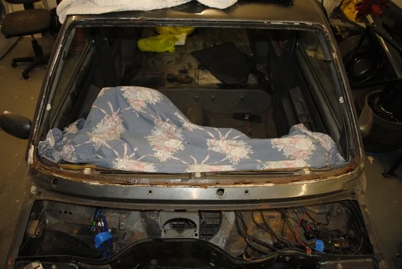

First job was to repace the windscreen surround.
As you can see it was fairly useless.
So I chopped it out and welded a new one in place.

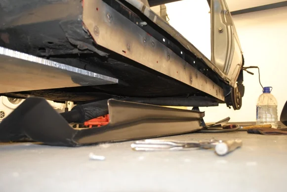

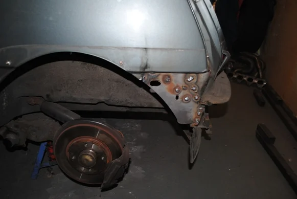

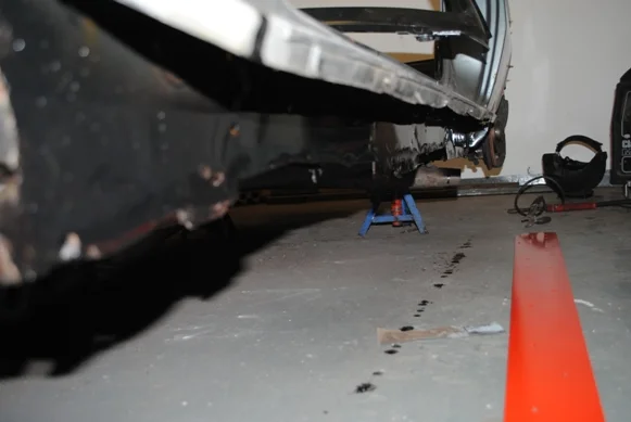

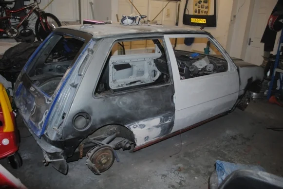

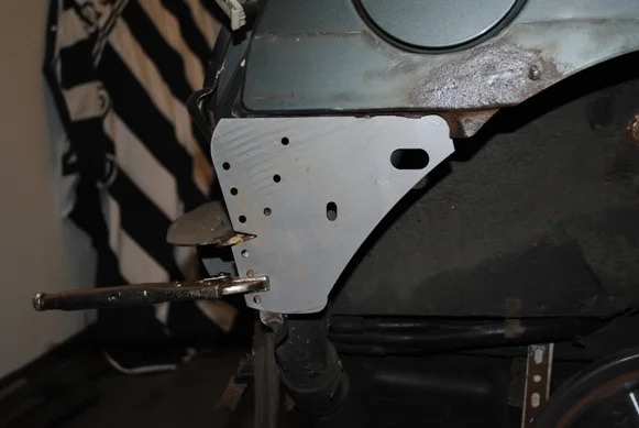

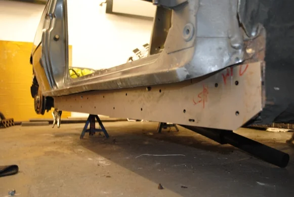

Next Job was Sills and rear Bumper mounts, I measured them up and got some new ones laser cut....
Job done...

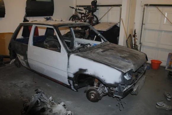

Now onto prep and paint for the full shell.
Then off to the body shop...

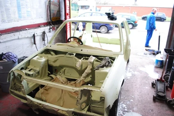

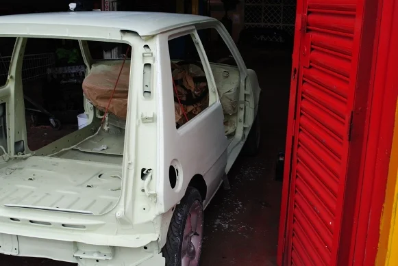

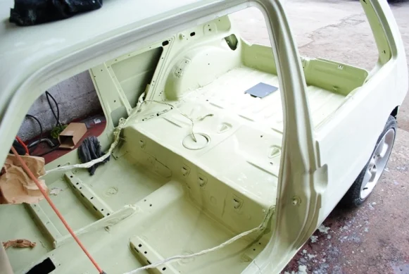

Shell in Primer...

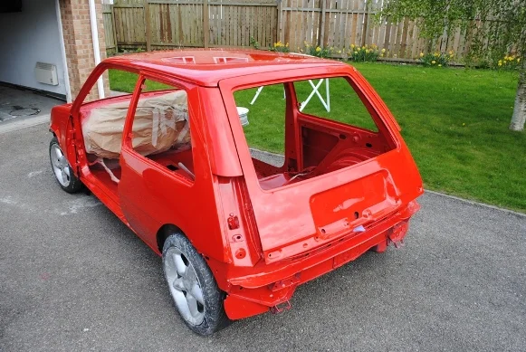

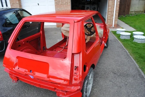

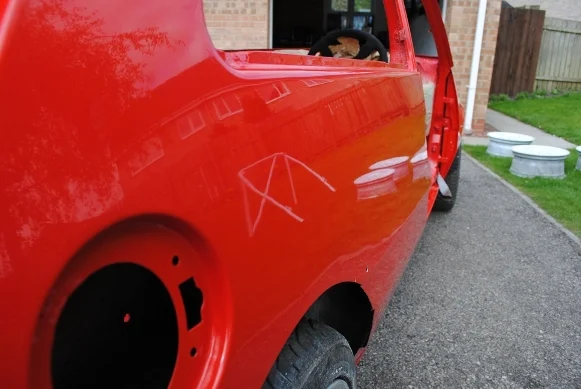

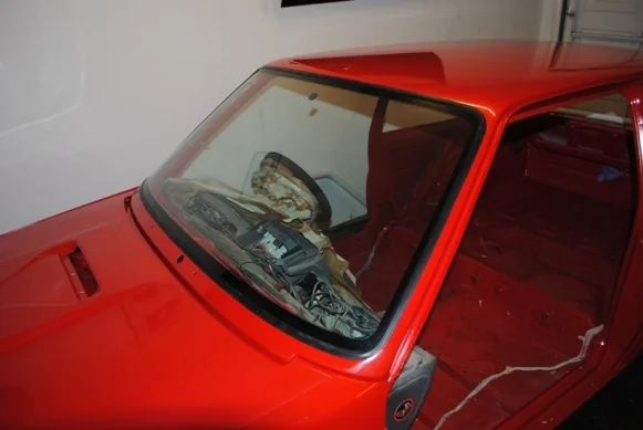

Got the shell back from the paint shop last weekend lookin lovely :)

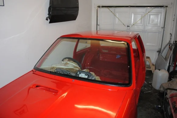

And then had the chap from A1 windscreens in today to fit a nice new shiney windscreen.
So thats the last years work in 1 post... Still plenty to do but its gathering pace so hopefully be up and running again this year?!?
