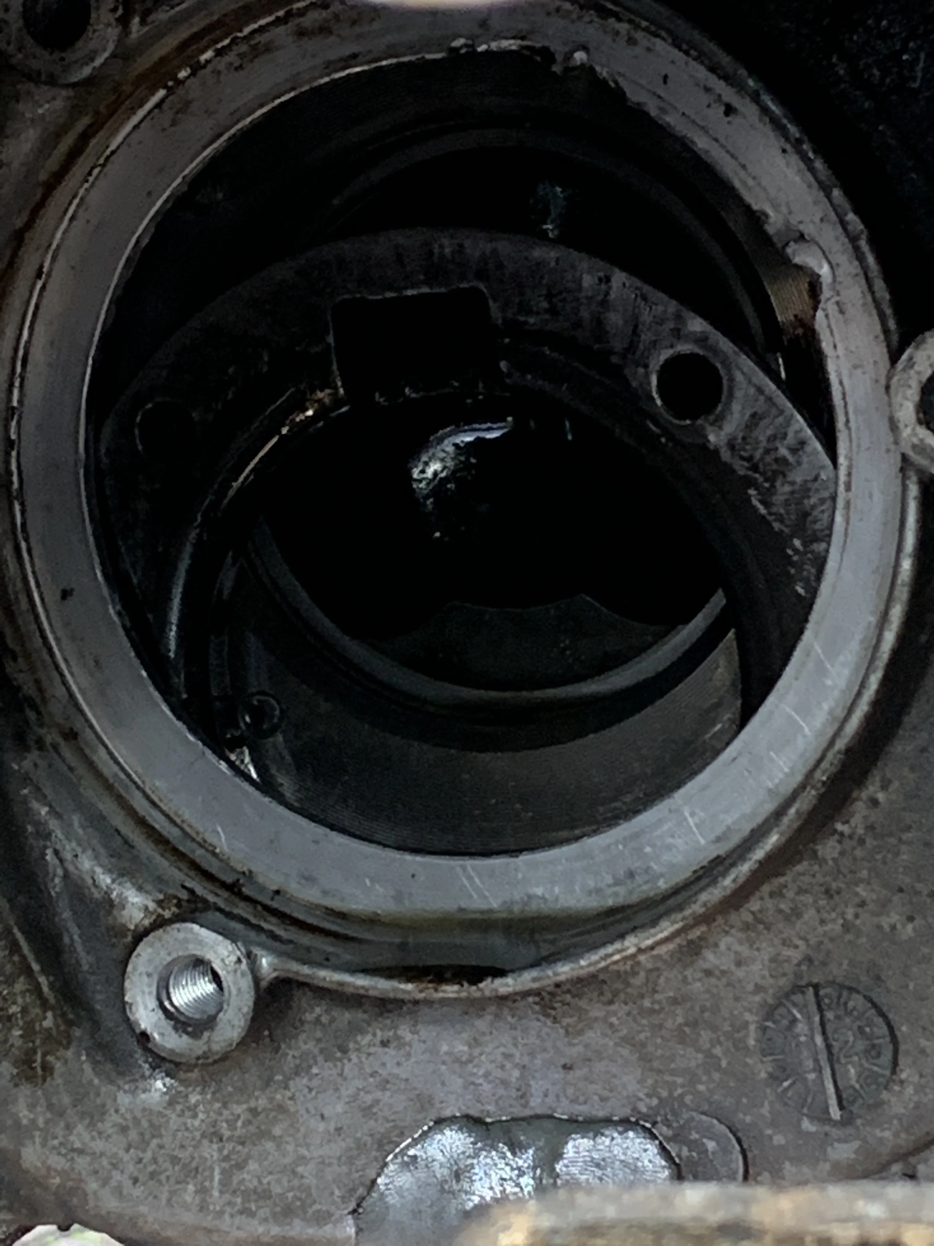

Bit of confirmation required.
Lost drive, and presumed it was a driveshaft.
Pulled the NS one as there was a noise from that side.

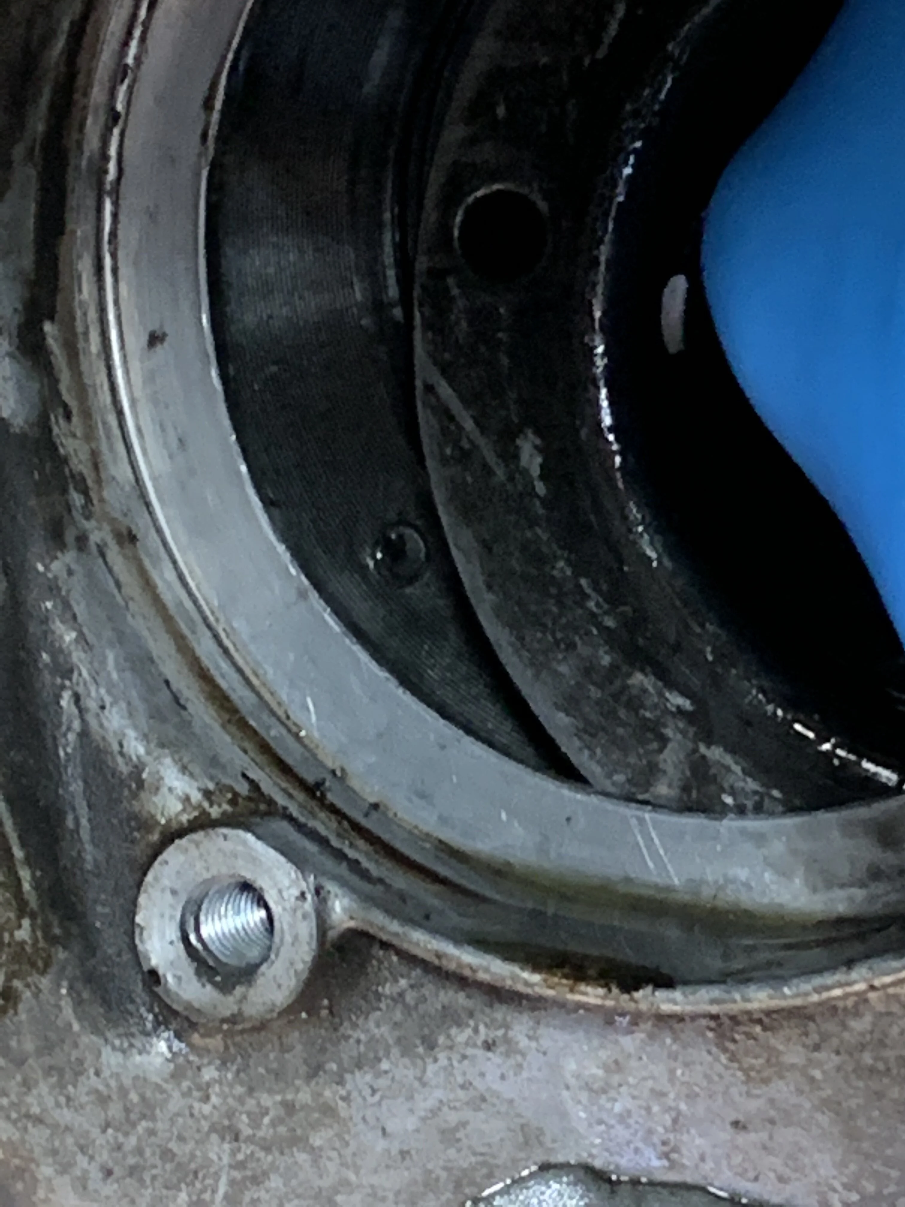

On inspection the driveshaft looks ok, but there’s a loose plate rattling around.
Looking at some other threads it looks to me like a Renfort type plate.
But like looks like the bolts sheared off.
I guess I should be able to drill out the bolts and replace with new bolts (no idea what spec / size).
Does that sound plausible??
Any opinions gratefully received.

I see, many thanks for the guidance.
Where does the rectangular locator go? 12 noon, 3, 6, 9 o’clock?
Any thoughts on the bolt sizes?
