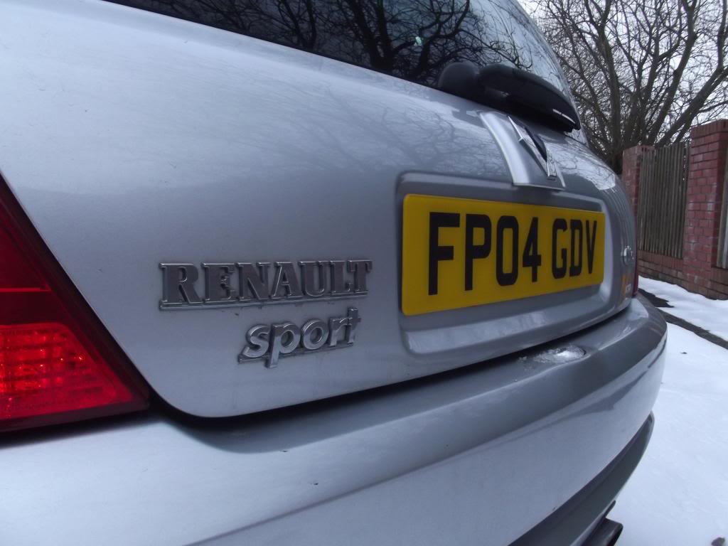

Also forgot to mention , I've bought some new vinyl carbon wrap to do the front and rear badges properly unlike they are at the moment ! They look awful !! Lol so that's a job for soon , and I've also received a letter from R-uk about this bonnet recall things that's everyone has been having ! Luckily for me , renault is next door to my work :D lol so it'll get dropped of this week and keep it updated :)

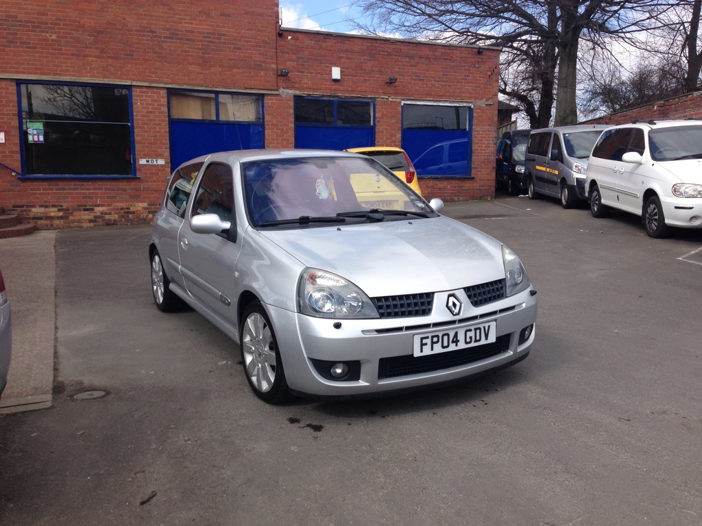

Again another quick update no photos this time , took the car to renault today after booking in for the bonnet hinge recall check , dropped it off and got a phone call , it's had to have a new catch , (don't know if they all did or not ?) so happy days renault replacing stuff for free !! :)
even got a courtesy mini valet for my hassles ! And even better I didn't get a phone call to say they had locked the keys in with the alarm ! Lol was half expecting it even after explaining how to get in and out ! All good :)

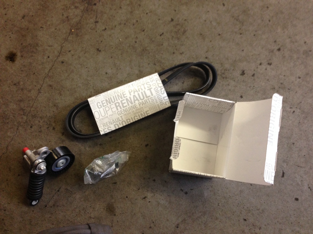

Another quick update ! After much stressing this week I've decided to buy a aux belt kit , the belt was replaced on the car cambelt time but the last few days I keep seeing tensioners letting go and killing engines :S they said my tensioner was fine but I'm not one to skimp when it comes to that so it's on order for Friday !
Luckily I get staff discount at renault as well now so it's cheap ish ill get photos and exact price later on ! It's around £50-55 + the dreaded ! (Tensioner on its own was £130 odd apparently :S
May sell the old tensioner and belt as there's nothing wrong I just worry about these things !

New shiney bits have landed ! :) I've also got some carbon fiber vinyl wrap for the from and rear diamonds , not sure if it'll look any good but for £1.19 of fleebay I can always rip it off
need to fit them now , spoke to gaffer just need to bring it in now ! Also have a new joiner to the Clio club ! Lol my sister and her fella have ungraded from his C2 VTS to a 54 reg black gold 182 !
Clio fwiend lol
I haven't fitted my aux tensioner yet :( I need to get hold of the special tool that's needed for the tensioner ! Soon though !

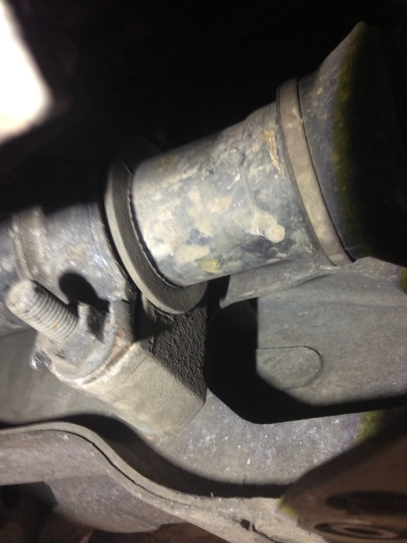

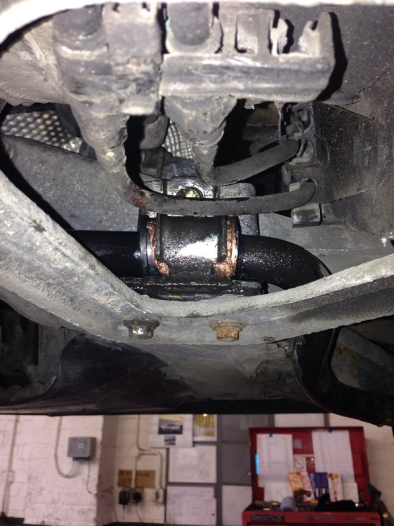

i went to fetch breakfast Sunday just gone and noticed a funny noise on the steering :/ so got the car up and had a look under Monday afternoon , I thought it was steering rack bushes but there's not a great deal of play although they look like they have moved a little :/ so ill be having a new set of these !
I rang renault and was told there's 4 different types of steering rack :/ and the TRW rack is the only one that's different , but because the bushes are less that £30 each they can't be sent back if they are wrong ! So in going to double check on the part numbers before ordering
But I believe the main course if the noise is actually the anti roll bar , its moved over to the left and is hitting on the subframe , again not a lot of play but if its moving about it needs sorting !

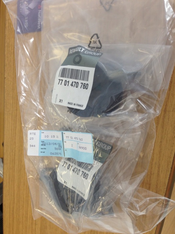

So on to renault , this time fairly straightforward , ordered all the ARB bushes both inner and outer , came to £28 for the lot ! Bargin !
They are going on Saturday :)

I have bought a carbon vinyl wrap for my front and rear diamonds , but then decided against it , so I've got a a4 piece of carbon wrap for something I'm not quite sure off yet !

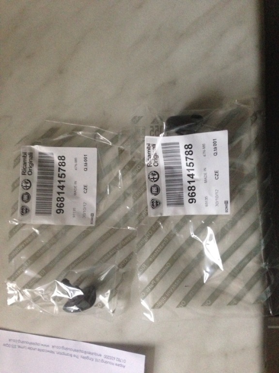

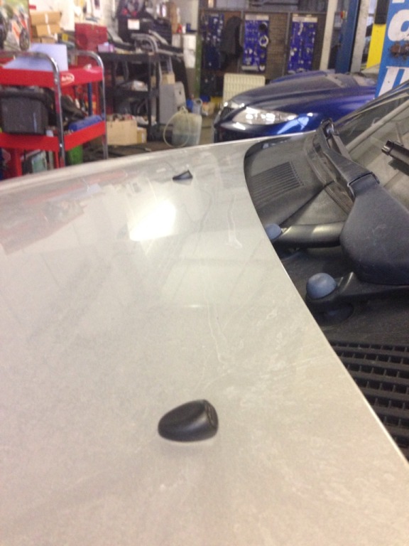

Today my new ''mist type" washer jets have landed and unlike me I decided to go and do it on the road lol !
They work a treat , and ill get a photo of them on ! I refilled the washers and tried them working okay although the filter to the pump could do with a clean, ill have a look see what they are like to get out :) I also bought 2 pairs of washer jets because I'm a muppet ! So might have a spare set for sale if anybodies interested ;) lol

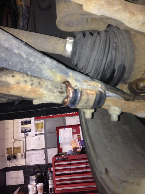

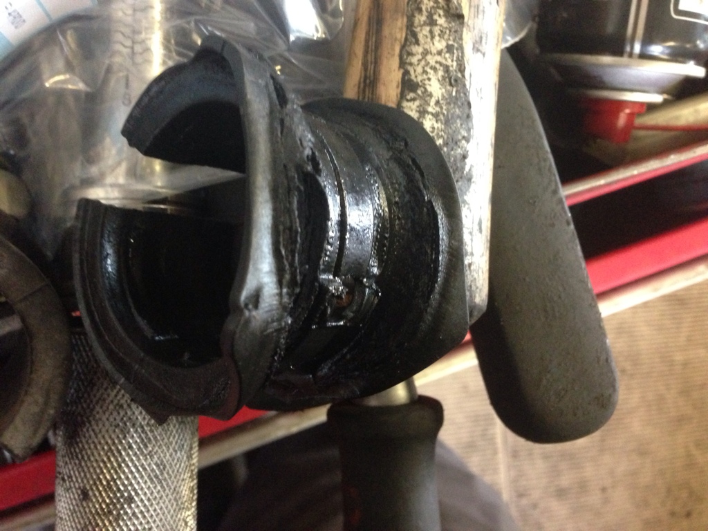

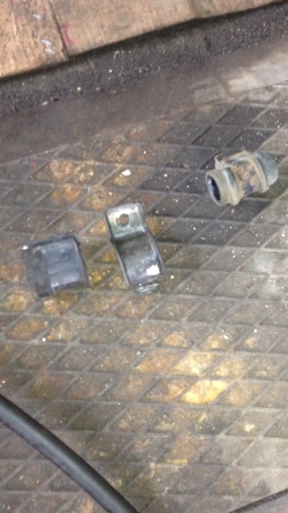

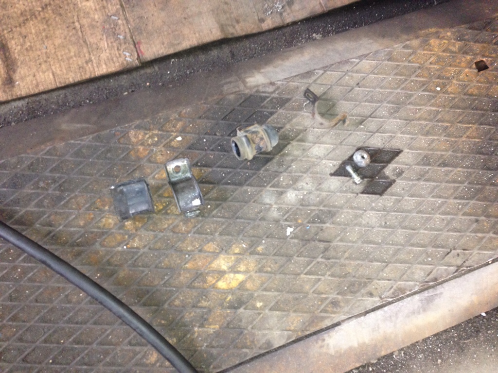

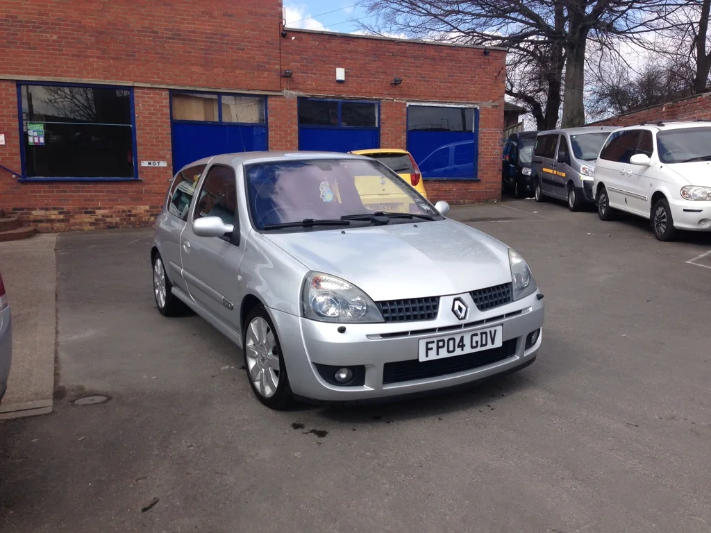

An update on the titty with pictures!

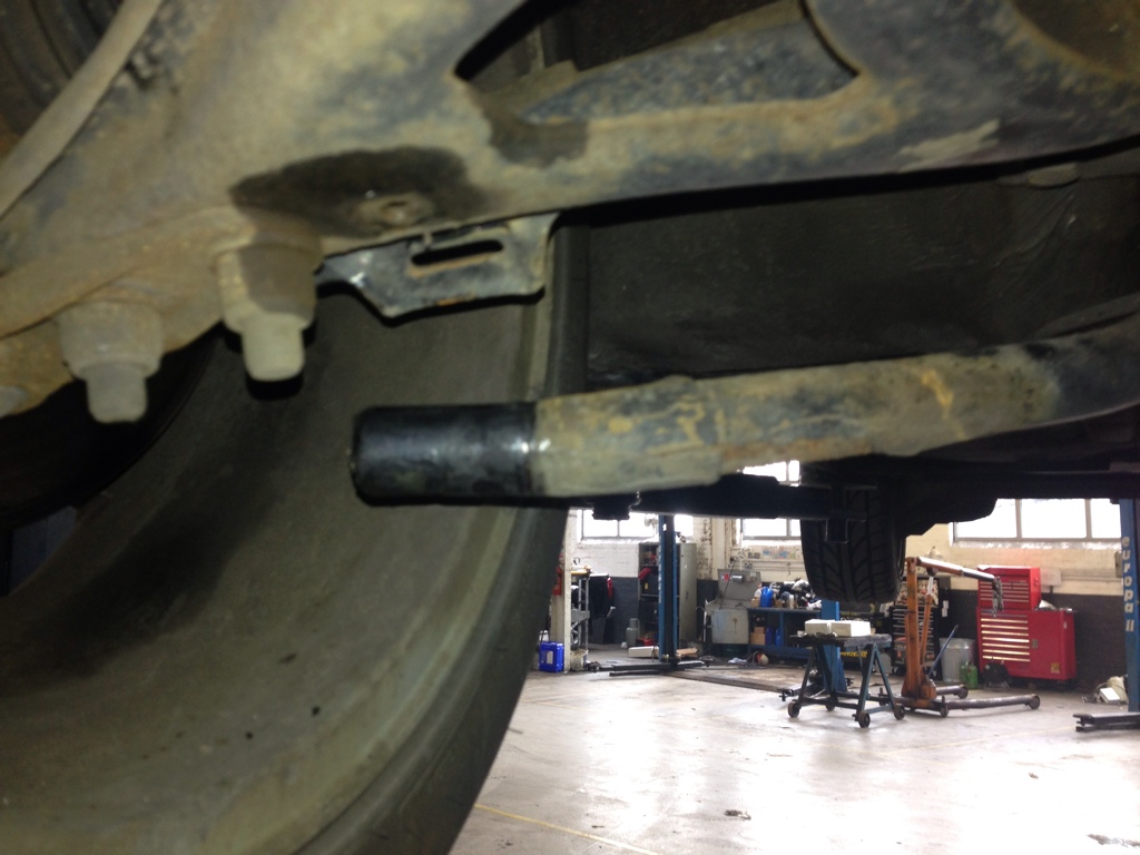

Well with it being Good Friday , work was quiet and my boss being the top bloke he is said bring it in ! Don't have tell me twice haha !

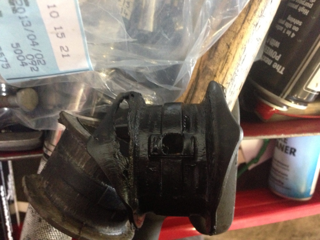

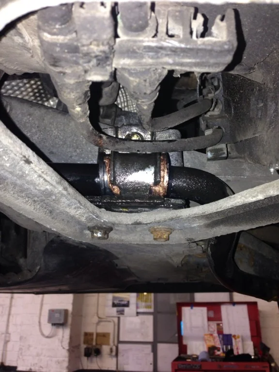

Thought , ahh anti roll bar bushes in the back of the car ill throw them on how hard can it be , it's only 4 bolts ! I've NEVER been so wrong in my entire mechanically life !
Any person who has the mis-fortune of ever doing them will vouch for just how much of a fist clenching rage of a job ! They just DONT fit !
I'd opted for the genuine renault ones, glad I didn't go for poly bushes ! I didn't drop the subframe as I tried doing without and after much levering, pinching and p1ssing in the wind they were out and in !
What a pig of a job ! Wouldn't wish it on my worst enemy lol ! But they are on and as you can see from some of the photos they were more than due !
Many strange knocking noise has gone for now :) so see how it gets on! You can also feel the difference when driving ! Maybe it's psychological but it feels tighter !
Also big thank you to Tony Hunter who told me how to find the rack ID , I have a SID rack or something similar , can't remember the exact , but as soon as I saw it was on the blower to renault , new rack bushes land Wednesday , so they will be on soon! ! £42 inc vat :D winner !

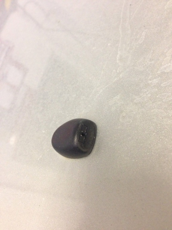

And last of all , new washer jets fitted , the 'mist' type
sorry about the crap photo quality it's iPhone at its best ! And again the car is FILTHY ! I'm ashamed but haven't had time clean her !

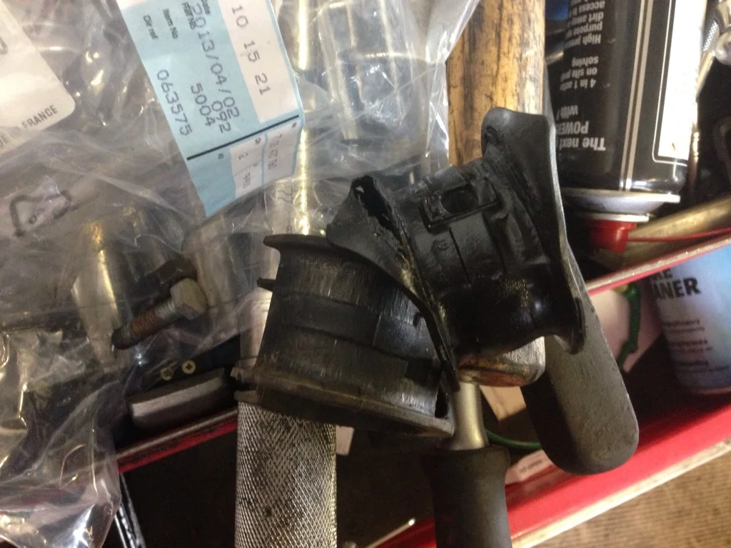

And a close up of the knackered ARB bush , you can see how it's been sitting all on one side !
thanks for looking any comments welcome :)

BLOODY WASHER JETS ARE LEAKING AGAIN :( thought it was the other day as the passenger side stopped working a little , thought nout of it ! Sure I saw a puddle when I pulled off the other day , but looked outside this morning ! ( first day in about 1 month it hasn't rained or snowed ) and there's a wet puddle under the passenger side washer jet :@ anybody know the warranty on fitted parts from renault?

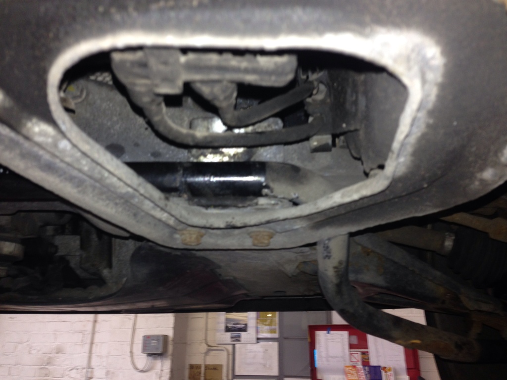

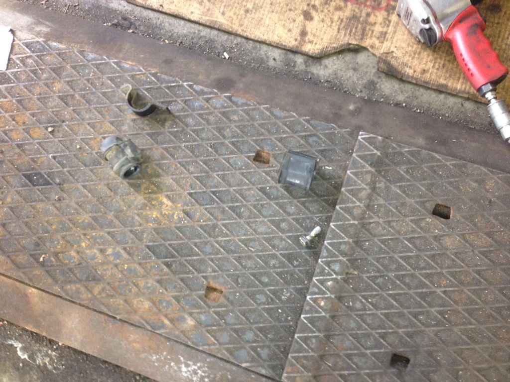

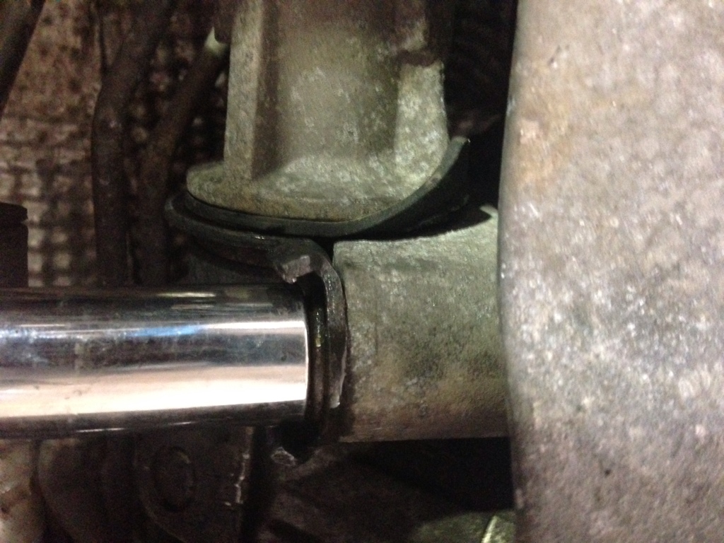

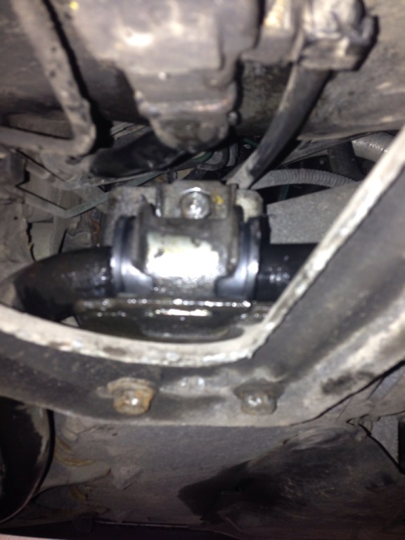

Hi people more work on the titty , the rack bushes needed doing so Saturday off translated to working again haha
I knew they weren't good , but I didn't realise just how knackered they were ! I knew the steering on the 182 felt different to my phase 2 172!
So after research on here and looking I got a idea of what was needed!
Looked a very straight forward job , 4 bolts holding the rack down ! Pahaha silly me !! Should have know better ! The two on the bottom located through the sub frame to the bottom of the bolts , and the two top ones hold power steering pipes down , then the two top bolts underneath them locate at the back but NOT through the frame :/ they hold the rack down but not in the same way :S what's wrong with two bolts eh? Lol
Well some photos of the old bushes ! They were completely fubar'd ! And on the drive back I can say it's defiantly tighten up the front end :D it's steers loads better ! Although I'm not completely sure the passenger side bush sat correctly ! But it's all tighten down looks fine , and it looks right place as the other is defiantly right postion and they look close! But I ran out of time so ill see how it goes !
Photos of the old bushes on the car and off
You can see where the rack has been moving a little bit for the clean shaft at the side !
Drivers Side bush - I thought it was supposed to be that shape ! Nope !
Bushes
Close ups
As you can tell they were about due !

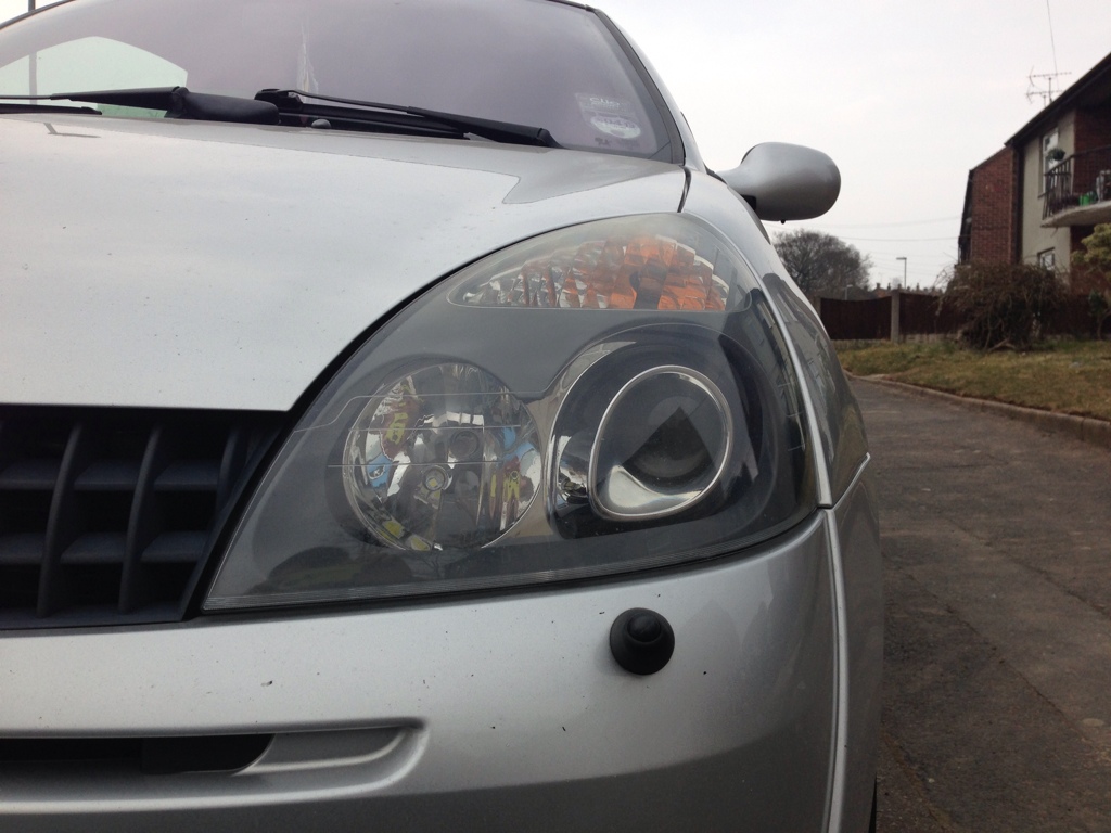

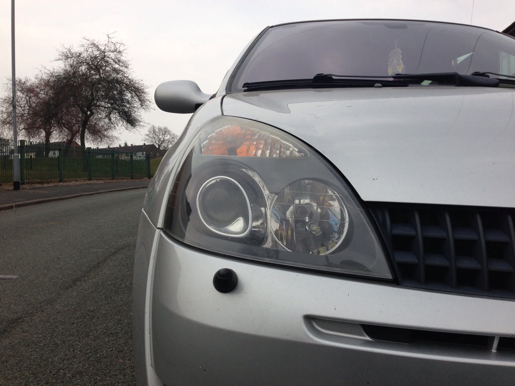

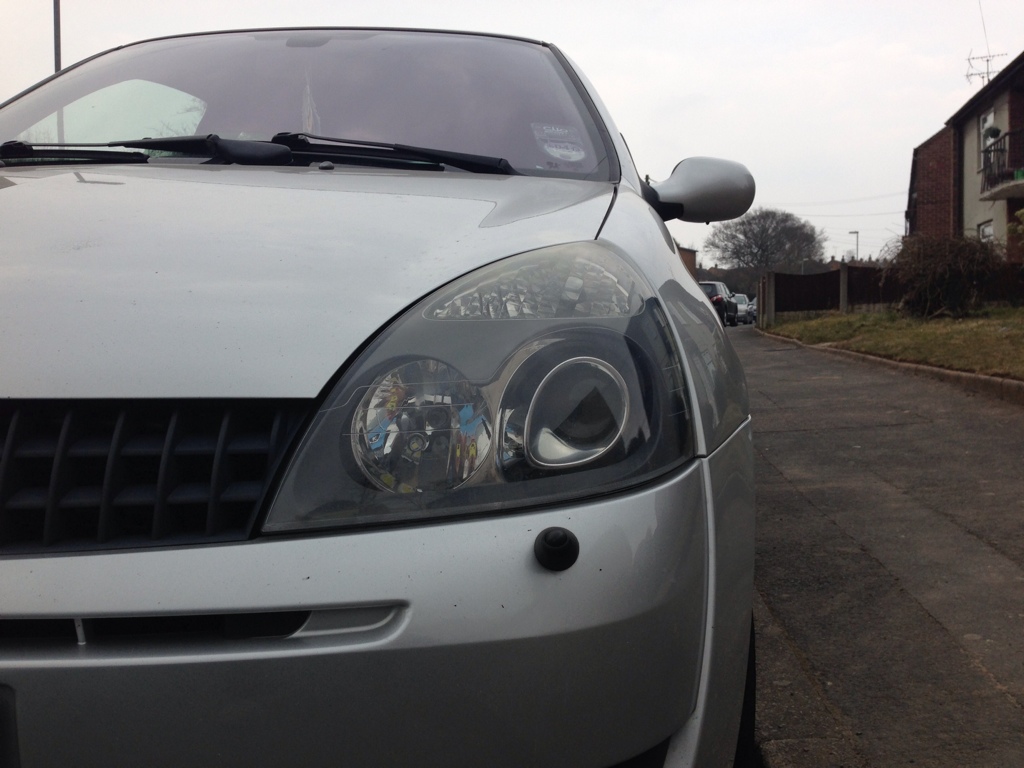

New bulbs have landed :) got them off ebay with the link :) £2.99 jobs a good un!
Got in from work and did it again straight out to the car ! Two second job !
Some photos
Before
And new fitted
I'm happy looks LOADS better in my opinion, going to order some for the rears !

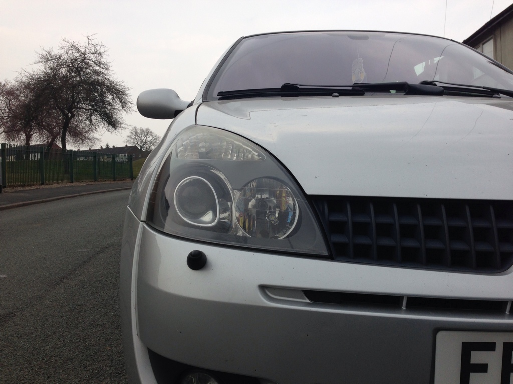

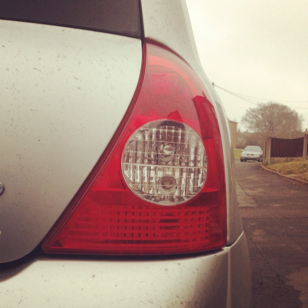

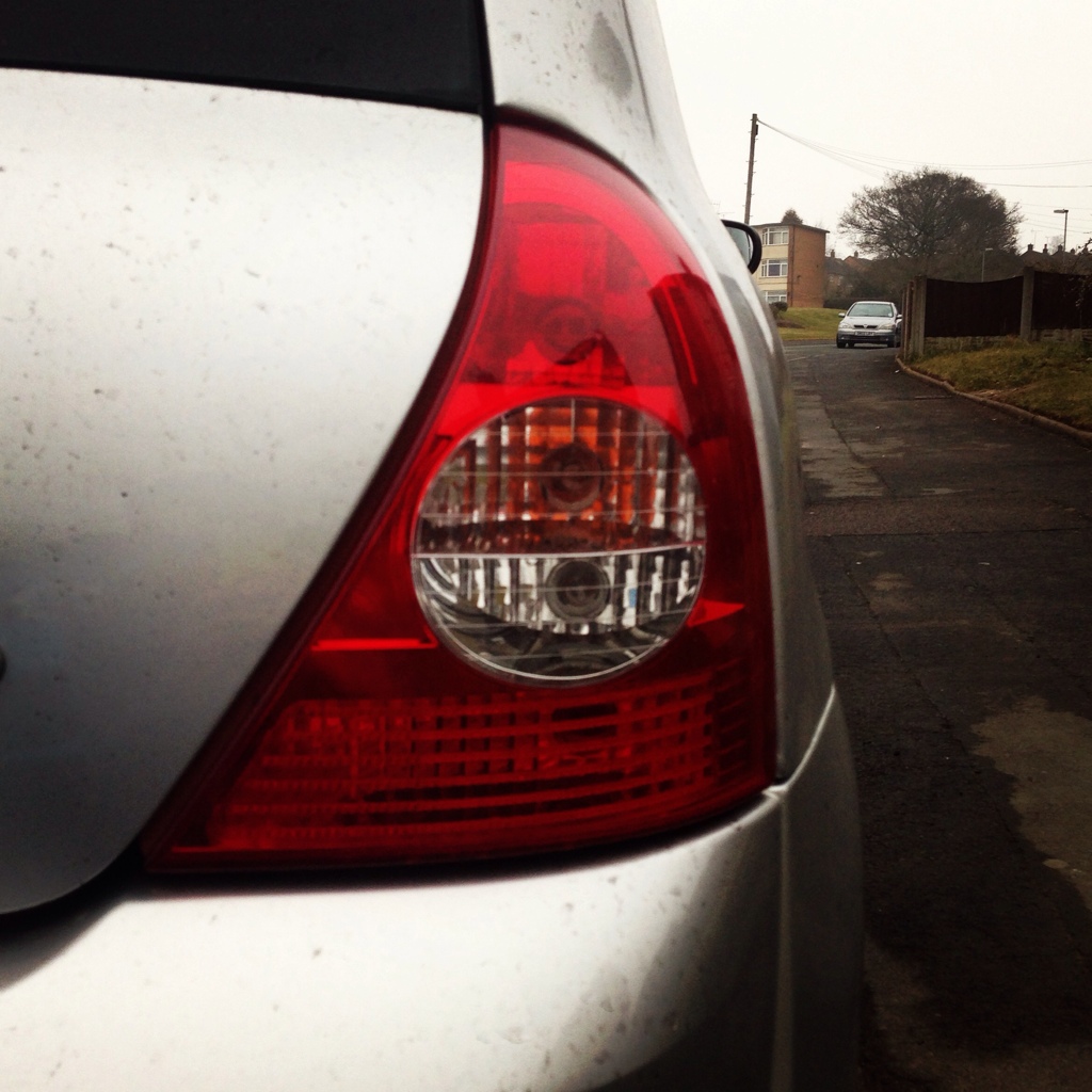

Rear bulbs have landed today , onces again out in the street , just as easy this time didn't bring any tools from work and i didnt need any lol first time i was greatful for Renaults sh*te build quality !
Before
After
Excuse the slightly wonky photo ! And the dirty car !!
