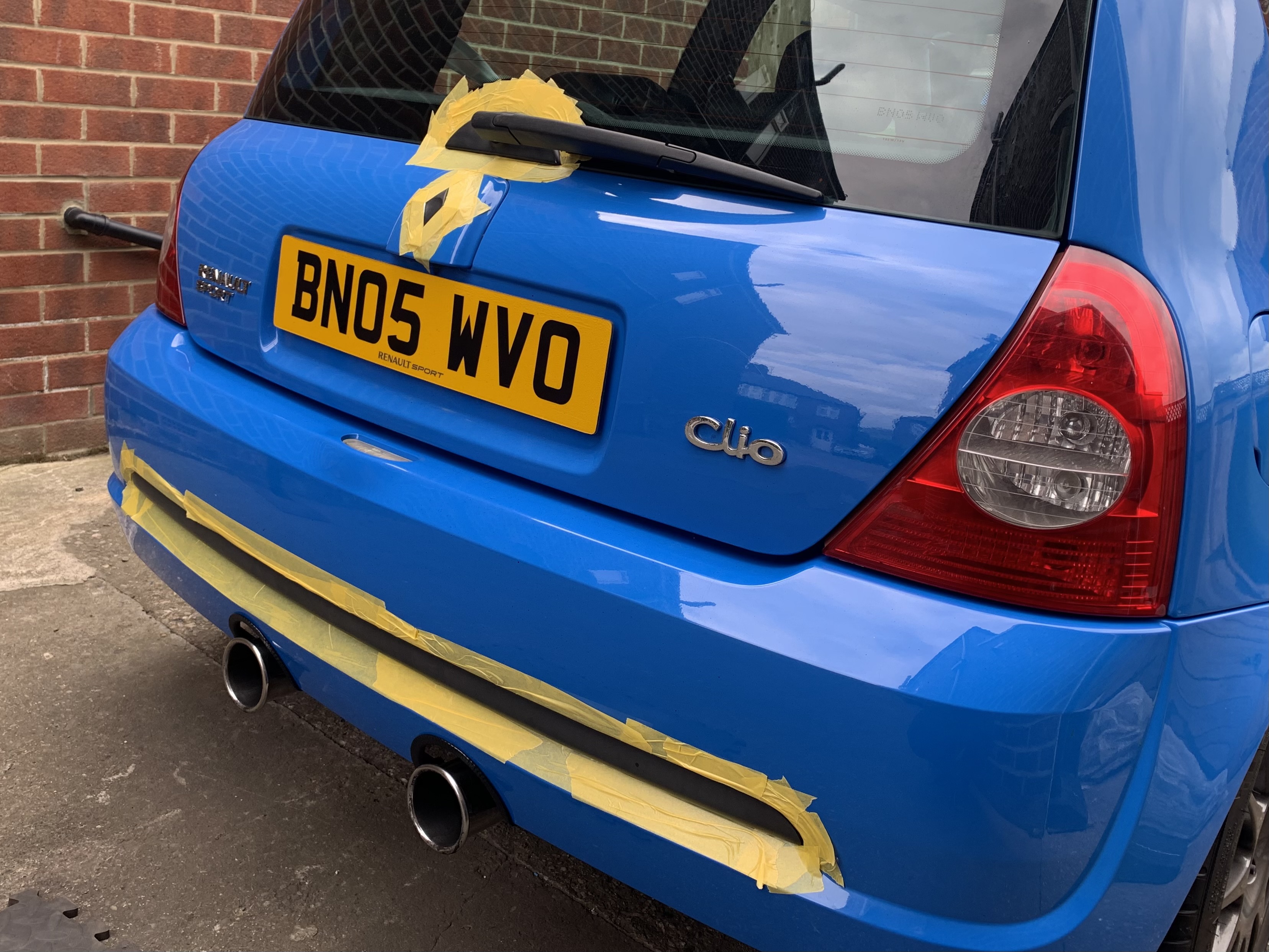

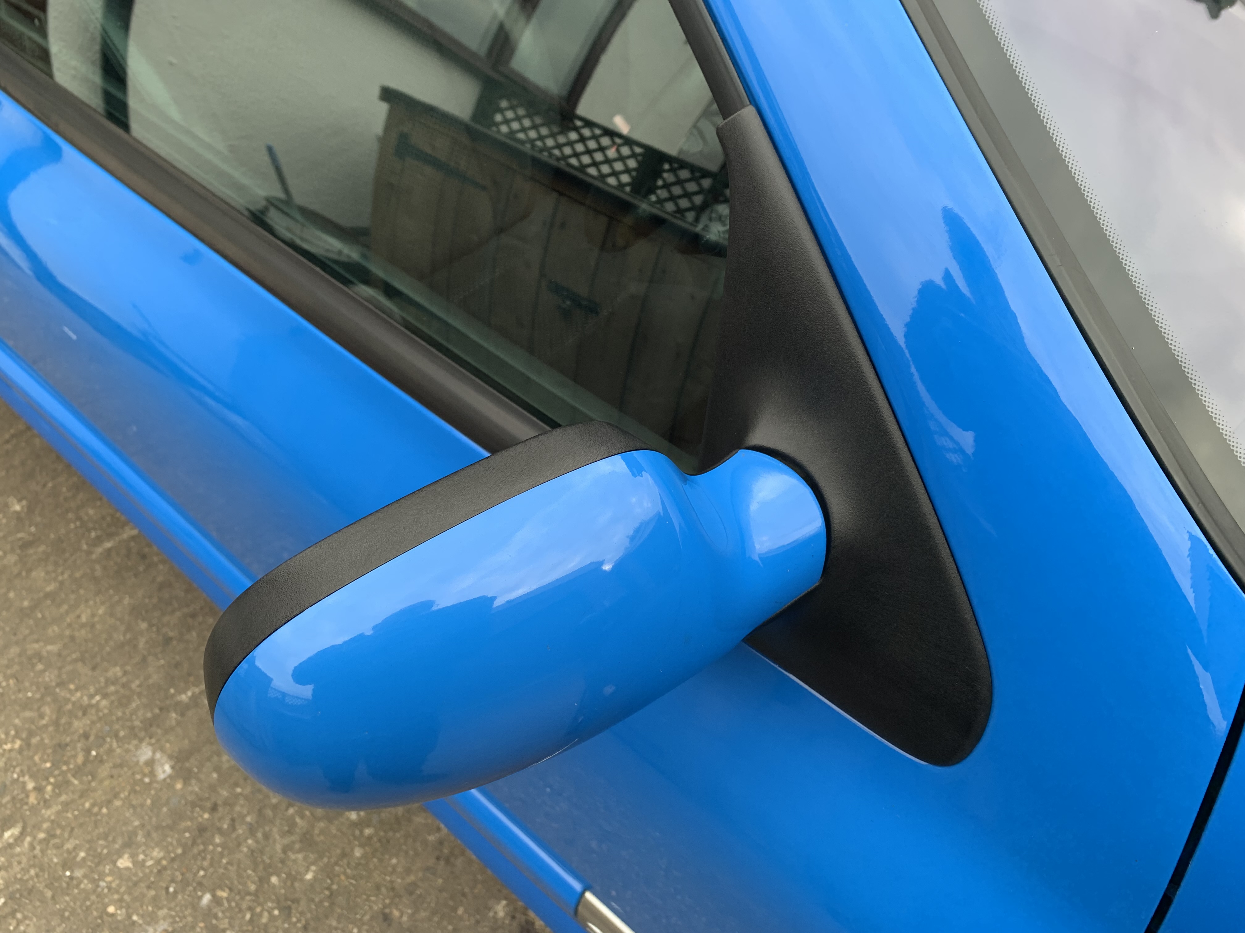

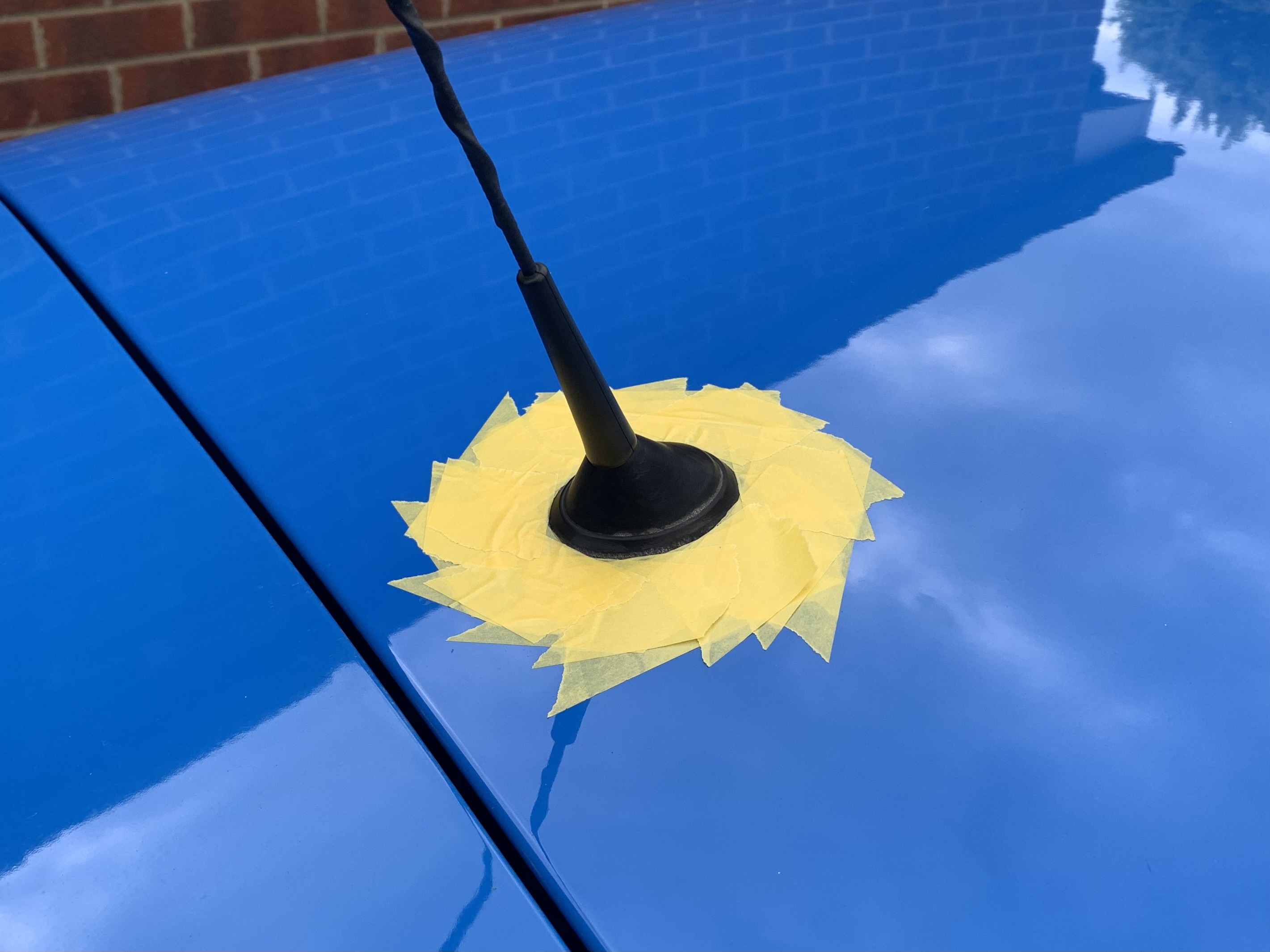

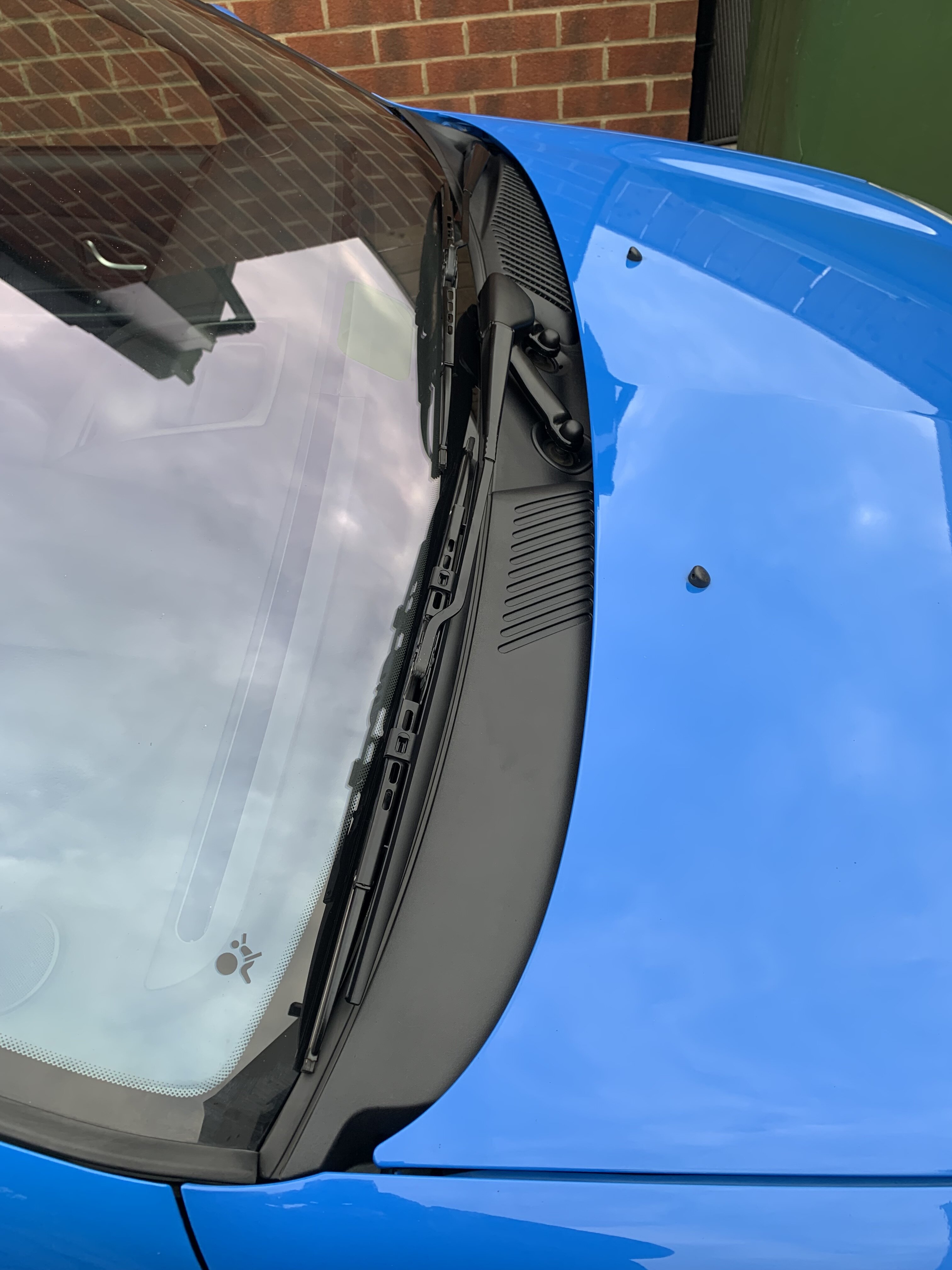

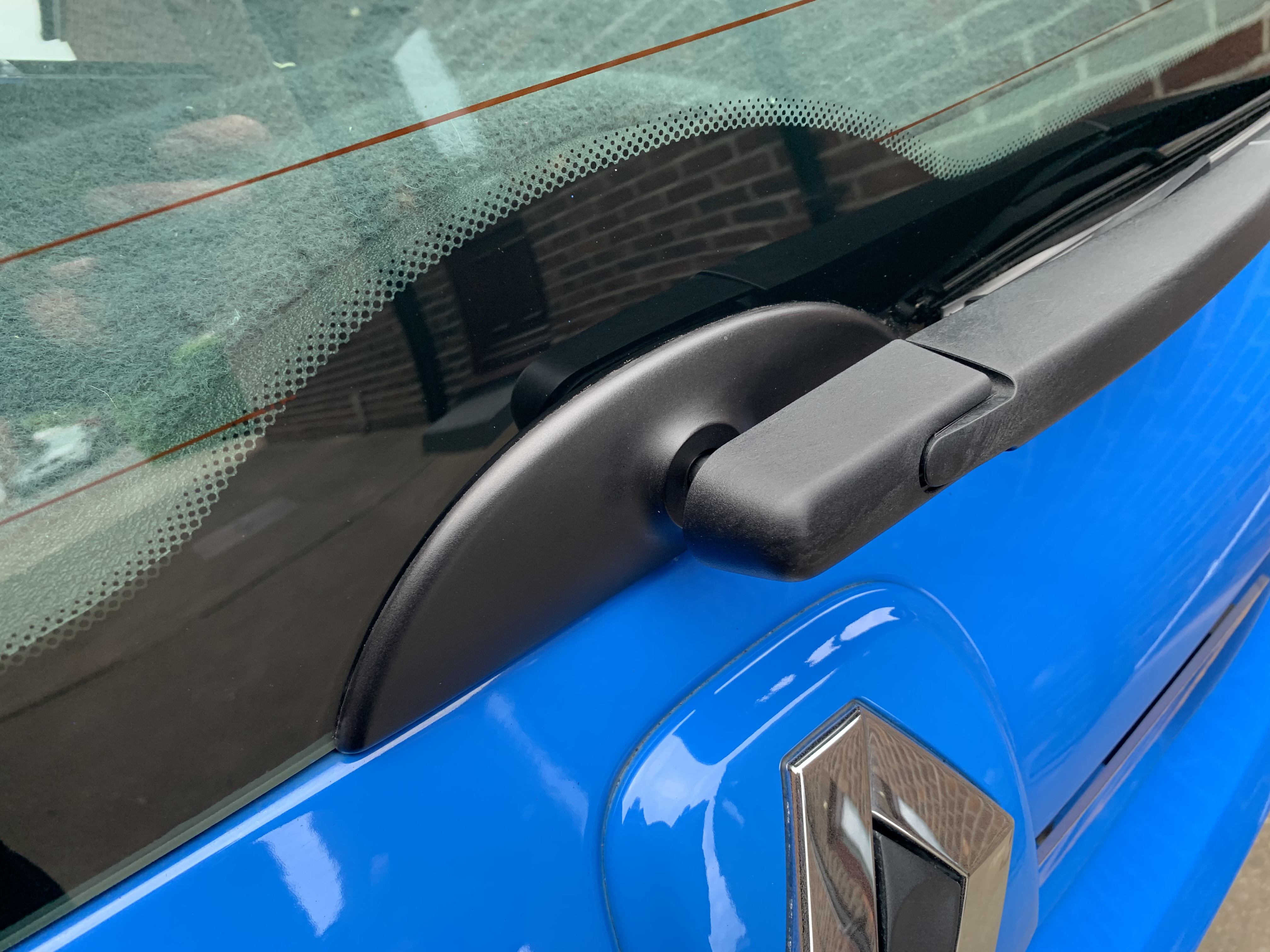

My last day off, so I thought I’d tackle the exterior black plastics.
I bought some C4 Permanent Trim Restorer after reading good reviews. While ACF-50 works well, its effects aren’t long-lasting.
For £22, I expected 5 litres, so I was a bit miffed when this arrived. 🤣 There’s one born every minute, I guess.
Being me, I decided to strip certain parts off the car and mask around the rest. Not sure if it’s necessary, but there you go. I gave all the plastics a good wipe-down with Bilt Hamber Surfex HD.

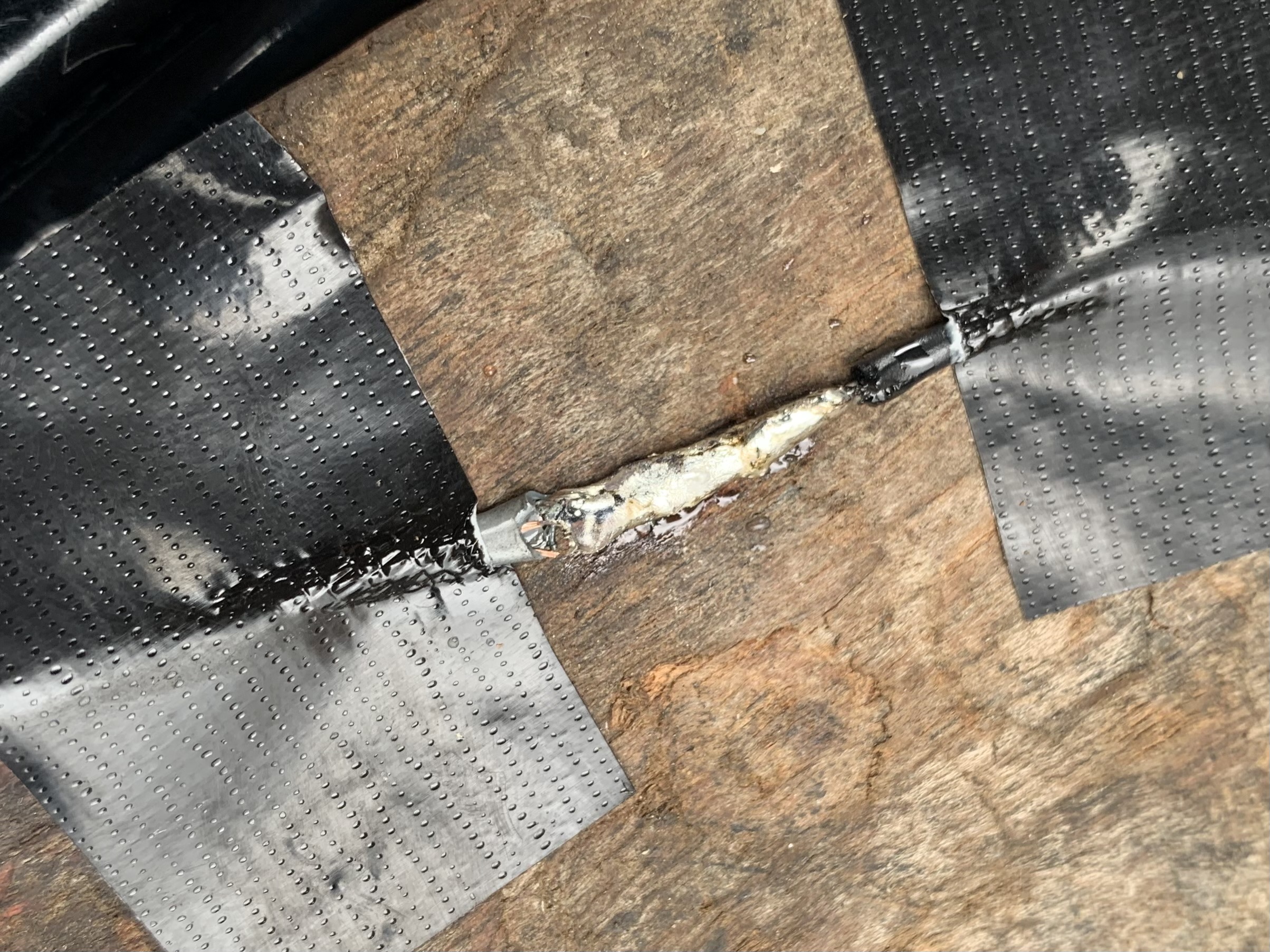

Before jumping in, I remembered I’d bought new connectors, particularly the two for the washer motors. While the scuttle panel was off, it seemed like a good time to replace them.
Continued….
The old connectors have a bit of corrosion, understandable giving their position next to a washer bottle.
The new ones.
I dug my old block of wood out to help me solder. As I’m on my own, I solder each wire and then tape them down to avoid movement.
It’s a while since I soldered, so it’s a bit chicken s**t, but solid.
I then finished them off with heat wraps and some conduit.
Job done.

It didn’t take long to apply, and I used nearly the entire bottle.
I wouldn’t say I was bowled over, as the results are similar to ACF-50. However, if it lasts as long as the reviews claim, it’ll save me a lot of hassle.
Just need to give the rest of the car a wax polish.

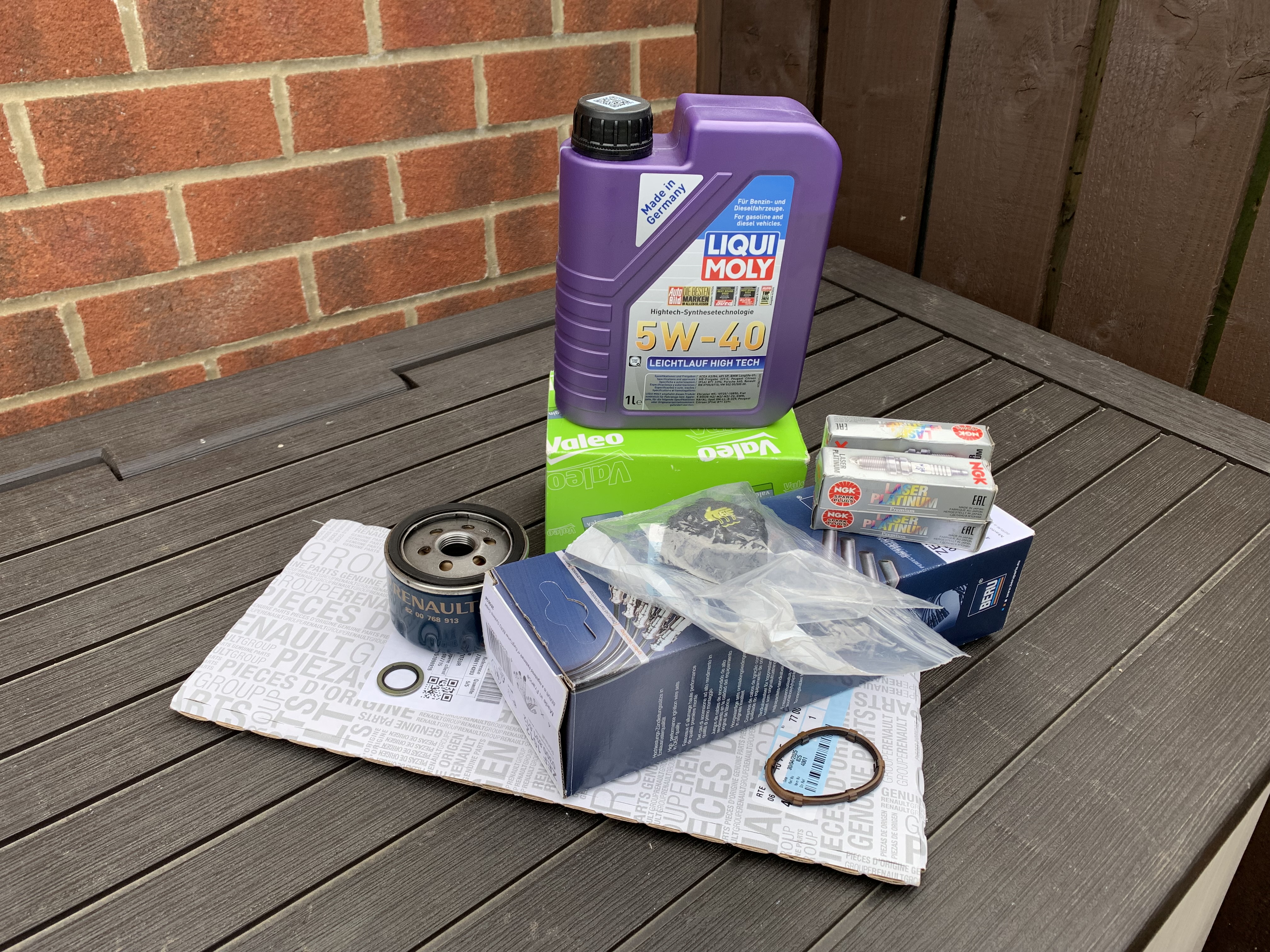

Biggish service on the car today.
I was going to get work to do it, but then I remember how they hate working on these old cars. So, I’ll just let them do an oil service when it’s due later in the year.

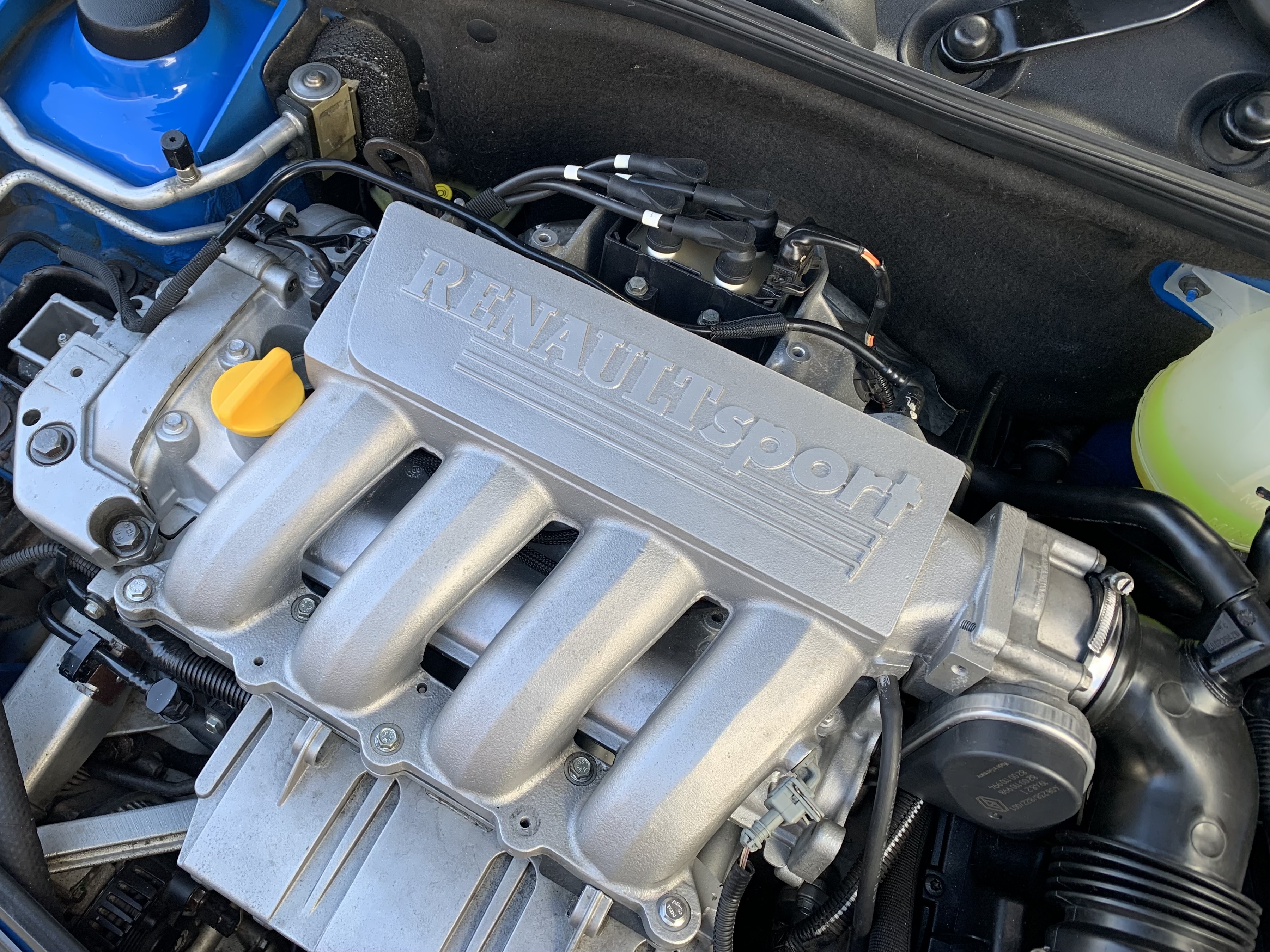

It’s been three years and 6,000 miles since the spark plugs were changed, so I figured I might as well replace those and the ignition coils and plug leads while the manifold is off.

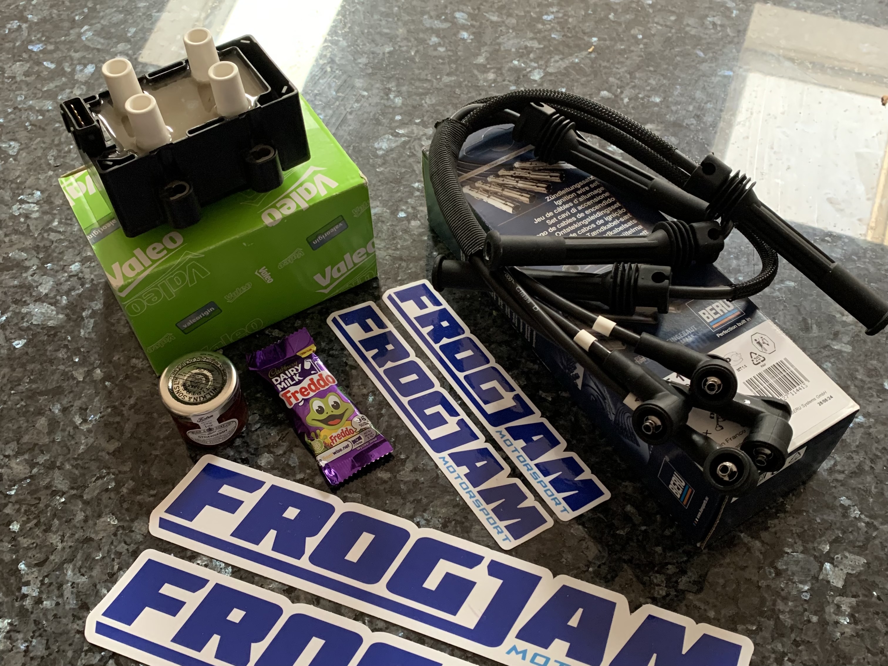

Reached out to @FrogJam Motorsport who sorted me with new ignition coils. Still loving the Freddo and pot of jam - nice touch!
I had some OEM oil filters and sump washers on hand, so I ordered oil to go with new upper manifold gaskets and NGK spark plugs, sourced directly - not Amazon.

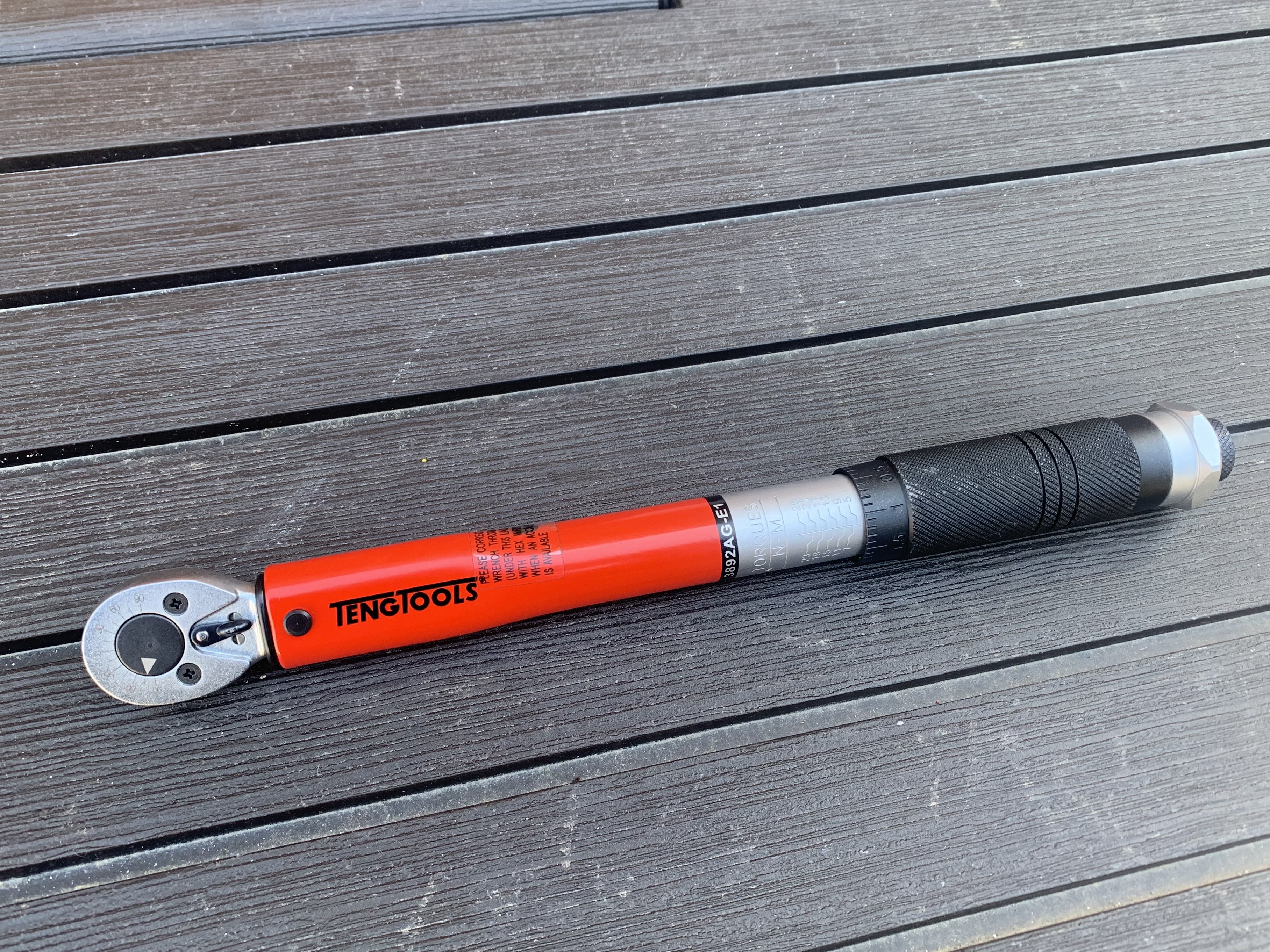

I’d also picked up a cheap 5Nm - 25Nm torque wrench a while back, perfect for these kind of jobs.

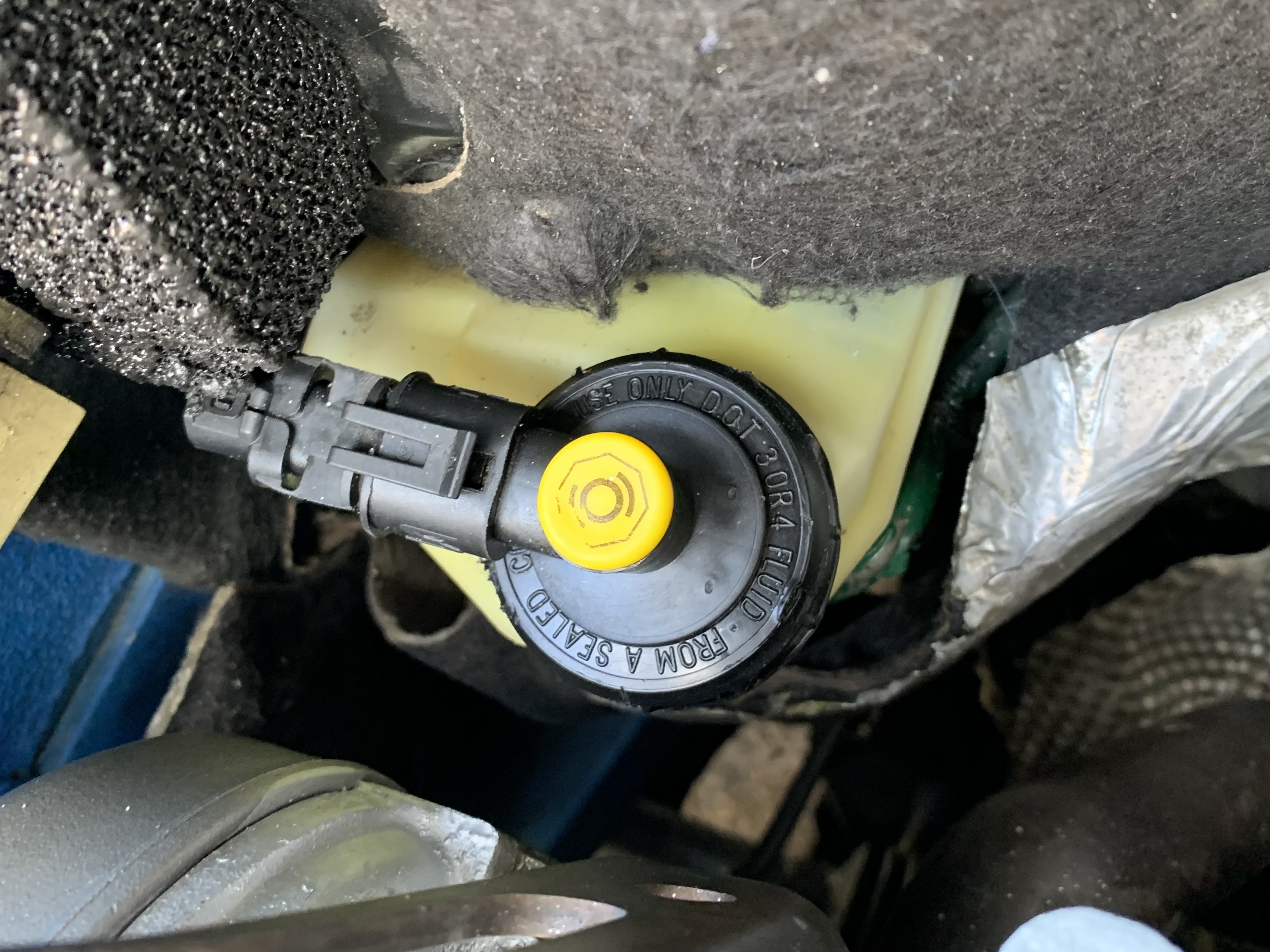

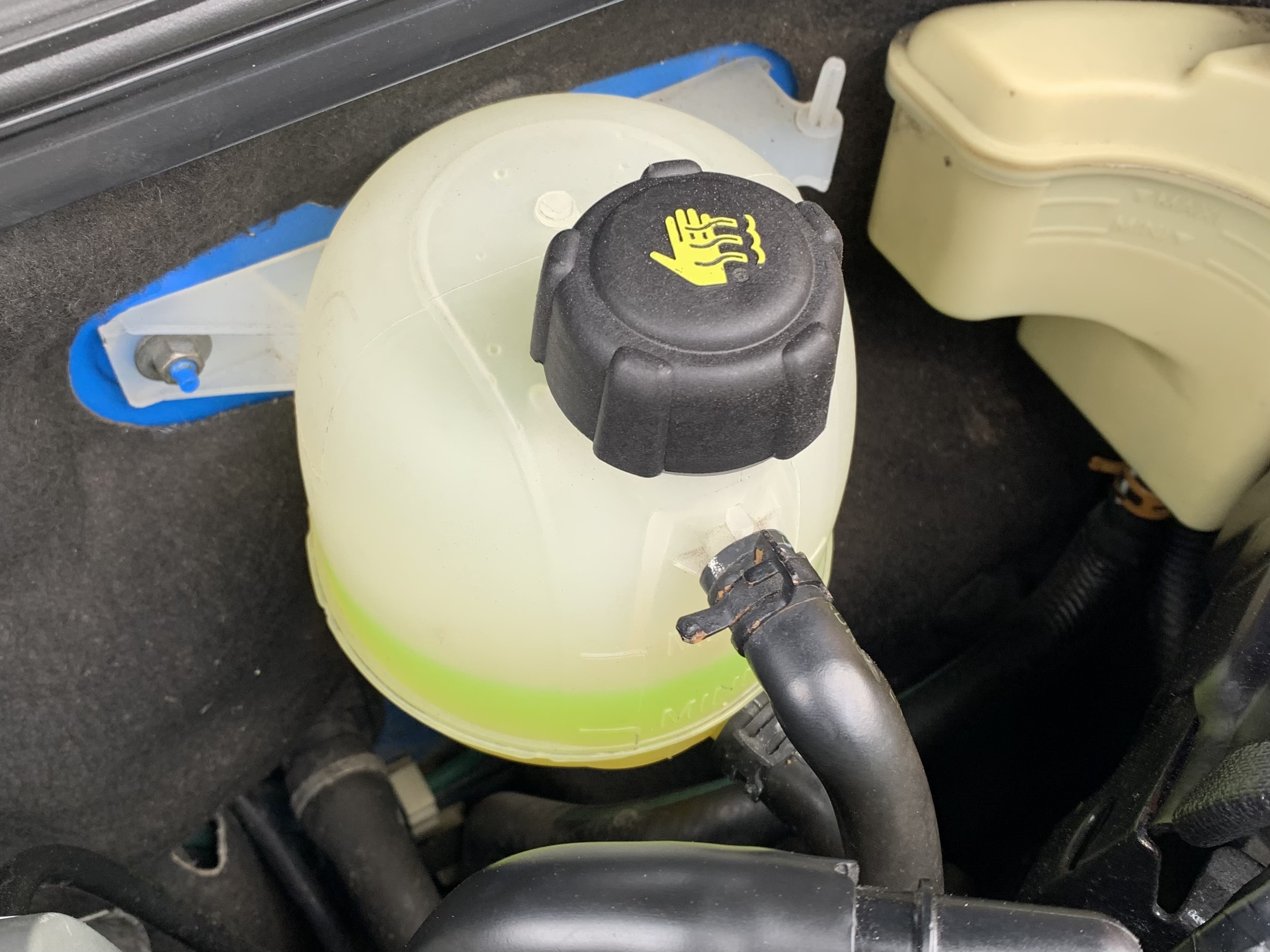

I also picked up a genuine Renault expansion tank cap, as the previous one was leaking. I bought that one from Renault too, but it’s never sealed properly.
Cap on.

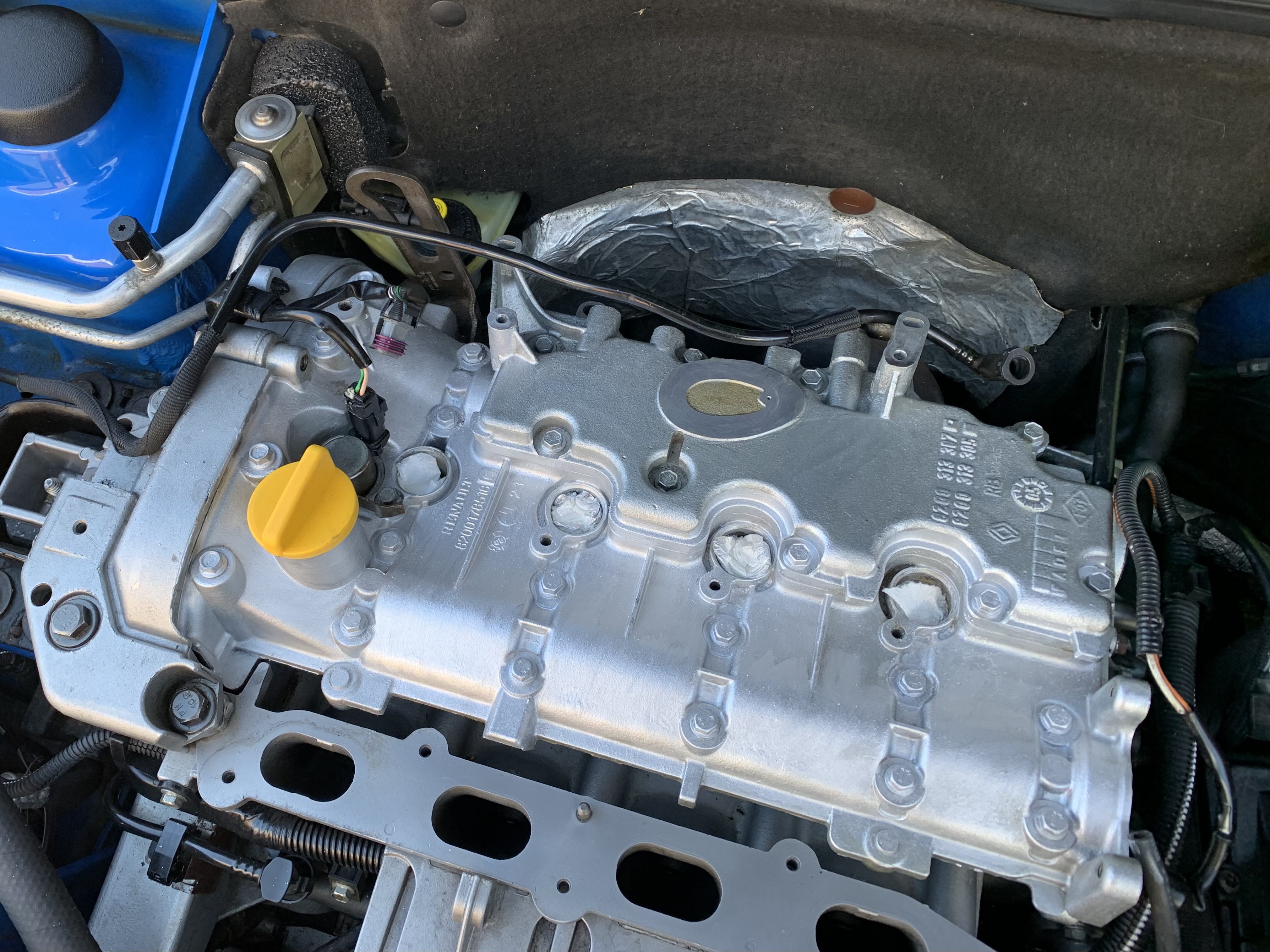

With that done, I took a close look at the back and top of the cylinder head, as well as the brake fluid reservoir. Some might recall my oil filler cap popping off and oil spilling everywhere.
I was expecting plenty of grime and dirt, but was surprised to find it relatively clean. I gave it a degrease and a coat of silver VHT paint to keep everything looking tidy.

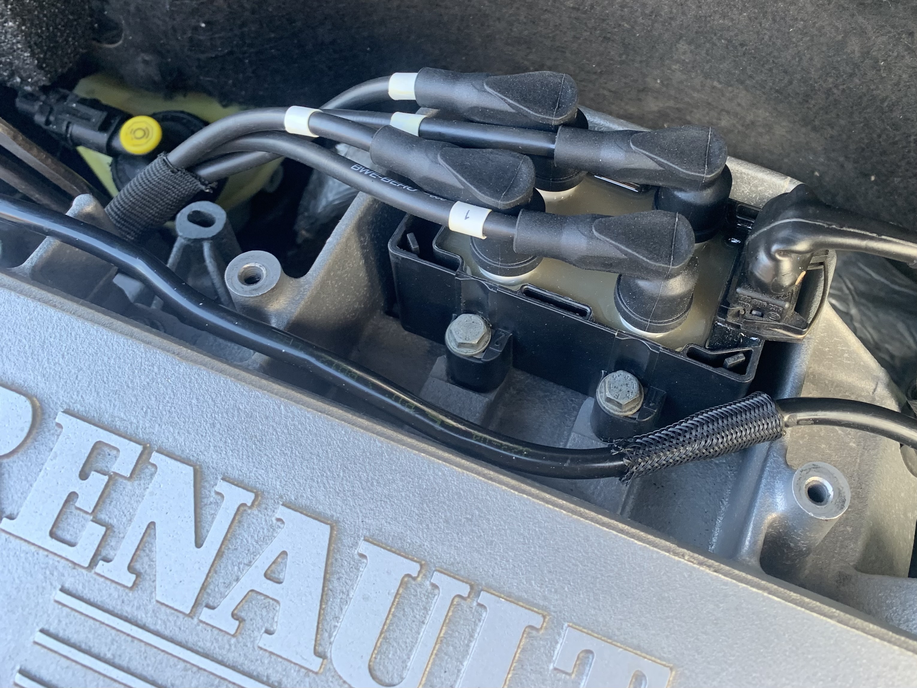

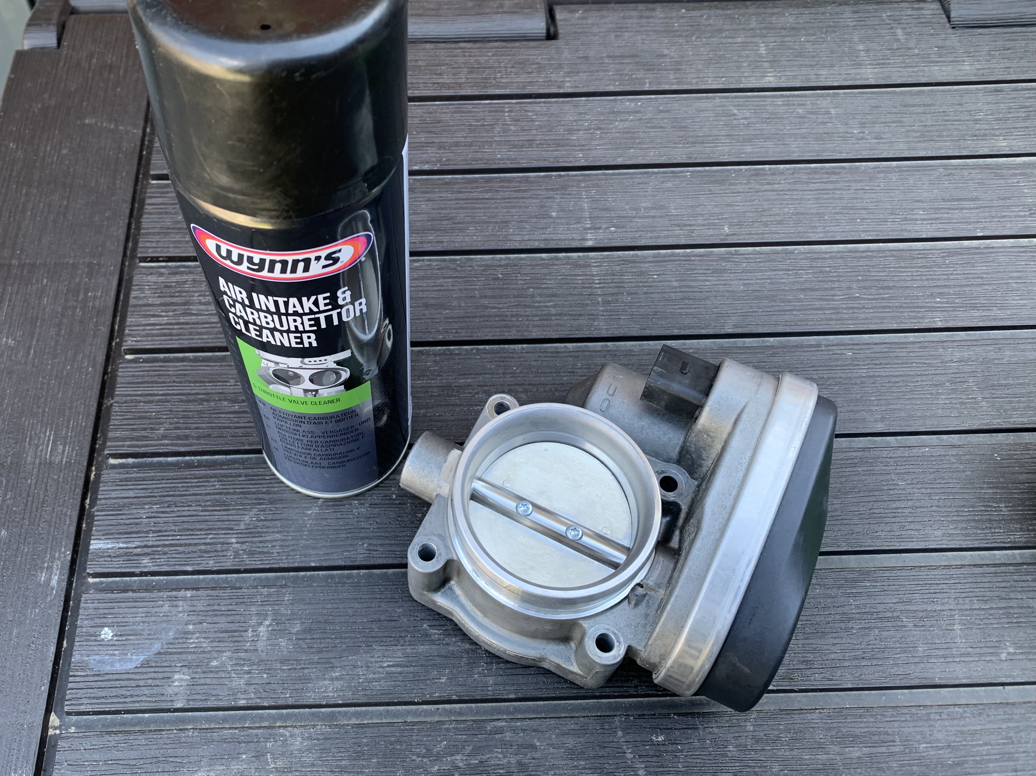

Finally, with the new coil and plug leads on, I gave the throttle body and manifold a clean up. Then changed the oil.
Purrs like a kitten.

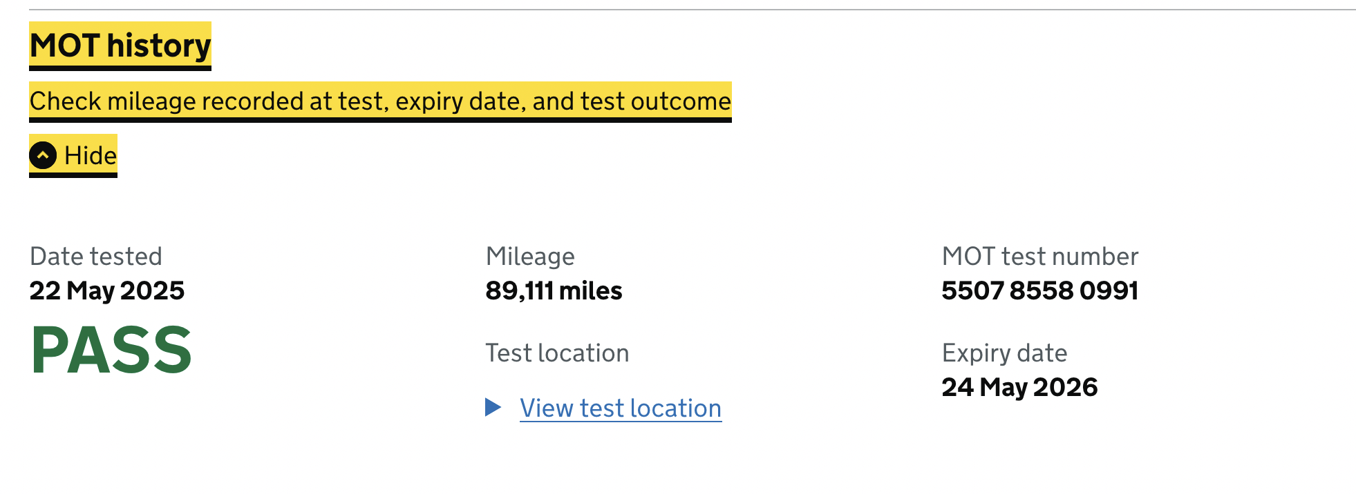

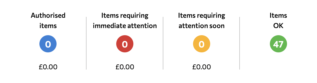

It's always nice to have a former Renault Master Technician checking over your cars as well.
On the engine front, I’ve been running some 10W-40 oil - cheers @NorthloopCup - and it’s definitely improved oil consumption to the point where it’s now negligible. It seems the valve stem oil seals in cylinders 4 and 2 are showing signs of degradation, potentially hardening from sitting around — these cars are getting old now.
Only 6,829 miles in the four years I’ve owned it, so it’s back on the road again and ready to clock up the miles. Happy days.
