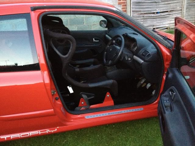

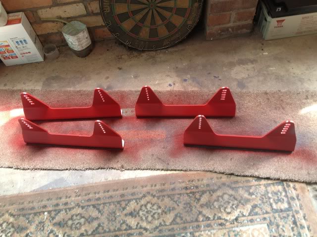

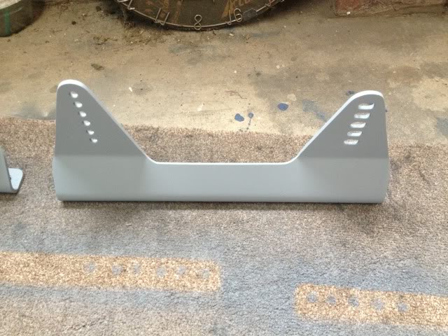

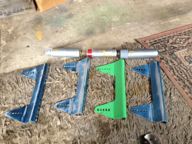

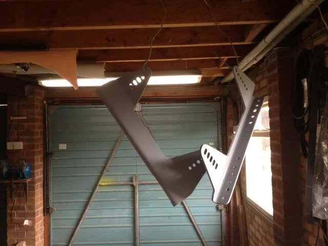

Side mounts were rubbed down
Primered
Painted

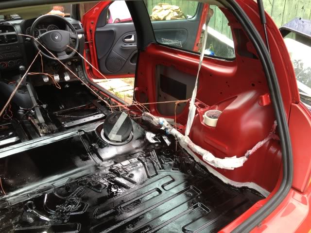

Then I gave a coat on the rear
Needs another coat in parts but is ready for the seats to go back in tomorrow hopefully

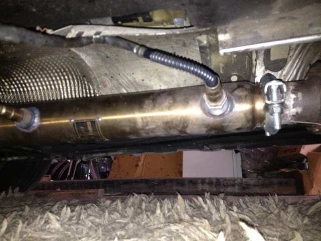

Recent updates:

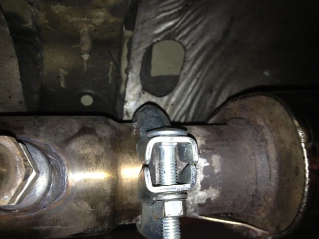

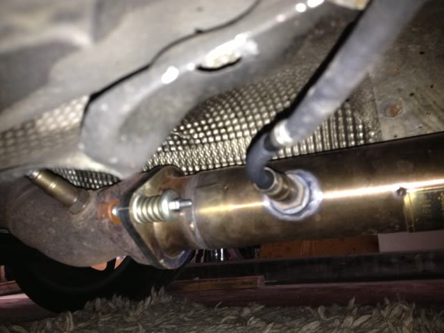

New lamb sensor sorted and on, however the light is still on and its idling a bit rough lol
So as we had a leaking centre box, we removed the decat and centre box and sent them over the dewismotorsport for some repair and another lamba boss adding so we can plug our wideband :)
New boss
Repair and new clamp

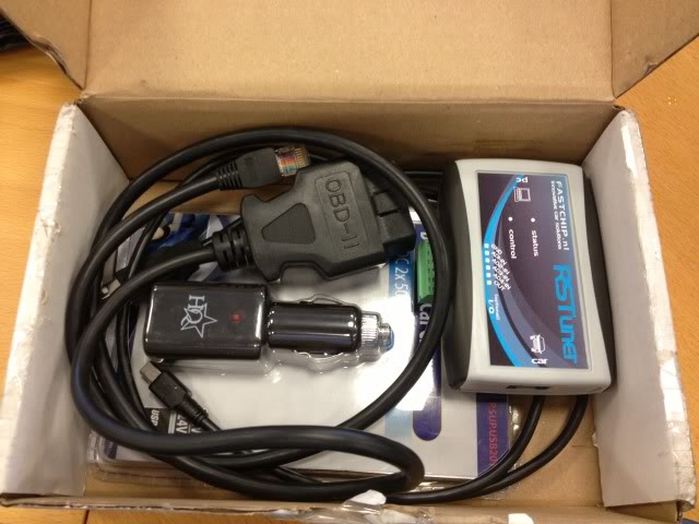

Finally, to enable us to turn off the eml and equip the car with the 98 Ron map we have bought the following :)

Has it got the ABS module as well Rich?
To get the lambda light to go off you will need to put the second sensor in fresh air, so you could have used that boss for your wideband.

When you say fresh air, does that mean start it up with it not attached to the decat? Then refit?
Thanks mate, for this and all the questions you've answered in buying one lol :)
  182/RS2/ Turbo/Mk1
No I mean cable tie it under the car and never plug it into the decat, as if its in decat then the ECU will see that you dont have a cat and so will put the light on.
  Clio Trophy #343
Oh right, it worked ok before? It went to Bedford and round Bedford with it plugged in? We bought that spacer price so its not too close and the light stayed of, will try it again but if we have probs then I will do as mentioned :)
  182/RS2/ Turbo/Mk1
Probably got away with it before because of the exhaust hole, which would have sucked in fresh air and made it look like the car was working by altering the lambda value for the second sensor.
  Clio Trophy #343
could be, it was not leaking at the time as we pasted the damage so when first fitting it was all sealed, however i have read that sometimes the light comes on after a while and tbh we now have a new clean sensor so may be more sensitive, i will try it the old way and see what happens... other wise, no need for that new hole then ha ha

We also have a rs tuner, still on original 182 map, can use live feed if there is some feeds people can suggest we track
