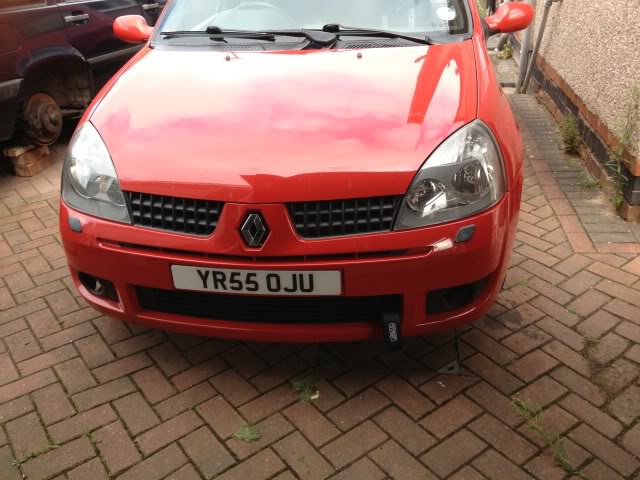

Last bit of messing before llandow:

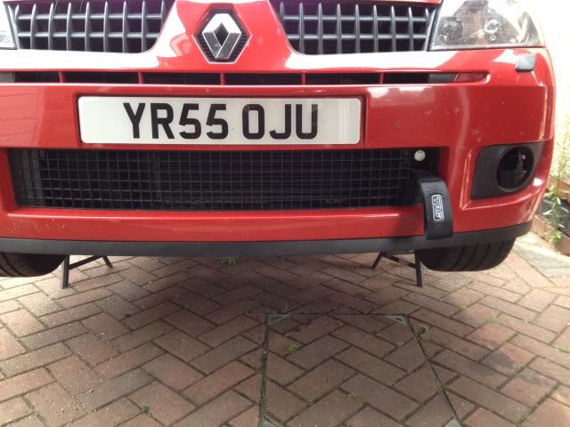

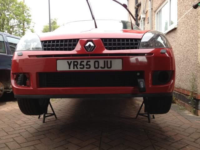

Tow strap fitted to the car finally, we got a warning at Bedford that if they needed to tow us that they would do so by any means, so added :)
Thanks to Dewis for drilling the hole out for us :)
Then as it came with the car we finally fitted up the splitter
7.3 grams of weight added but its added 40bhp in the photos and at the pub :)

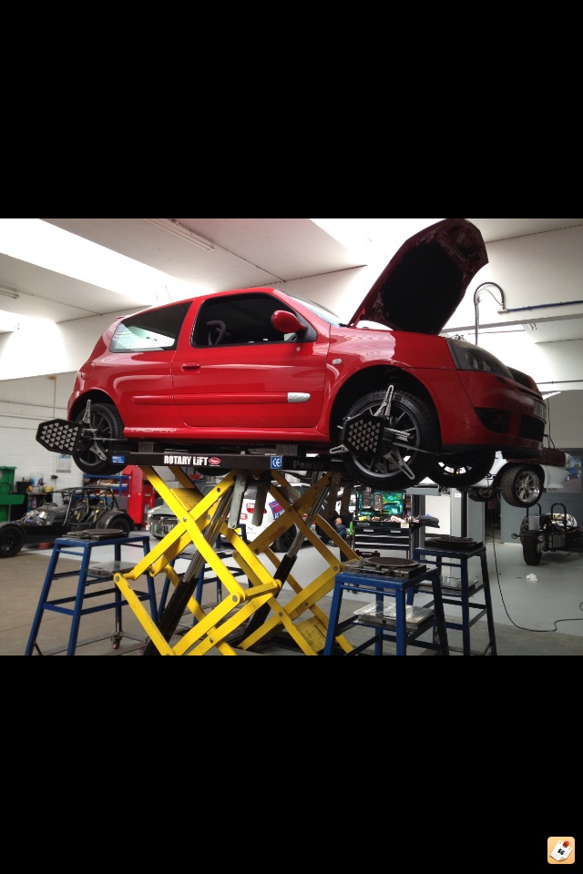

Geomatary done at Northampton Motorsport set to 1.5 deg camber due to max achievable on the one side, and half a degree tow out on each side.

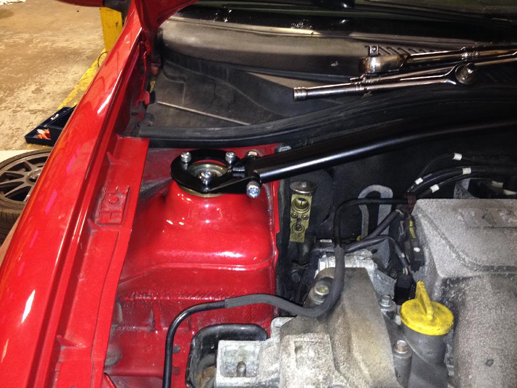

PMS top mount and strut brace kit

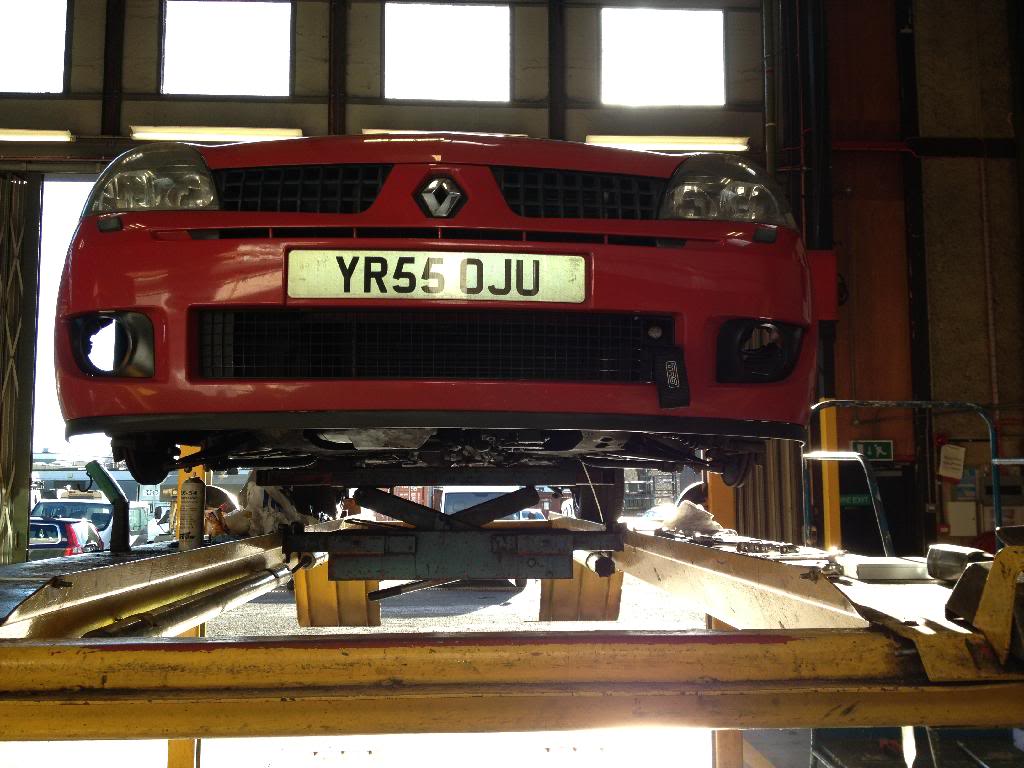

The has been MOT'd yesterday thanks to the help of #fred@btm
Car needs a run though as it's developed a very slightly rough idle lol

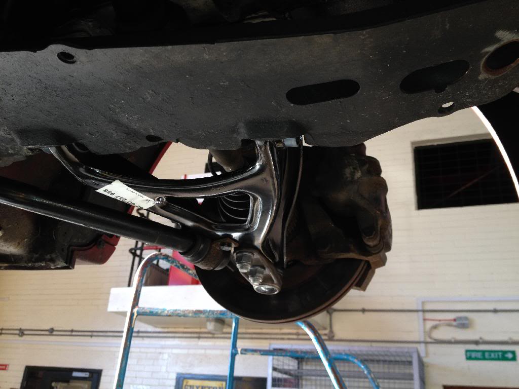

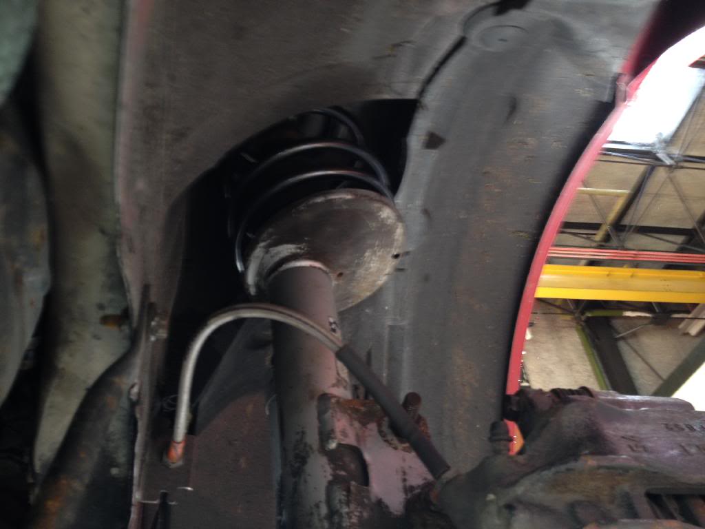

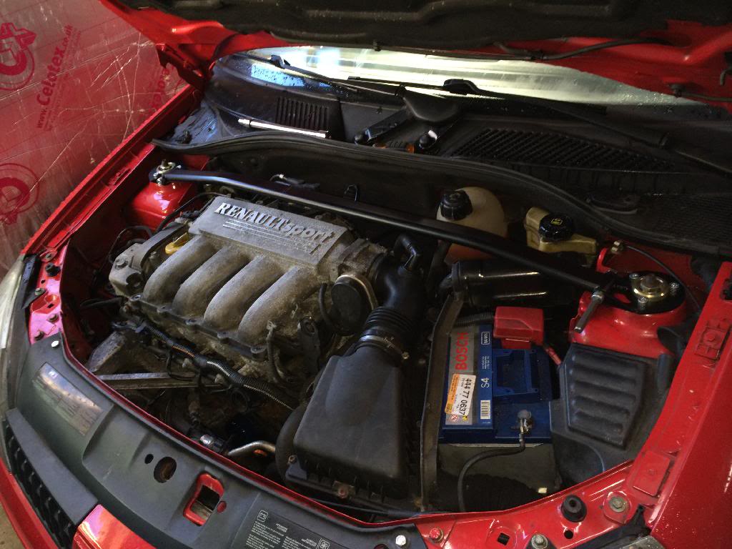

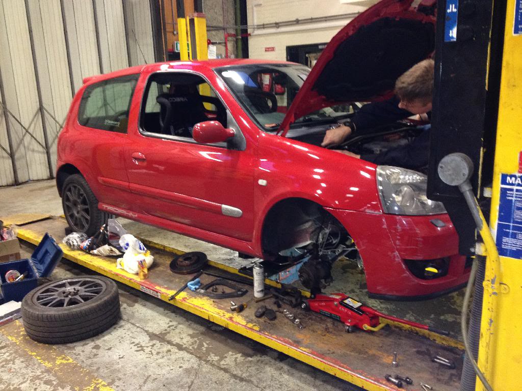

Yesterday's and today's progress

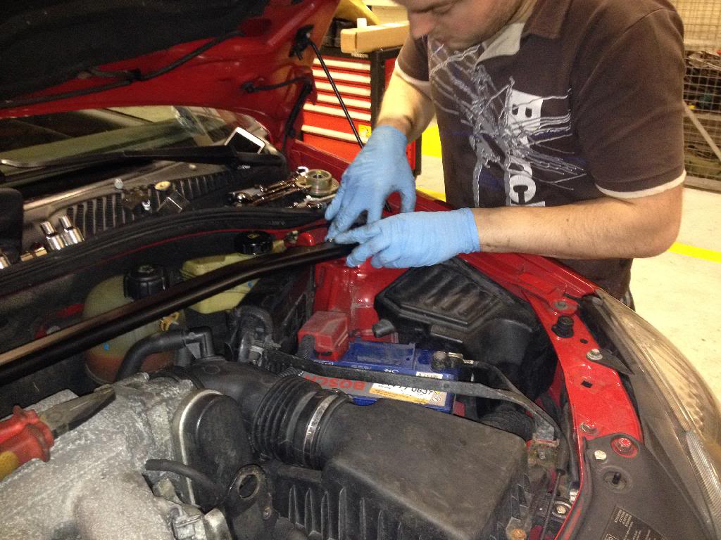

Stripped down the front end to refresh most of the bushes and upgrade to the copksports plus the pms topmount and strut brace
New pms topmount and strut brace being fitted:

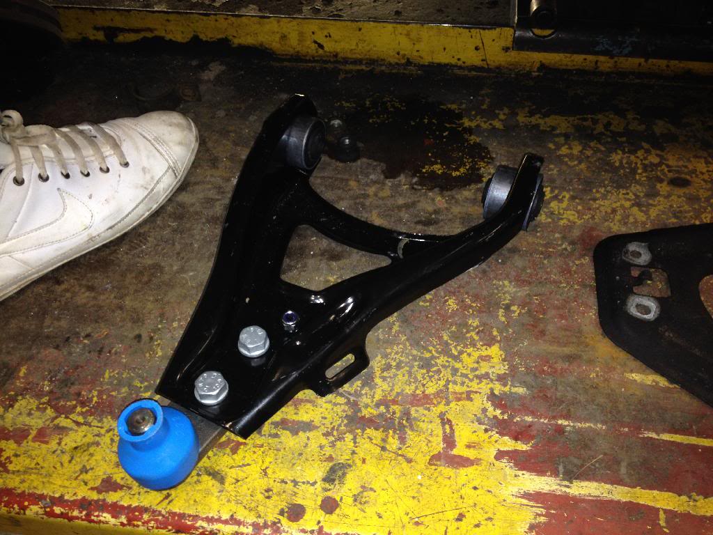

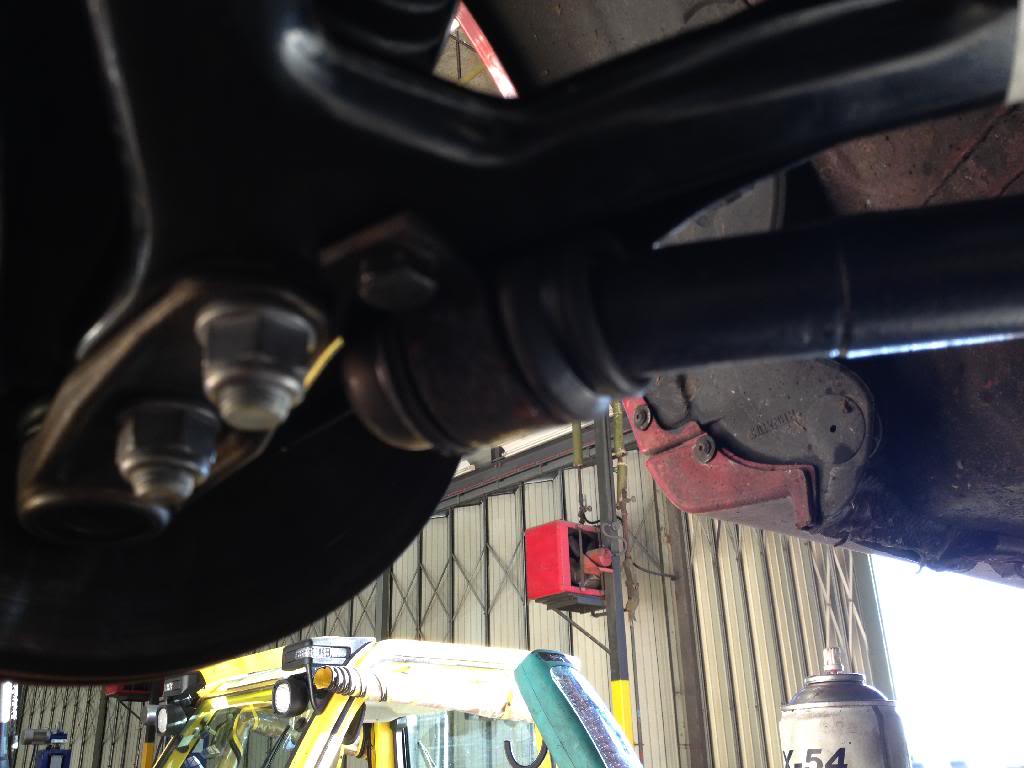

New wishbones fitted... Old ball joints totally shagged
New front arb bushes changed
The centre ones were a total t**t to refit

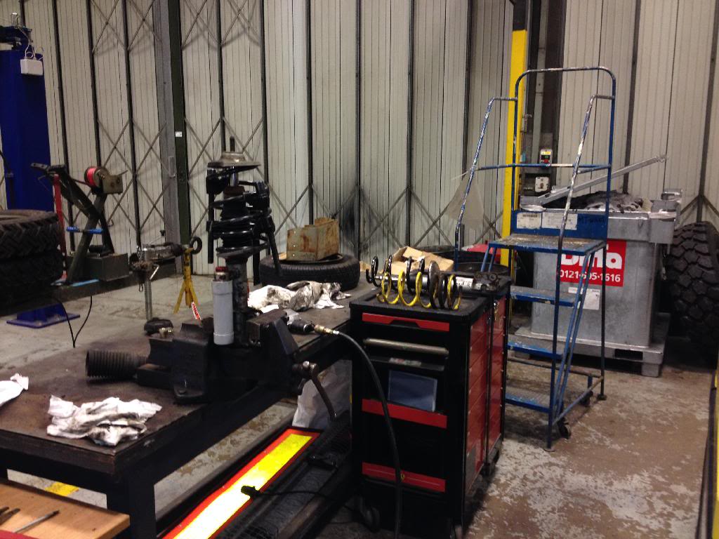

Cooksports fitted to Sachs

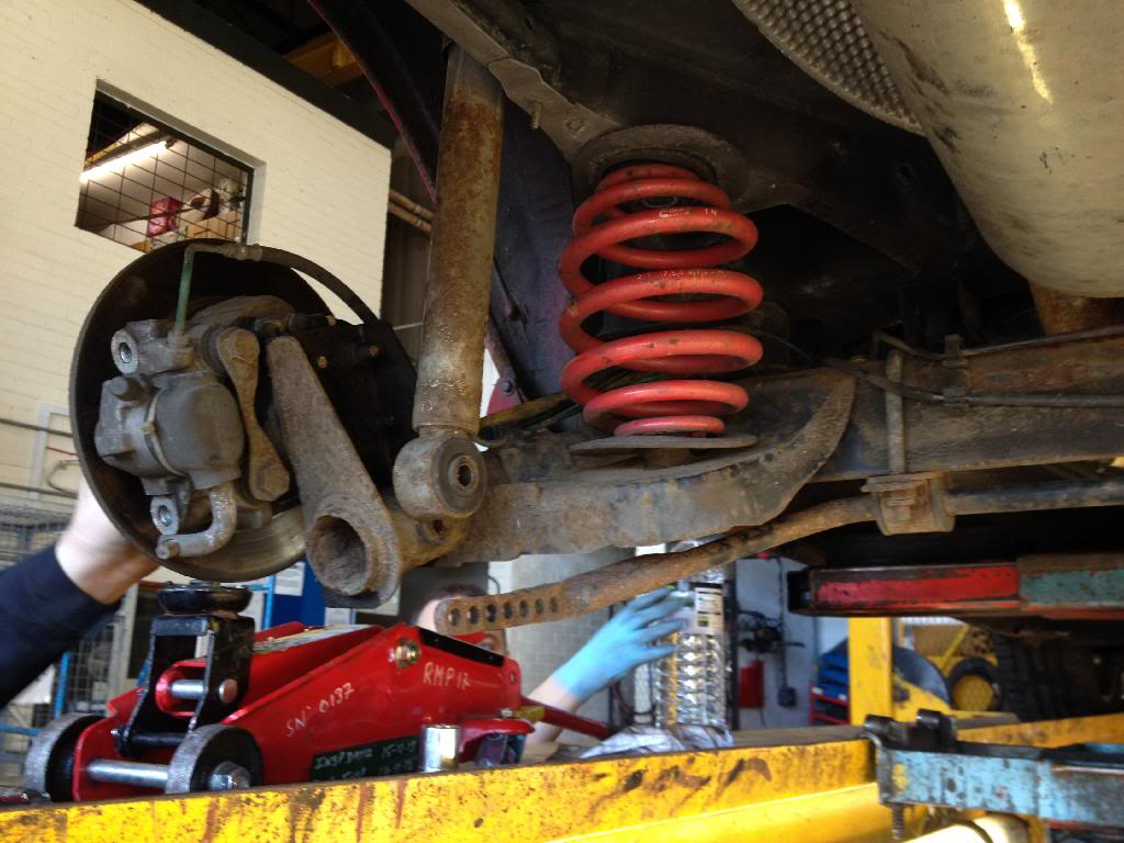

Rear shims and springs fitted to rears
Forgot to get pics of the finished article
Oil and filter done :)

Geometry done also :)
1.2 deg camber front
1mm total toe out
Rear camber 1.7 deg drivers side and 2.7 deg passanger ( will remove shim next weekend)
Stupidly we did not check rear camber before we started as it we thought it was 1deg birth sides after the Northampton Motorsport set up.. Whoops

Initial thoughts are that car feels great, really taught in comparison :)
And finally and most importantly a massive massive thanks to dewismotorsport for the use of your workshop for the weekend, letting us stay your house, for driving us around and most of all for your help with the car :) you sir are a legend and slowly becoming a renault specialist :lol:

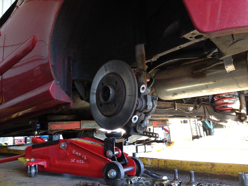

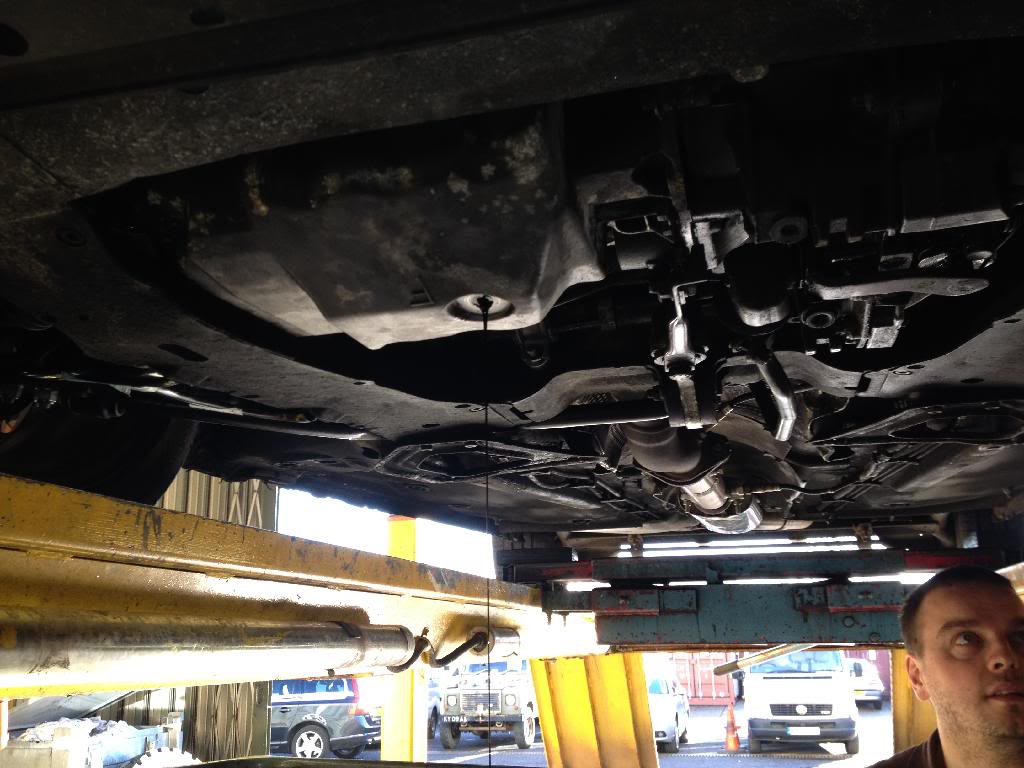

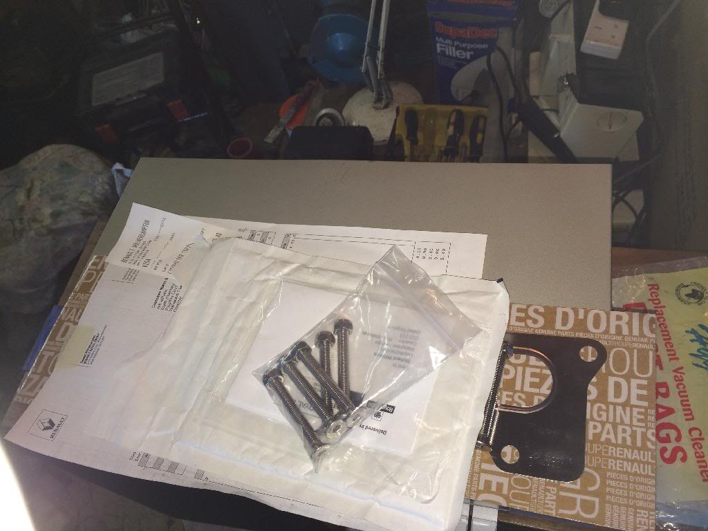

Had a morning free today so the list was as follows:

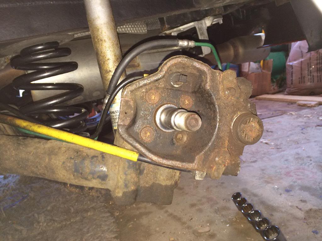

Removed drivers side rear shim
Fit 13mm stub axle bolt we had previously sheered
Investigate misfire, suspected exhaust mani gasket or injector so fitted new exhaust gasket
Only pics I took as we were short of time
New parts:
Rear stub axel bolt missing,
Then we messed around here lol
Exhaust gasket was fine tbh
However we had the plugs out and one of the plugs was very black, changed the injector over for a spare... And its running perfectly :) successful morning overall :)
Only thing left to do is change the pads, another bleed and give generally clean and generally service them
