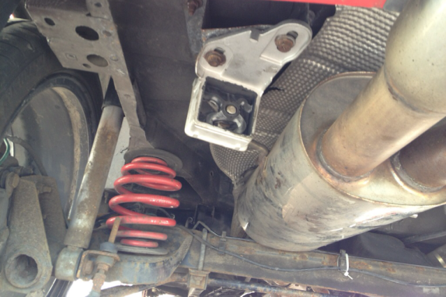

Replace exhaust mounts on back box :)

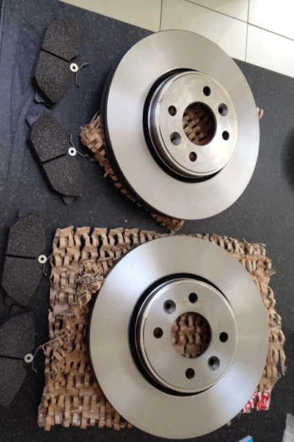

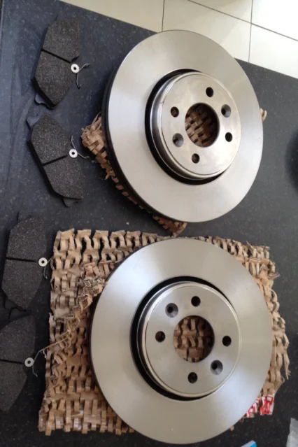

These turned up today :)

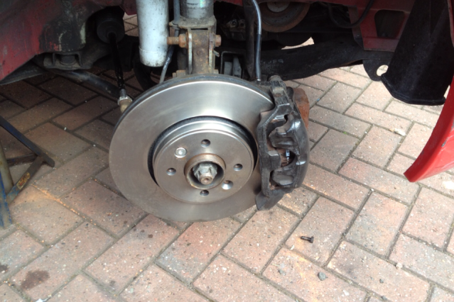

New front disks and pads fitted

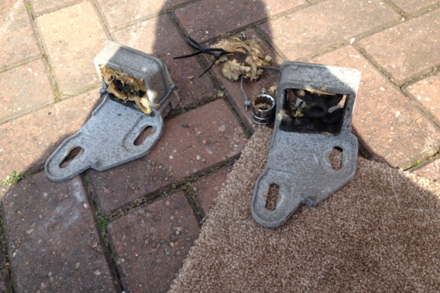

Old exhaust mounts
Nice new ones fitted

i hope you filed down the back plates on those pads!
Cam racing told me that these fitted straight on, they also sold a version that needed fettling with to fit.
Should we have filled these down anyway? I will have to check with Matt as he did this on his day off yesterday
Thanks for the reply though Fred, very much appreciated :)
100% need to file them down or when they get hot, they expand, bind on and destroy the frition material trust me, i sell s**t loads of these (kam will have sent you the 406H pad, it should be the 565H for future reference, both fit just the 565H has a larger pad area and are thicker, same price or a tad cheaper = win win win)
Sorry for the delay, been away for the week with only limited access to wifi :)
Matt said he filed down the top and bottom of the backing plate and made sure they felt free enough in the caliper, is this what you are referring to? If so its the same as in my leon :)

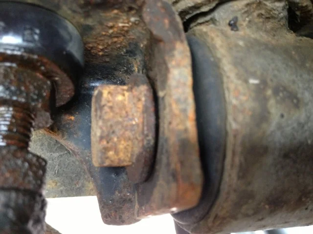

Only recent progress is around working through all the little rattles and knocking noises we have noticed, the worst being the exhaust and exhaust heat shield...

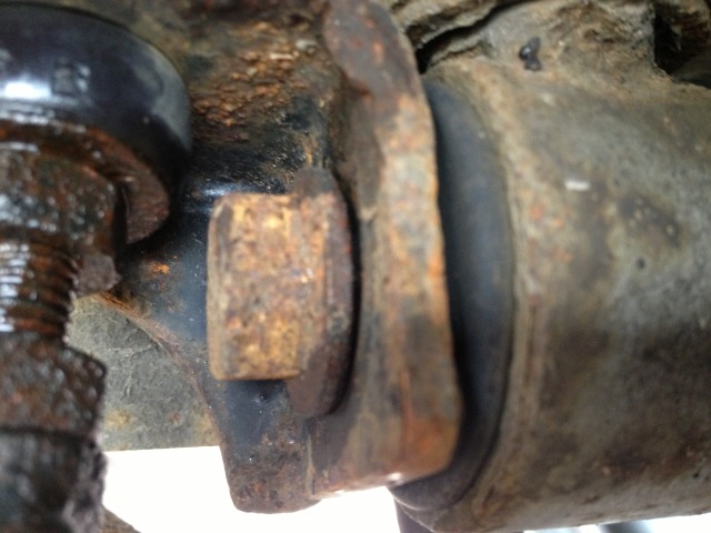

Or so we thought... Went to see Fred at BTM to return the seat and he took it for a spin, confirming something up with the rear one side is rattling its tits off suspected shagged rear shocks :(
Turned out to be this
Still need the rear shocks looking over but hopefully this was causing the noises and shocks are all ok:) not sure of it just worked its way loose or what but its a bit worrying lol

Replacing the rear shock bolts due to damaged one from it bring loose

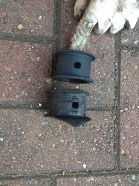

replace steering rack bushes to cure knock and steering play
Old vs new
Old ones were totally soft and s**t
Good news is they fixes the steering sloppiness but we still have a knock :(

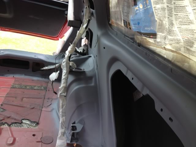

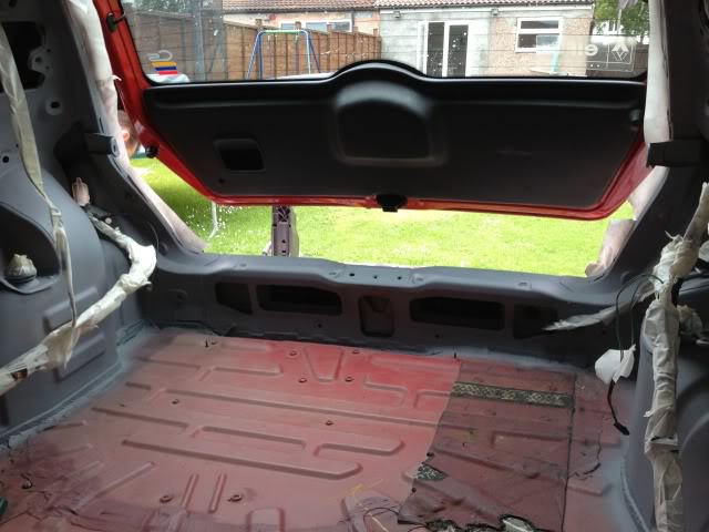

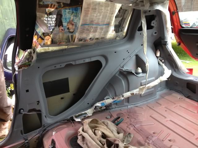

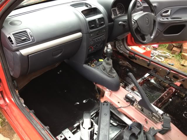

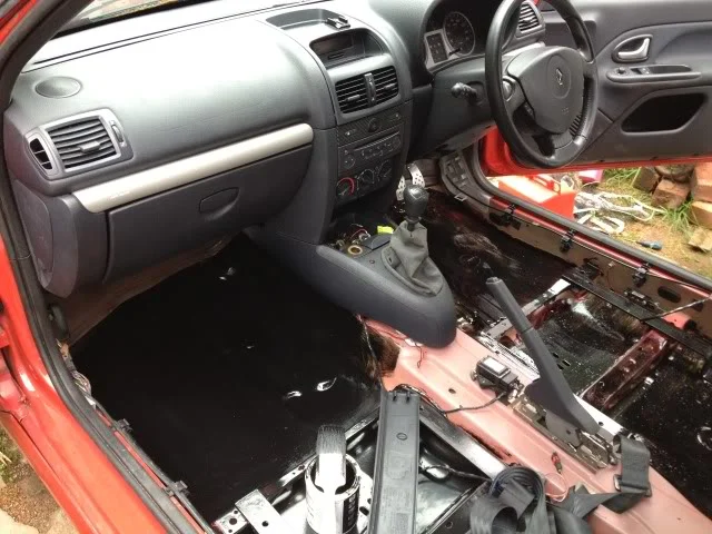

In prep for Bedford we are part way through tarting up the inside
Its actually a bit further and the sound deadening removed etc but forgot to take pics, not sure about the back yet but its hard to say half done
