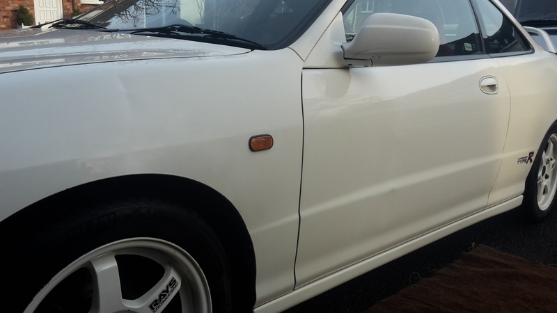

had the paintwork seen to in the summer by Bifcaids to try and match the panels -

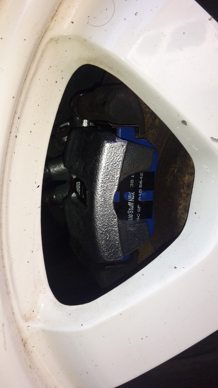

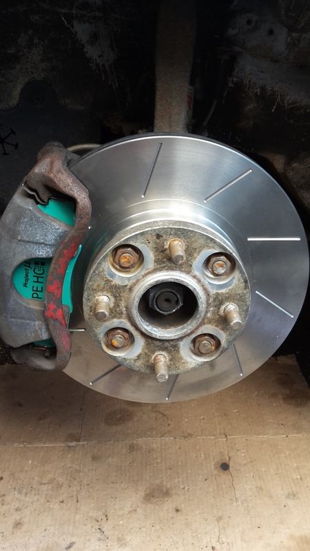

new front brake pads, Project MUs and the same cheap grooved discs -

brakes were great all day so really happy with them, don't need to touch them other than the usual rebleed inbetween every trackday.

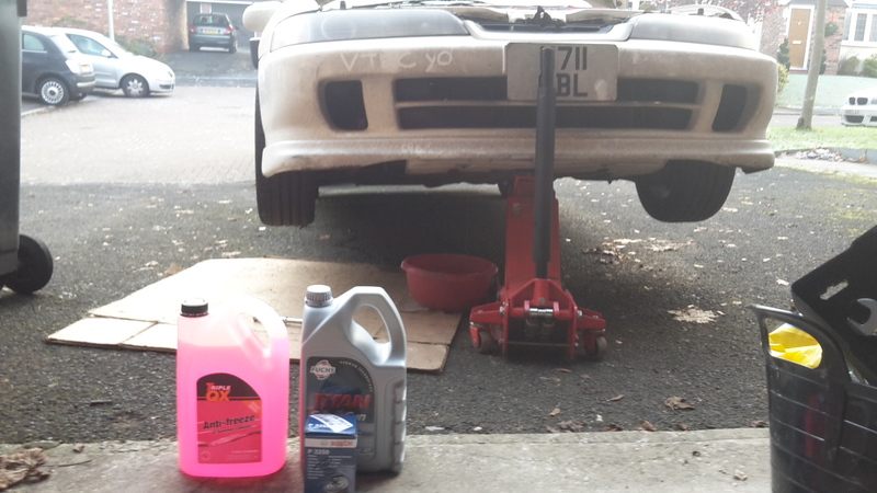

serviced again and antifreezed up for winter -

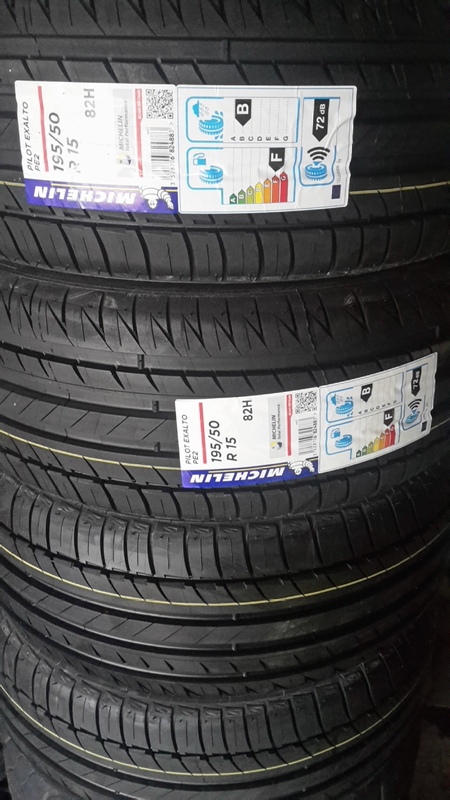

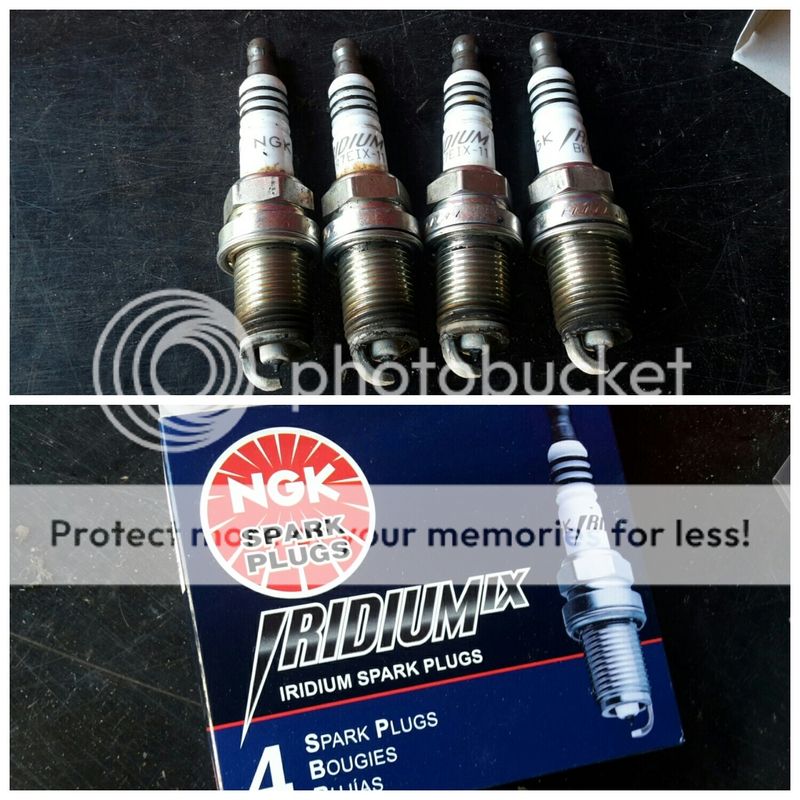

making the car fresh for 2017, new plugs same again, the old ones done me proud for 2years -
new tyres same again with PE2s, the old ones lasted me around 10,000 miles and 9 trackdays as n when they were needed, the best allround tyre in this size for road and wet track and even when the tracks 95% dry they are still very impressive -

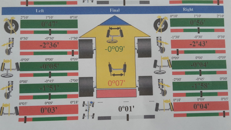

also had the alignment 'checked', it hadnt been on a Hunter system for 18months i've tweaked the front toe from time to time and it read this when they strapped it on, was suprised with the track use and kerb hopping that it didn't needed a tweak aha, tried numerous settings over the years and found this setup my favourite (-2.5 front -1.5 rear camber,-0.10 toe out front 0.08 toe in rear) -

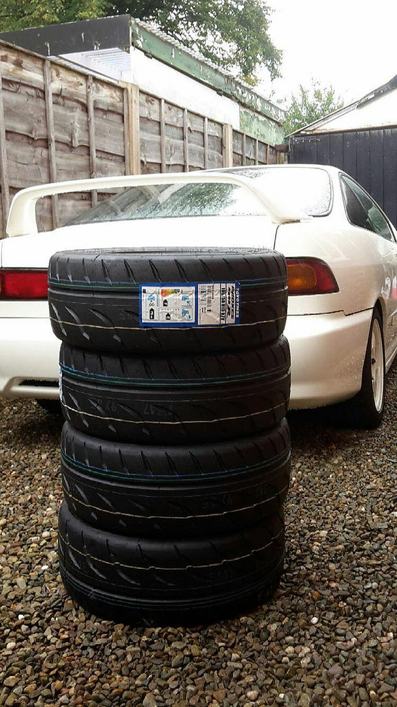

Got some new tyres on their way to replace the 'great but not so much when hot' federal RSRs, need to go over the brakes and give it a service before the next which is at Oulton in November! Also got a Tegiwa 1.3bar rad cap hopefully with that and a vented header tank now i wont have anymore pressure/coolant issues!
yeh man big one at the end of the video, was a little lairy aha, done the same again later on when me and my mate in the quick Primera were on it wish i remebered to press record on my camera, sods law
What tyres you got?
What tyres you got?
R888r's

new blank discs on the front along with Bluestuffs allround as i havent tried them yet, old pads did me proud haha -

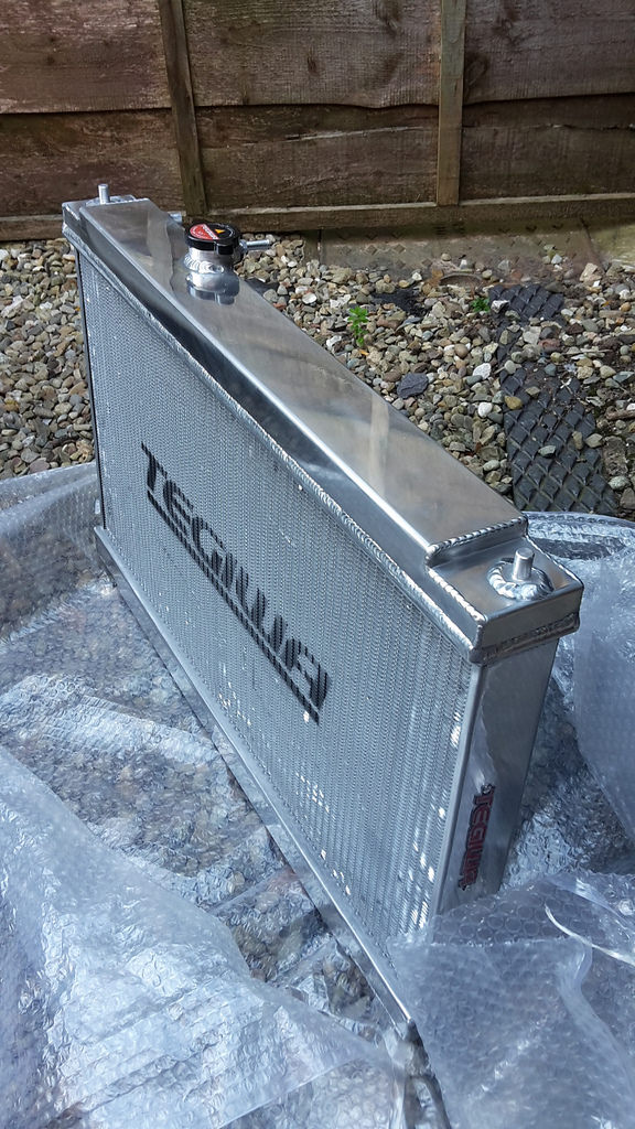

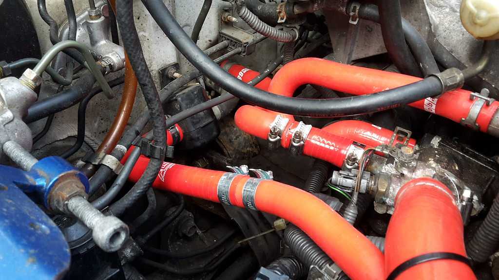

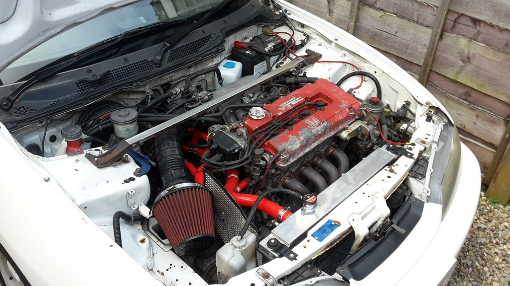

New Tegiwa X-Cool radiator after finding the Nissens one split where the fins met the base from i'm guessing the pressure from just before the radiator cap shat itself at cadwell -
20171017_145726 by jamie rigby, on Flickr

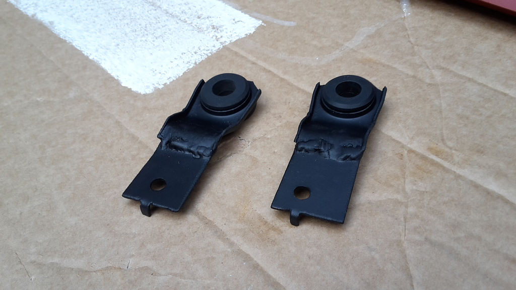

made some extended rad brackets with the rad being 70mm deep at the top and bottom (55mm where the fins are) -
20171023_160314 by jamie rigby, on Flickr
the only reason i got rid of my old ally rad was because the big radiator hoses were swelling with the pressure, so this time i got some silicone hoses, a cheap ebay kit to be exact that needed some attention as 3 of the 6 hoses didn't fit, some joiners and a 90degree bend sorted them but you can see the tiny 90degree hose still on the back of the heater matrix ill chance that that wont split, got lots of spares if it does fingers crossed it wont -

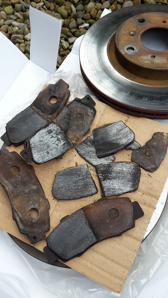

Found the EBC bluestuffs incosnistent and they've worn around half way down already in 100 track miles and half of them were me cruising around making some clear track lol. Tyres were great but the front have also seemed to wear abit too.

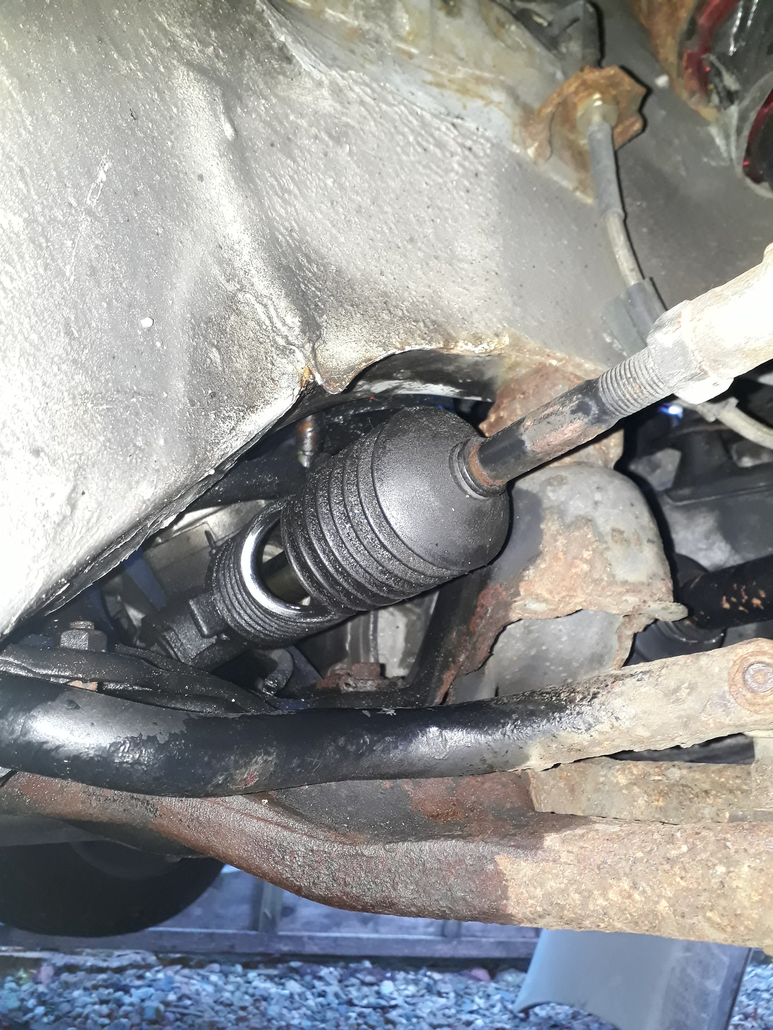

So, fitted new shafts from Tegiwa all seems good again!
Got new brake pads instead of the Bluestuffs will fit them nearer the next trackday!
When swapping the shafts i noticed fluid EVERYWHERE all underneath the offside of the car, wasnt gearbox oil, i presumed it was oil from out of my catch tank but it hardly breathes anything anyways just vapour so it couldnt have been that, then noticed this... motherfocker! swapped and all cleaned up now -

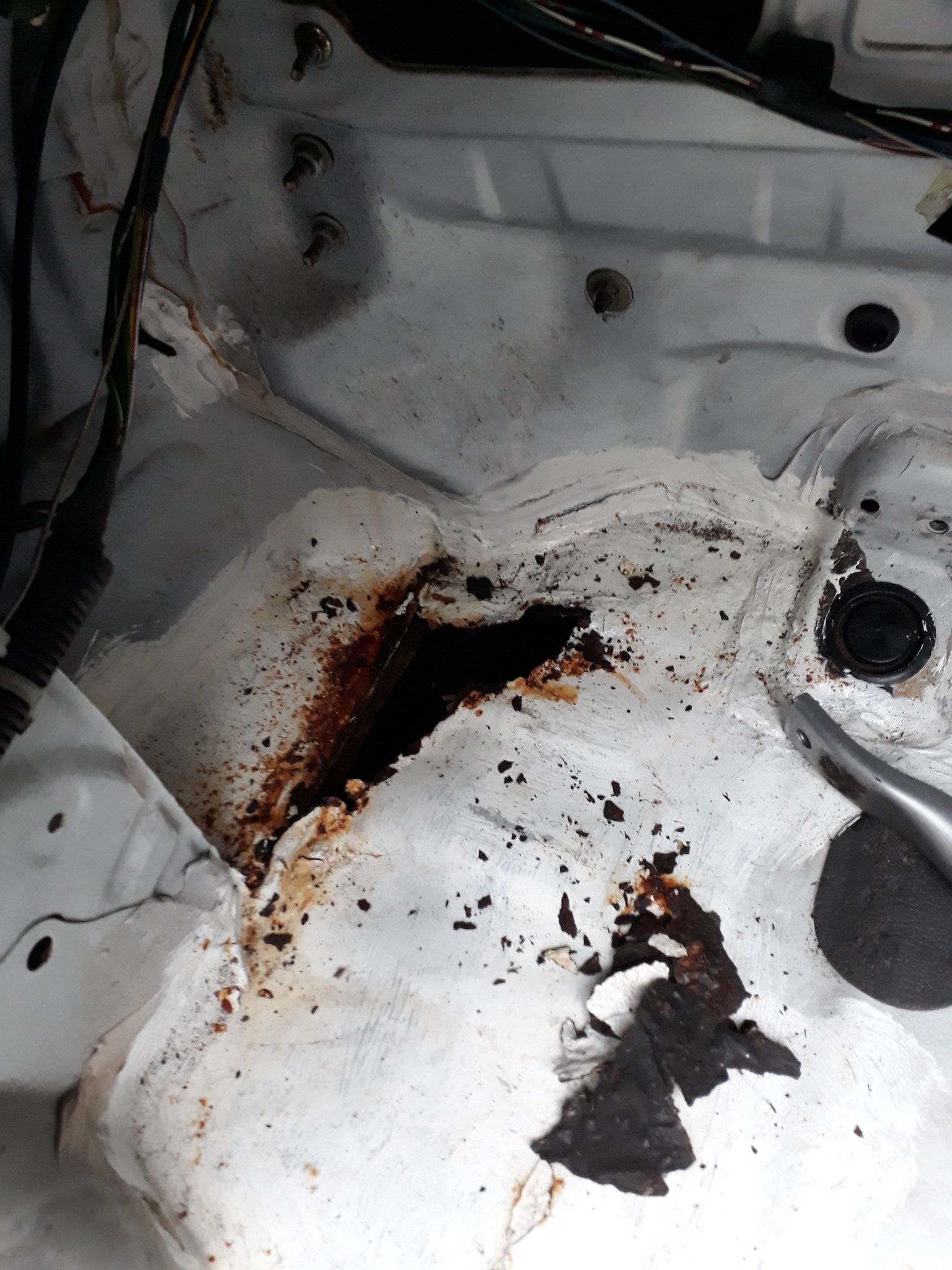

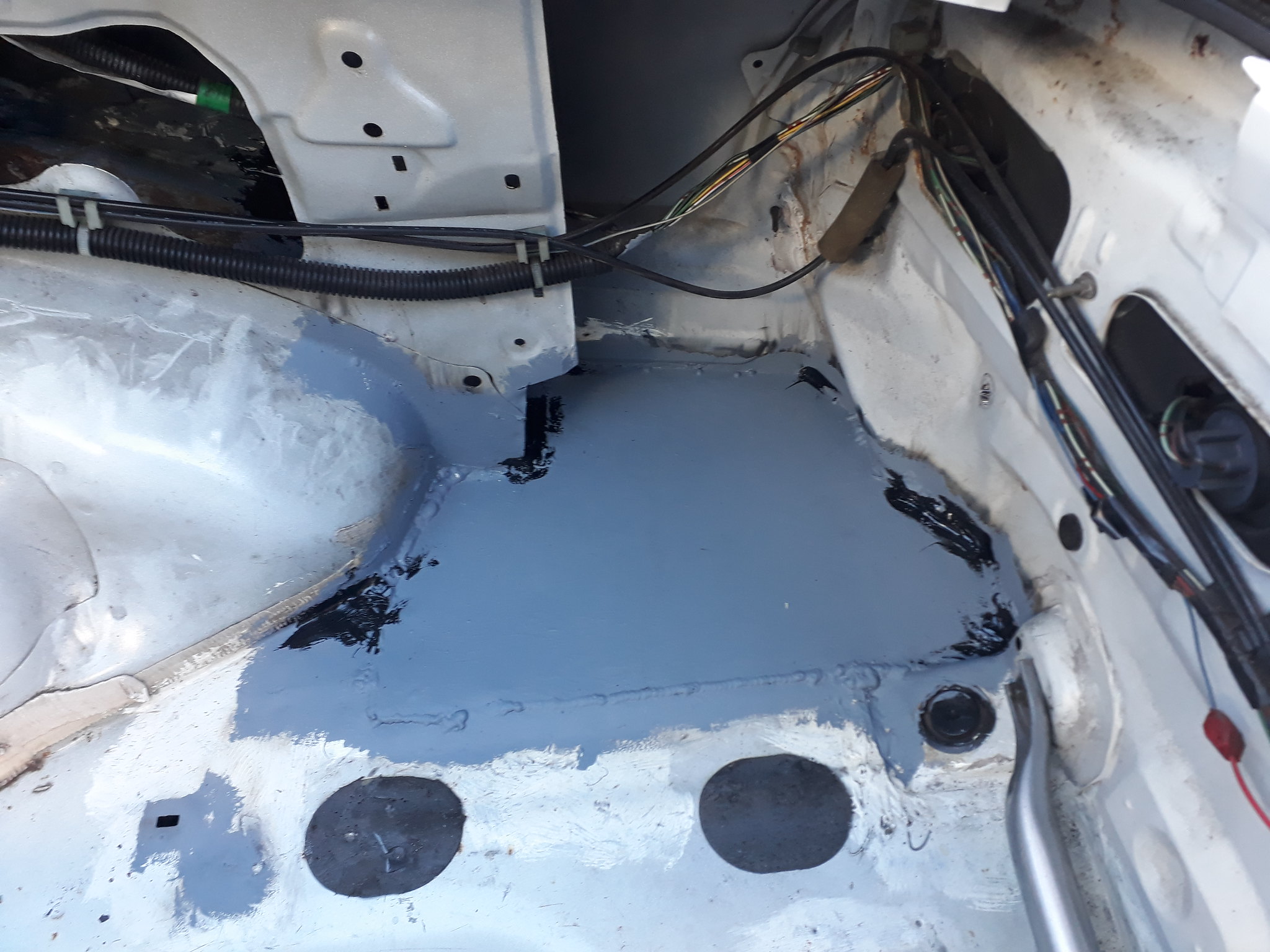

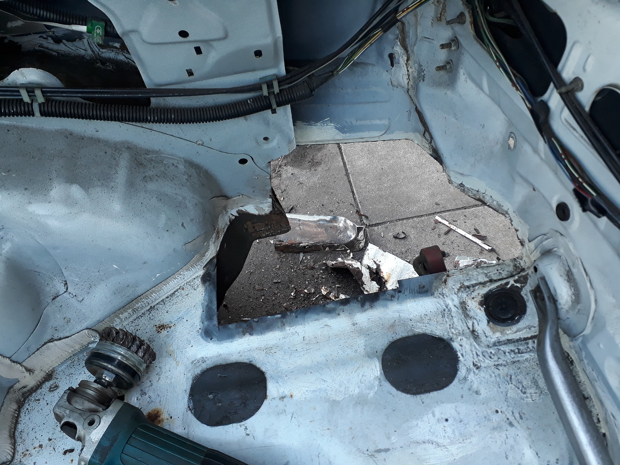

When removing the rear seats for the Oulton trackday in november i noticed quite alot of water in the boot and abit under the rear seats, turns out when i attended to the rear lights seals and tracing other water leaks from the bootlid when i removed the bootlid and refitted it i split the seal/shroud that the wires go through into the bootlid so water has been getting into the bootlid and coming out of the drain holes into the boot and waters been getting in the rear quater and running down the wheel arch and sitting in the corner of the boot behind the rear door cards, removed the door card and it didnt take much for this to happen -
20171222_142227 by jamie rigby, on Flickr
What happenes when you can't see water leaking into your car for over 3 years (since i done the rear light seals etc) and the boot floor designs sh!t/not flat so the water would've been sat in that crease/recess for ages until it evaporated, so went to f0xys, chopped it right back to the good metal -
20180106_100403 by jamie rigby, on Flickr

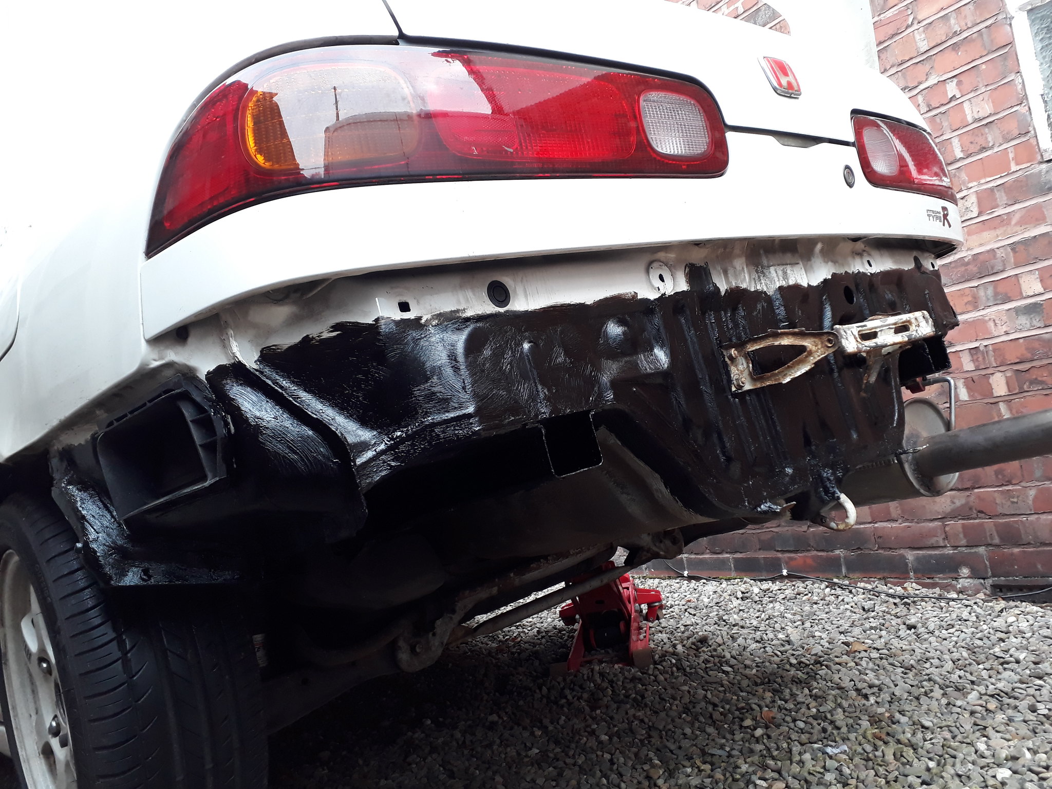

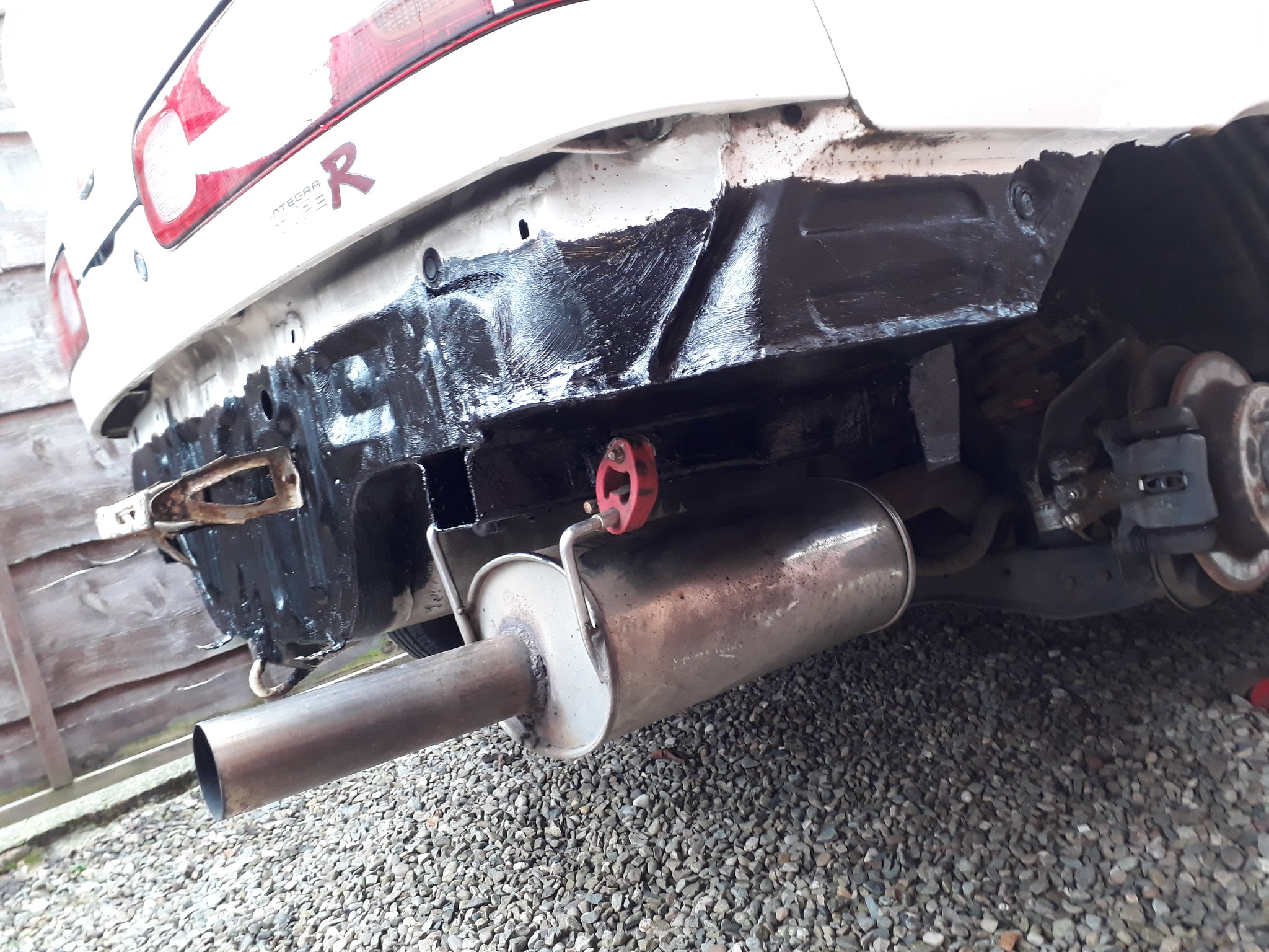

made a template out of carboard, traced onto some 1.5mm, one nice flat piece how the boot floor should've been (not that it should leak water in but still) and welded in and anti-rust primered -
20180107_115604 by jamie rigby, on Flickr
whole rear end undersealed, otherside's completely solid and all underneath the car is, checked everywhere and this only happened like i say because i couldn't see the water leaking it, if it was stripped with no door cards i wouldv'e spotted it straight away god damn haha
