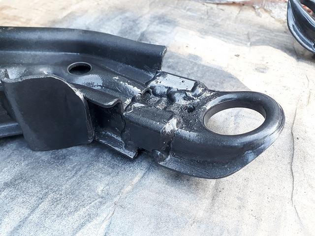

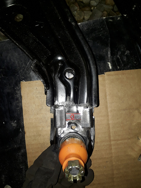

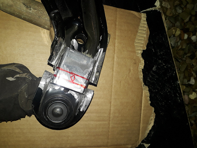

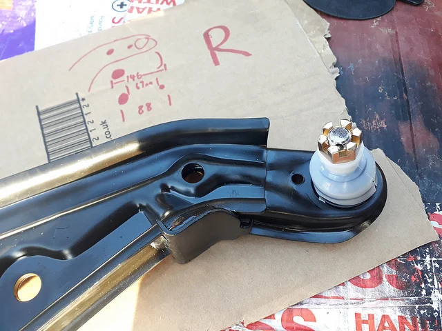

little update, bought some new lower arms and extended them 8mm to give it some much needed camber, turns is so so much better now -
20181217_105000 by jamie rigby, on Flickr
20181219_163822 by jamie rigby, on Flickr
20181219_161208 by jamie rigby, on Flickr
20181222_150325 by jamie rigby, on Flickr

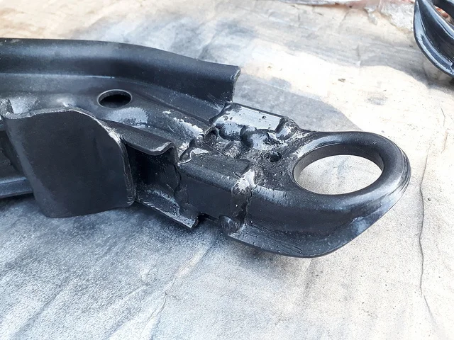

f**k sake, I cant believe Im actually looking at this. It's genuinely terrifying that someone looked at that and went "proper job" and fitted them tbh.
Very little overlap
Little to no structural continuity
Lots of nice places for fatigue cracking to set in
Piss poor welding
I'm all for people being creative and I have no objection to modified parts, but please please take responsibility for doing it properly.

The 50x25mm 3mm thick box section underneath which has been overly welded is taking all the strength, them tabs ontop are just for added bracing which again has been welded to the max, they haven't moved or bent flexed in 500 or so spirited miles since fitting them.

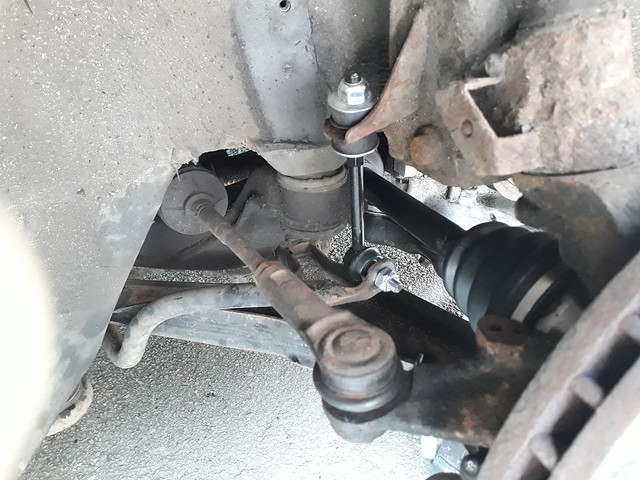

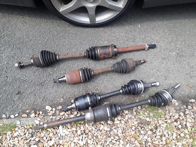

then last weekend i swapped the shafts, fitted new droplinks whilst i was at it and gave it a service
