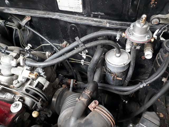

more progress, FSE adjustable fuel pressure regulator fitted -
20180822_160155 by jamie rigby, on Flickr

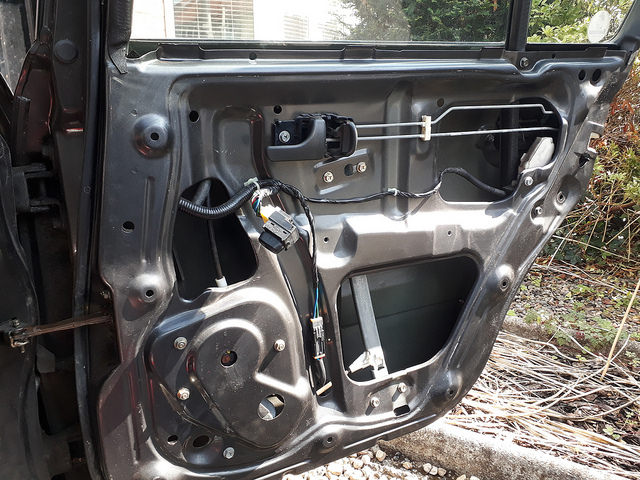

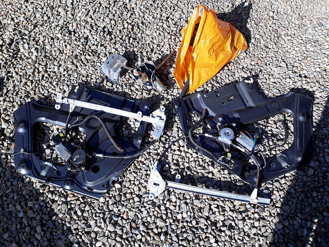

rear doors before -
20180825_142815 by jamie rigby, on Flickr

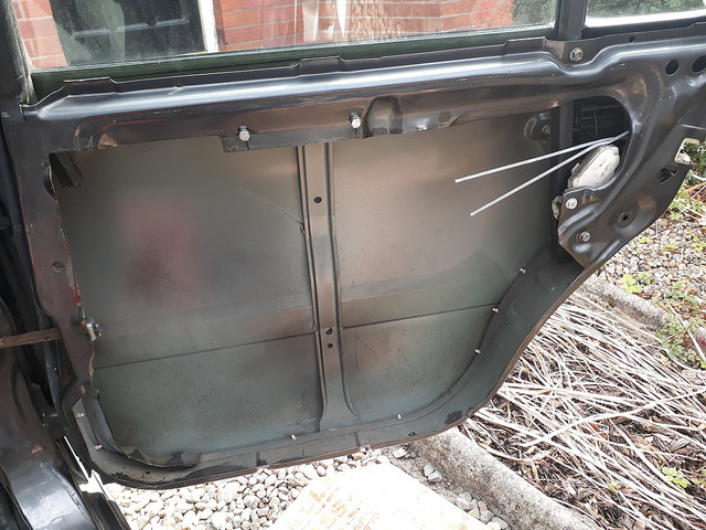

both doors stripped also removed the aerial motor-
20180825_164748 by jamie rigby, on Flickr
bolted the windows inplace using the M6 holes that the old window mechanism was bolted too -

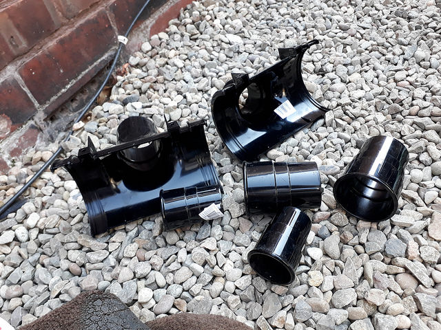

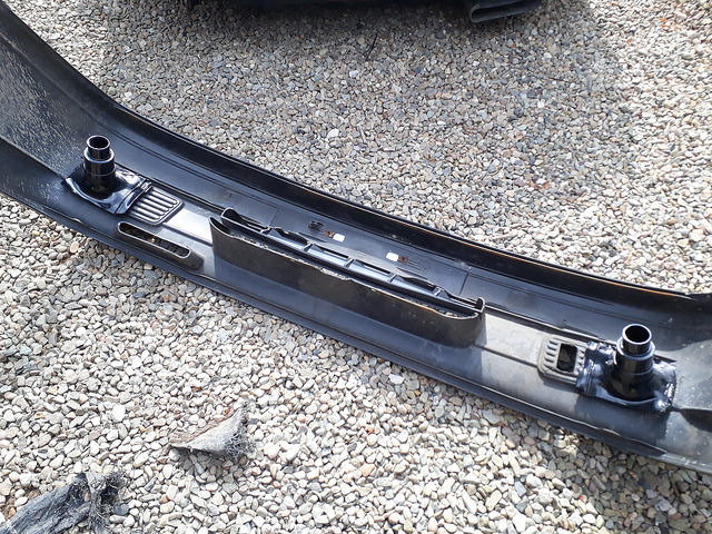

gutters outlets and reducers -
20180626_151348 by jamie rigby, on Flickr
chopped and molded with a heatgun to make -
20180723_165013 by jamie rigby, on Flickr

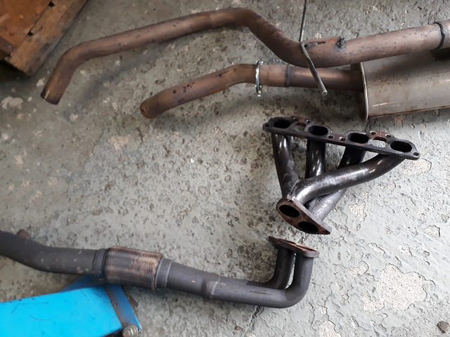

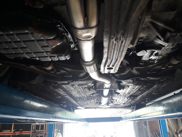

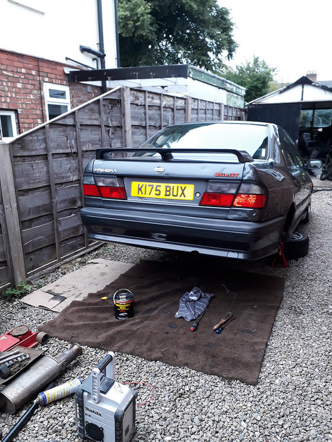

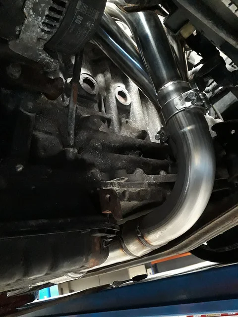

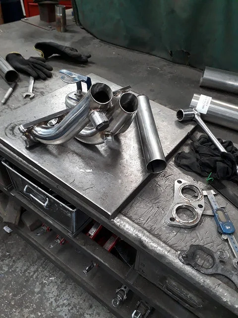

So the Exhaust is awesome exactly what i was expecting, if you live in the Northwest and want a custom exhaust, manifolds, downpipes etc take it to Pipewerx! So old one removed -
20180910_100914 by jamie rigby, on Flickr

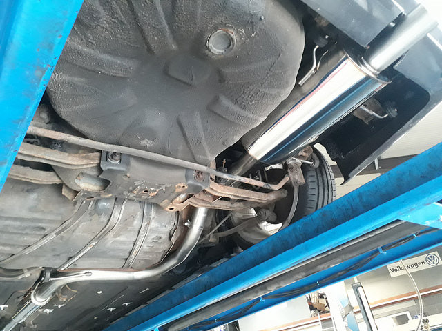

i got a new japspeed manifold off a mate and the best thing to do was chop it in half and do away with the terrible flange that had a horrendous step inside and the really restrictive 38mm sharp secondries and fit new 2'' swept secondries instead -
20180910_100720 by jamie rigby, on Flickr
20180910_151002 by jamie rigby, on Flickr

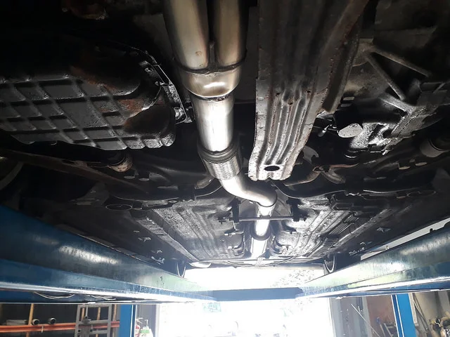

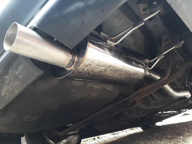

...into a flexi and a mandrel-bent double box 2.5'' system and a 2.75'' tip -
20180910_165908 by jamie rigby, on Flickr
20180910_165942 by jamie rigby, on Flickr
20180911_152719 by jamie rigby, on Flickr
mega job, sounds great nice and quiet and just quality.

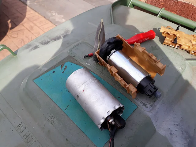

Along with the adjustable regulator i fitted i thought to fit a walbro 255 for reliability and future mods, compared to the old massive one, more weight saving haha -
20180916_141213 by jamie rigby, on Flickr

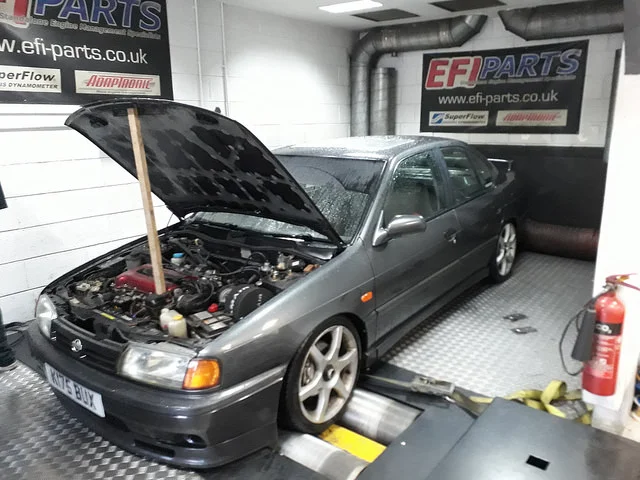

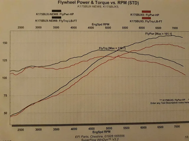

went back to see Chris at EFI Parts last night, first run it was even leaner (obviously) than it was with the old restricted manifold and crap powerflow 2'' system, so afew tweaks to the regulator we had nice fuelling, then a further alteration advancing the ignition timing it see great gains and an ideal low 13 AFR, 13bhp and 8lbs ft up almost everywhere aha -
20180920_195352 by jamie rigby, on Flickr
20180920_180939 by jamie rigby, on Flickr

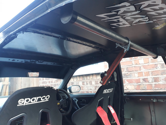

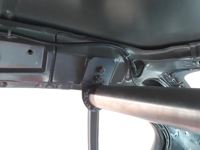

I needed to make a new camera mount as it was too far back and shakey at cadwell in july, so i got a length of 38mm from Pipewerx and made up some end plates and have f0xy weld them on for me, tidy up and abit of paint and voila -
20180917_163936 by jamie rigby, on Flickr
20180917_164726 by jamie rigby, on Flickr

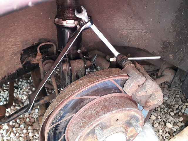

regreased the rear sliders on the carriers as one was seized, taken over an hour to undo this top bolt as it was rounded off so i had to file it to an imperial size and use this method haha, can't get a socket in without removing the brake line -

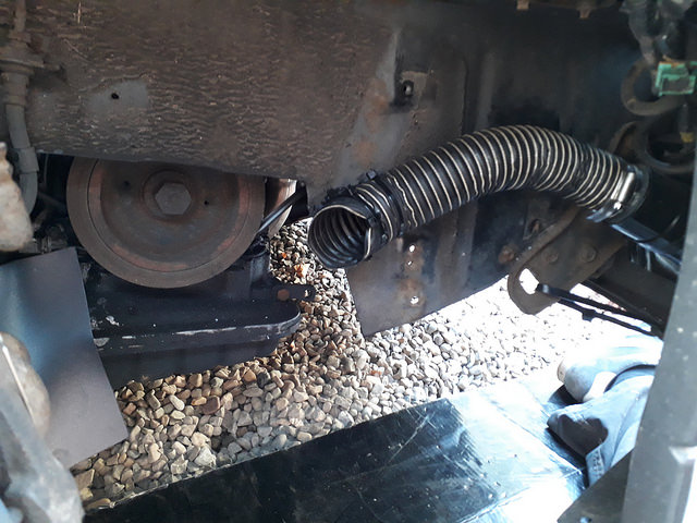

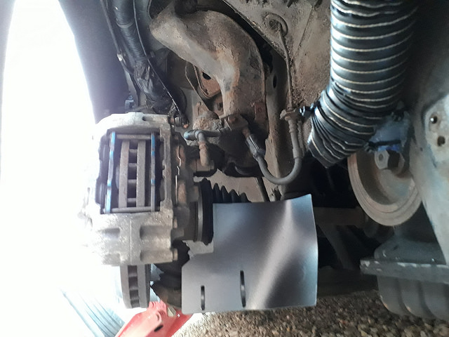

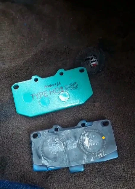

Brakes wernt the best at cadwell in the summer so made some cold air feeds, cant get the hose past the wheel so had to put it to the tyre face on full lock then make some air deflectors -
20180925_174339 by jamie rigby, on Flickr
20180925_174220 by jamie rigby, on Flickr
replaced the blue stuffs for the best pads i used in the DC2 - project MU HC800s -
20180930_141344 by jamie rigby, on Flickr
so after all the changes from the past 10 weeks (suspension, less weight, better brakes, more power) the car was awesome, had a full dry day, ended up pushing too hard putting 2 wheels off the curb at church and the brake air deflector bent into the cv boot and has split it but not too bad that i had to change the shaft (got new spares anyways) so will just swap the shaft ad get a new boot fitted, brakes were much better, only pic ive got from the day -
