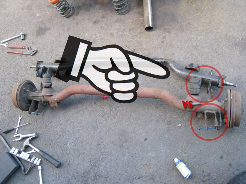

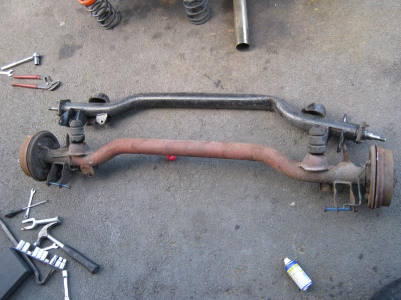

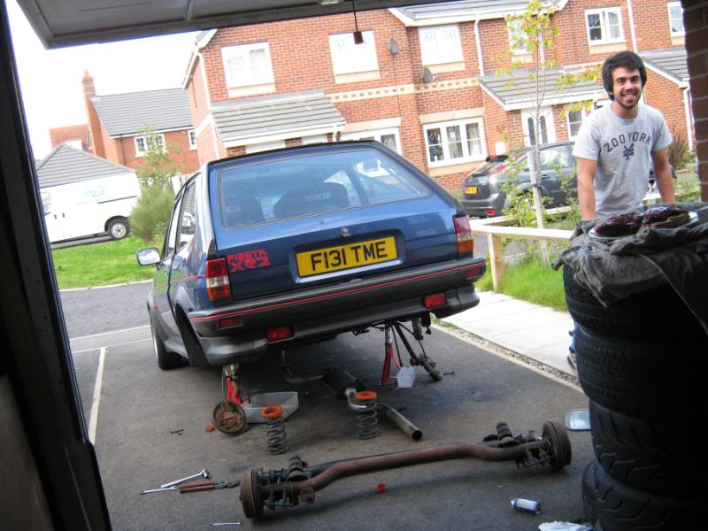

got a new rear beam on thursday so swapped the beam over yday before i had to go work...

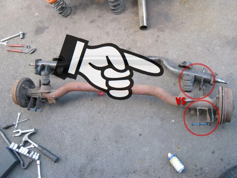

got the old rear beam off, didnt realise how bad it was actually bent/creased lol -
i used my drums and wheel bearings so just swapped everything over fromt he old beam after i took this pic
fitted it all, luckily everything just about lined up, re-bled all the brakes then as i still need 2 new road tyres ive just fitted the hweels on with the R888s for now

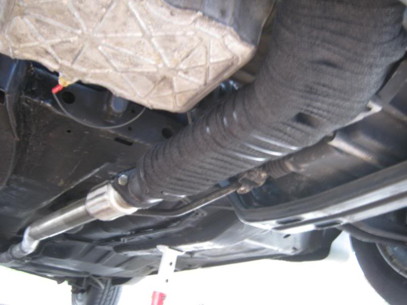

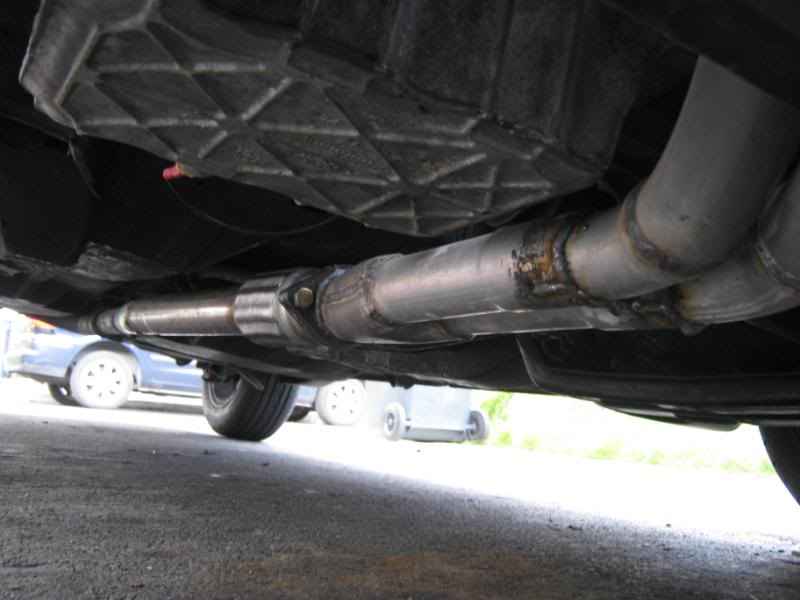

went pipewerx yesturday, had the manifold welded so its all one now, had a flange fitted instead of a sleeve joint and also now got a 5" flexi istead of an 8" so its not all over the place anymore... was pricey but well worth it now and no need to keep messing around with it all the time -

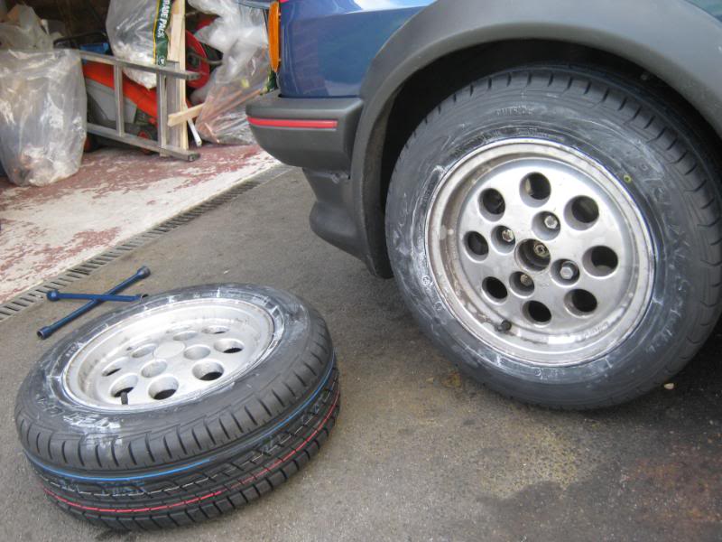

and the new tyres arrived yesturday too whilst i was out so went to collect them last night, just had them fitted now, left one of the centre caps there *FFS* -
Just looking at that rear beam comparison picture, are you absolutely sure nothing has bent on the car? As the bracket on the right with a bolt going through it is it as at a pretty epic angle. Also, pocket that the strut seems to sit in is also at a pretty extreme angle to standard too, so there must be some damage to the strut.
what picture are you referring to?
first thing i thought what you meant is the bolts on the new beam on the floor but take it you dont mean that!? lol
quote the picture and point to what you mean...

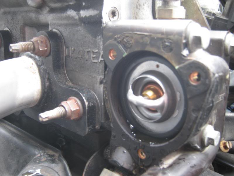

Removed the thermostat yestuirday to see how it run like without it as the water temo does get quite hot so drove the car for 10-15mins, let it warm up on idle for 3-4mins... when the oil was upto 100degrees the water temp was on like 1/4 then when i hammered it it went down to like 1/8... all bled sweet, the heater in the cars alot cooler than it was obviously lol... the annoying thing is the pressure is still quite high on the hoses, like could hardly squeeze the top rad hose when i got back after the bit of a drive :S...
just tested the thermostat in boiling water for 5mins seen no movemenmt in any of it at all so gonna get a new thermostat monday
yeh doesnt look the strongest part tbh, the strut lined up well enough into the new beam anyways....

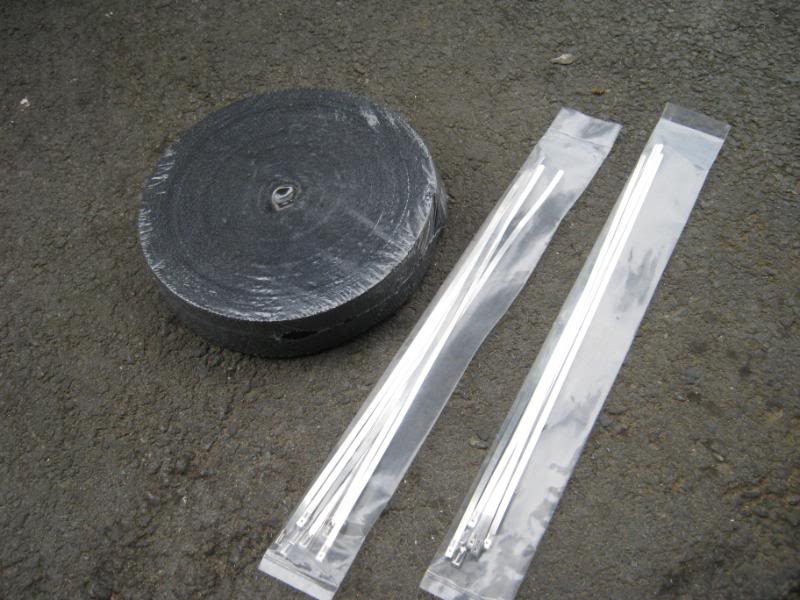

went to collect the 30m of heatwrap and ties earlier -

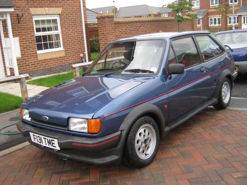

then thought it deserved a quick clean -

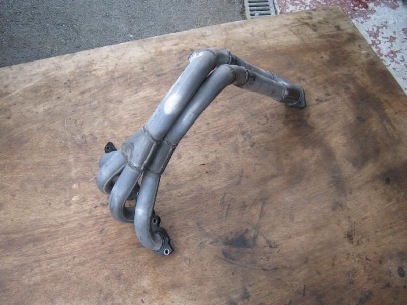

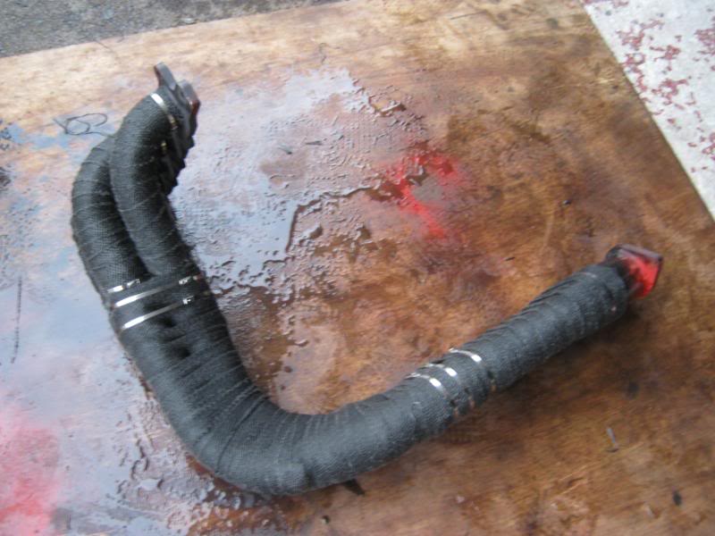

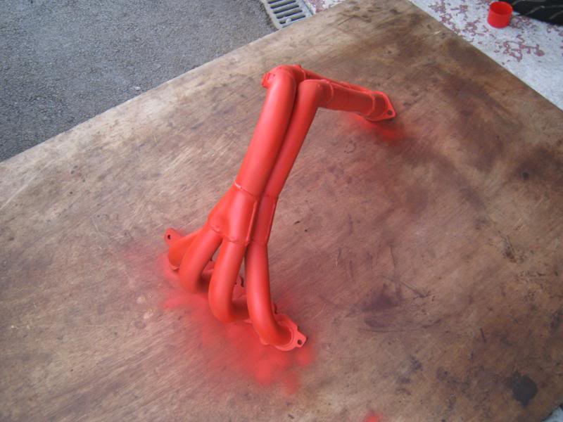

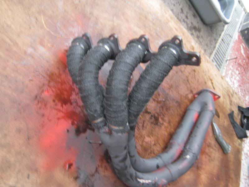

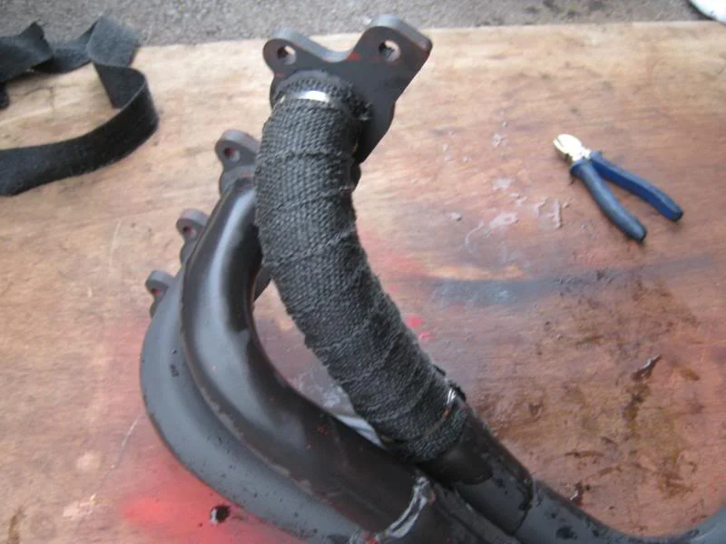

alternator, starter and manifold off...
manifold before -
sanded down and painted -
more paint as i ran out of red -
progress -
done -
arms are itchy as fk now lol

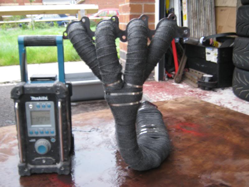

gonna let it mostly dry overnight, then dry the rest tmoz with a heatgun then paint it in some more VHT black
nice work, thats gonna smoke like a chimney when its on....
shouldnt be THAT bad considering how much its dry now, but yeh still expecting quite abit lol
Hows the hand lol
get some of the silicone spray that stops water soaking into the wrap
hurting lol

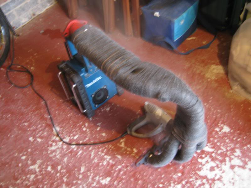

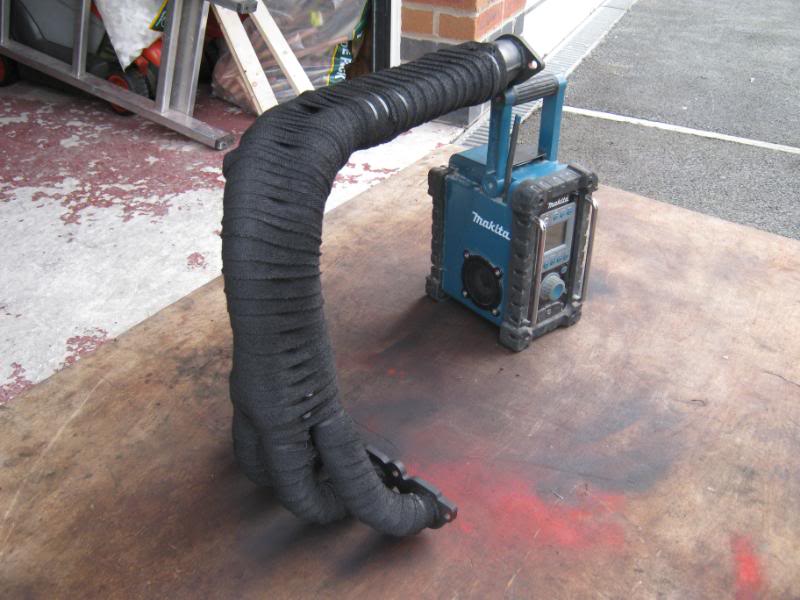

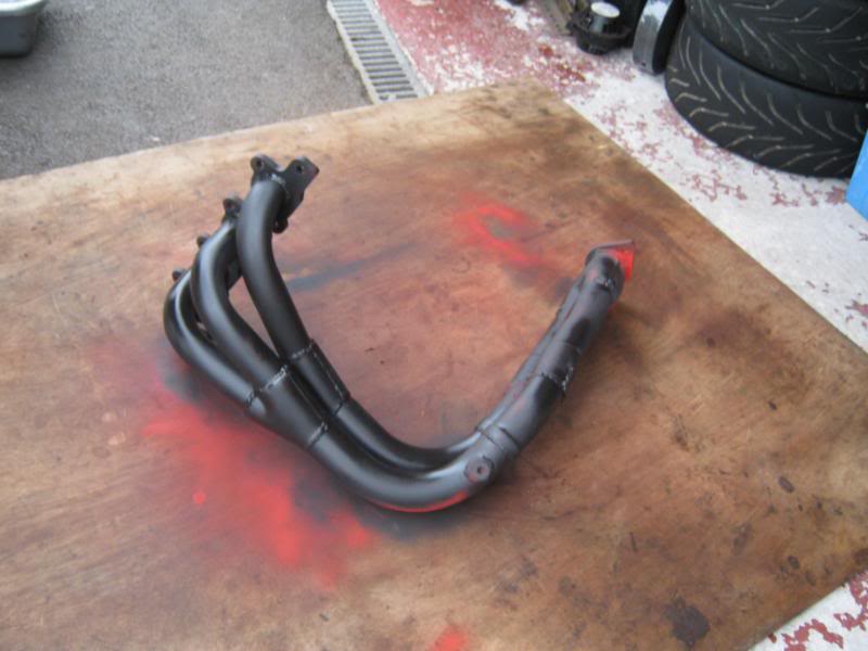

so... after leaving the manifold overnight i spent another 1/2 hour drying it with a heat gun -
painted in VHT black -
manifold, starter and dipstick fitted -
system fitted -

collected the 6pk900 and fitted that and the alternator and started it up, let it running for about 15mins till the smoke slowed right down, i can still taste it now lol!

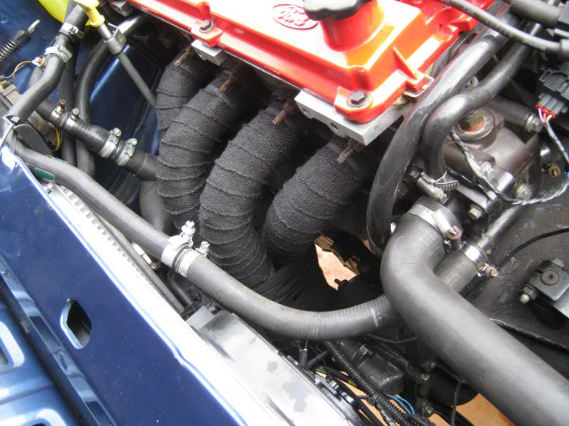

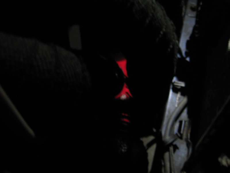

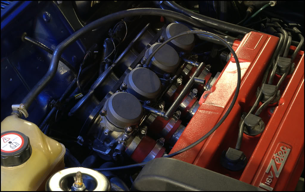

when got back as, i lifted the bonnet as the manifold still stinks from heatwrapping it and i noticed...
This image has been resized. Click this bar to view the full image. The original image is sized 800x600.

I can't tell what you noticed from that pic? My iPhone screen is quite dark though.
Just watched the video though, and Jesus Christ!!! Although you seem to have to rev quite some to get them, which is a good thing I guess for road use.

manifold glowing where its not heatrapped just before the collars
Wrap the whole exhaust and see wot that does lol :rasp:
would but cba, manifold was bad enough
