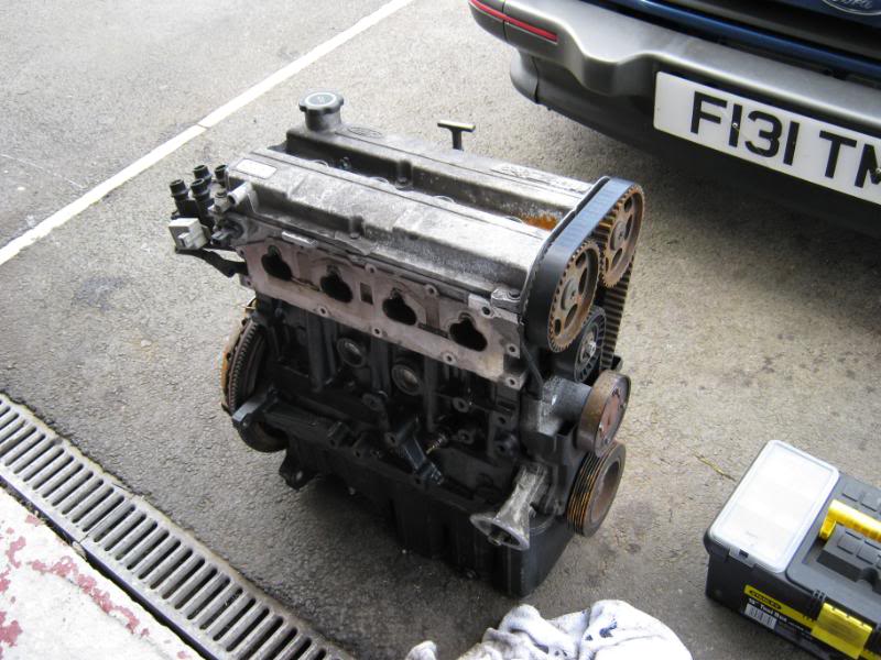

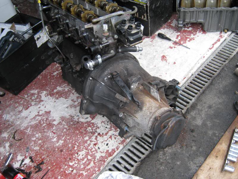

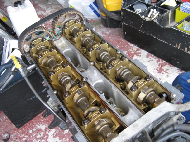

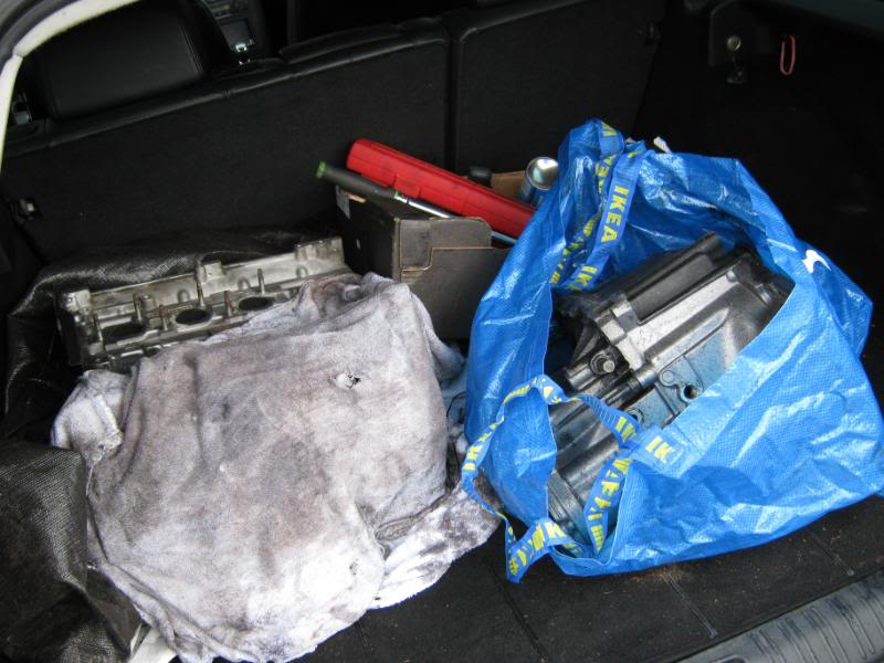

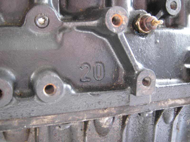

Found a 2.0l Zetec E yesturday, 70k came out of an Automatic too, and already fitted with a 1800 sump and pick up pipe which is 2 out of the 3 things needed to go for a 2.0 over a 1800 :D
So set off at 6.30 this morning and just got back from a 564 mile round trip to collect it, turned it over with a spanner and feels perfect

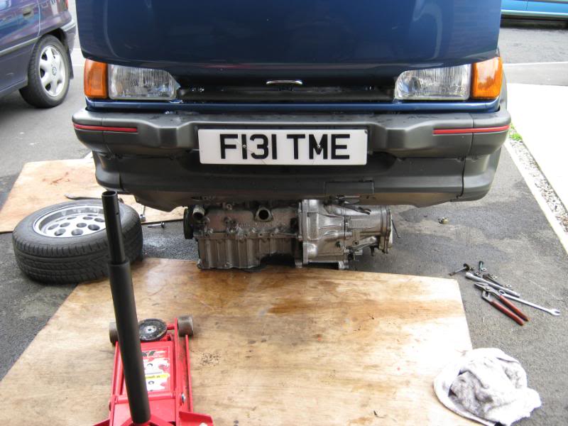

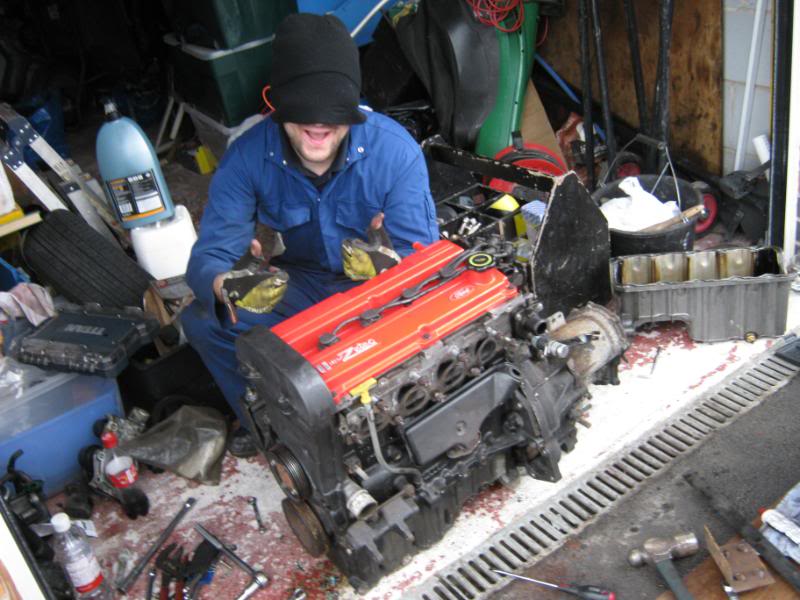

Progress yesturday -
Drained the Oil and Coolant and disconnected all the coolant hoses
Disconnected the gear linkage
Disconnected the track rod ends and pinch bolts
Removed axhaust manifold and system
Removed alternator
Removed the starter
Remived the carbs and inlet manifold

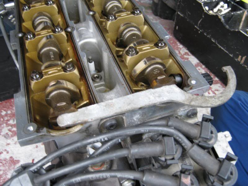

Removed the Piper cams out the 1800
then swapped over from the 1800 to the 2.0l -
Dipstick
Crankcase breather plate
Spark plugs
HT leads
Coil pack
Thermostat housing
Rocker cover

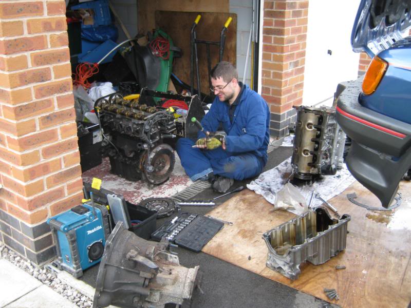

Progress today thanks to f0xy for coming round helping we got the fornt lower arm/ARB off, cradle off, drained the gearbox oil then pulled the driveshafts out and lowered the engine down to how it sits for now till tomorrow as i havnt got any room for it in the garage atm -

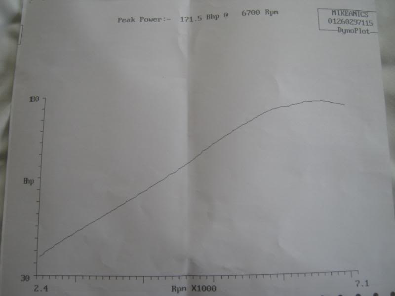

So if the 1800 produced 157bhp what should the 2ltr produce. Roughly?
the 1800 made 158bhp and around 125lbs ft with the Piper 285s... im sticking with the standard cams in the 2ltr for now, should be around the same 160ish and around 135lbs ft

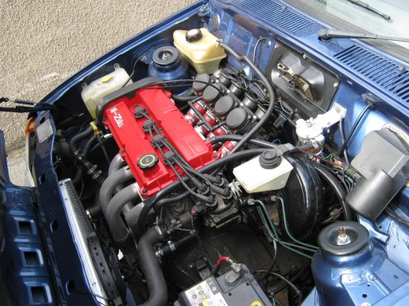

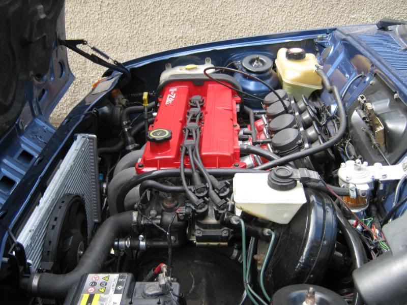

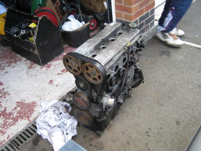

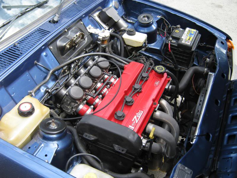

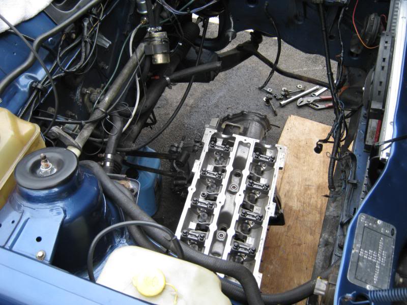

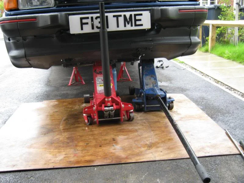

Andy came round around 10ish this morning, so started out by dragging the 1800 out from under the car then , Swapped the waterpump over, all the tensioners and Cam belt, re-timed the cams up too, Lightened flywheel and helix clutch on, then fitted my new box, no lsd but iyt goes into all the gears so win for me, andy put FRST gears into a Fiesta mk3.5 Si box as they're a stronger box than a FRST one (bearings/casing etc) so where here at this stage few pics form along the way -
then lifted the engine up into the bay, who needs an engine crane when you have 2 fkin huge jacks lol -

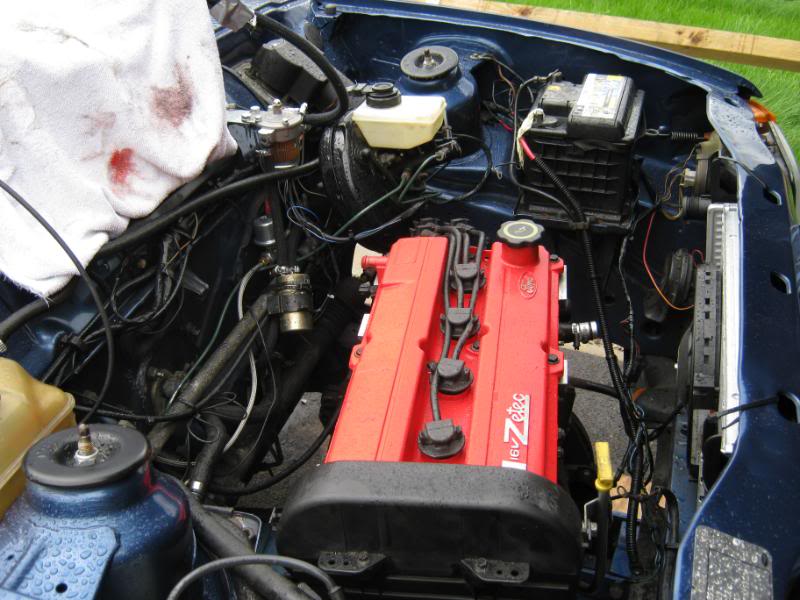

Nearly there -
then fitted everything back together, whilst it started pissing down -
Bye bye 1800 and a Knackard S1 RST box -
Then started it up, and listen to how sweet this sounds, its the alternator whining btw lol -

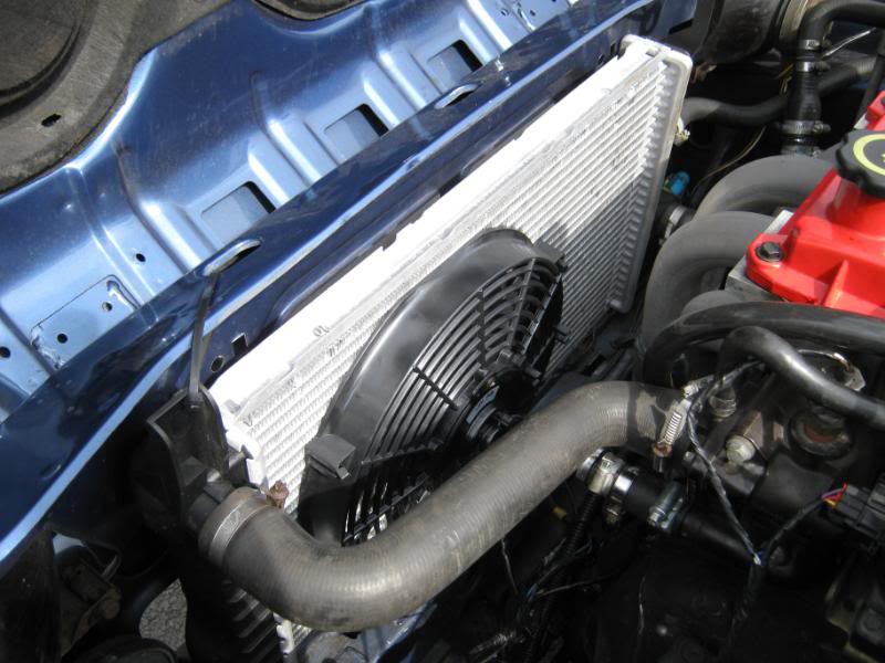

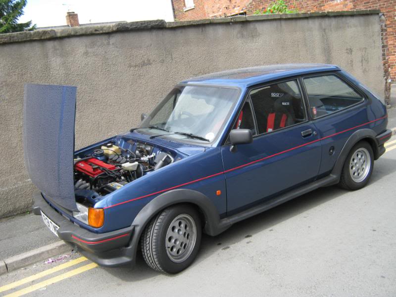

All been going/running well so far until last night, went onto a motorway enthusiastically then follwed a huuuuuge cloud of steam, i thought great.. the head gaskets gone, thank god it hasnt, one of the coolant hoses has slpit that goes to the heater matrix so just a 10min fix, so relieved its not the head gasket.. going to sort that tmoz, going to get a new thermostat too to make sure
Just booked the XR2s first trackday at Oulton Park for next wednesday :D

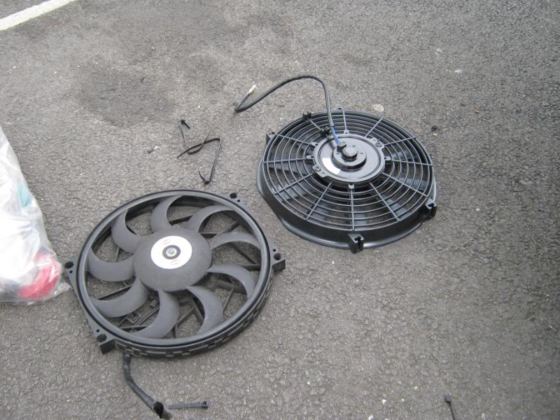

Just bought a new 10" cooling fan too as the kenlowe only pushes and dont think it can be reversed, should be here wednesday.
  JDM Dc2
Went to the scrapyard to get a new hose and been to Euro car parts to get a new thermostat which opens at 88degrees, so hopefully thatll be the last of the coolant problems, all fitted back together and bled the system running sweet again :D
Very bored atm so thought id no an upto date spec list
Engine:
2.0l Zetec S2 Silvertop
1.8l Waterpump, Sump & Oil pick up pipe
Omex 200 ECU
Kawaskaki zx7r 40mm Bike Carbs
Ashley 4-2-1 manifold
Ashley 2" Single box System with 2 1/4" (standard) tip
NGK Platinum Spark Plugs
Yamaha R1 fuel pump
Filter king fuel pressure regulator/filter
XR2i Starter motor

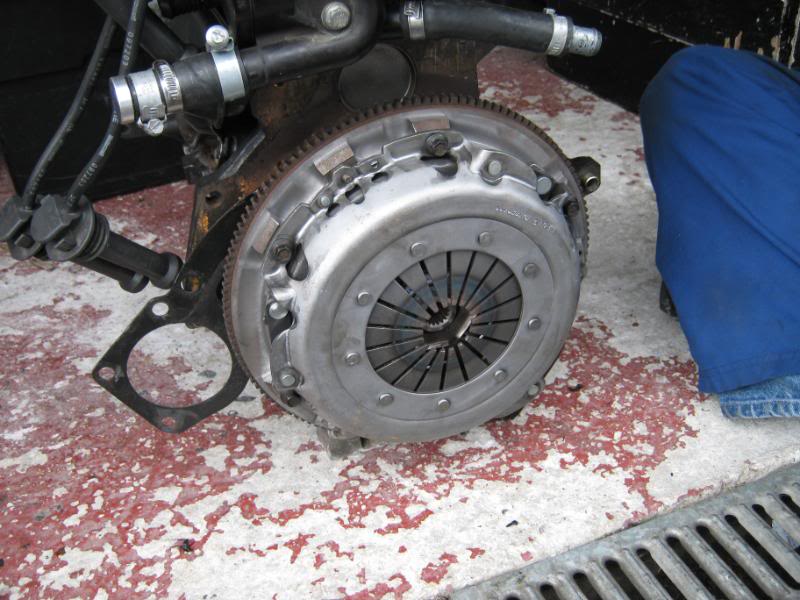

Lightened & balanced 1.8l Flywheel
Modyfied Zetec and CVH coolant hoses

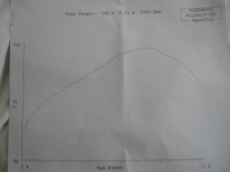

Power - 172bhp & 145lbs ft
Running gear:
Fiesta Si Gearbox with FRST ratios and final drive
Helix Organic FRST clutch
Toyo Proxes CF1 tyres, R888s for track both sets on Pepperpots
Strandard XR2 Calipers and drums on the Rear
Brembo HC brake discs
Ferrodo DS2500 Pads
Gaz Gold Coilovers
Fully Polybushed
Interior:
Fully Stripped apart from the heaters and dash
Sparco Circuit Buckets
TRS 4-point 3" Harnesses
Welded in Harness bar/Rear strut brace
OMP corsica steering wheel
8 ball gear knob
Oil temp. and pressure gauges
Exterior:
Pretty much standard
De-wipered bootlid and taken off the fornt spot lamps

The new 10" coolaing fan arrived earlier so just fitted and made sure it pulls and not pushes lol
Pretty much ready for next wednesday now :D
