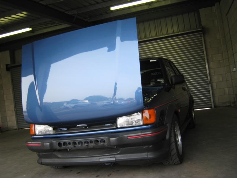

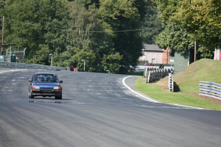

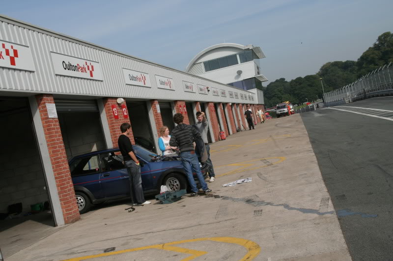

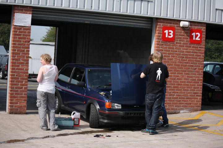

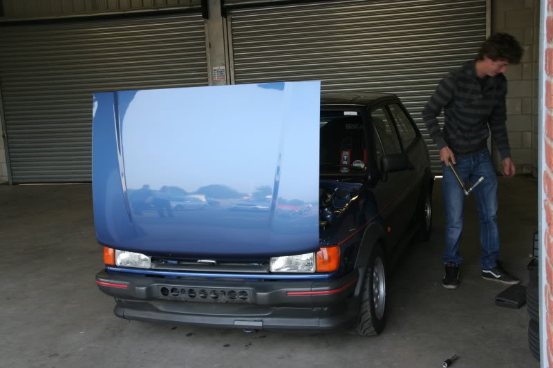

Just got back from Oulton pretty fkin tired altho i only managed to drive around 6-7 full-on laps all day lol...
Went out for the first session Oil got upto 140degrees after 1 warm up and 1 full-on lap, was pretty gutted tbh so i just thought itd be best to come in and let the car cool down and see what it was like next time...

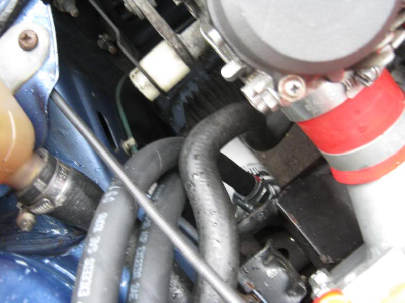

when i came in and lifted the bonnet noticed coolant pissing out all over the gearbox from the thermostat housing, so took the thermostat housing off, re-siliconed the gaskets then refitted it, also whilst the coolant was drained i previously blanked off the bottom part of thje thermostat housing to save running a hose right past the exhaust manifold and to the lower rad hose, but then i thought it could be building up pressure so thought so then as i tooka load of coolant hoses and jubilee clips luckily had a T-piece too i added in that extra hose then bled all the system, happy days no more leaks..
then i noticed oil on the floor.. form where my breather hoses were pointing and kinda pointing towrads the nearside wheel arch, then i looked and noticed oil EVERYWHERE in the wheel arch, was pretty annoyed at this point considering i only done 1 full on lap in the first 2hours of the day,s o then got a 1liter conatiner to act as a catch tank, thanks to mark for that, so that sorted that out...
so after 2-2 1/2hrs of pissing about i headed out just before dinner, but still can only do 2 laps max before the oil temperature was creeping the red on the gauge, so just had to keep doing that all day...
after i came back in after that session looked in the catch tank and noticed it had 1/2 a litre init already after like 2 full on laps, maybe just down to the temp of the oil and how thin it got or what but still 1/2 a litre after 5mins hard driving!?
so as i said only managed probs 6-7 full on laps all day as i thought i wanna drive home tonight so next ont he list is an oil cooler and some thicker oil, thinking of some 10w40 would be ideal...

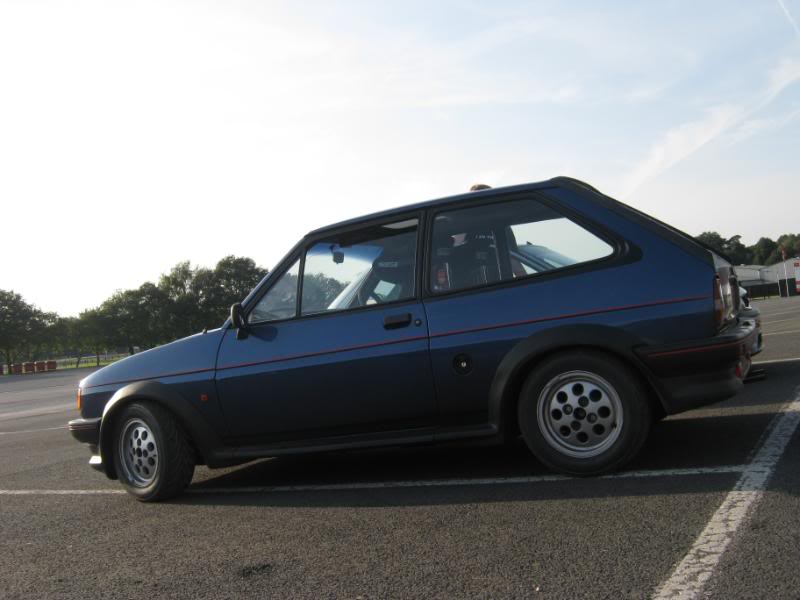

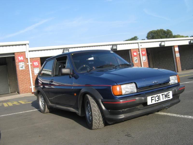

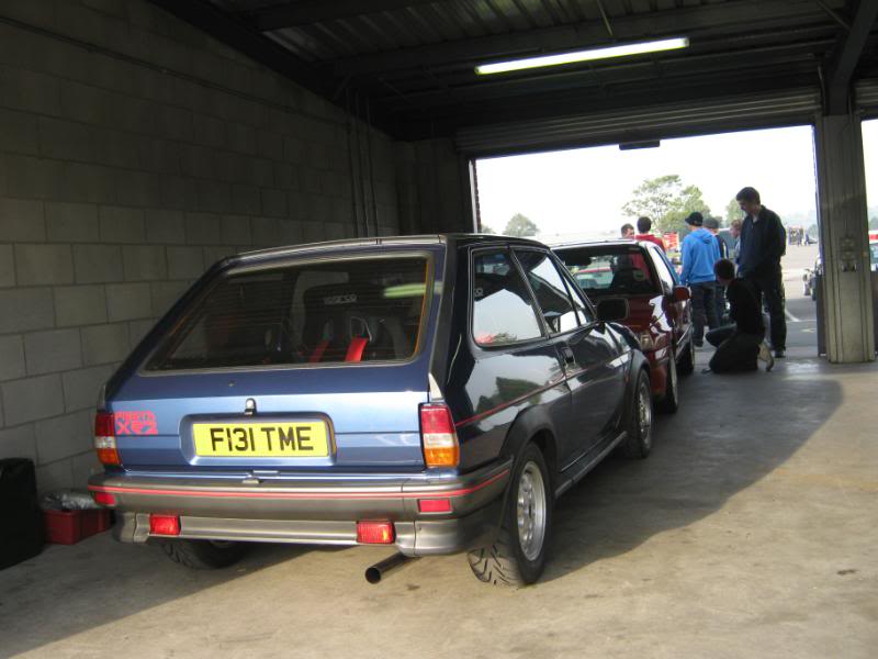

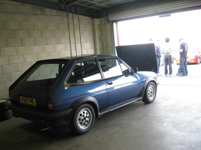

some pics from yesturday -

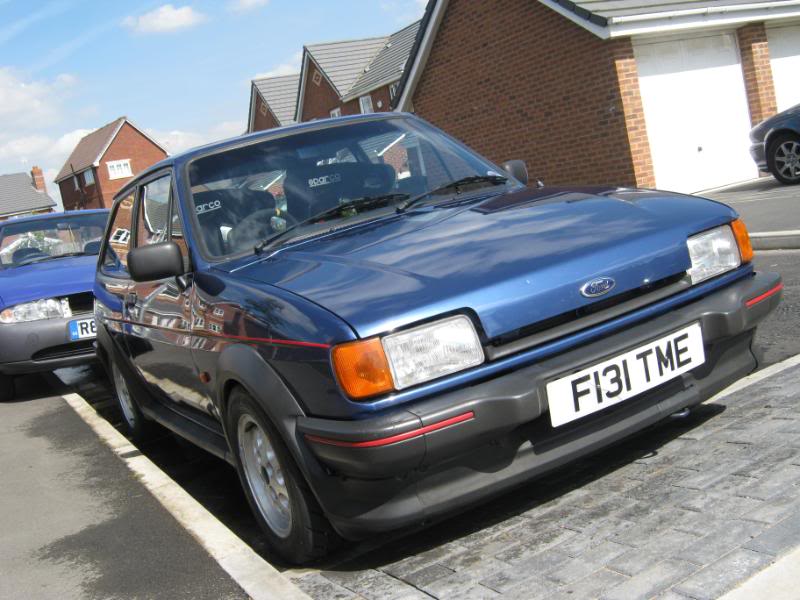

Just found another pic from Wednesday too-

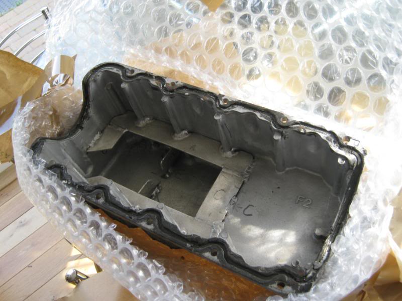

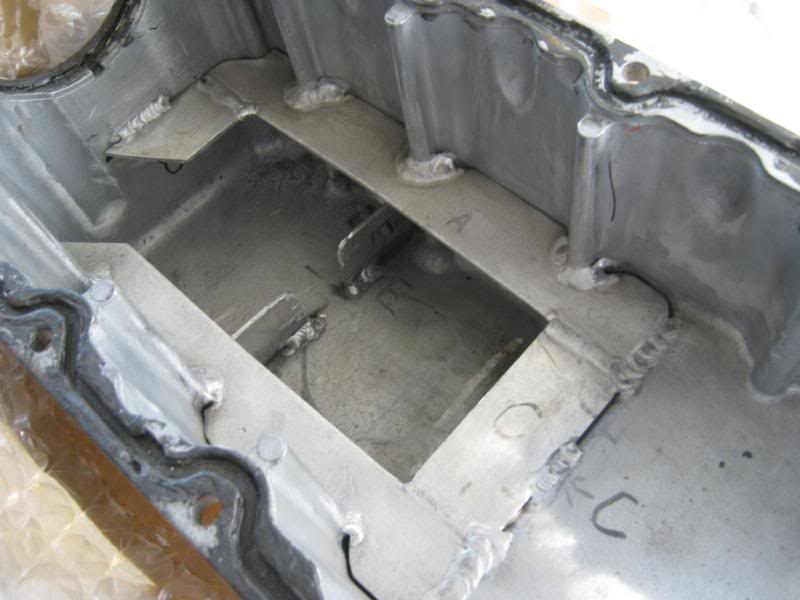

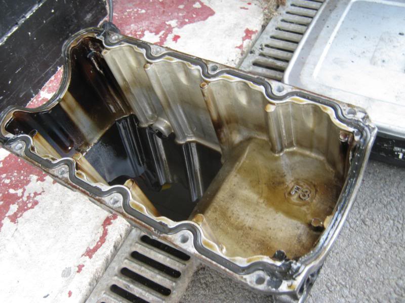

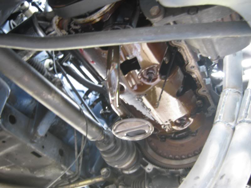

thought id crack on and fit the baffled sump, hopefully the oil cooler will be here soon, maybe even today we'll see...

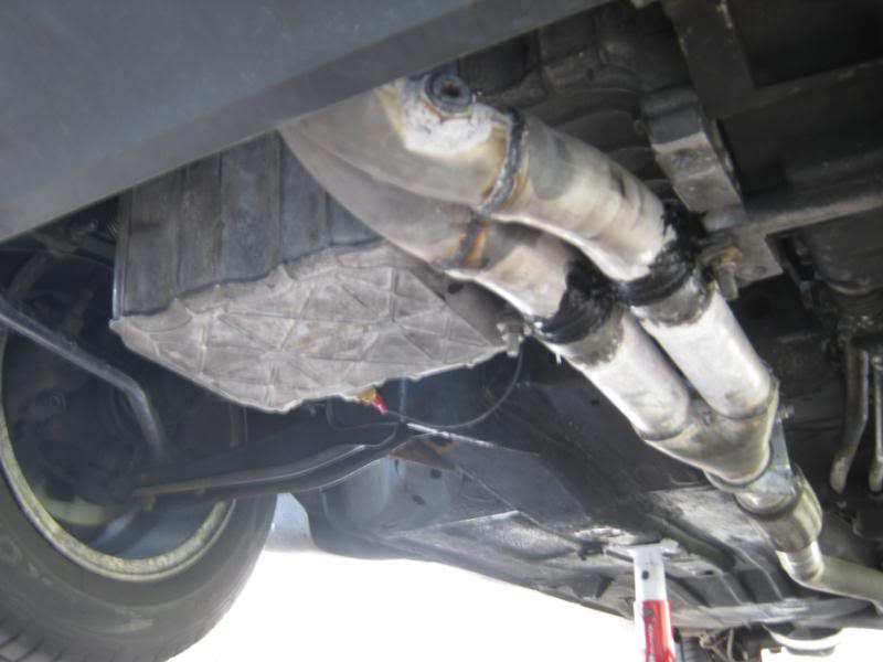

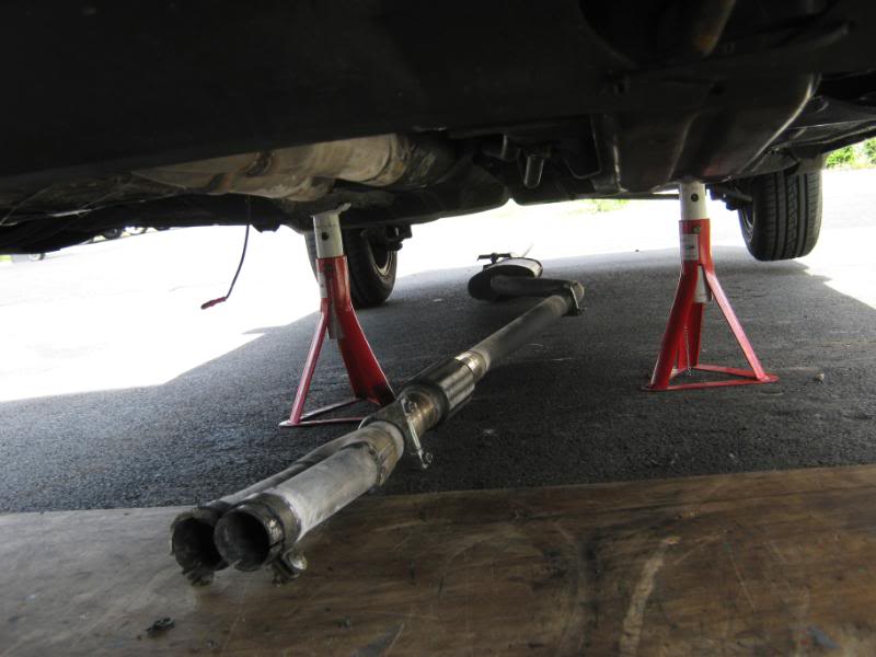

so Drained the oil, then disconnected the exhaust system -
then disconnected the battery and disconnected the starter motor, exhaust manifold then removed the sump -
then fitted the baffled sump which was an absolute nightmare cos of the baffle plates they kept hitting the pick up pipe so i ended up having to disconnect the alternator to get the clearence, all fitted and back together :D-
All done now just gotta wait till the oil cooler and thermostatic sandwich plate arrive then ill fit them...

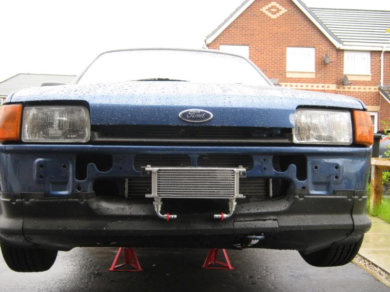

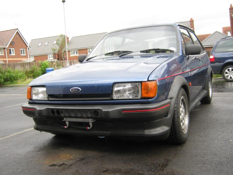

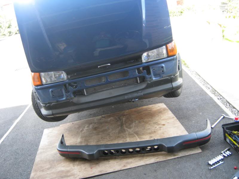

came up with a nice idea of where to mount the oil cooler so ive taken the bumper off ready, i think it looks mean as fcuk without it haha -
about as much as i can do for now :D

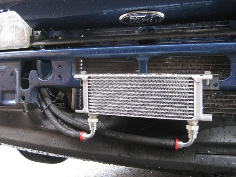

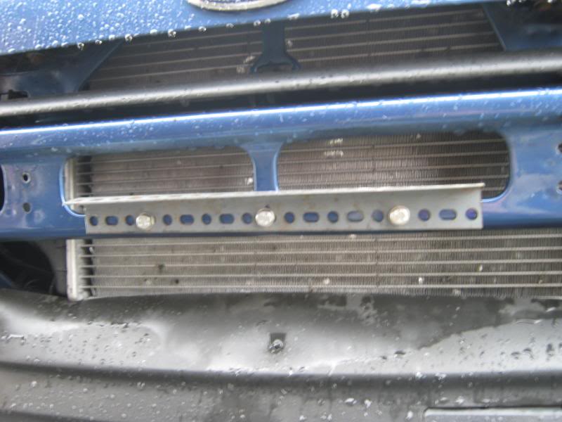

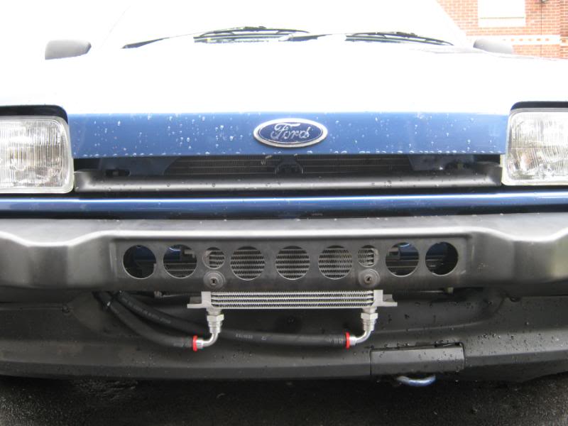

Picked the oil cooler up last night so managed to get it fited whilst dodgeing the rain earlier...
so take one piece of meccano -
One 13-row oil cooler -

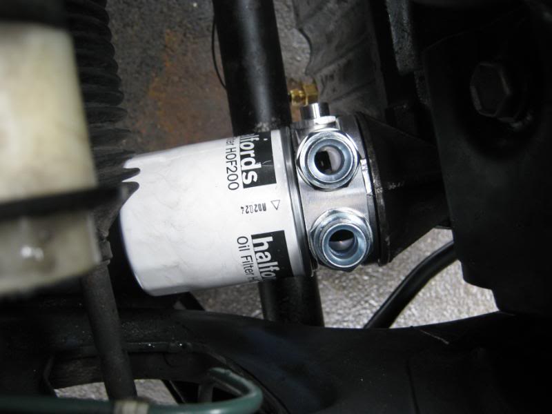

Sanwich plate and new CVH oil flter fitted -
piped up, was a nightmare but got there in the end with pushiong the fittings on once putting them in boiling water -

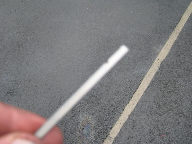

Then started the car check the sump gasket and all the fittings etc etc, not one leak im proud to say altho when i started the car there was a loud ticking noise and all of a sudden the dipstick shot up, so pulled it out and it was bent at the end and mustve hit the baffle pplate and was fouling the crank when the engine was running, so chopped abit of the dipstick off so not i have no dipstick below minimum lol -

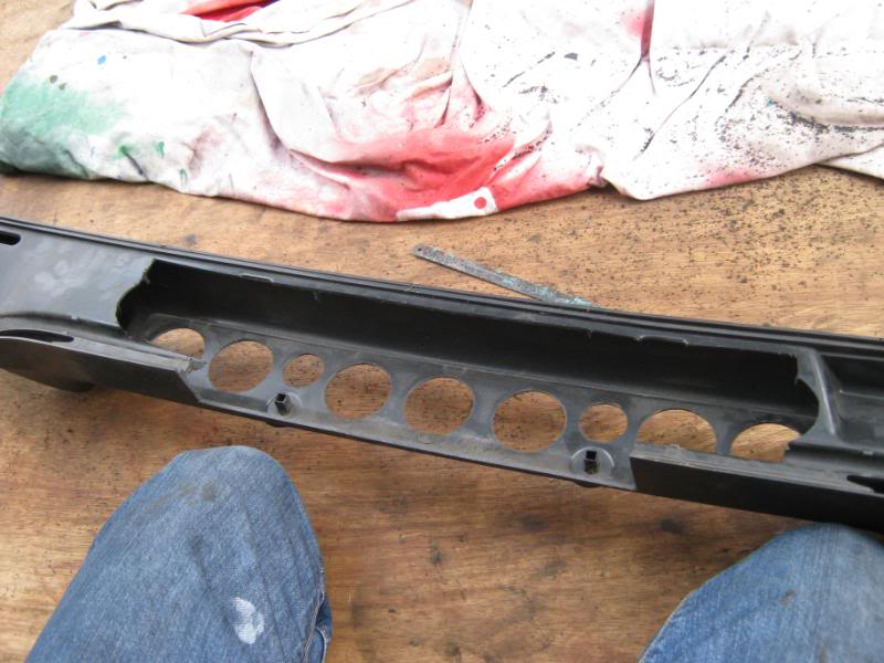

then chopped the rest of behind the bumper out using a hacksaw blade -
and how it looks all fitted and back together -

Cool looks good, you had chance to drive it yet mate, has it made a big diff with the oil temp?
So when do you think the next trackday will be
we still have one easytrack credit left too
well consdiering your the only other person who has one credit left we kinda need to discuss it dont we lol... have you thought about it yet, ive not tbh, just looked on easy track, oulton 20th November is the only one that catches my eye as ium sure Jord said Donningtons fully booked but the sites not been updated... think id rather just do oulton anyways wanna get one full trackday done out the way so i know i can trust it really so think it'd be best to do oulton as its so close and everyone can come down to watch too if they wanted...
Is it better with the cooler on?
yeh

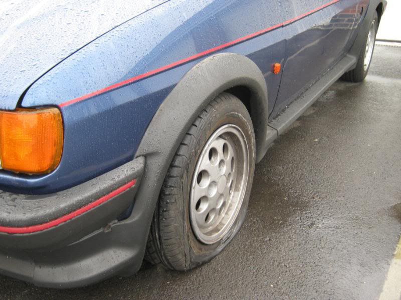

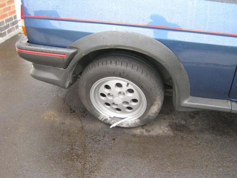

had some major bad luck tonight...
going down a dual carriage way braked for the roundabout and locked up, so i lifted off to stop them locking up to try and free them and they stayed locked up couldnt do anything about it and just slid into the kerb on the right then kinda bounced to the other side of the road, hit that kerb then went into the kerb on the roundabout
really dont see how the brakes locked up and wouldnt free up thats the scary part, a mate recons its cos i never pressed the clutch in and the box locked!?
oh and to make it even better car overheated too at the same time f*ck knows how or where from just coolant pissing out everywhere when i eventually came to a stop
fkin heartbroke to say the very least
damage from looking in the dark atm looks like -
bent rear beam
maybe bent arms and panrod bar
one pepperpot complete mangled
2 tyres fked
maybe the offside rear shock bent
just hope to god theres no chassis damage again
will post up some pics tmoz
