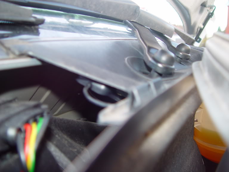

Justin182 said:
Works well here too....
Strange that works as it doenst look like its getting a clear view of the sky... looks like its completly covered by the skuttle panel ?
^^^ The signal can pass through plastic no problem, so its still getting a good view... if not perfect. It doesnt do so well with metal and hence why it needs be near the windows.
I have had it there since i got it almost a year ago and have never once lost a signal except for tunnels and next to tall buildings.
Thx, didnt know plastic didnt affect the gps signals.. getting a RA2 soon so that is where ill put he antenna..
