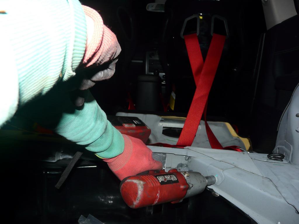

Well that was interesting, it took all of 30 mins to fit the rear in total. Really easy, much easier than the Clio infact.... Took a few pictures along the way,

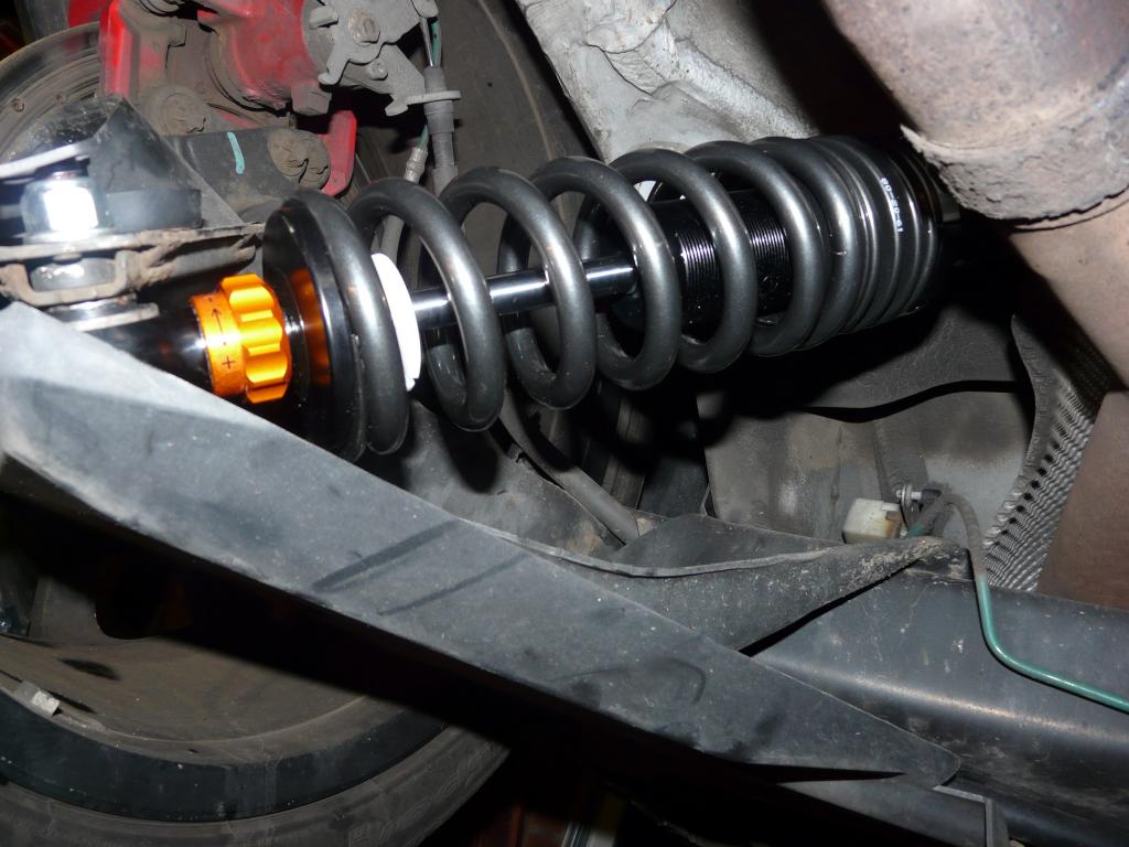

Only two bolts hold the rear shocks on, one on the chassis leg inside the boot floor......
image_zpsb74f5e65.jpg[/URL

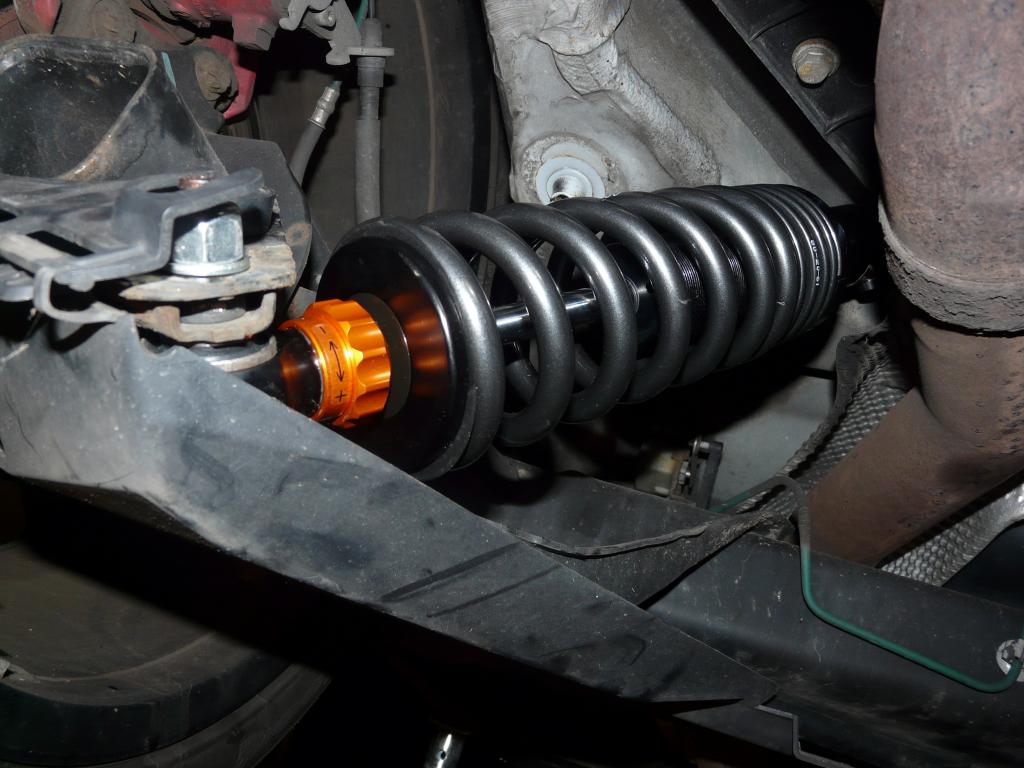

and then on on the rear beam.....
really easy and and pretty effortless to remove, no bolts were seized or even remotely stuck so everything came off relatively easy. So the standard dampers which have a separate shock and spring are replacer with a complete coilover unit, looks a million times better and hopefully the handling will be the same :)

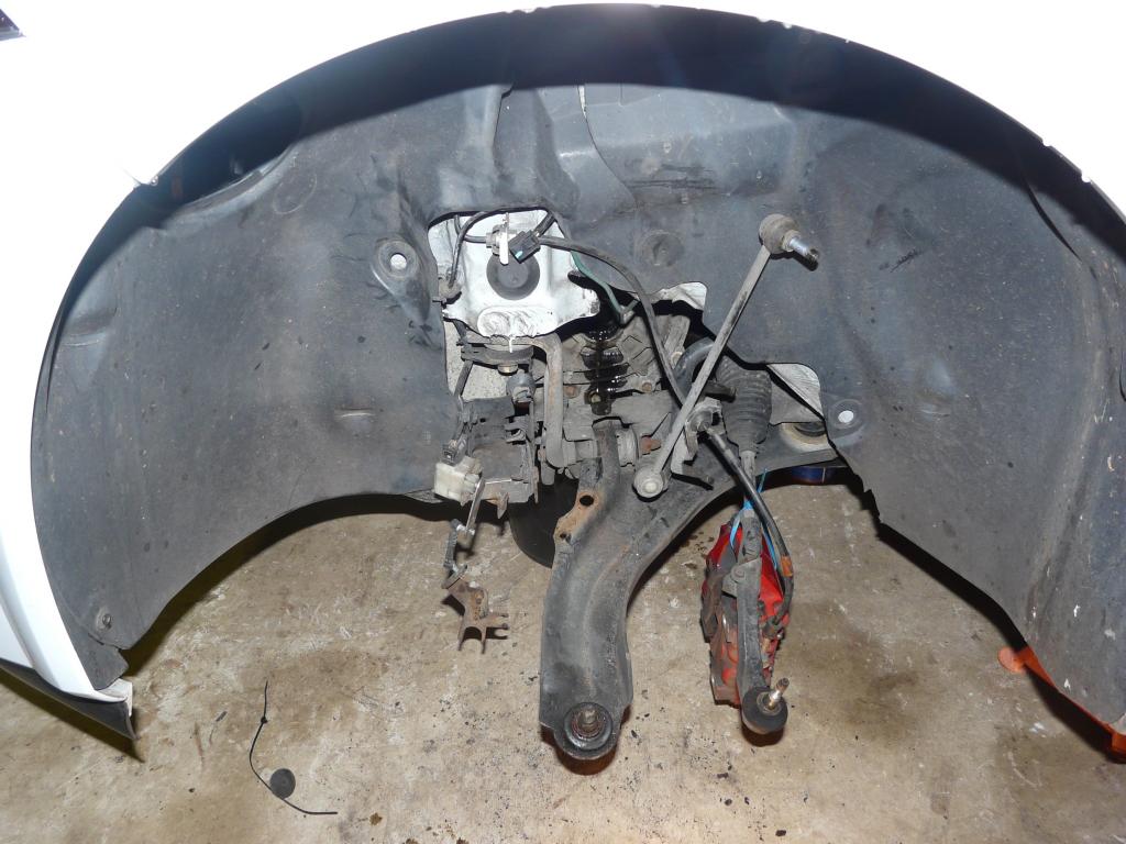

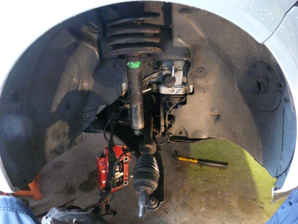

With the rears done we then moved onto the front, thought it would be a nice simple job same as the rear..... How wrong were we. Virtually everything has to come out. But yes of course there had to be one little thing stoping everything else from being removed >>>
[url]http://www.k-tecracing.com/show_product.asp?id=4651&appid=12

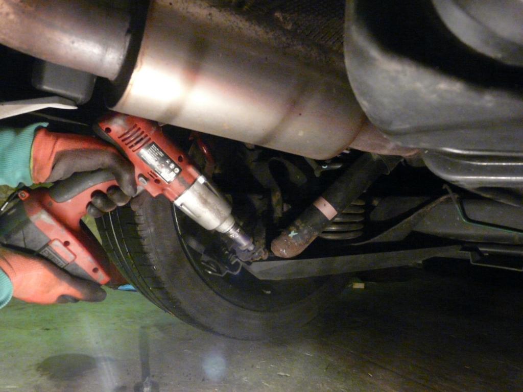

there are two drop links on either side, the drop link that goes from the ARB to the shock was very easy to remove, the stabiliser bar (as shown in the above link) were very tight and seized in. So after 90mins of messing, buzzing, hammering, we gave up for the night. I'm sure the neighbours didn't appreciate the buzz gun still going at 11:30. So we shall carry on tomorrow hopefully with abit more luck.
Yep, might be good for handling... but terrible to work on. Did that but the issue was the joint spinning, plus it doesn't help when the torx bit snaps off in the thread so you cant even hold it still to undo. Rubbish
We will be using a grinder later next week. Just about to order 2 new stabiliser bars so I can just replace those old ones.

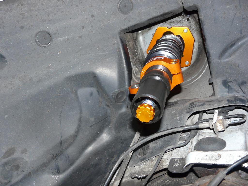

Well after fitting the rear shocks lat night and "attempting" to fit the fronts at silly o'clock last night. We got started on the car around lunchtime today. Still faced with the issues of removing the stabiliser bars. Anyway we got there in the end, it's been a lot of effort to get the front apart and back together but it's near enough there now. Few pictures from along the way,

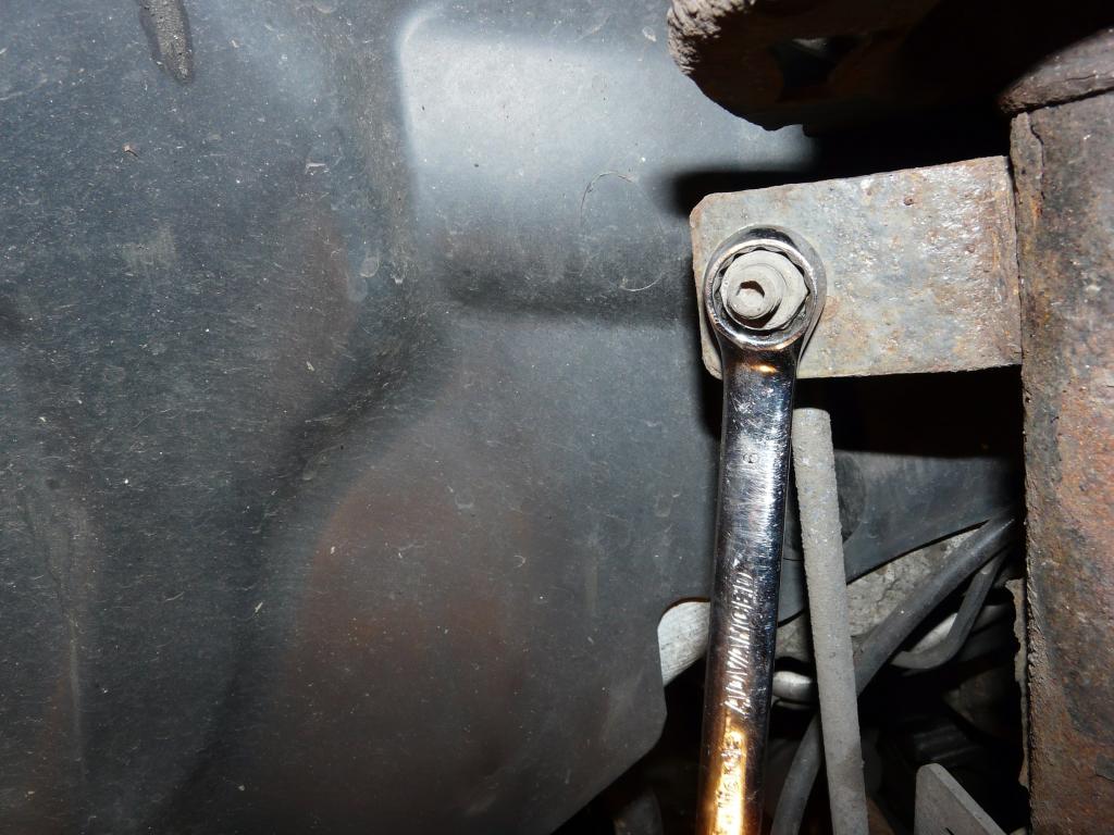

first up up was to remove the drop link that connects the anti roll bar to the shock, easy enough with an Allen key and a 16mm spanner.

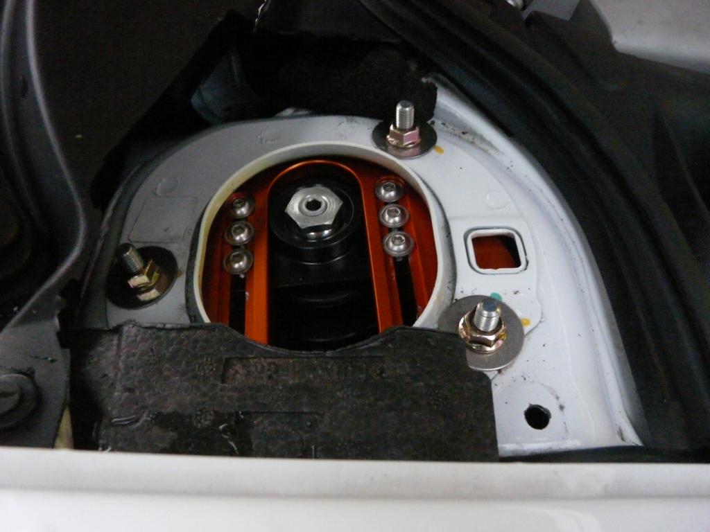

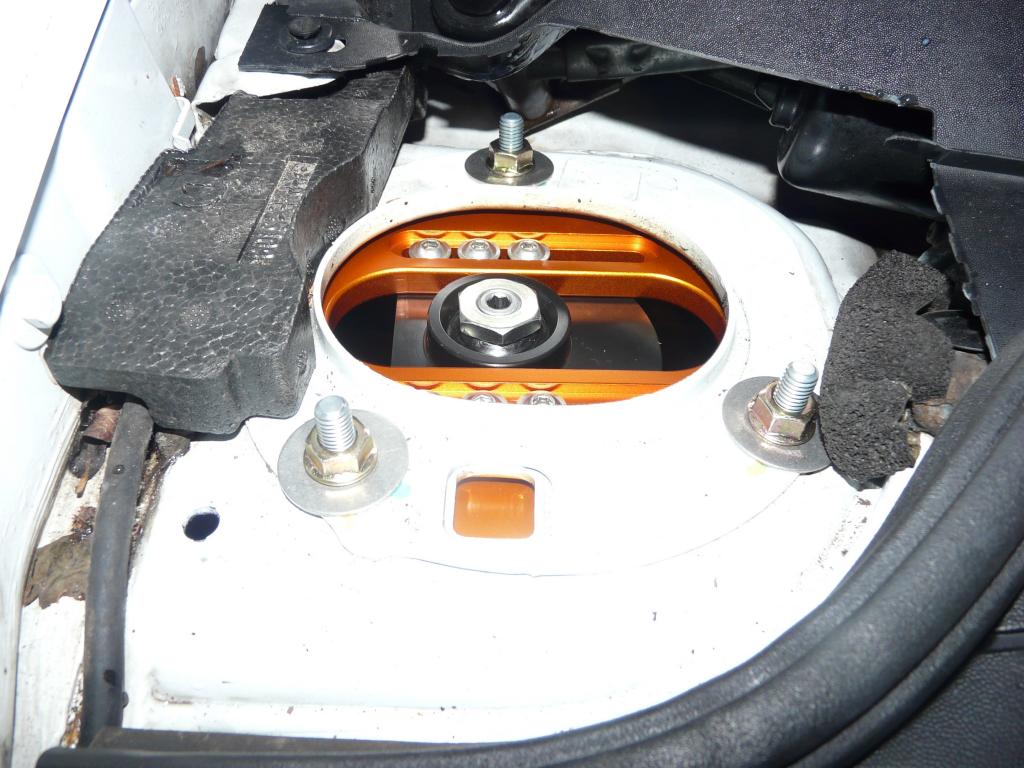

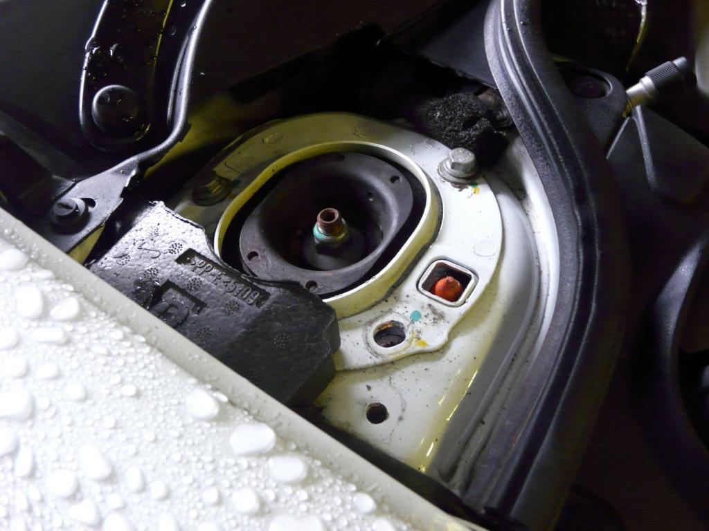

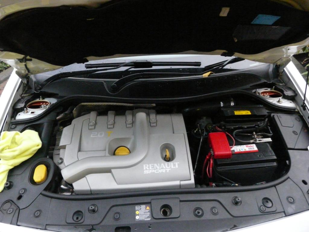

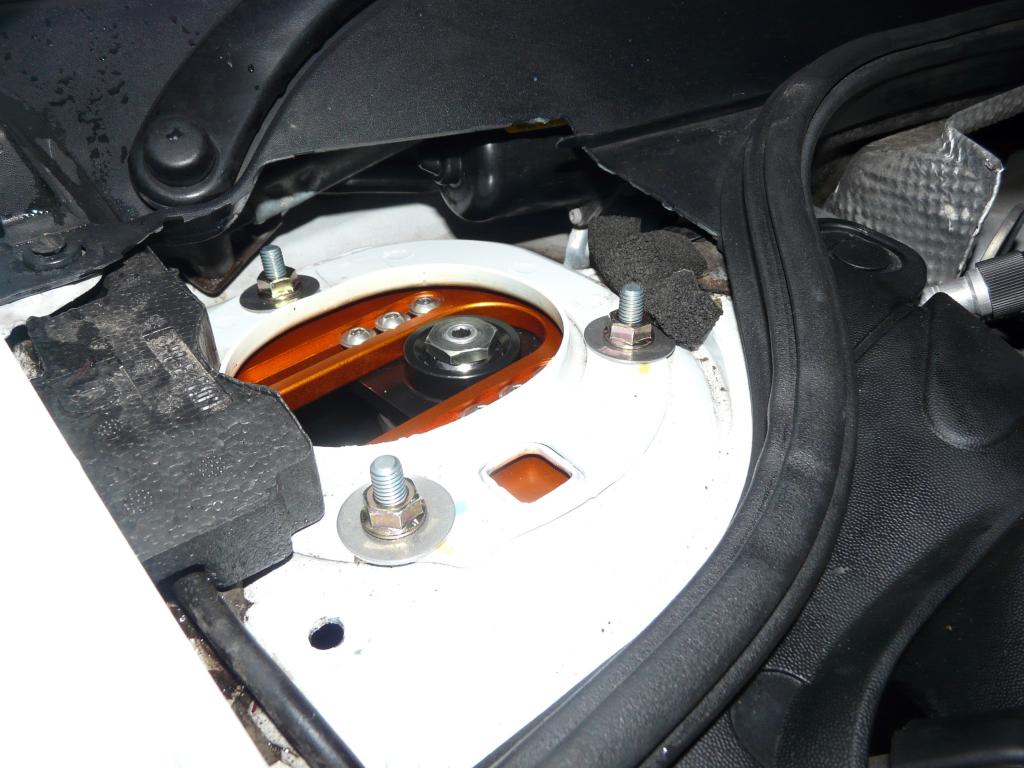

then removed the three 13mm topmounts bolts

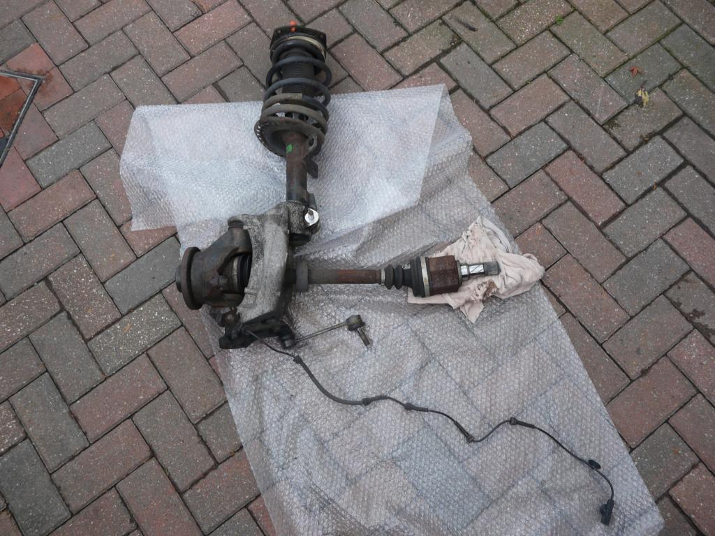

We then removed the stabiliser bar by using the buzz gun and a pair of grips as they were a total nightmare to remove. Then removed the track rod end, and ball joint nut, removed the pinch bolt from the hub and slid the hub off the shock and off the car.

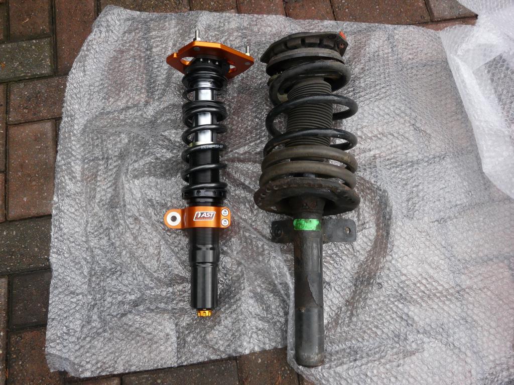

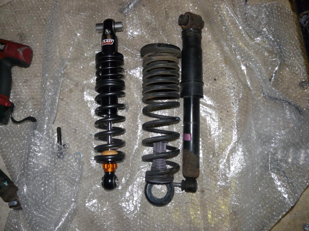

the standard shock vs the AST coilover unit

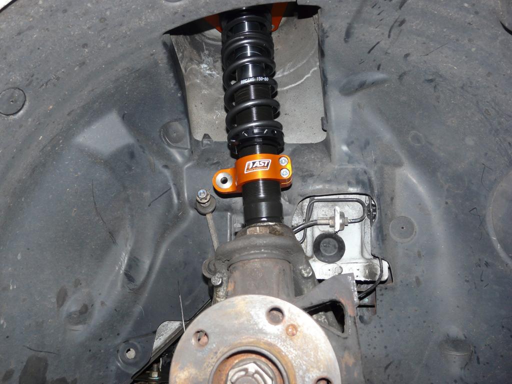

then just assembled in reverse order, put the shock upto the strut to and tightened up the three m8 bolts
then re-fitted the hub, stabiliser bar and track rod end

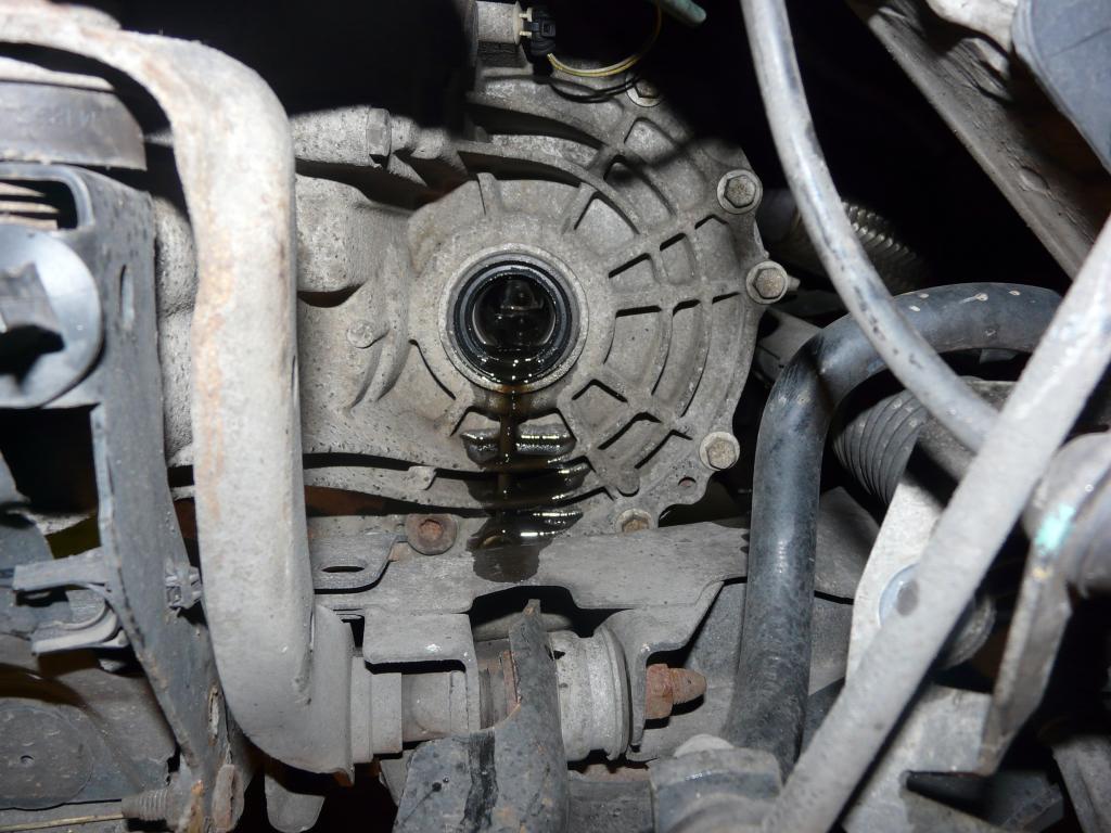

the drivers side seemed to come apart very easy once we got going, so we thought happy days, only take an hour or so to do the other side, as with all Renaults nothing is ever that simple lol. After finally removing all the stabiliser bar from the other side, disc, calliper, track rod end ect, we were unable to remove the driveshaft from the hub whilst it was in the car. So we decided to drop the gearbox oil and remove the shaft from the box with the hub all in one go.....
with everything removed
and then after many hours messing about we finally got everything together. Still need to replace the two stabiliser bars which I've ordered from ktec and re-fill the gearbox oil with this

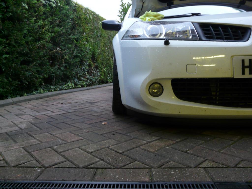

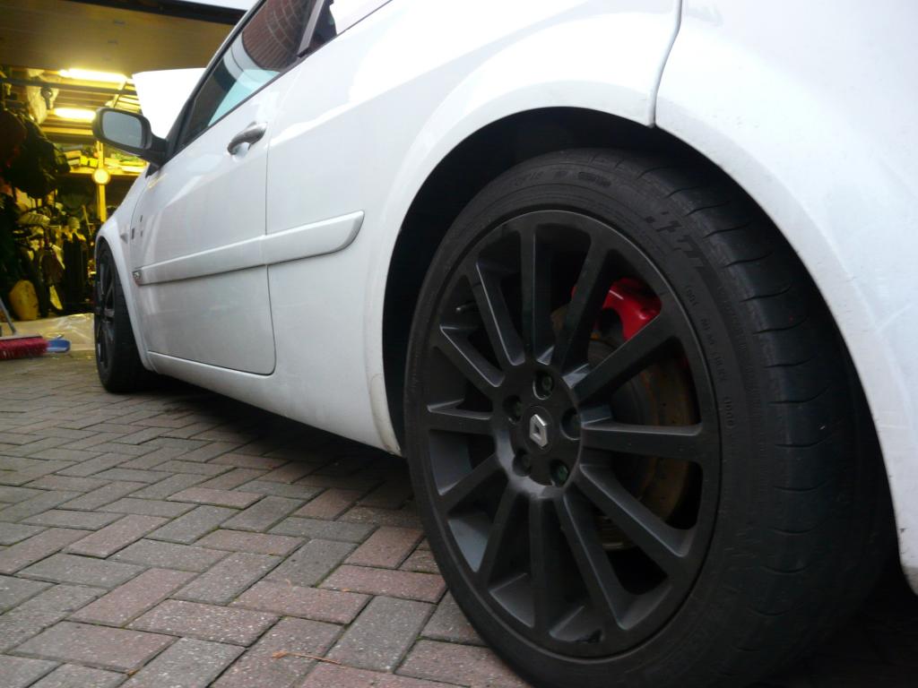

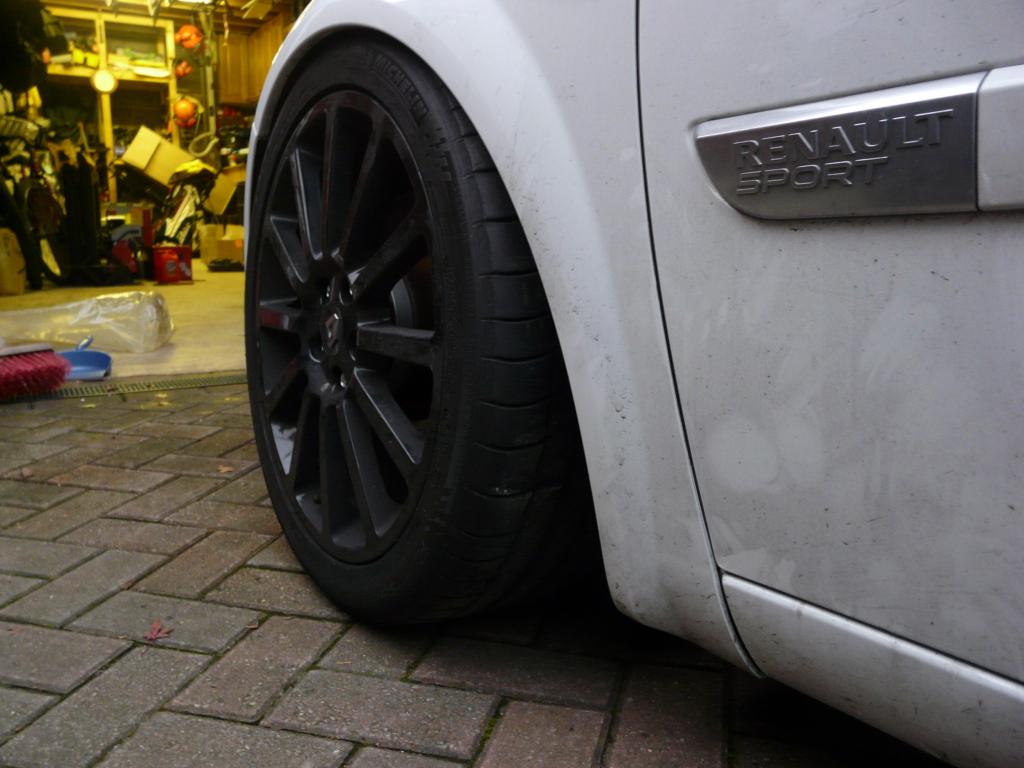

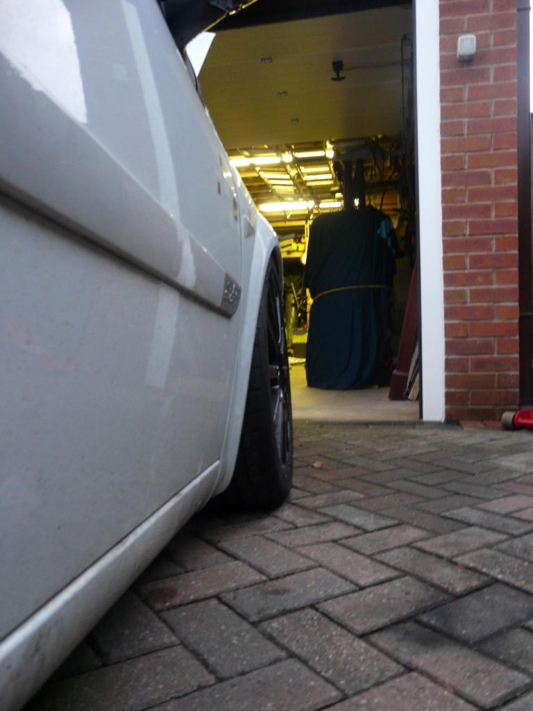

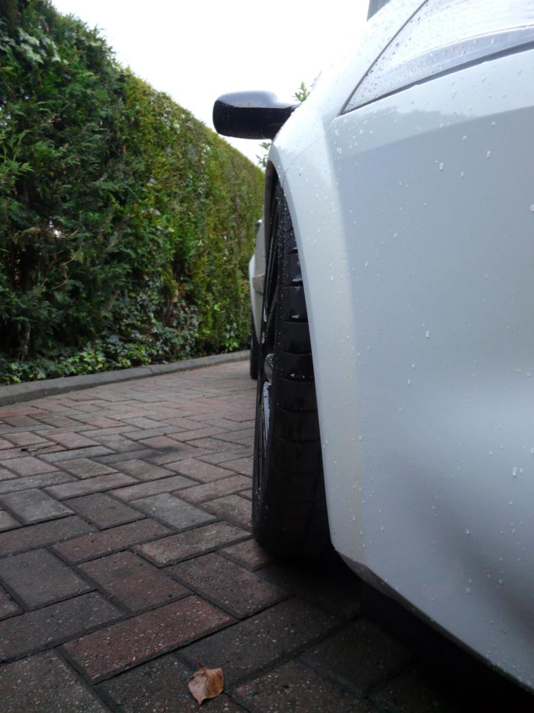

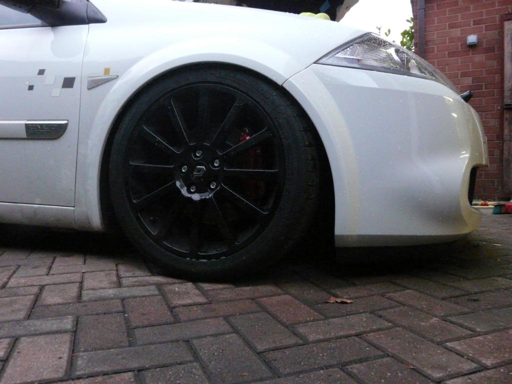

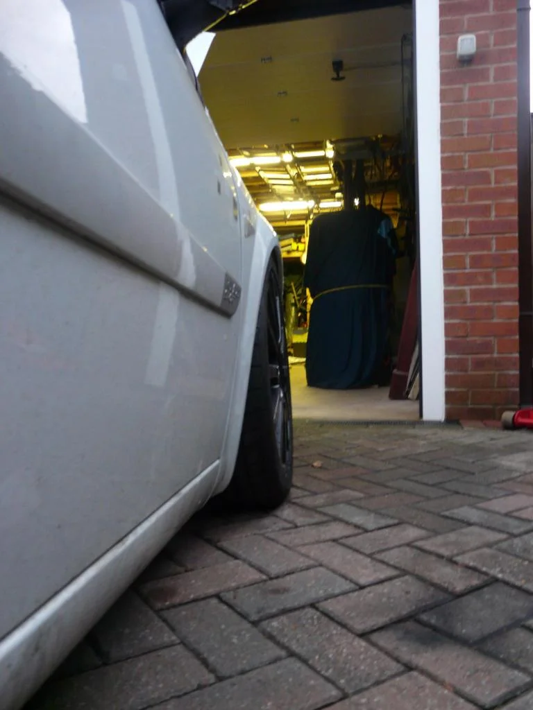

And finally a few pictures once everything was on and back on the floor, the height still needs adjusting as it's too low on the front Nd too high on the rear. Also fitted the 19mm spacers onto the front aswel, really love the way it looks in the photos but sadly it's just too low and too much camber :(
Camber.....
