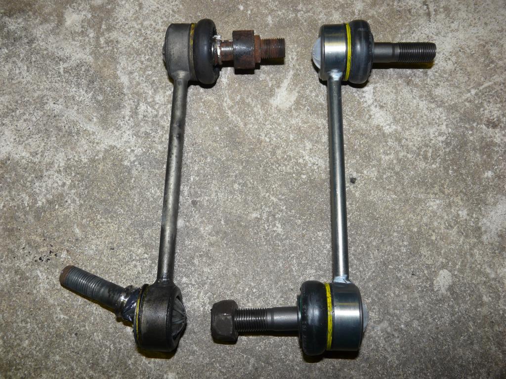

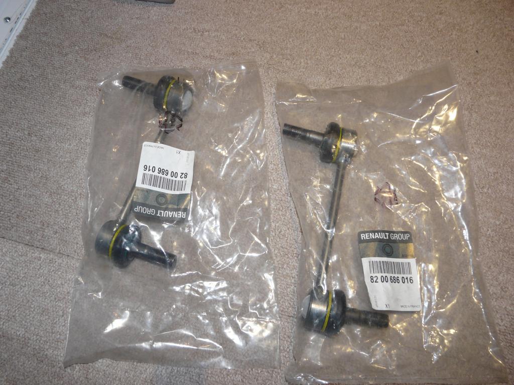

simple enough job, with an oil pump as there wasn't a lot of room to fit a hose down from the top so just pumped it in :). And finally the stabiliser bars from ktec turned up today aswel. So fitted those at the same time, easy enough job to fit cut the boots off the old bars, held the thread with a pair of grips and buzzed the nuts off :) then used a load of copper grease to stop them seizing up if they need to be removed in the future :)
certainly don't look like £112.08 worth of stuff, total rip off.... And the old bar compared to the new :)
