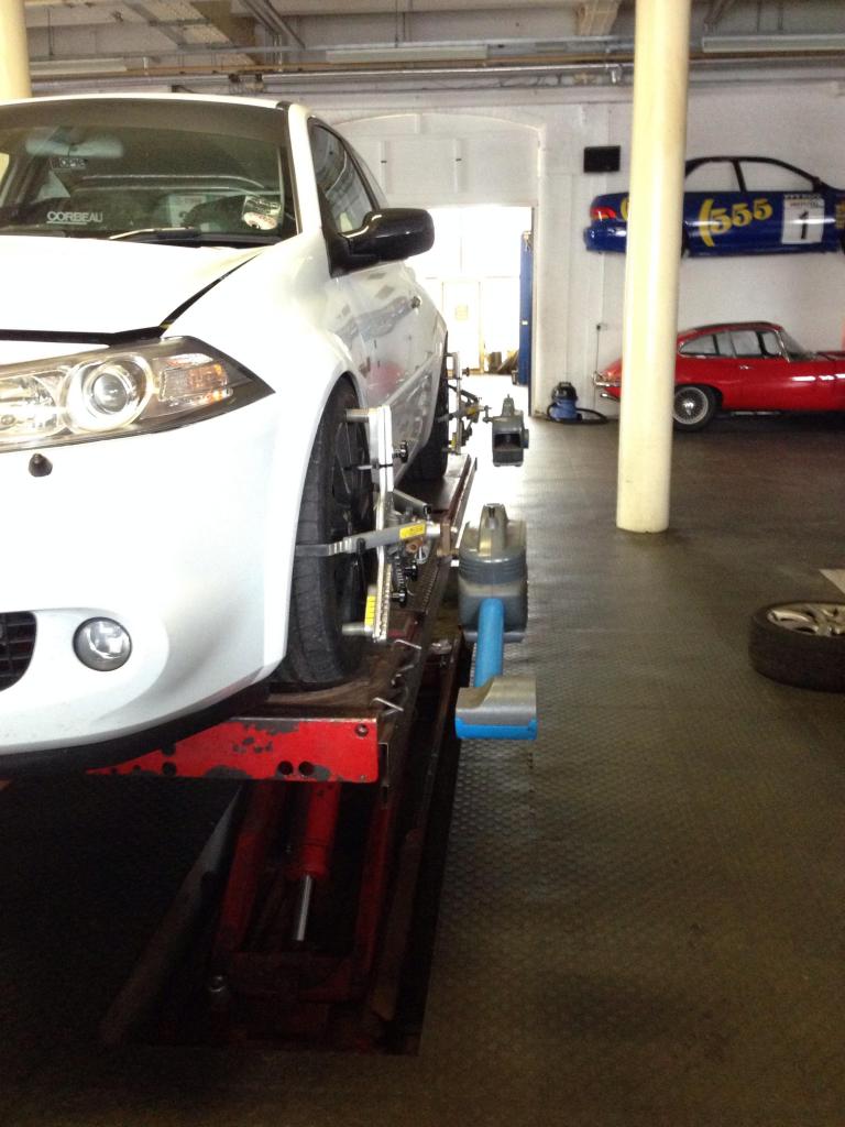

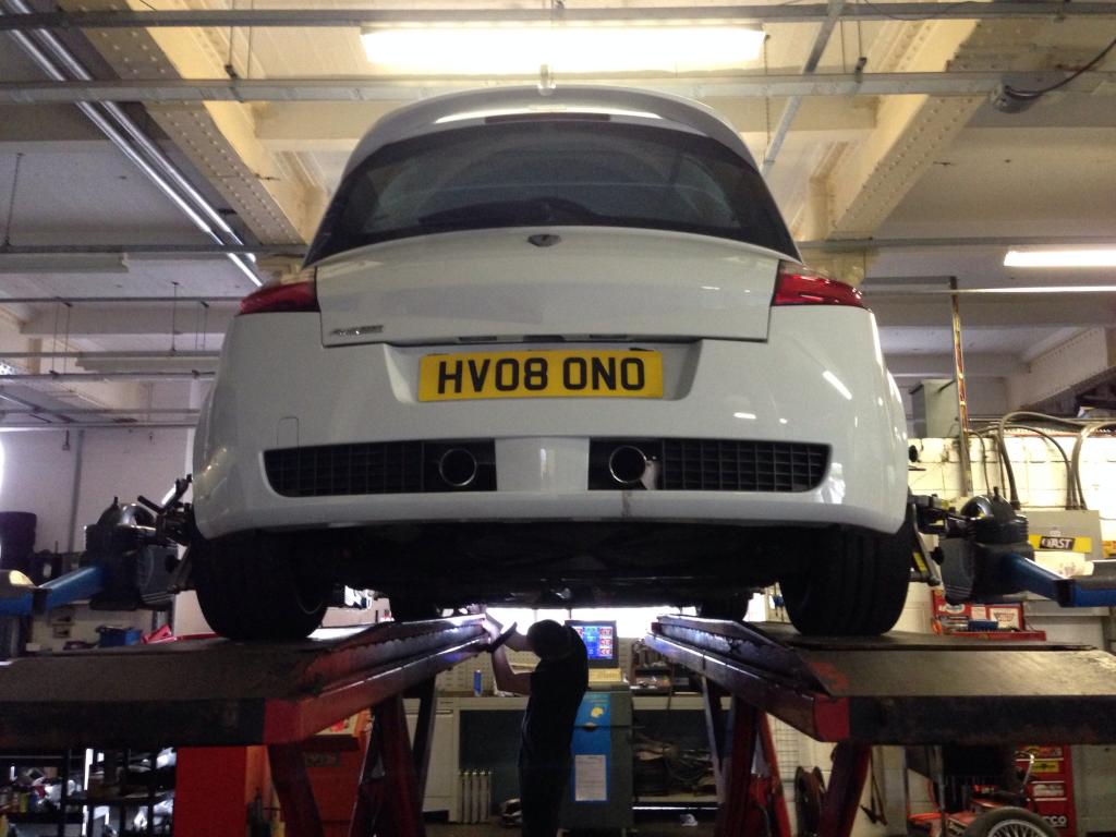

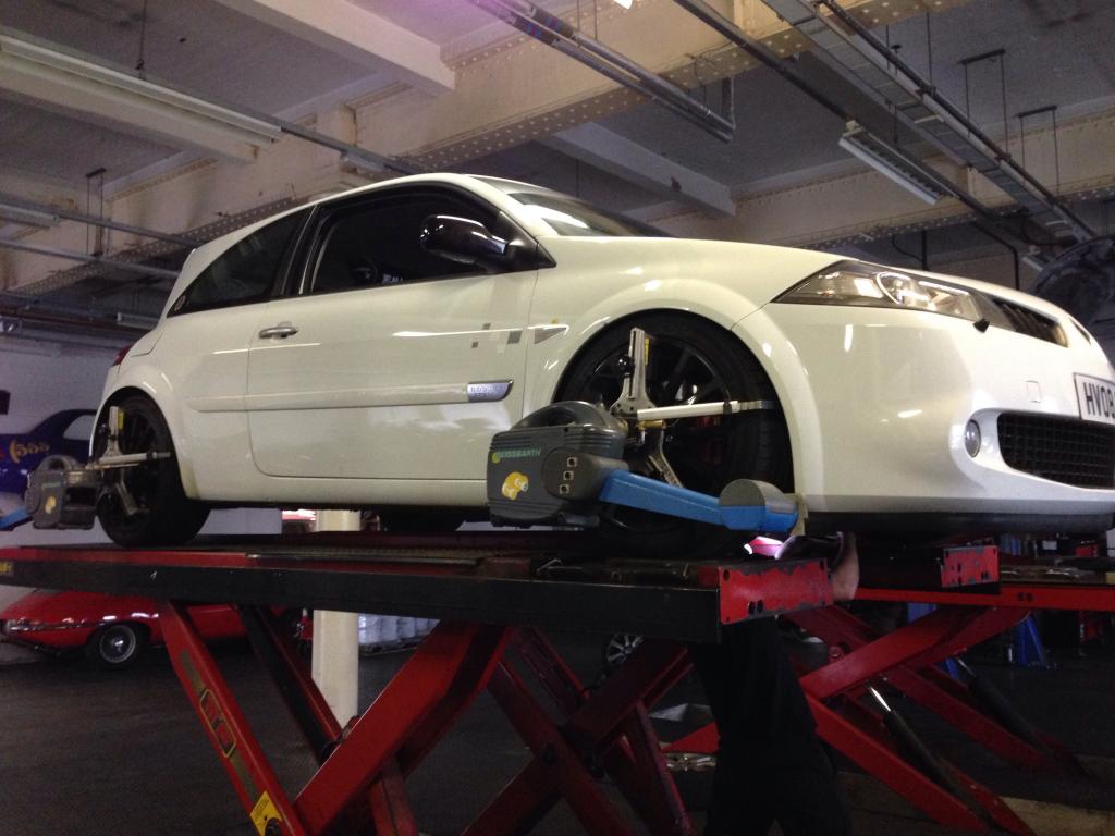

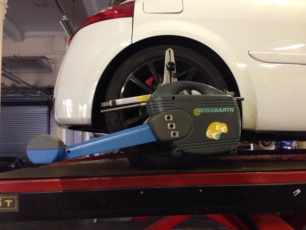

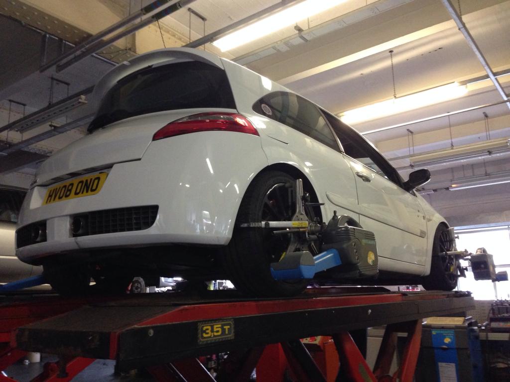

Not been on here for a few days, been abit busy. So last Friday I was booked in at AST to get the right rear shock sorted out and have the car set up. Was an early start to get down there and took about three hours with traffic. Anyway I arrived, had a brew and a chat to Curtis and James, within no time at all they had the rear shock sorted. One of the washers that seals around the damper adjustment knob had gone faulty, so that was sorted. Had another brew, whilst they waited for the ramp to get the car alligned. Only took a few photos on my iPhone but here they are whilst it was being set up
managed to get it all set up with no issues. it's been set up with 3 degrees negative camber on the front and 6mins toe out :). All in all I'm very happy with it now, not been able to really test the car on the road yet but it feel amazing. It's abit of a handful to be driving in the road with the toe out as any sort of groove or off camber dip in the road and it just wants to follow those haha. Currently running the shocks on full soft and the ride is fantastic allot better than standard. And with all the traffic on the way home it took a joyful 7hrs to finally get home after leaving AST lol.

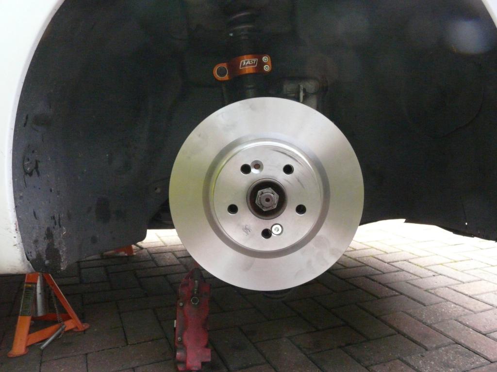

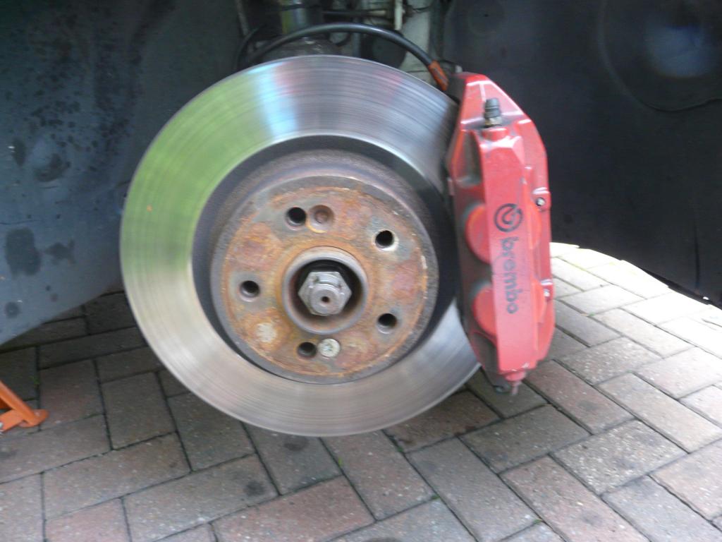

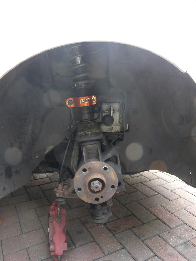

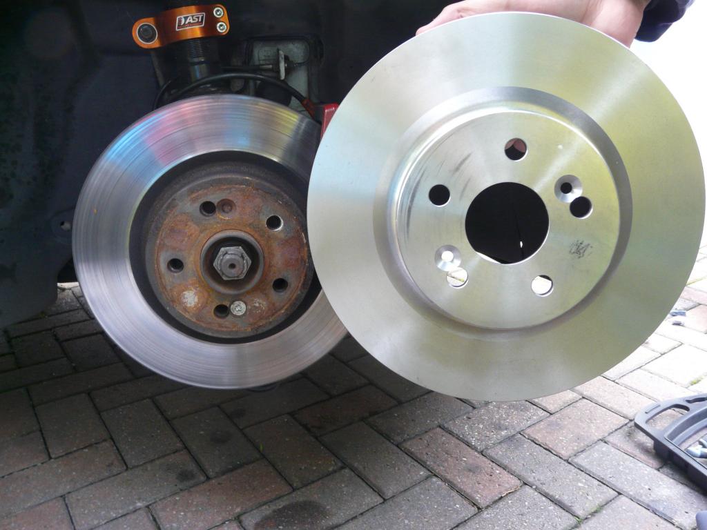

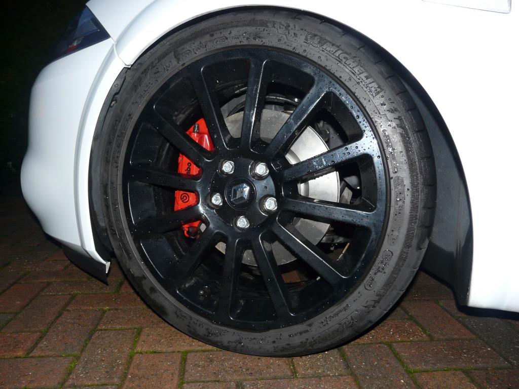

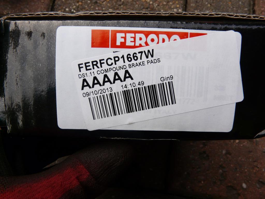

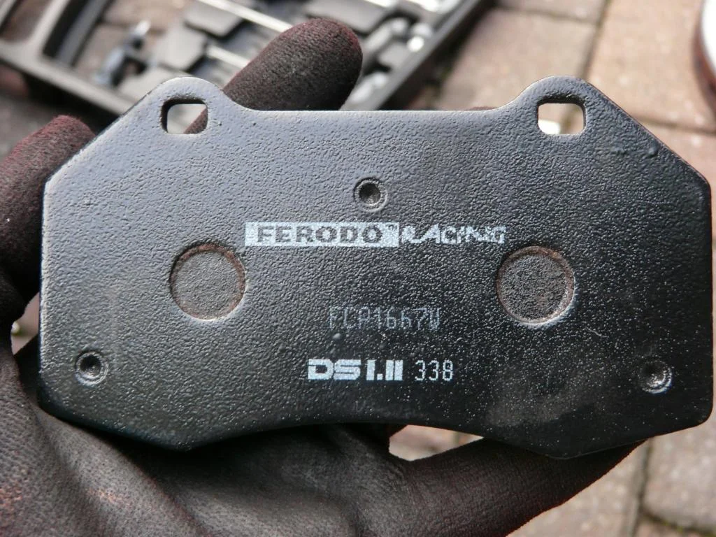

Well I've not updated this for a few weeks, not really done too much as it was all ready for Oulton apart from the brakes which needed replacing. Since the update there have been no issues with the car until now..... But I'll get to that in a little while, first the brake :), really easy to replace on the megane once they have been off before :). I stuck with my previous setup of Ferodo Ds1.11 pads and Brembo HC discs, they have always worked well before, so why change what's best :)
first up up was to remove the calliper by removing the two Allen key bolts that hold the calliper to the hub, then removing the little retaining torx screws that hold the disc onto the stub axel.
removed the disc and replaced with the new shiny ones :)

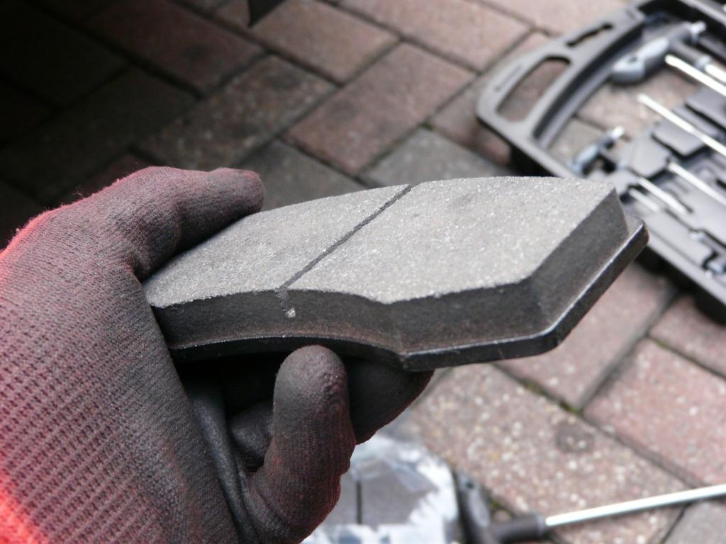

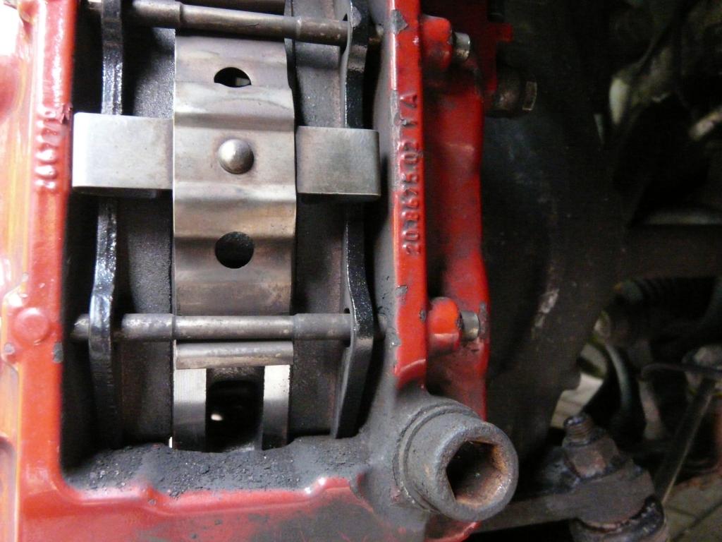

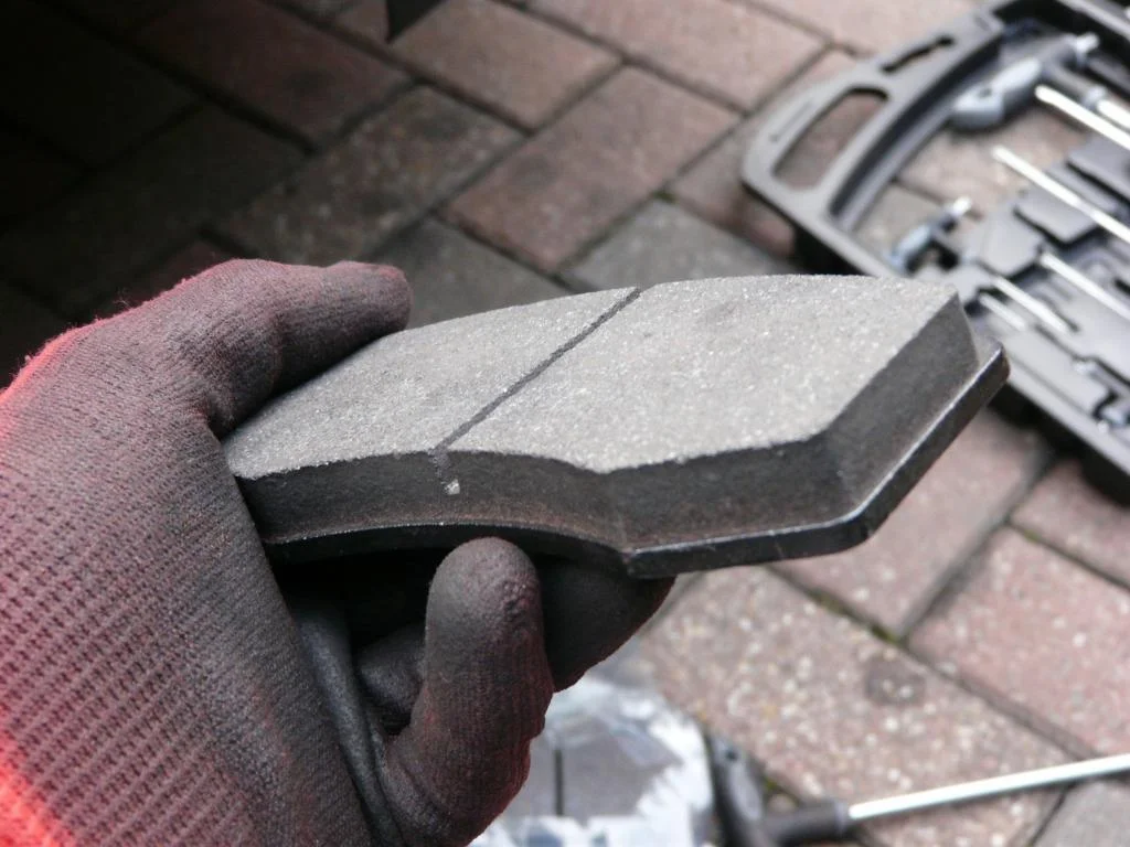

i then refitted the calliper, knocked the two retaining pins out and replaced the pads
refitted the pads, popped the pins back in, job done :)
after cleaning the car all way finally ready for Oulton :)

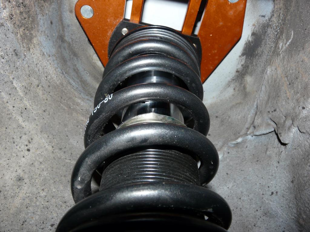

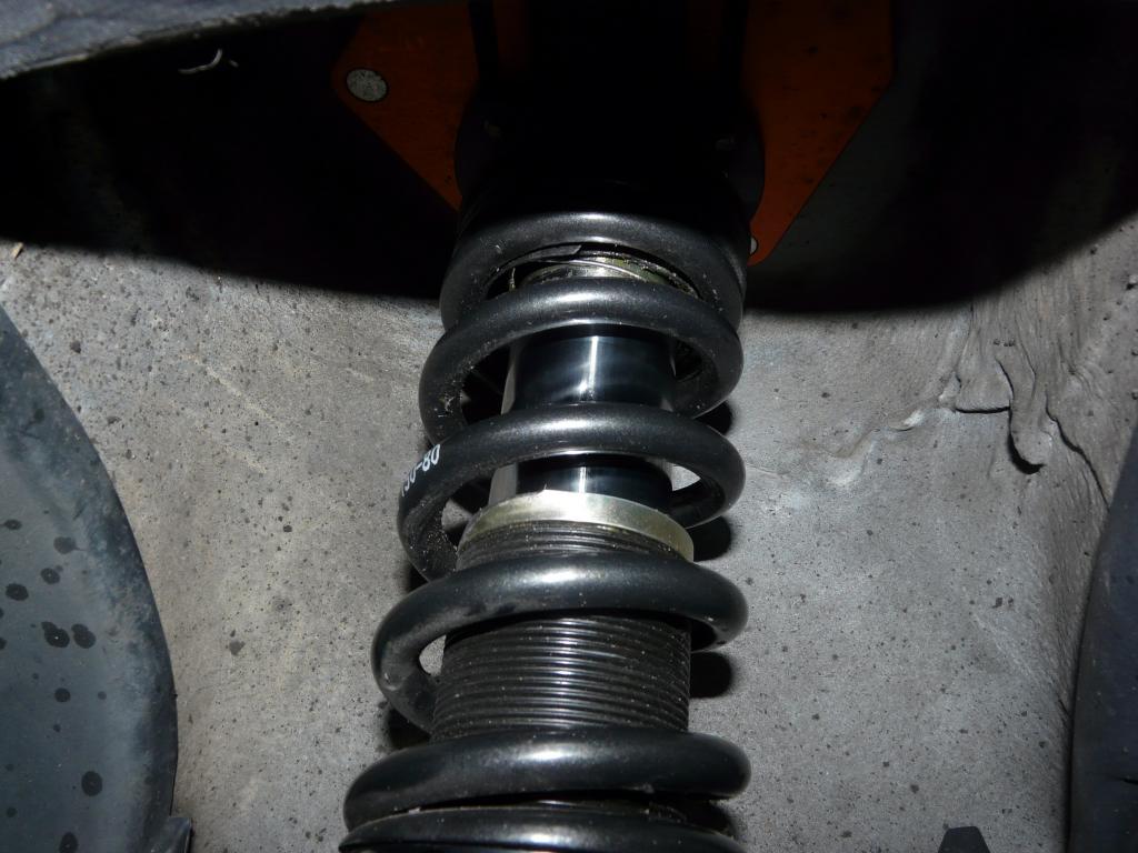

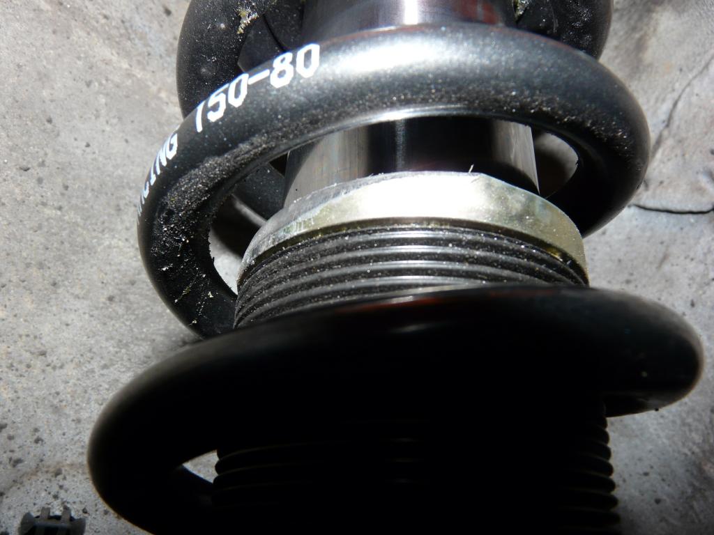

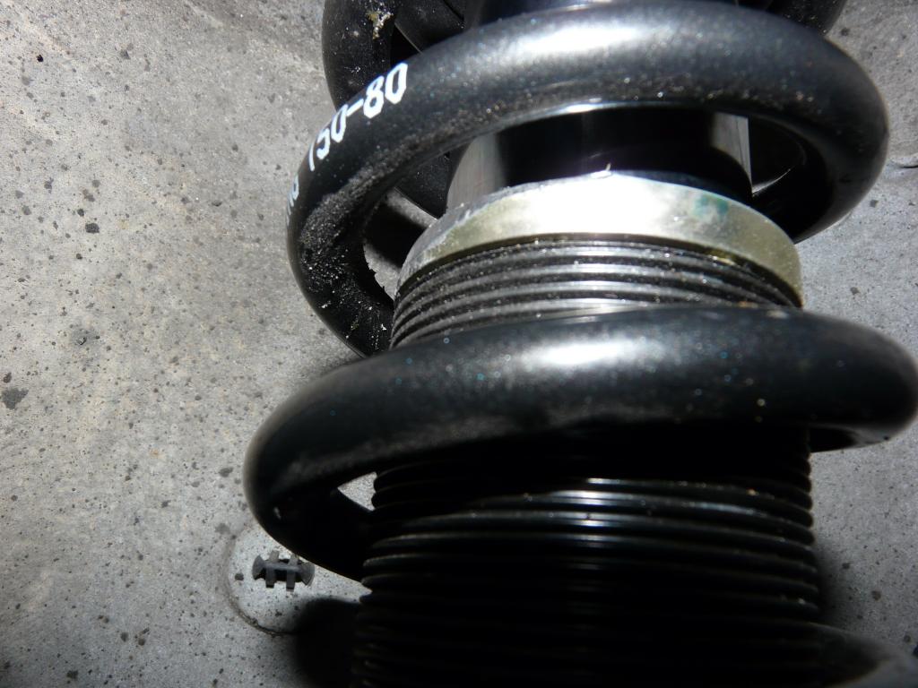

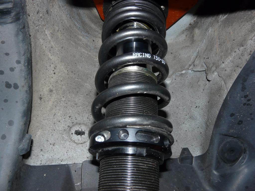

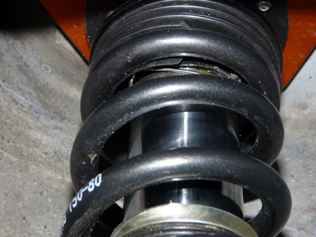

Nearing the end of the day I noticed that I had some Cv grease on the wheel, not a major issue it just looked as though the clip had come of. I didn't take the car out again so I didn't go ruining the driveshaft. At the start of the day I realised I couldn't adjust the rear adjustors on the coilovers, so I had to tape up some grips some could turn the damper adjustors. After looking at the cv boot I noticed that something wasn't quite right with the passenger front shock, got the light on it and saw that the helper spring has snapped, which has ripped the protective boot over the rose joint in the topmount, damaging the retaining spring for the boot and scoring the damper. I've also noticed that the spring has been catching on the metal seal at the top of the strut casing which has damaged that (this has happened on both sides) not too sure what has caused any of this yet, I need to ring AST tomorrow, but I'm sure they will get it sorted out :)
in in this photo you can just about see the damaged helper spring, damaged boot, damaged retaining spring for the boot
In these photos you can see the damage to the top of the strut casing

nope I'm not :( I'm sure Curtis will be able to sort something out as the rear adjustors are too stiff to turn without grips, both front socks are damaged on the strut casings and the passenger front helper spring has snapped.
