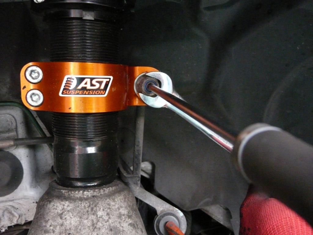

My rear AST’s are very difficult to adjust too but I just wrap them in a cloth and use grips on them.

Mine are really hard to turn, can't move them without grips which I don't think you should have to do haha.

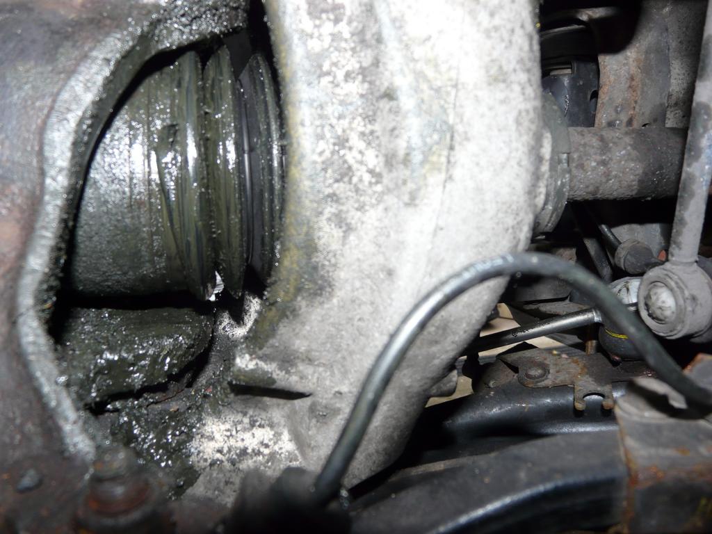

Cars looking great, did you manage to get any videos of the day? Also how much was a new shaft?. my cv boot looks like it's popped off with the amount of grease on my wheel,but hoping it just a case of putting a new clip on.
Thanks Adam, may have got one as I borrowed a GoPro so I think I got a few laps on there. I managed to get the shaft for £130.50 posted from Renault believe it's or not :). Just get a new clip on :) cheaper than buying a shaft. I've only ordered another as I'm not sure how long I was out on the damaged shaft and the boot is destroyed anyway.
Had abit of an update on the suspension issue this afternoon from AST. It turns out that the front shocks have been fitted with the wrong spring, apparently they should have been fitted with a 64mm spring not what they are currently fitted with (they didn't tell me that). They are going to replace the front strut casings on the front as there both damaged, both front springs and helper springs will be replaced as both front springs are damaged, both topmount bearings are going to be replaced along with the protective boots so hopefully that should be the front all sorted. The rears are going to be fitted with new damper adjustors as they can't be turned by hand which should sort out the adjustors being so stiff, and the car will be alligned / setup for free again too. I should be heading down to Tewkesbury next Friday to finally get sorted out :).

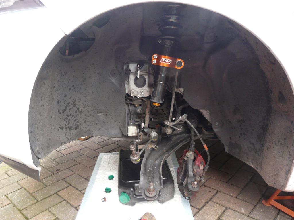

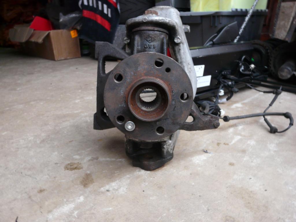

Well today was another day spent messing with the car :). Today's task was to get the front left corner stripped down, remove the driveshaft and tidy a few other little bits up. The front end came apart really easy having been taken apart before the fit the suspension, only took 30 mins unlike last time. Pretty simple job to do, now I'm just waiting on the new shaft being delivered from renault tomorrow :).

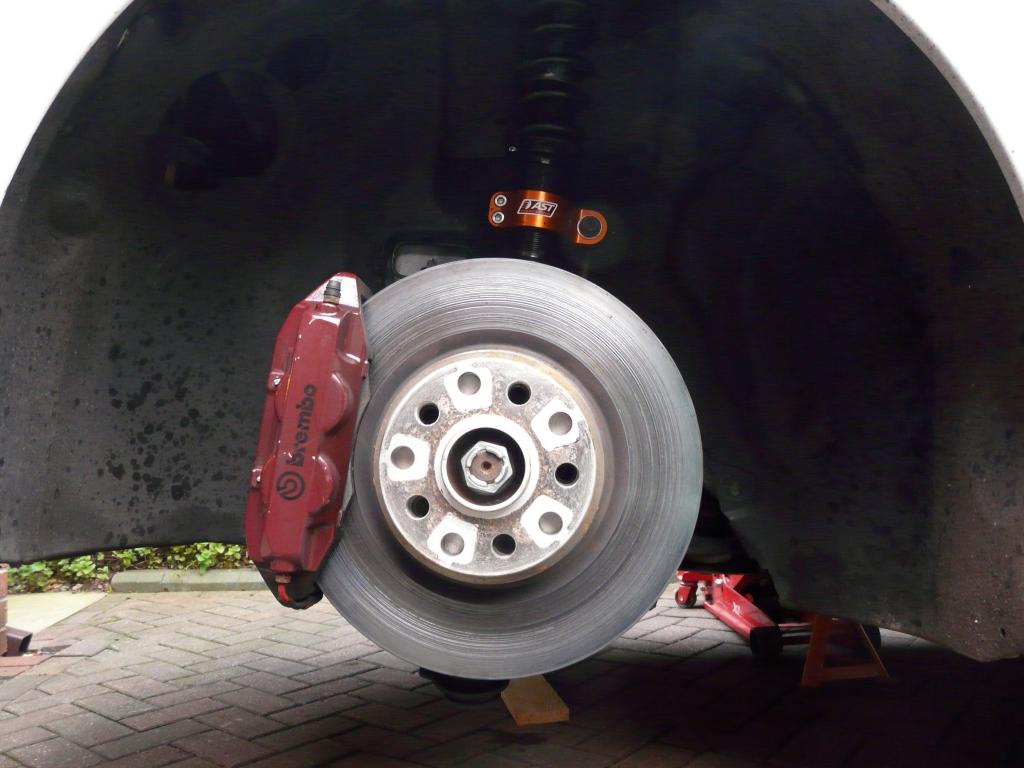

First job job was to remove the calliper and disc and loosen the hub nut with the 32mm socket. Big Allen key bit on a ratchet and a torx bit for the screw on the disc and they were off pretty quick (although everything was covered in CV grease) hate that stuff.

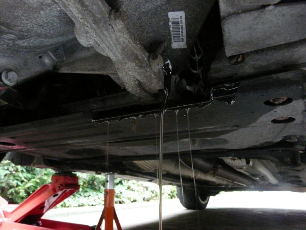

Then I had to drain the gearbox again.... The oil was only two weeks old and had done one trackday :( but needs must. Have another 2.5 litres ready to go in tomorrow :)

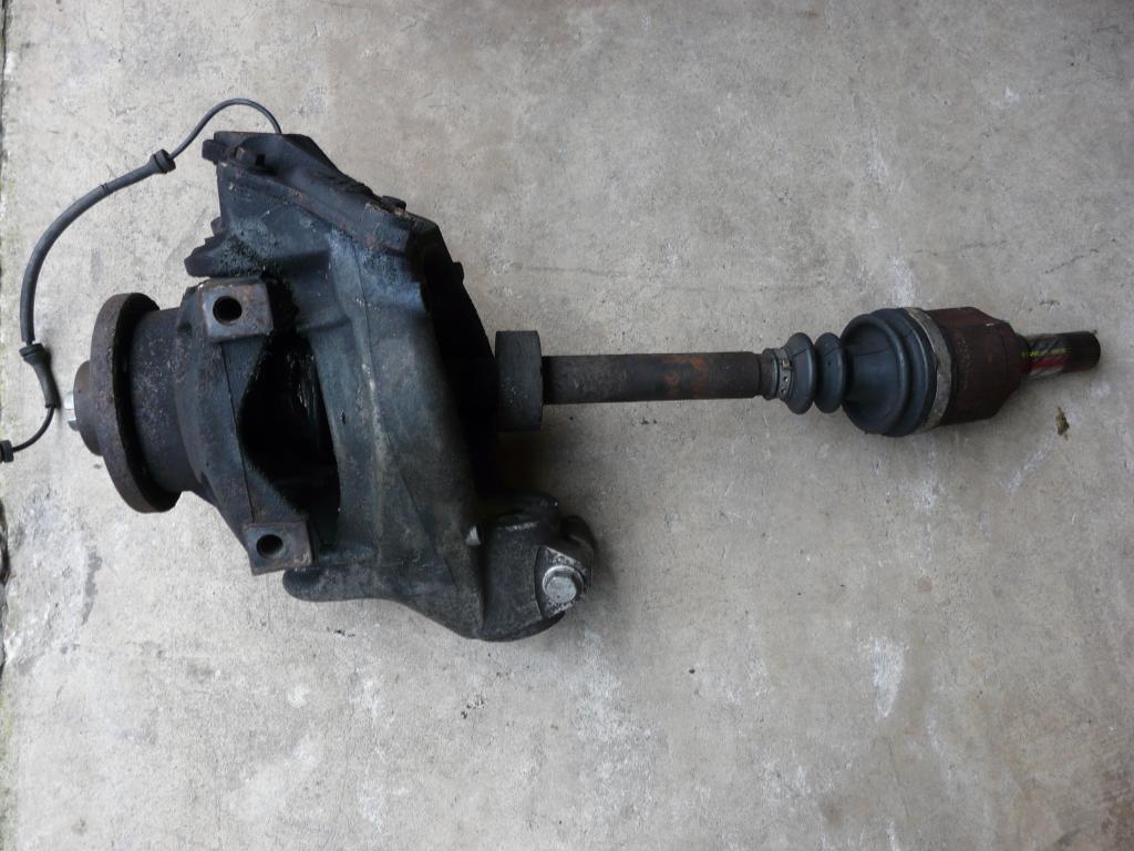

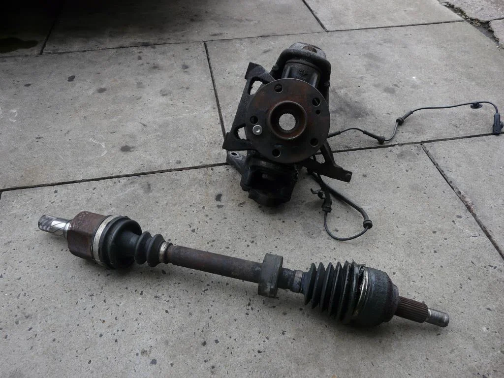

quick photo of the driveshaft that coming off.
next i I loosened off the 16mm nut that holds the stabiliser bar on, thankfully they all came off easily as they were only replaced a few weeks ago.

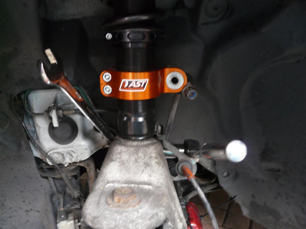

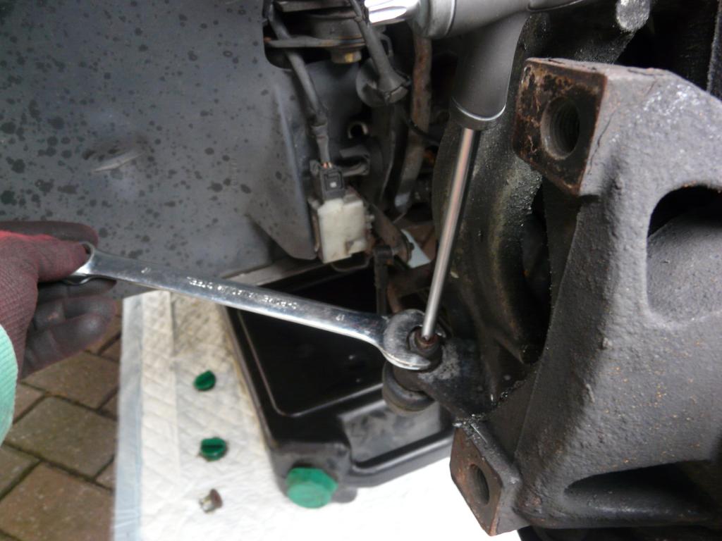

Then I loosened the ARB drop link off the shock again using a 16mm spanner and a Torx bit, that came off a treat.

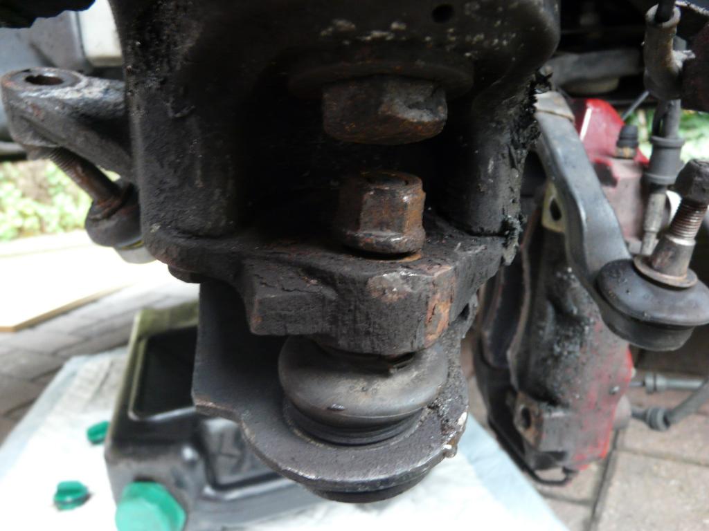

Then i I had to undo the lower ball joint with the 18mm spanner, this was an awful lot easier than last time lol.

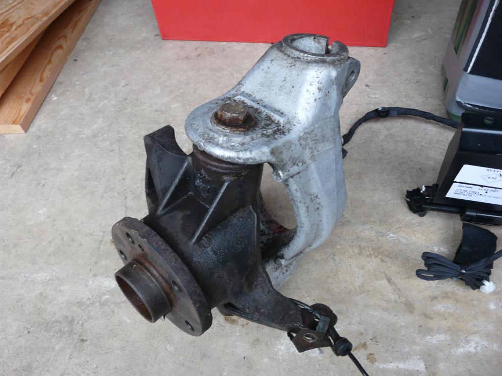

Then I could pull the hub complete with the driveshaft that's stuck in out :)

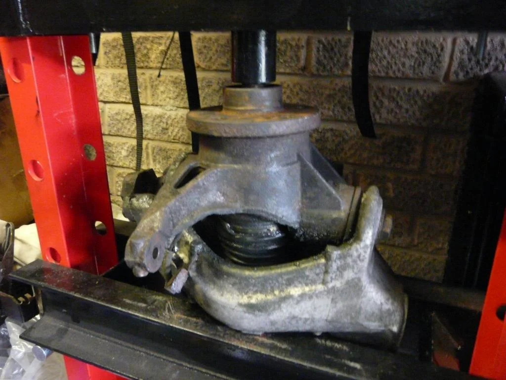

Seeing as the driveshaft was so stuck in the hub, hitting it with a hammer wouldn't work, had to nip round to jords and borrow the press so that we could remove the shaft, took a fair old bit of force to get out aswel.
eventually it came out :)
then headed back home and decided the give the hub a good old clean as it was starting to look terrible. Took a while but pretty happy it all clean :)
