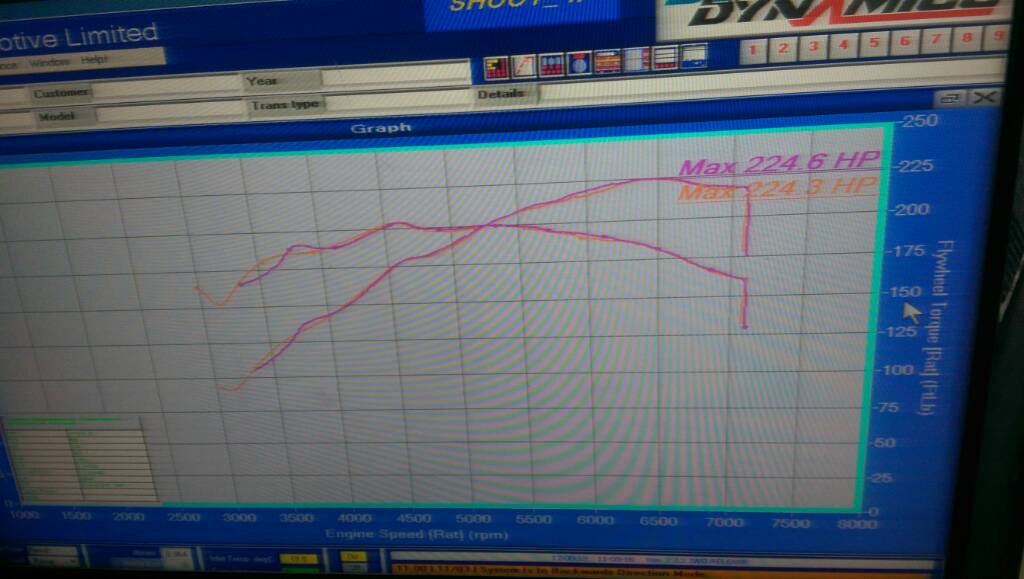

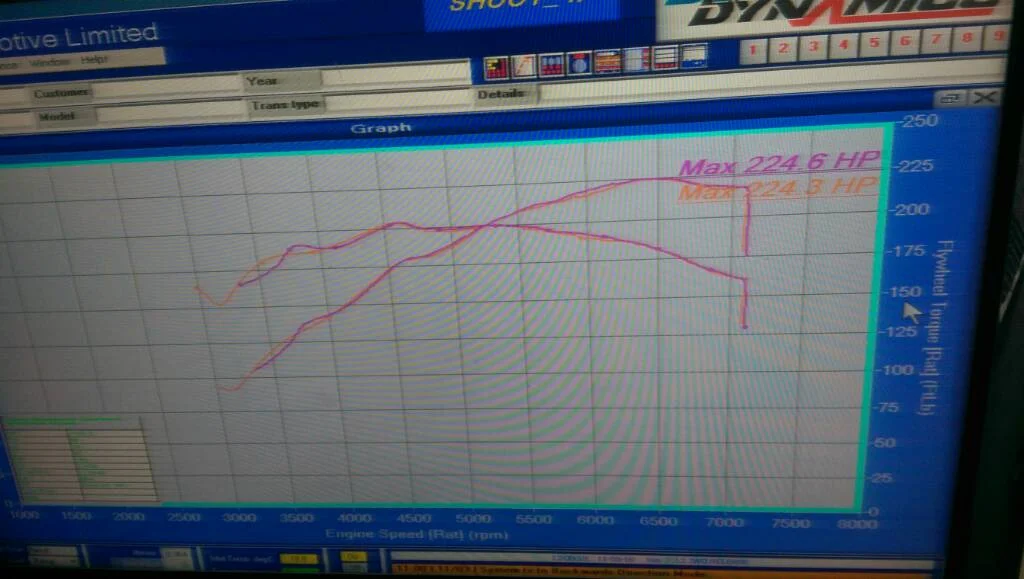

And the results are in...
In all honestly a little lower than I was hoping for, but I have said all along that I'm not doing this for the 'gains' it's all how it drives, and my god does it fly! I can't imagine what you turbo boys with 300 plus experience! [emoji1]
Although lower than expected I'm still very happy, and considering with the supercharger disconnected she made about 145... [emoji23] it's a bloody good gain! And from what I have experienced so far on the road it's a very usable power. We hit 228 on one run but never recorded it, due to high intake temps it wasn't easy.
I may look into a different intake setup similar to what @Cub. uses or maybe even a water/methanol system.
Big shout to @Dan@SJM for all his help and advice. I would wholeheartedly recommend him to anyone!
Watch this space, as there's plenty more to come. As we all know 'the project is never finished' :wink:
Awesome mate. Figures aren't everything! .
It's how it drives and feels. Graphs very smooth too which is always good! Must be a blast to drive!

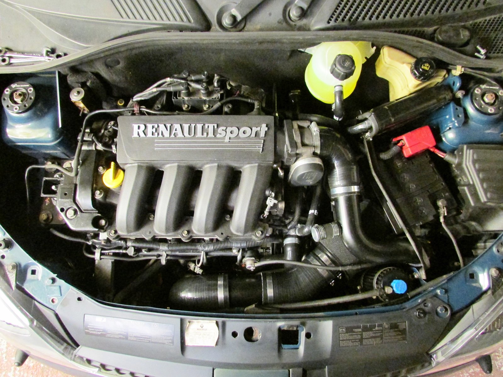

Current spec sheet...

With regards to the final figure, arent most S/C conversions usually around 250bhp? Did Dan say there was anymore power to be had with any changes?

Yeah they should be, and that seems to be the usual figure produced. Might just be that my engine was down on power prior to the supercharger even being fitted.

After a second mapping session we ended up with 266bhp, that's the furthest he'd go to on stock internals. 250 is about the threshold for low boost forced induction on F4R internals

Graph looks smooth :smile:
I don't know what restrictor mine is running as it was the one that came in the second hand kit. Let me do some digging and see if I can find out.
It may be that the engine wasn't a strong one before charging. My second engine (the one in it now) ran 179 bhp iirc, so it was a strongish one prior to charging.
Regarding the 250 bhp, then yes, that is pretty much the norm on a healthy engine with a reasonable restrictor. That's what mine ran at RS Tuning, with 220 lb ft. As said though, I wouldn't worry about chasing figures, it's how it drives that matters.

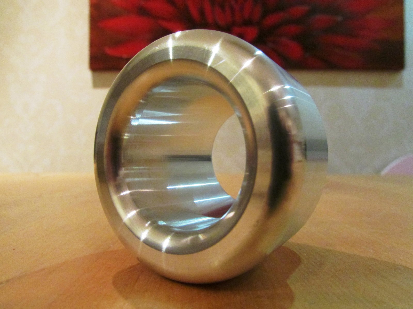

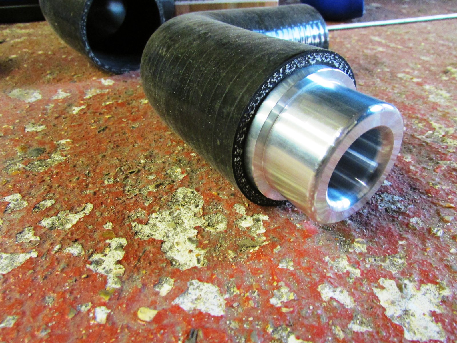

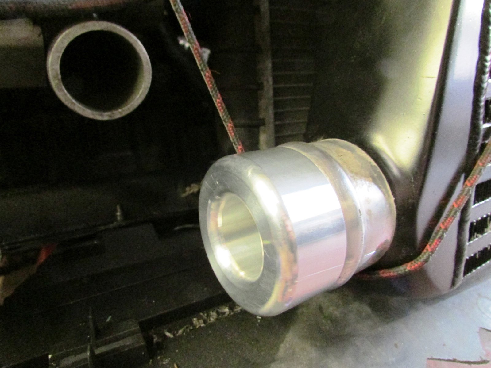

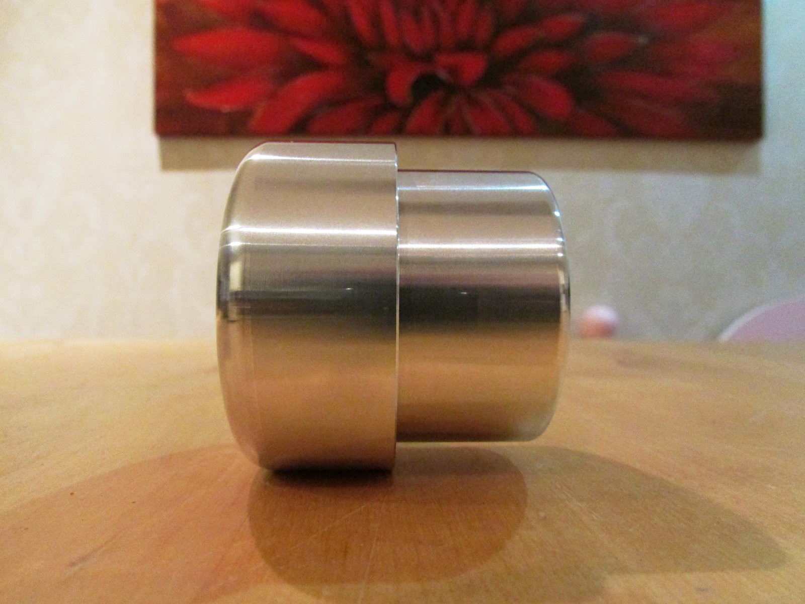

I believe the restrictor hole diameter was 28mm, I fitted it in the 90 reducer elbow hose between the charger and the FMIC. It was engineered to fit inside the outlet of the FMC outlet and the 90 degree hose. I had 4 made with different diameter holes in case I needed to change them to meet certain bhp requirements

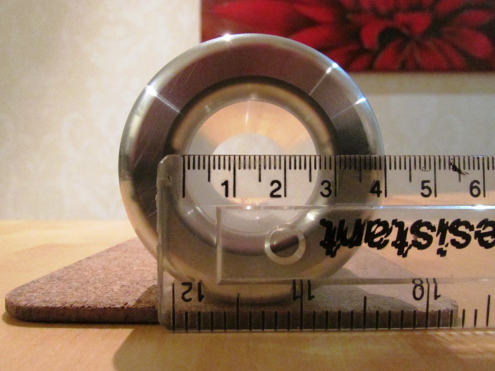

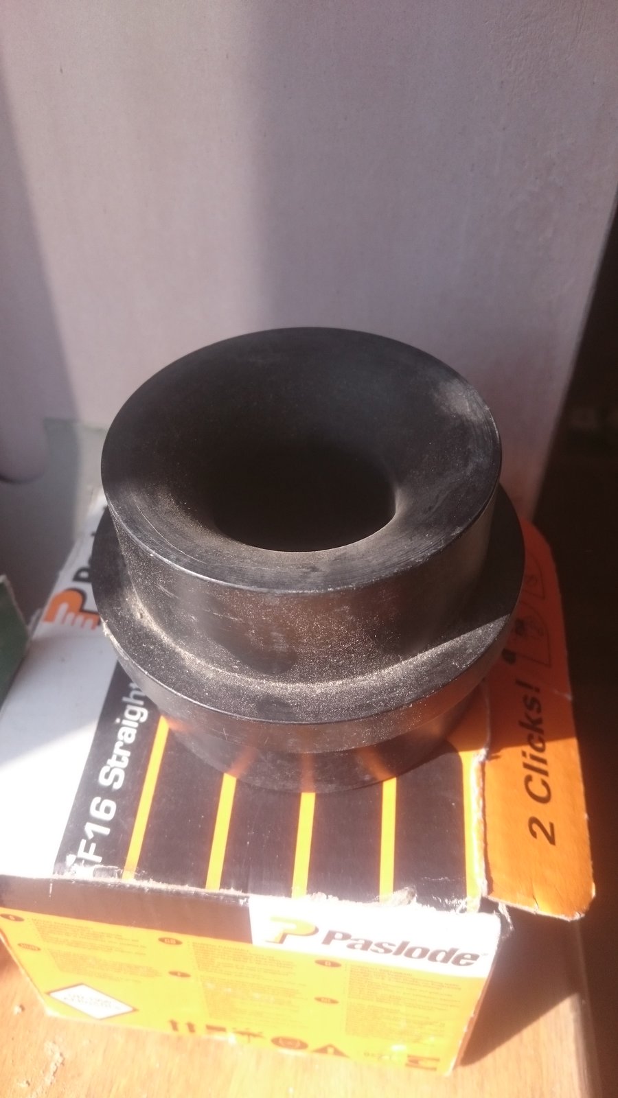

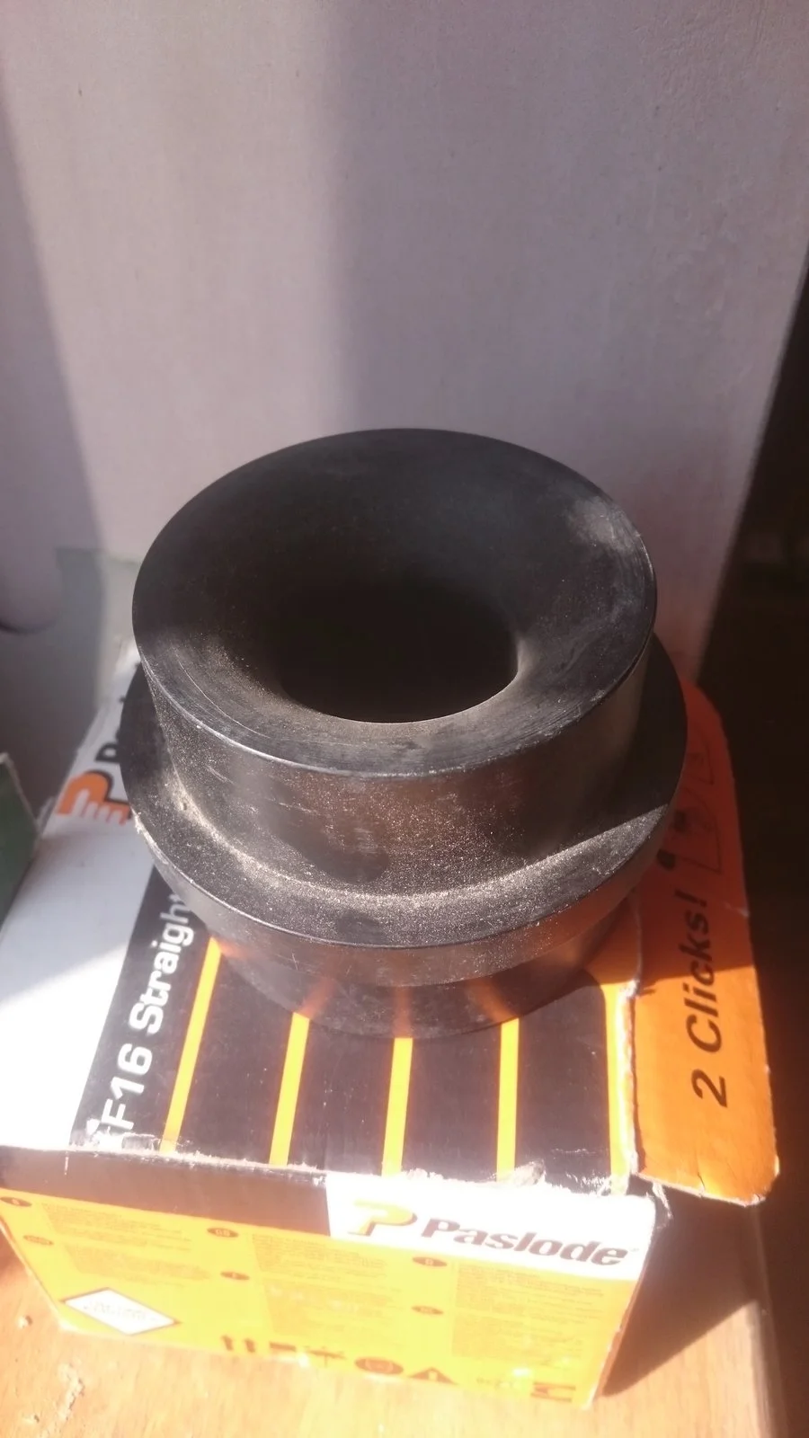

So looks like I need to measure my restrictor and see what I've got?
If yours is the K Tec restrictor it's located on the induction side where the air filter runs to the charger. I still have the restrictor and can measure the diameter of the hole if that helps
Yeah that's it bud. I'll whip the air filter off later, and get measuring. It's just the internal diameter that's needed isn't it?
I think the restrictor size depends on its location, before SC or in the pipe run. Ill try and see if i can dig out what mine were at 240 and 280bhp, they were pre sc
That would be a great help mate thank you.
As it happens it's sitting in the boot of my work car.... 37mm diameter
