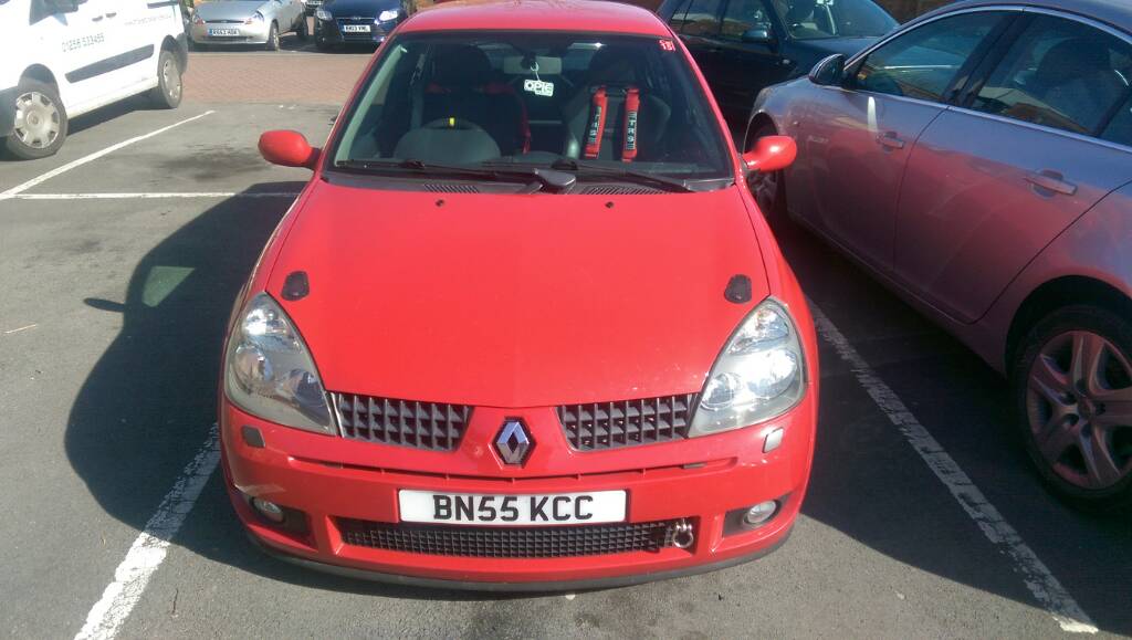

Aerocatches fitted. Not by me sadly as I haven't got the balls to drill various holes into my bonnet! Got XSport in Basingstoke to do them for me.
(Shocking Phone Camera Photo)

Excellent news rob. Glad it's all back and your loving it.
How comes you've decided to fit aero catches?
Cheers Mark. She's going very well indeed, and I'm over the moon with how the car currently is!
Apart from being a massive tart, and always wanting a set of Aerocatches, they will allow me to do away with the original bonnet mechanism, and position my engine and supercharger coolers better.

Ah OK. I knew the bonnet catch had some issues a while back and there was a recall. I didn't know that the aero catches would benefit the charger coolers though. Makes sense I guess.
Plus, they look cool :)
