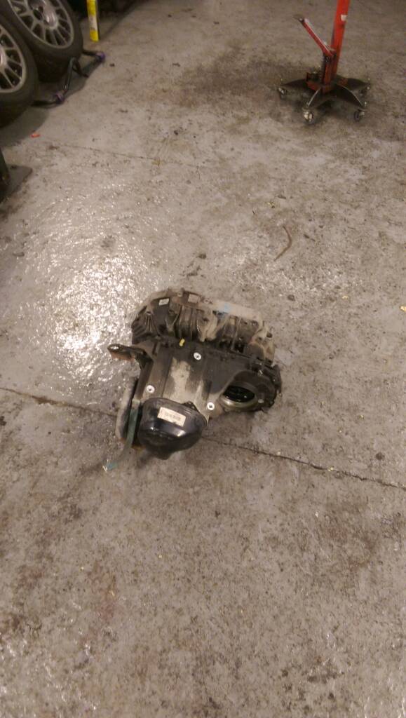

Gearbox is out and the cause of my horrid noises were shagged main shaft bearings! So whilst that's getting rebuilt it would be rude not to renew and upgrade a few items! :wink:

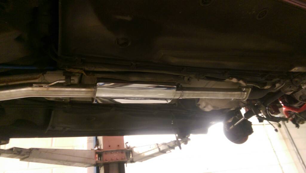

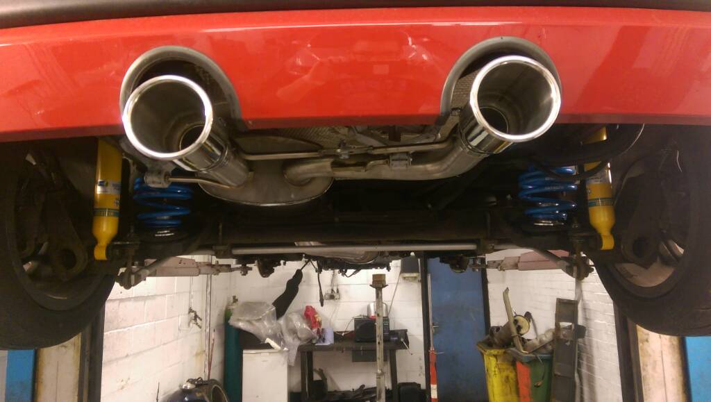

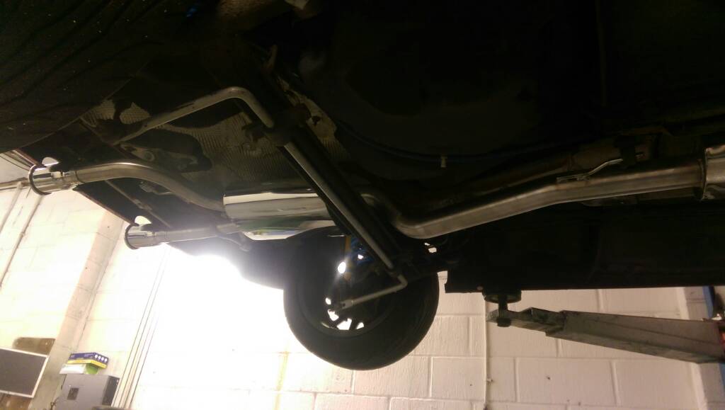

Fitted the Bilstein's to the rear, and got the Pure Motorsport exhaust system loosely fitted. I'm really impressed with the quality and design of it. Such a well put together, piece of kit! I'm itching to hear it! [emoji1]

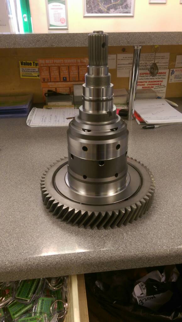

It's arrived! [emoji1]
Cannot wait to get everything back together, and get back behind the wheel!
Massive thanks to @NorthloopCup for sorting both the Quaife, and the TTV lightened flywheel. Great communication through the whole process, and I would recommend him to anyone after something transmission related, lol!
