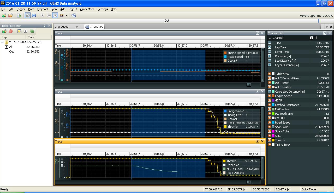

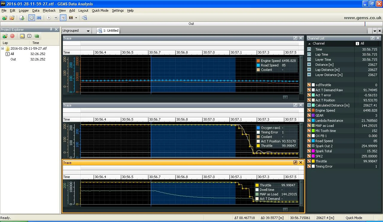

Image 1 - GEMS GDA Data Logging plot of data on Dyno.
Note the following in the highlighted blue areas
Act T Position = Throttle body position
Throttle = Pedal position
MAP as load = Manifold pressure

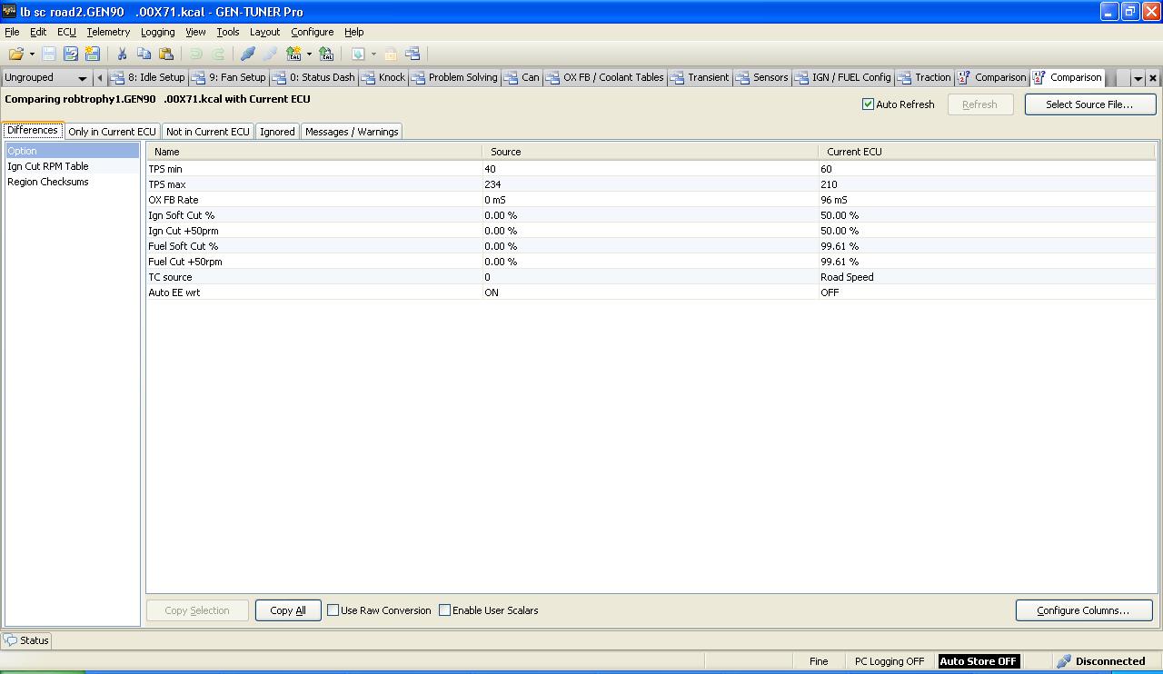

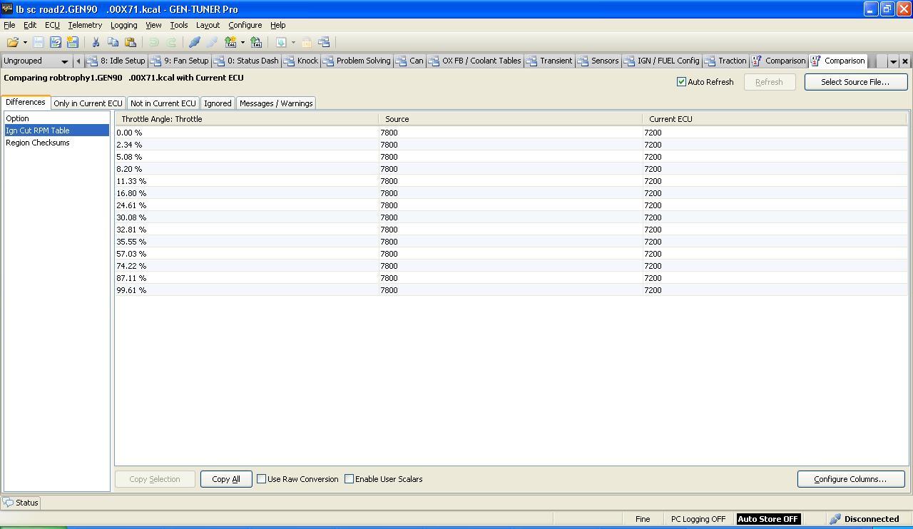

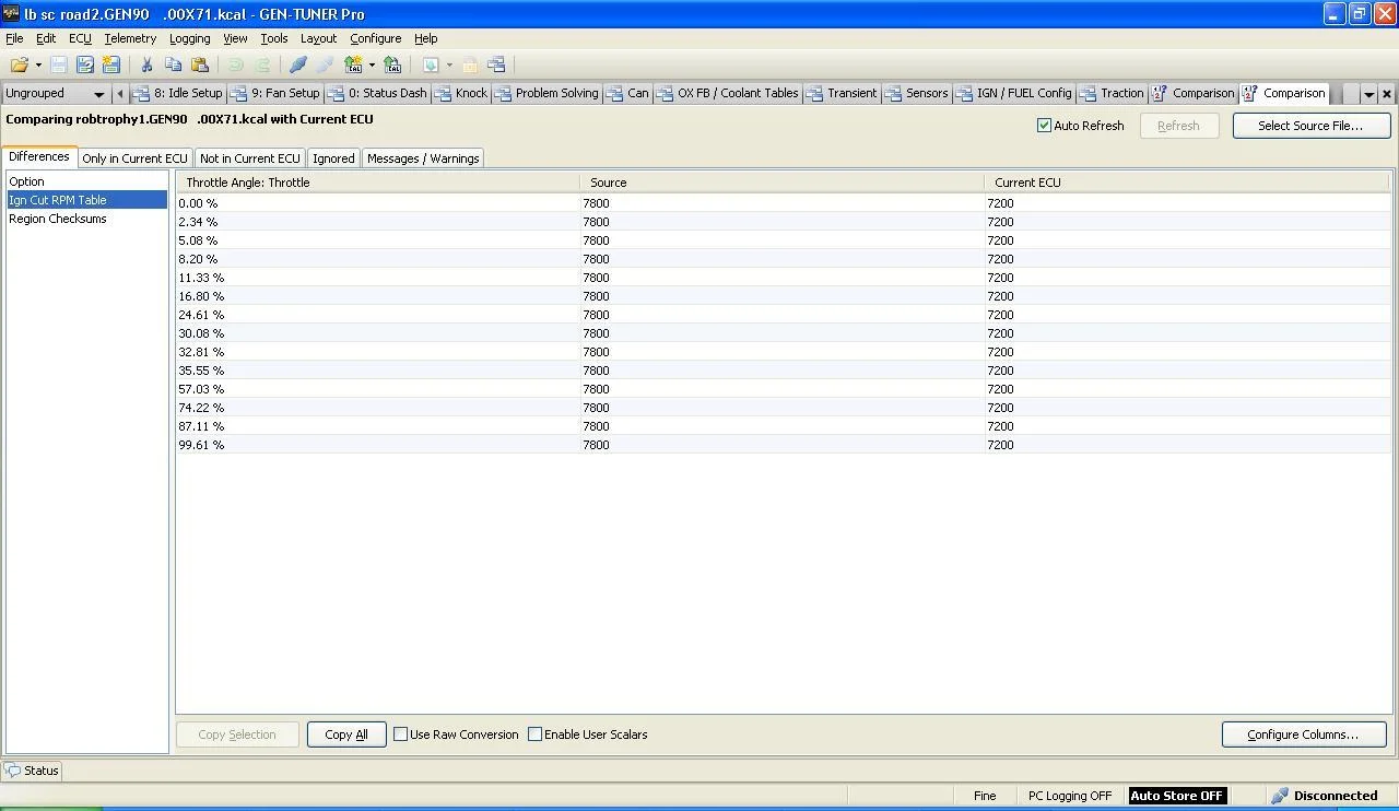

Images 2-4 File (calibration) comparison function in GenTuner Pro
Current ECU = Original calibration when mapped and locked - Original Reg: WG**GKZ 24/09/2014
Robtrophy1.GEN90 = Cal received from SJM
Here are the facts for you to ponder
Changes made to Options, including turning off the Lambda sensor, changing TPS Min and Max values. Rev limit raised to 7800 RPM (which if the 80mm SC pulley is present assuming it was one of our kits purchased used, will overspeed the charger, hence original limit set at 7200 RPM)
MAP as load indicates engine goes into vacuum at WOT circa 6300RPM, throttle is not closing until operator lifts (Act T Postion and Throttle). XX71 does not have throttle vs. boost limitation.

So nothing bizarre on the changes then? TPS min as explained was set to an excessively low value to eliminate a TPS setting issue. Lambda feedback, are you honestly saying you do the mapping with OXFB enabled? Care to explain how the engine goes into vacuum at 6300rpm yet with the new cal this doesn't happen? All mechanical items that have an impact on this were checked (in particular air filter removed to check it wasn't collapsing.) Rpm limit set to 7800 rpm just to be well beyond the place the engine was being taken to in a completely controlled environment on the rolling road, to rule out any "soft limit" options that might start the limiter having an effect before the actual limit itself, an entirely temporary measure just to rule it out during controlled testing on a dyno and not something the customer would be driving down the road.
