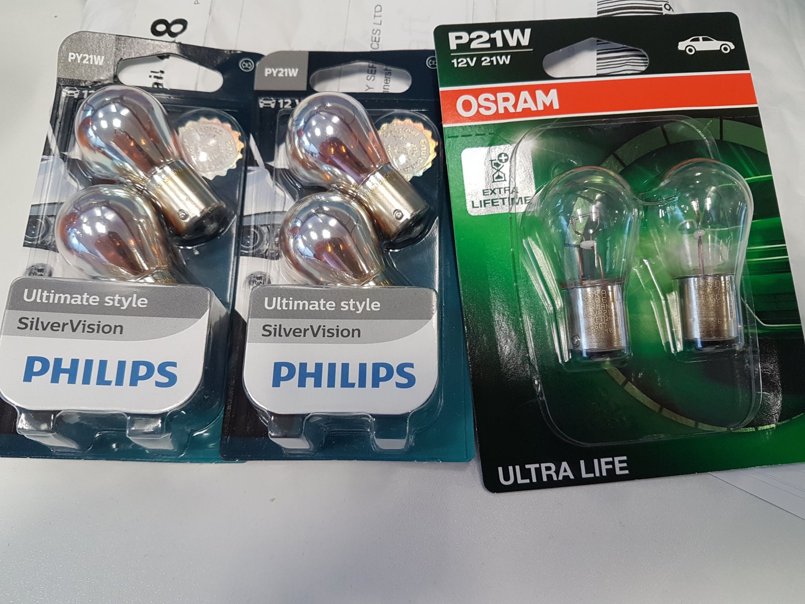

Confirmed they are 382's so ordered some nice Osram ones, while i was at it i ordered new Philips Silver Vision indicators all round and finally some new Bosch Aero Twin wipers all round :)

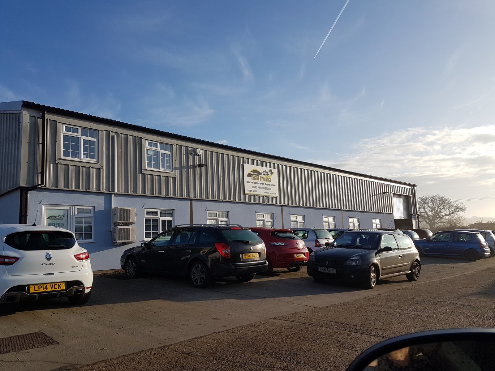

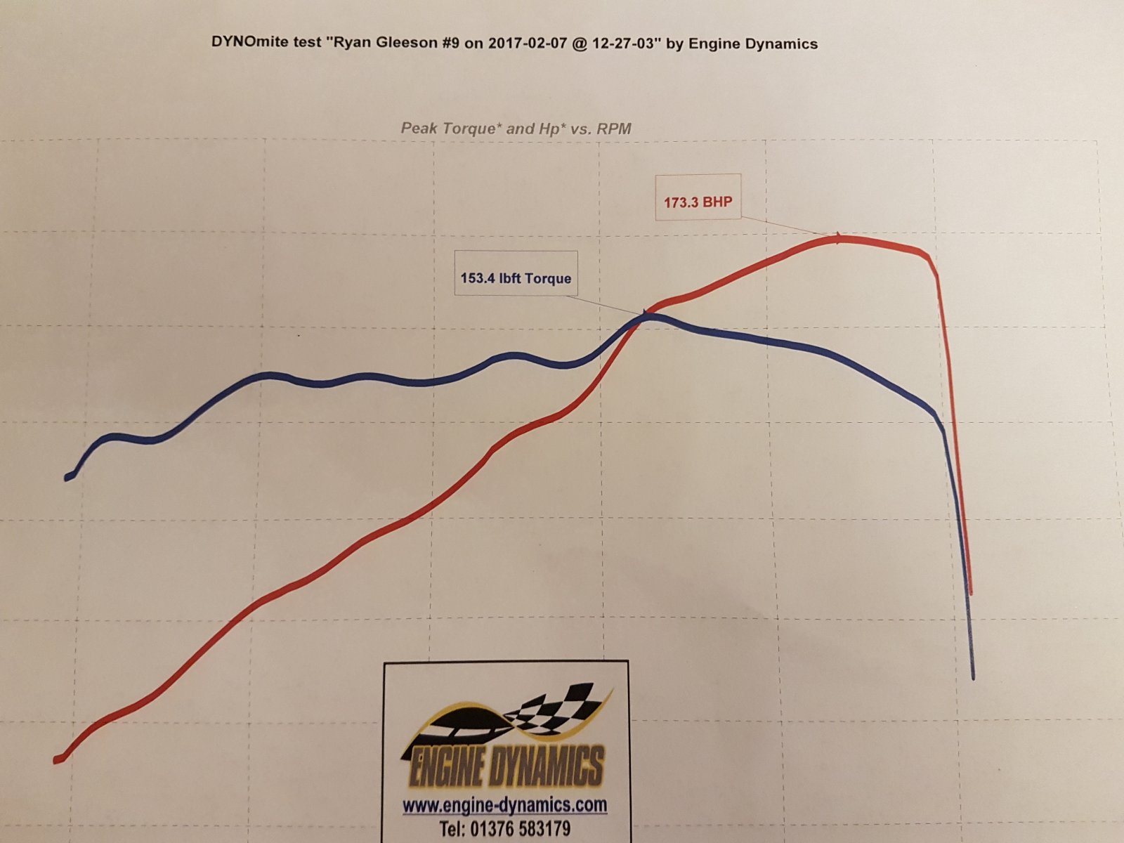

So yesterday was judgement day for the car! It had started getting worse with the jerking and cutting out etc so the trip to ED couldn't come soon enough.
Arrived bright an early on Monday, had a quick chat with Andy and left him to get on with it. This morning i spoke to Andy again and he confirmed it was the crankshaft sensor causing me all the troubles! He said that they just touched the wire and it cut out, so a new one was fitted :) Next he noted some slight play in the track rod end so got that swapped. I will list the full work below, but i drove it home on the back roads and must say I'm very happy with the car now and I can't recommend Andy and ED enough. He said he had seen a lot worse and the car drove okay with a strong engine so that made my day.

As you can see pulled some healthy numbers on the dyno and it's relatively smooth, i was expecting around the 160 range tbh. Anyways now that's all done i can focus on suspension, exhaust and some nice wheels.

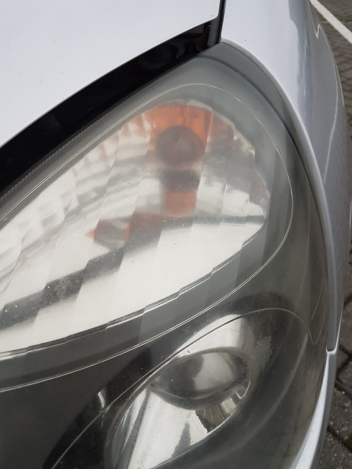

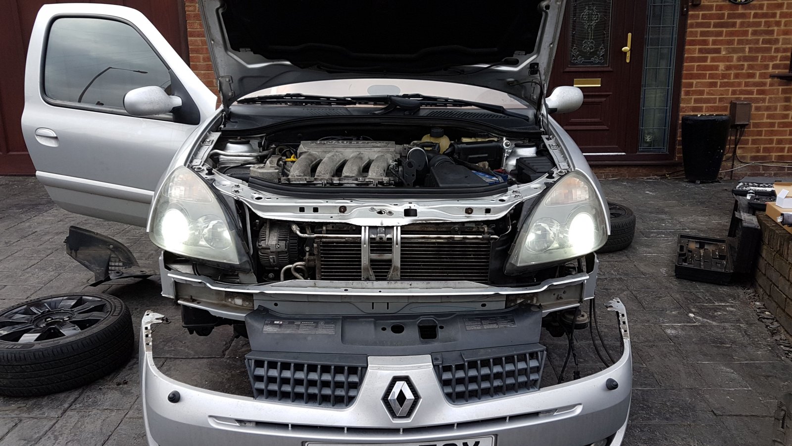

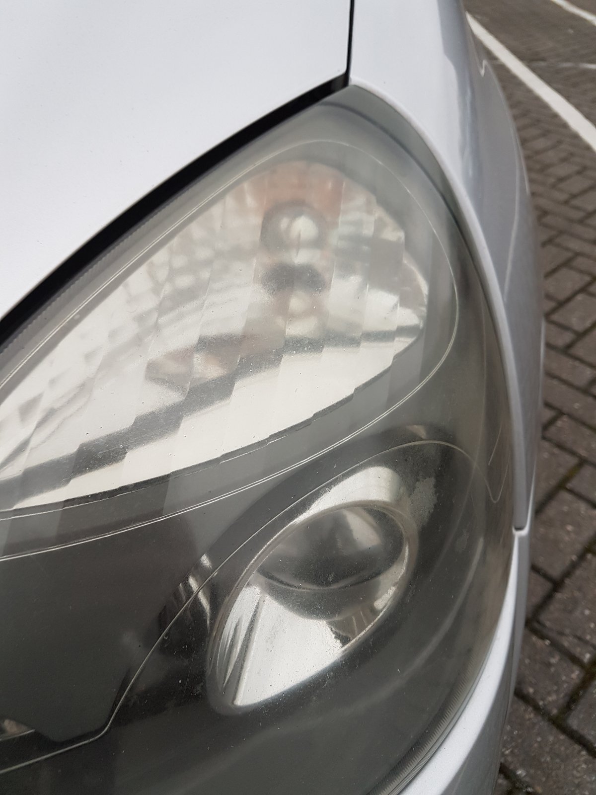

This morning i set about sorting my xenon bulbs, it was very annoying that only one was working! On the advice of @Dr Jekyll i purchased some D2S 5000k from hids direct. Also fitted new Bosch wipers all round. The new bulbs look really good, will go for a drive later to see what they are like at night. Need to do a headlight restoration.

The bulbs look good too. I ordered some 6000k which they had no stock of and was desperate so ended up with 8000k. Nice bright light but a bit blue for my liking. They are better than the standards though but they will be getting changed for 6000k later on.

8k is a bit much for me I have had them before, the ones i got from HIDs direct were only £11 or something.
Did you go for a night time drive to test the bulbs out?
Yes i did, i went to the pub and in the country lanes the lights were great a big improvement so thanks for the recommendation. Can you advise on some new sidelight bulbs. The ones i have now are OK, but they are bluer.

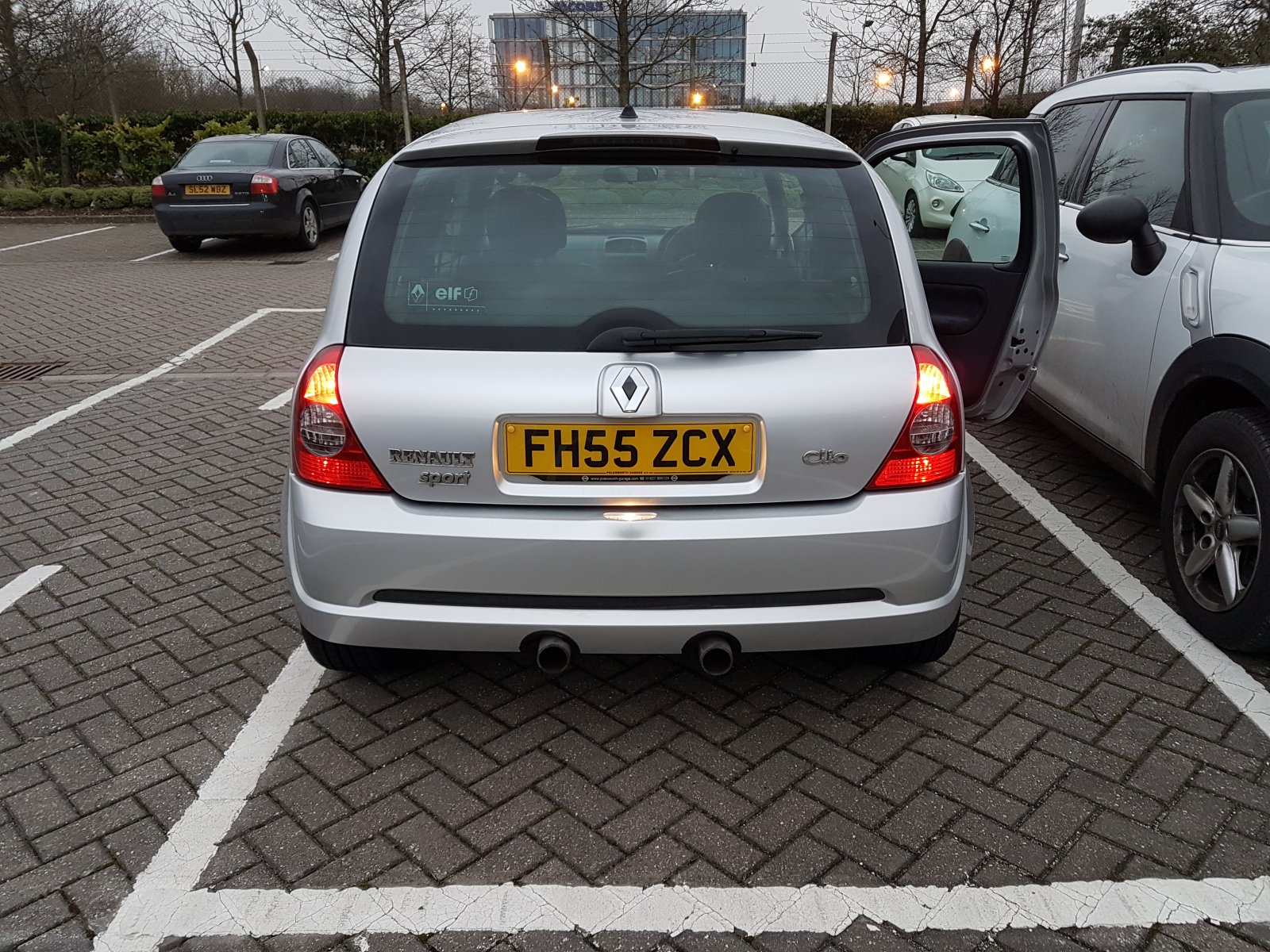

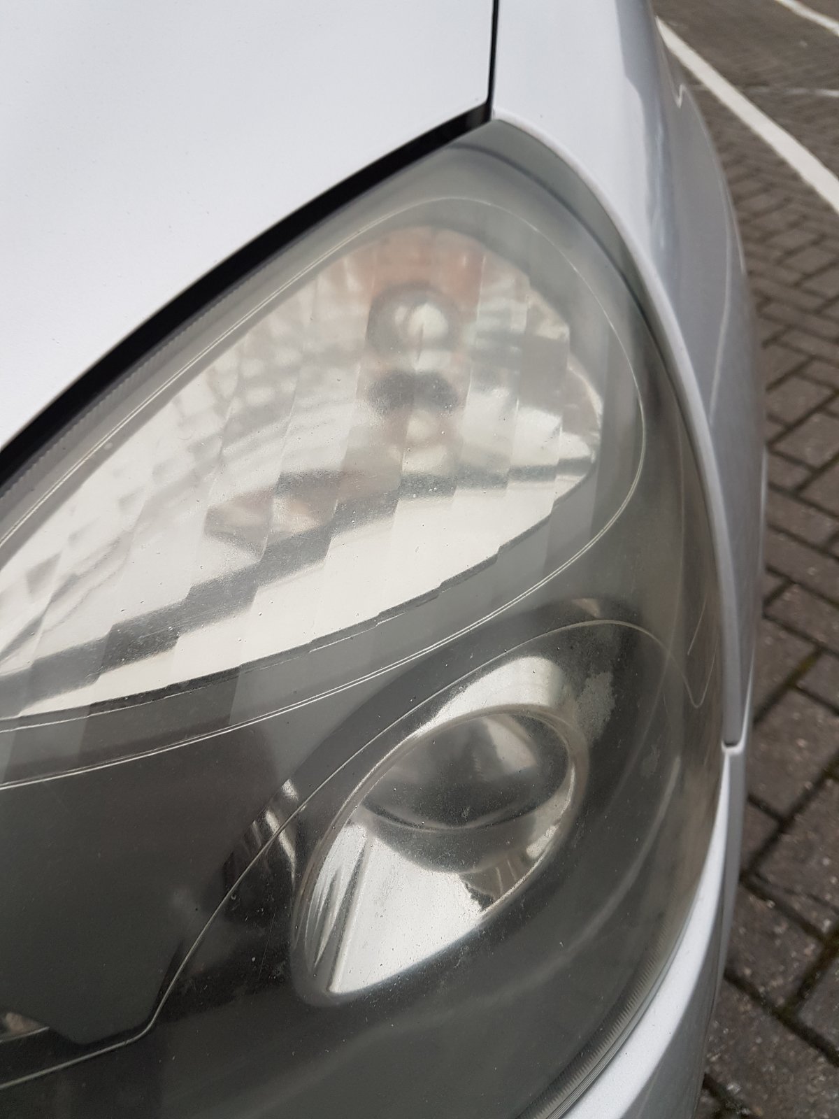

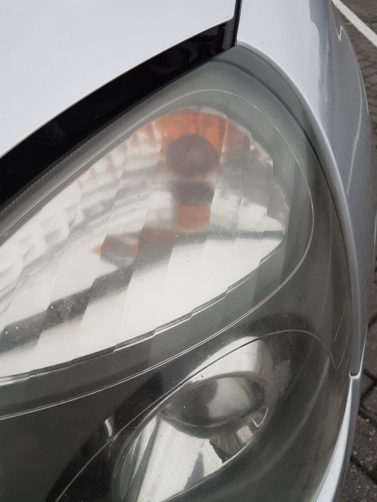

I ordered some new bulbs and got them delivered to my work, so just ran out and fitted them. Can't decide if i should get wheels, exhaust or suspension next.
Before
After

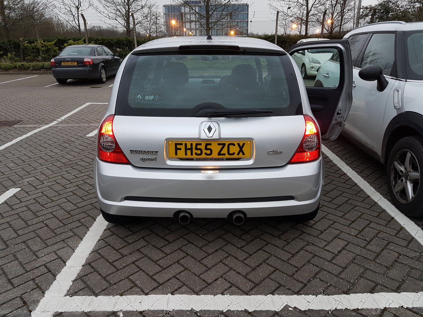

And i have some rear fogs again :)

Headlamp resto will make the lights look even better.
The ones @OssPoop linked are just cheaper versions (which you can notice by looks, ive had both) but both work ok. They'll be bright and a nice white look.

I got silvervisions in mine, and you can still see the orange. Weren't the cheap ones either!

I was a bit disappointed when i saw the bulbs because they were a little orange still but like OssPoop says it's still a big improvement.

I agree with you, I am trying to decide the best way to replace my power steering pump as in with Euro's or a refurb etc. I have also just ordered the Autoglym Headlight Restoration Kit, normally I would go with 3M stuff, but thought I would give it a try. I also ordered some Gtechniq C4, some IPA and tape. I reckon I will run out of sanding discs so may need to get some wet and dry.
I have also noticed since I fitted the fog light bulbs when i brake or indicate with dipped beam on the fog light bulb comes on in the dash. I know this should just need a clean up of the connections or earths so something I can do at the weekend.

The fog light thing is the earth under the boot carpet. Mine did it before when I braked, and also when I indicated left with the headlights on. Just need to sand/clean the earths.

I like those wheels, anything other than turini's! I used the AG headlamp kit and it did a decent job. My lights weren't badly yellowed though but i reckon you sound only need more of the roughest grade if your lights are bad, after that it's just flatting the sanding so what's in the kit should suffice.
