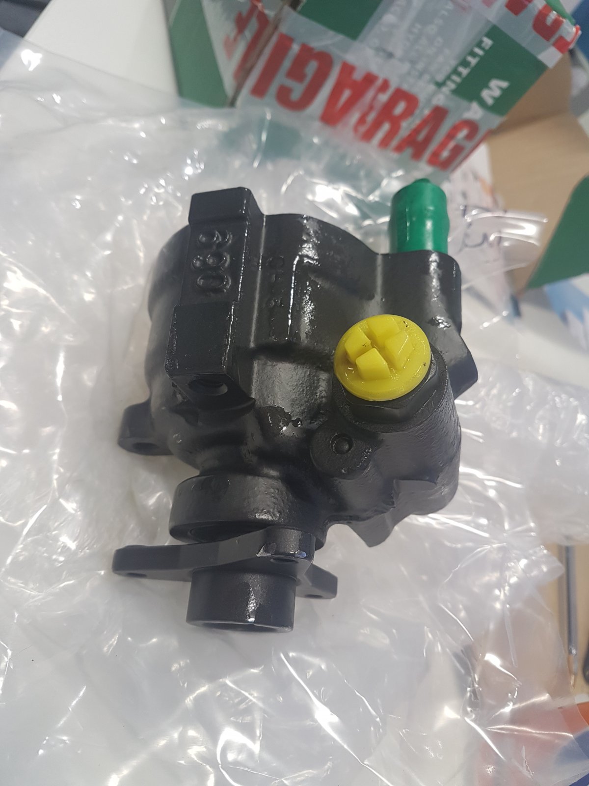

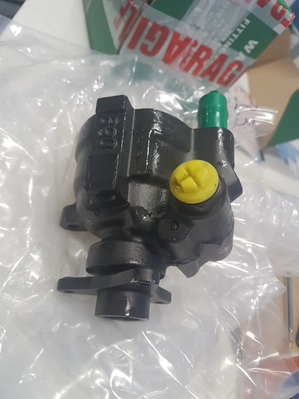

Bit of a blow this morning :( I have parts arriving at my work and today i received the new power steering pump so I was all excited. I then had a reply to my PM from Mick at Diamond Motors and he said that he wouldn't be able to fit a pump that he didn't supply as the tolerances are so small on certain parts (1mm) if it failed it would take the aux belt then the cam belt with it! So i understand Mick's side as its his warranty and name on the job etc, it just means I would have to leave the car there longer and it will cost a bit more.

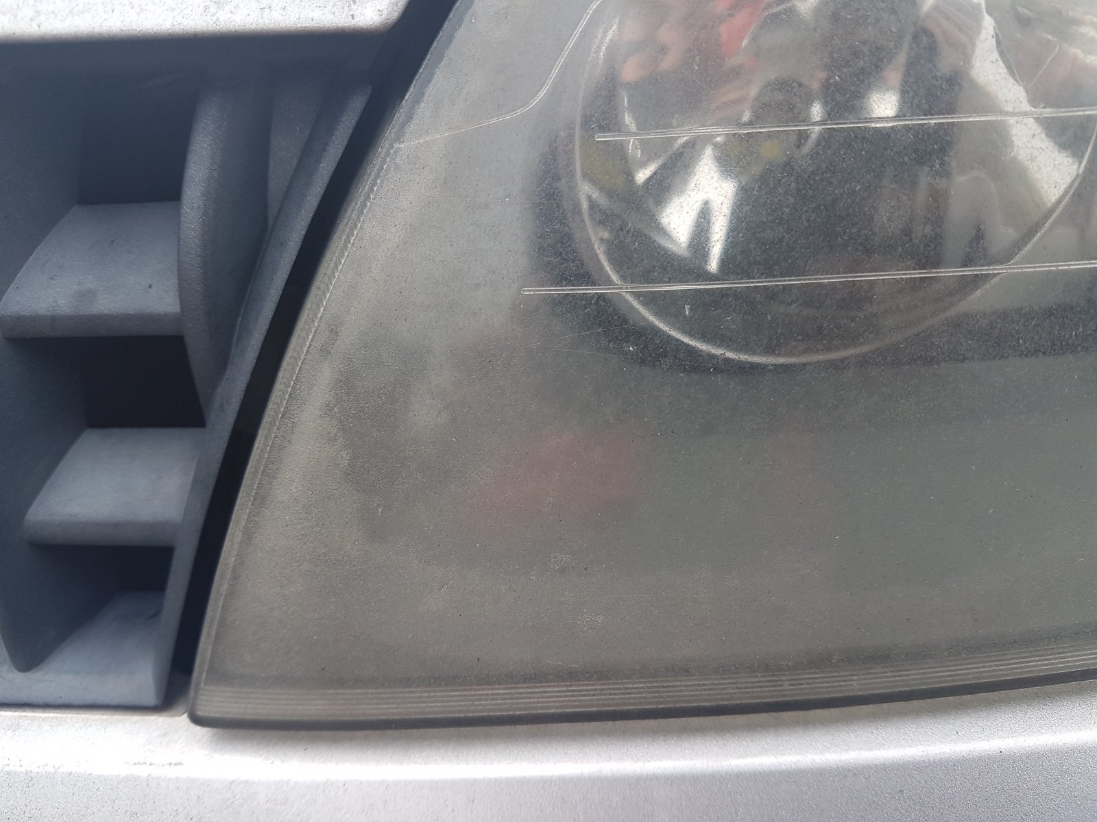

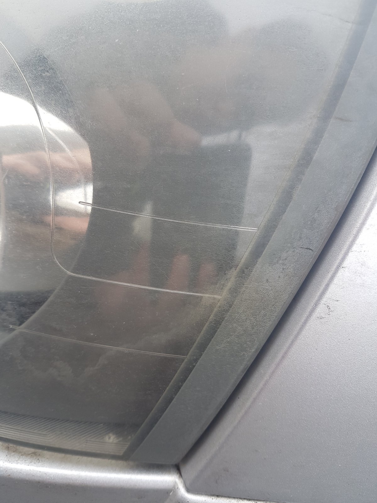

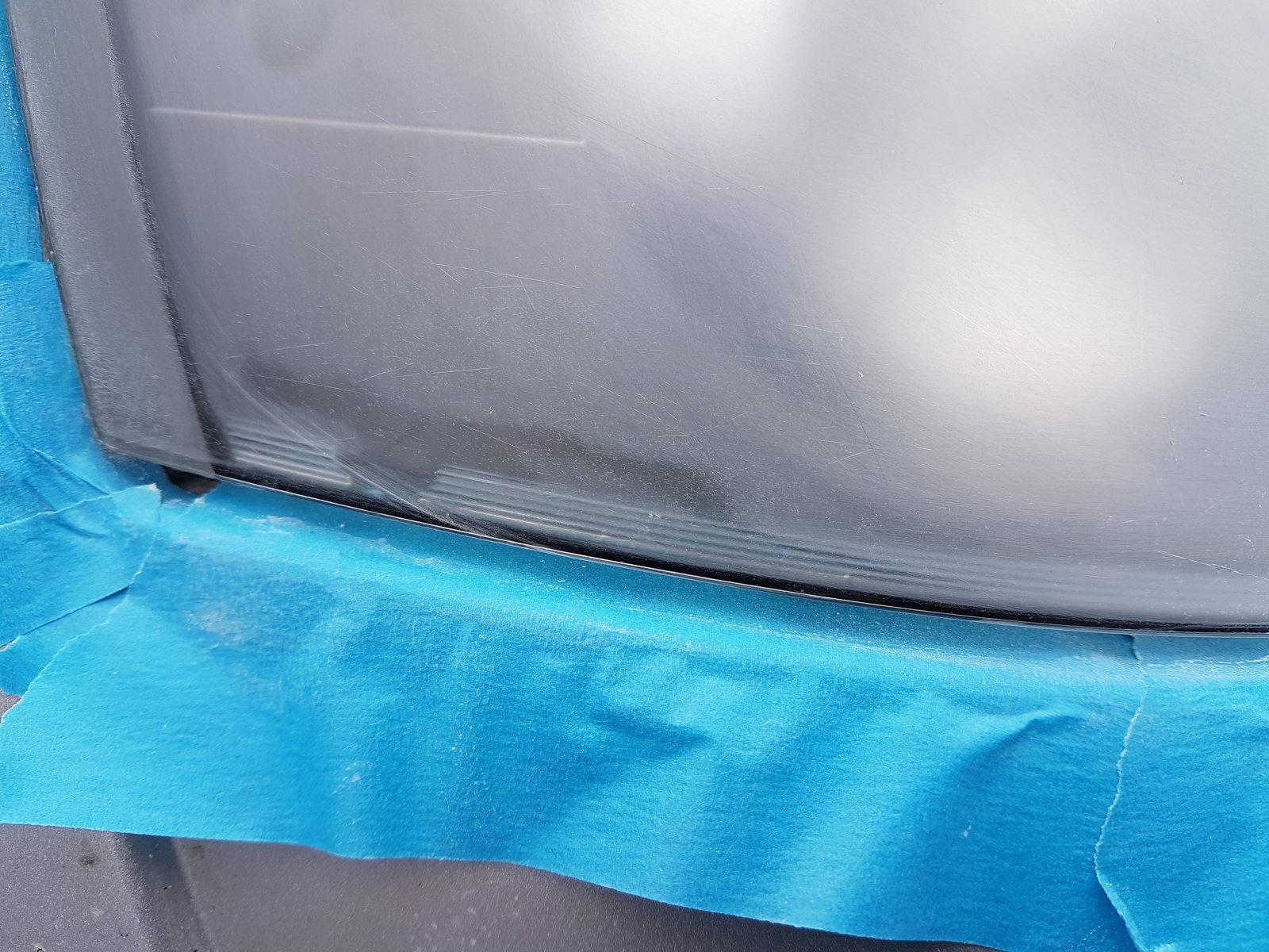

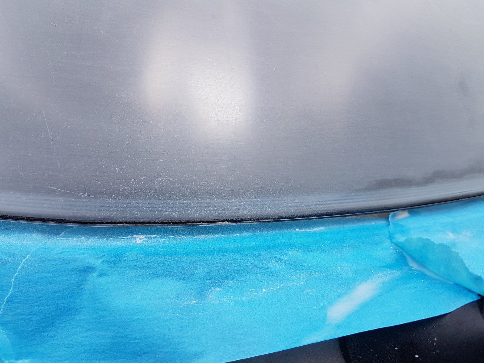

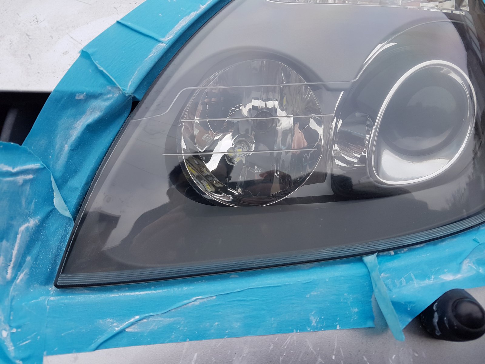

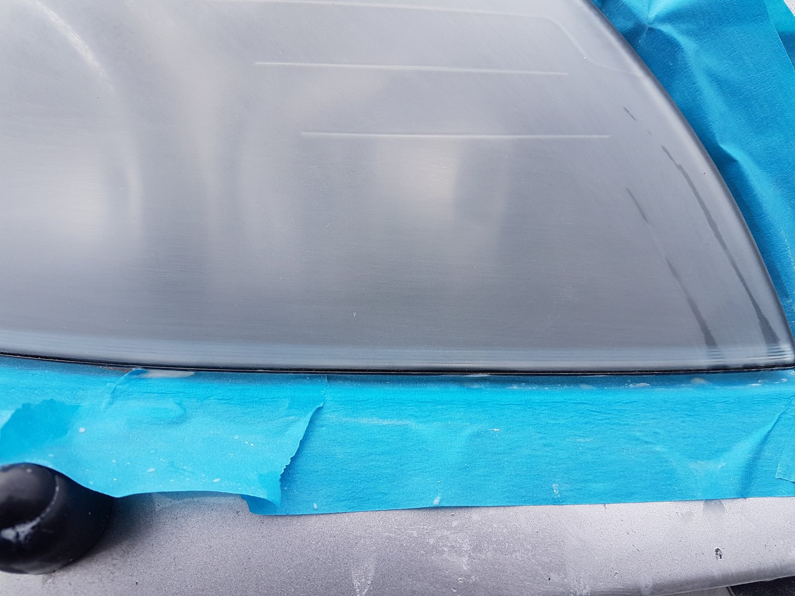

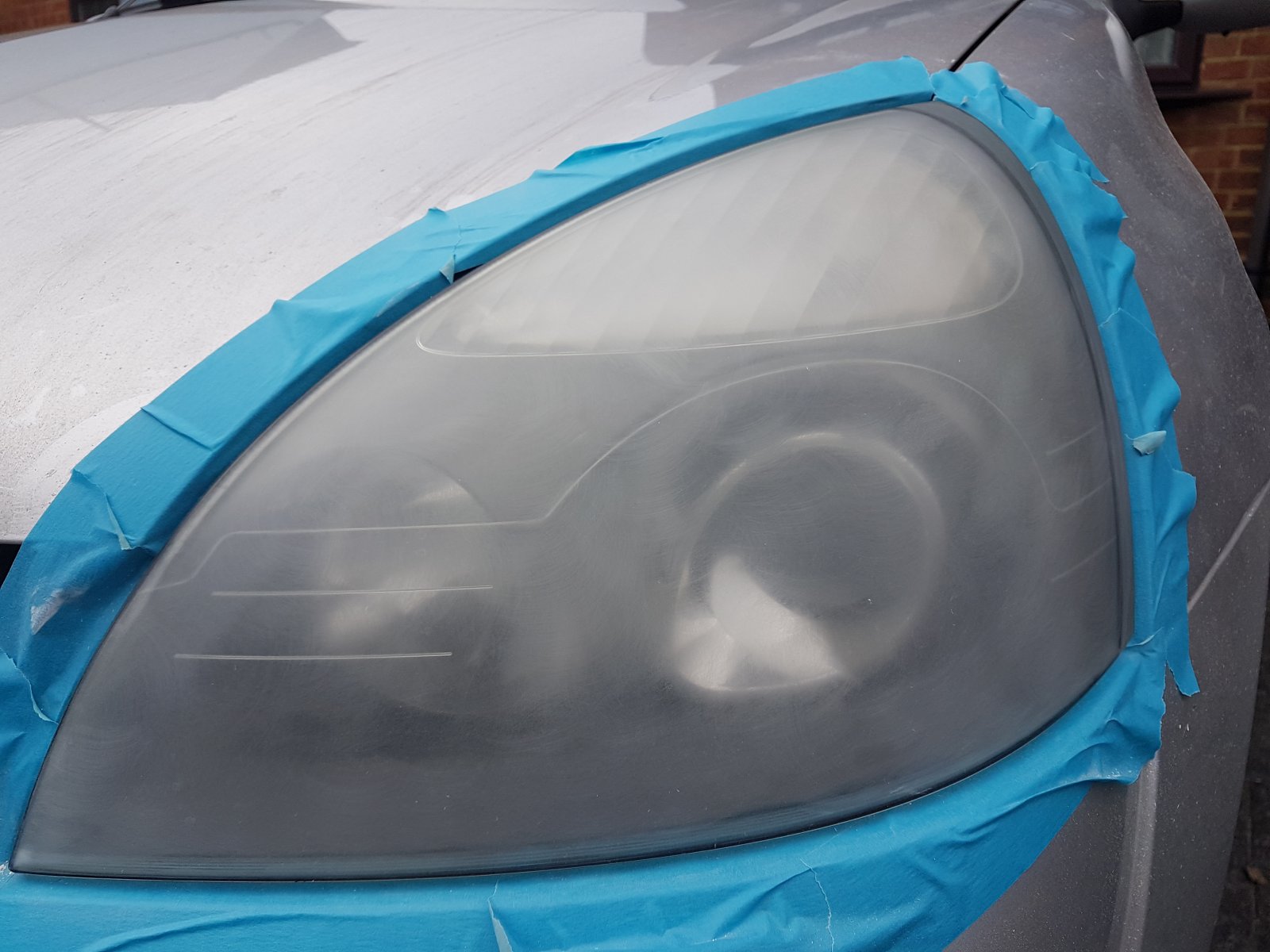

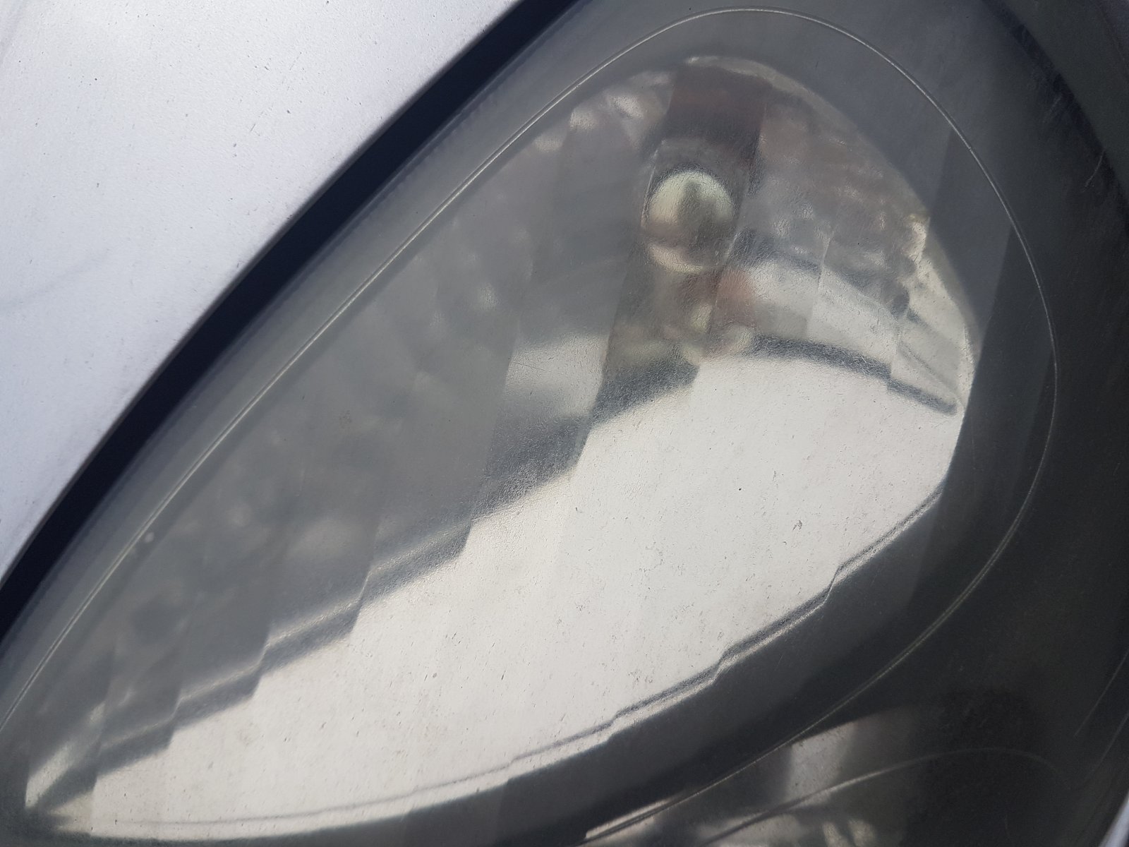

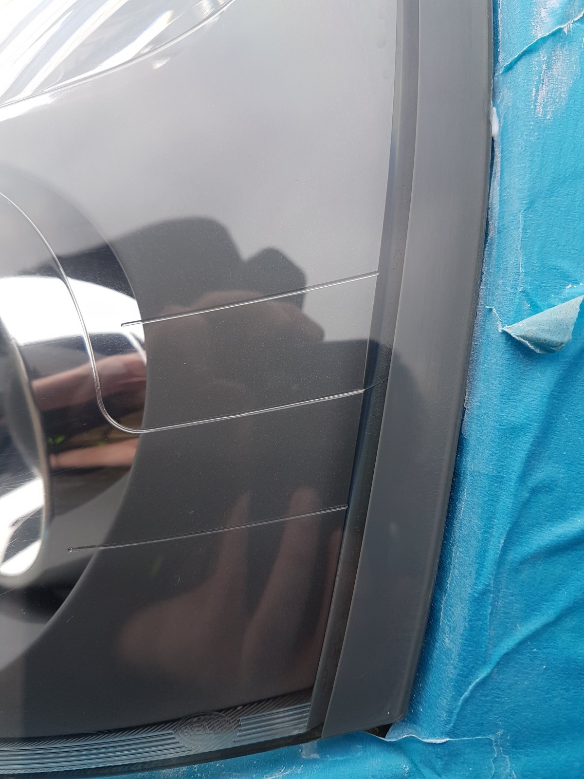

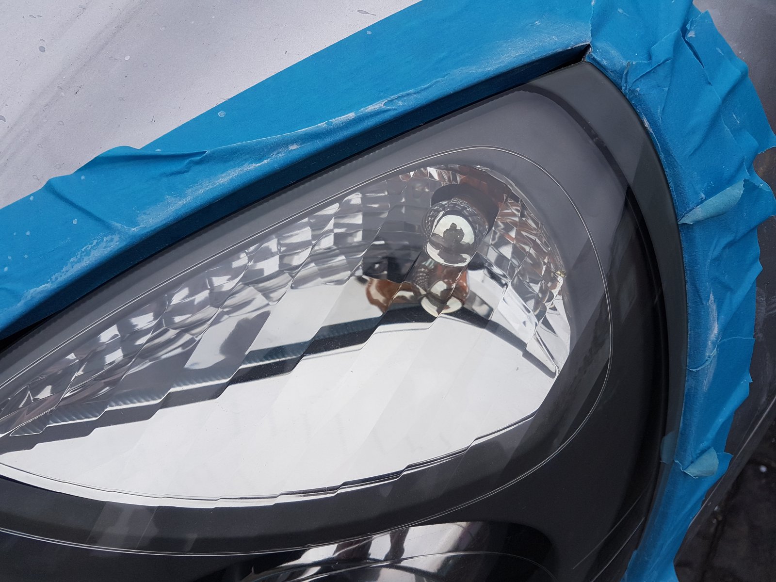

Just to keep @OssPoop happy ;) I decided to do a headlight restoration today. I ordered the bits i needed during the week (AG Headlamp Resto Kit, Tape and sealer). The lights looked OK from a distance, but were quite poor on closer inspection.
First thing i did was grab the de-greaser and give the lights a good wipe over, this will help prevent the sanding discs clogging up. Then mask the lights up, good idea to put a couple layers of tape down in case you catch it with the paper. In the kit you start with 800 grit, i used a cordless drill at first but the batteries were s**t so I ended up using a corded one.
On the first attempt with the drill I still had a lot of scratches, tbh some parts i found it easier to do by hand and a bit of water. So further refining it left me with the above. I then went through the various stages so 1500, 2000 & 3000 and this is the end result. Not perfect by any means, but alot better. I am happy with them for now will seal them with some Gtecniq C4 tomorrow.
In regards to the Autoglym kit it is OK in my opinion, the sanding discs are of decent quality, but like i said some times it's easier to do it by hand rather then use a drill. The polishing compound provided is OK, i would prefer to use 3M Fast Cut Plus as I have done in the past. Overall a positive review and would probably use again.

PAS pump (genuine part reconditioned as Renault don't supply new ones anymore)

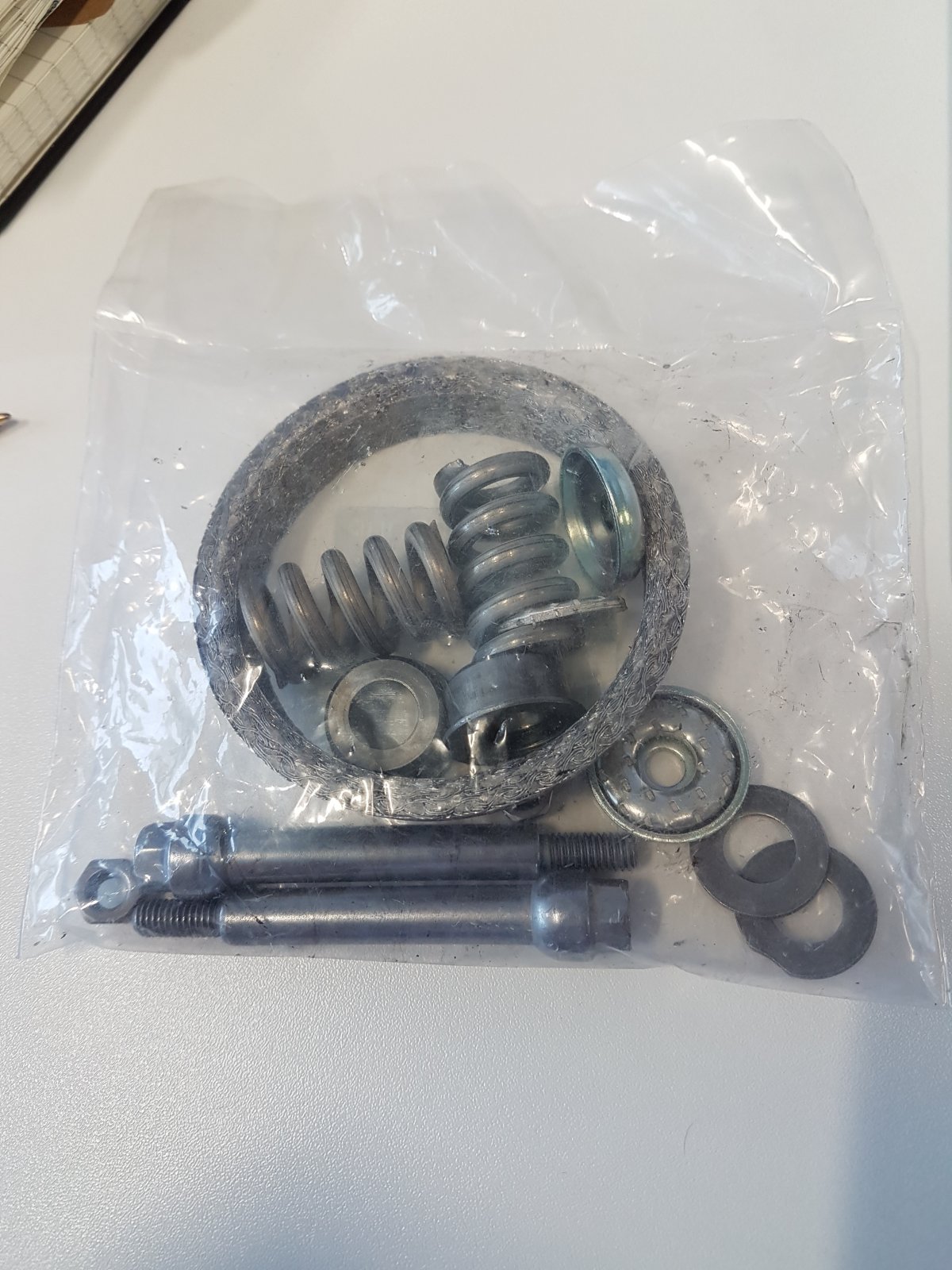

PMS Exhaust system + Genuine CAT fitting kit

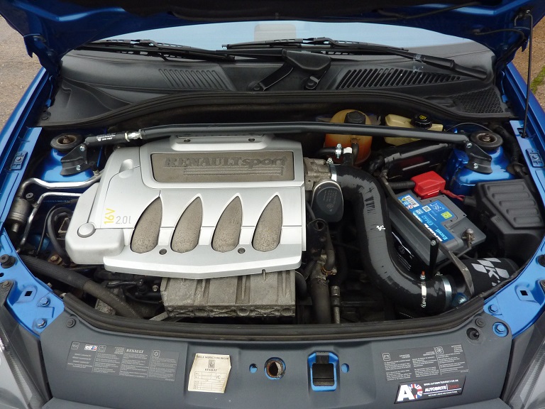

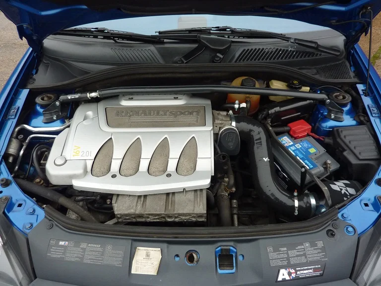

As for the K-Tec induction kit, this is my engine bay (just to tempt you with one 😂)
Rojer
That's an awesome list of things to get done matey, hope all goes well.......... map, new exhaust and induction kit and it'll be nipping along nicely, peace of mind getting the maintenance bits done too :up:
Your evil.....

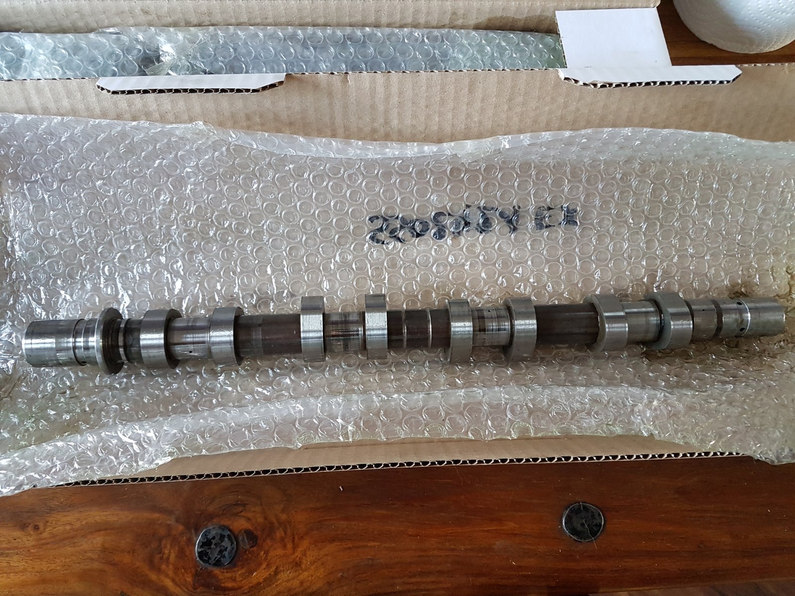

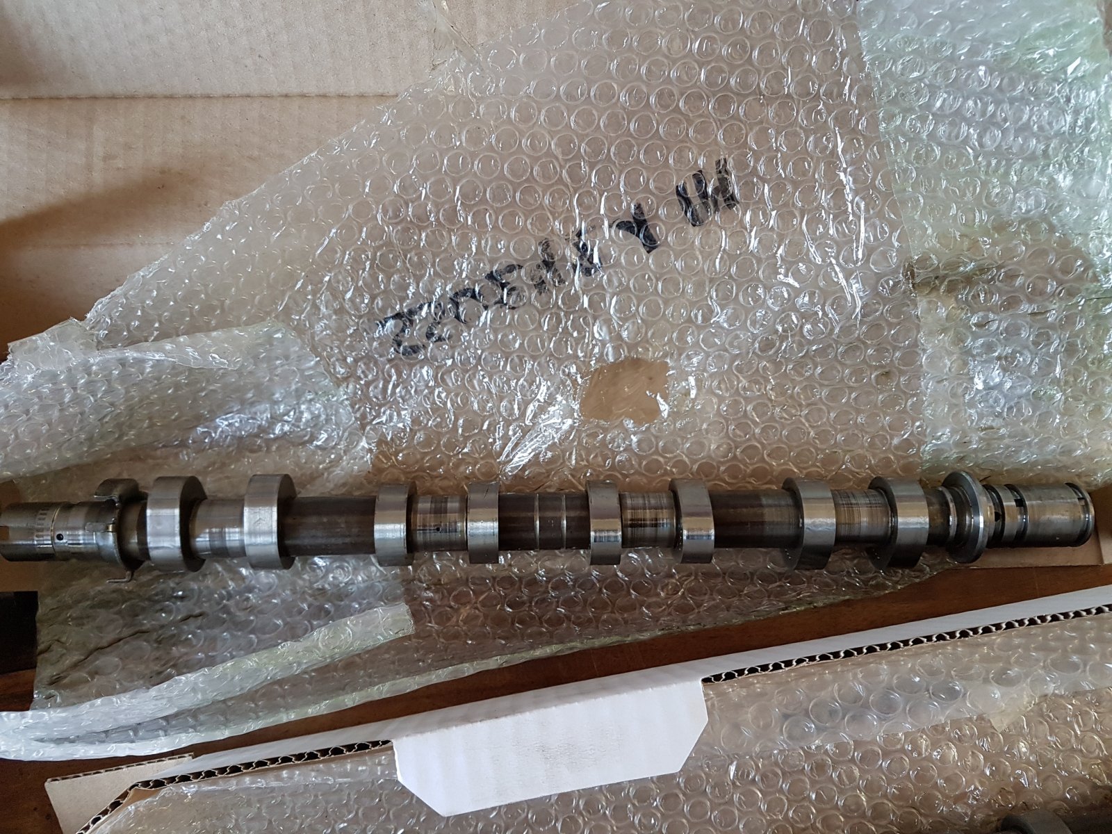

Anyway more exciting updates, I think i may have lost my mind slightly. Tomorrow I will be picking up some low mileage 197 cams :) and my exhaust will be delivered. Very excited, Chris is going to fit my mounts and exhaust on Saturday. I have since emailed Andy about the cams and mapping so waiting a price on that. Couple of pics of what has arrived so far.
Rojer
Awesome!! Will be interested to see how you get on with the cams and mapping when it's all done
Well it should be relatively easy to fit them as far as i'm aware its a straight swap and just have to advance the timing by 8 degrees on one of the cams i think. @NorthloopCup is the man in the know i have been told. Hoping to gain around 10bhp, but more interested in the torque increase. With the induction kit, PMS exhaust and the cams hoping for 185/190bhp and a nice bump in torque.
Speaking of which, i wonder whats in the box.....

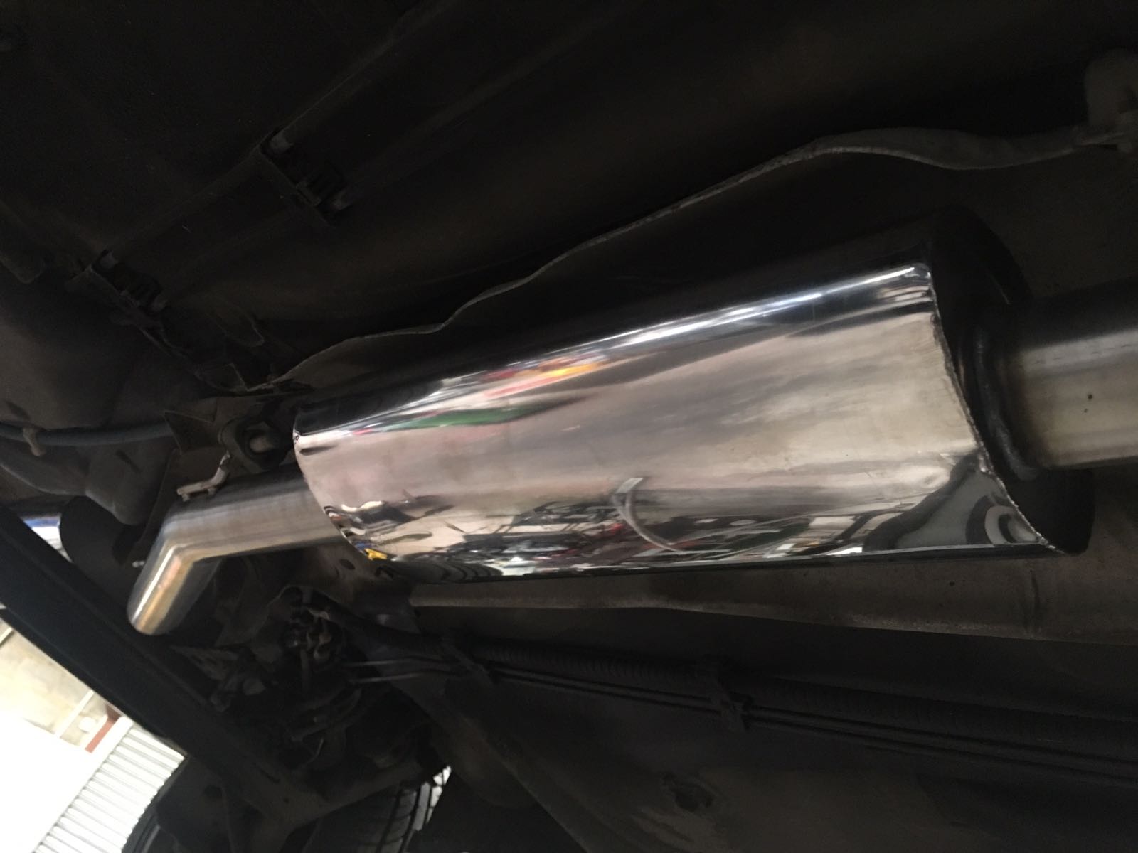

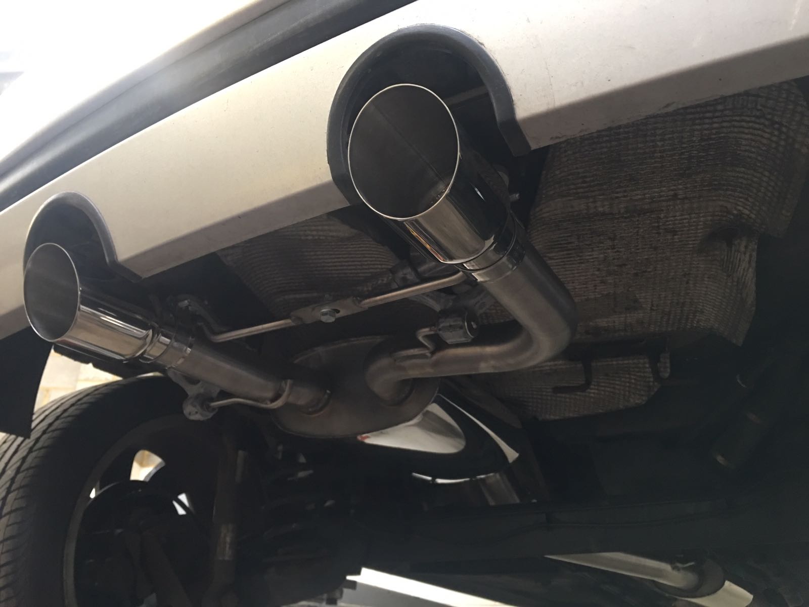

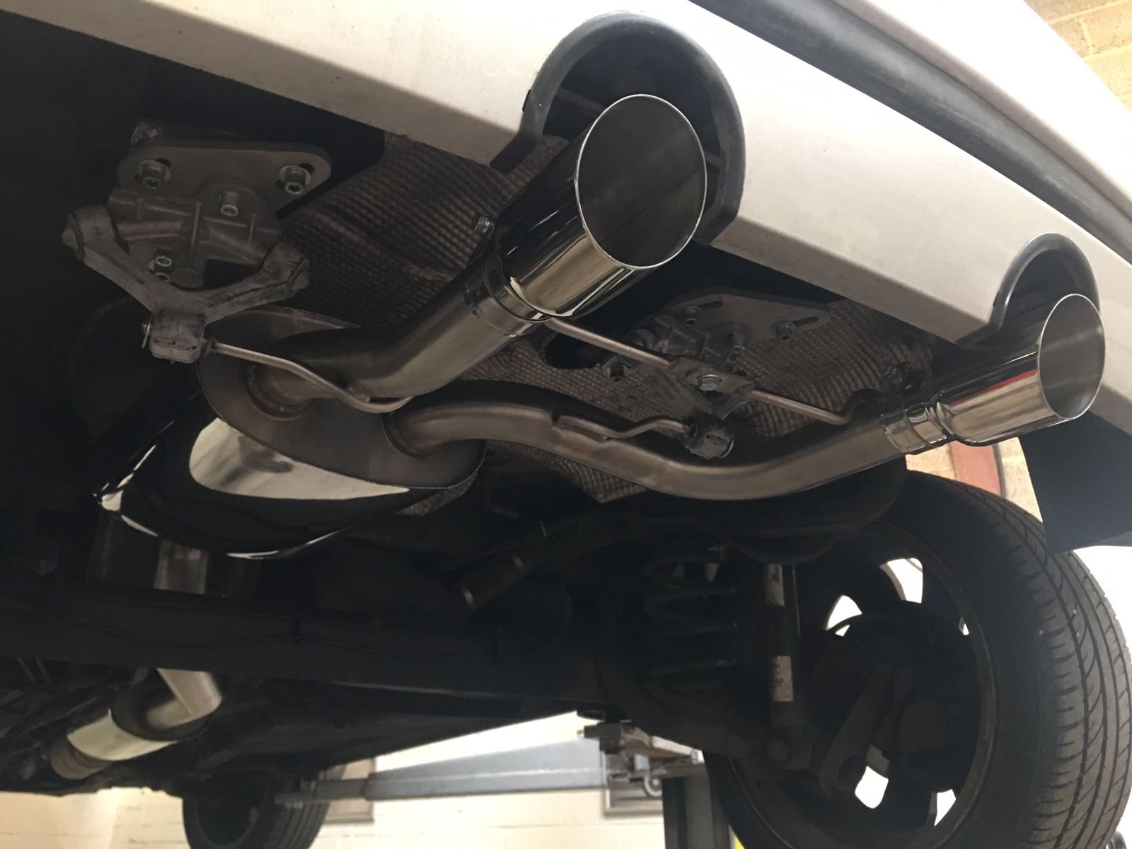

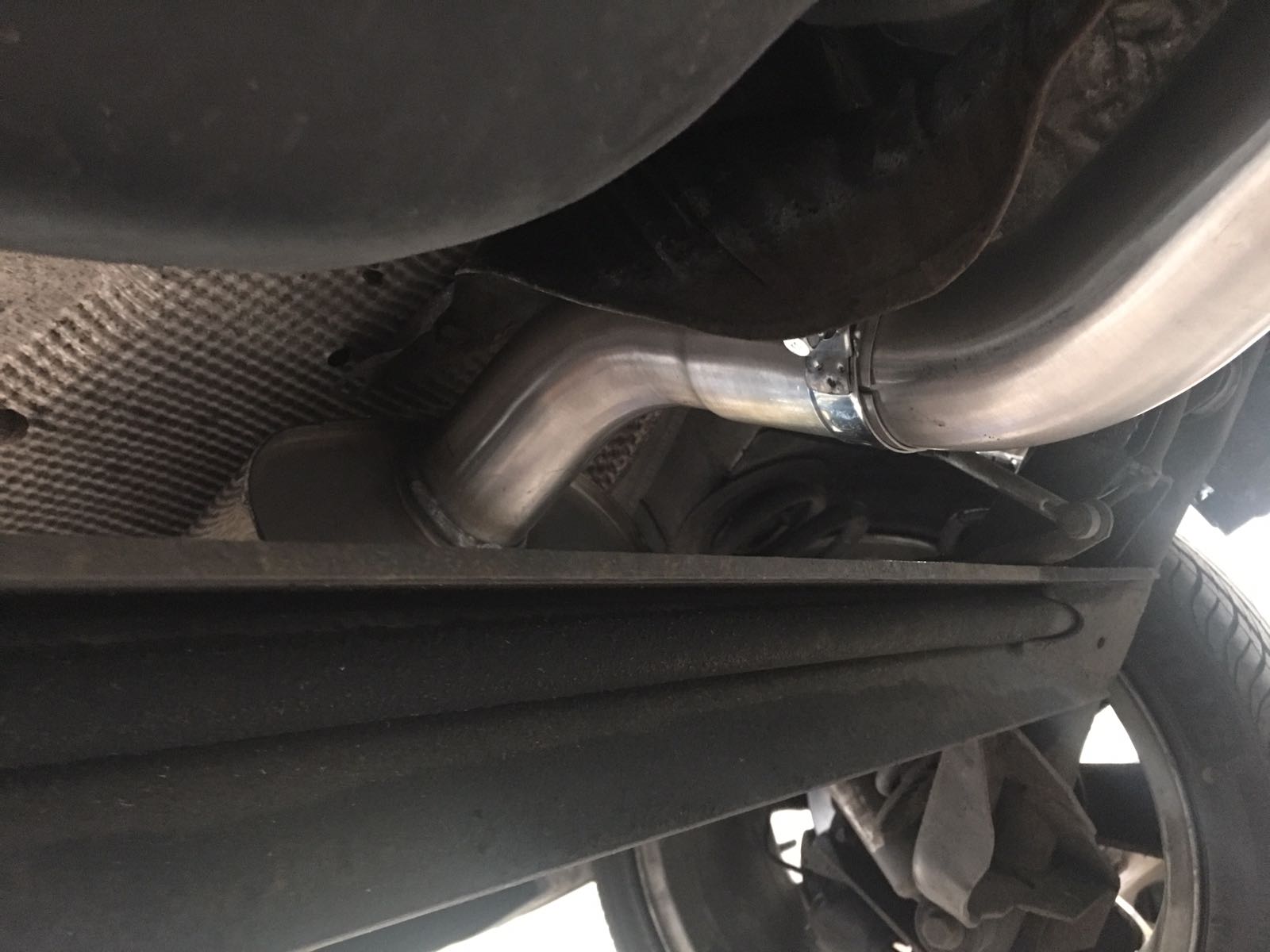

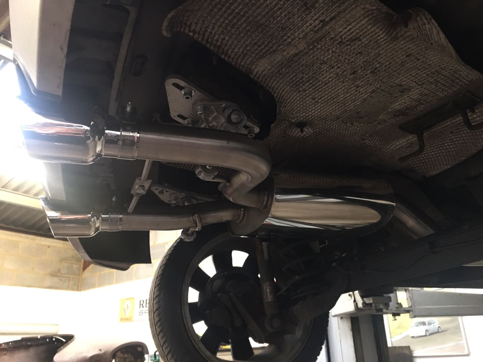

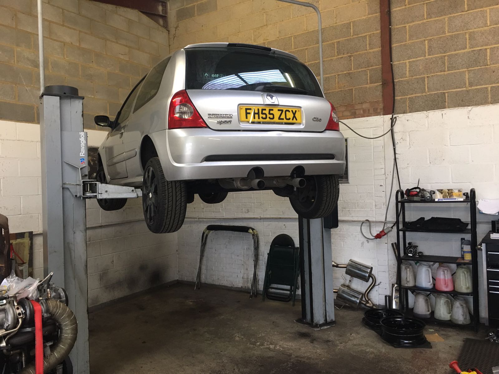

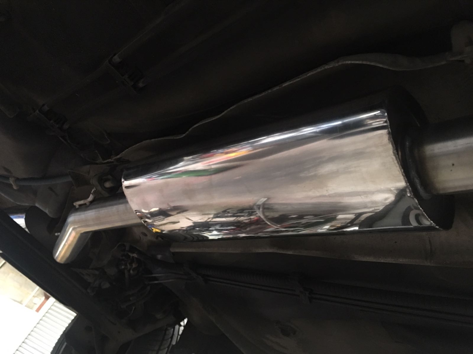

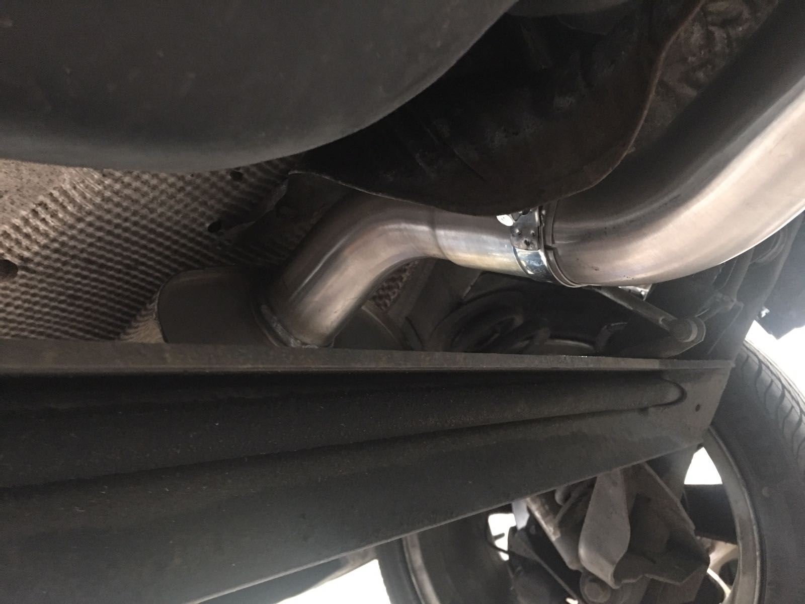

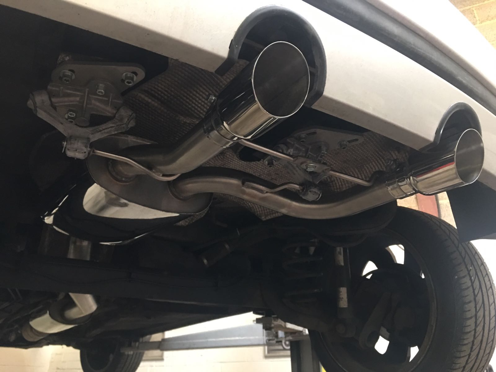

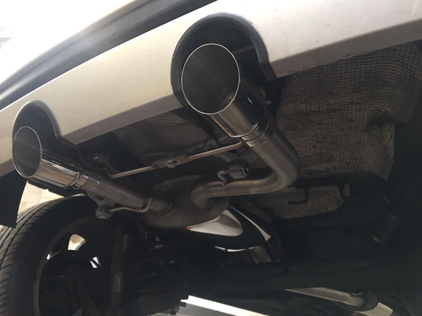

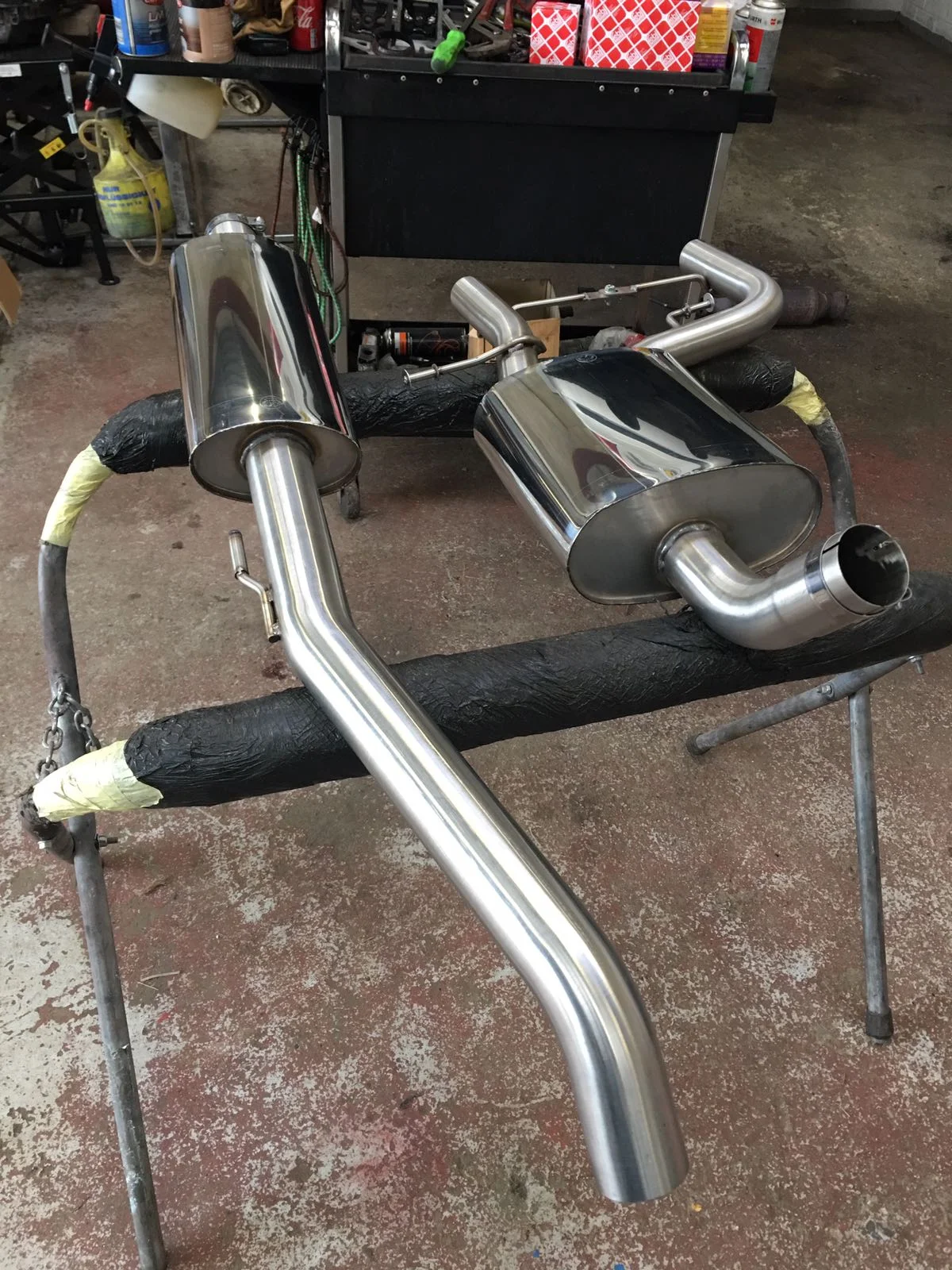

Today was a fun day! I have been all excited because my exhaust arrived, i had the car booked in with Beaniesport for fitting. I must say Chris is a great guy loves to have a chat with you, very knowledgeable with great workmanship. I would highly recommend and will use again for sure. When i arrived just after nine this morning he was pushing this bad boy out of his workshop.
So after a quick chat and a look around the car it was time to get her in and get cracking. Standard exhaust wasn't in the best of shapes and the current CAT fitting kit was pretty poor!
Rojer
Continues...

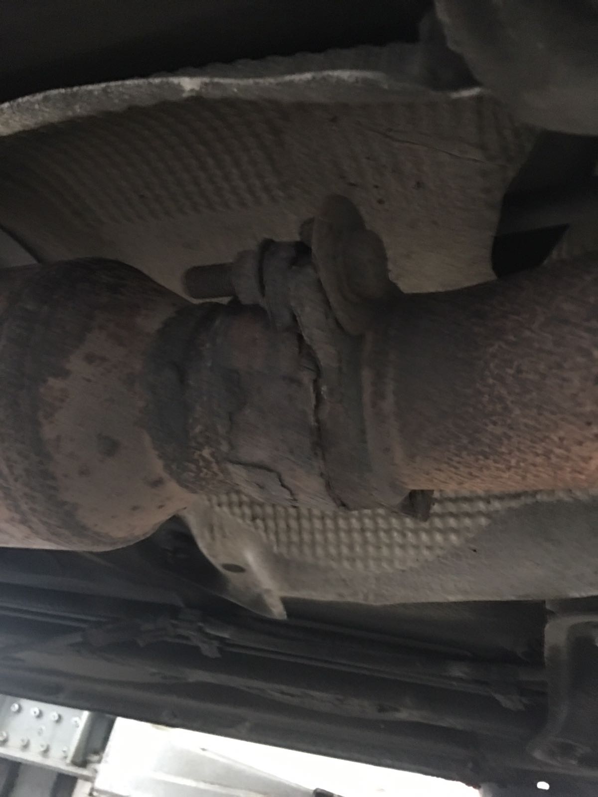

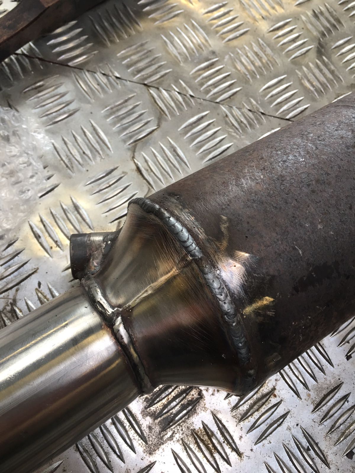

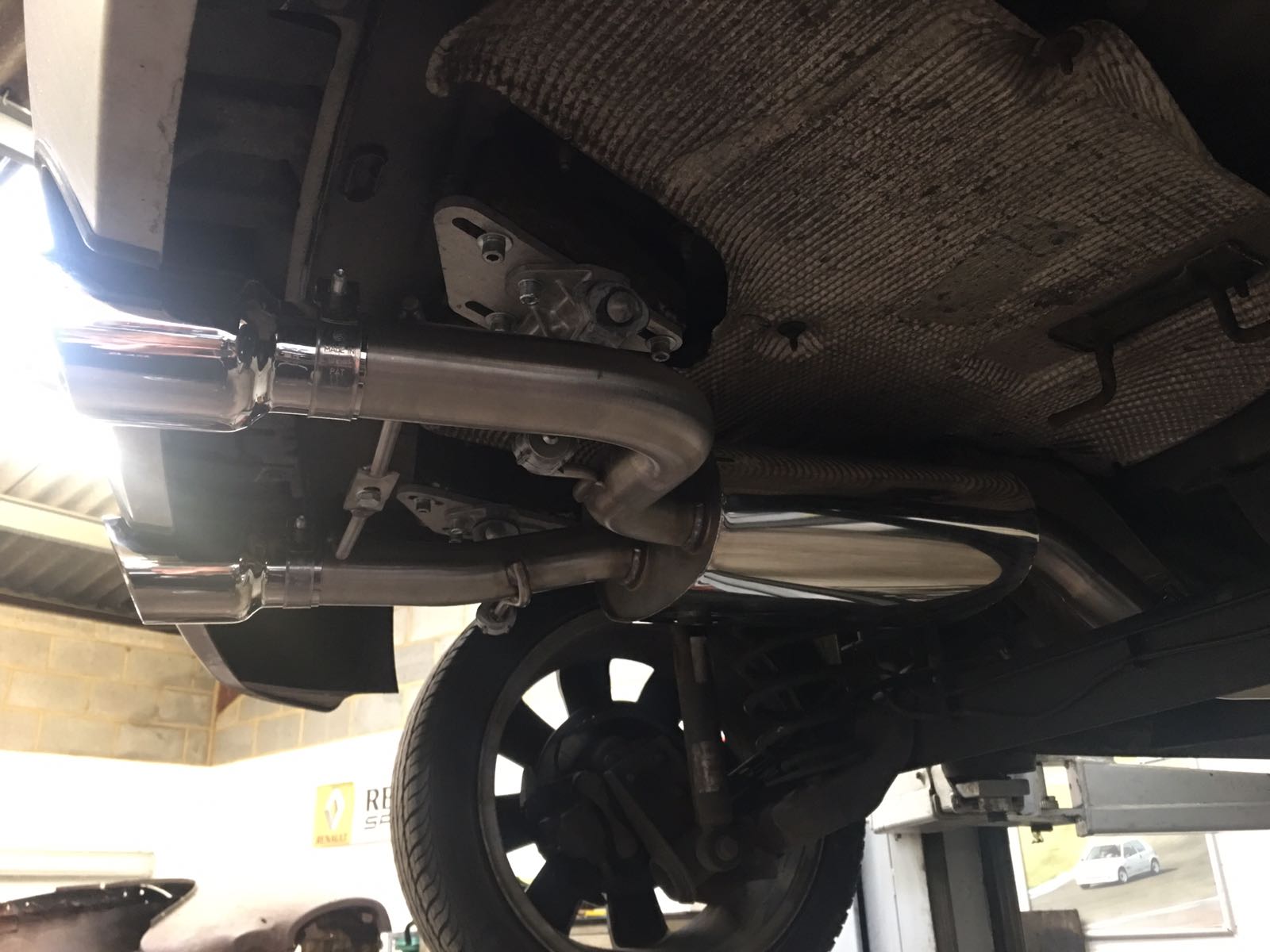

So as you can see Chris did a great job and the PMS exhaust system is lovely extremely good quality. Only think i might change is to go for the 3.5 inch tips to fill the bumper a bit better. The sound just has a bit more depth to it at low revs and sounds nice at high revs not to different from the standard in terms of volume, but a nicer tone overall. Also my hunch was right as the whistling noise has stopped now.
While it was there is also had the new mounts fitted with the PowerFlex insert, now i was a bit worried at first thinking its going to vibrate the car to pieces. However I have been pleasantly surprised so far. A very small increase at idle and the car feels a lot nicer through the corners now, couple extra little vibrations in the cabin, but nothing serious. Overall I am happy with the choice of OEM mounts with the poly insert and I love the exhaust. Stay tuned for more updates!!!!!

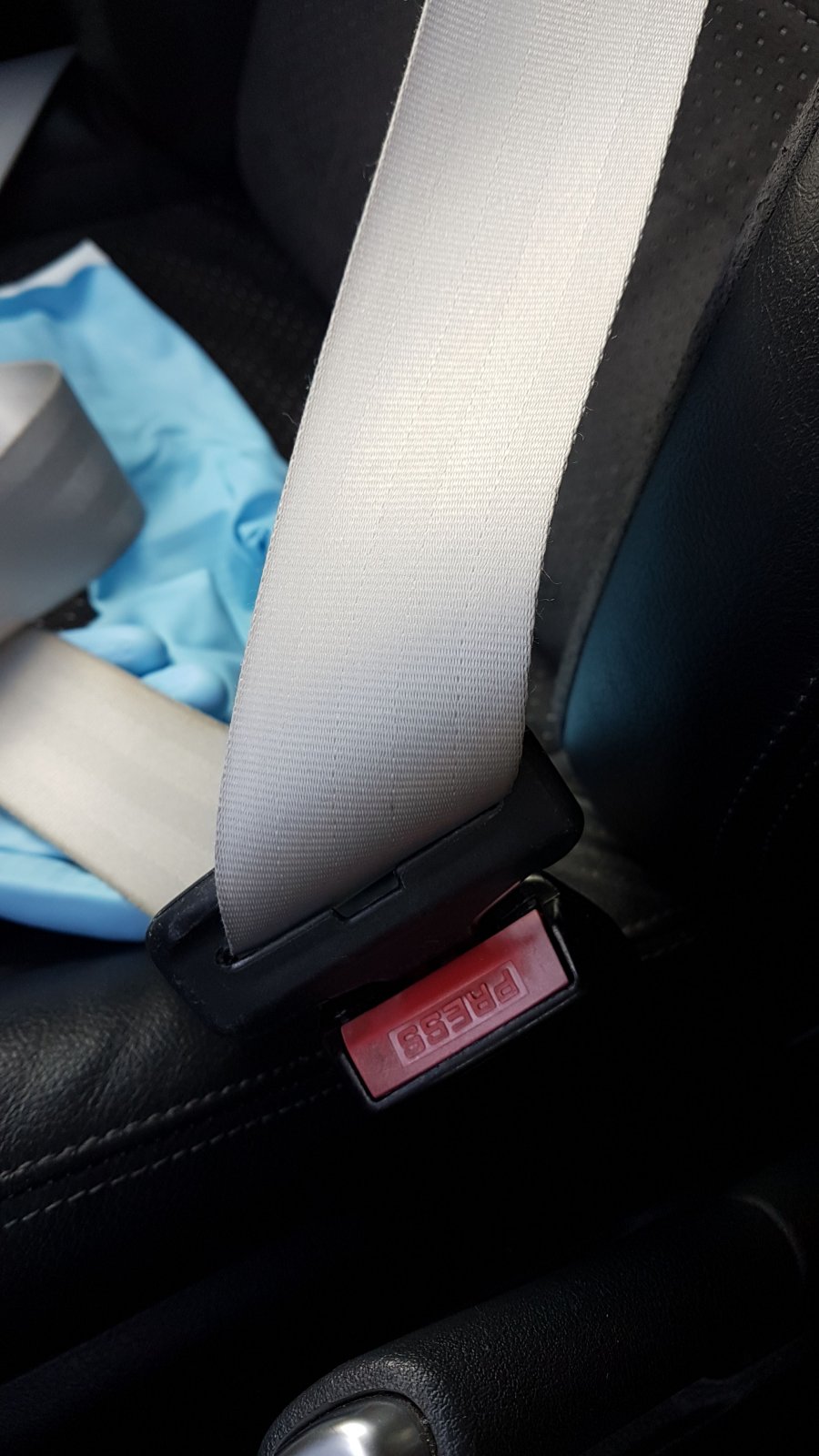

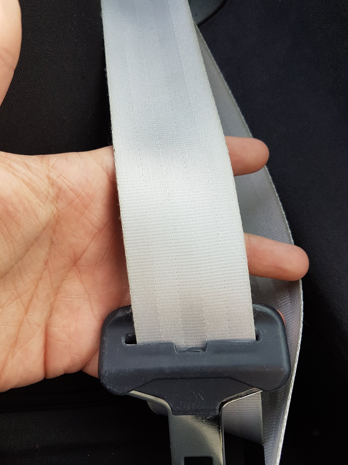

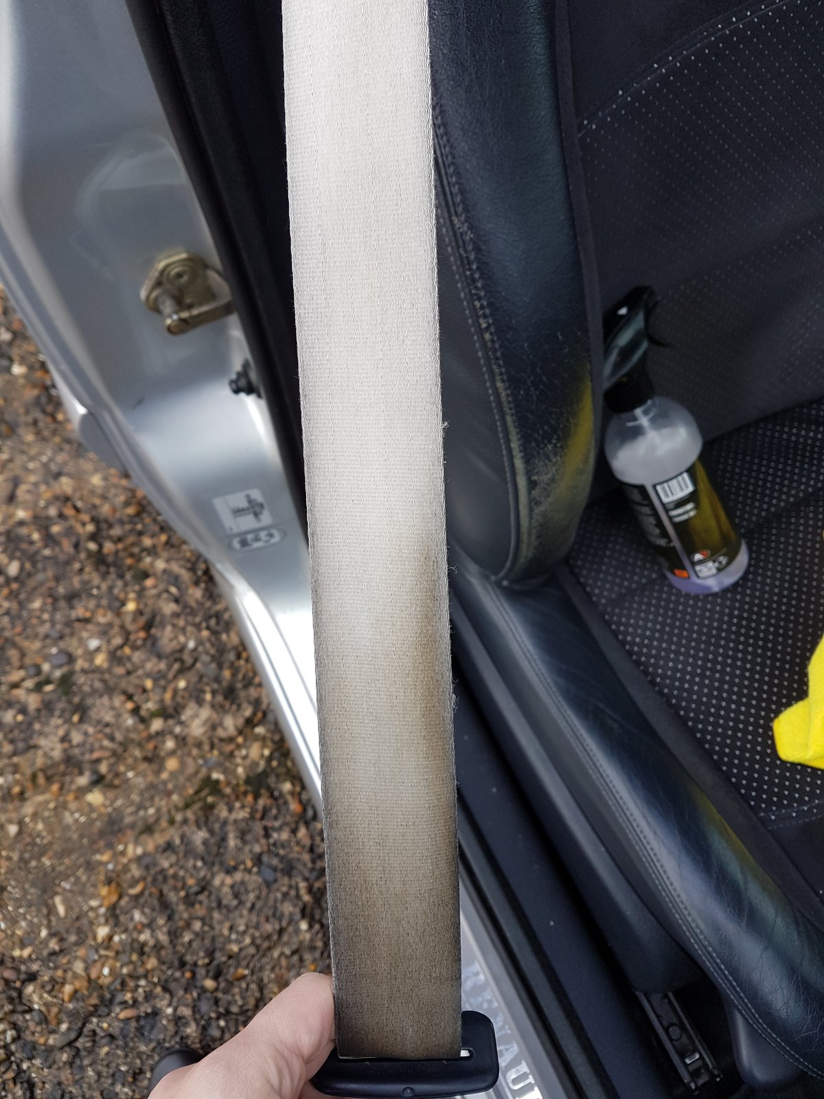

Nothing that exciting today, woke up and decided to clean the belts for work as it was long overdue!
Going to order my intake today :) and think about a PMS shifter....
Continues...
Nice welding on the cat top work.
Rojer
Thanks, it wasn't done by me (i wish). It was Chris at Beaniesport. I have ordered my intake today and some nice PS3s all round can't wait to see what the difference is on those compared to Jinyus haha. Getting them fitted on Saturday :)

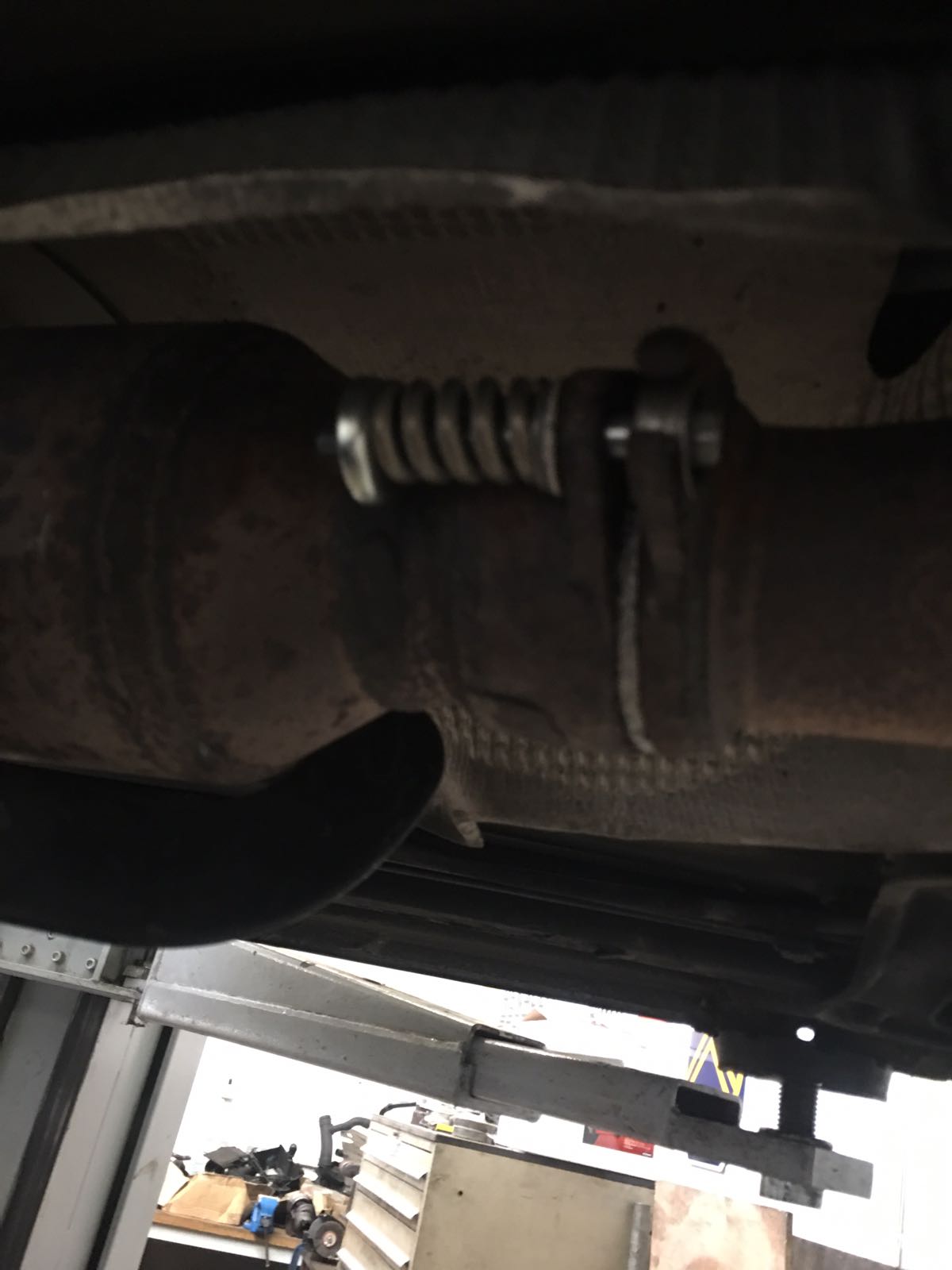

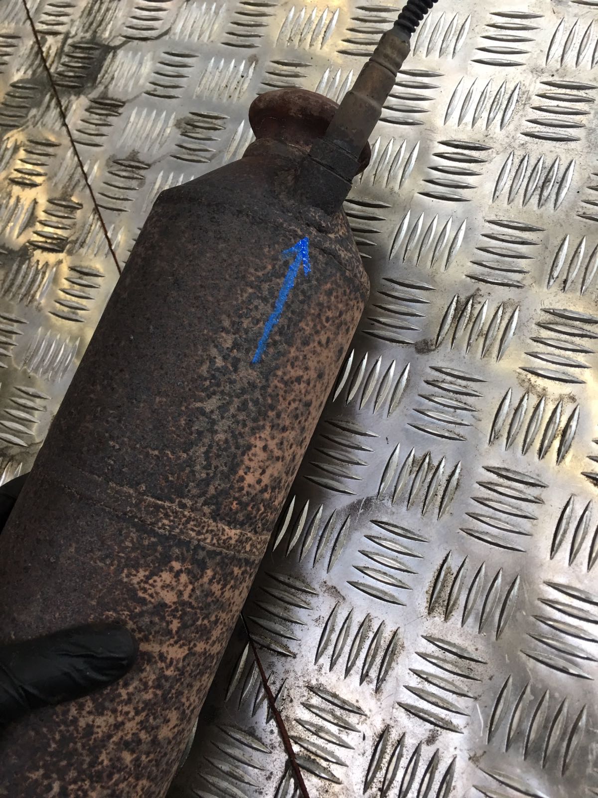

how come you kept the cat?
also with standard mounts and powerflex upper insert and dogbone you'll be fine. it's a nice set up.
Rojer

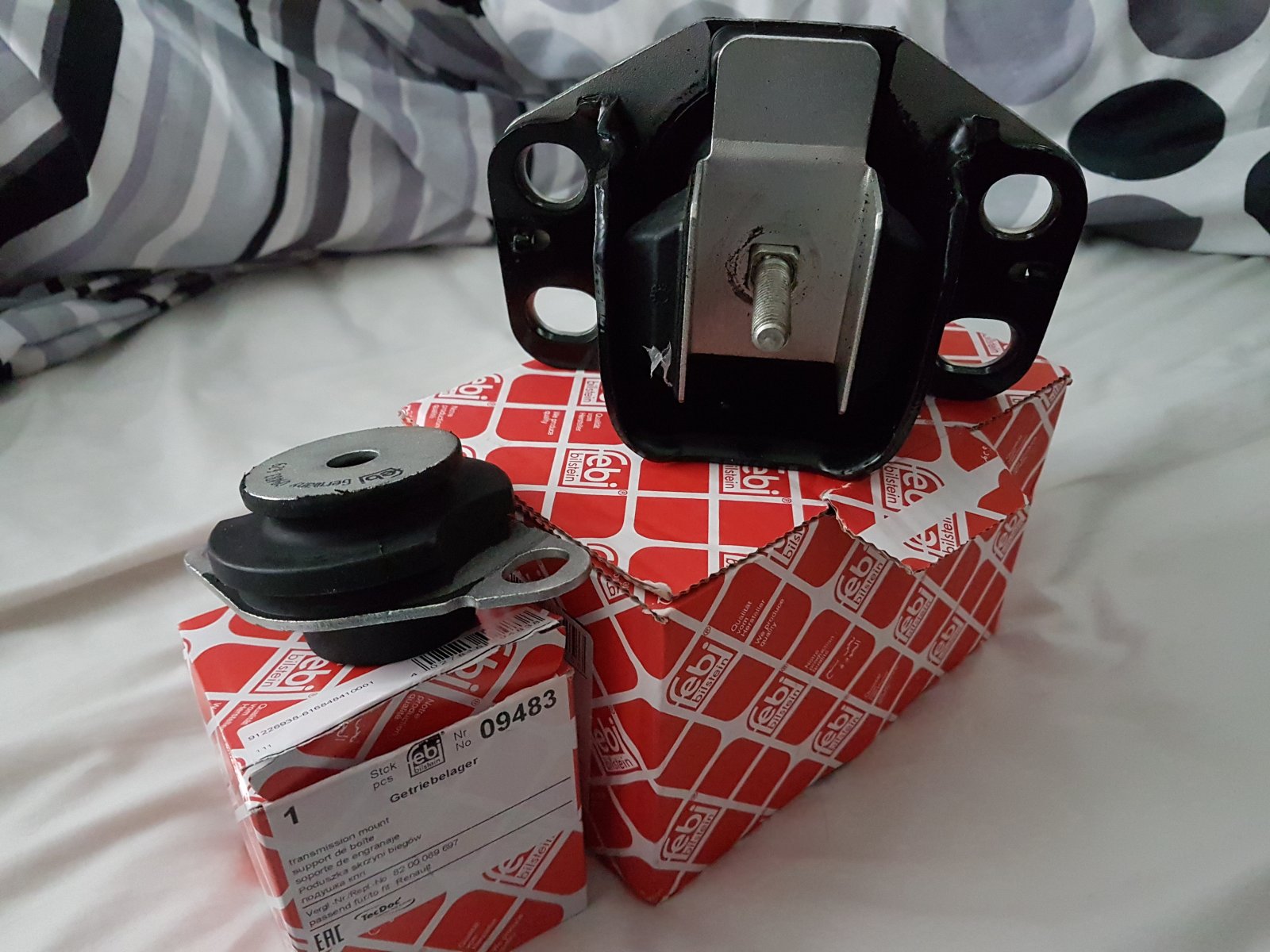

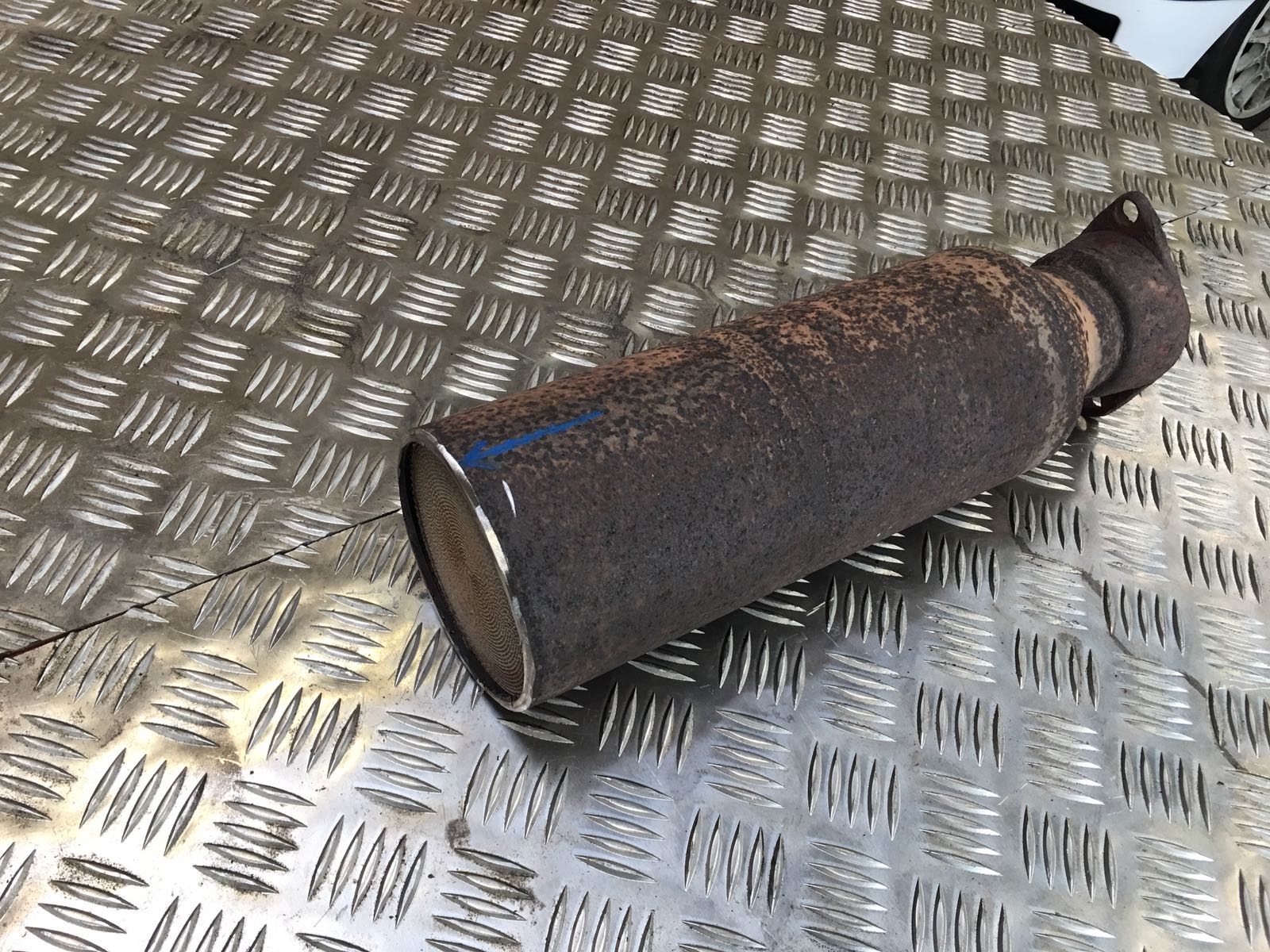

I kept the CAT for a few reasons, when searching on here people were saying the 182 CAT is like a sports one anyway, plus with the derestrictor welded on its a lot better. Also i do 110 miles a day mostly on the motorway so didn't want any drone or anything. The noise is slowly getting a bit louder which is fine and to me it sounds decent. I will have to post some videos of flybys and starting etc.
With the mounts im happy with the OEM ones and the poly insert. I do need to change the dog bone for poly as i thought it had already been done, but its a new OEM one and has no movement yet so will change it over once it perishes.
  dan's cast offs.
my 182 was a bit quieter once i'd decatted it.
the febi mounts seem good as well, have been using them for a while now and everyone's been happy with them.
Rojer
Lol that's weird was it a good CAT? I have never decatted a car and it was quitter haha.
I believe the Febi are OEM Renault anyways and for £37 all in compared to £110 for one it makes sense.

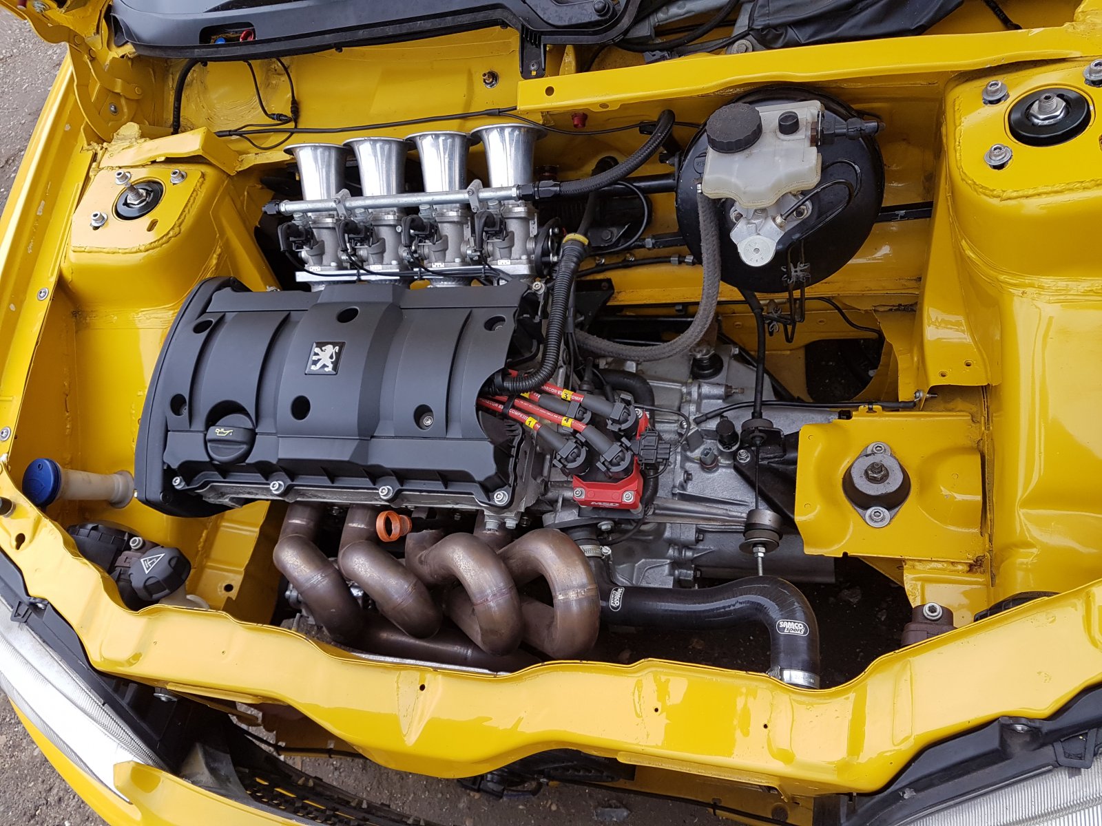

Exhaust looks like a very good decision. Liking Chris's work, also been lucky enough to see the yellow 106 up close. What a beast!
It was a very good decision, I am very happy with it. I would love to see that 106 on the track must be a beast!

Seeing your belts tho --> 🙈 only because they look so good haha mine sooo need doing, its the only dirty bit on my whole interior lol!
I used the @Dr Jekyll method with a bucket of warm water, some Vanish Gold and washing up liquid. Pull the belt out as far as it will go and use a washing peg or a clamp etc to hold it out, leave the belt to soak for 5 in the bucket then use a nail brush to scrub it and leave to dry :)
