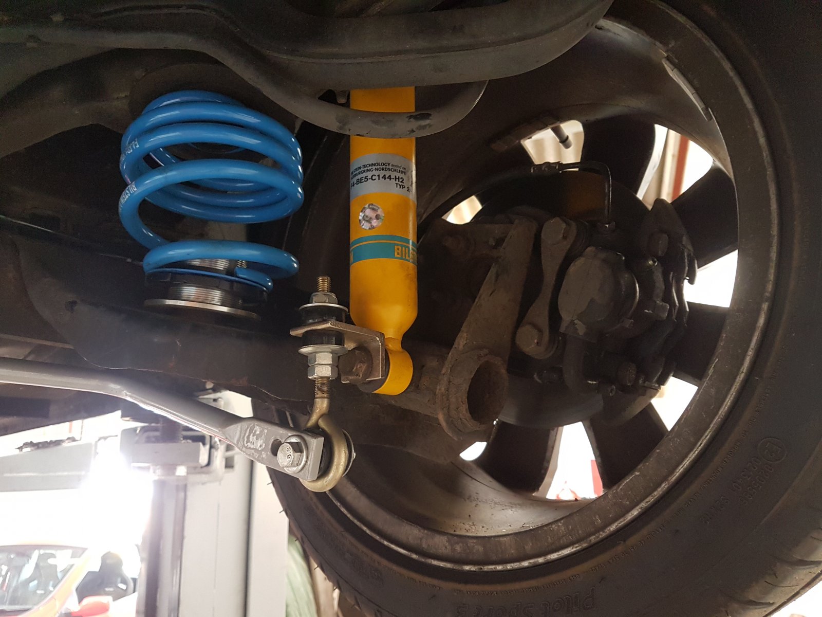

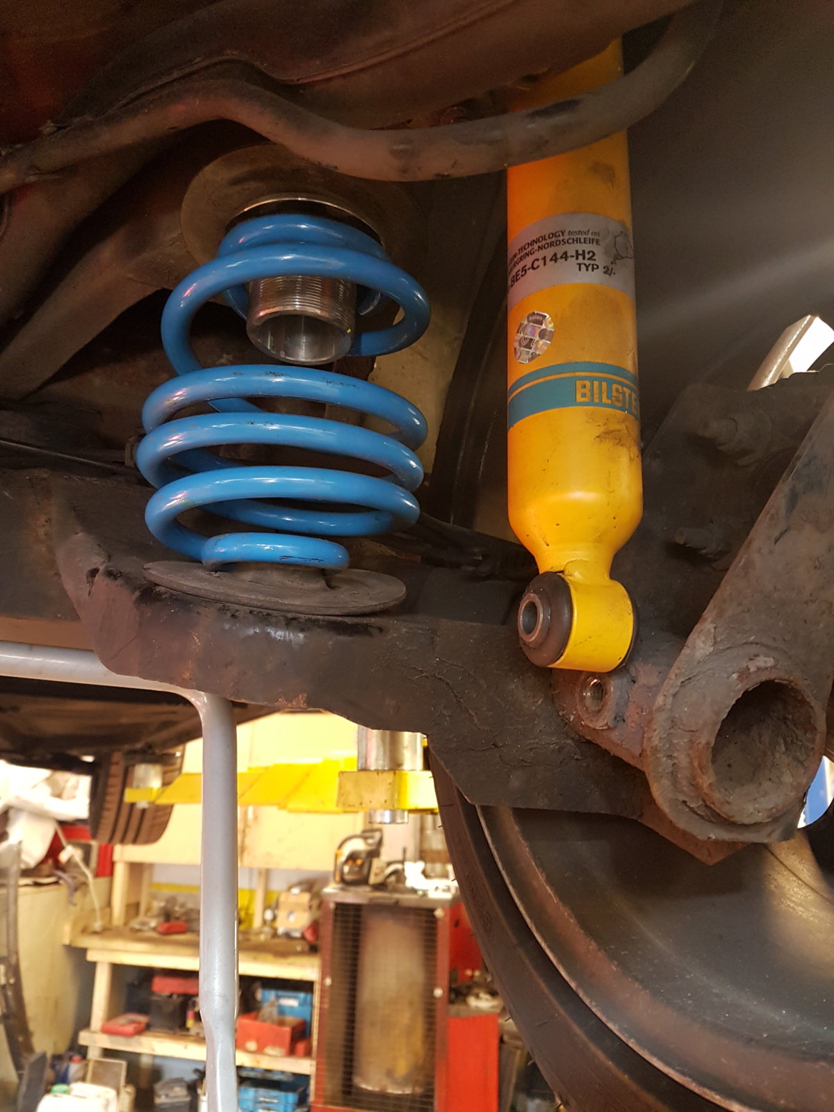

Just a heads up, you have the rear springs upside down.
The adjusters goes at the top.
Seriously?! Guess that's another job then, if the weather is decent at the weekend im going to have a look and adjust myself. Atm i have an issue with the temp gauge doing it's own thing.
Jekyll

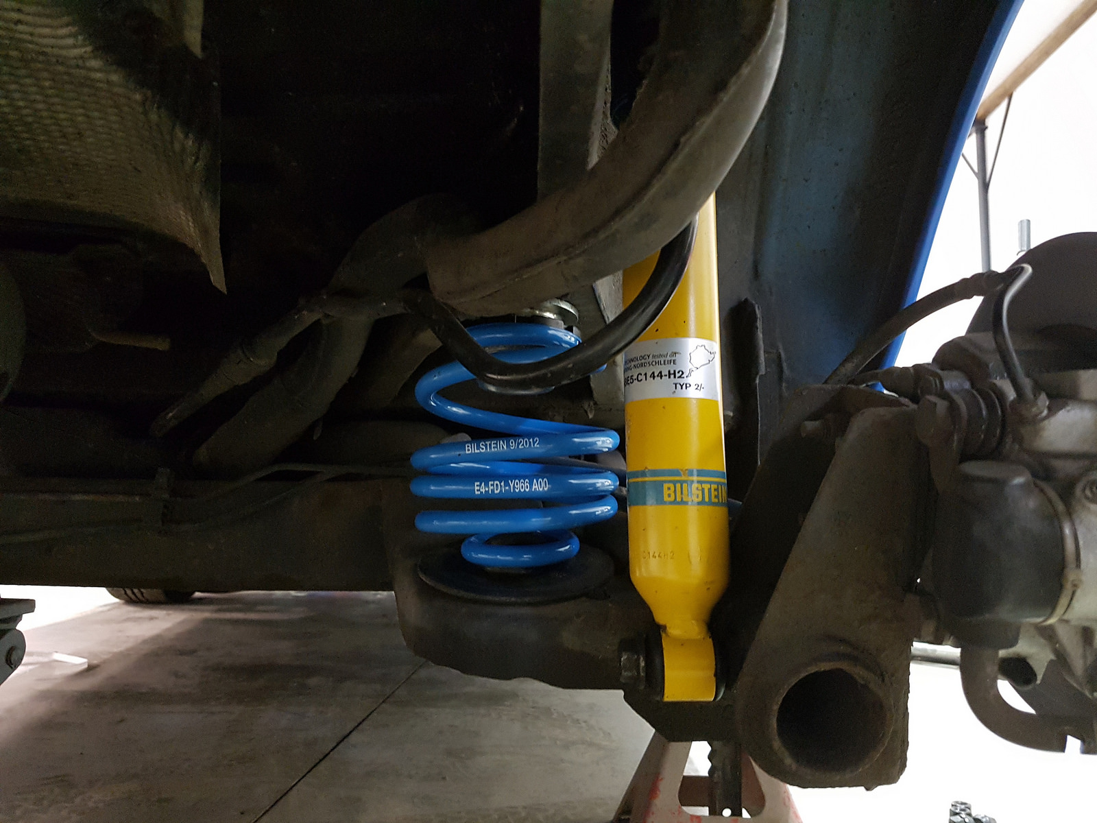

Yes. If you have a look at the writing on the springs, it'll be upside down.
They should look like this:
  172 Turbo

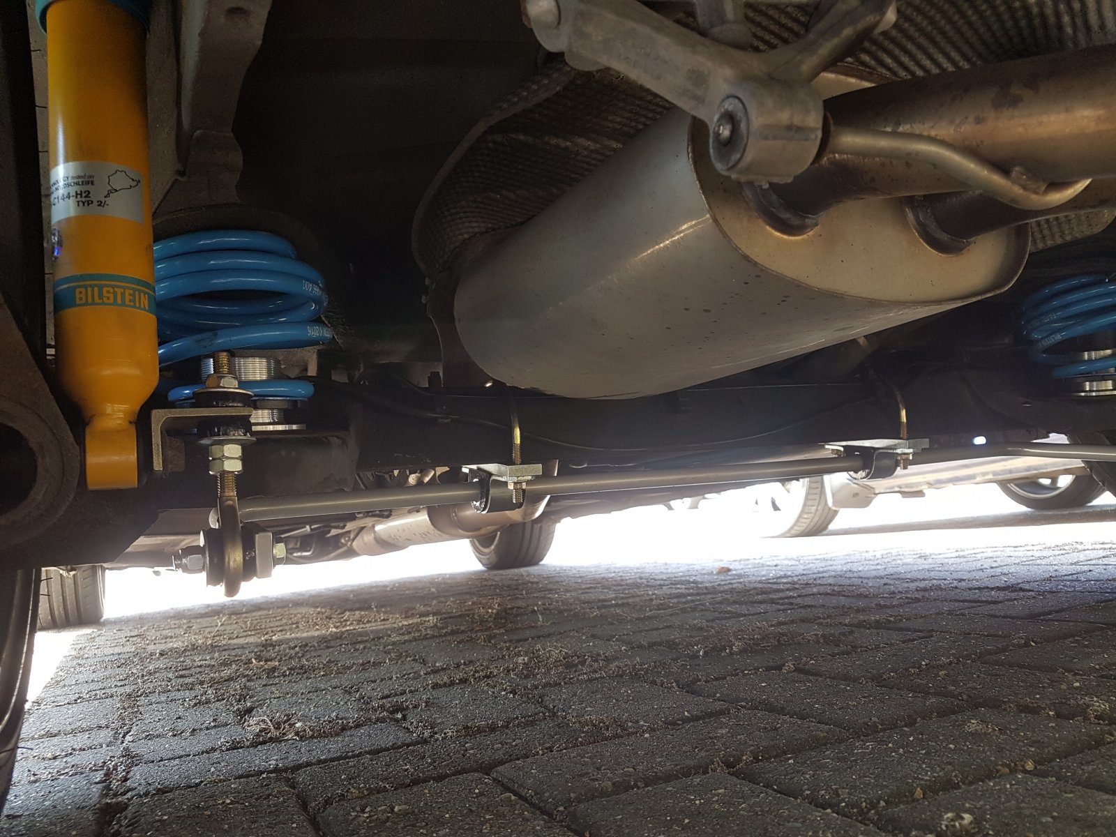

If you look at the above and the below
The adjusters have moved and settled in a weird position, probably giving you the odd feeling
Rojer
Its probably because the adjusters are upside down. I think i also have some spare washers left over that came with the kit. I'll get a picture and hopefully someone can tell me what they are for.
  172 Turbo
Yeah, the adjuster is probably moving around on the bottom mount.
I think all other kits go the other way, Billies usually go this way apart from on certain models!
Rojer

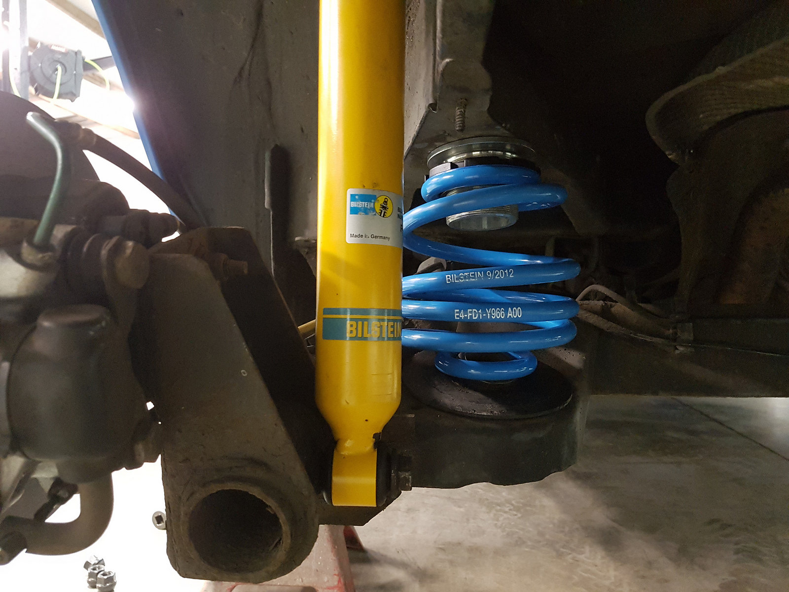

View attachment 193540 View attachment 193541
Mark, is there any reason why they are supposed to go that way. Did Bilstein say that? I was thinking it might be because the way the spring is.

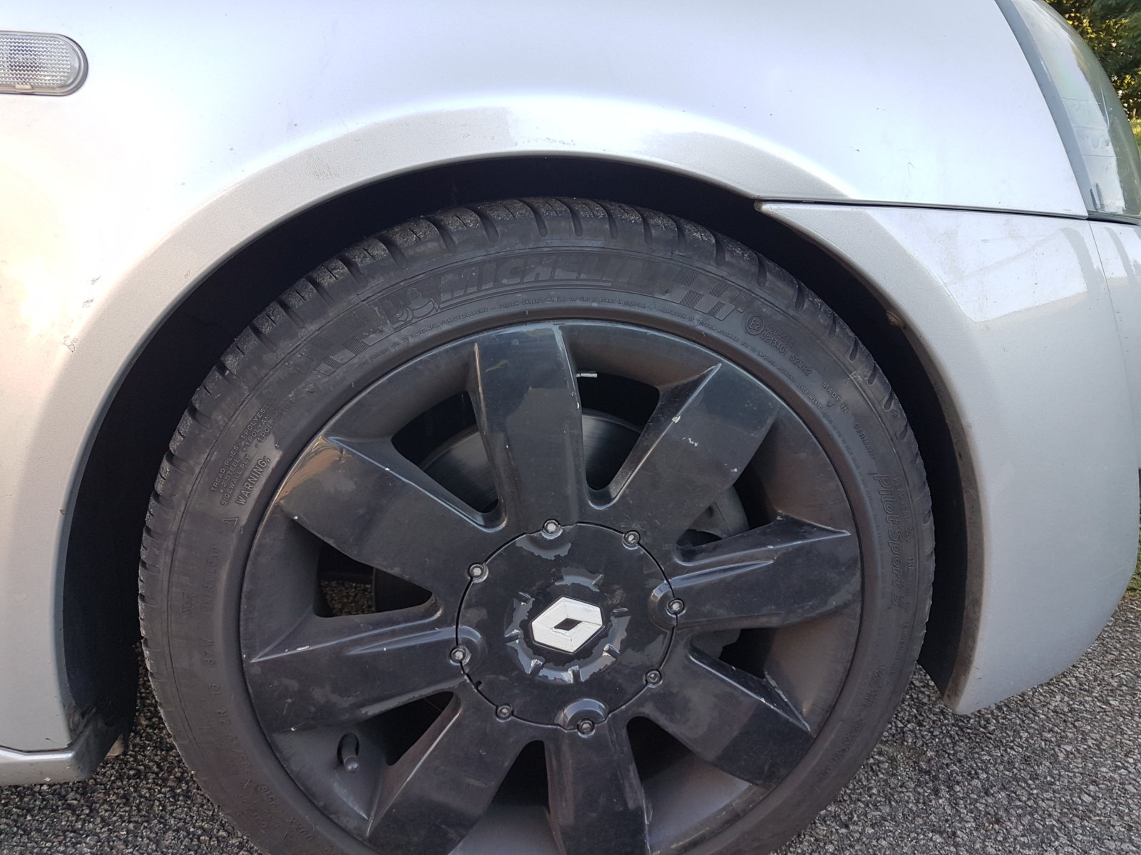

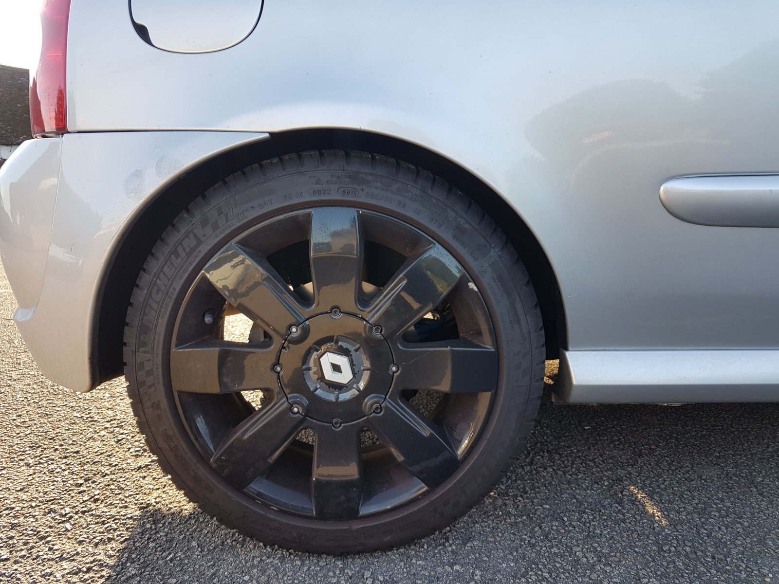

Anyways been a busy night, on the way home got a call from Kev and he told me to come to the shop. Stopped by after work and we got it on the ramp, swapped the rear springs round and lowered them all the way. Then at the front lowered it around 10 turns. Took it for a spin and OMG sooooooooo much better, can't believe it! The dampers must of been at the top of their stroke and that was the problem. The front can probably go a bit lower so i will wait for a proper setup next week. Got a couple of pictures of how the wheels are sitting now.

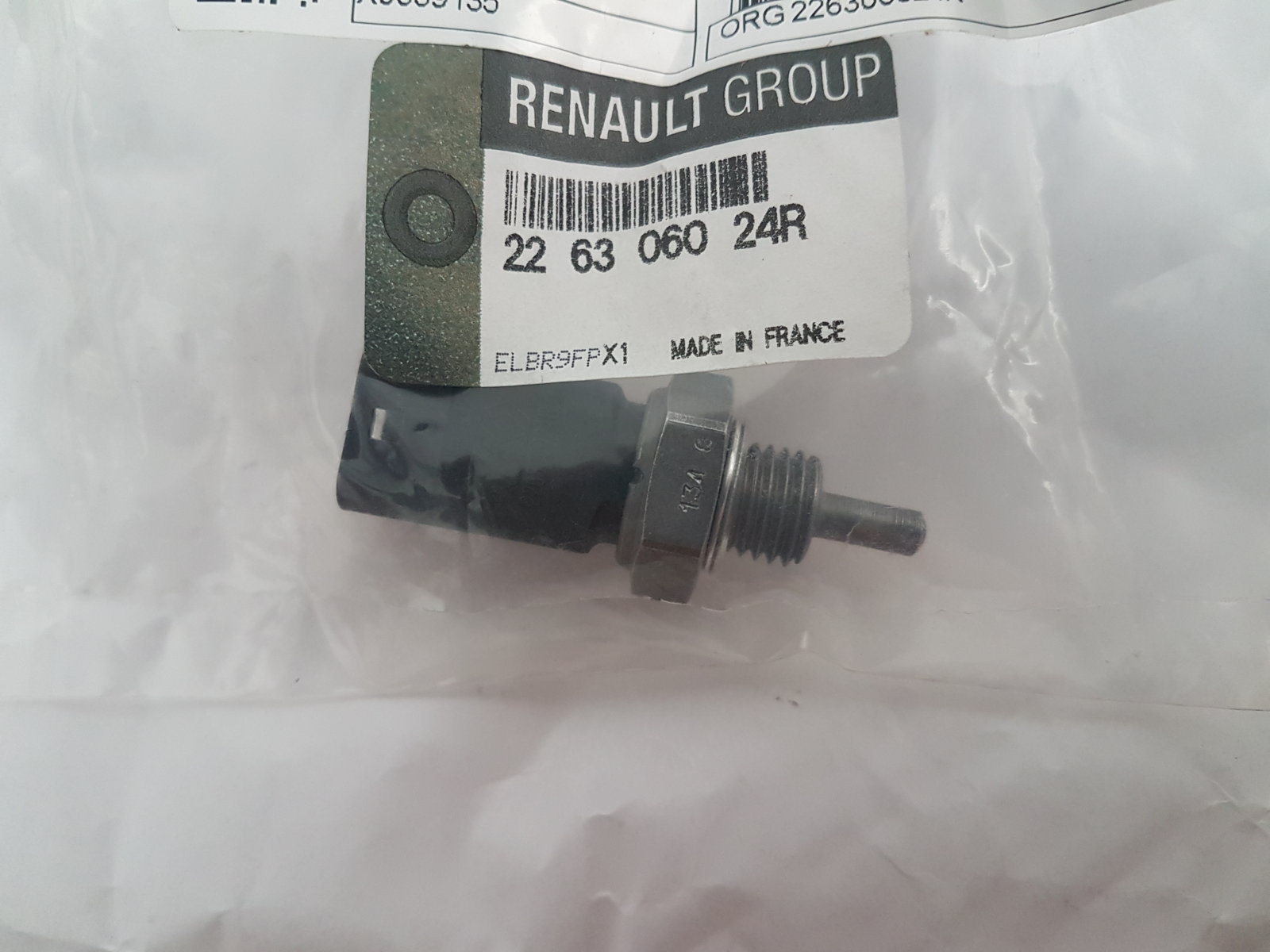

Also been having issues with my temp gauge and tonight it just dropped to zero and you try to accelerate and the car wouldn't go anywhere just bogged down and was braking itself. I pulled over and everything looked OK, gave the coolant sensor wires a bit of a wiggle and so far all good. I have already ordered a new sensor and stat which will be here tomorrow so that should fix that.

Happy days buddy!! Glad it's much better now. It did seem odd as I've never heard or felt the billies being stiff.
As for the way the springs are, it's just how bilstein designed them. Not sure why. I "think " KW ones are the same, with the adjusters at the top.

Thanks Steve. Think i might take the rear adjusters out to get some more lows, not sure how much lower the front can go without causing issues. Need some diff wheels to get it sitting 100%

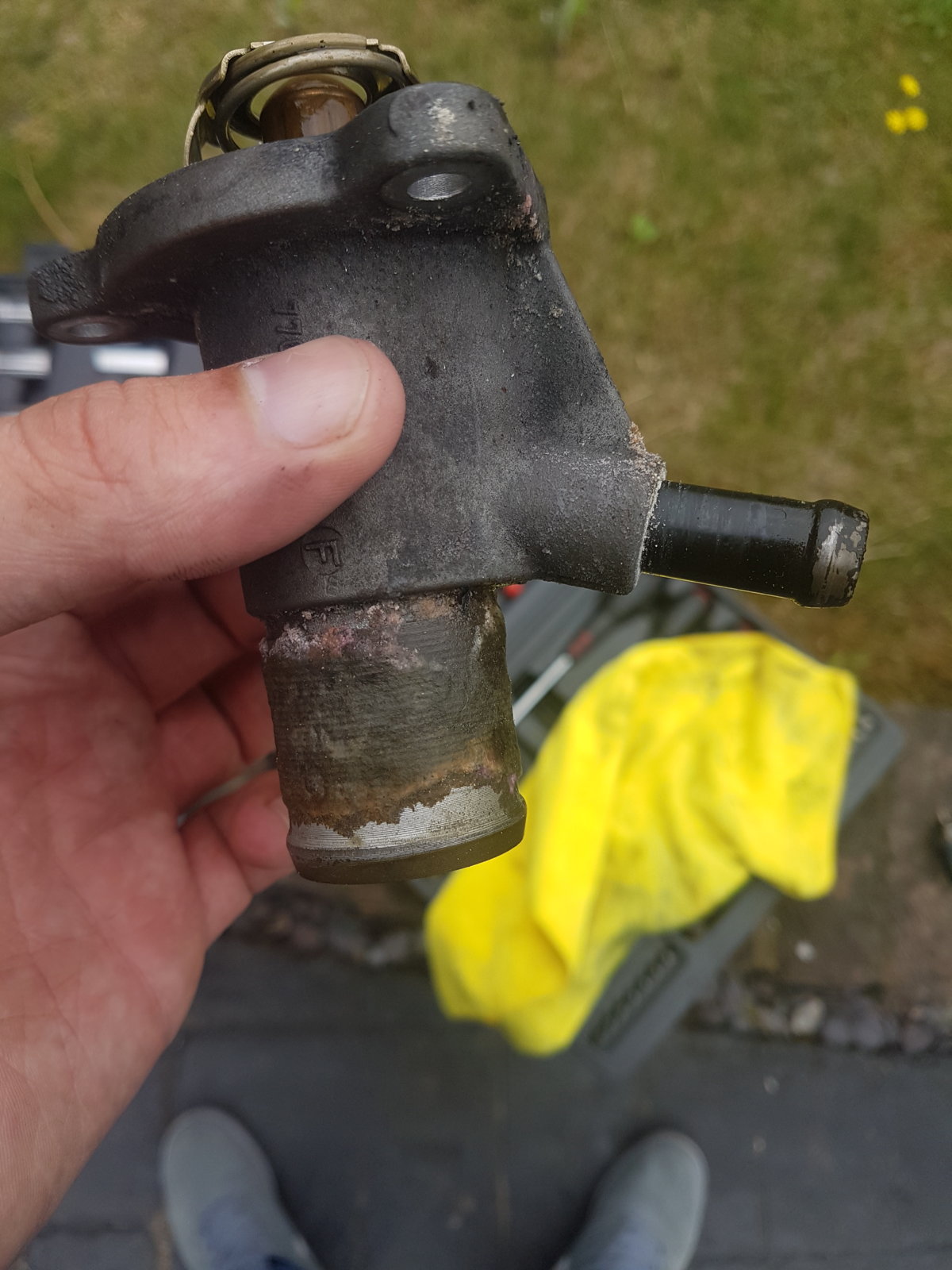

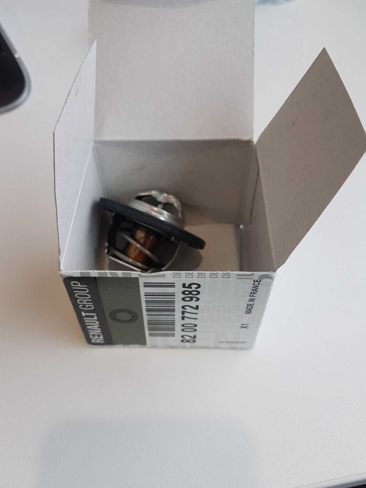

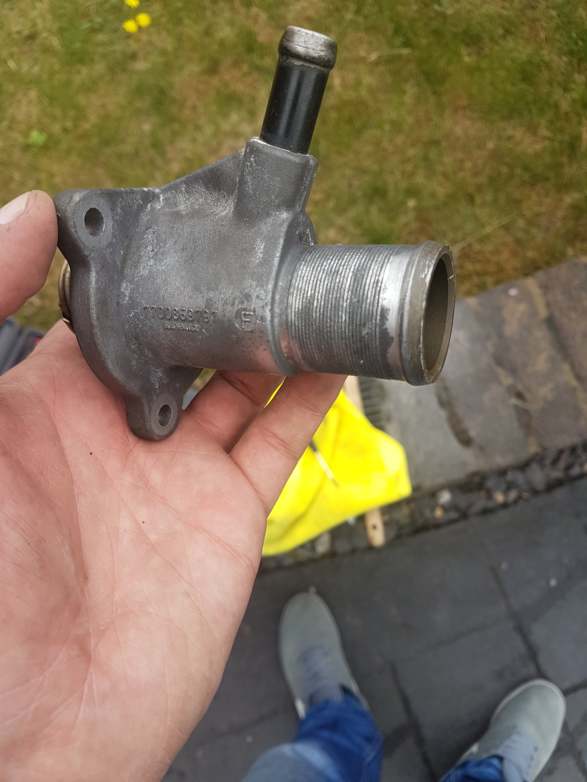

With news on my car i had an issue with the temp gauge dropping off randomly and affecting the car, also had a slight leak from the thermostat housing. Today i set about sorting that.
New bits ready to go, took off the top rad hose and could see why i might have a little leak.
Took a wire brush to the housing and cleaned it up all nice :) Changed the thermostat and sensor and then bled it up.

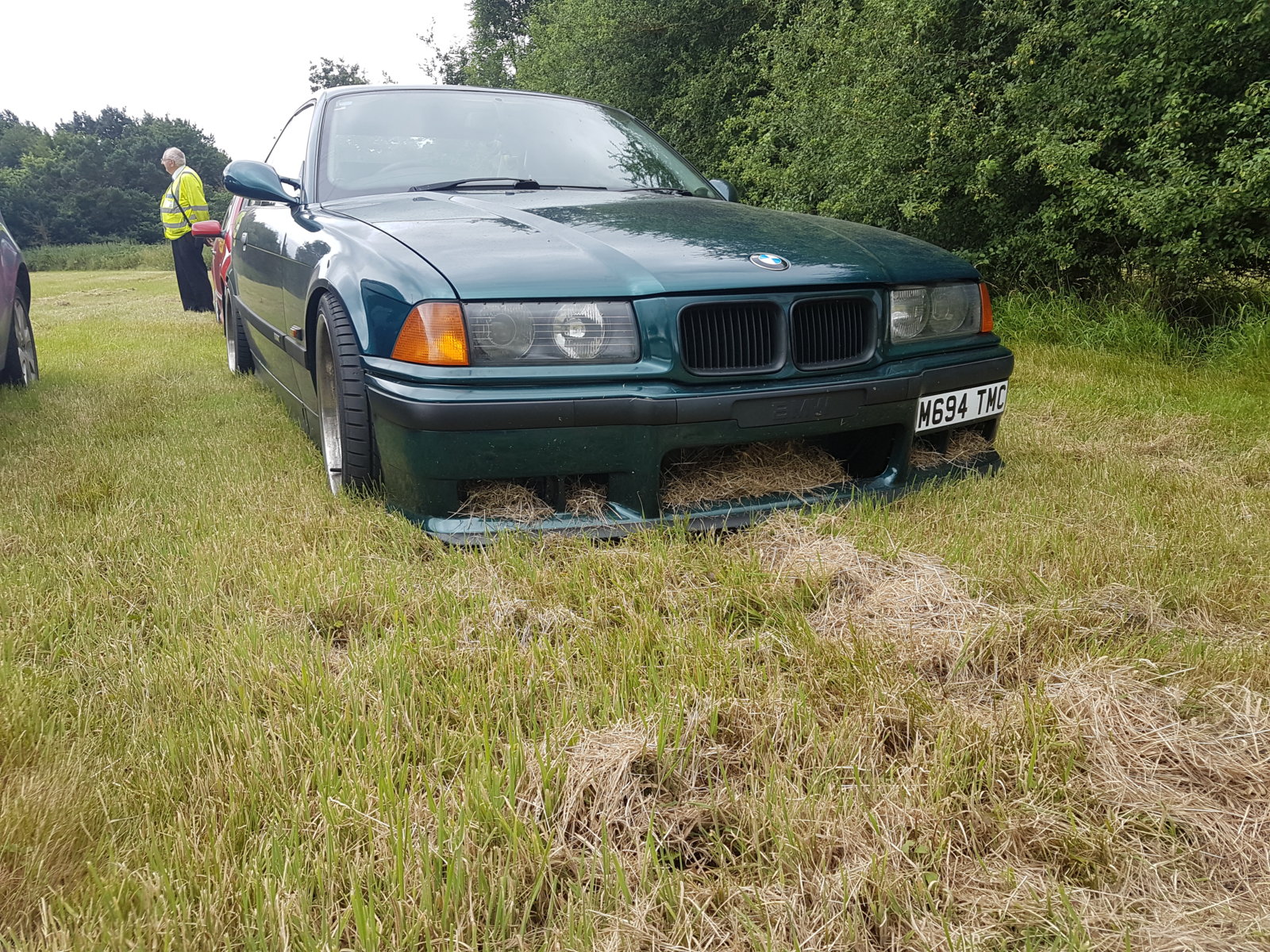

After we left the show we had a bit of an issue, my mates 3 series is so low and we had to park on grass so it ended up being a lawnmower. We did clear the grass out before we left, but shortly after we left we were flashed to pull over and alot of smoke. Popped the bonnet and looked underneath and a s**t load of grass was stuck to the exhaust etc and catching fire. Luckily enough we had a little water with us to help and then jacked it up at the side of the road to remove and much as we could. We mate it back home with not much drama. It's such a shame because it was a really mint car when he first bought it, he then lent it to our other mate who crashed it hence the front not being 100% I think he is just fed up and will buy another m3 or 335i.
