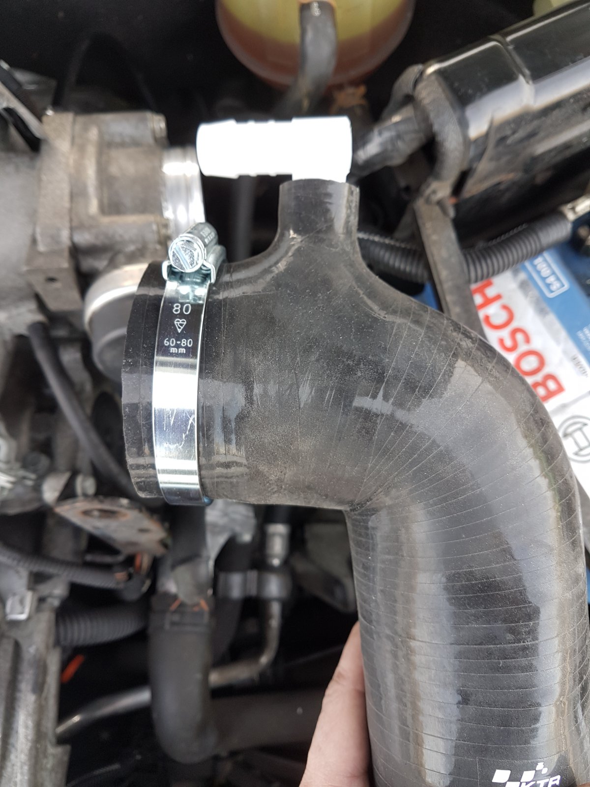

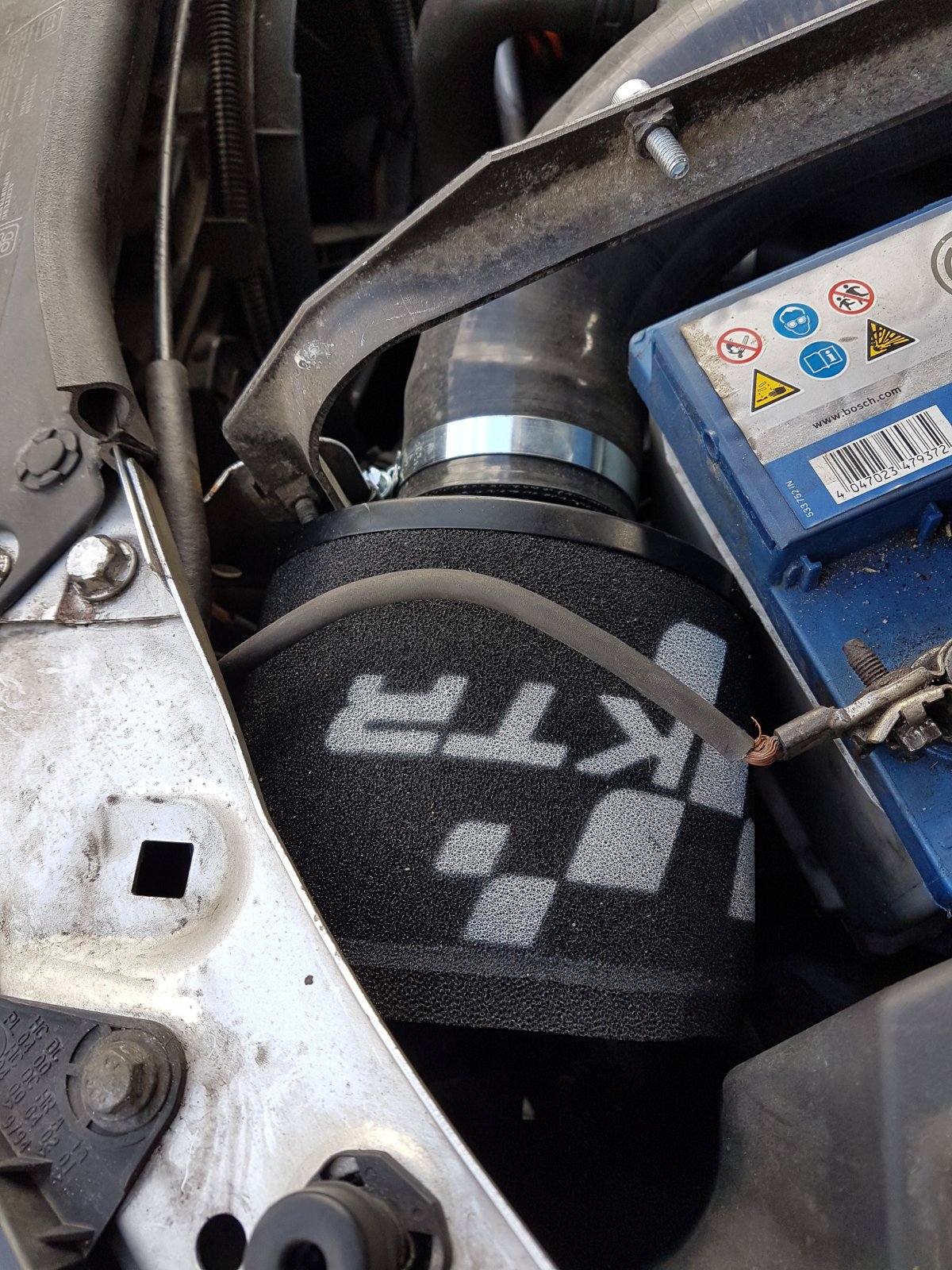

I have received my induction kit today and the fitment is shocking. I was rushing to try and fit it in my lunch break, but im going to have to remove it and try again at the weekend. The piece of pipe that joins to the throttle seems way too long before it bends and it seems to rub underneath on the brackets and wiring on the side of the ecu. Its also very difficult to fit it onto the throttle body in the first place. Maybe its just user error, but i would appreciate it if you guys could help? I have already emailed K-Tec with some photos.

Mine was the same mate, just ended up trimming a bit off at the throttle body end.

Hmm not very happy with that. The price you pay for one of their systems you expect it to fit out the box no issues. I don't appreciate having to cut or modify the pipe to get it to fit. The whole reason why i bought the KTR kit was to make my life easier. I will wait and see what they come back with tomorrow and i will try again over the weekend. I finish work at 8PM so going to have to remove it in the car park and put it back to standard for now.

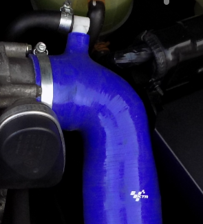

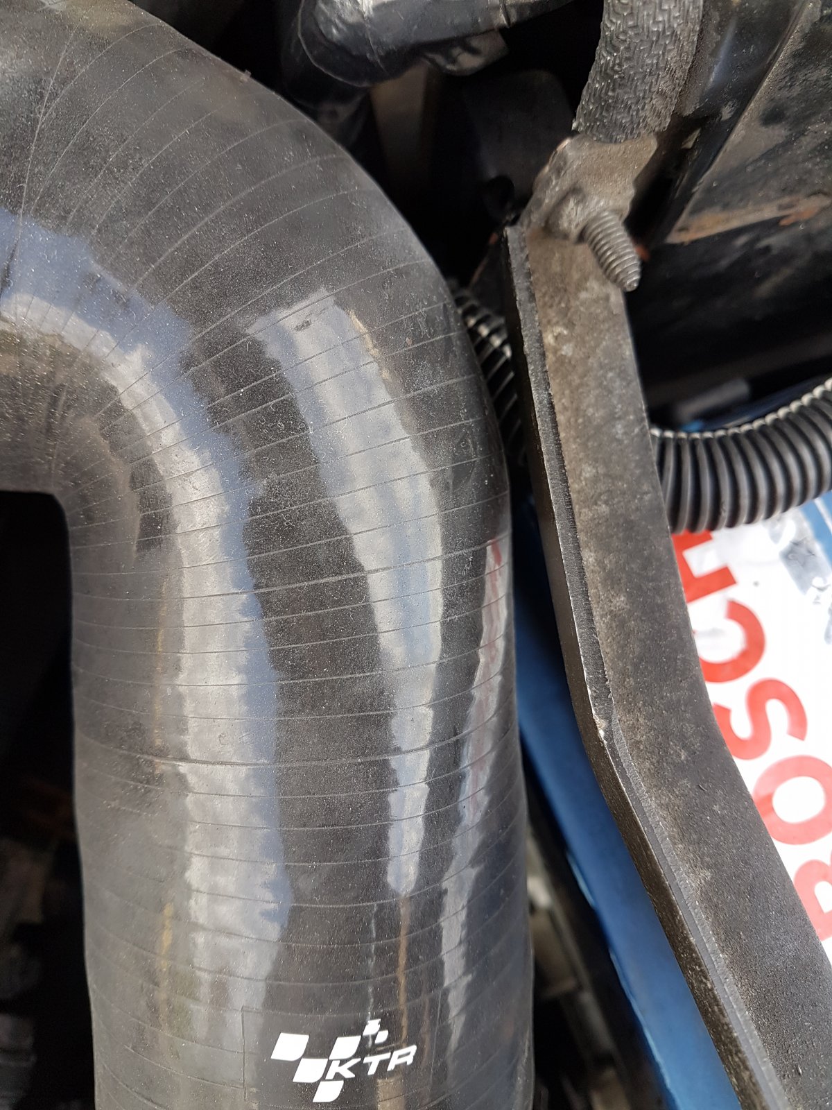

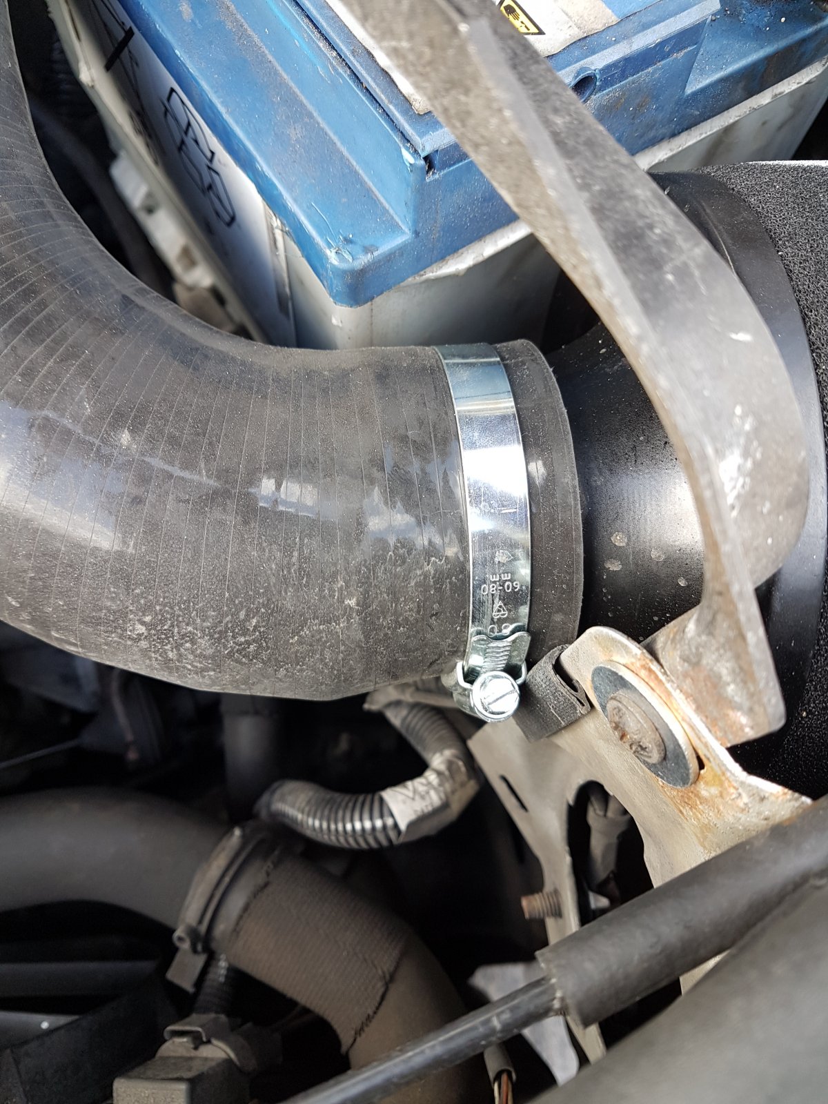

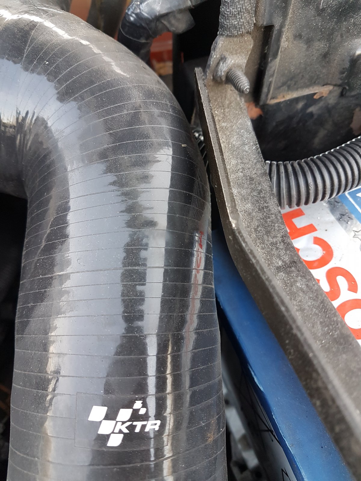

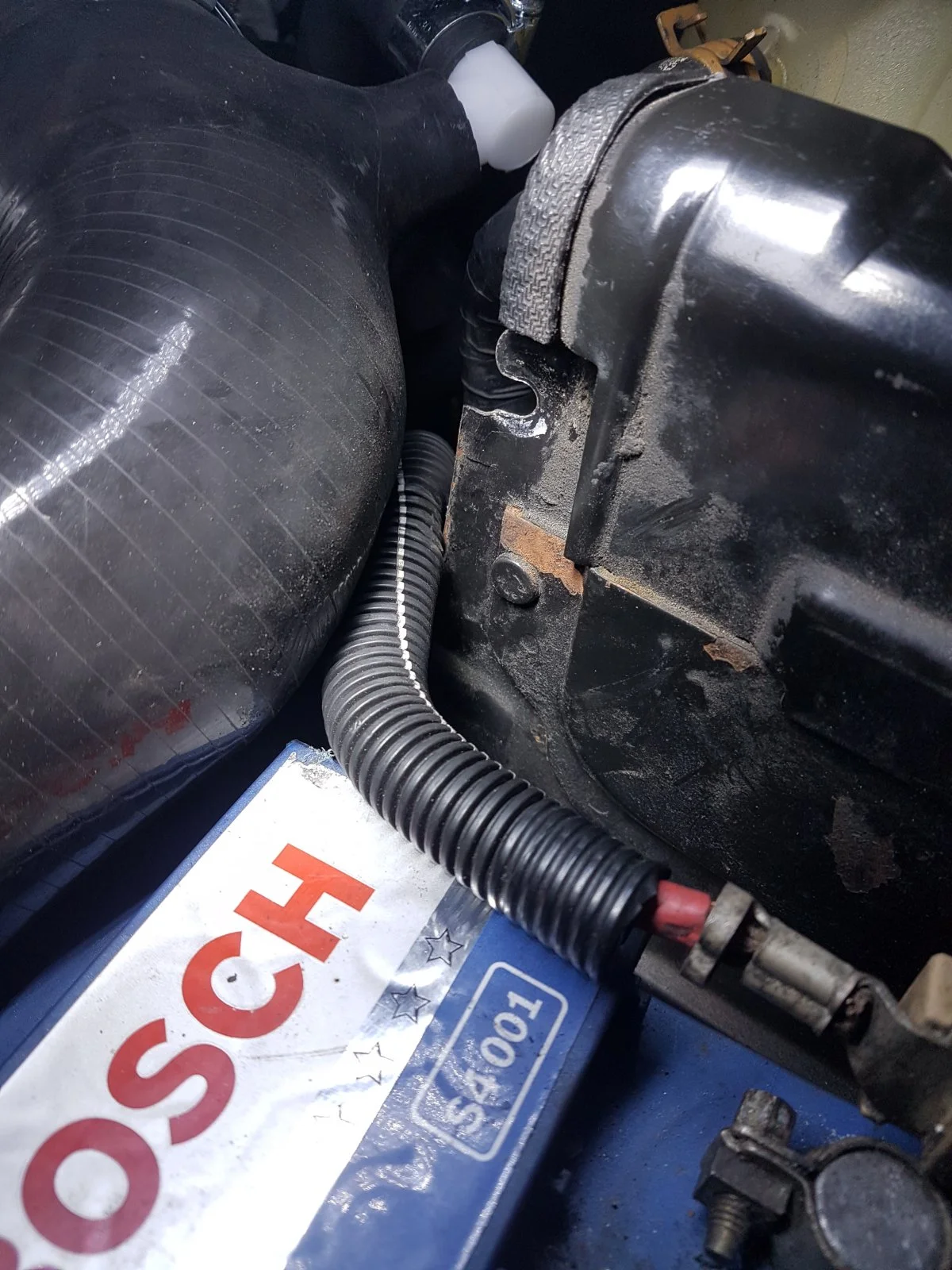

On your first picture, that bit of pipe i swear isn't as straight as on mine. I'll have to have a look tomorrow but i'm pretty sure mine curves more than that. However they are that tight onto the brackets next to the battery. They're of a crap design really, fitment wise, but they sound amazing.

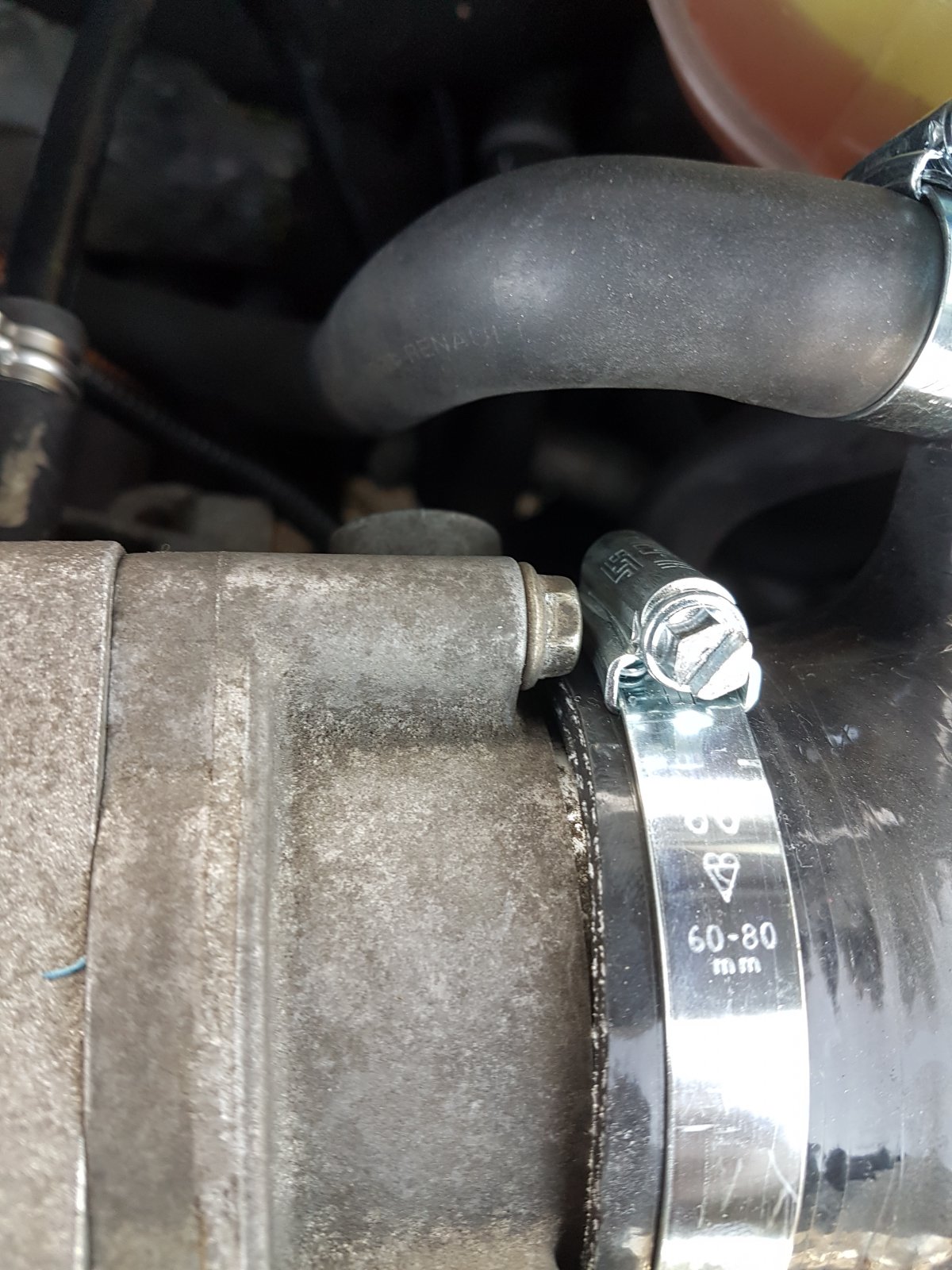

Where you have it onto the throttle body is wrong, it will push on more than that and sit flush. Undo the jubilee and pull it right back, then disconnect it from the air filter end or atleast loosen those jubilees too. If you then push it fairly hard itll sit better on the throttle body. Going by those pictures it may even not be on properly at the bottom as the silicone has a habit of curling upwards. Run a thin screwdriver all the way around the edge to make sure that hasn't happened. I trimmed both my KTR systems to get them fitting better but mainly because of the battery box i fitted too. It's easy to do, use a jubilee clip as your edge, but i understand why you might not want to do that after spending £160+

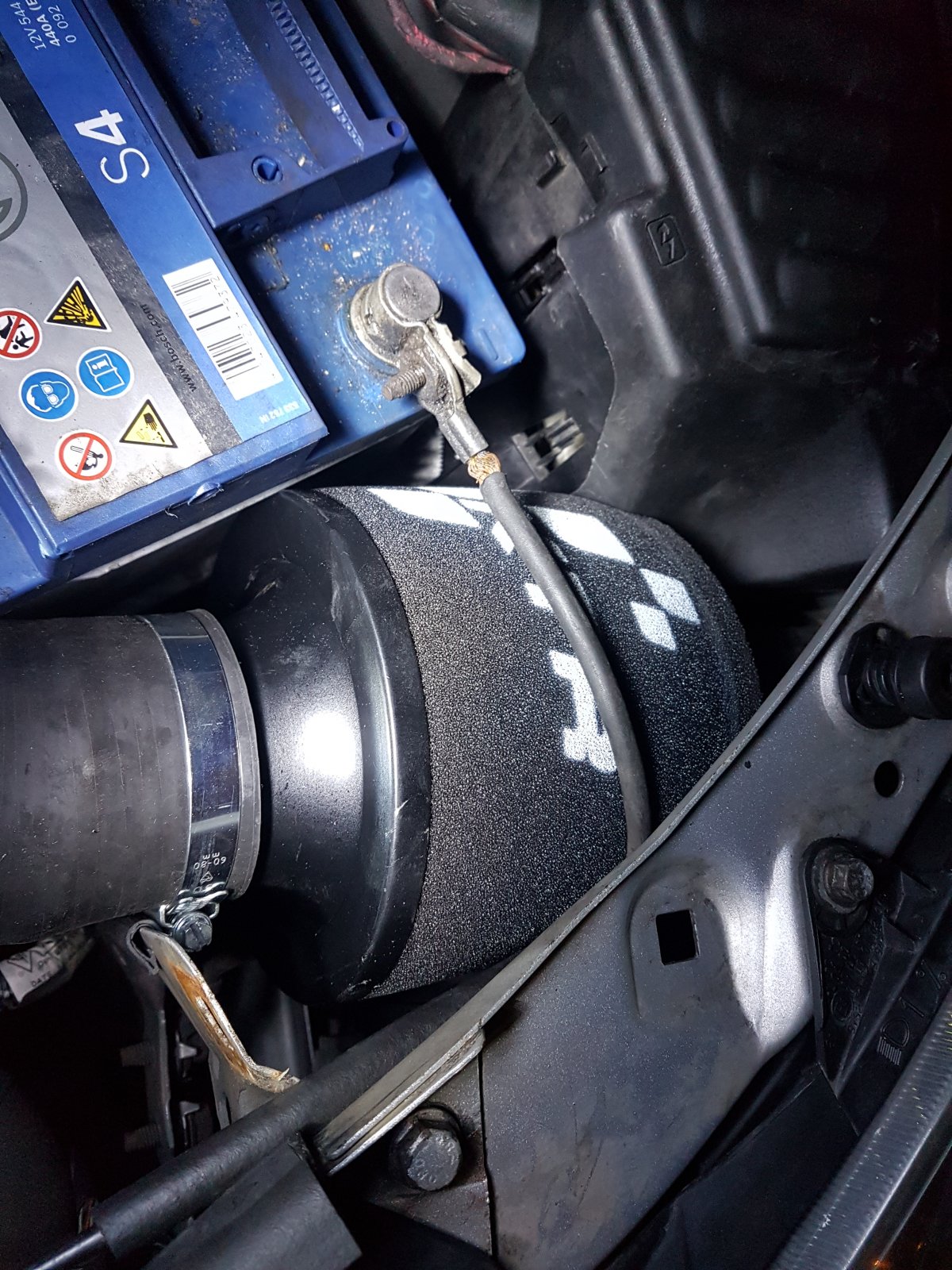

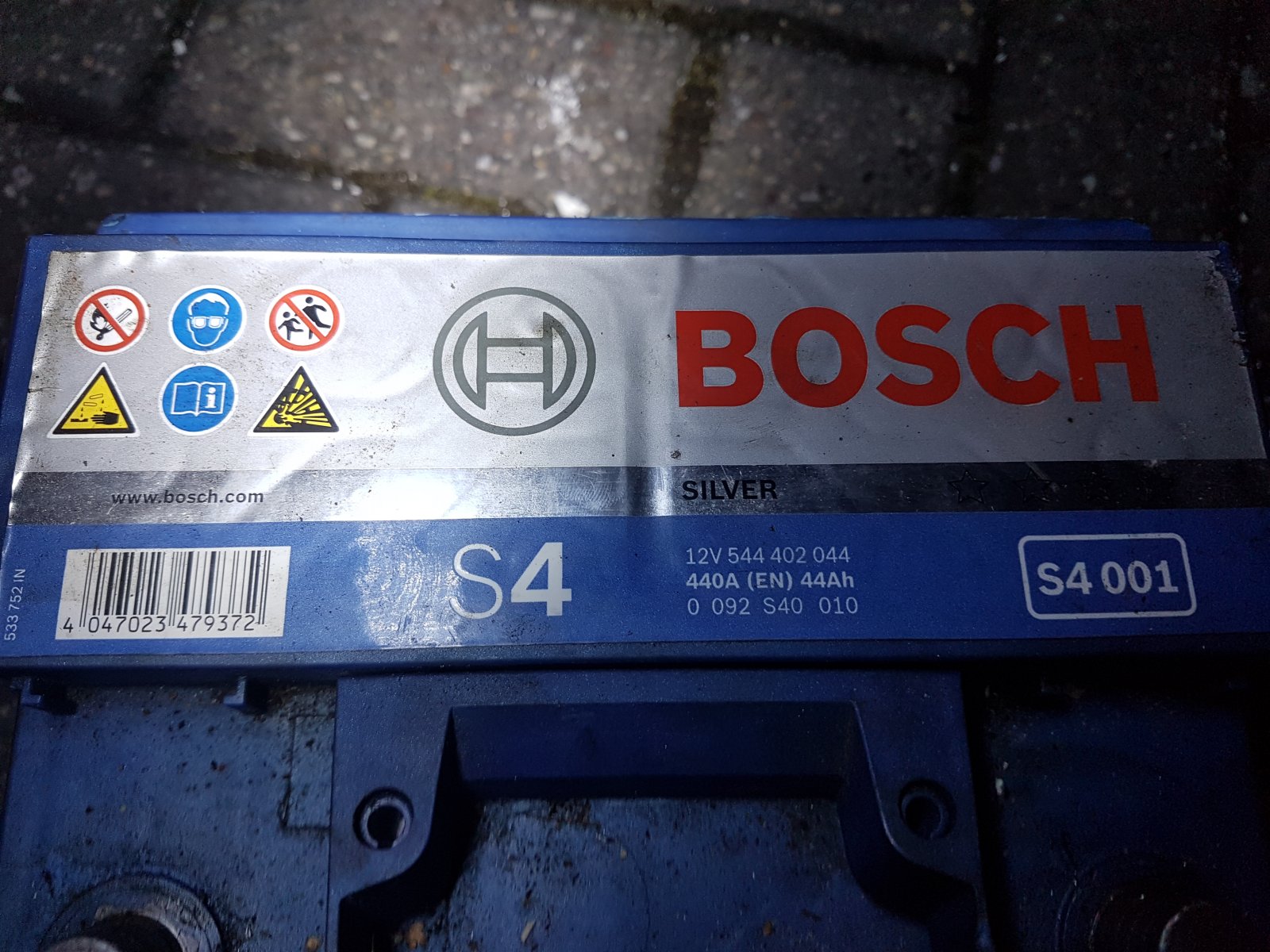

They also sit fairly tight next to the battery... You are running the smaller recommended battery yeah? 063 IIRC.
Hope you get it sorted mate, but Ktec will probably just say that's how they fit, and offer an exchange but your replacement may not be any better. I just don't recall mine being as straight next to the throttle body.
Where you have it onto the throttle body is wrong, it will push on more than that and sit flush. Undo the jubilee and pull it right back, then disconnect it from the air filter end or at least loosen those jubilees too. If you then push it fairly hard itll sit better on the throttle body. Going by those pictures it may even not be on properly at the bottom as the silicone has a habit of curling upwards. Run a thin screwdriver all the way around the edge to make sure that hasn't happened. I trimmed both my KTR systems to get them fitting better but mainly because of the battery box i fitted too. It's easy to do, use a jubilee clip as your edge, but i understand why you might not want to do that after spending £160+

Thanks for taking the time to come back to me, i think i have a dodgy pipe to me that bend is far too severe and the pipe ends up getting crushed and bent when fitted, almost back on itself. With regards to fitment on the throttle body i have to man handle it with two hands to get it to sit flush and as soon as i relief pressure it goes back the way it is, then when i twist the pipe to join the filter it wants to come off the throttle body. it wasn't even connected to the air filter end at the time, the jubilees were as loose as possible without them splitting apart.

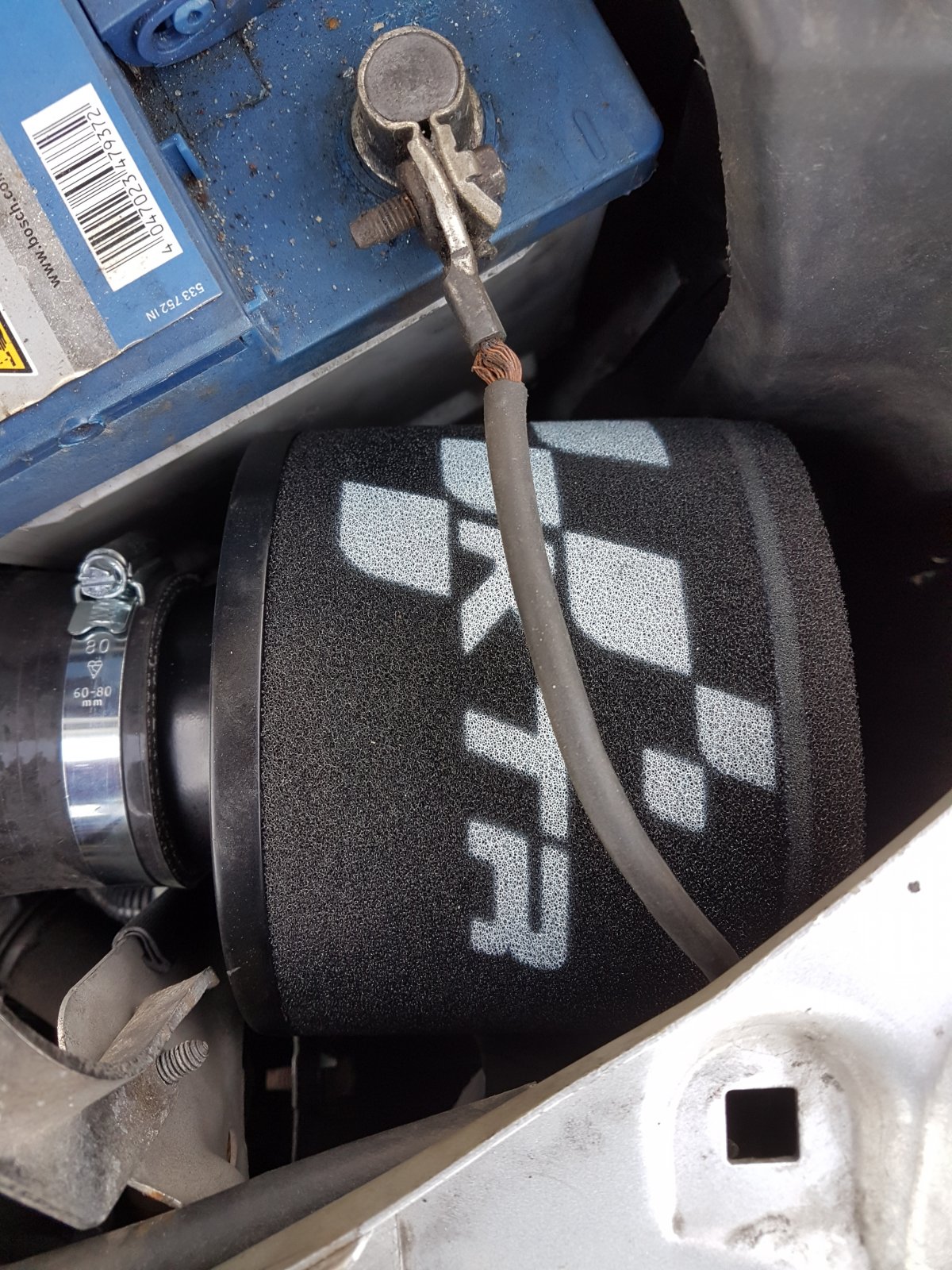

Also to me the air filter is massive it seems way to fat to sit there i would prefer a smaller filter as i think it would fit better. I'm not sure on the battery size i have i just have a Bosch s2/4 can't remember but it seems about right to me . I probably will have to trim it but i'm pissed that i should have to do that in the first place when spending that sort of money, it's ridiculous. I will have to wait for K-Tec to come back to me in the morning and see what they have to say. I might ask them to send me a new pipe and to test fit it on one of their cars first!
Is hazard a guess that what @Louis' said is what will happen.
Shame as at that price to don't want to make alterations.
Yer exactly for the price i paid i expect it to fit first time, if they send me a replacement pipe and it fits then fine. If they don't do anything or send me another pipe that doesn't fit i will send it back and just do the same as you.
That's strange, had zero issues with mine so far although to be honest I didn't fit it myself. I did however have to adjust the fitment on the throttle body myself as it was almost off at the bottom when first fitted but after pushing and pulling it slipped onto the throttle body much better in the end. It is a tight fit near the battery but again, all good!

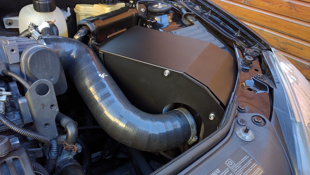

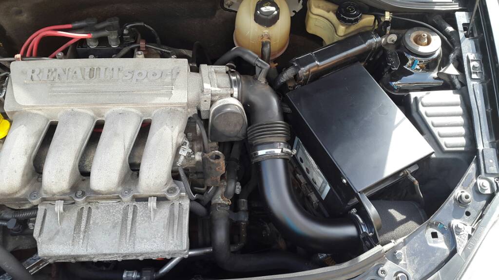

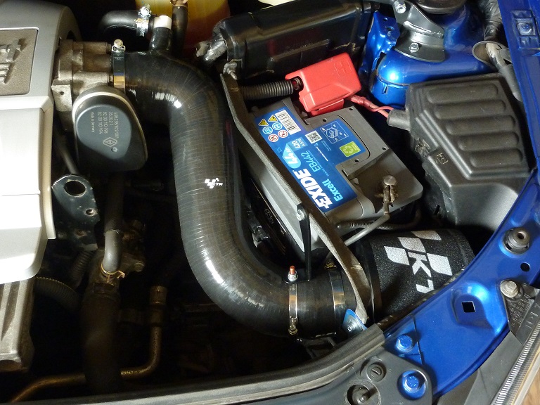

Here's how mine looks;

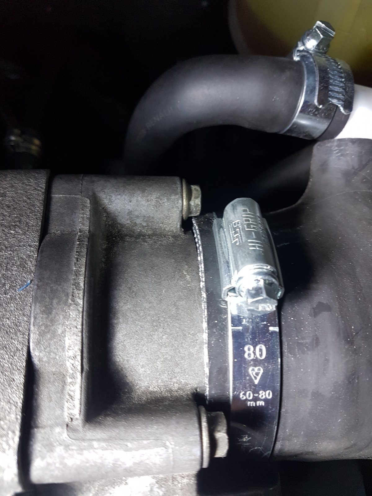

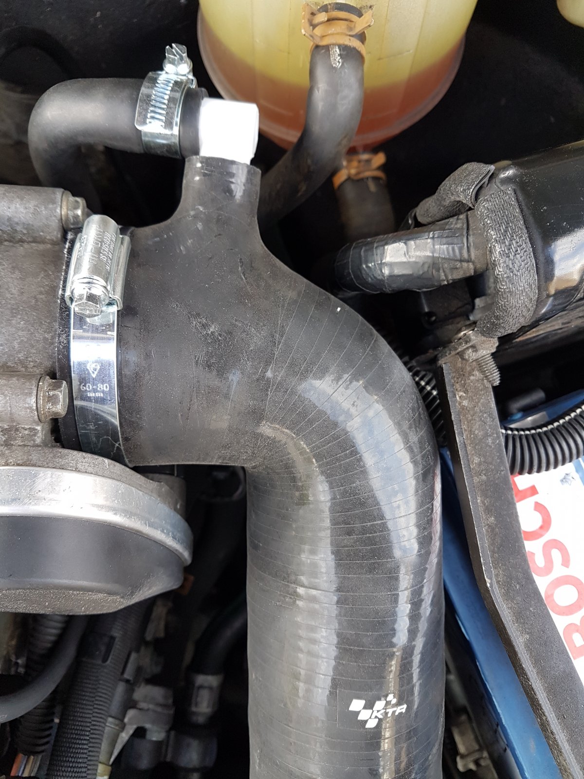

Well i went into the car park after work and thought about what to do. I decided i would have another go at fitting, although it was dark i didn't have a time limit and had an LED light with my tools. I loosened it all up and managed to get it fitting a lot better on the throttle body, but i had to remove the bar that goes from the ECU cover to the front of the car. When removing the bracket the kit comes with it just snapped clean off the jubilee clip....Anyways cut a long story short i got it to fit better but it was rubbing on that little bar and its still pushing against the wire that goes from the battery towards the ECU. I think if i trimmed some of the throttle body end it will be alright and i should be able to fit the bar back on and it wont rub or touch anything.
I drove it home and gave it some beans and the noise well its hard to describe, at first i didn't really like it much, but it has grown on me. It is very loud and reminds me of my old Honda, its like Vtec when it gets to 5k lol. I will trim it at the weekend and see how it is, then I will give it a week on the car and see how i get on with it and then decide.

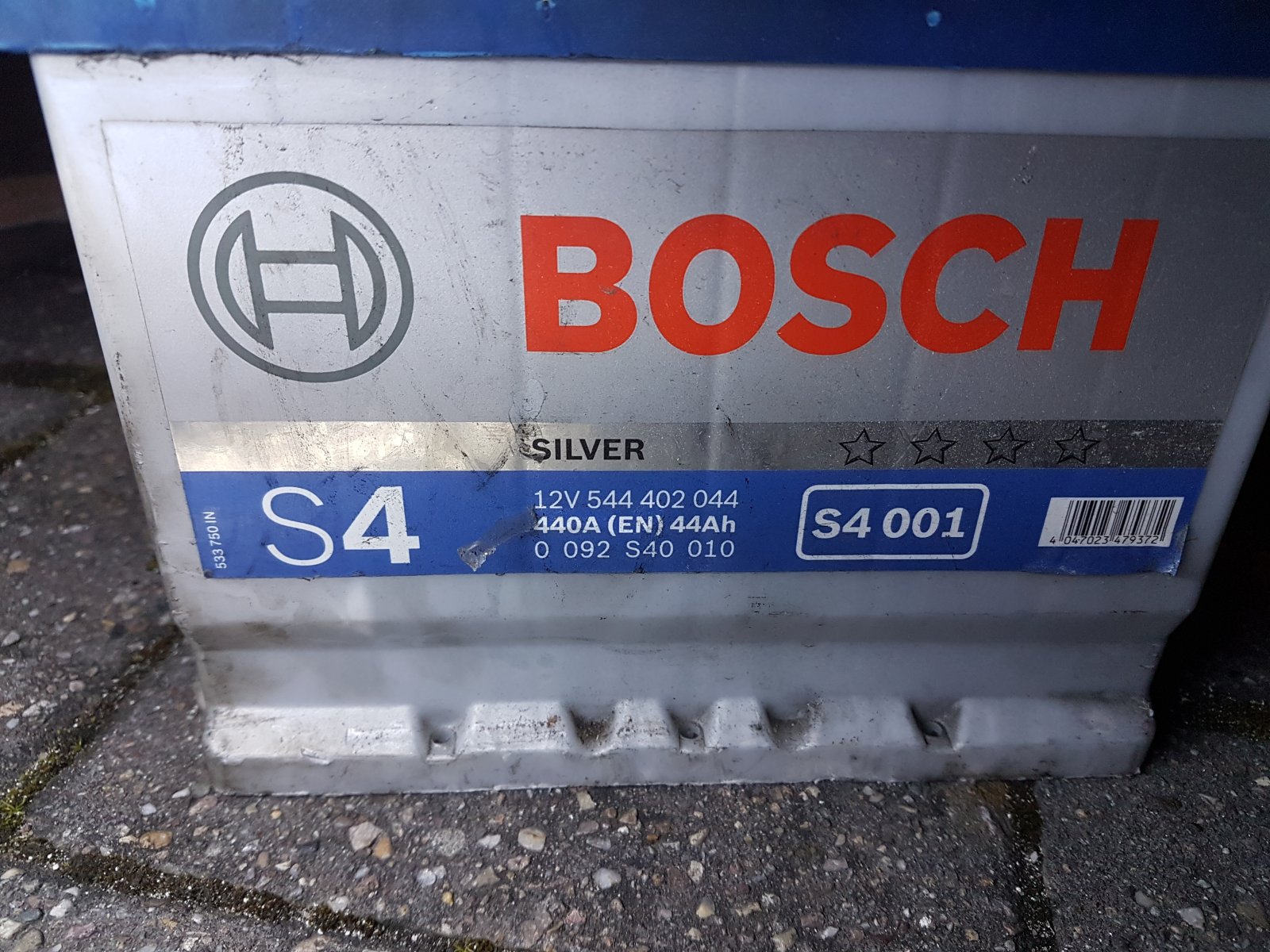

@Louis' this is the battery i have.

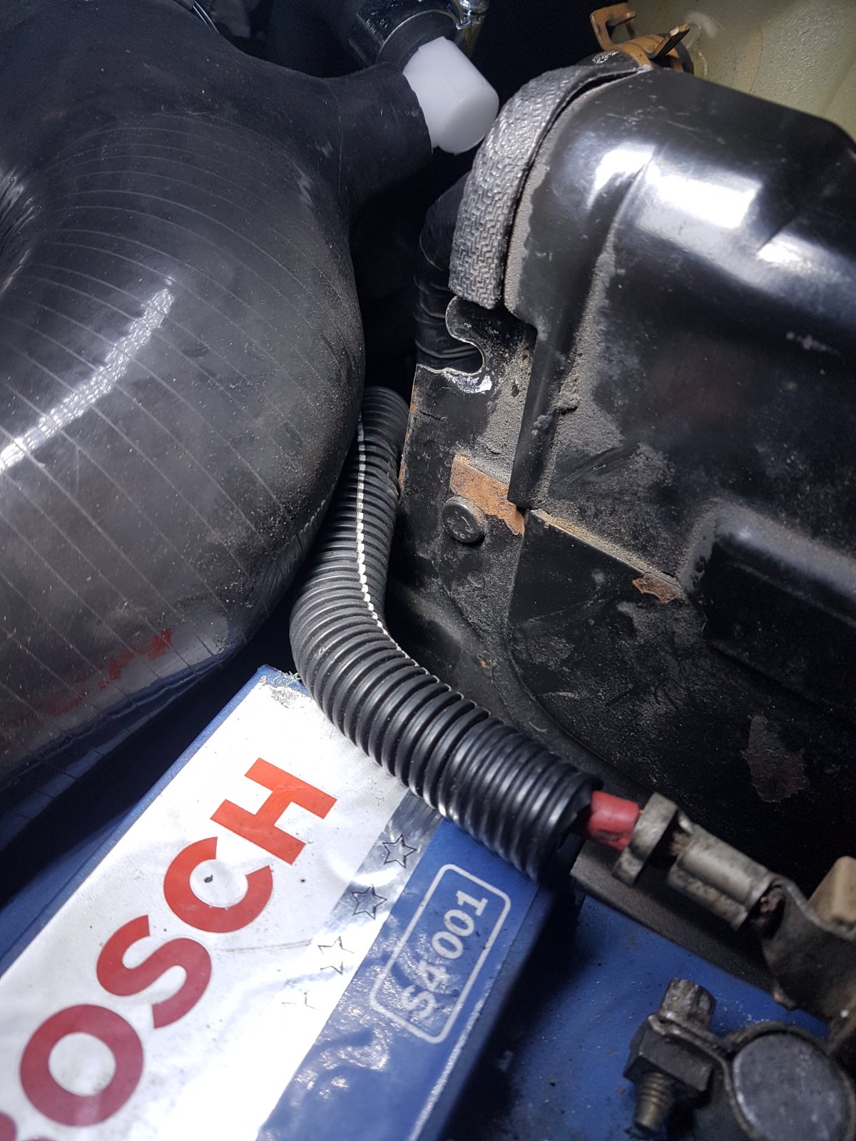

Looks loads better on the throttle body. Unfortunately the rubbing on the bracket off the ECU is just how they are. I'd recommend slicing some away as it's not too difficult really! Just get a brand new stanley blade, line up a jubilee clip straight and use it as a guide. Not fun, but one of those things. You might be able to get a partial refund from K-Tec depending how far you push the complaining, although i wouldn't cut it before they respond to an email as they'll just use it against you.
Those jubilees with the bolts on are really brittle too! Read before how peoples have broken. I'm sure someone made his own at work/got some at work for mega cheap? @Advikaz maybe? That's probably wrong, sorry if so!
Get K-tec to replace the jubilee clip. 'It broke upon tightening, must've been weak from factory'.
Your batterys an 063 which i think is right for the Ktec as the other battery is a lot larger.
Looking at the jubilee clip from hose - air filter, i moved mine slightly backwards so that the metal of the jubilee was onto the bracket just to reduce the chance even further of it rubbing the silicone. Good use of the rubber trim stuff though, mines surrounded with the stuff :)

Tbh i dont see much point of the other jubilee clip with the bracket, doesn't really hold it up much and as we know its weak. I will wait until tomorrow and see what they say and then cut it at the weekend i guess. its 90% there just needs the final adjustment, i may even change the filter to a smaller one.
Thanks for the pic it looks quite tight on the bend as well but still seems to fit pretty good.
The filter is what gives it the noiiiseee, I wouldn't change it out! You may as well have done the fatty induction, or just waited for a cheap KTR to come up rather than buying new haha.
That jubilee does a lot on mine, it reduces movement a hell of a lot! Glad i've got it.

Lol true it does give it the noise just touches everything and doesnt look the best when fitted if you know what i mean. I like it all to fit nice! I'm just impatient and lazy lol a bad combo haha. What are you mounts like? I have just had mine changed so can't imagine there would be much movement.

Engine mounts? I'm running the K-Tec solid engine and gearbox mounts. I'm talking the movement in the filter up and down is quite a lot without the jubilee nut/bolt bracket.
Not sure what all this faffing with fitting the KTEC is all about, mine went on no problems.
Sure it's a tight fit but some after some persuasion it went straight on, only took me 5 minutes.
Trim it, buy one of Marc battery covers, the forget about it.
I also think at the bottom jubilee near the battery, mine is on the other side of the brace, might a result of trimming but will probably give your filter more room.
Another thing! Try twisting the induction hose before tightening it up as sometimes it sits better with a minor adjustment

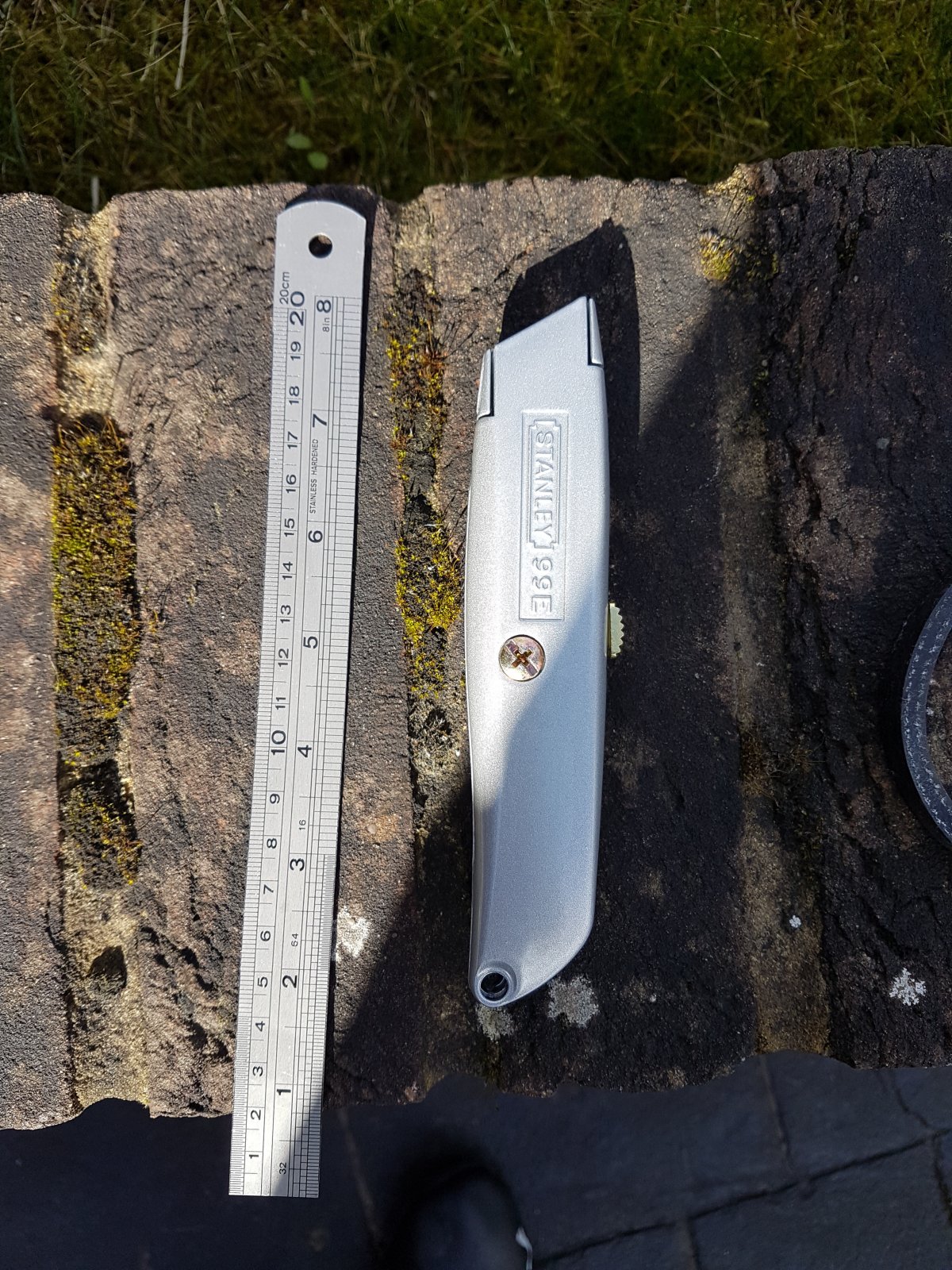

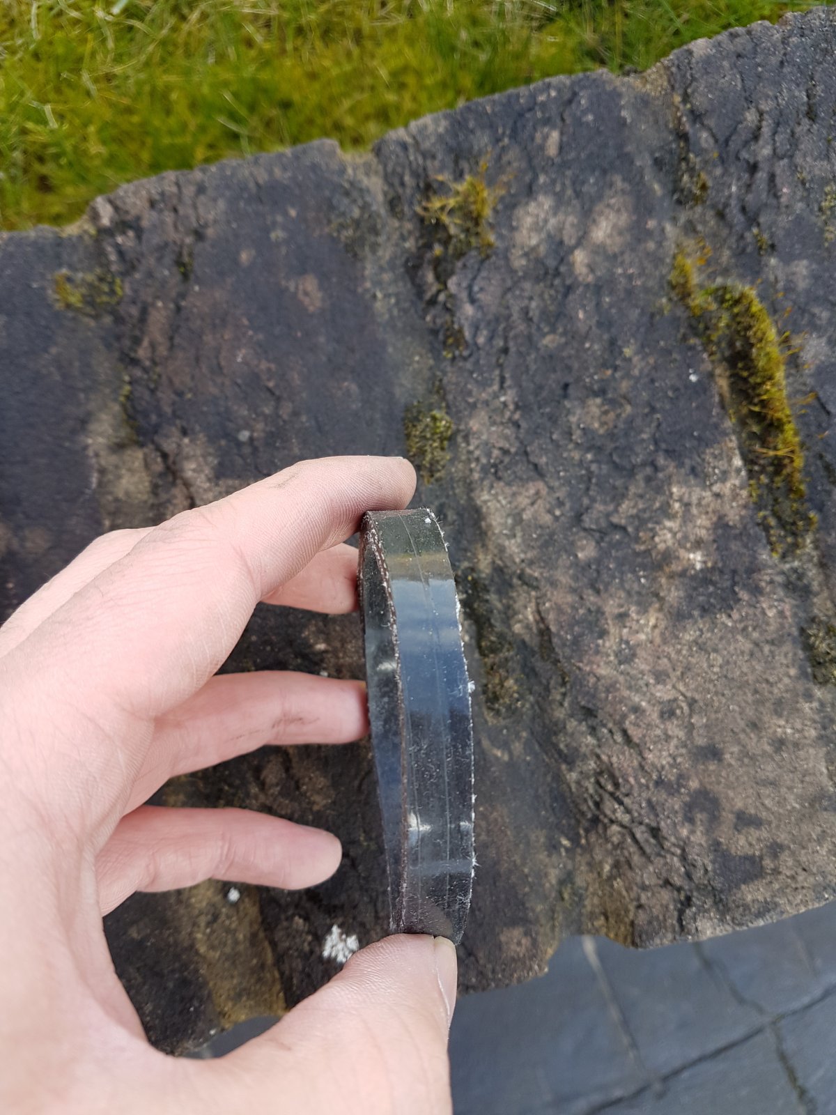

Yesterday I had the new tyres fitted while i was waiting i decided i will cut the intake pipe instead and save the hassle. It must of looked weird me in a hooded jumper walking into Wickes just for a Stanley knife ha.
Took the intake off and measured 10mm from the end of the pipe and set the jubilee in place, i then checked with the rule that it was 10mm all the way round so it was even. I ended up with this. (the cut was straight just the angle i had the phone)
