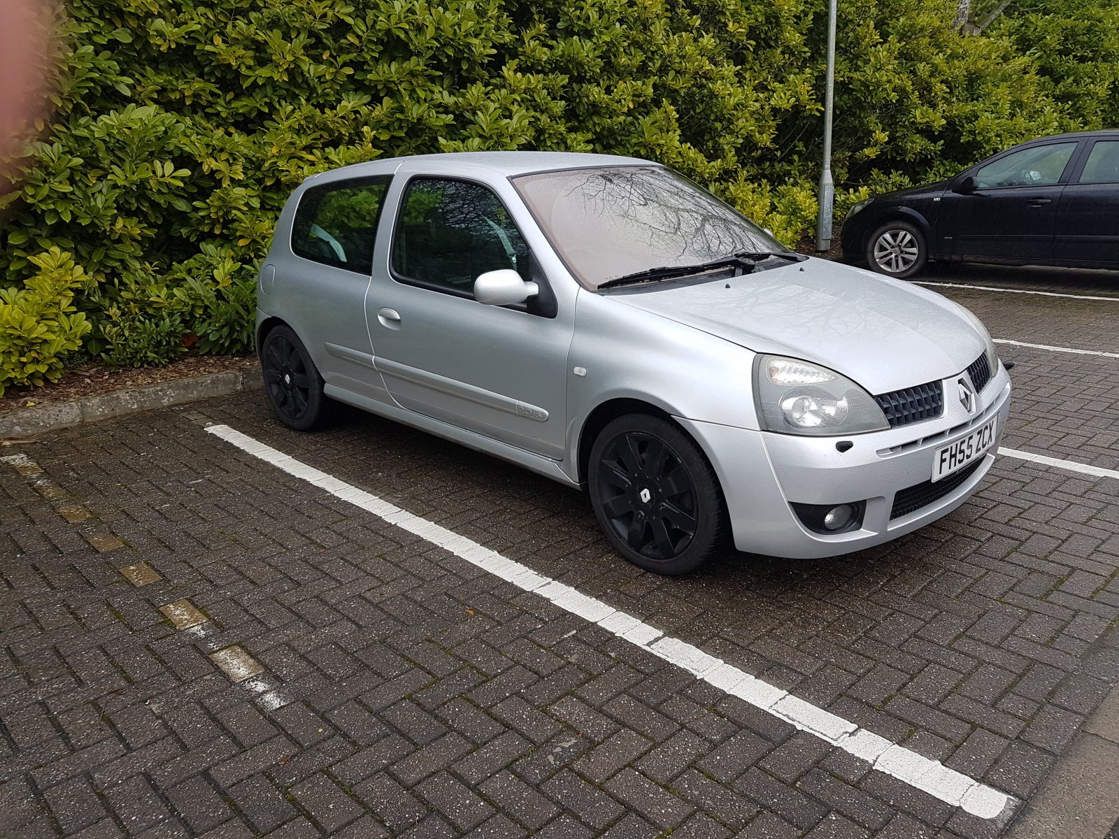

The story begins on Boxing day, i was bored as most people are on that day so decided to take a look on eBay. I didn't even need to replace my car I was just bored of it ha. So I found this with a short time left on the auction, description seemed OK so i stuck a bid in and I won! This is my first sport, I am normally a Honda or Japanese car guy (spent many thousands building my old Civic EG), but i have had a few Frenchie’s in the past. I always fancied one of these so thought I would give it a go! The car itself is in good condition, i was surprised when I went to check it over and took it for a drive. As with all cars now I have been using it for a couple of weeks the faults start to creep out.
Now i really should be saving to move out, but i can't help spending money on cars. I'm sure for a lot of you guys it’s the same, the car makes me happy so why not! I do 110miles a day and its doing around 40/1mpg which was a big surprise running on Vpower. Yesterday was the first day i pushed the car hard around some lanes, despite the s**t Jinyu tyres it actually handled very good. I was impressed!

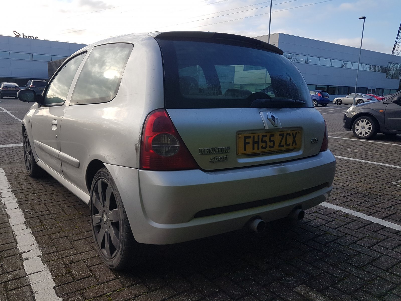

So time for a couple of pictures then we can talk plans.
Only just noticed my thumb got in the way! That was this morning in the work car park.

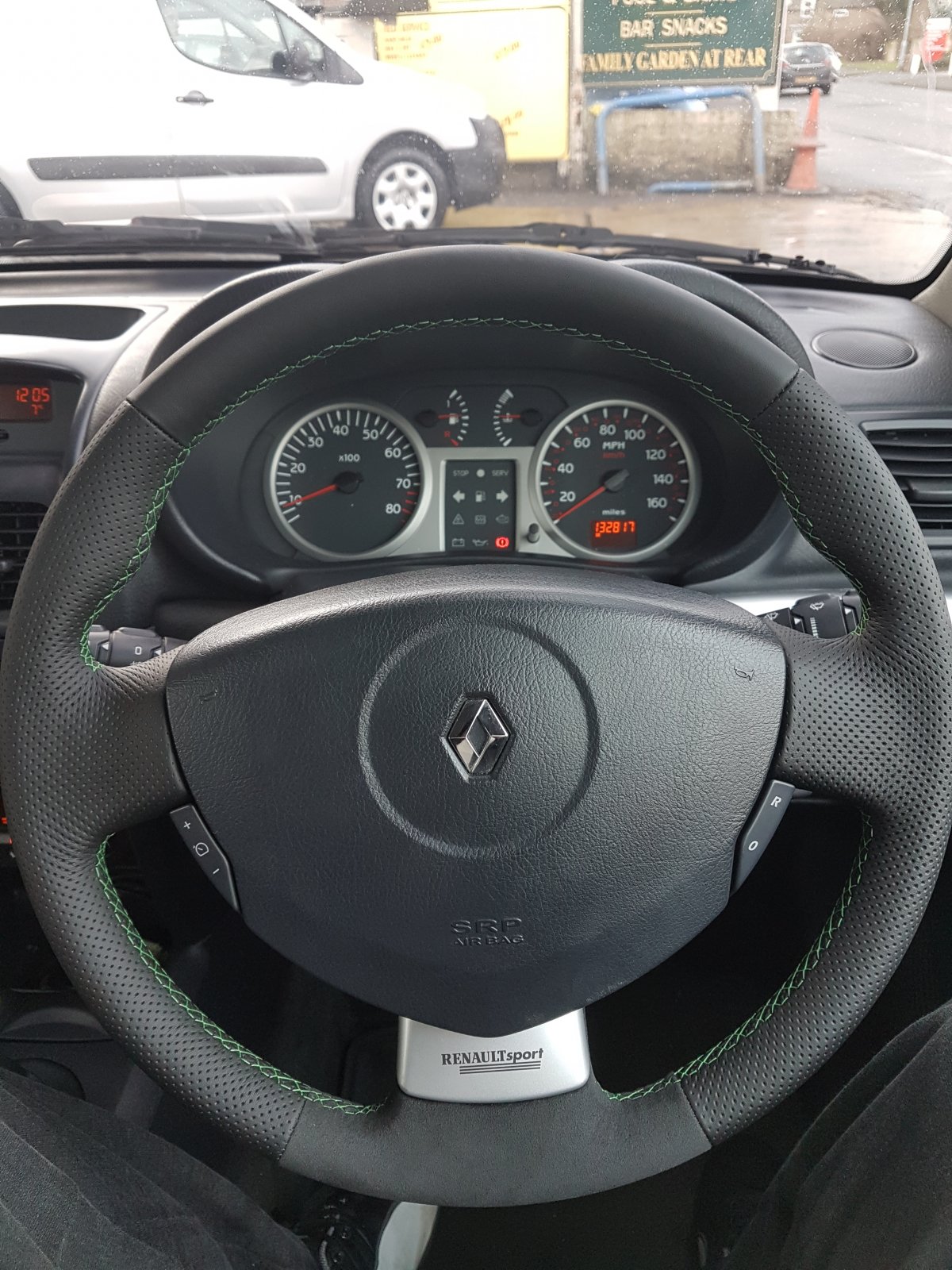

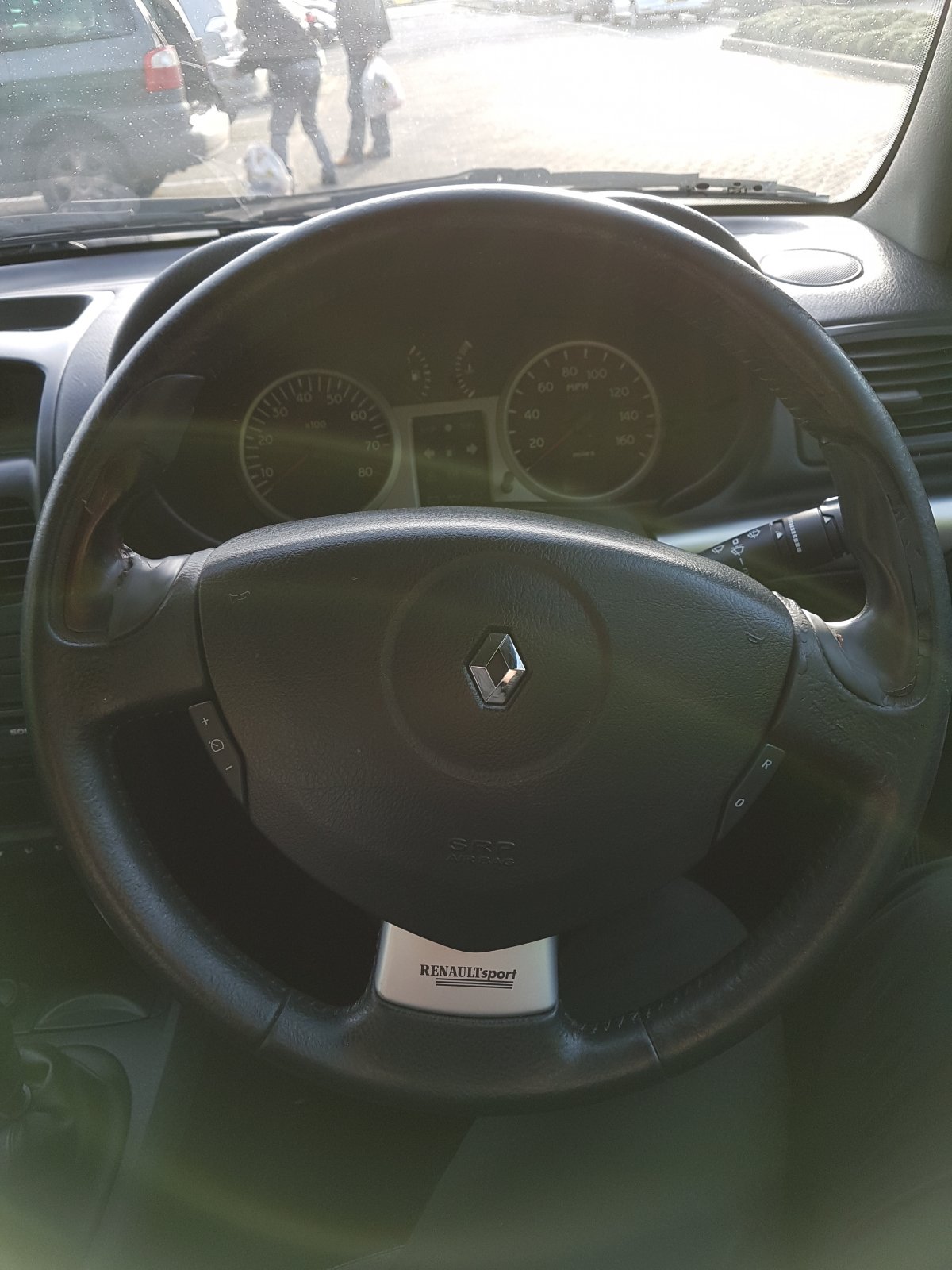

As with most, the steering wheel has perished. I have been speaking to Royal Steering Wheels in Aylesbury and I'm going down on the 28th to have the new wheel fitted :)

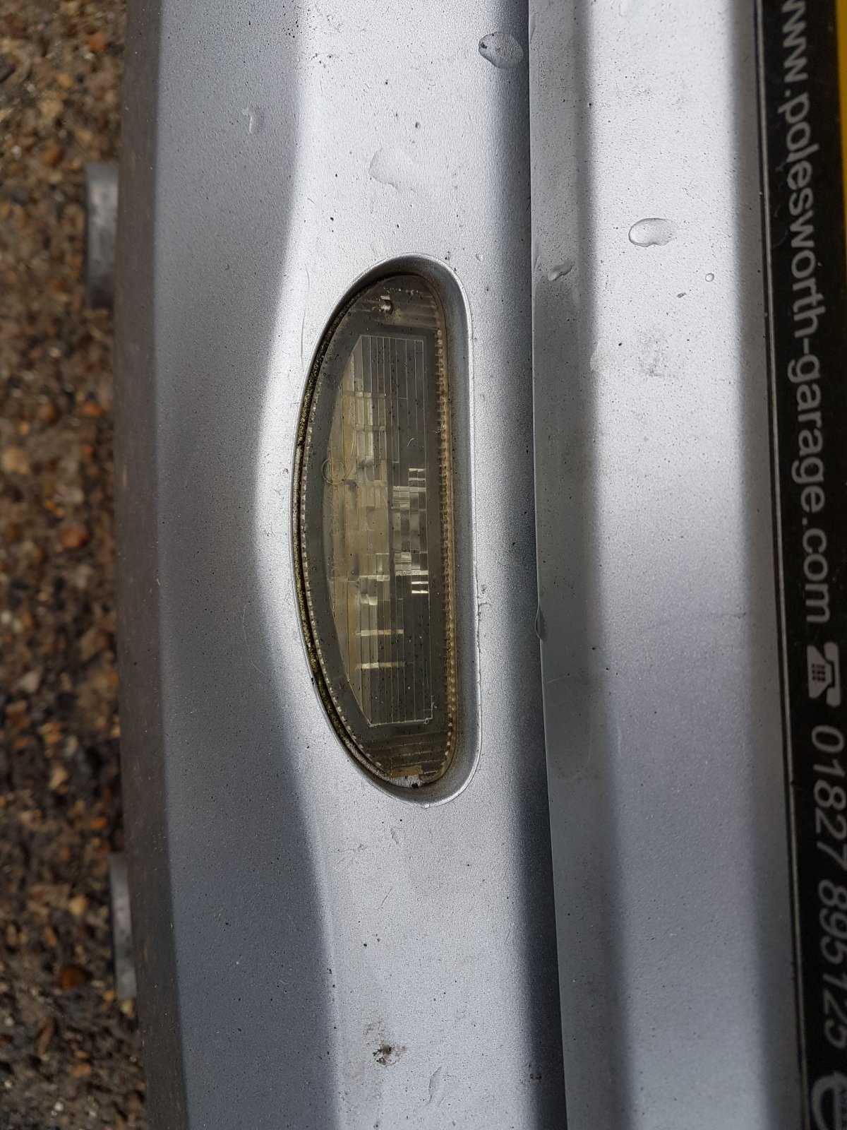

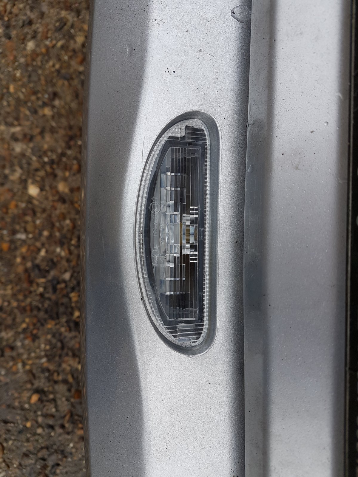

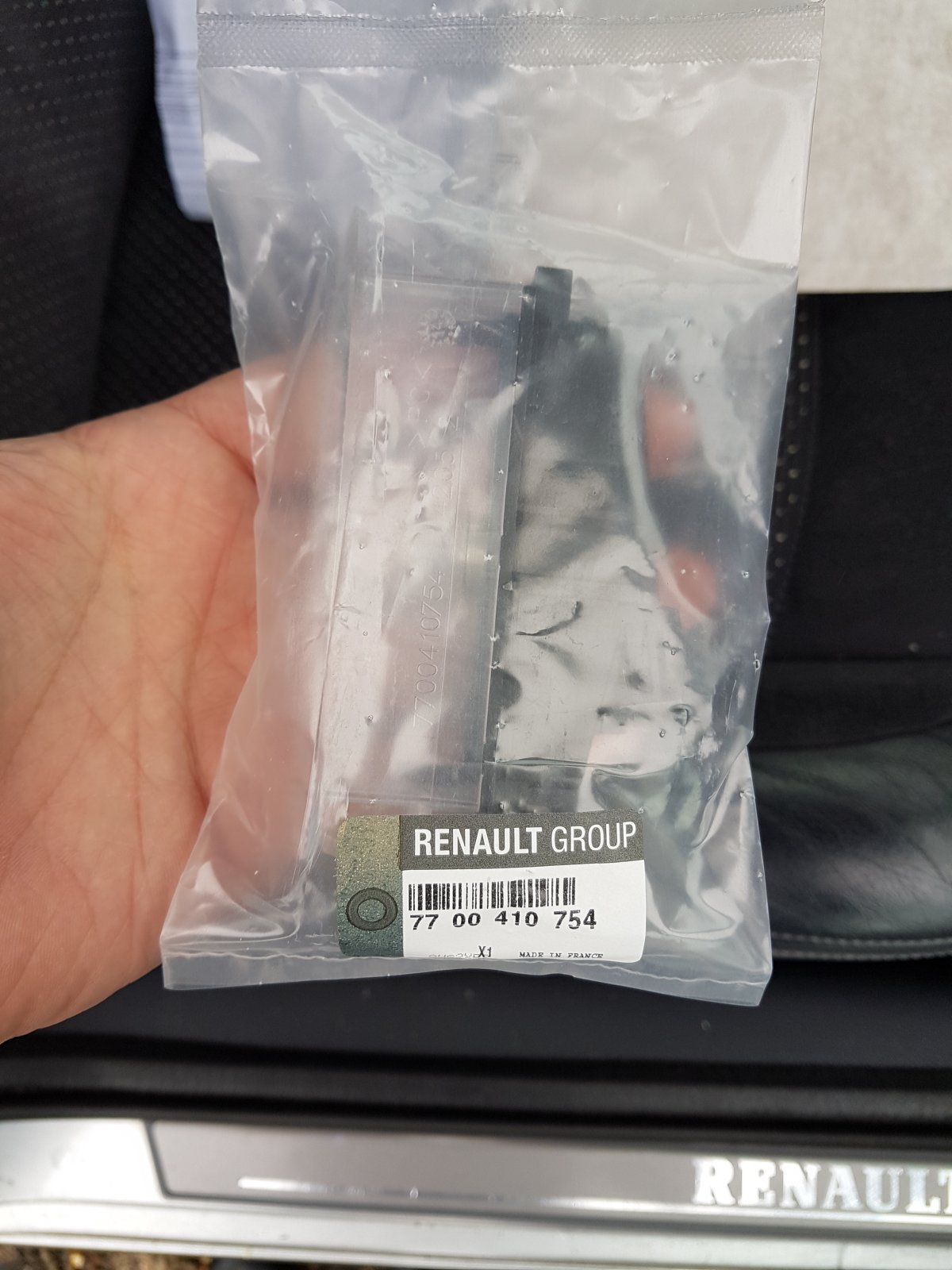

Next purchase was the rear number plate light as it was pretty past it! So gave the recess and the connector a clean before refitting with the new item. I also threw out the engine cover as it was nasty and broken in several places, it was just rattling around making noise. Will need to source a replacement at some point.

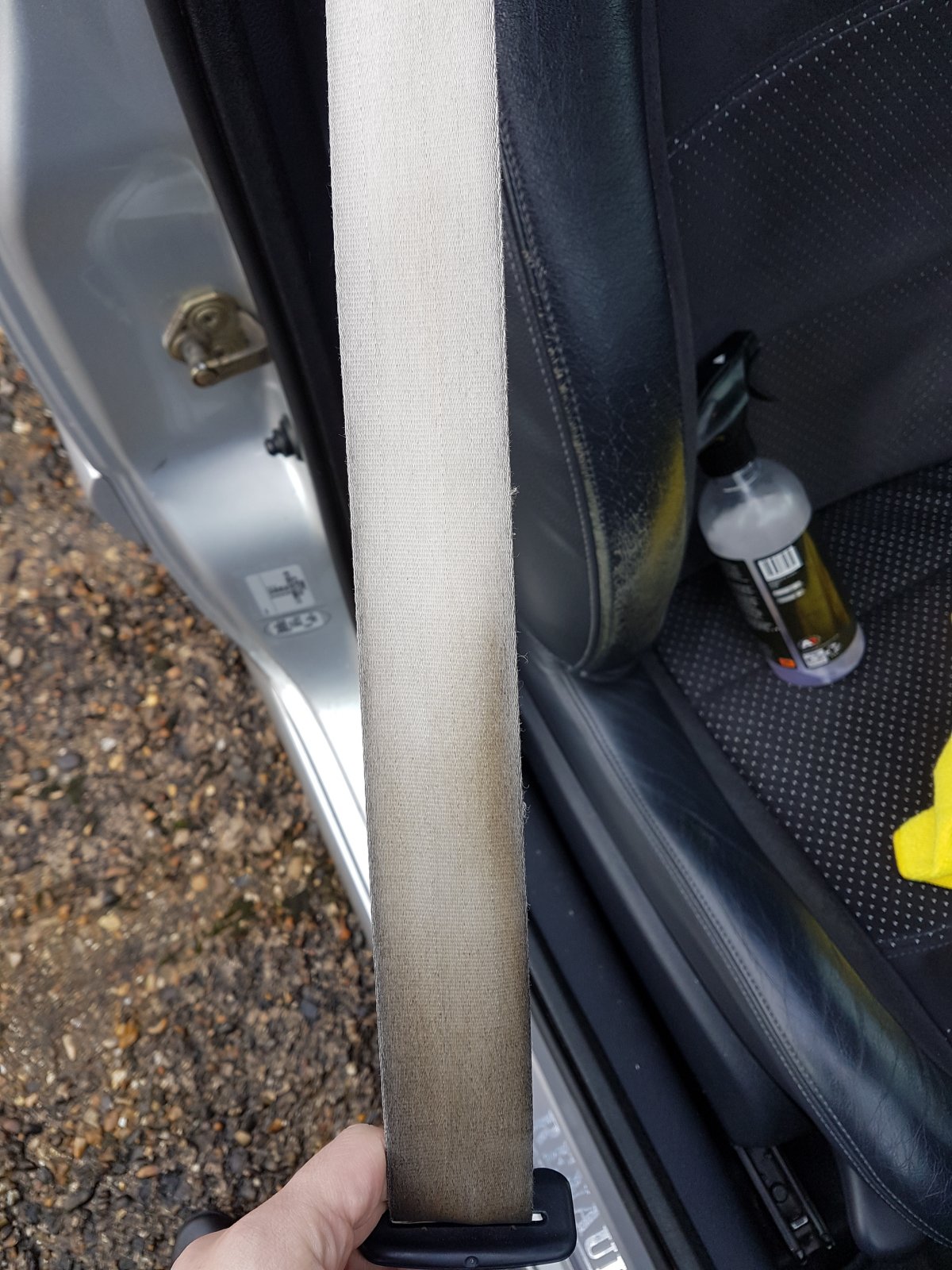

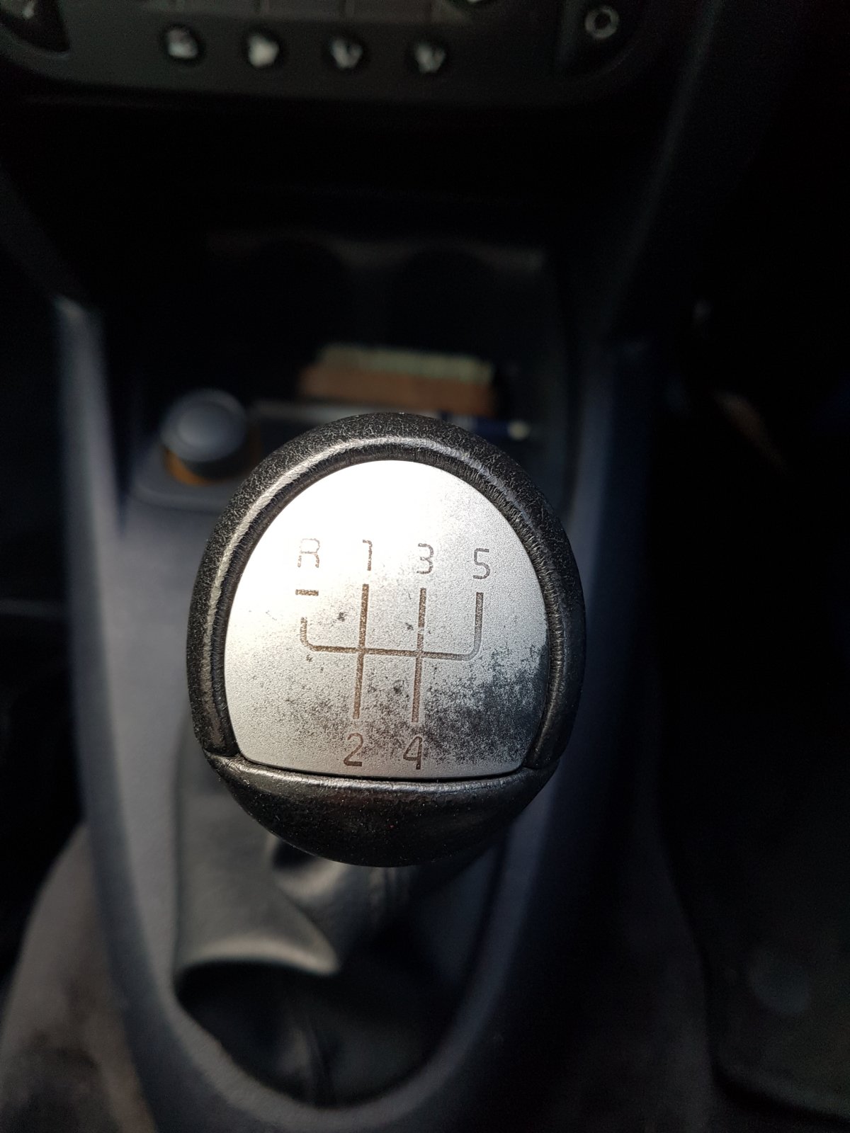

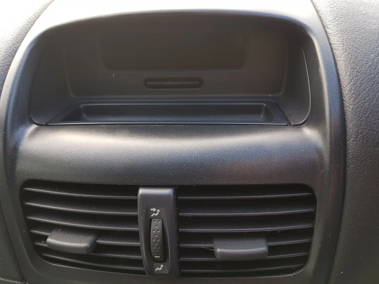

Anyways some more pictures to give you a general idea of the condition.

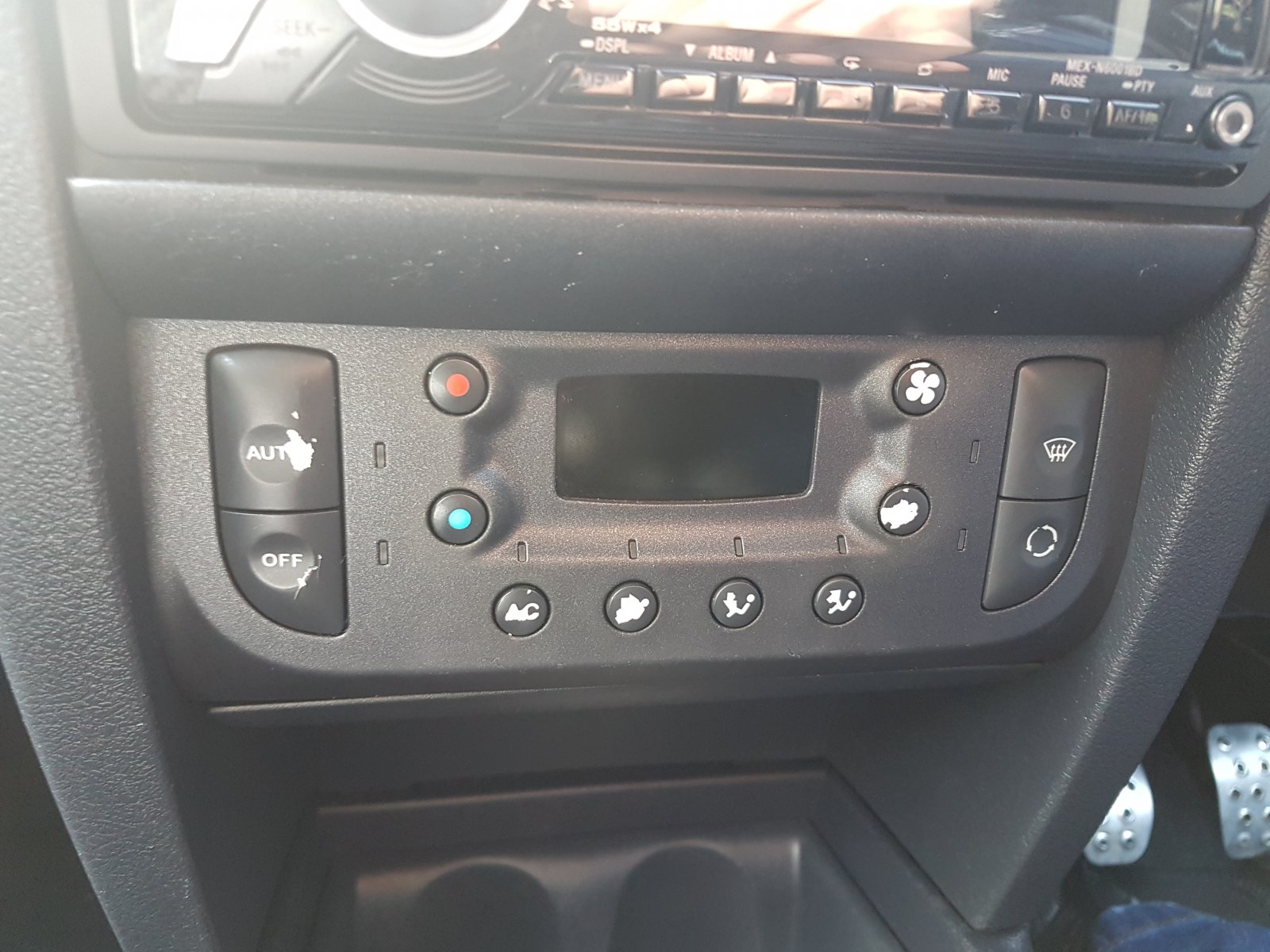

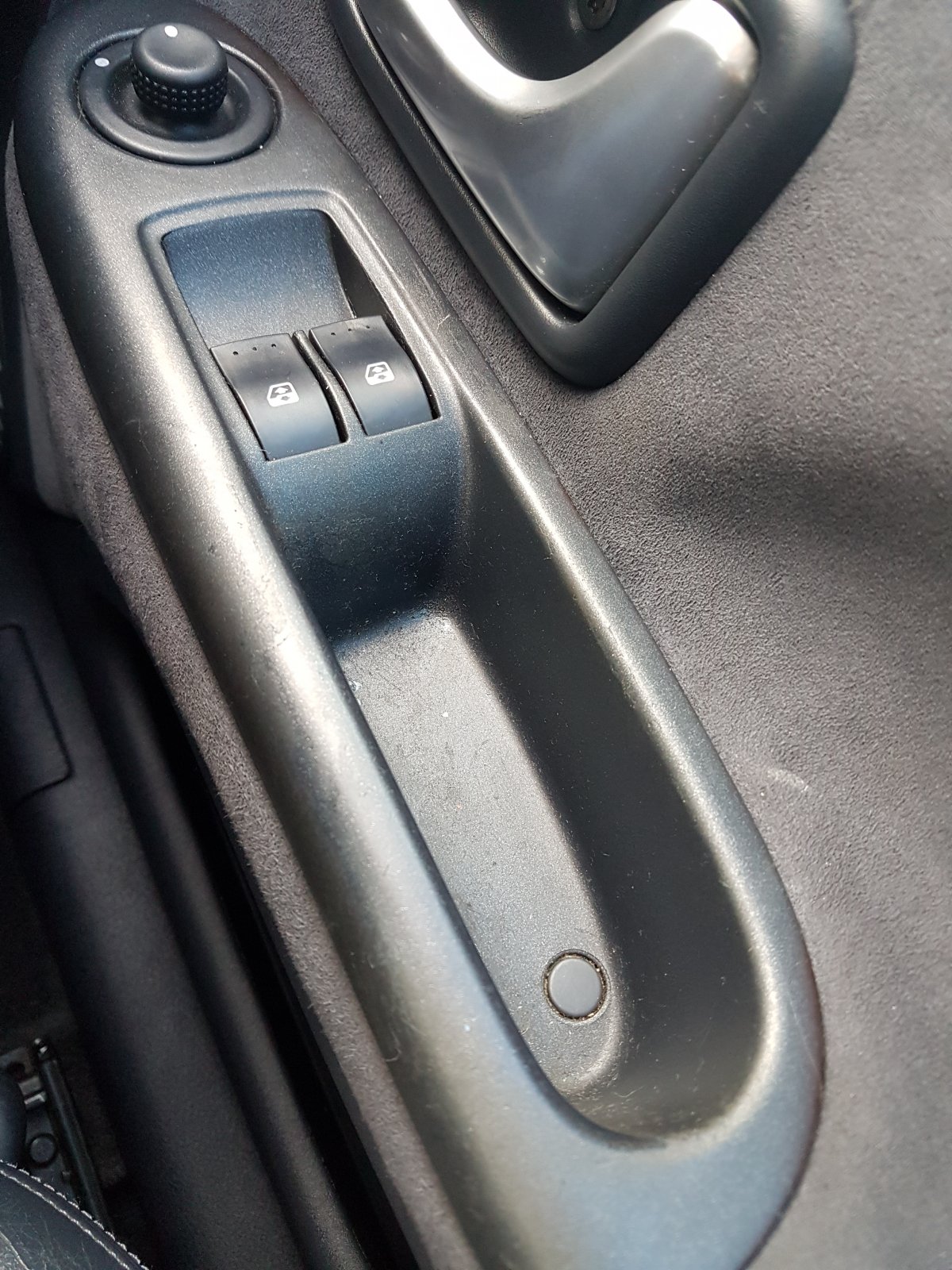

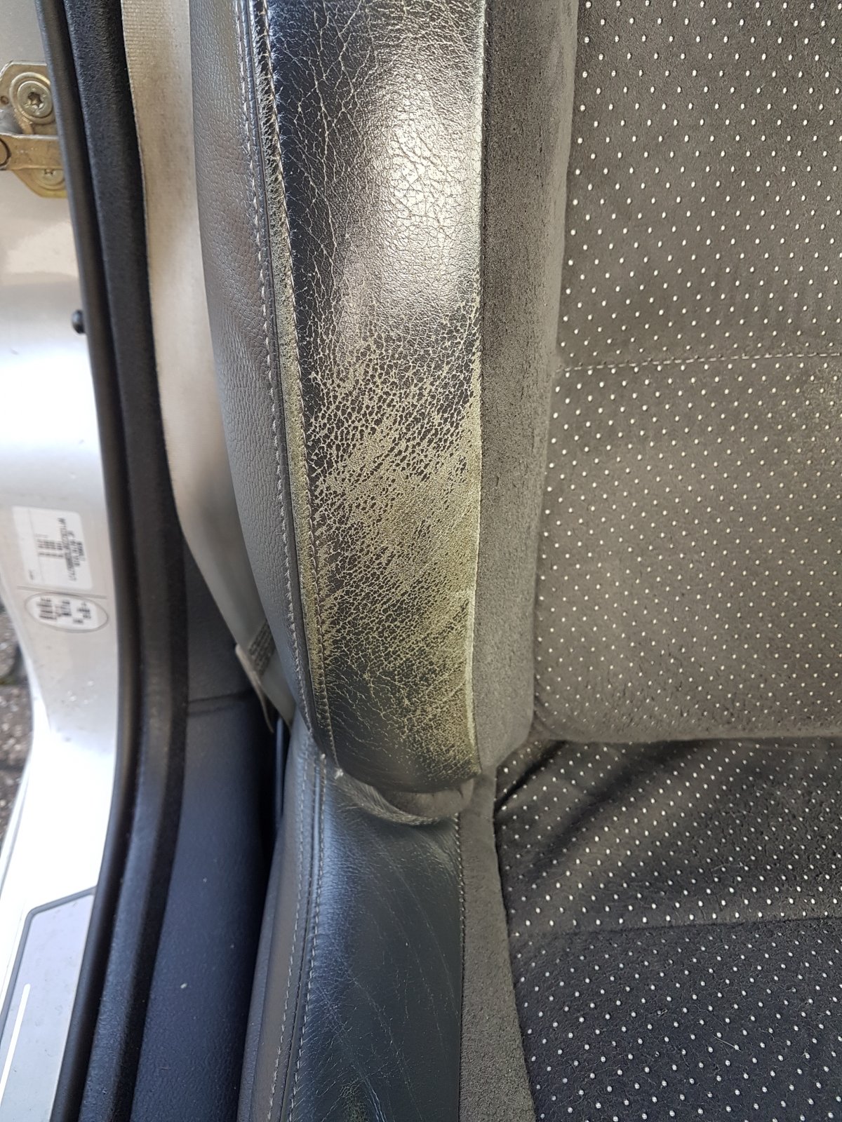

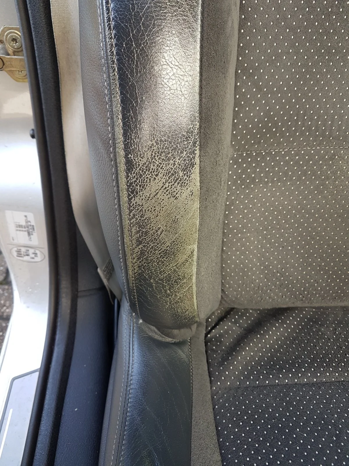

Very dirty thanks to the snow and salt on the roads atm, i'm not sure if someone has painted some of the plastics inside they seem to have a bit more metallic in them then i remember. Either way there are all sticky and horrible!
Rest of the interior is probably wearing inline with the age and mileage of the car, but i will replace most parts and make it fresh again! If anyone can tell me where i can get the carbon fiber bits I will be happy, I have been looking everywhere! Do people just get them dipped?

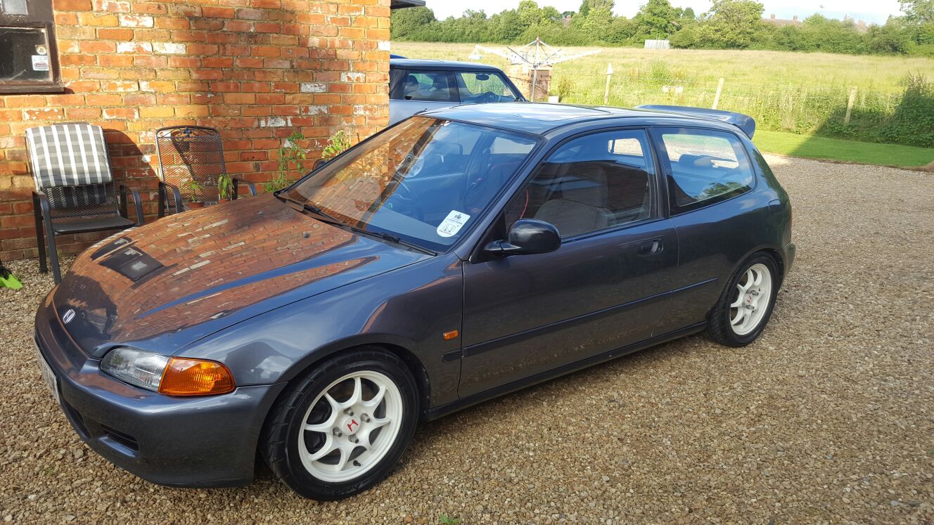

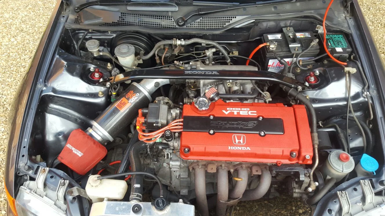

Didn't do much at the weekend tbh weather was pretty poor, met up with @STEVE.M for a beer and a chat. Thought I would post up some pictures of my old Civic EG for you guys.

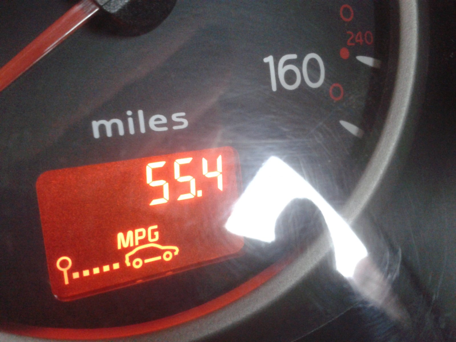

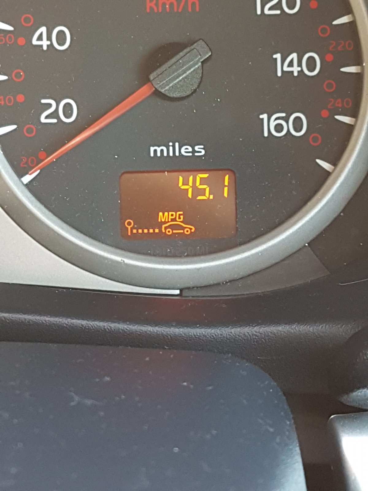

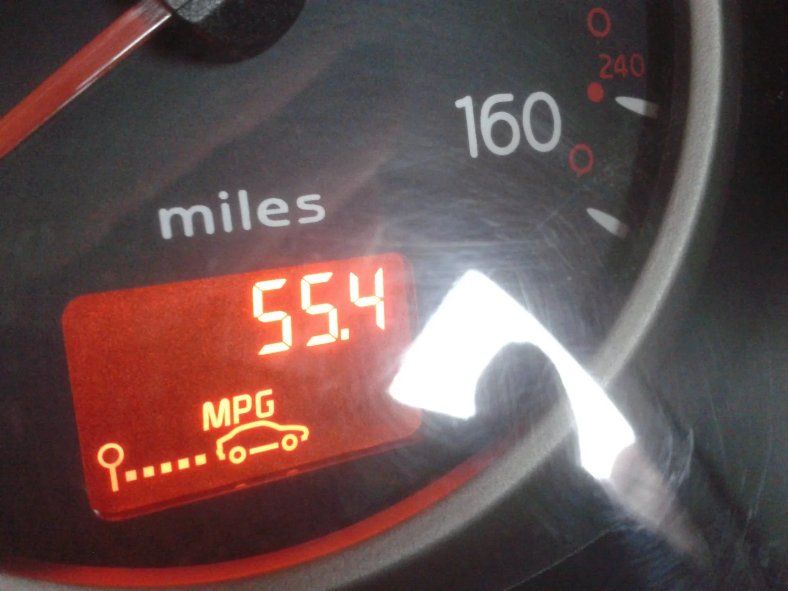

Filled her up yesterday and driving home and to work again I managed an impressive figure!
45.1 [emoji15] is it all down hill?? I wish mine would do that, just once to keep our lass quiet [emoji23]
Ha ha no far from it! I have to use M1, M25 and M4. It's all about anticipation especially around town, try not to stop unless you can help it and keep the momentum up etc. I was driving like a grandma but still doing 65/70mph. I just wanted to see what I could get out of it.

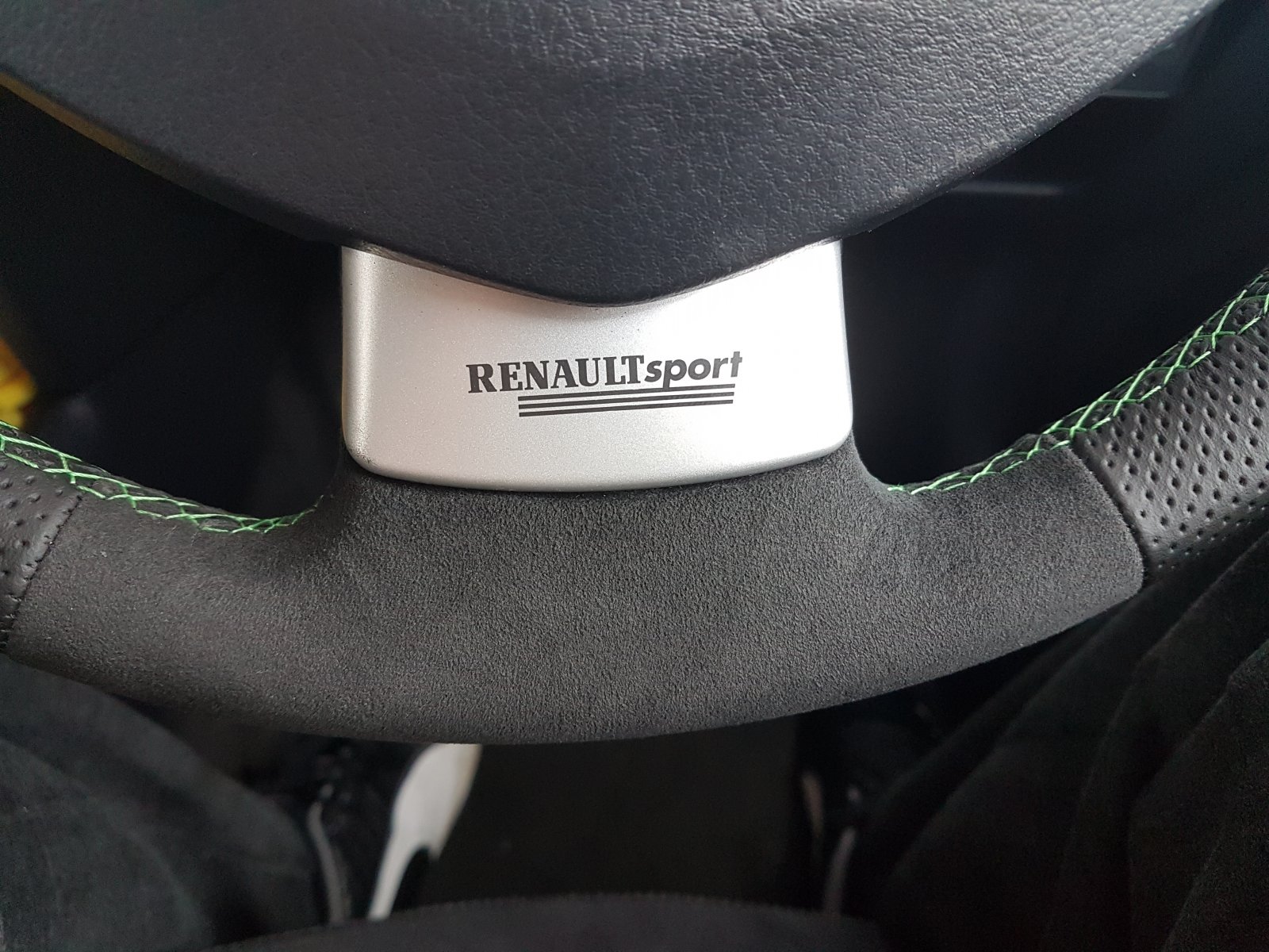

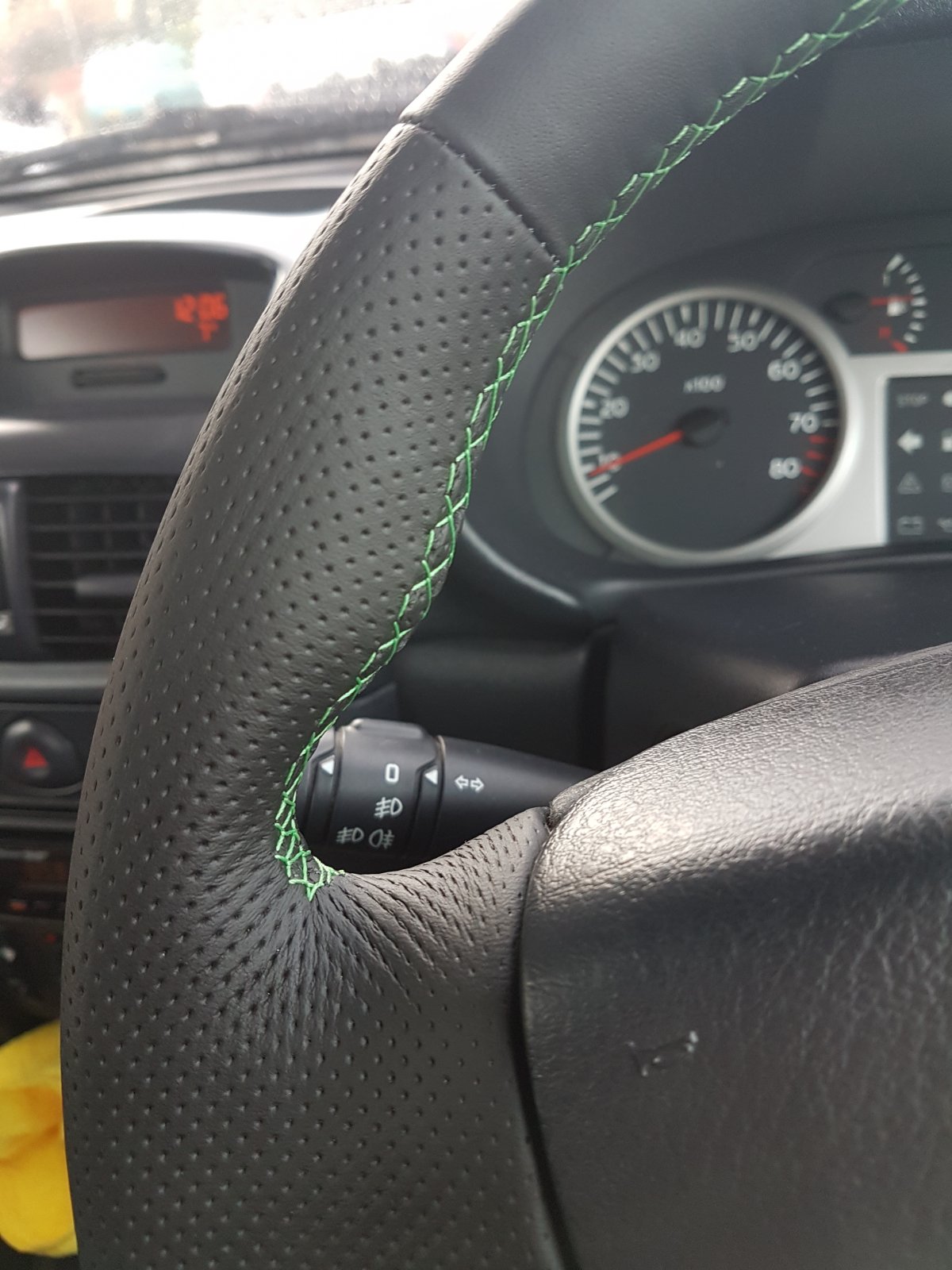

So today was exciting as i got my new steering wheel fitted, much better than the original. However it was not all good as the car now has a problem :( Will make another post for that. I'll let the pictures do the talking, work was carried out by Royal Steering Wheels.
Looks great.

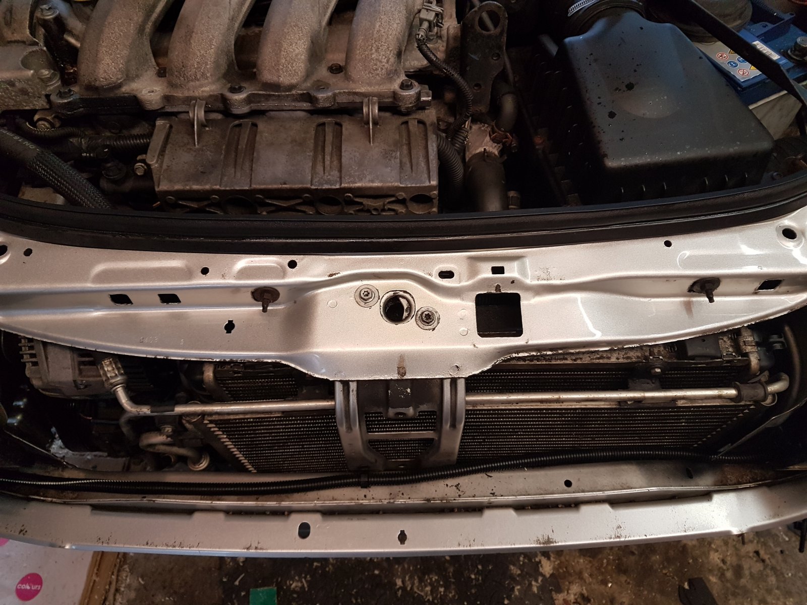

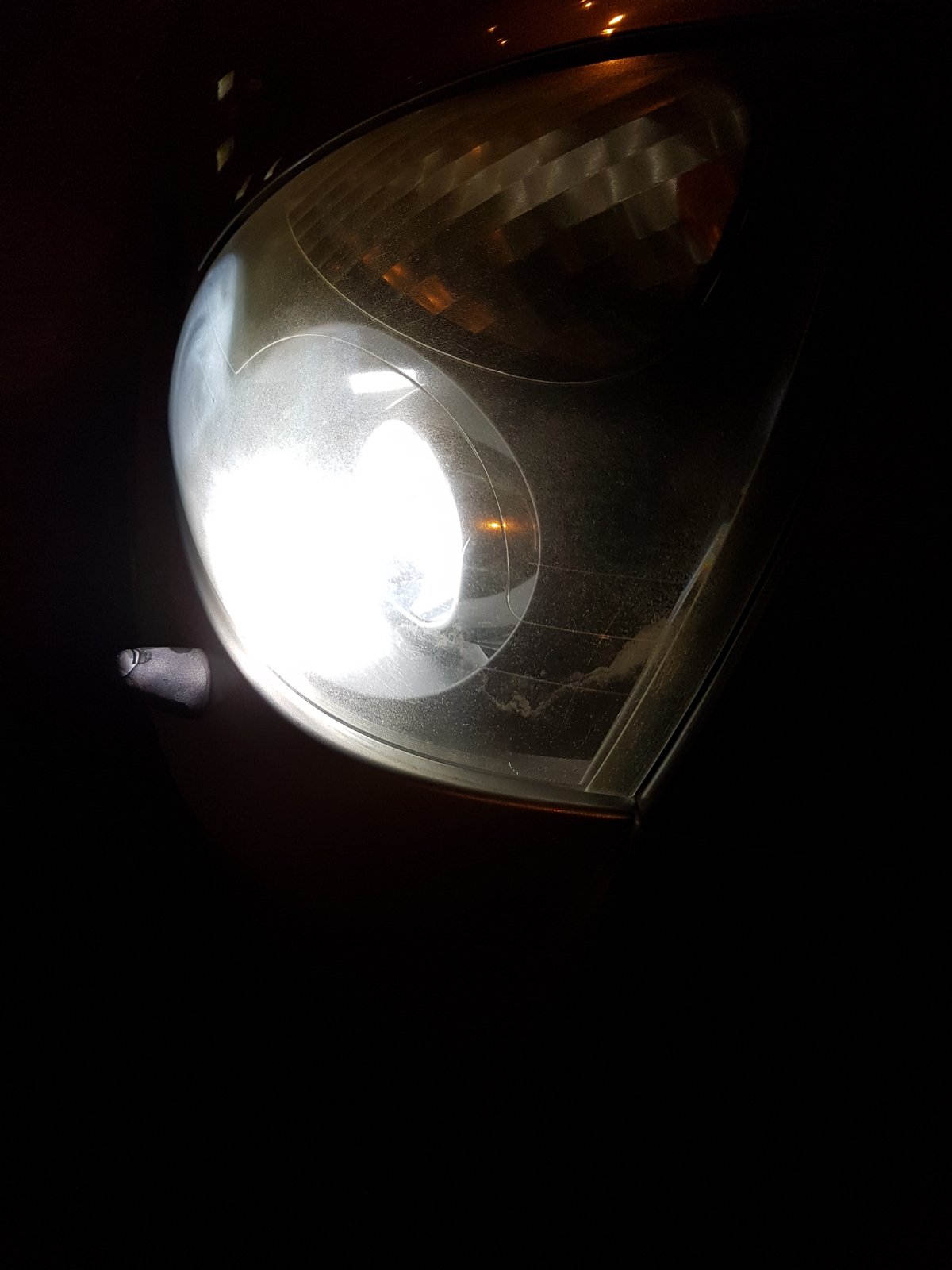

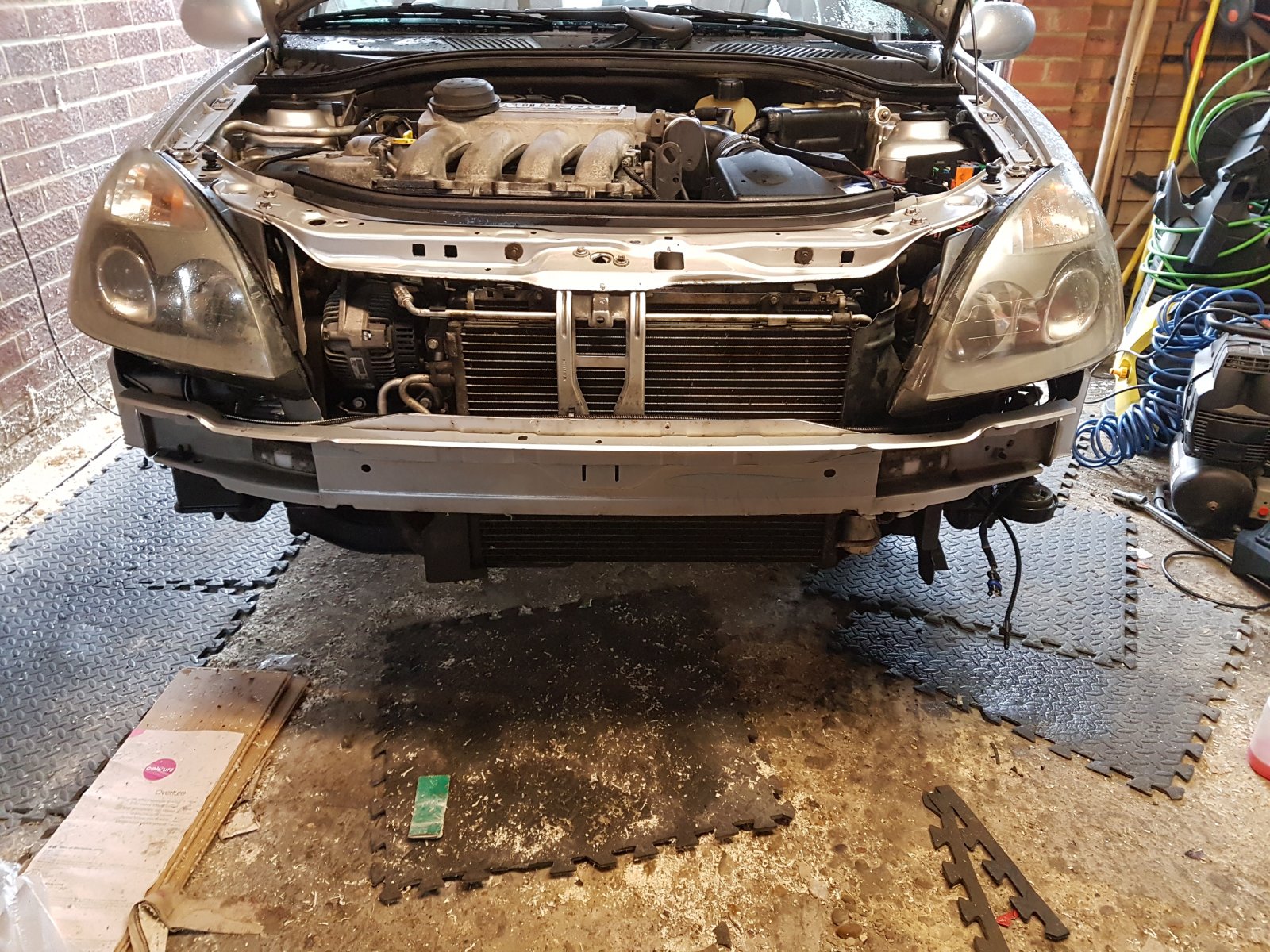

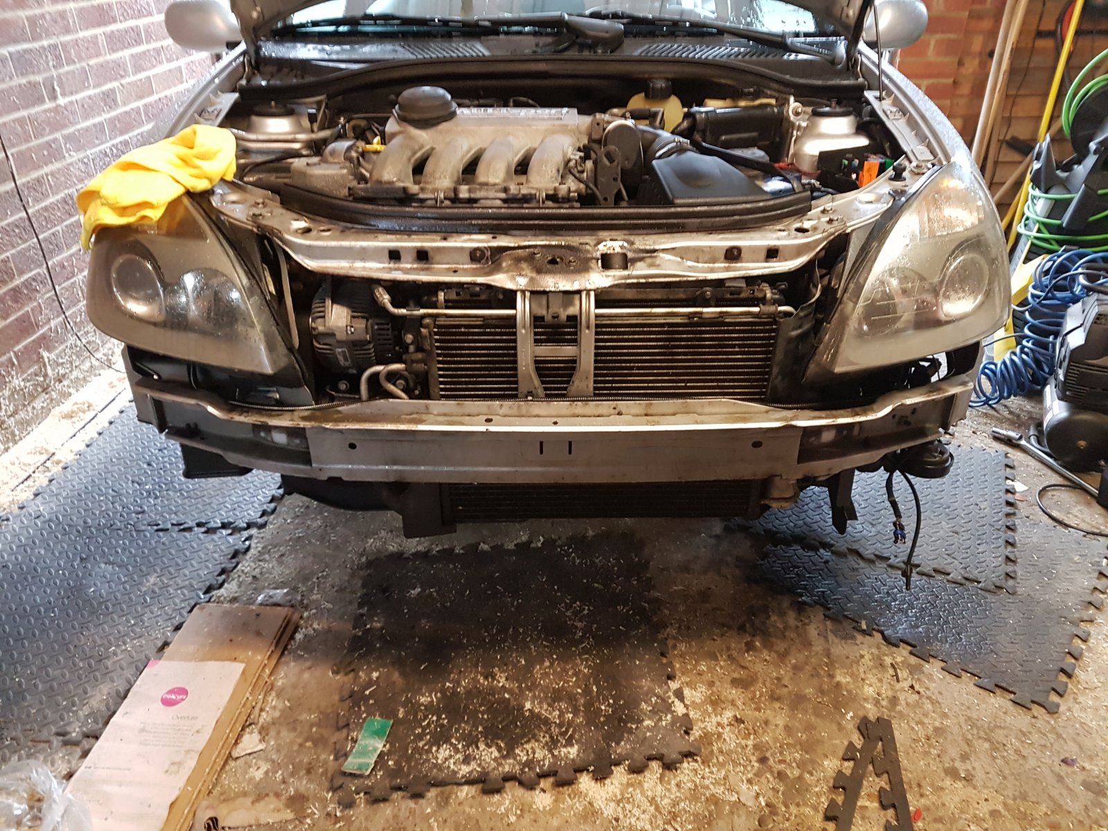

First problem started a week or so ago, I was driving home and noticed one of the Xenons had gone red. The plan was to take the bumper and lights out swap the bulbs over and see if it happened on the other side. Luckily it did so i know its the bulb and will order some replacements shortly.

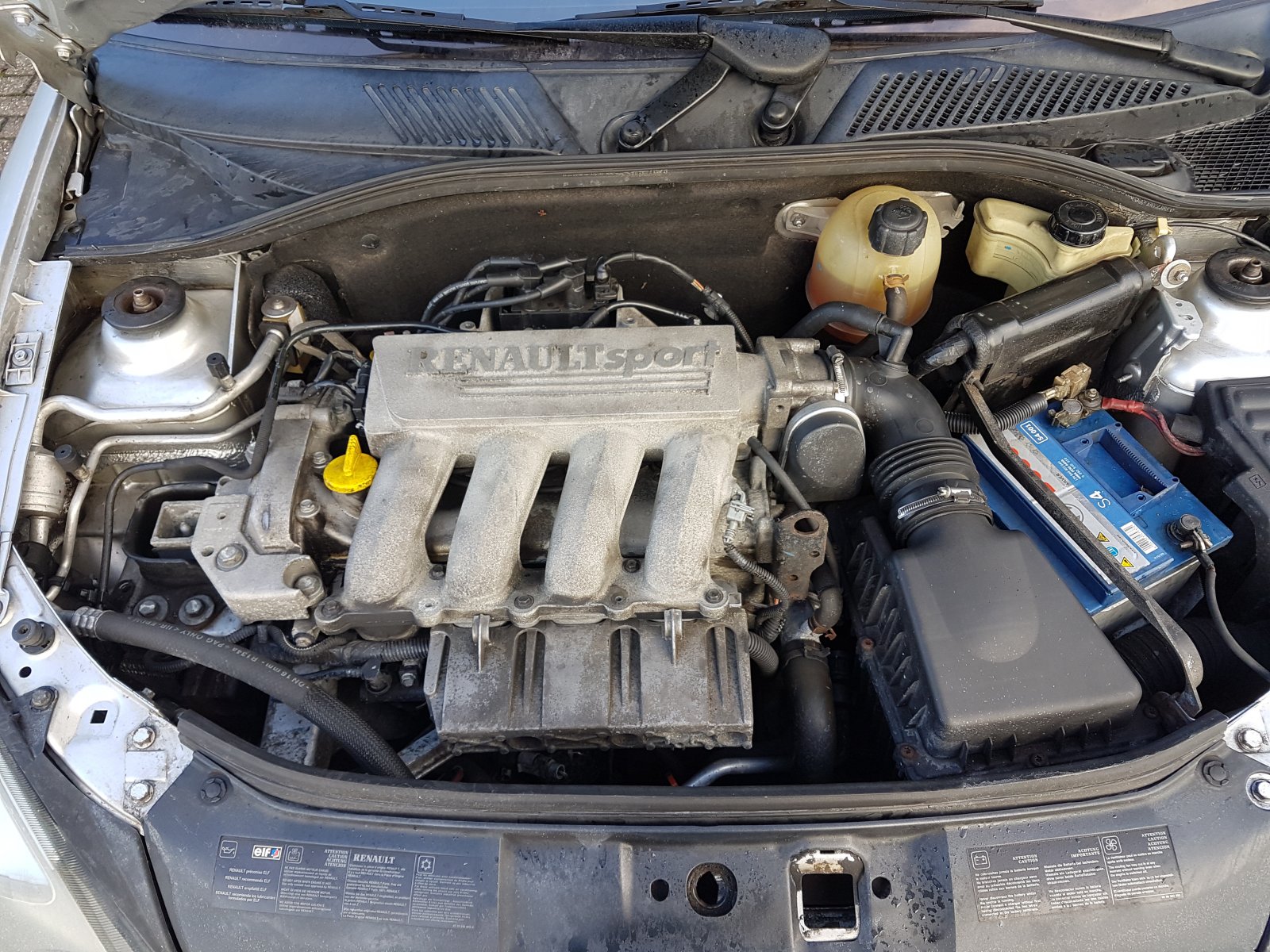

The second and major issue is that the car is now cutting out when slowing down in traffic or pulling up to junctions etc. I have taken the throttle body off and that was very clean so no issue there, I checked the relays in the engine bay fuse box and no sign of water ingress there either. I'm sure it will be something electrical i'm just not sure what, as the car is going to Engine Dynamics next week I will ask them to investigate and hopefully they can fix it!

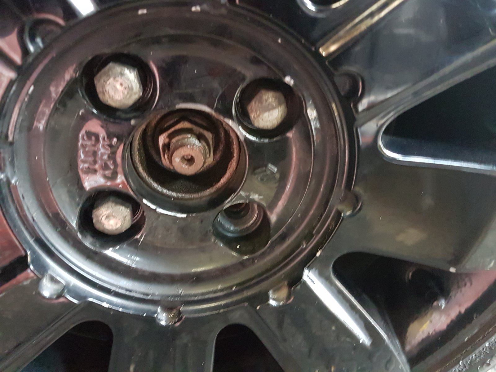

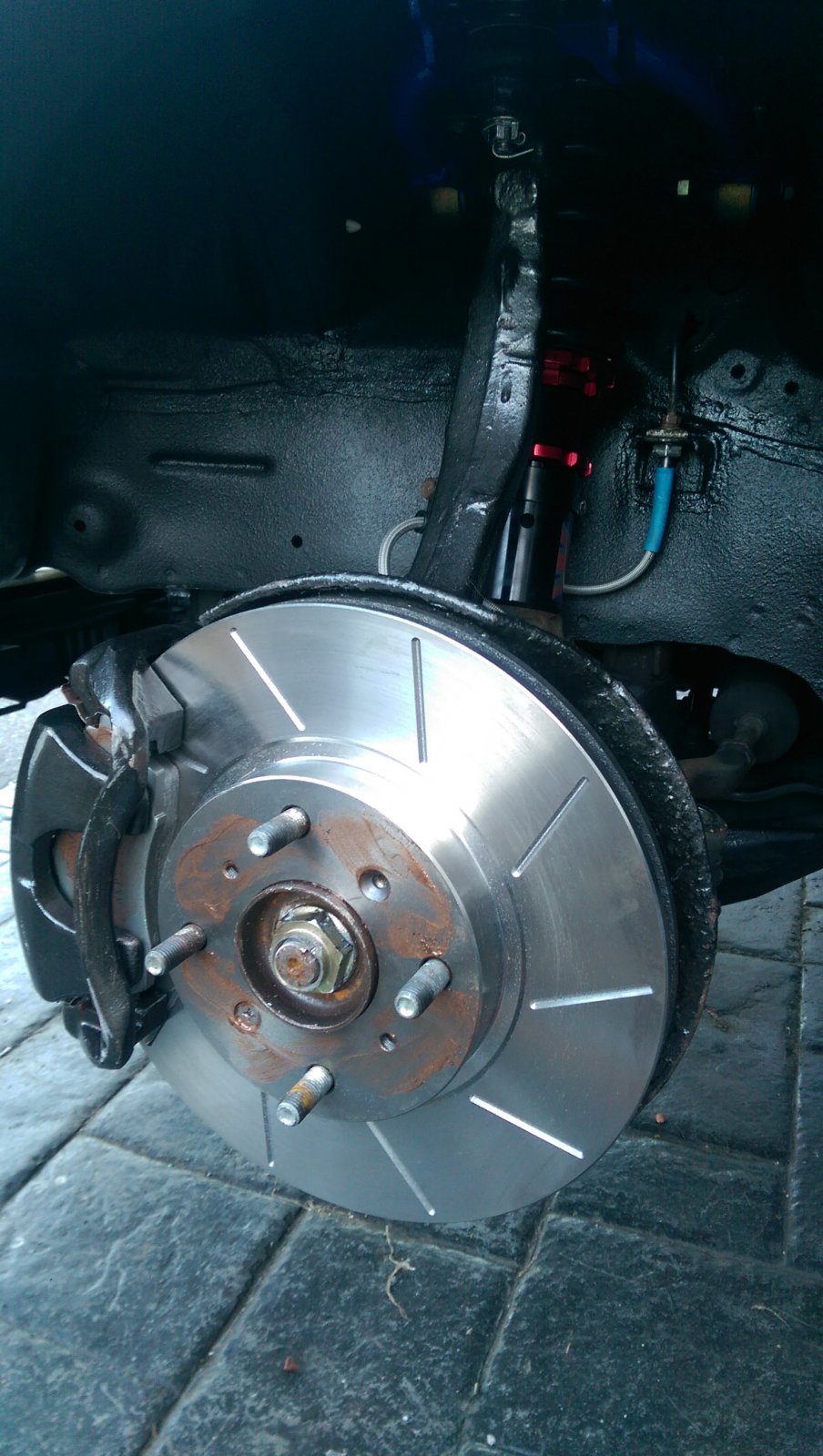

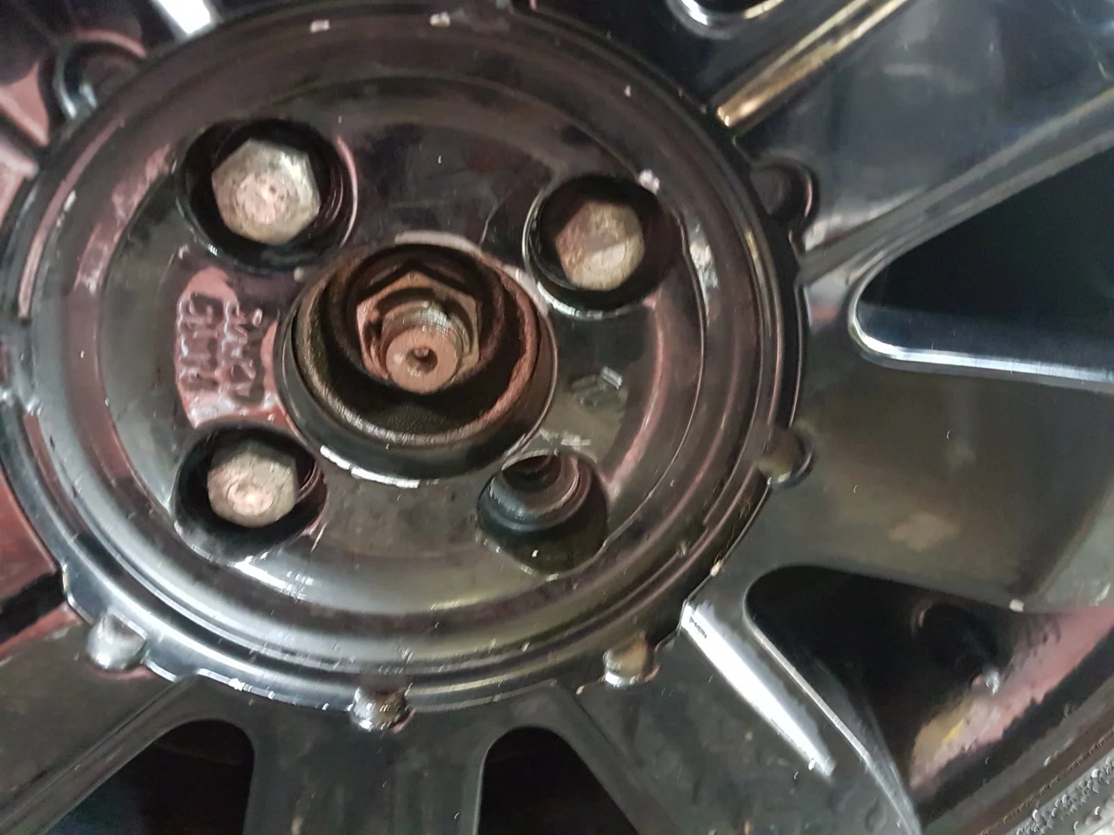

Started to jack the car up to get the wheels off and then found this! I went and checked the others and they are all the same, so i need some more wheels nuts.
When i got the car on stands and the bumper off it was pretty filthy so gave it a wipe over.
Decided to get the under tray off as it was a bit tatty, when i undone the tray this fell out.
As you can see the padding on the under tray is totally past it so I ripped that off and threw it away. Had a look under the car and it's not as bad as i thought it might be, the sump looks like its leaking, the ARB D bushes are finished and the exhaust manifold is dented where it used to hit the sub frame before the dog mount was changed. I checked the lambda wiring as someone on here had similar cut out problems and it was shorting on the wiring. Couldn't see any issues with it, so i have a little shopping list of parts and i'm just praying to the gods that the cut out problem is simple to sort.
Yep, I have them.in mine as well as many others and never had a issue. Mine are 5000k temp.
In fact, on many forums you'll look that have D2S bulb, they recommend HID's direct own bulbs.
Going to order the bulbs in a min, stupid question I have noticed the top bulbs in the rear lights are missing! What are they for the rear fog?
