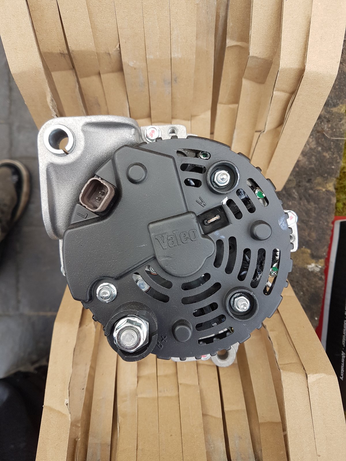

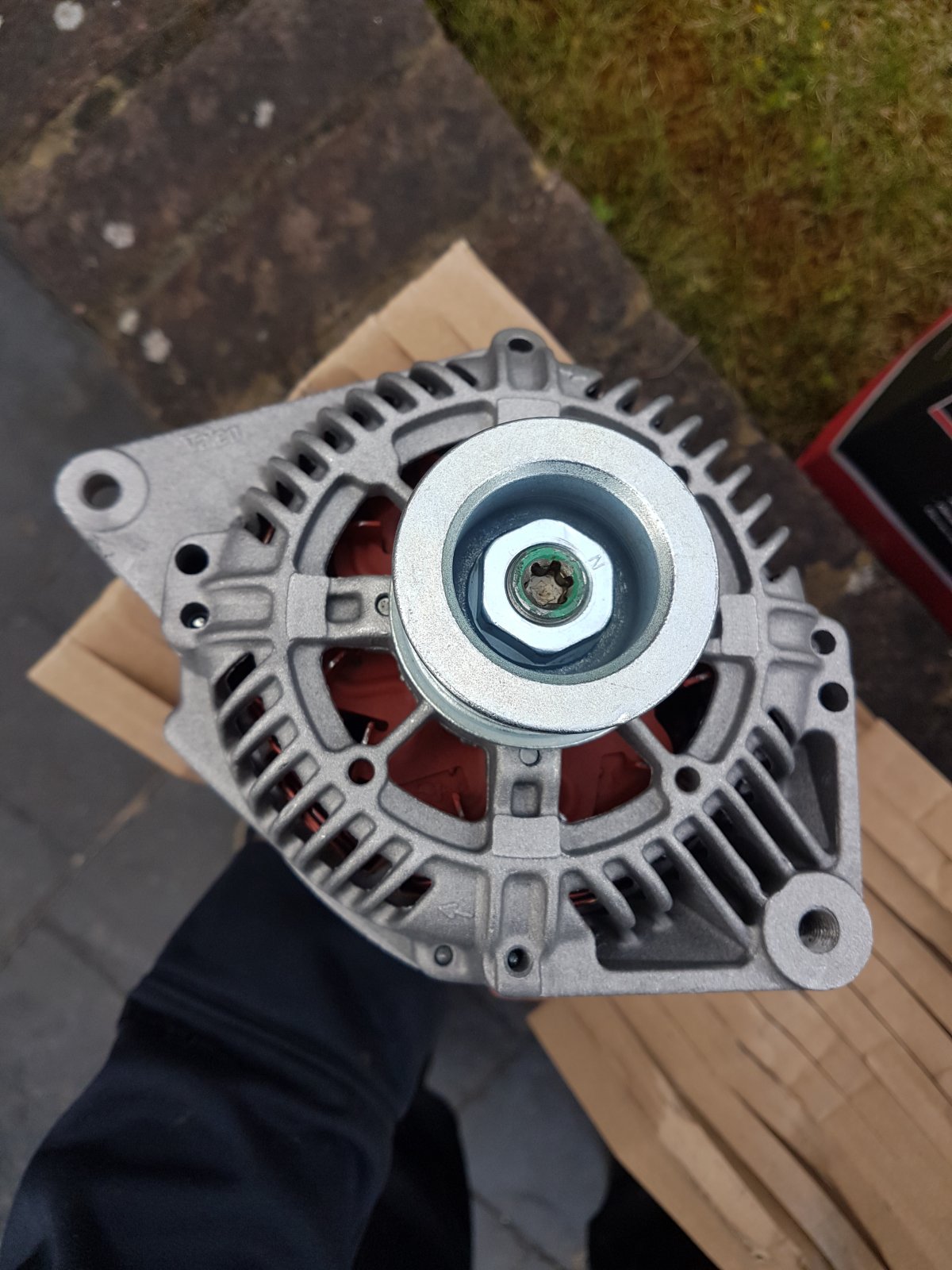

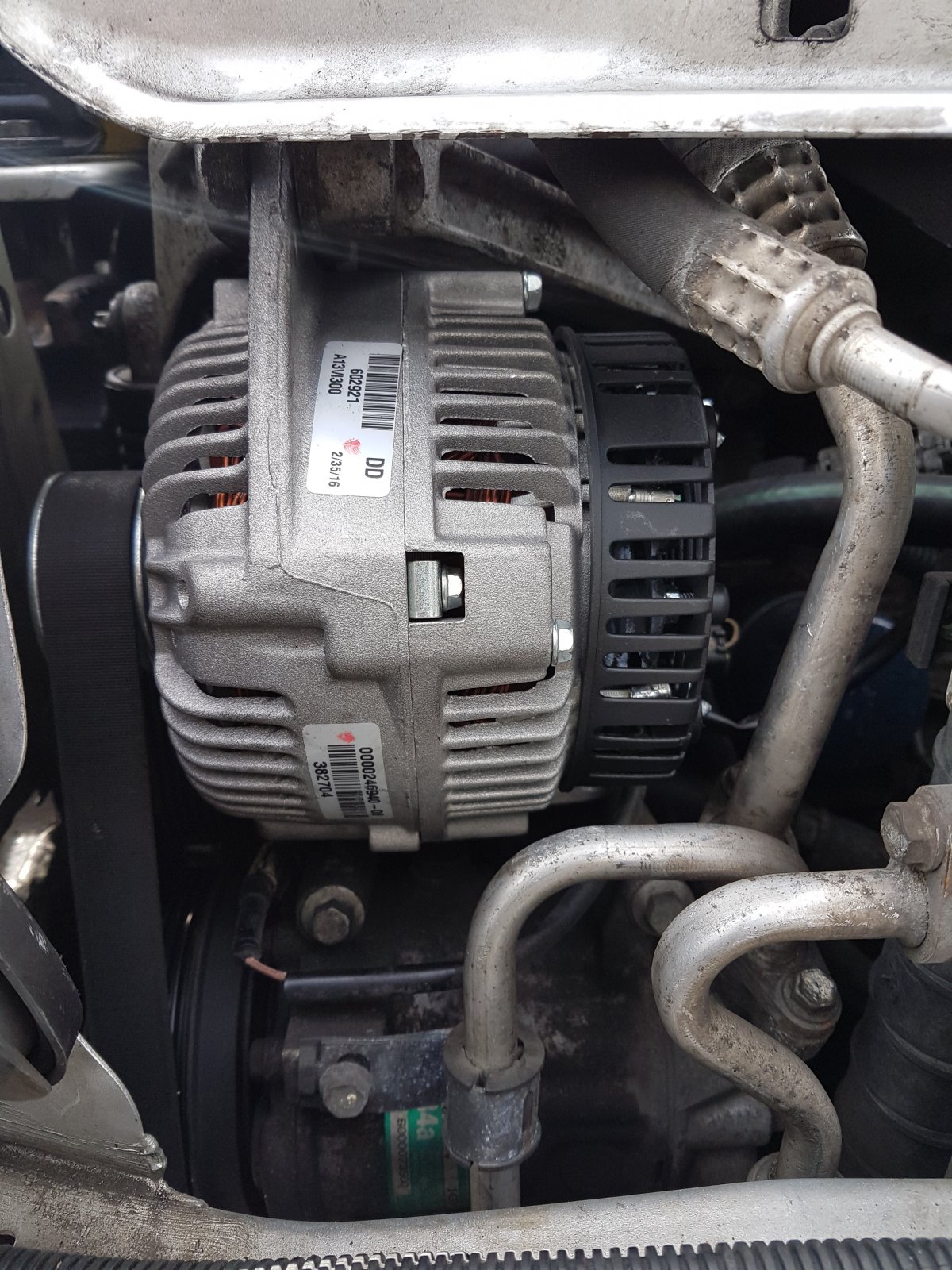

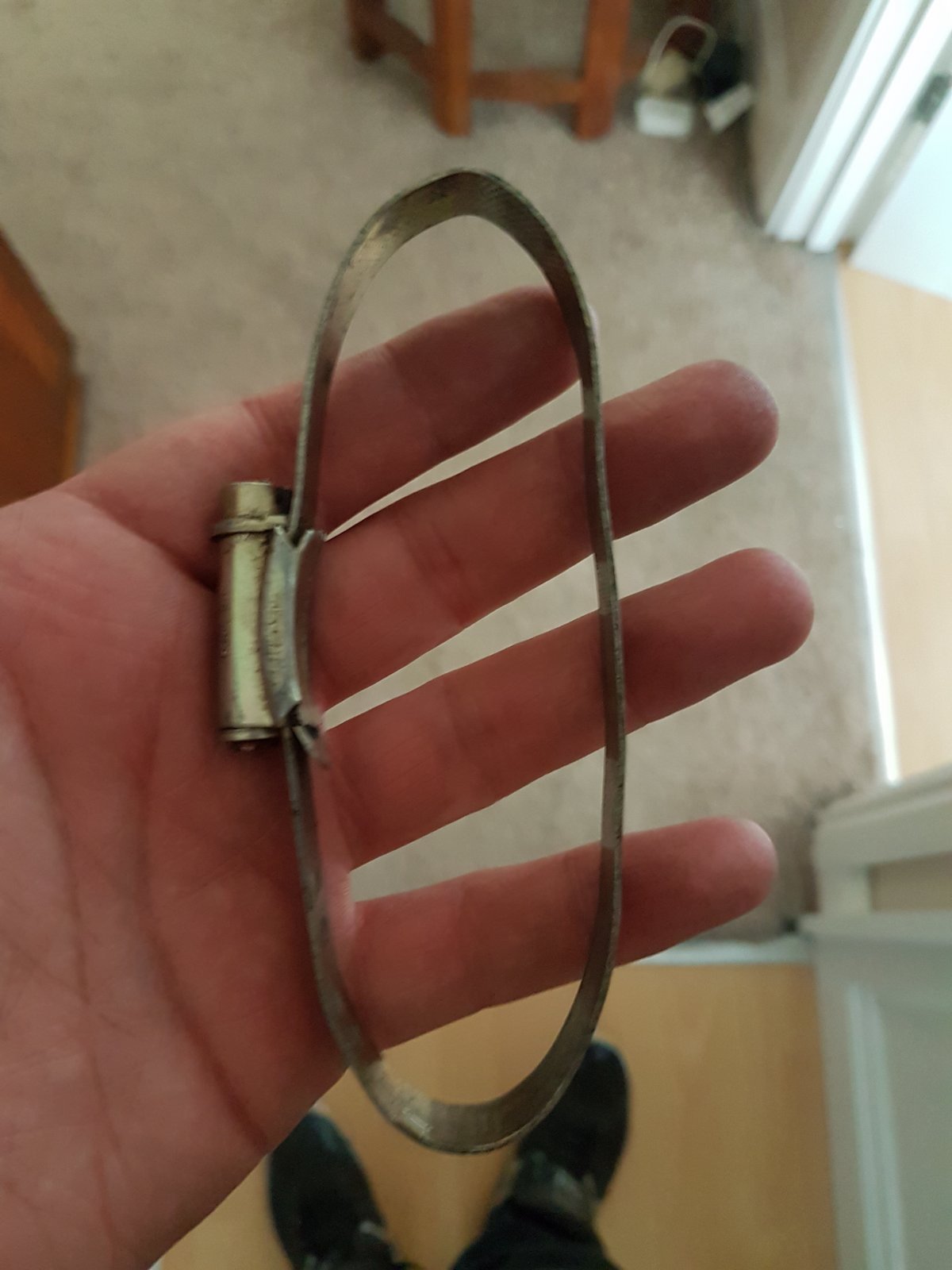

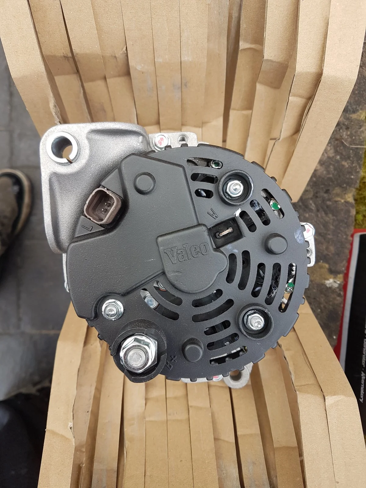

Well haven't updated this much, haven't had much to update really. I have been on holiday and training etc so haven't been massively using the car. Before i went away i did notice the battery and stop lights were occasional flickering away on the dash. With a bit of research people were saying it would be the alternator or the battery. I popped in the see Chris at beaniesport and he said it would be the alternator, which was frustrating as the alternator on it wasn't massively old. Yesterday i did a long drive to Plymouth and back which is a 500 mile round trip and it came on for a while and then came off so i decided today to replace it rather than break down at work etc. Most people say this can be a bit of a pain in the arse, even speaking to Chris he made up a special tool to release the tension. I decided on the jubilee clip method and luckily had one just right. (I will be now selling my amazing tool to anyone interested haha)
I loosened the alternator and could lever it to move the tensioner and then bent the jubilee clip to fit, then i slide it over the spring and it held the tension back just enough to get the belt on and off. Didnt have to remove the slam planel just the top four bolts that gave me more wiggle room and it came out were the grill would be. The new alternator was from Euros and i was surprised when i unboxed it to find it was a nice new Valeo :smile: Anyway an hour later and the job was complete so not bad really.

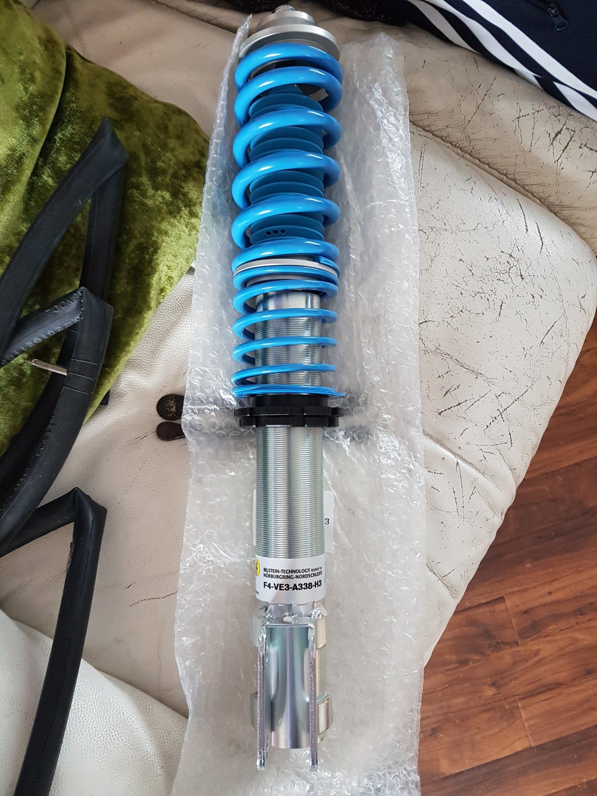

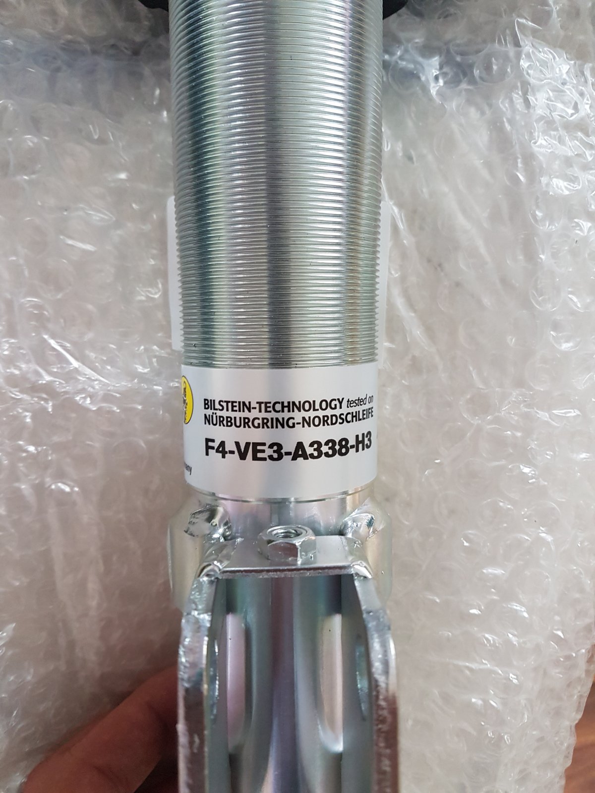

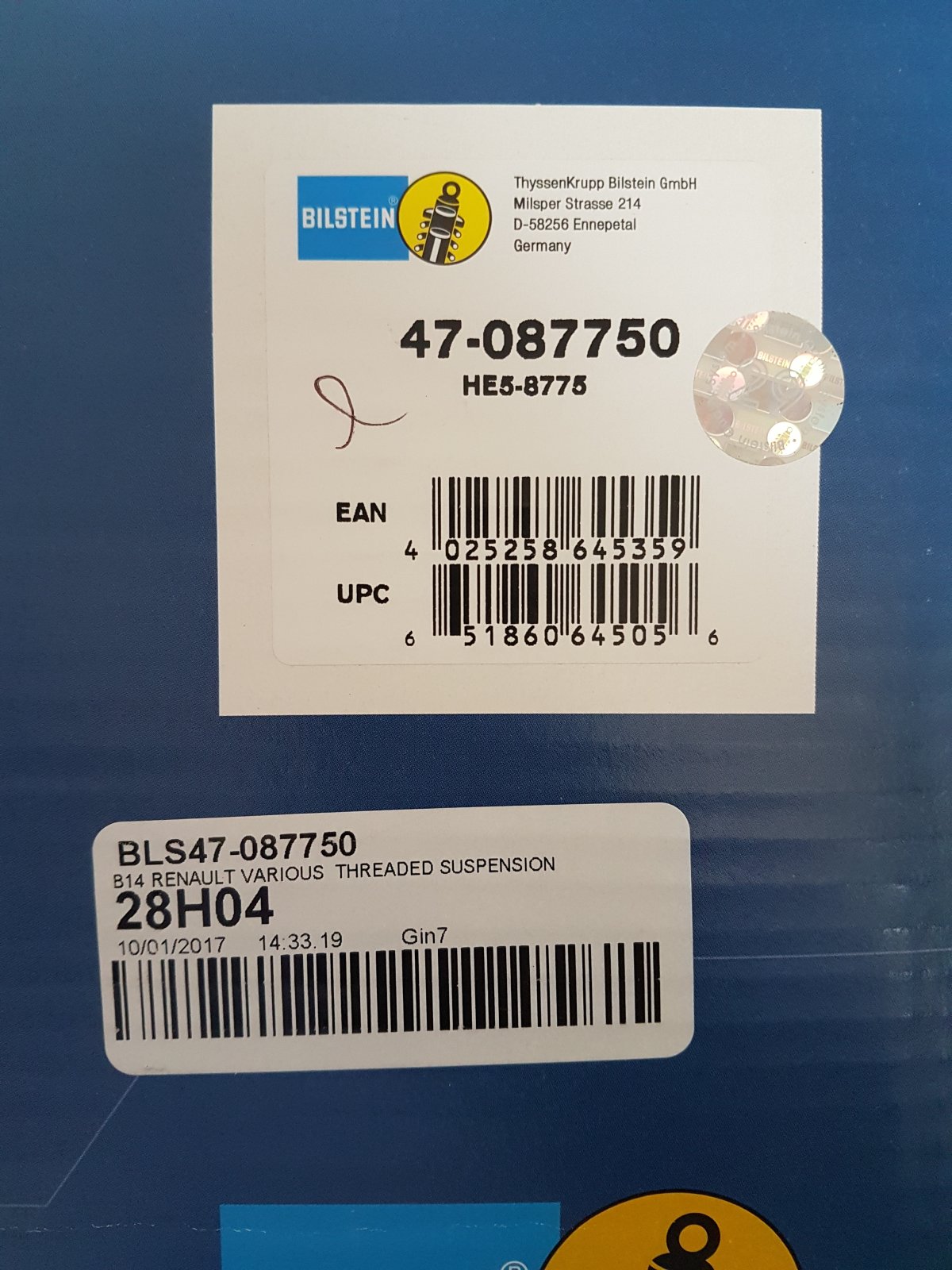

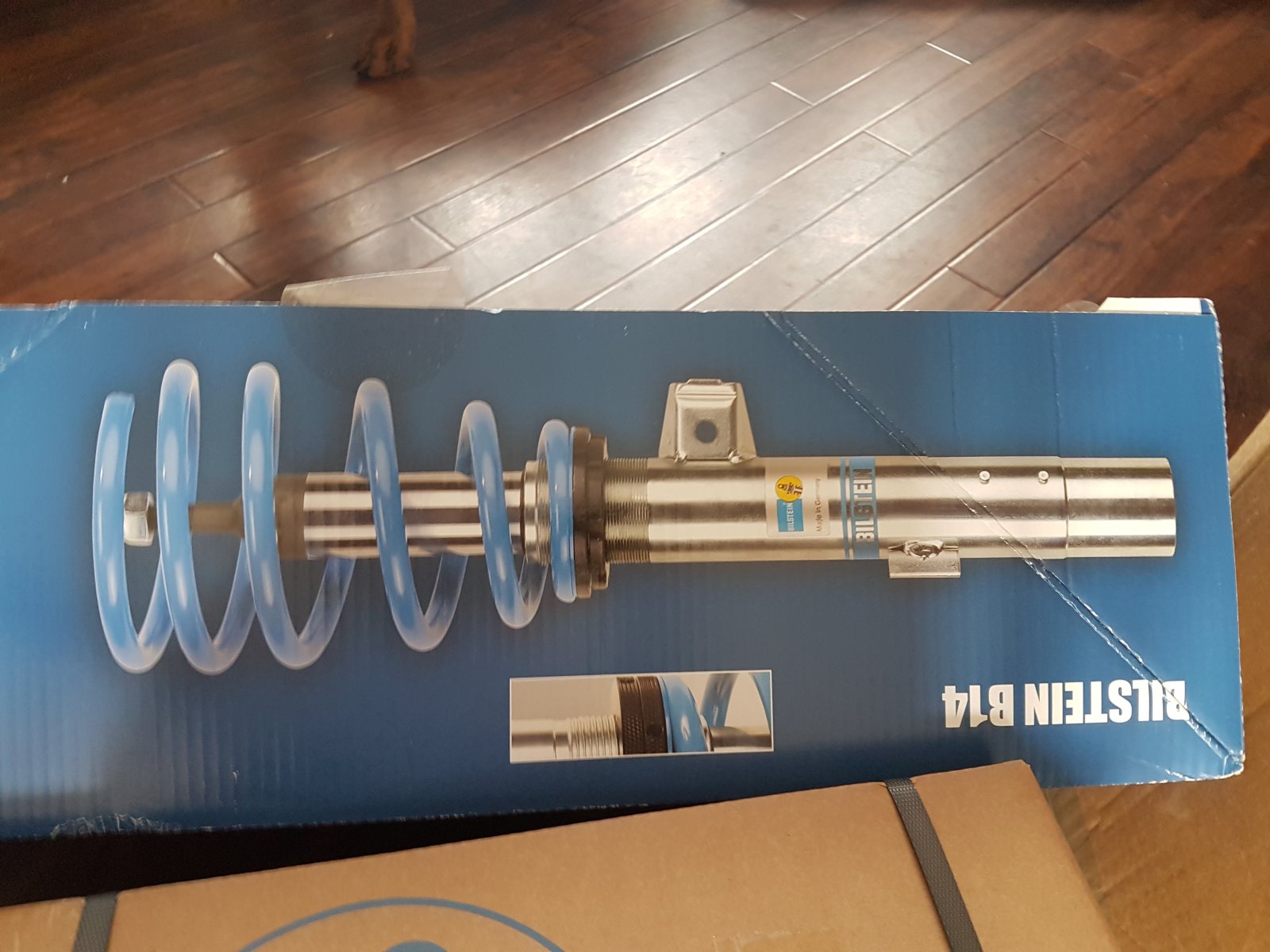

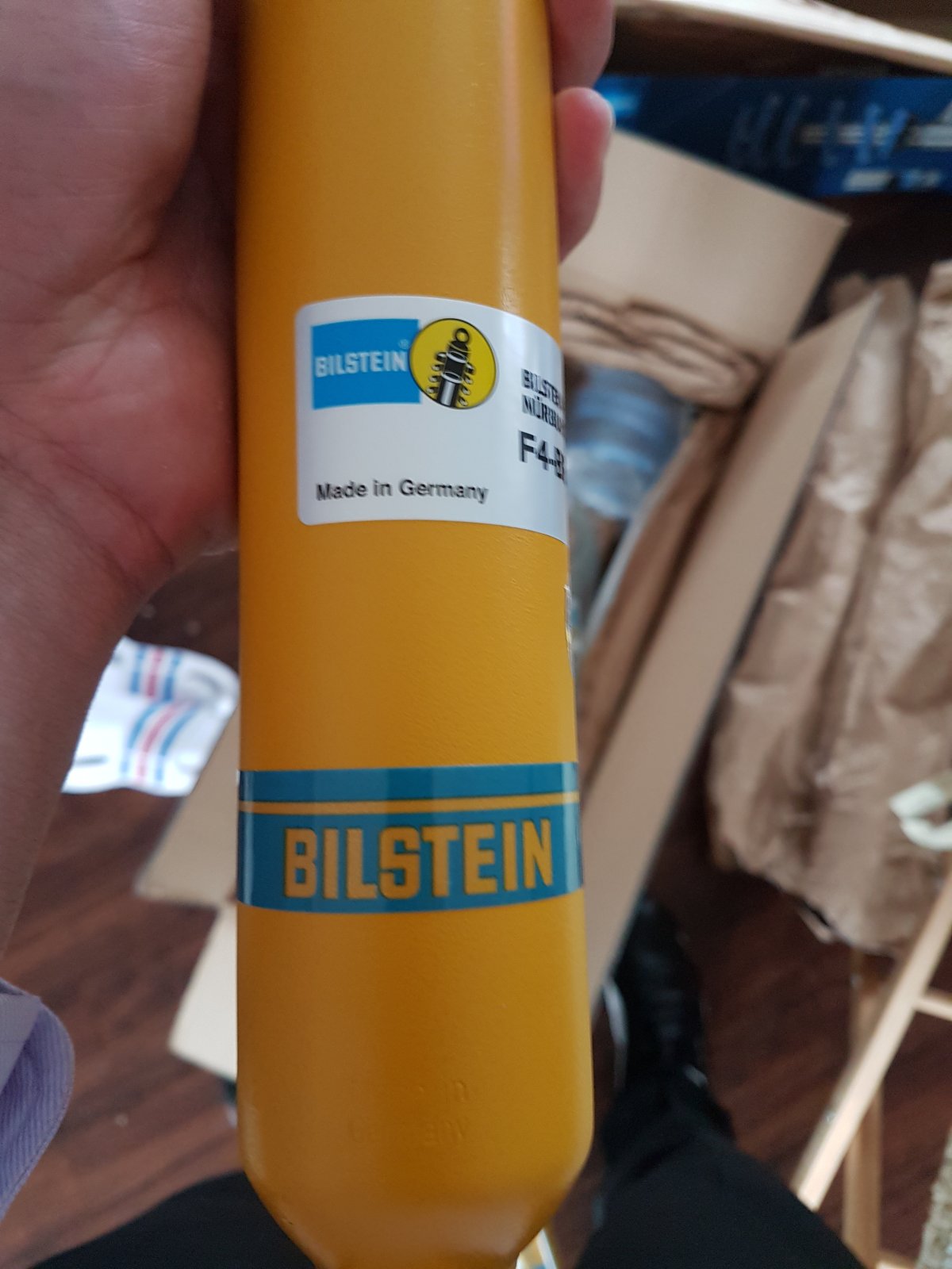

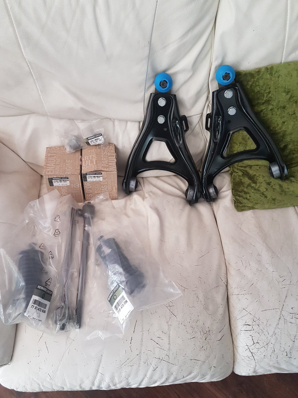

Being off work is never a good thing because you end up spending all day online looking at car parts. I have now just ordered the Bilsteins and made a list of all the other parts i want to buy in the next week or so. I want to replace all bushes and suspension components so if i miss anything can you let me know! On the list so far i have the following:
* Check driveshaft and steering gaiters replace if required
* Inner steering arms
* Replace shocks and springs with Bilsteins
* New top mounts (front OEM rear poly)
* New wishbones OEM
* Inner and outer ARB bushes poly
* Steering rack bushes poly
* Rear axle bushes OEM
* Camber bolts
* Rear ARB
I think that is all i need right? Can anyone recommend somewhere for fitting all this and setting up the suspension?

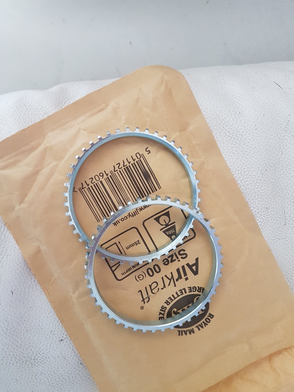

Have a look at the abs rings while you're at it. May as well swap them if they are rusty while it's all stripped down, they are only a few £ on ebay.
Rojer
Do you know which ones i would need? I have seen a few different sizes and teeth etc.

That is a big ol' list. I'd add new ball joints if you've missed them, but they will probably come with the wishbones.

They do indeed Steve, they do indeed! Hopefully all this suspension work will make a big difference, atm when breaking from moderate to high speed the car can pull quite hard in either direction and the back end wants to come around! Also when going for an overtake for example if the road is a bit rough the steering is all over the place. Im pretty certain the brakes are not the issue as they have been done recently so hopefully its just worn out all suspension ready for the bin.

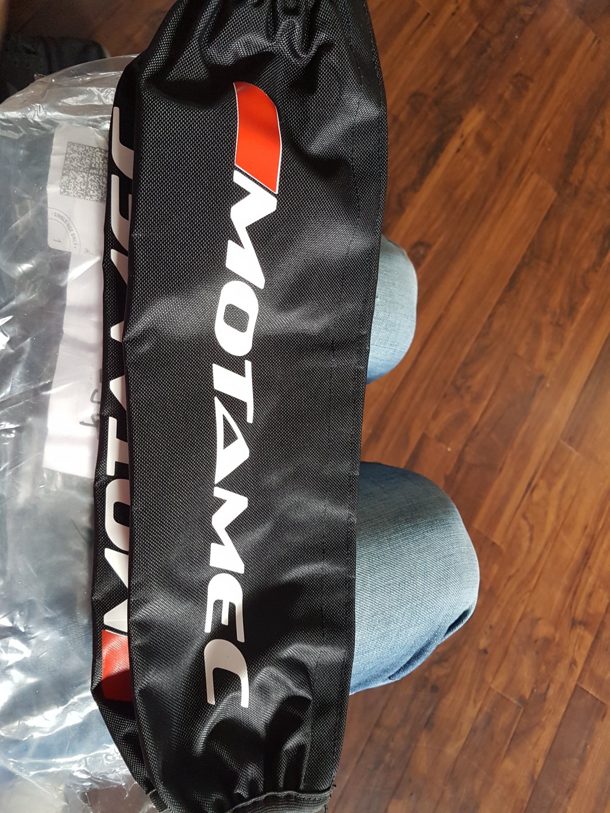

Make sure you get some protection on them coilovers or they won't look like that for long 😂
Rojer
@Dr Jekyll do you have any recommendations for protection? I noticed your covers which i may order some, did you cable tie them to the show as well? What is the best for thread coating?
Jekyll
@Rojer Yes, I have the motamec ones. I have found that they fair up very well to protection. They are made of nice durable material and the elastic is nice and strong. The good thing is thaey can be taken off and refitted without removing the shocks.
I've not sprayed mine with any coating as the covers cover most of the threads barring the last bottom bit, which I'm never going to use.
My covers are 406mm I believe. They do 3 sizes and mine are the middle ones. I will dig out the link in a mo. Check my progress thread for pics on how they've performed over the winter. I'm happy with them.
But the ACF-50 that @leeds2592 recommended has good reviews and isn't expensive.
On a side note, the bilsteins are excellent. Not crashy at all and a perfect fit and forget coilover kit :smile:
Thanks for the heads up, I will order some of those then they sound really good. Might get some of that ACF-50 stuff as well.

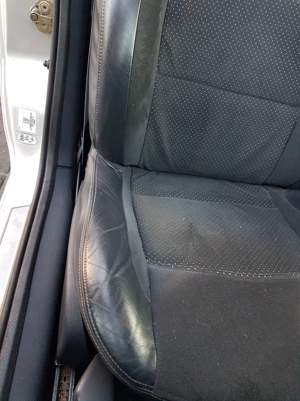

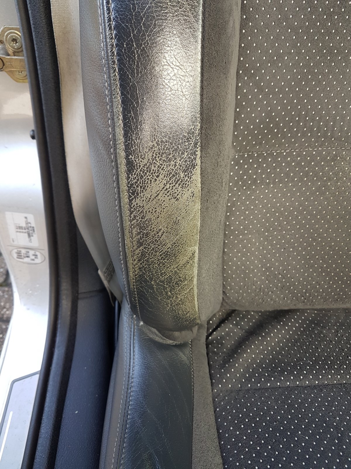

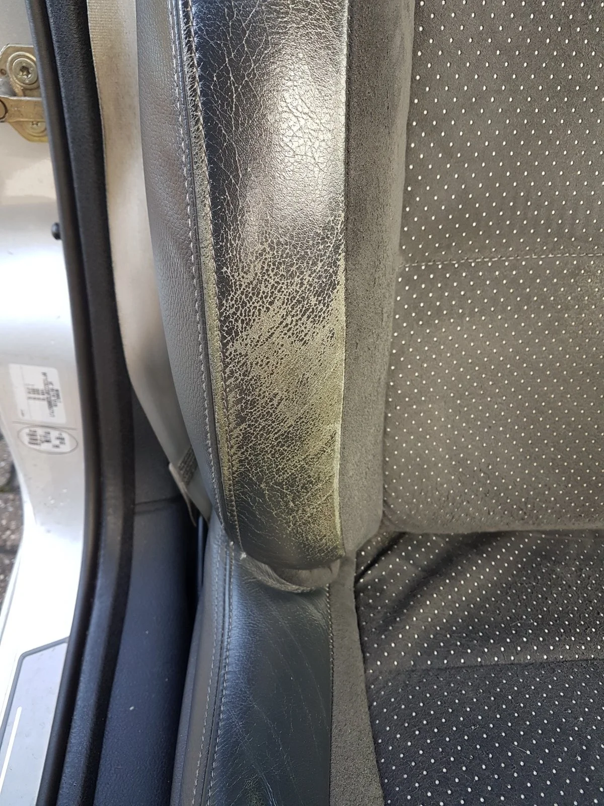

So today after work i went and visited @colesy all i can say is wow lol the scenery and roads around his area are epic lol. We had a quick chat i put the new to me seat in the back of the car and i was off, nice guy. Good luck at the weekend!
Once i was home i got the car jacked up and stuck the new seat in :) Went for a test drive and all good. Very happy with the results. Two birds with one stone because my cable had snapped on the old one so wouldn't slide on the lever. It will clean up nicely. Next up more suspension.
OLD
NEW
