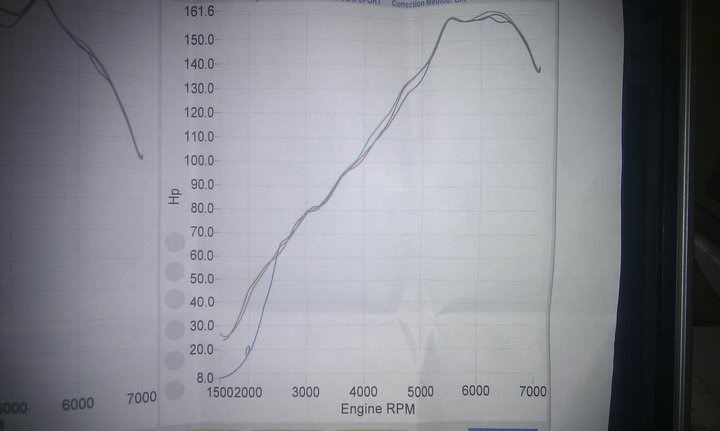

I know what your saying mate but 161 bhp lol come on thats just not right at all and it aint just the bhp diffrents its the fact they showed me it was running way to rich about as rich as a turbo'd car and it shouldnt be after having it mapped.

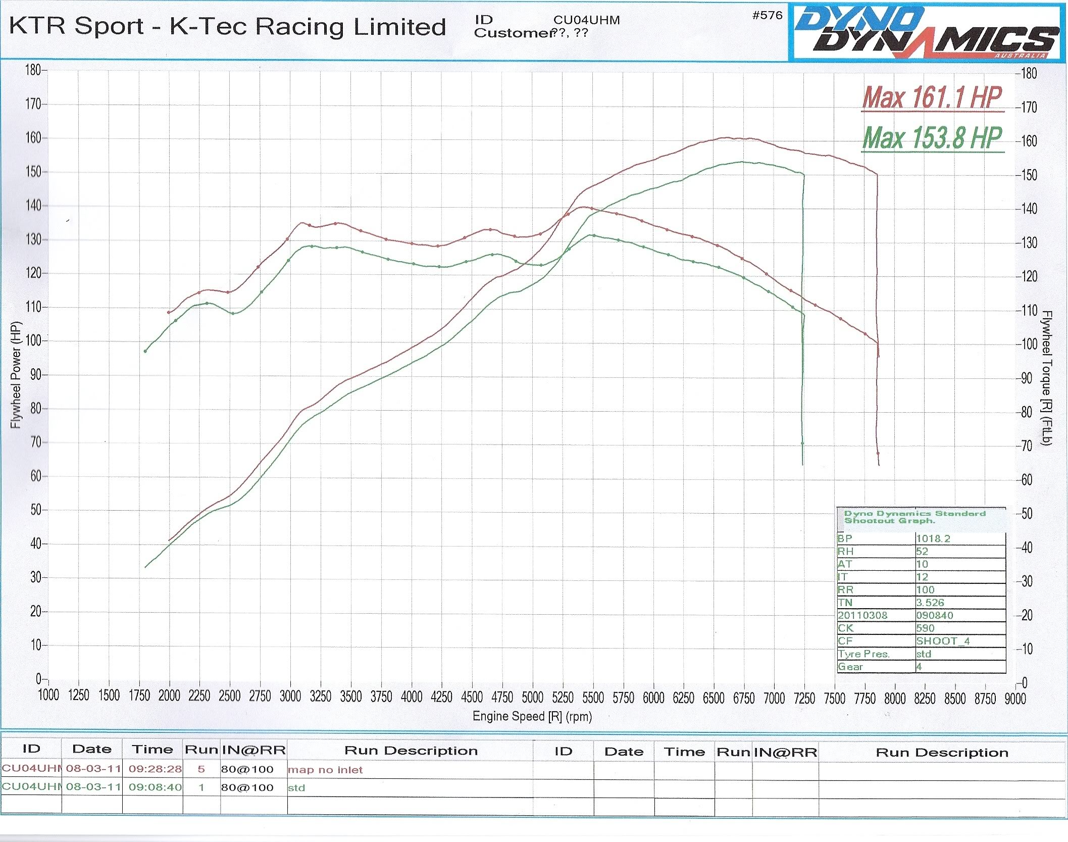

In that case your figures weren't majorly bad. The majority of the 182's at our recent dyno day made high 150's low 160's (mine made 164 ATH) admittedly with matched inlets and a map you should have maybe got a few more but that might be lost through using a different dyno. Once the 10-12% drive train loss figure is added then your flywheel bhp figures shouldn't be that far off the mark at all.

With the mods iv got thou it should make more then 161 bhp and its a massive 27 bhp down to what jamsport said and its running rich what is not right not considering its been maped.

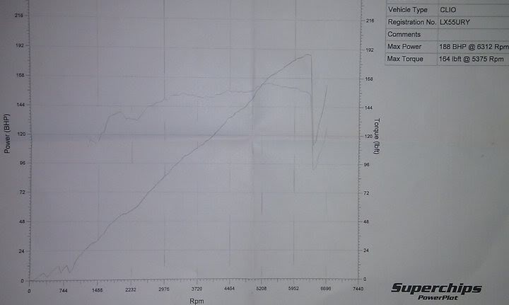

My 182 made 163 bhp at Ktech with same mods mate and 184 bhp at powetstation in tewkesbury 3 hours later
Dyno lottery I'm afraid

It does seem to go well enuf just seems to have a flat spot between 6500 rpm and 7000 rpm and i dunno what think i could do with taking it back jamsport and having the map look at again as it cost me over £500 to get the inlets done and maped..
It could be a sensor has started playing up since you custom map which is giving your higher afr but from what I remember I thought 12.1 afr was ok but not got any of my results to hand. What's your mpg like?
Ktech was cheaper than that for mine how long you had this problem for since jamsport mapped it ?
I know mate but a had a custom map and k-tec do the the group n remap witch is cheaper and yes since iv had it back from jamsport it seems to have a flat spot after 6500 rpm like the power drops of alot then comes back in at 7000 rpm.
as i said mate dyno lottery look at my graphs

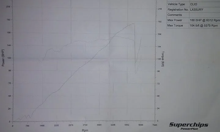

Its basicaly a basic map wheres a custom map is maped to your mods and looking at your graphs your car holds its power good as mine when it gets too 6500 rpm the graph reading just drops off.
As you can see from the graph the power dissapears at 6500 rpm what isnt right.
Has it occurred to you that peak power is at 6500rpm then? That's why your seeing a drop off after that. Just because you car revs up to 7,250 or whatever it doesn't mean it will produce peak power at the highest revs, hardly any cars do in fact (at the limiter).
Yes the peak power is at 6500 rpm but when it hits it peak power it doesnt mean that all the power goes away it should hold power more just like gti6steve graphs what hes posted on here just look at the diffrents between his and mine lol.

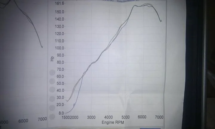

This is my graph from JAM - sport when i had the inlets and custom remap as you can see the power drops off too soon.

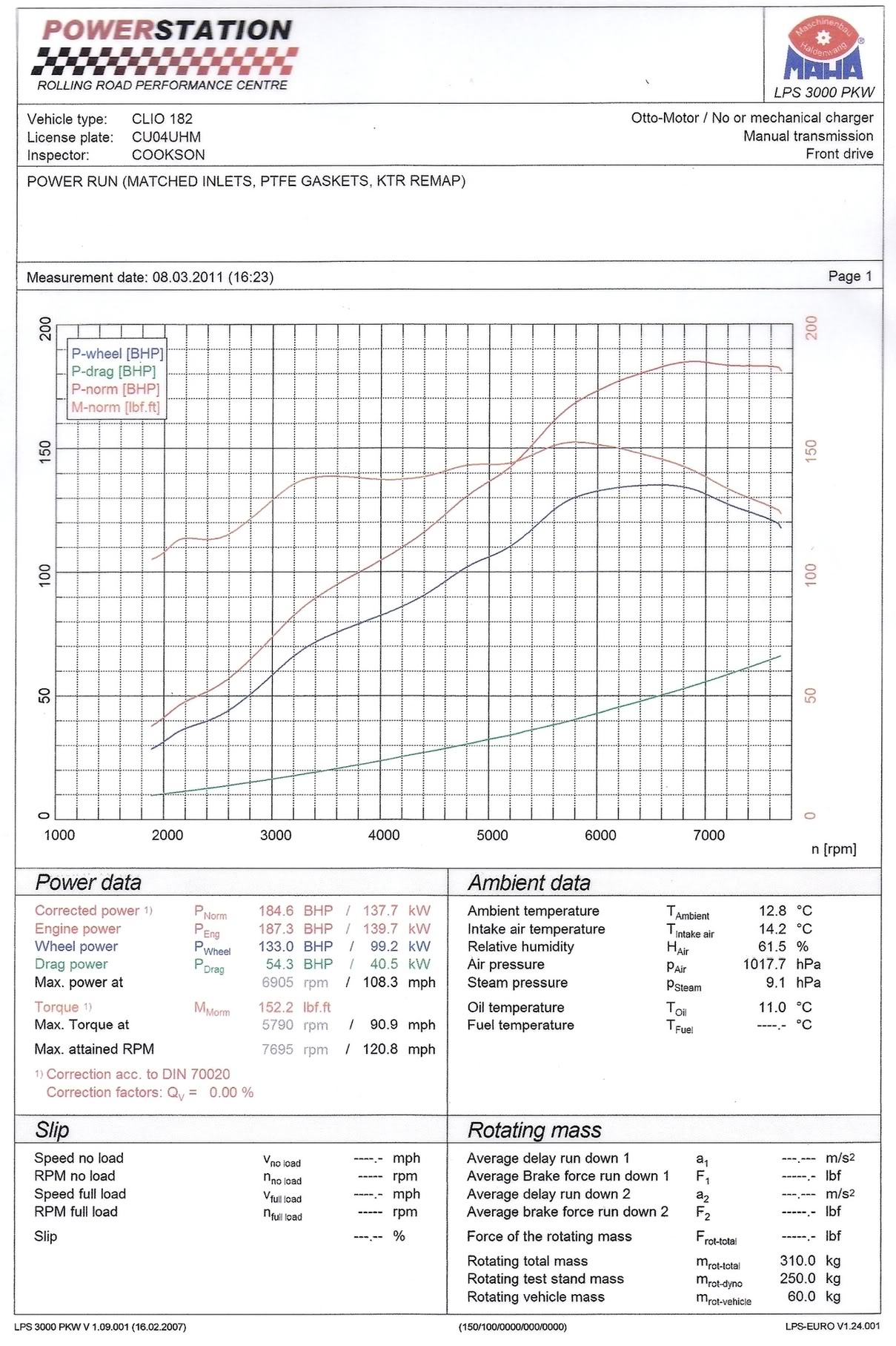

I love powerstations rr.......they always add 20/30 bhp.
And how they work out the whp?????
allways used powerstations rollers and quite a few of us belive them to be about right ktech rollers are knackard thats why they are having new ones installed im going to back to ktech in april to have my map adjusted and to see what i it gets on there new rr
Yh im going take it back to jamsport cause it defo aint right at all and after spending over £500 on having inlets and remap done i want it right.

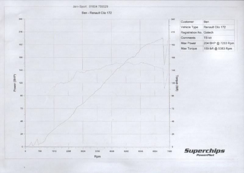

Should be a bit more like this
Yeah your power doesnt drop off so sudden like mine as mine just before 7000 rpm it drops off to about 137 bhp wheres yours holds its power alot better so just shows it aint right at all.
