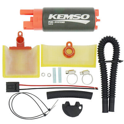

Any recommendations for which fuel pump to fit as there’s lots on the market from different suppliers?

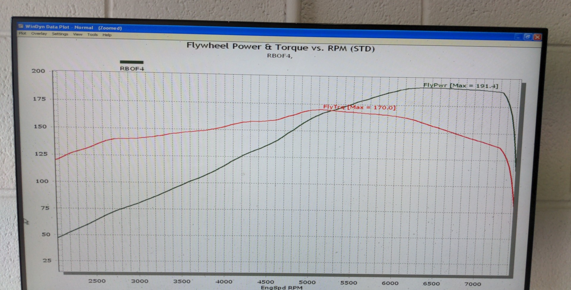

had mine done 2 years ago on about the same millage, belts and dephaser were due. I found a set of 197 cams and had them done @ Birchdown along with belts. Mapped at EFI in runcorn.
191.4bhp and 170lbs/ft
It done a few Cadwells and Oulton parks since :)
I’ve wondered this as well, I’ve thought about changing mine
