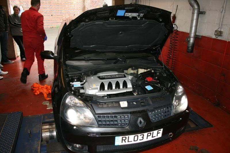

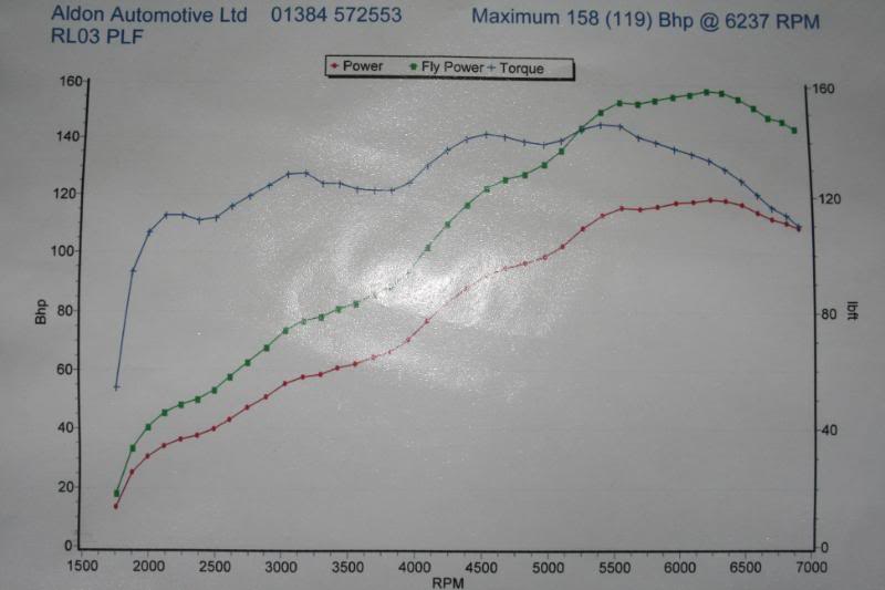

Tagged along with the FordTorque guys and RR'd my 172.
158bhp
Results were as expected tbh, car is standard and really needs a service/new plugs.
will be getting panel filter, NGK plugs and engine mounts done in the next few weeks, any other recomendations after that?
Pics here for you guys.

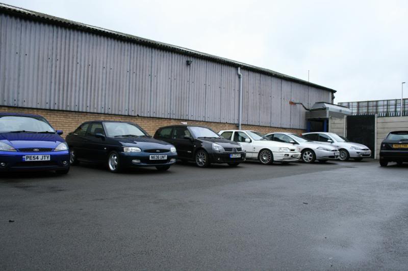

Various cars:
how were your tyre pressures?
mine made 169. it's standard other than my exhaust.
Realistic if a little low, least u didnt get an AWEOMSE 190bhp from a filter and an exhaust. A good starting figure if nothing else, I hate RR posts in general though :D Ive been back to the same RR 4 times now and im slowly gaining, 10bhp up on the first visit so far from suble changes :)
Lol no i'm no fool claiming massive gains off minor mods... maybe i should get a resistor off ebay....? lol
Do tyre pressures affect RR results that much??
yes iirc. i went to TDF without having checked mine in a while. i made 159. Matt told me to go away and check my tyres... i went and put them back to their normal 30psi and hey presto... 169bhp.

And guys checked my tyre pressures and they were as follows
Front:
NS - 24psi
OS - 27psi
Rear:
OS - 33psi
NS 29psi
I think this is the reason like si said about the pressure being out....
