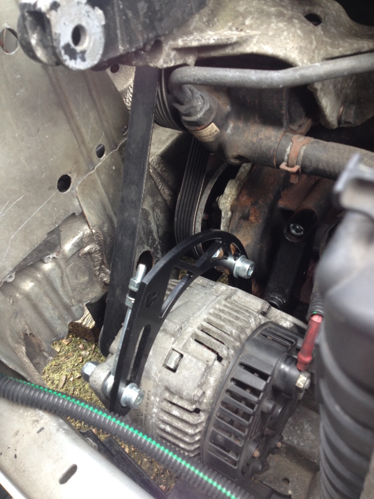

Am wanting to add the 50mm spacers to my rs2 inlet manifold so can anyone tell me the bore size of the rs2 inlet so I can order the correct bore size spaces to match. And when fitting a pure Motorsport air con delete kit dose this work with a non cup alternator or do you have to buy a cup alternator. and last I need to fit a smaller radiator to make space for the rs2 extra I know it's the vw polo radiator that's used any specific model. thanks guys
My Ph1 172 set up as mentioned above
